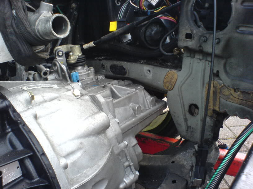

I bought a mocal pump, 8 row cooler and filter for my old box, exit on the front under the wing nut, re entry on the 5th gear casing.
Its sounds like a neat system. Did you drill and tap a new hole in the casing for the inlet pipe to fit into?
Yeah, you have to strip the box though (swarf)
Prob cheaper just to let them blow up, I only did it as I had a avanti gearset, rods and diff to go in (never made it in though)
Just use the standard drain and refil points with appropriate screw in fittings. Much easier and allows it to be a bolt on setup then.
I've done this on Ford/Getrag 6 speeds and Sadev ST75's with good results.
