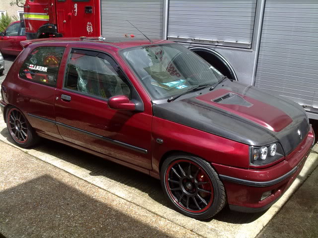

This pic also shows what happens when you use r19 16v wishbones inplace of Williams, they induce too much castor
is that not 'cause your bumper is on the piss?
no, even with the bumper straight it catches you can see the wheel isnt centre to the opening like a williams

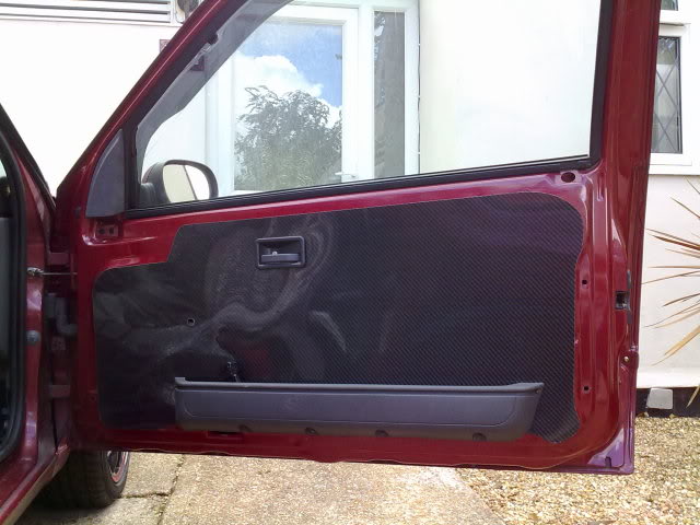

Also fitted the carbon door card to that door.

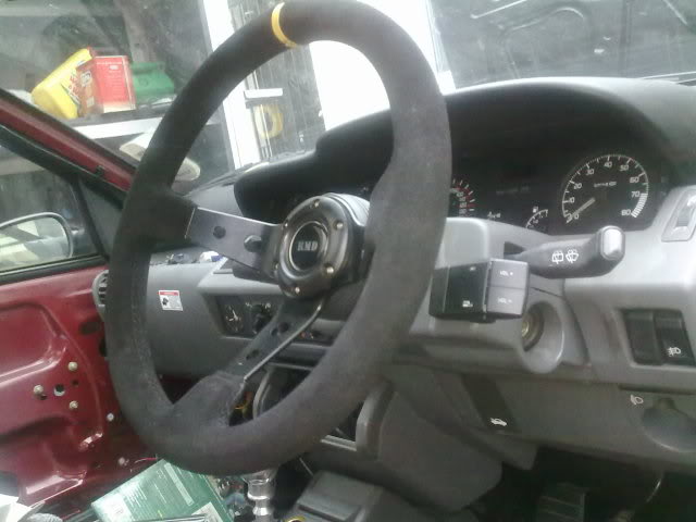

Fitted the new steering wheel, R19 ph2 16v stereo controller (its angled more towards the wheel and just generally looks better), Filled the box with oil,

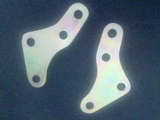

Got my rear brake brackets !!
GET
IN!!!!!!
just waiting now for some bolts to turn up in the post so i can fit the brackets :D

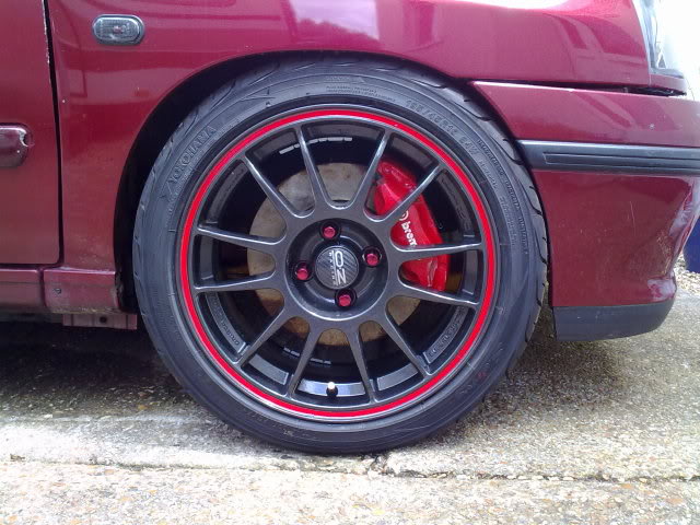

Have you got a bias valve to try and sort the brake bias out? With the extra mechanical advantage of the 265mm discs your going to want something surely?
nah was just going to adjust the std one. no need to now tho, going to put standard stuff on. really lost interest now
when i plotted the brackets i made the mistake of adding the difference of the disc diameter's to the drawing, not the radius, so it moved the caliper out twice as far as i needed :( school boy error

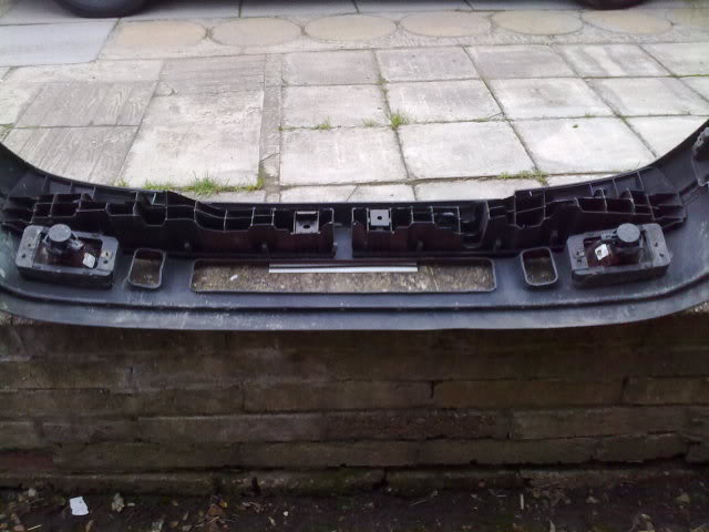

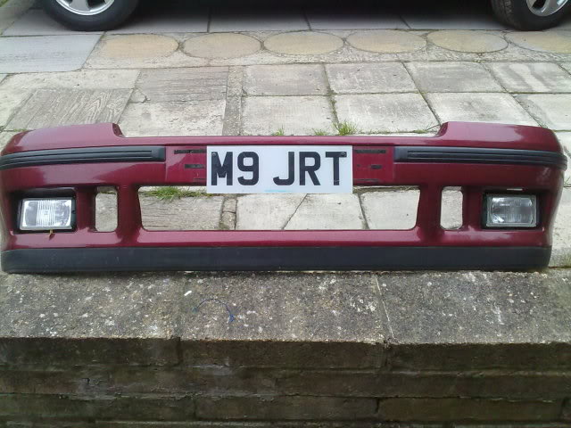

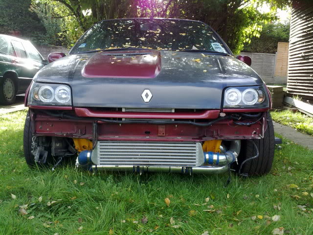

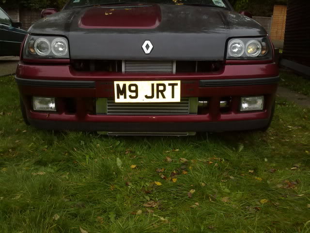

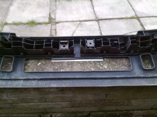

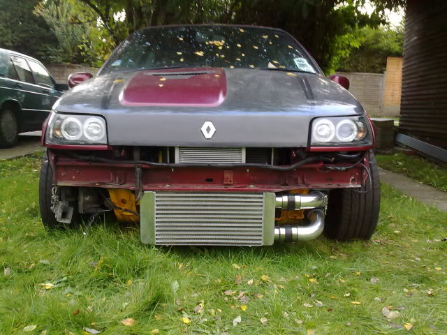

How much bumper are you going to have to remove? I fitted my intercooler in basically the same place and was pretty shocked how much of the bumper had to go.
so much neater! That's awesome.
Yeah i had to trim a fair bit off mine, not too bad though as it still retains its look fortunately
Intercooler sits a bit low though, think i might have to get an Ibiza splitter or something :(
