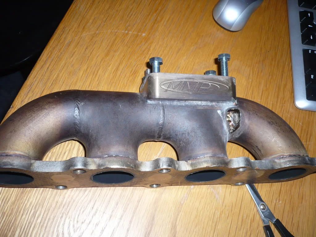

Looking good.

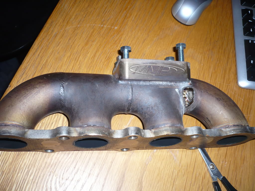

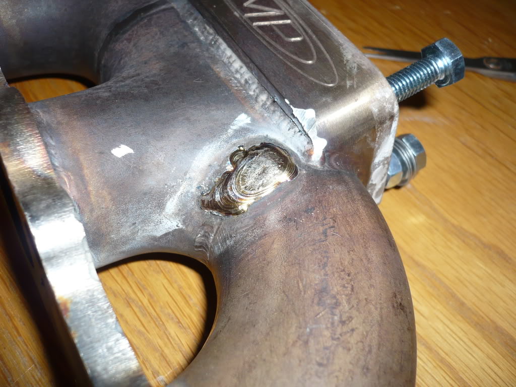

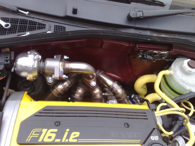

From experience you are going to have sooo many problems with the manifold. I garentee those welds will crack after time. Log type manifold is better but even these seem to warp and crack.
  Renault Clio 16v
yeah im aware its going to crack :( one of the biggest pain jobs to do aswell, as im going to have to remove the head/engine to get the manifold off
  Sunflower & Golf Mk6 BMT
If you can somehow re-enforce those welds, then try to. I replaced all my exhaust mounts and tried giving the system more support just to take abit of stress off the manifold. But its difficult to stop warping and expansion.
Some manifolds have a cut on the mating face of the manifold to allow for expansion.
I have had to remove and weld mine twice now!! lol
  Renault Clio 16v
ah right, well i've got to fit all new rubber mounts on the system anyway. plus im looking into a mani/turbo brace to the block to take a bit of weight strain off of it

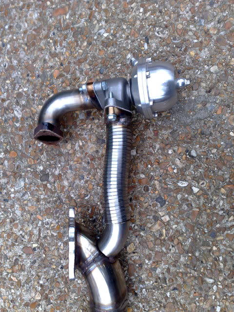

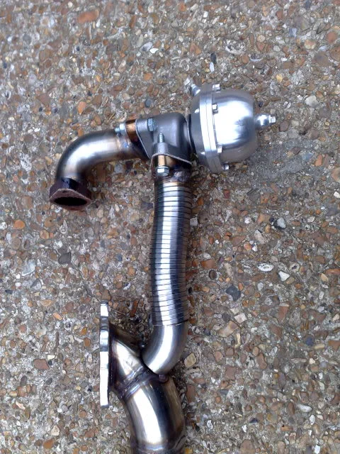

Exhaust is finally all put together and worked out after much hassle!! Found a nice section of flexi piping :)

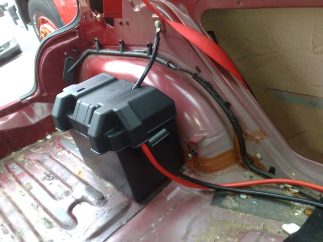

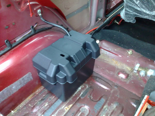

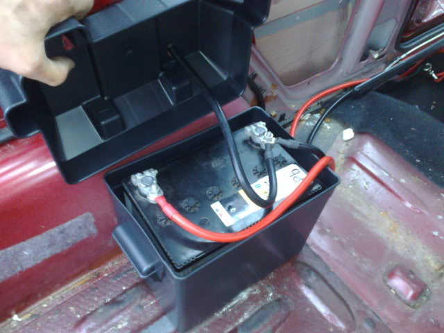

Also put my battery box in

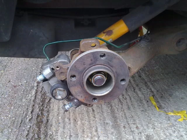

Tomorrow is D-Day (decision day) on rear brakes wether i mod them or keep standard as i'll be hearing from/visiting the machinist

  Clio V6 Mk2 255
Looking good.
I concur with some of the above ...
I just saw this thread and read the first couple of pages (will finish the rest in a bit) and my immediate thought was the manifold and turbo - it is in clear need of a turbo stay IMHO to prevent cracking/failure of the manifold which I would say will occur otherwise. I have had a fair bit of experience with turbo installations on various cars and have had tubular manifolds made before and have experienced issues with no stays.
It shouldn't be too hard to make a stay up to support the turbo though if you haven't already.
I also hope all the welds have been cleaned up inside the exhaust manifold too but that should be a given and it looks like a comprehensive job ...
Looks a great project though and I love turbochargers :)

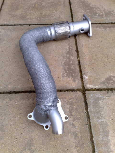

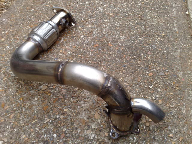

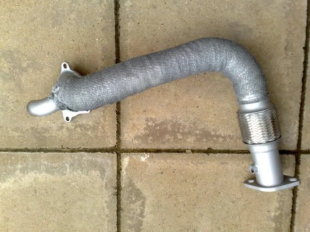

Wrapped the downpipe today. Bought 100ft of exhaust wrap and still have miles left :lol: so going to wrap the decat aswell lol doesn't look to bad, sprayed it with some silicon stuff for heat wrap ?

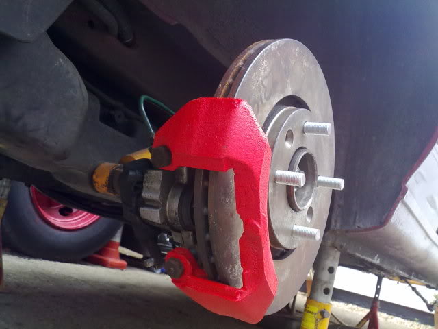

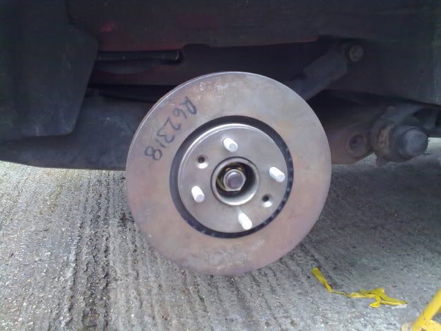

Lil update

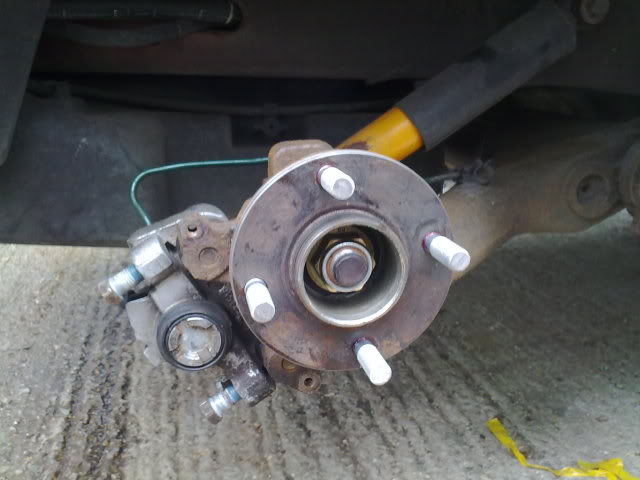

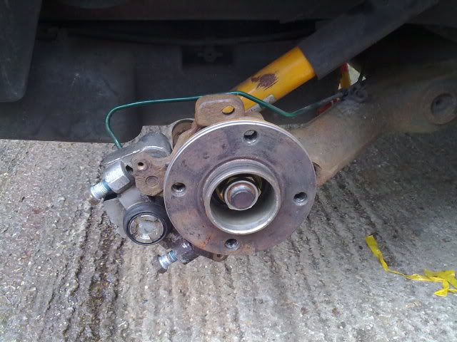

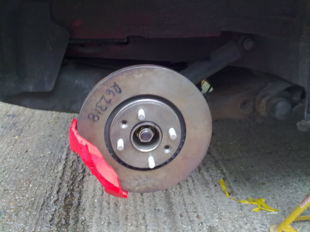

FINALLY got my hubs back after sending them off again to be reduced further
Bolted them on

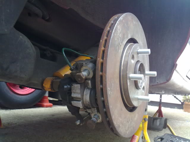

Fitted the studs
Slapped a disc on
then put the pad carrier on to see wahst what wehn it comes down to moving the calipers out for them
A little unsure as wether to drill and tap holes for a disc retaining screw at the moment...
Discs are 265mm

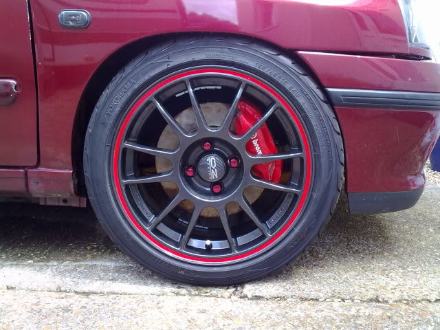

Put some rimtape on the wheels
This pic also shows what happens when you use r19 16v wishbones inplace of Williams, they induce too much castor
