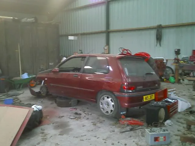

Back in June of 07 :eek: my bottom end decided to throw a shell and knock its tits off. I kept driving till she seized as I had a court case pending due to a motor offence ( those of you who know about it! :dapprove: )
Anyway, once it was properly fookered i took it to a barn my mate had let me use to store it and keep it safe. The months passed on by and i thought to myself sod it, I'm going to giv my beloved naples a bit of help with a blower AKA a turbo ;) .
It looked like this for a while, an abandoned, battered Clio :(

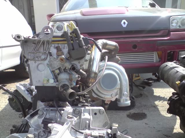

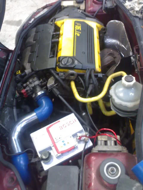

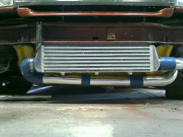

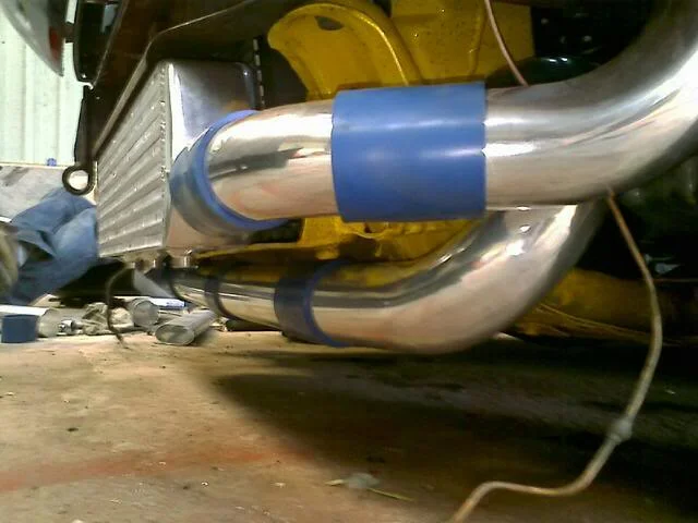

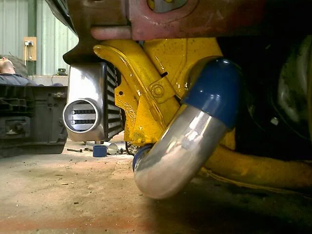

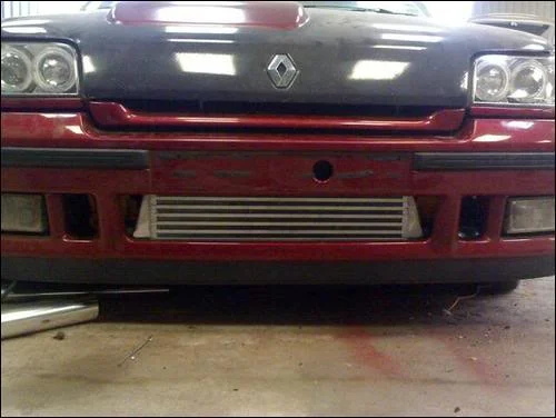

During its time there i did practically bugger all due to a serious lack of funds! But, I had managed to scrape pennies together for boost pipework and and FMIC to which i fitted to the Valver in this fashion :D

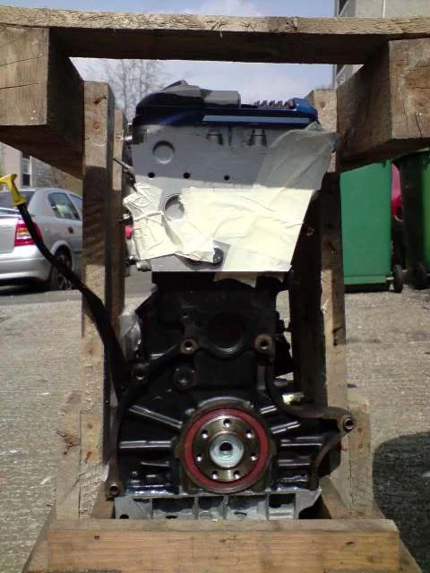

Mid April my engine finally turned up from BBPT :D It was like 5 birthdays rolled into one
Here's the spec

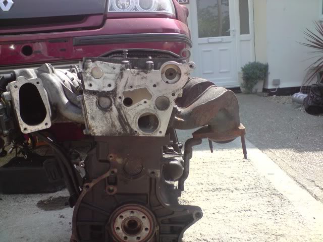

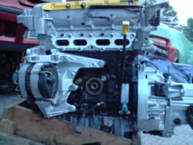

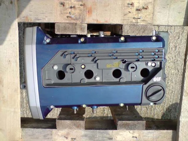

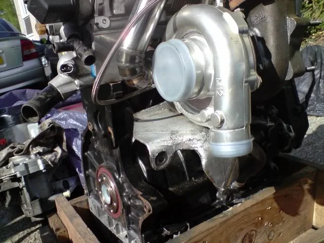

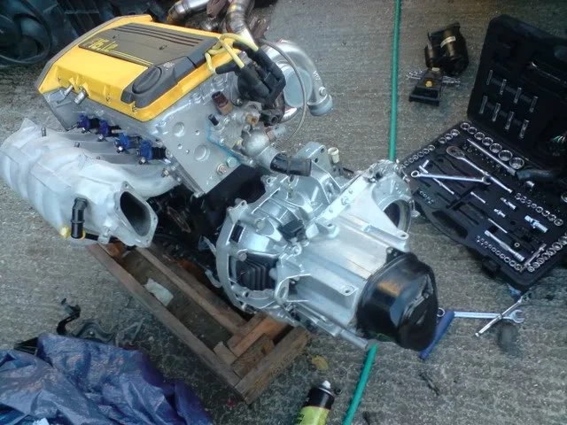

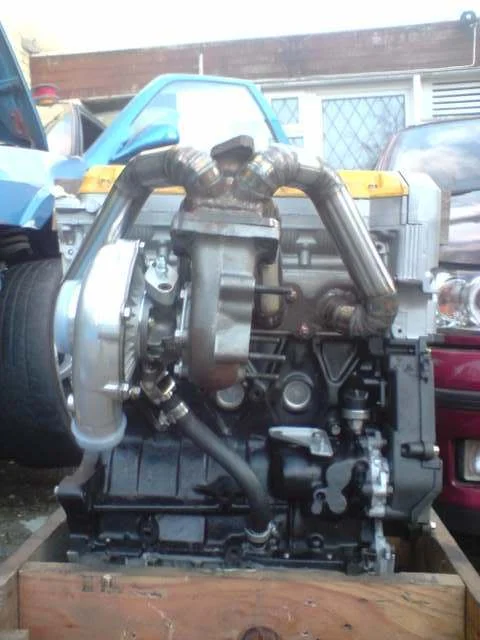

First thing i did was bolt the manifold i won on ebay on..
And then the turbo along with my yellow cam cover..

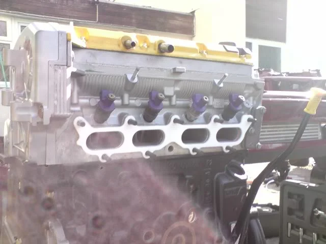

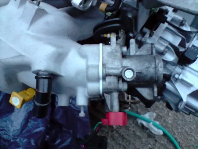

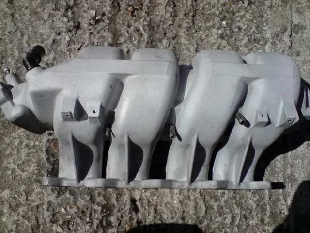

Took my spare inlet manifold for sand blasting, came out like new, and gave it some vigirous cleaning and de-coking to get rid of any trace of sand inside it. Once that was done i bolted it on with the PTFE gaskets i purchased from hill_power_clio along with the throttle body
Although it has to come back off because I found a sensor right under the inlet that's impossible to get off with the manifold on :rolleyes: and i've had a change of heart with what to do with it.

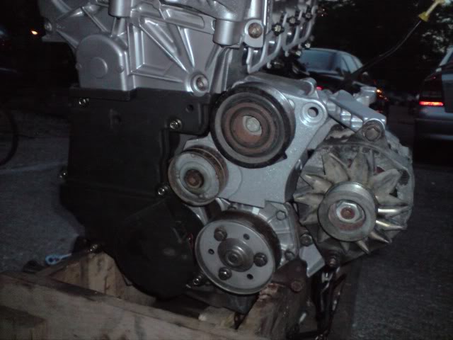

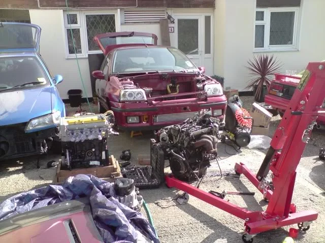

Got the old engine oot and stripped the loom, ancilaries, gear and flywheel. During the lift it kept getting jammed and was starting to get on my nerves so with a bit of not so gentle persuasion and shouting :eek: it came out. I'll give the bay a cleanup at some point.

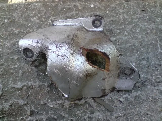

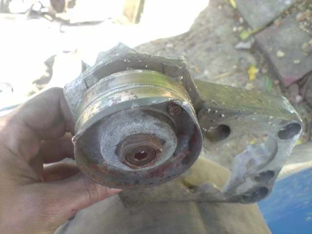

During the strip down i noticed i had damaged the idle pulley with my brute man strength :clown:
So this means more delays untill i can source another and replace it. :(

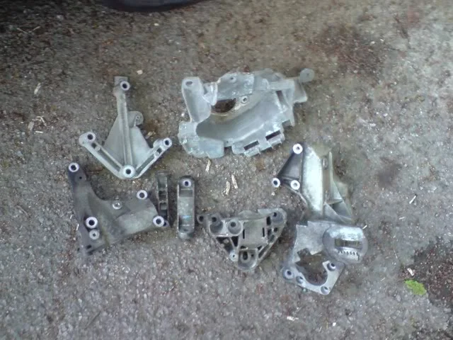

Once i got all the bracketry i tried pressure washing the parts clean but this didn't satisfy me so, along with the inlet manifold, theyre going for sand blasting and having a silver powder coat to help cleaning. This was said to me by ARJ256 and i decided to take his advice as it was a good idea.
So all these goodies + the inlet manifold are going to be powder coated

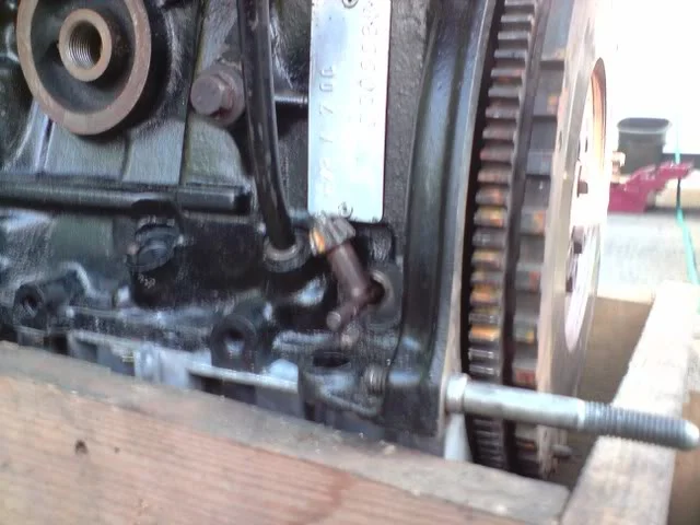

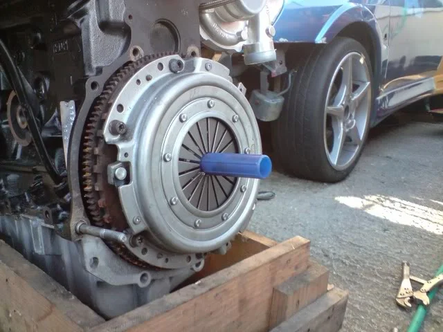

Next i bolted the fly wheel on, keeping the crank still using a chuck key in the hole on the side of the block an then on with my OMP paddle clutch and pressure plate with a clutch alignment tool. Hopefully this clutch will last a good 20 k on this engine :clown:

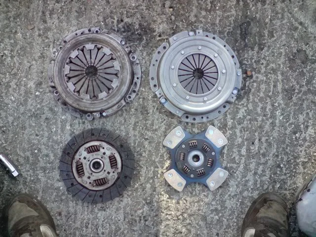

This picture shows the differences between the OMP clutch and an OEM Valeo clutch

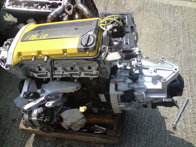

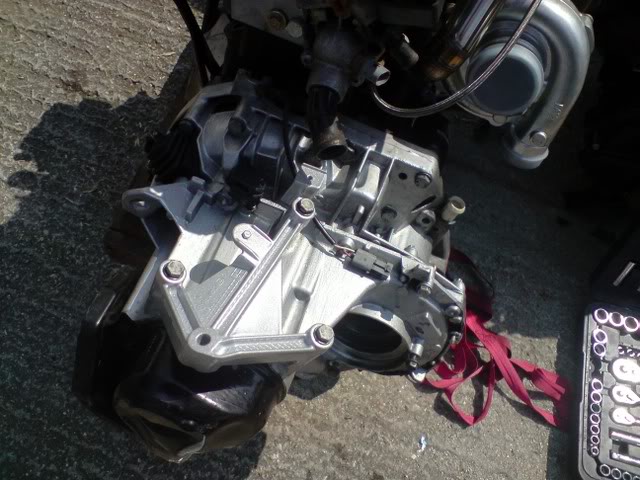

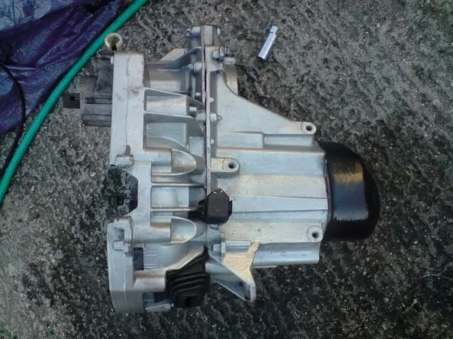

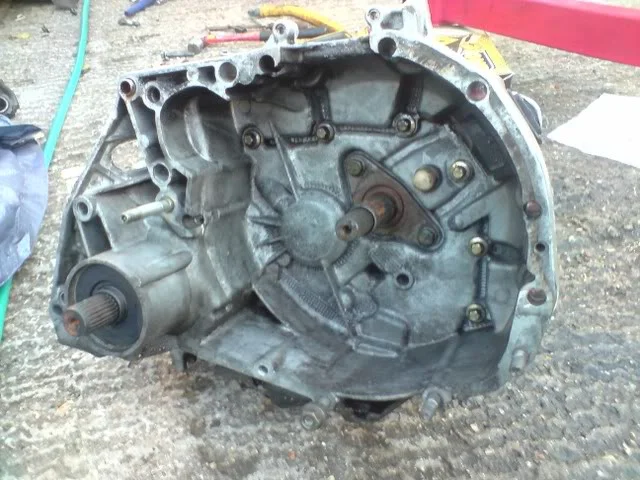

Then it was on with the gear box and suprisingly it just fell on! Everytime i've done the box before its taken a good half hour of wiggling to get the box on but not this time thankfully! This Box Is MK2 Ph1 172 JC5 gearbox.
Once that was i i went to fit the valvers recently replaced starter to find.......... IT DIDN'T BLOODY FIT :rolleyes: at least i now know why they dont fit the F7R, its because of the strentghening veins on the rear of the block :roll: :oops: No pics of that cos i was that fooked off i gave up and went home :lol:

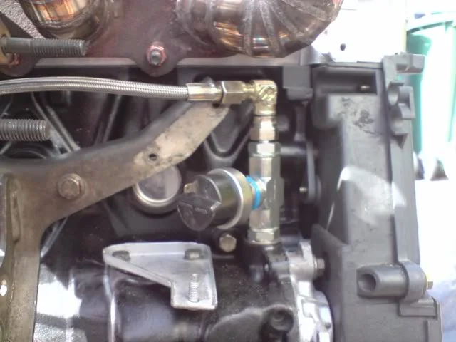

Next day i thought i'd have a look the oil feed and return for the turbo. i modded the starter heatsheild the miss the oil return and took a trip to my local Pirtek http://www.pirtek.co.uk/ and had them shorten my braided oil feed line and make a T-peice for the feed and oil pressure sender to bolt to.
more updates when i can remember what i did :p

I don't like the look of that new clutch.

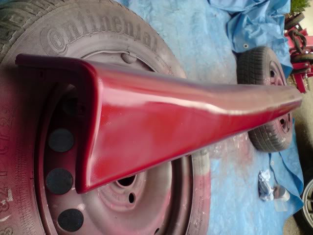

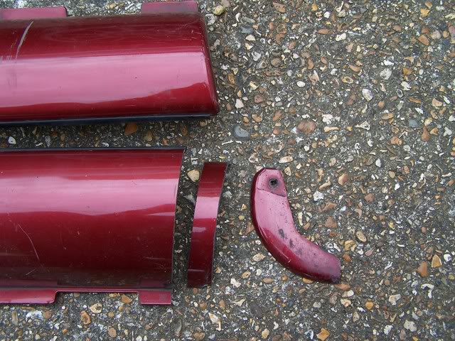

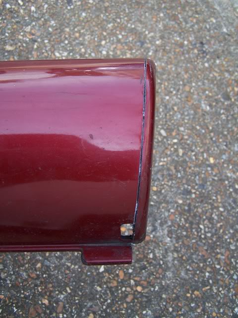

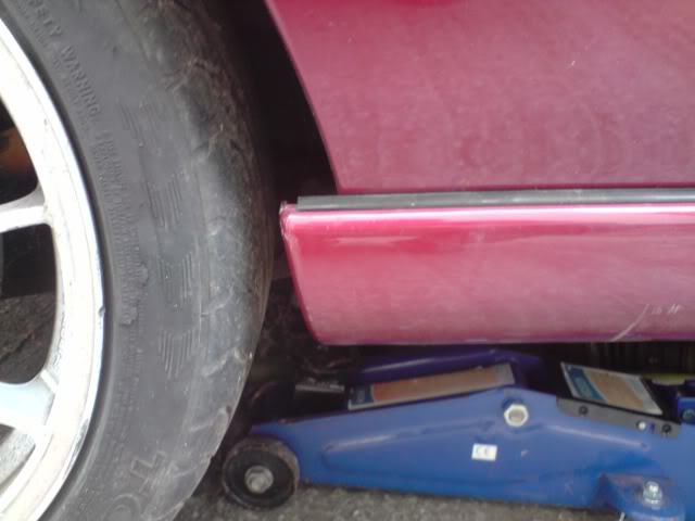

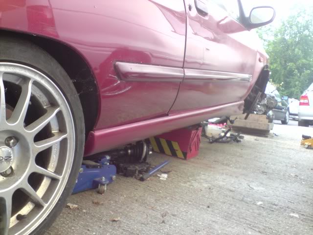

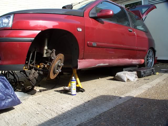

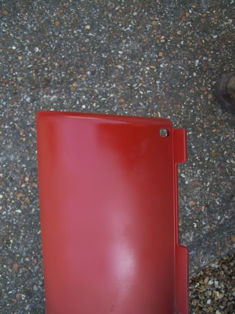

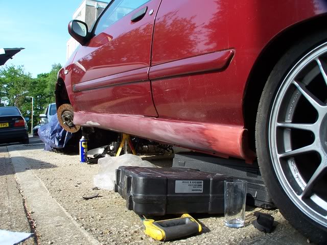

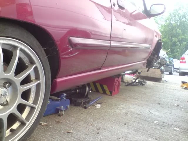

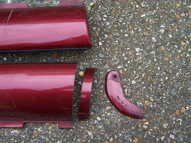

Not had any money for a while and still waiting for parts from powder coaters, so i thought i'd have a bash at my sideskirts. But dont worry theyre Gen Renault skirts not some chavved affair.
As many of you know, when it comes to RSi skirts theyre too long for the 16v shell.
It's not much but enough!

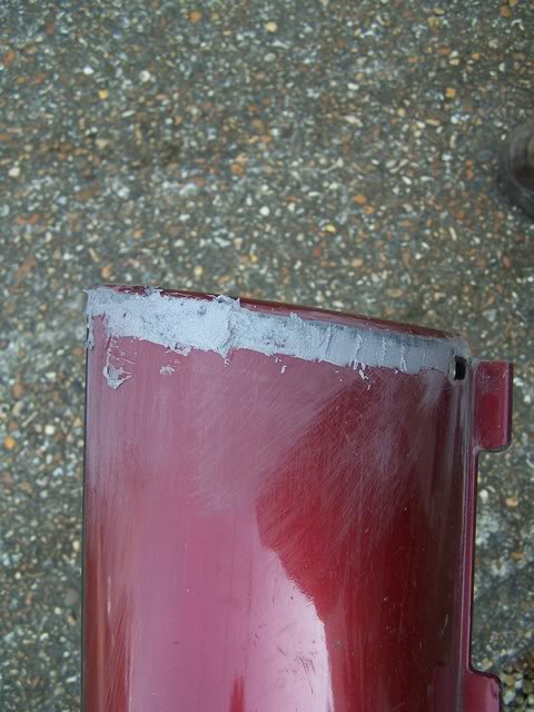

I cut them down, used some upvc facia super glue with its aerosol activator to get it stuck on in position
It's allmost good enough to leave, damn I'm good just a shame they're scratched to hell :(

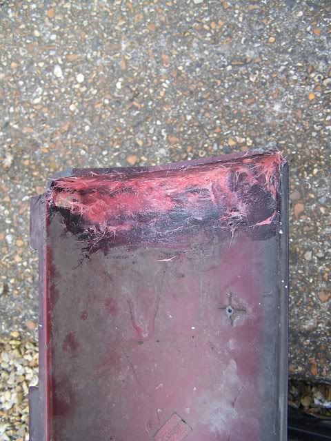

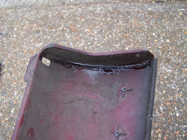

Anyway, before my head gets too big lol, I put some fibre glass on the rear to give it some real strength even the the glue is strong it did break of too easily for my liking.

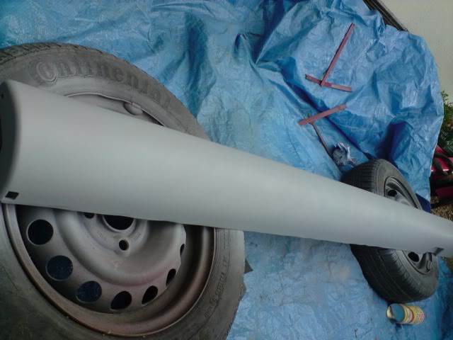

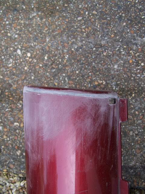

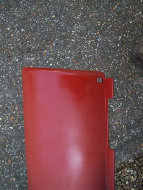

Once that had dried on both skirts I fillered and sanded down the join i had made to make it nice and smooth :) After that a quick coat of red plastic primer to check for any parts where the filler sank.. Guess what, it was perfect :D then i rubbed down the entire skirt removing and guages and scratches in the paint ready for fresh stuff.
Once that was done i gave it a trial fit after removing the rubber around the edge so it still has the OE look when painted.

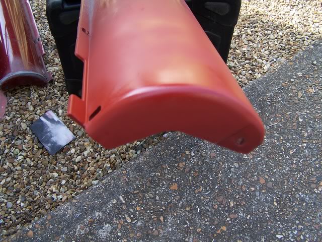

Finnished my skirts off today, went all good untill i laquered them. A bit patchy. Anyway, a few pics.
Going to give them a polish or something to see if it evens it out bit.

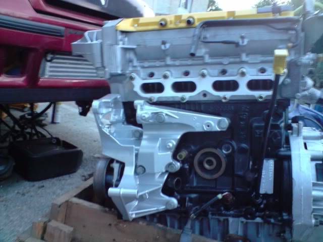

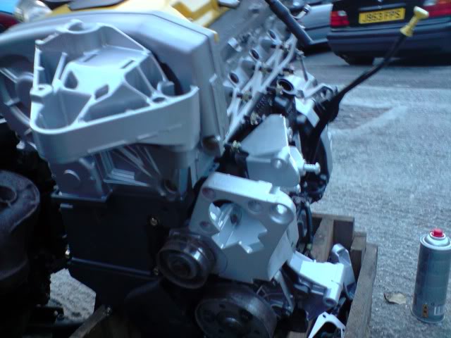

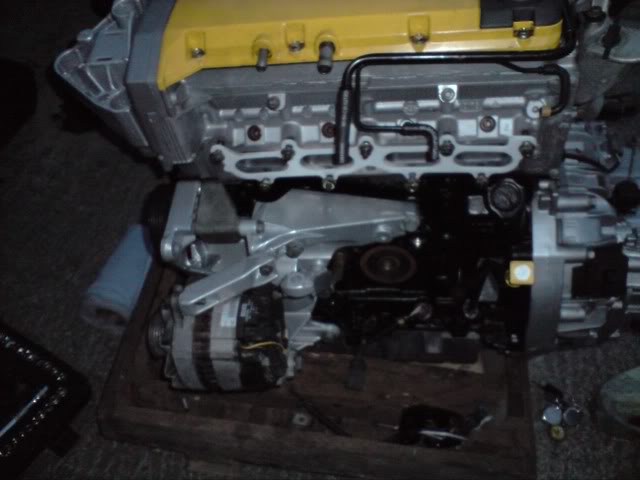

Got my bits and manifold back from the powder coaters also and bolted em on.
Was getting dark now, so finished up with bolting on the pas removal pulley
A rare part :D
Today i bolted the box mount on.
Quick pic showing how it is at the moment.

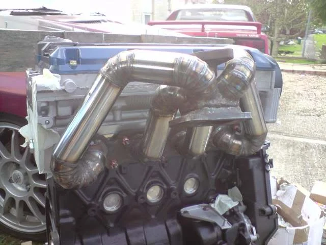

And some pics comparing standard manifold to the turbo'd one. Not a great deal i dont think
Ditch those 325cc inj's. 440cc + ftw!
whats up with the clutch?
injetcor upgrades will ome when i get a new turbo.
2 Points
1) I don't think it'll ever be able to cope with the torque you will produce
2) Its 4 puck clutch that means it'll be very on/off in the engagement. Makes setting off a ball ache and it will kill your already weak 172 box and driveshafts.
2 Points
fair call. any recomendations for a better clutch?
Waitey
  Alpina D3, AC Cobra
2 Points
Give Helix clutches a call. Tell them what torque you'll expect to be running then tell them you want a kevlar disk.
I've got a custom Helix organic/kevlar clutch. It drives and engages just like a normal clutch except it'll handle 260lb/ft.
It is a bit costly though. I think the final bill for mine was £310.
Whereas most 'uprated' clutches on ebay will be £100ish.
