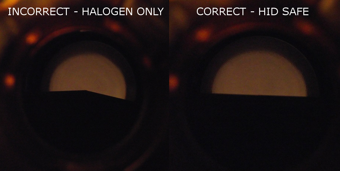

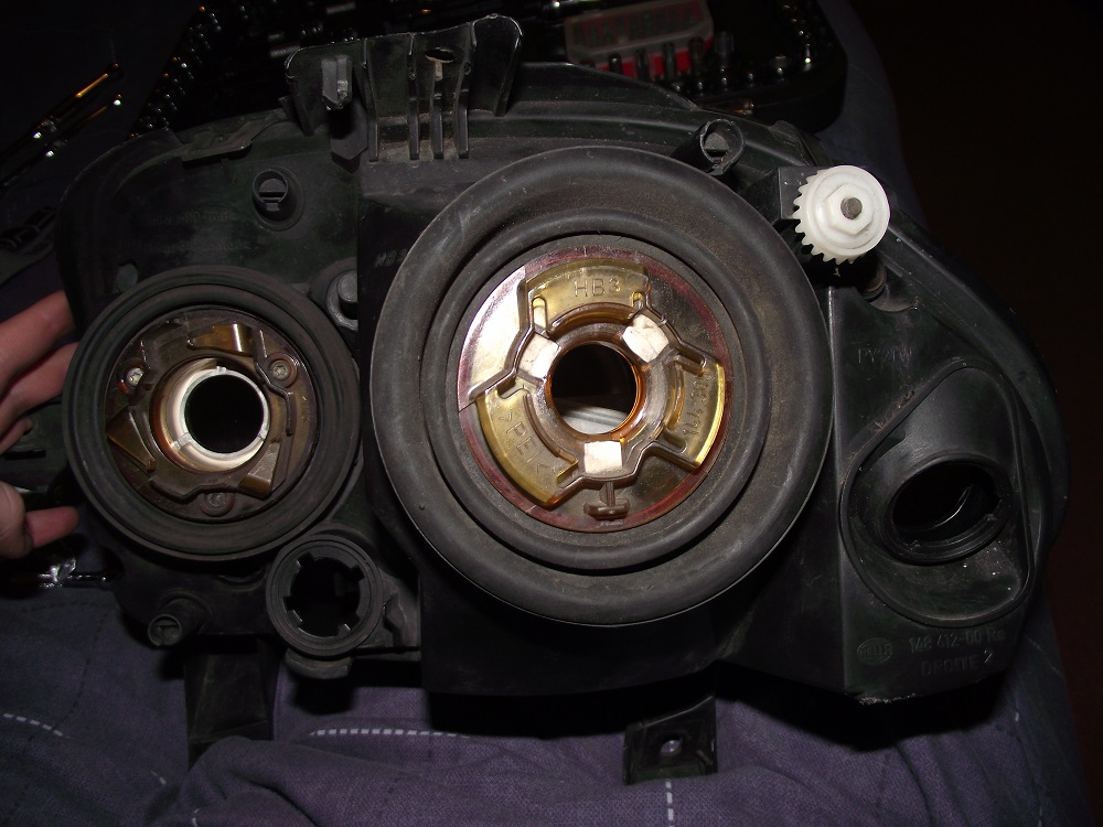

1. Remove the headlight bulb. You'll probably need to look down the opening it sits in to verify the shutter position. (You can do this with a small mirror, or if you're doing the conversion you can set them up before fitting them to the car). In this guide I'll be doing it with the headlight off of the car like so:

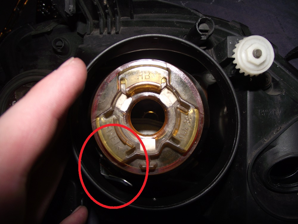

2. Remove the rubber cover around the dipped beam holder. It just pulls off.
In the red circle is the lever we're interested in. It moves left-right, and controls the shutter. Slide it left to move the shutter into HID mode. Verify the shutter has moved correctly by looking through the bulb holder at the shutter:
Obviously you want to have it set up as on the right.

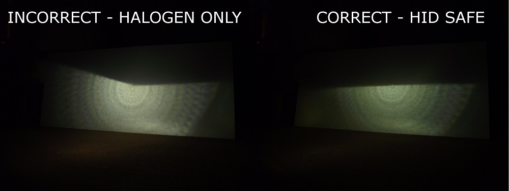

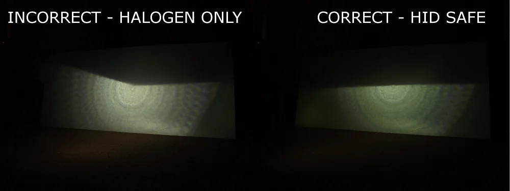

Then slide the cover back on, reinsert the bulbs and you should now be able to test the headlights. The beam's not totally level here as the unit's sat on the floor and the light is being provided by my phone hence the change of brightness.

Ph.2 headlights are HID safe anyway, as the cutout is permanently in the position shown in the right of the picture above.

wrong a HID can have the same pattern as a halogen bulb. it wont blind other road users as the kick up is on the nearside of the road same as a halogen bulb. if you have removed your headlamps then you need to get the aim rechecked.
only HID conversions using the h4 bulbs will need converting.
the bit you moved is so the headlamps can be made to be used abroad.
Whilst the kick up is to the near side, when cornering and when there is a vehicle in front of you, there is a risk posed that the kick up will allow the other vehicle to be exposed to the full beam strength. Which is dangerous. As for checking the aim, I can do that myself, but for the record it's worth rechecking the aim after doing the above. HID conversions using the H4 bulbs in the reflector headlamp unit are completely forbidden by ECE Regulation 98.
