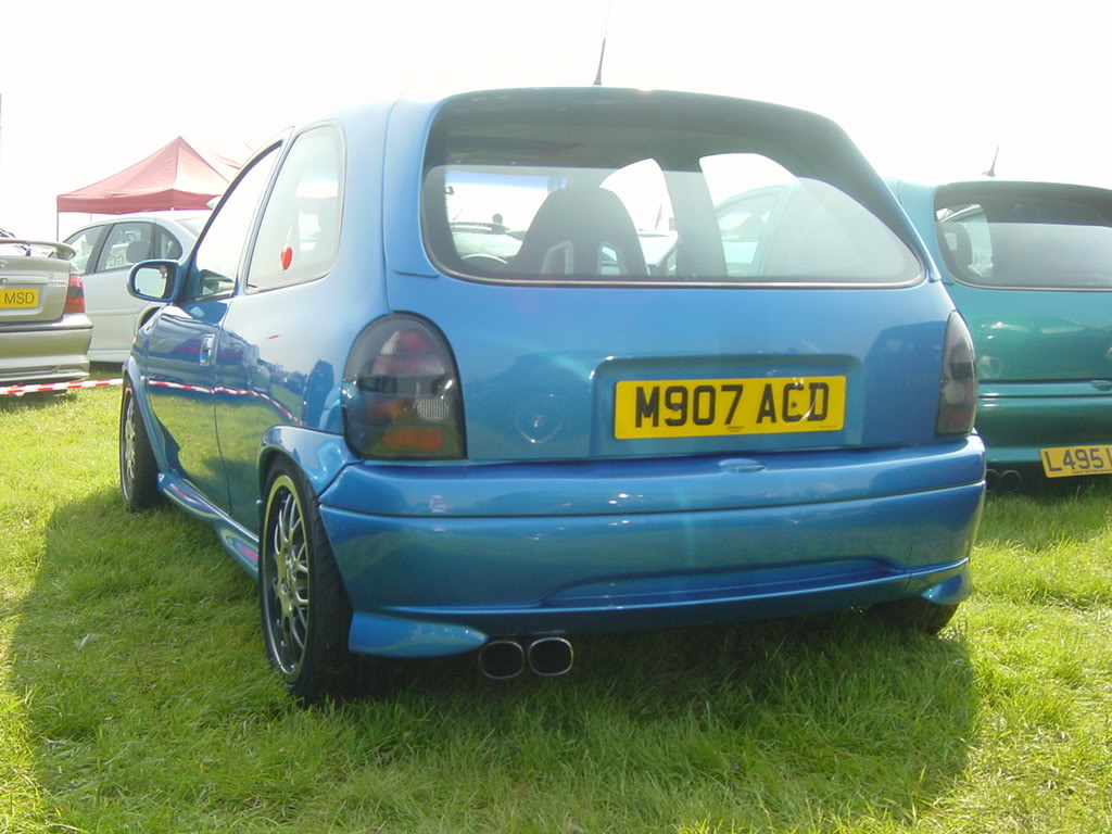

btw how much is your car lowerd in that pic? looks nice
It's already snapped off pal!
It's lowered on sportlines so about 35mm, but it's on 17s so will look lower! I want it lower at the front though but it just wont go any lower with springs :(
