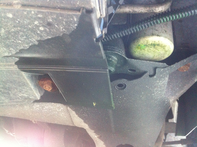

Are you sure it's missing a bolt? Not just a hole for the engine cover bolts?
Sorry 4 delay.
Definitely missing a bolt. I'll probably renew all of them while I'm at it.

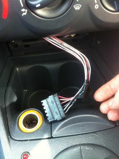

Also found what I think is the reason the unlock/lock switches aren't working. I think it's the one that got altered on the conversion.
Still waiting for a reply from Rob on that one as to where it goes.

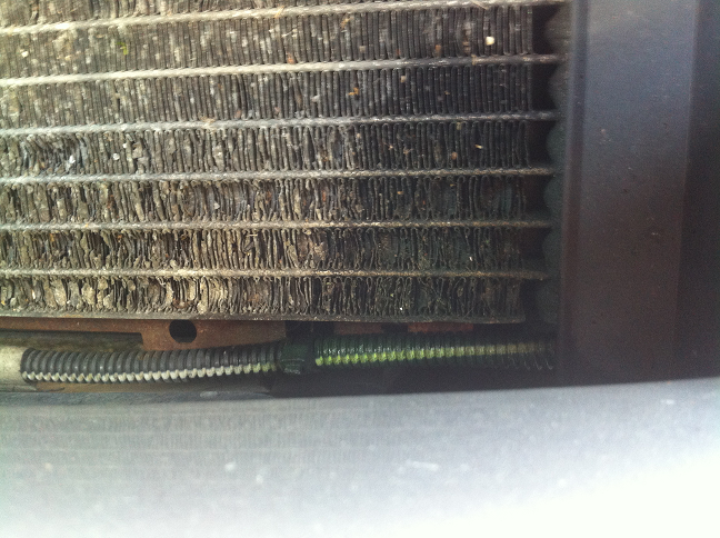

Hit a birdie the other day, went straight into the front of the car but didn't even make a sound, so I wasn't sure if I hit it. Got out, checked. Nothing at all so I assumed I missed it or it just bounced off.
However the little b*****d has left his mark. No pressure in the AC. Wonder why?
Something to fix.

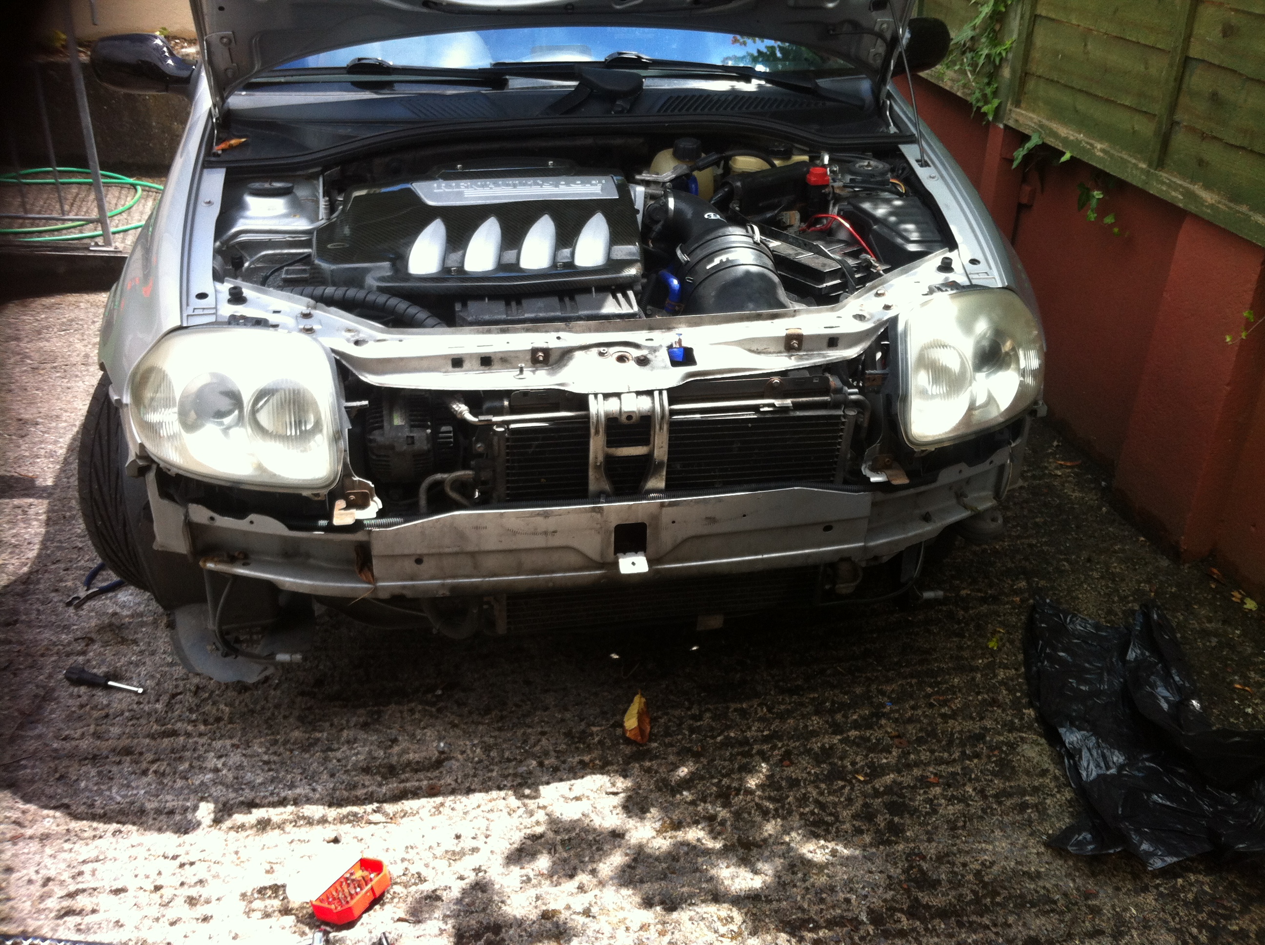

Had it in bits yesterday to change the AC condenser, but other than that, the changes above and a carbon engine cover it's pretty much the same as when you had it. Got a bearing noise to fix though, sounds like it's on the transmission though which is nicht gut.
