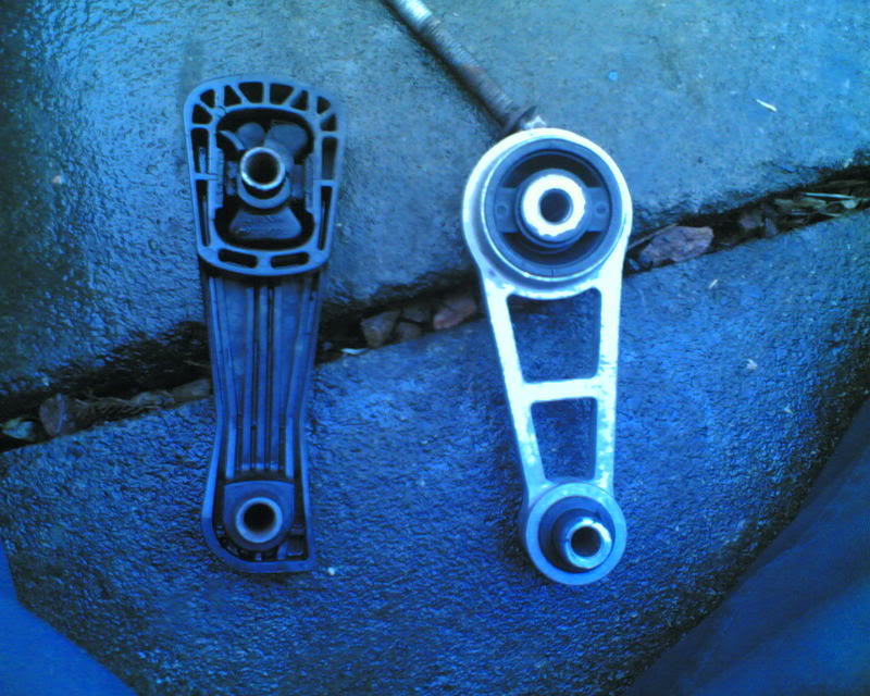

erm, cant use an uprated dogbone on the 1.6 dude.. Get an alloy one of a kangoo, lighter and stronger!

About the dogbone Andy, why not just get brand new bushes from Renault?? Any specific benefits of a Kangoo mount? Do all the dogbones fit from the diesals etc??
  Tweaked Leon Cupra R
it's lighter and the construction of the rubber looks better. it feels tighter than the std mount too.. although ma exhaust has started rattling at idle now... :(

Stiffen everything up, gearstick doesn't move about any more whilst your driving and its much nicer to use the box as its not moving around as much. Tradeoff is increased vibration on idle.
