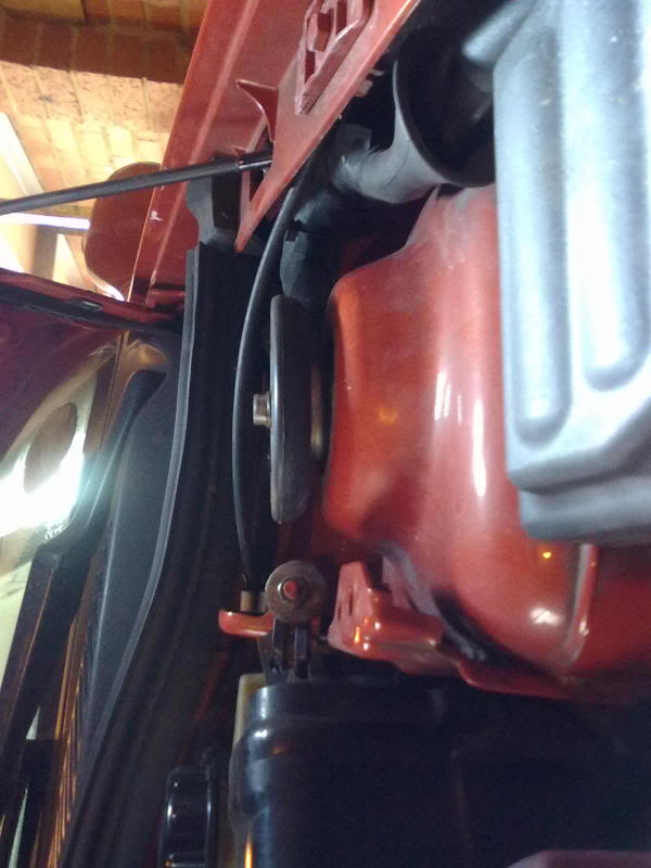

just picked mine up from renault in slough, where abouts do they fit? under the top hat but below the arch if that makes sense

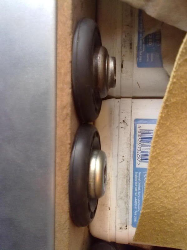

im guessing these fit on top of the rubber hats? will i need to jack the car up or just do it as normal?
I had a look at the nut at the top of the rubber hats and they appear to be a one piece part already... or am i looking at the wrong part?

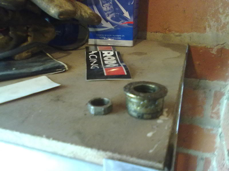

dont know why it looks so rusty in the pic coz it didnt in real life lol... but is it this nut/spacer im replacing??

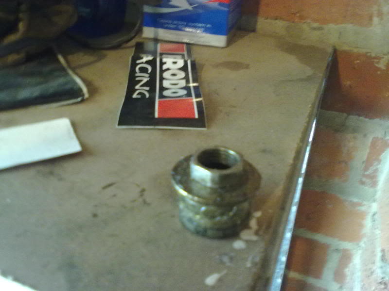

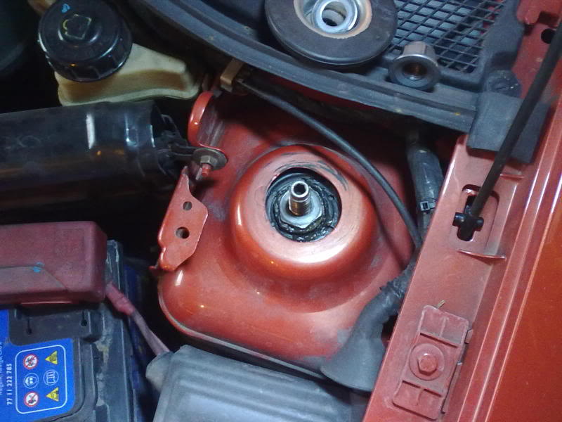

Due to popular demand here it is:
Old style insert and nut:

New insert in place (single piece):
Assembled with an m14 washer betwee top hat and insert:
