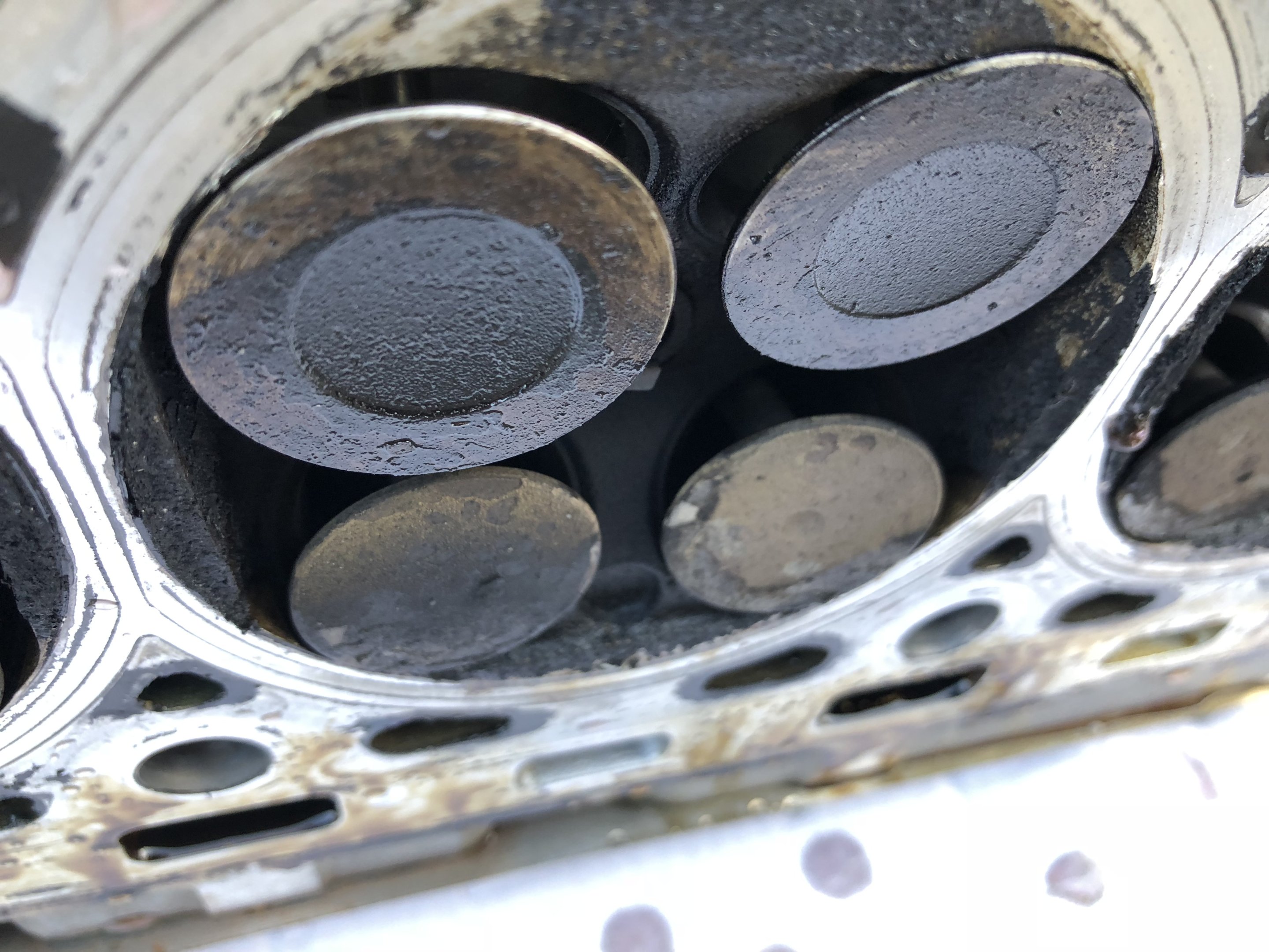

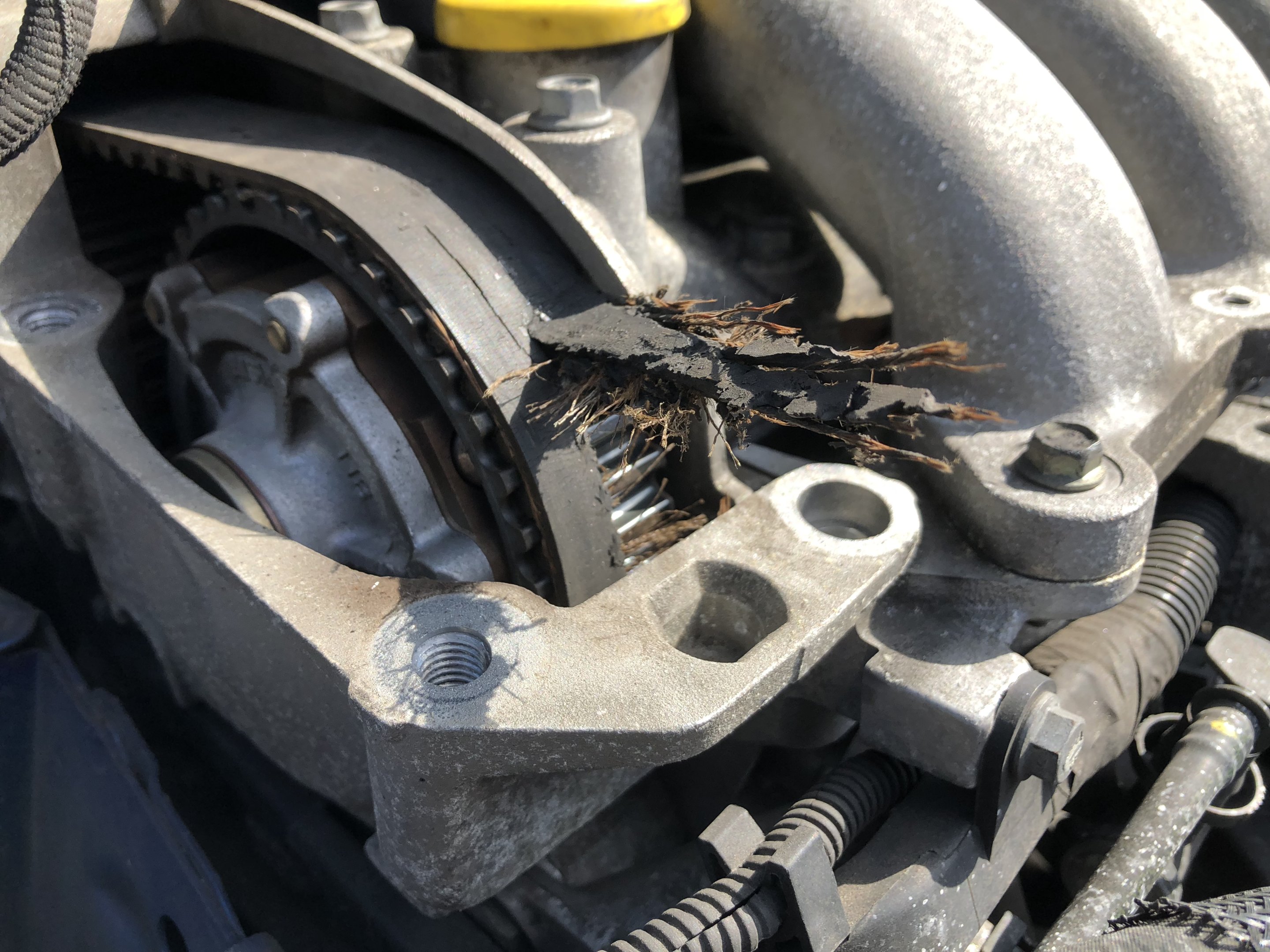

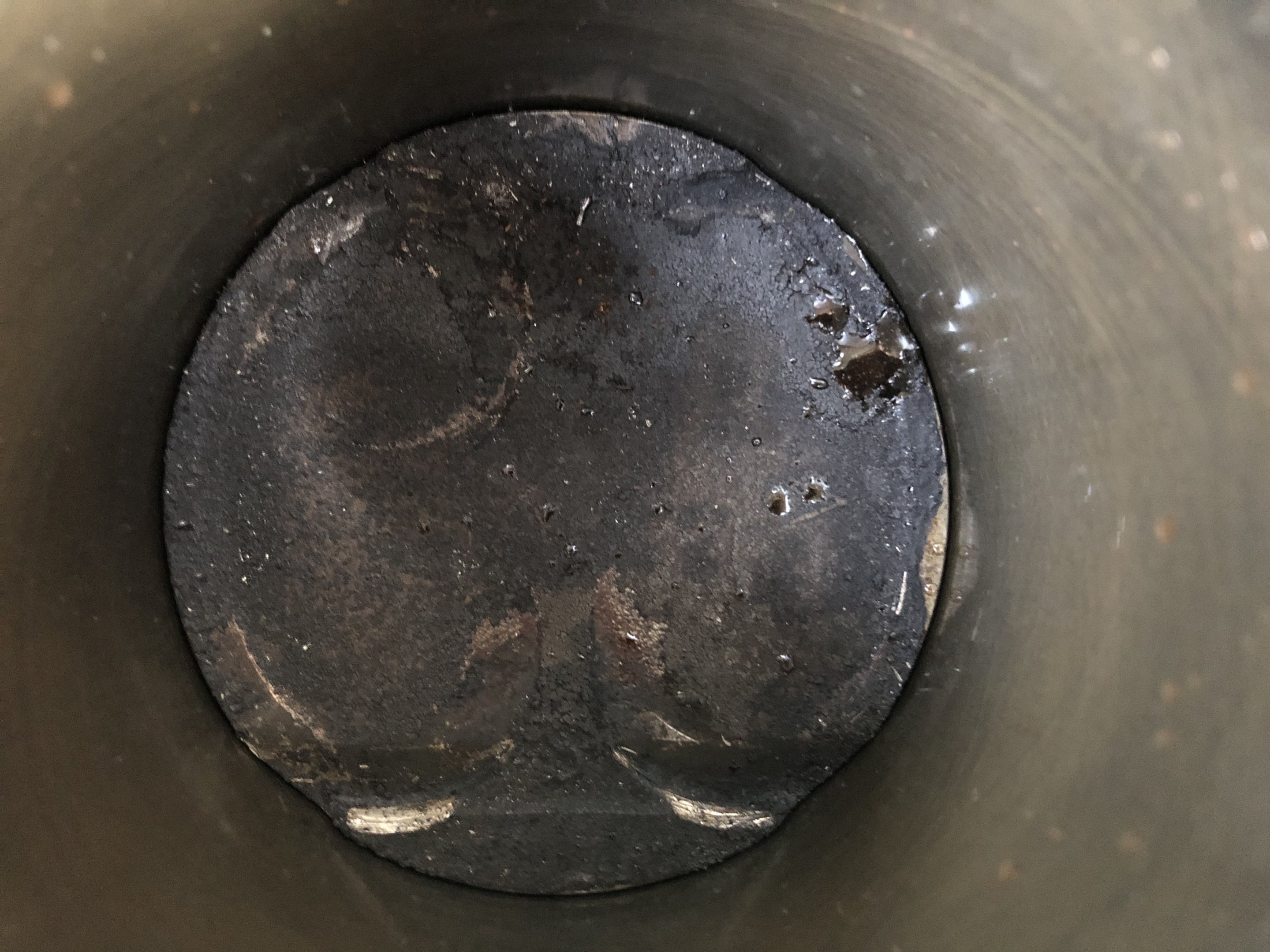

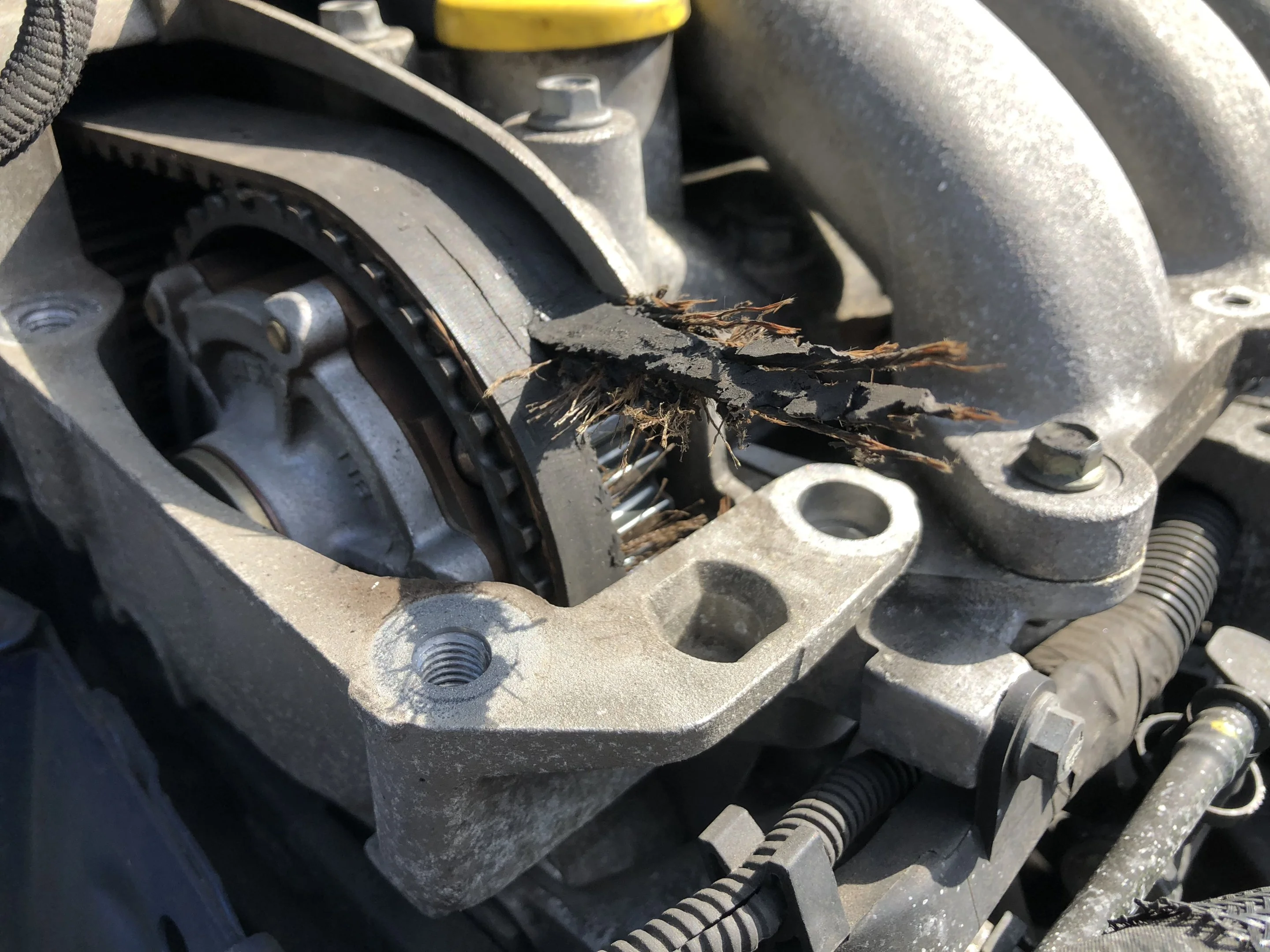

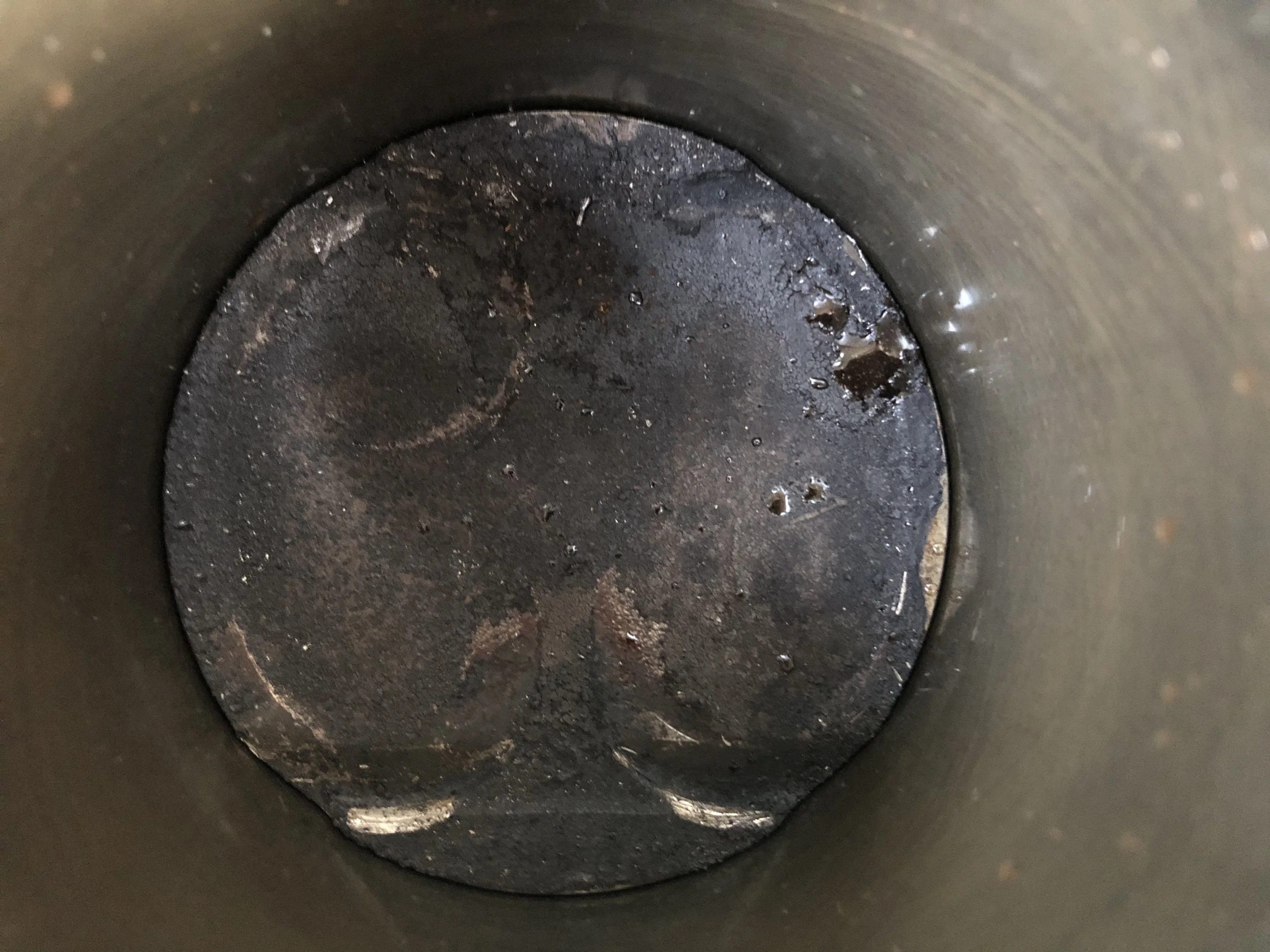

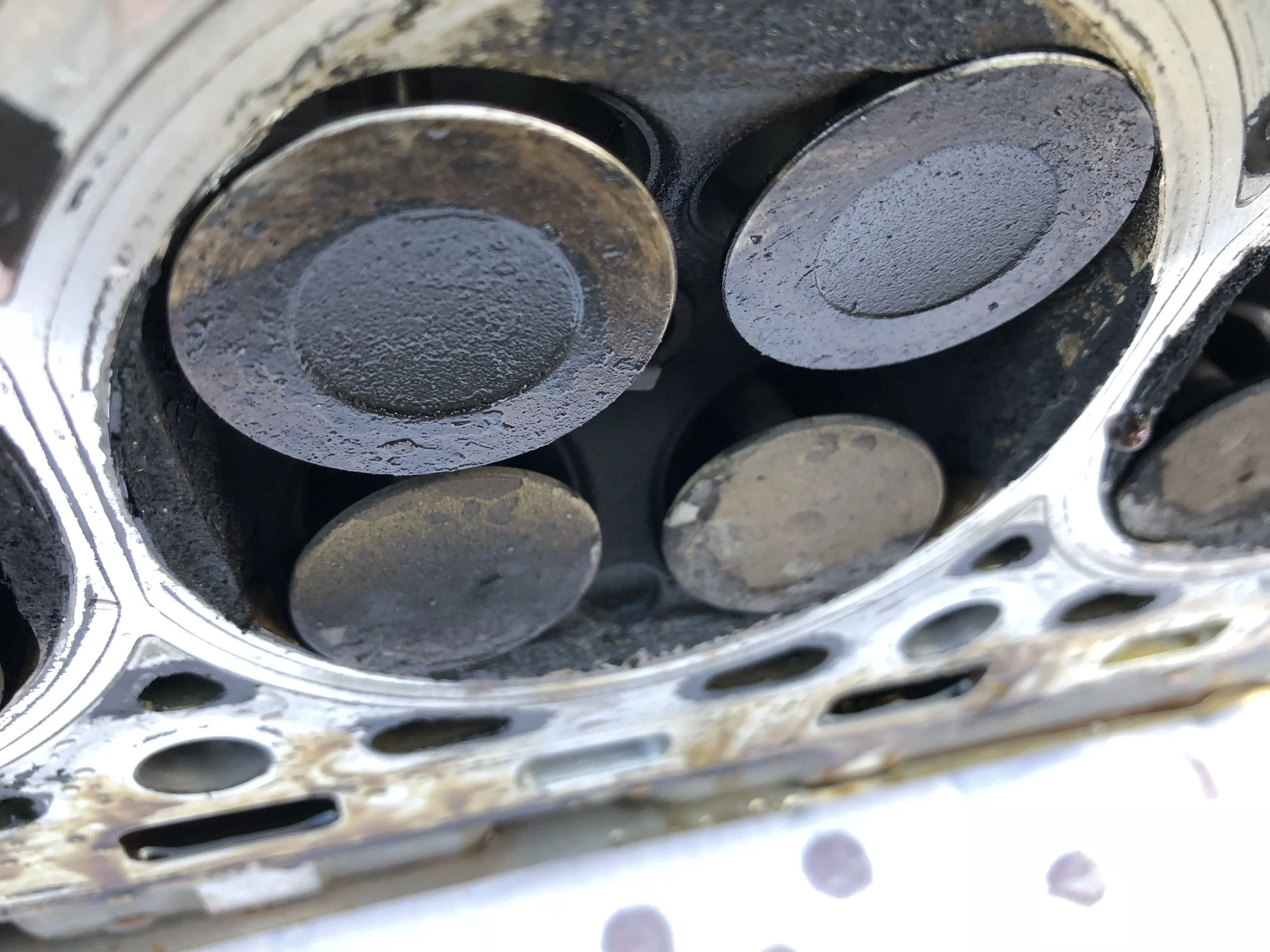

I thought id done my research but didnt realise the cambelts not only have a mileage limitation but also a time limit.
Long story short, cambelt almost snapped causing the timing to go wildly out.
Every valve is bent with minimal damage to the pistons.
Has anybody got any idea where i can find a decent engine!!
I believe buying another engine is cheaper than rebuilding the top end.
Any help will be appreciated

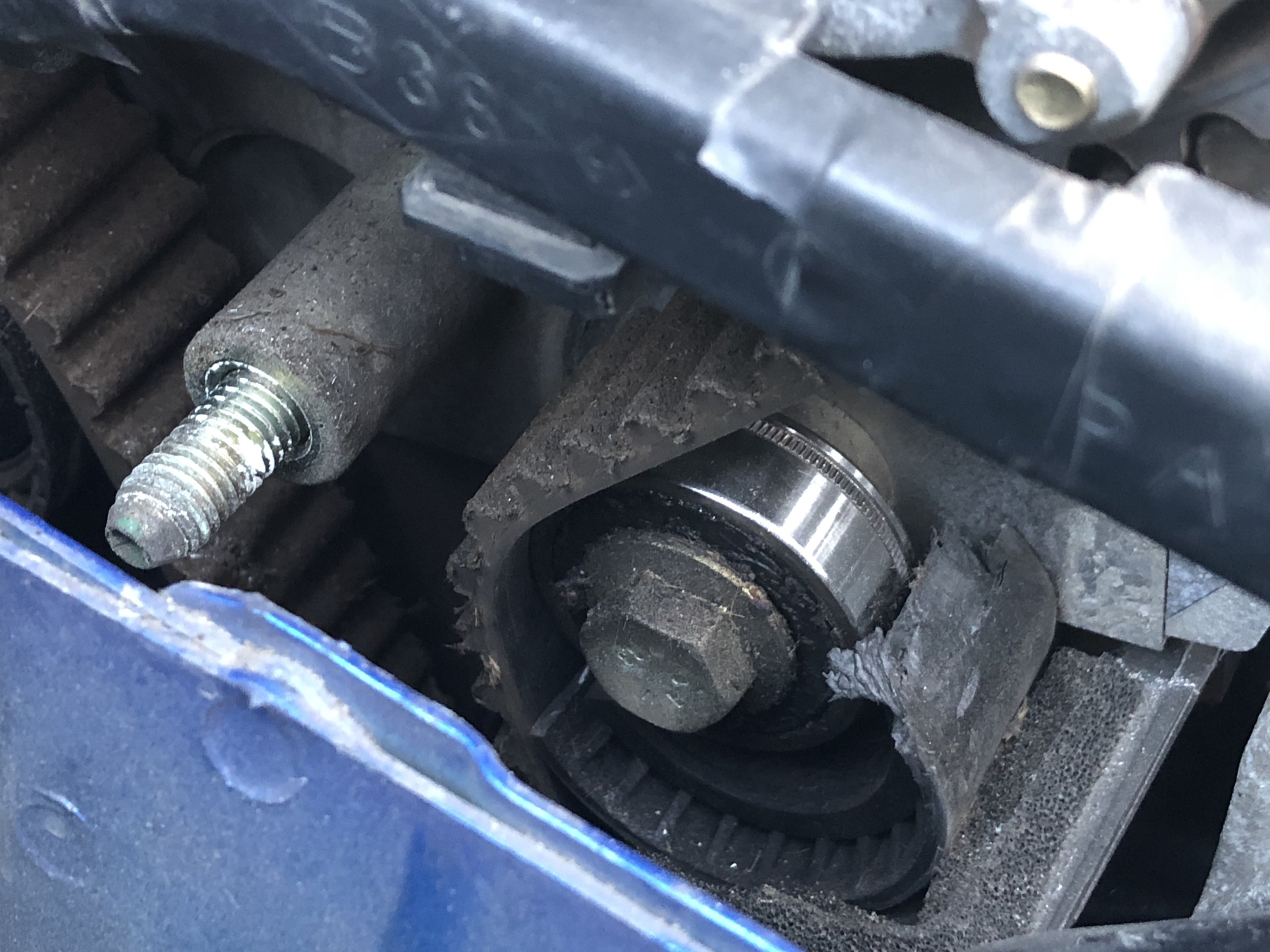

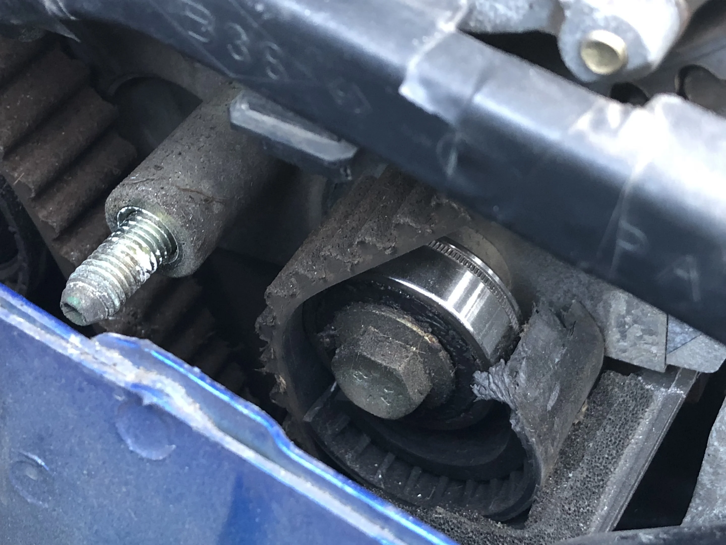

Back to the clios's, as someone that really isnt familiar with them im absolutely shocked at how much of a liability the cambelt is and that it must be done within 5 years. Never known anything like it.
Edit: plastic coated idler/tensioners ffs!

You probably now know, but the interval is 72k miles OR 5 years. Whichever comes first. The aux belt is 36k and 5 years. Be warned that the aux belt is just as important, as if it fails, it often wraps itself round the crank pulley and takes the cambelt with it.
Believe it or not, these are highly reliable engines in the grand scheme of things....aslong as they are maintained as recommended
Im gutted that its only after this has happened ive been aware of it.
I also noticed the wheel arch fire wall piece all warped running along the aux pulley... so that probably would have happened if the cambelt didnt!
