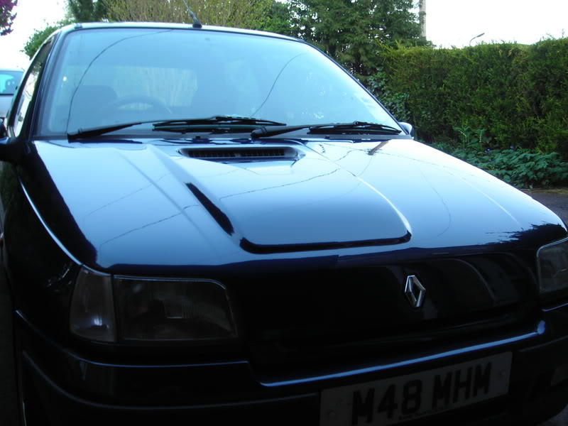

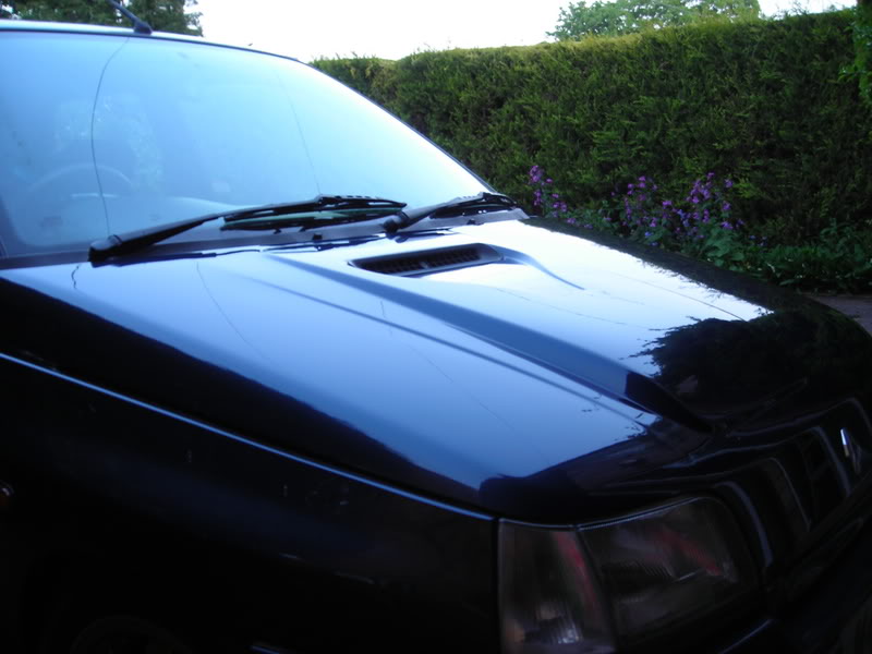

Had another go on the bonnet tonight...with the SFX-1 Pad and the 2.5 pb's...definately seemed to remove a lot more of the spider webbing and scratches...but there's still some there! I this this lacquer must be super tough....so I guess it may need some more persuation. It's still on it's original bonnet and paint, so thats not bad going. Any suggestions Rich as what to try next...cos I definatly use a lot more pressure on the pads tonight, even the 4"? Here are the b4 and after pics...not very good pics as it was getting dark...i'll get some better ones tomorrow. Matt
How many sets of passes did you do and what sized area are you working?
I split the bonnet into three sections...the middle budge and the two bit of the bonnet either side. I used the 6" SFX-1 pad on the bits either side of the budge and the 4" on the budge, edges and around the lights and front. I did 3 passes with pb's 2.5 on each section with a good bit of pressure, then finally went over with the pb's 1 on a single pass.
I would be tempted to split those sections into half that size and try a two more sets of passes in each one with a 4 inch pad and SSR 2.5.
