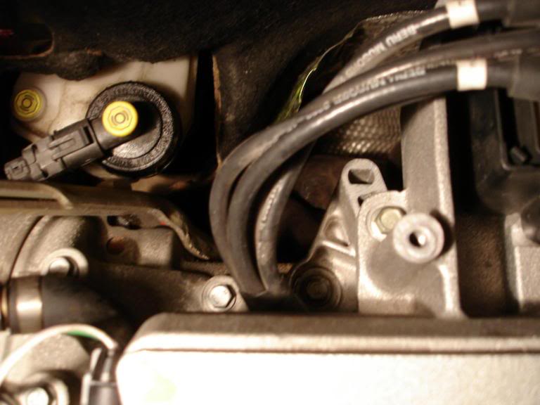

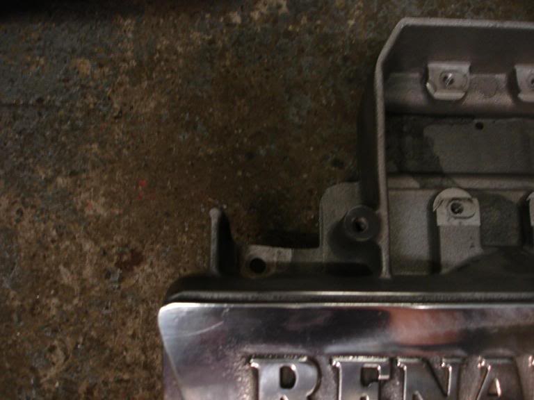

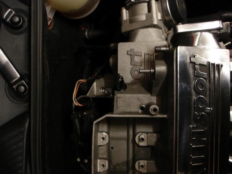

Fred i don't follow...Why use the 172 Plenum? For starters it doesn't fit due to bolt spacing...:S
It will fit, you just need to exchange the inlet into the top of the rocker cover. Although when I blew up my 172 engine I fitted a 182 engine directly. Didn't change inlet manifold. You just need a longer pipe to reach the charcoal can, but this should come with the engine.
Still not with you...inlets are the same. You'd need to change the rocker cover and plenum so that the bolts will line up... Or is this what you meant?!
its just the breather bit that needs changing IIRC, i dunno, its been so long since i've actually worked on one!
Yep, just need to change the breather bit on the top of the rocker cover where the manifold sits on. But I'd just use the 182 inlet!
Nah...I'm sure sure....the bolts don't line up regardless of the breather...Hold on i'll look for pics...
