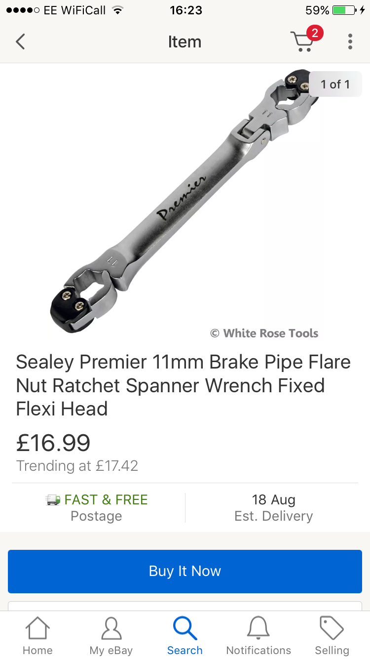

What size flare spanners do I need? Tempted to get some, especially if it makes life easier
Thanks all, some really good info on here!
Must confess I didn't actually get around to doing it, my mate who was going to help but couldn't make it so it will be done one evening this week!
11mm for most brake lines on the CS.
Something like that do the job?
Or am I better off just getting a full set of sizes, bare in mind I'll probably never use them again

You sir are a legend! Good price too, especially with a lifetime guarantee
I'll call by after work today,
I see they come in two sizes on the same spanner so it's 9&11mm together, any other sizes I need?
Nope, 11mm is fine. Then just use regular tools for everything else.

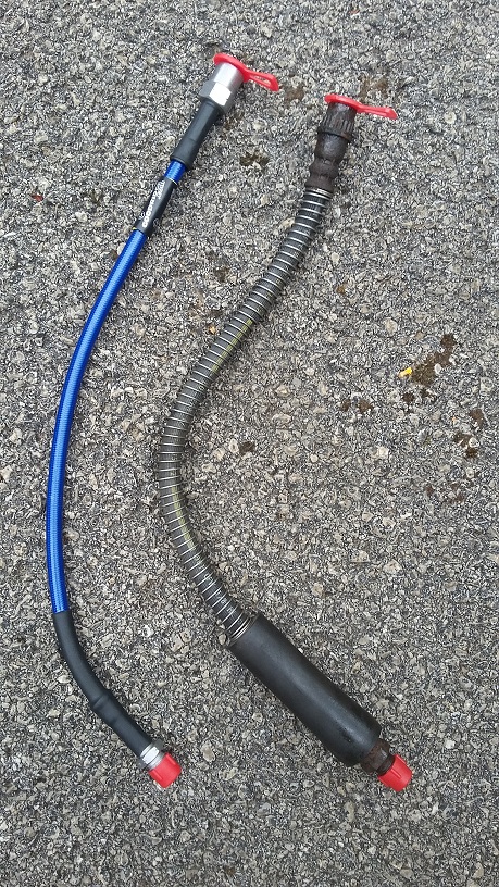

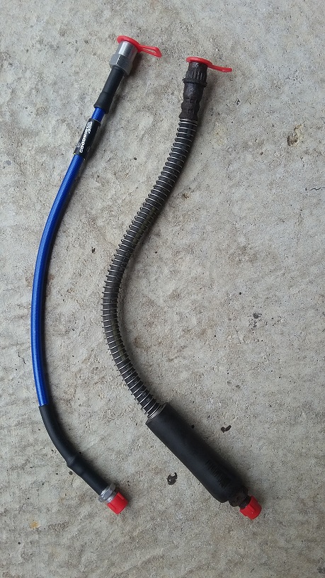

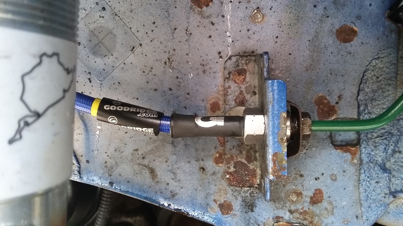

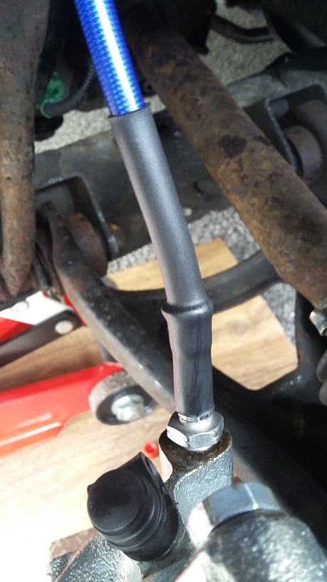

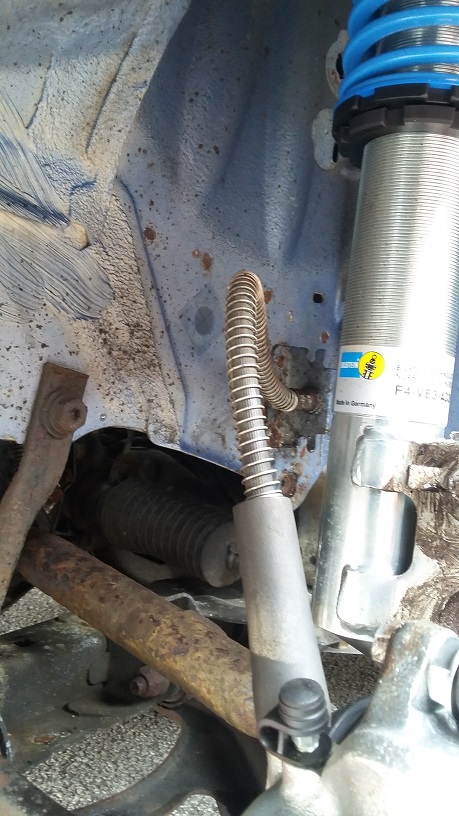

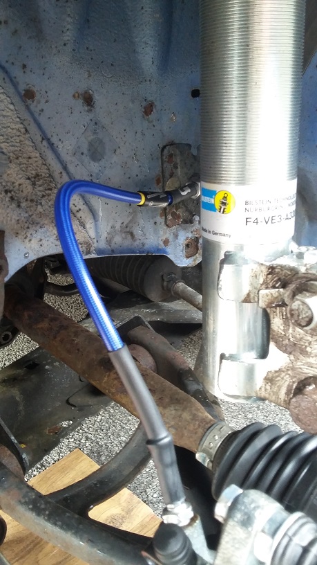

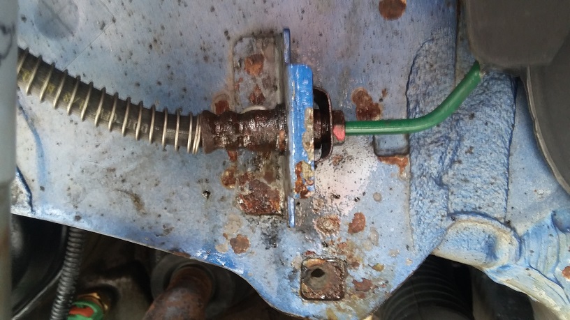

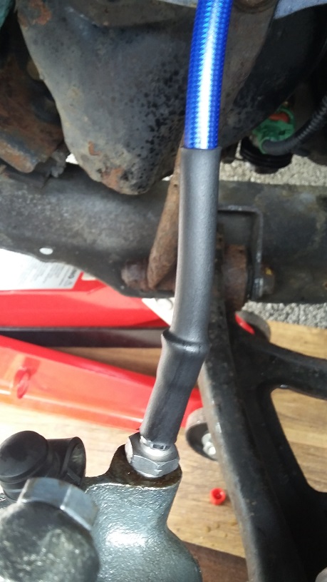

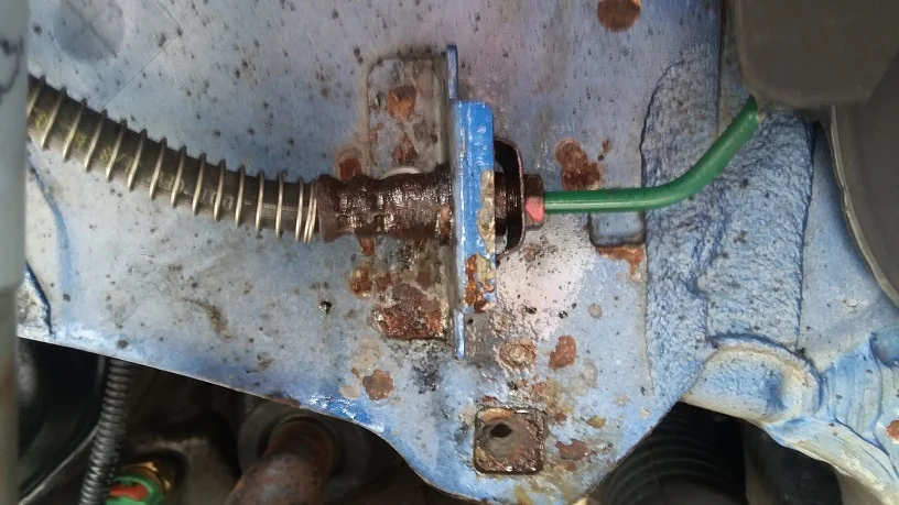

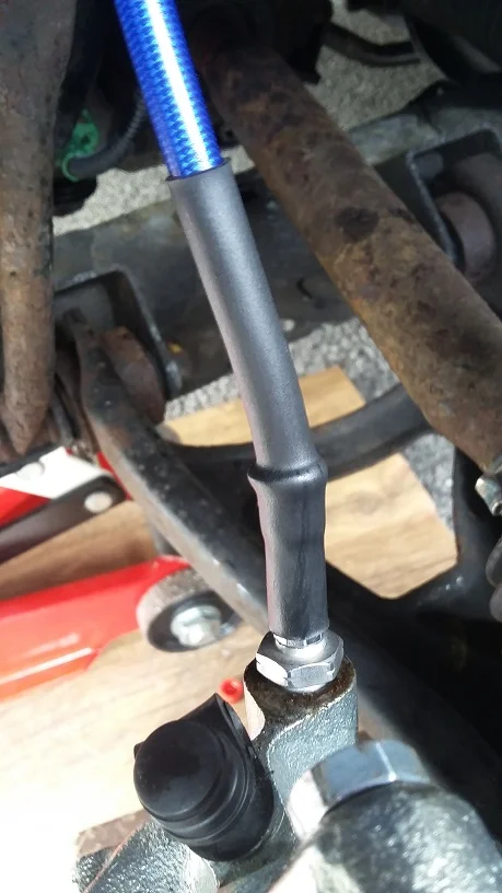

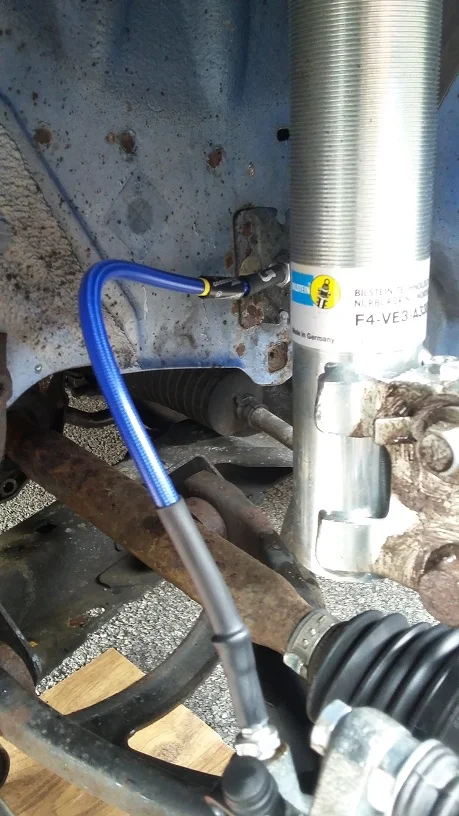

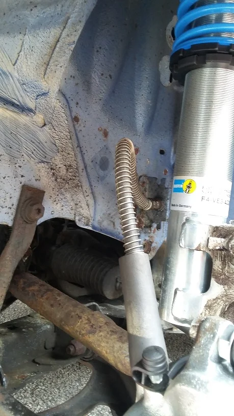

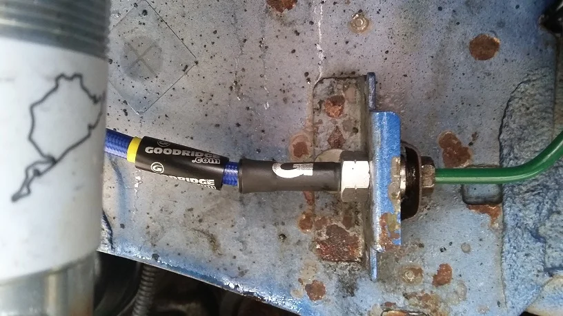

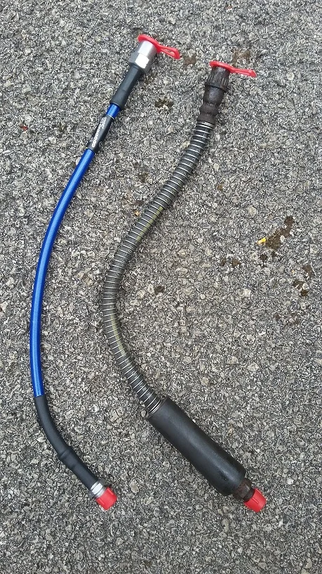

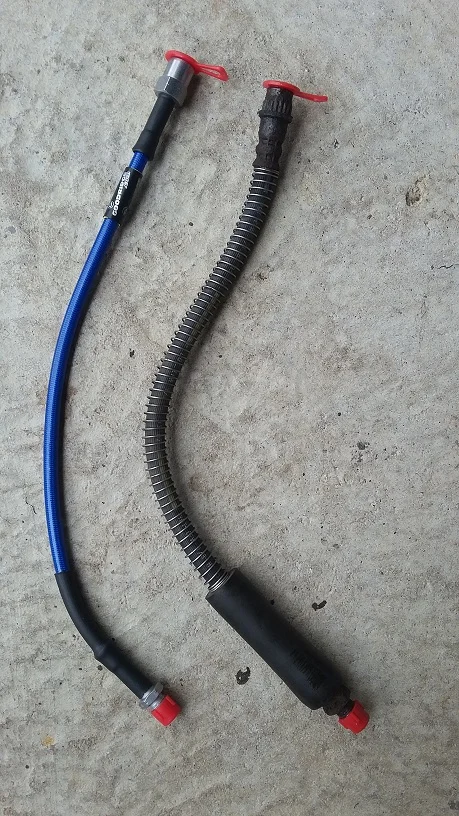

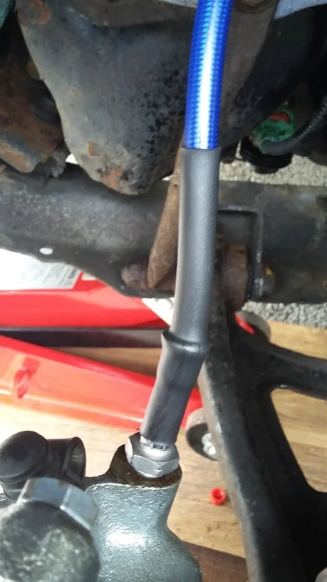

Just my fronts today (Rear has K-Tec on already, so I'll leave those for now). I put new suspension and calipers on the other other week, so it was a fairly painless job.
I did it this way to try to minimise the amount of air:
1. Loosen off old hose from caliper. If it's really tight, you'll be taking the caliper off later anyway, so don't go crazy on it.
2. Unbolt the caliper but leave it where it is for now.
3. Remove old hose from car (Stick a take away plastic tray next to the drive shaft to catch drips).
4. Attach new hose to car (We'll do the final tighten later) with the cap still on the other end.
5. Unscrew cap until fluid comes out so you know the new hose has fluid in it.
6. Remove caliper.
7. Remove old hose from caliper (Try to keep the caliper uprights so no fluid comes out).
8. Remove cap from new hose and screw the caliper onto the hose (Might sound odd but the hose is attached at the other end).
9. Refit caliper to car. This is a good time to make sure the hose is tight into the caliper.
10. If the hose is coiled (i.e. it's not nice and straight), undo the car end of the hose and adjust so it sits nicely.
11. Tighten car end.
12. Bleed brakes to make sure you have the air out.
