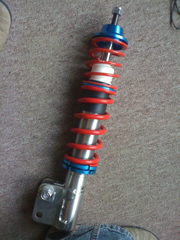

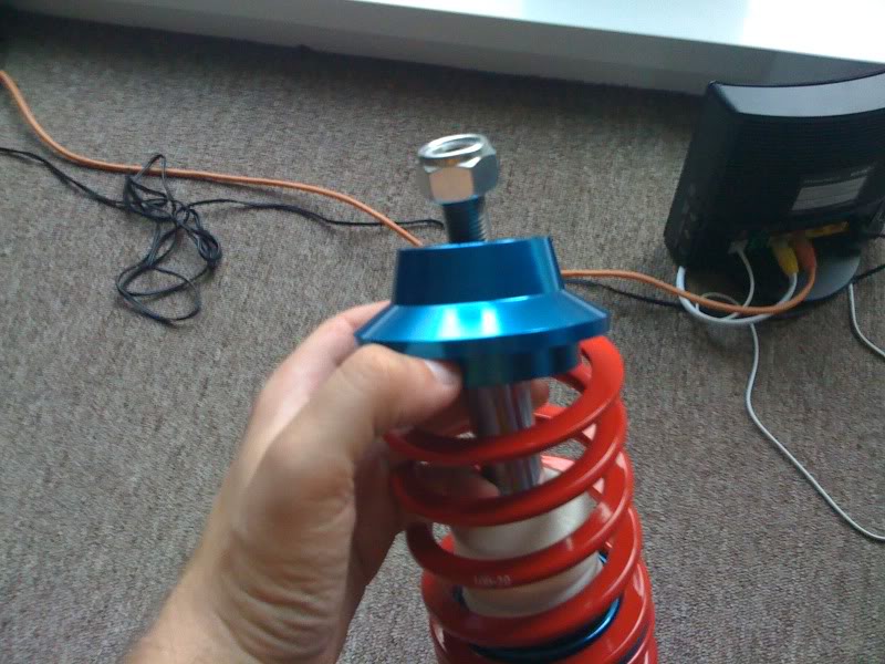

Right got some piccies just to confirm a few things...
Do I use the BLue top mount shown with these??
Alright im only checking! :o
And one would assume that I should bolt that down first using the nut supplied ..fit into place then use the mounts from the old ones and secure the top...Im not doing it at mine so if I get it wrong its a fair old drive back into town!
Ah wait no I think I get it all now! :o
No, the nut supplied is just for shipping to keep them together, your top mount goes directly on top of that.
I edited it...It made sense when I looked at the flat bit of the coilie :o
I remember how the old ones were now.
Ok, just dont bolt it down with the nut that came with it, you do NOT use that nut.
I know...im sure it would of made sense when I take the old ones off"...from memory though there is a bolt holing the old standard ones on isnt there?? MAybe thats why im getting confused!
Yeah, its above them as you would expect, sometimes they can be an arse to get off, but as you have had yours off before, should be fine.

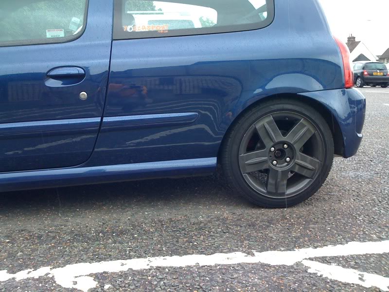

Managed to do the rears before it pissed down big time here so rain has stopped play for the moment.

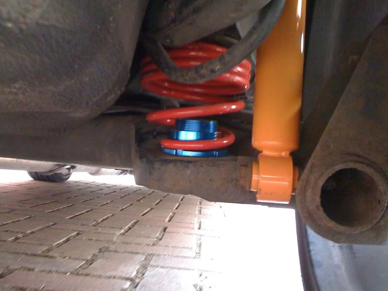

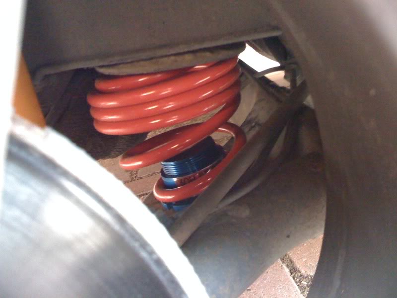

Rears..
Rears are wound all the way

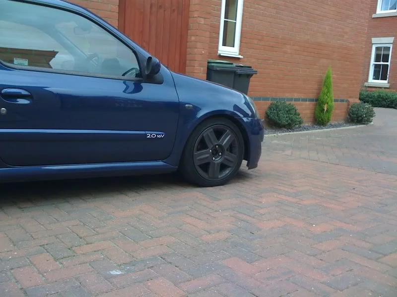

Fronts are still on just 60mm springs and standard shocks for now (Ithink...)

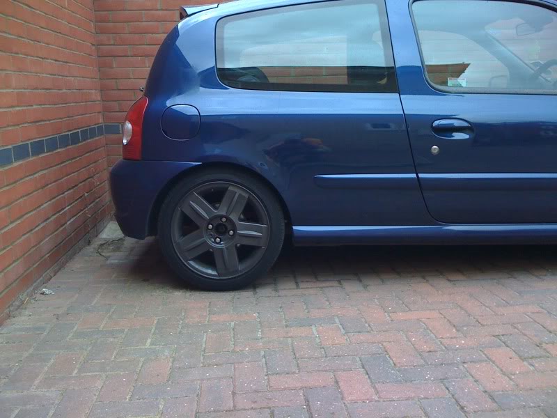

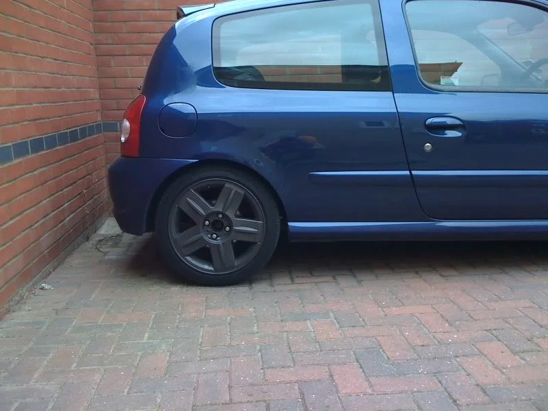

I dont think the rears are as low as what they were before though on just springs :(

They need to bed in mate so will be slightly lower, the springs are proper soft so they do differ in height dependant on weight.
