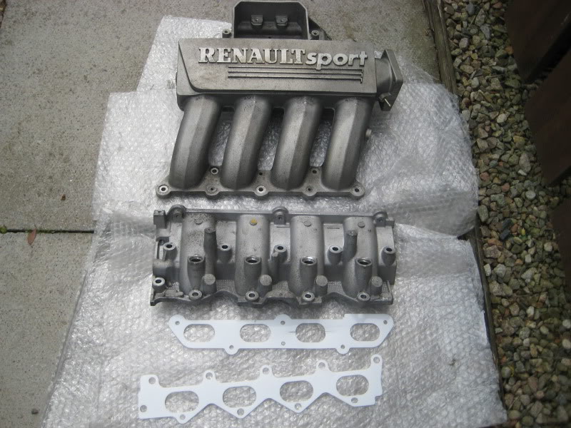

I have recieved my matched Inlets from Jamsport with PTFE Gaskets to replace my standard ones :)
I think they need a clean up and paint though as they look rough to the standard ones.
The Inlet Manifold (plenum) looks straight forward enough to swap.

Getting it back in is the fun bit. Especially as the PTFE gasket is thicker. I've heard of people grinding down part of the lower inlet to get it to fit. I didn't use the PTFE gasket on my 182. I managed to get it back on by loosening the bolts holding the upper part of the alternator bracket in as many places as possible.

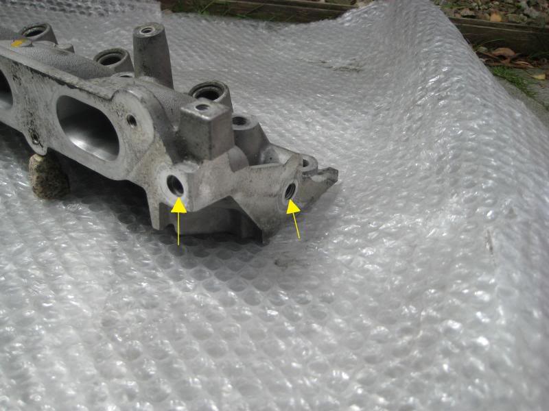

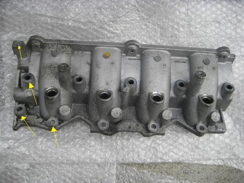

Also you will need to grind the inlet down on the left hand side slightly to fit them in neatly with the new PTFE gaskets.
You will see which hole you need to grind when you come to fit.
What do i need o grind ?
Or would that have been the bit Mark (Jamsport) said he'd grind ?
