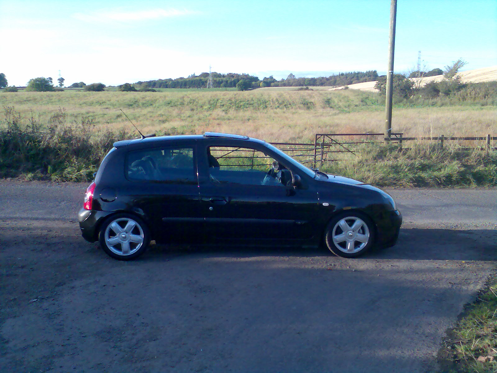

lowered on 15s is a cool look for a non RS for me!, This was mine nearly 20yrs ago now when i was 17!
