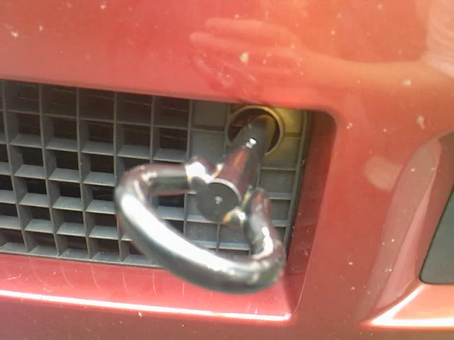

Got my Tow Eye from Si which looks great so figured i would just pop it on and be done with it but it wont screw in! Every time i turn it and it starts biting on the thread after about 1 full turn it tightens towards my foglight and gets stuck as the bumper is now catching stopping it from getting tighter! :mad:
My car hasnt been in an accident, or if it has its been professionally repaired outside of the insurance company as everything lines up and all the lines match. The only thing me and Pepsi could think was that its been towed in the past and bent the socket.
How do i go about sorting this. Any ideas? :(

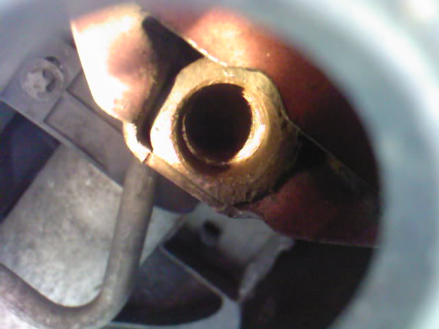

Right. Had another bash with the stock Tow Eye but im really stuck on how i can fit this. As you can see from this picture:
After getting about 2 full rotations it sticks and will not tighten. It appears to move towards the upper right corner (which makes me think its out of allignment) and then nothing, no movement at all.

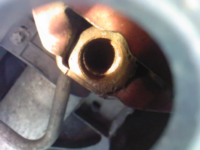

I can only assume that this holder:
Has been bent while being used in the past by previous owner perhaps. But with it being attached to the chassis and in such an awkward position it doesnt appear to be adjustable. Does anyone have any ideas? :(
