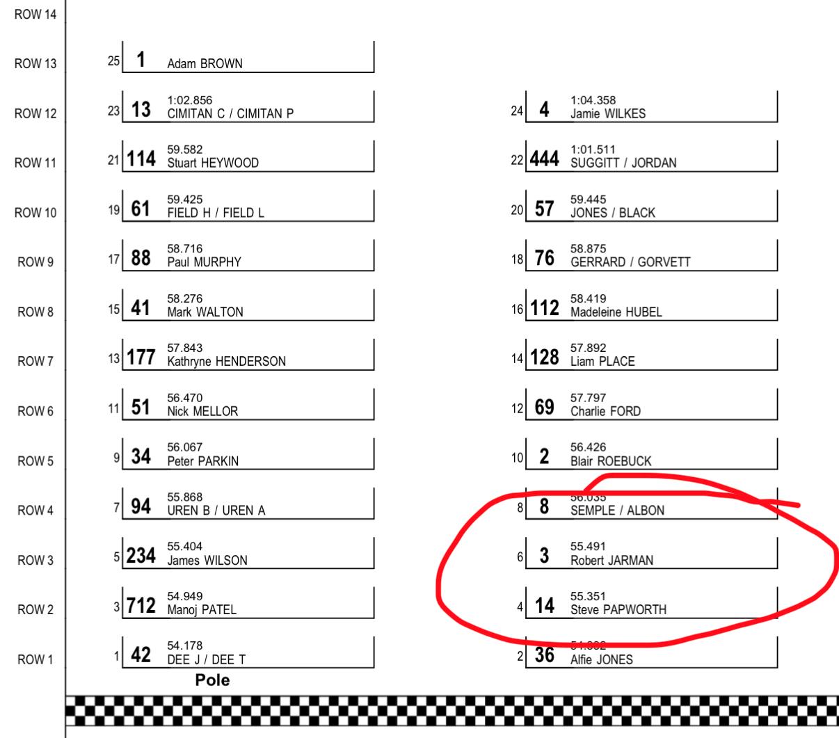

At the end of September we returned one final time to Snetterton. Feeling confident we went into the weekend to round off our season with the CSCC Tin Tops once again.
We qualified P12 on the road and P2 in class, just 9 tenths off pole in class. So with all to play for it was decided that I start the race and with a rolling start this time it seemed that the pressure would be slightly less.

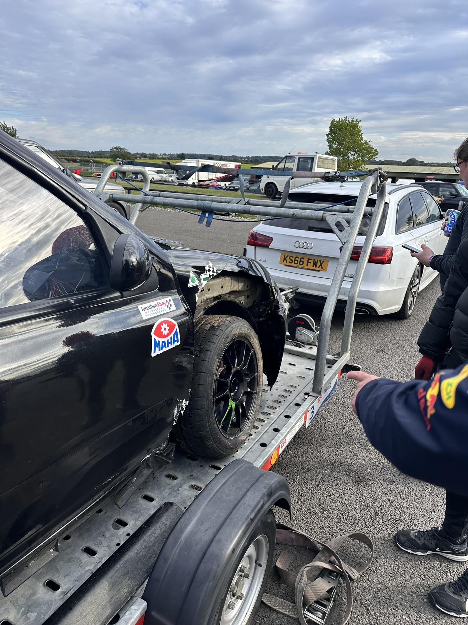

Coming up to the end of the start/finish straight I had made a good start, making up a few places but I was on the outside. Two cars a little way in front touched - no drama there but I stayed out wide in anticipation of something more happening. They continued but I found myself coming in a little too hot and heavier on the brakes than I would normally. Cold tires and out on the marbles, I very quickly found the back end coming around faster than i could catch it. With right foot buried and opposite lock applied I did my best to try and save the slide.
What actually happened though was that the tires bit when I was already over 90 degrees turned which then led me darting across the track amongst all the traffic until the inevitable collection by one car on the inside with three quarter to three quarter connection that span me around and spat me back off the outside edge of the track to roll into the barriers. Race over and car done…
worst start ever
Thankfully of course these race cars are build strong and neither I or the driver that collected me were hurt. I spoke to him afterwards and naturally he wasn’t happy but I’ve known him for many years and we both know what one signs up for when you go racing.
Equally Rob, (who’s car it is) was cool with the situation and again, we all know the risks and he knows that we are in it together and i will play a major part in building him a new car. (more on that later)

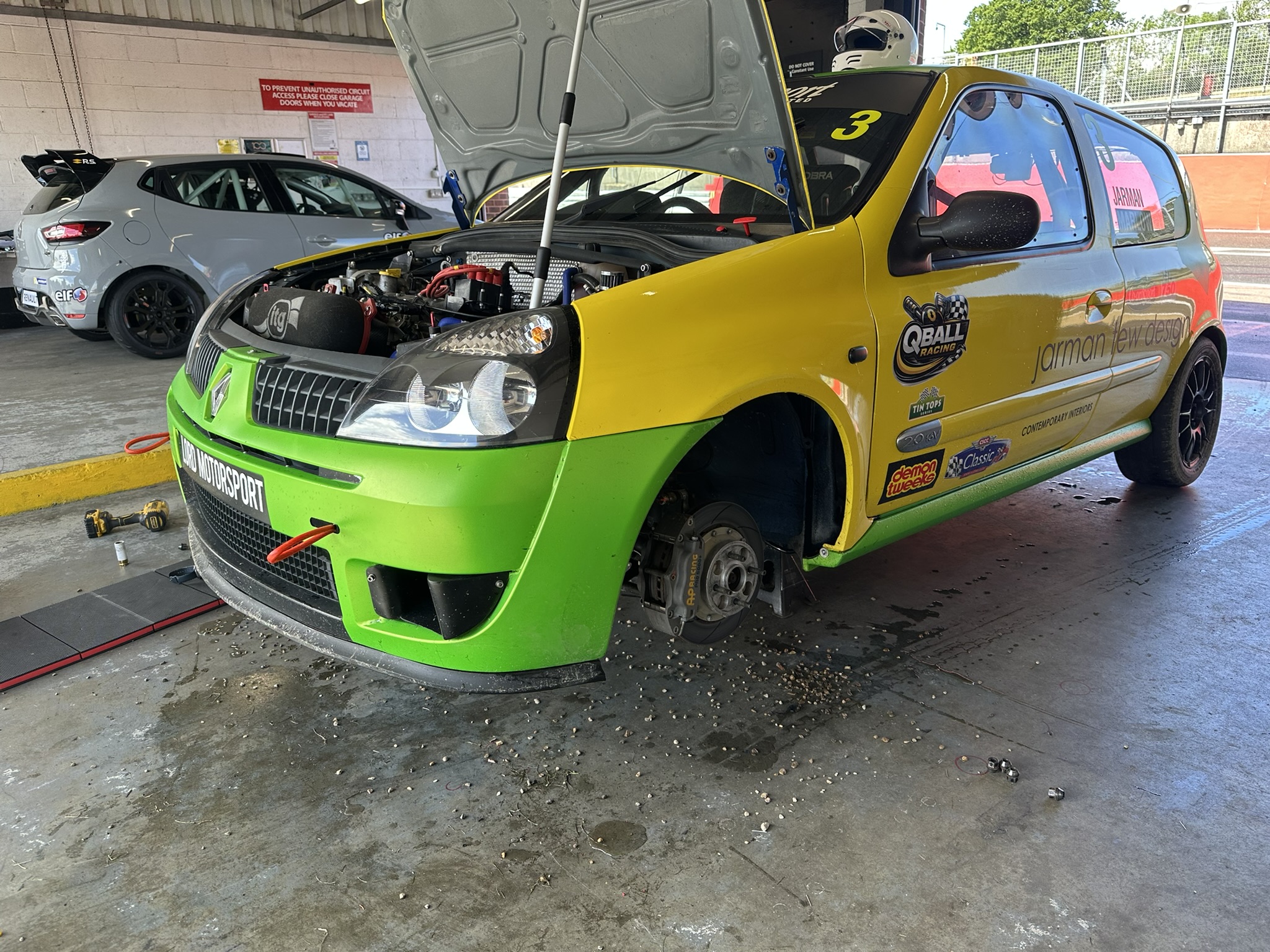

So, with no race engine yet I quickly put together a spare engine with standard internals. A look over revealed it hadn’t been terribly well put together before so I ordered some new big end bearings and ARP bolts and booked a session on the dyno.
The dyno session was long. Being a new dyno there were some teething problems but we spent a good 5 hours building a map and doing some runs. Strangely, the engine didn’t seem to want to make the power I expected though. More on that later…

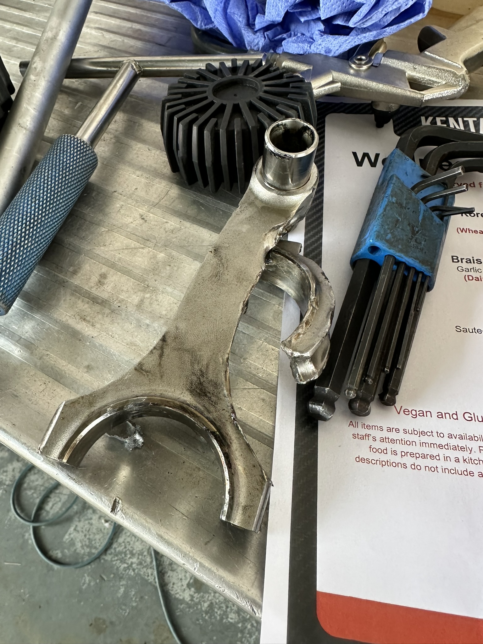

The Birkett came…and went disappointingly quickly. After being held for almost an hour in the assembly area, once we headed out onto track for qualifying the engine immediately started to play up. By lap three it was done, with the cabin filling with smoke and noises coming from the engine that were not good.
All very odd after it surviving the dyno but maybe the low power was the tell-tale.

Returned to the paddock after engine failure, just as friends arrived to watch!

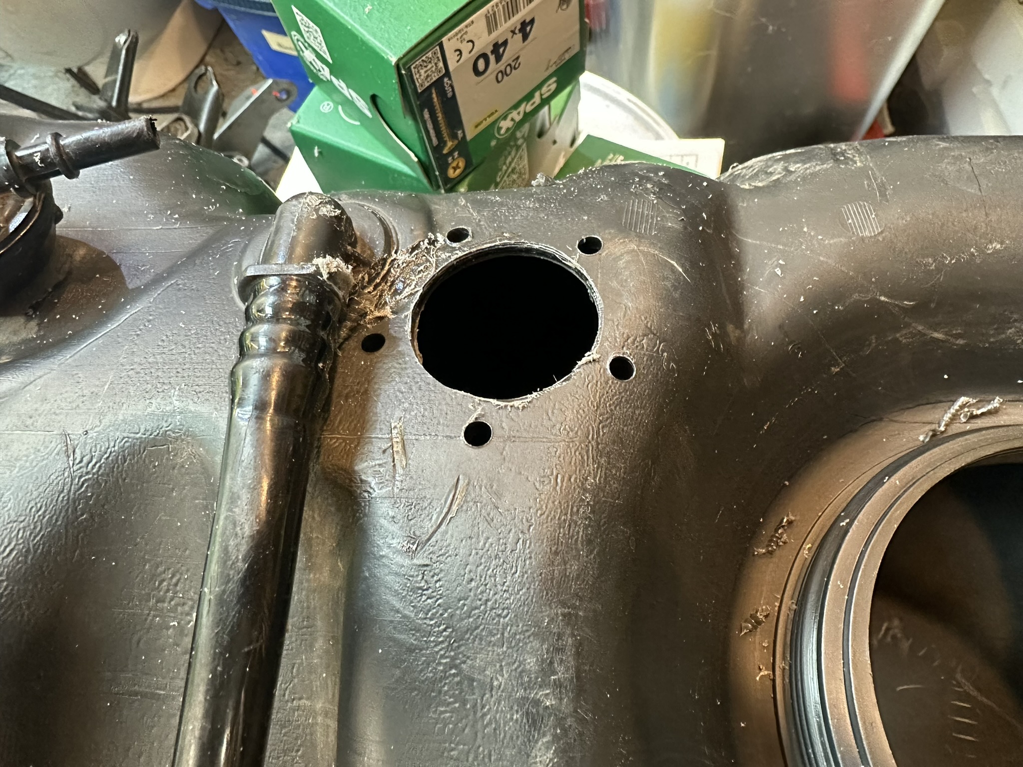

Sure enough, the tank appeared to be leaking and further investigation seemed to show it was the joint between the rubber flexi from the filler neck and the tank. But no amount of tightening of the pipe clip seemed to cure it. Even after doubling up the clips - nothing.
It was difficult to see clearly but we figured that it was possible that there was a break in the tank around the neck of the flexi. Replacement tank ordered.

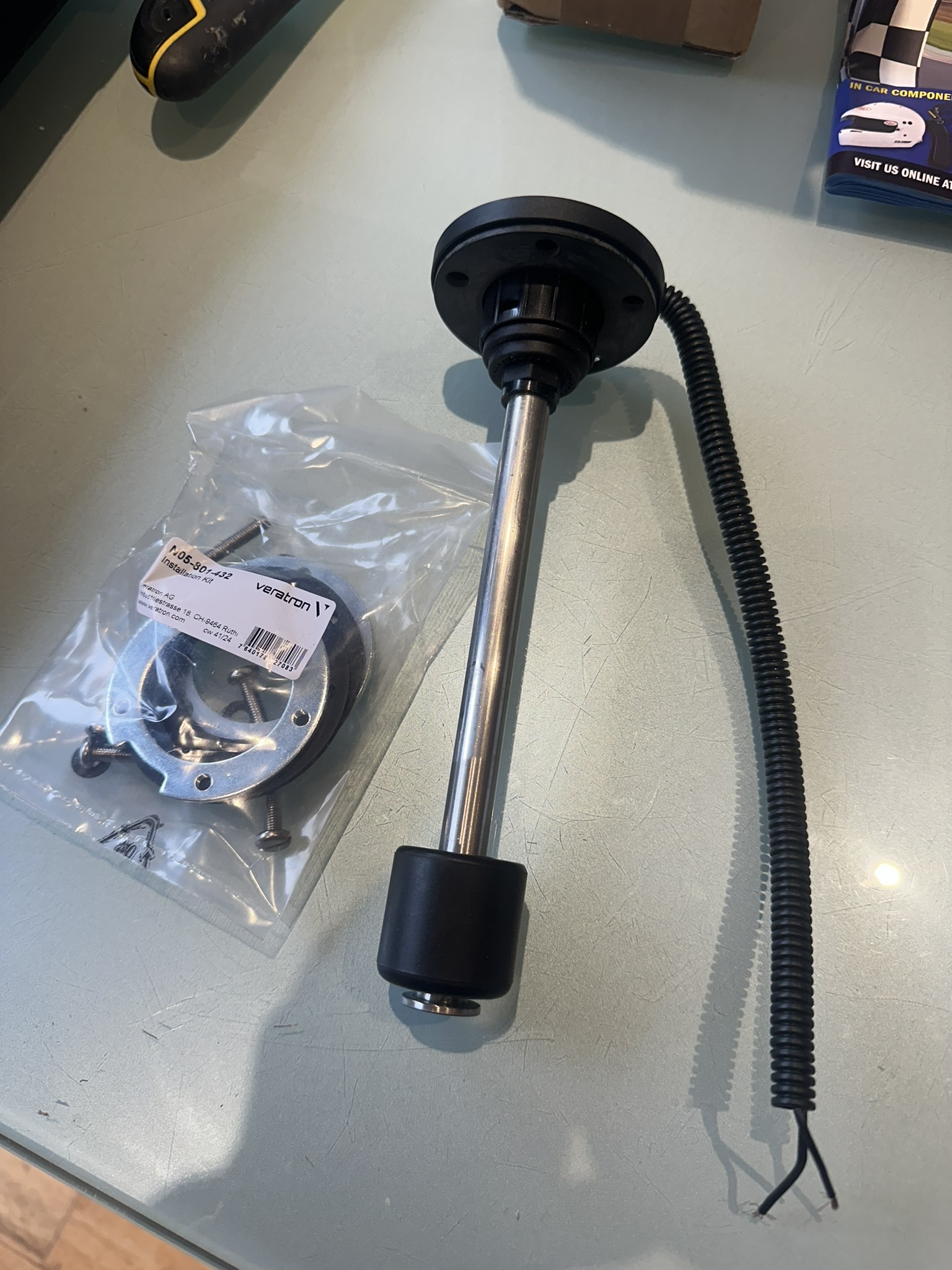

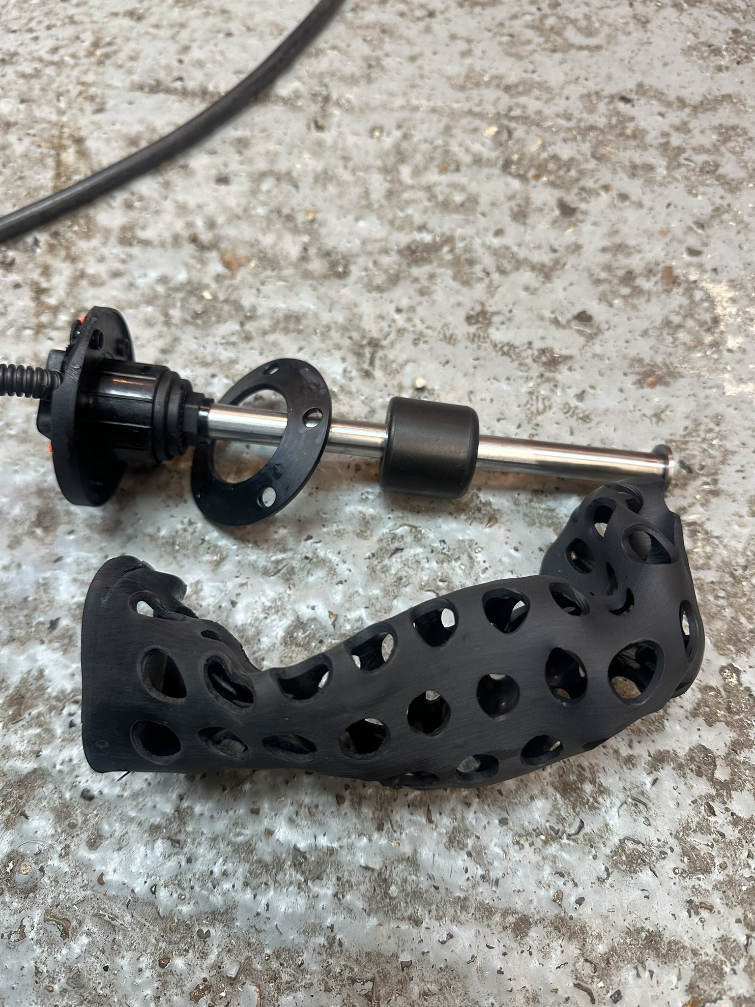

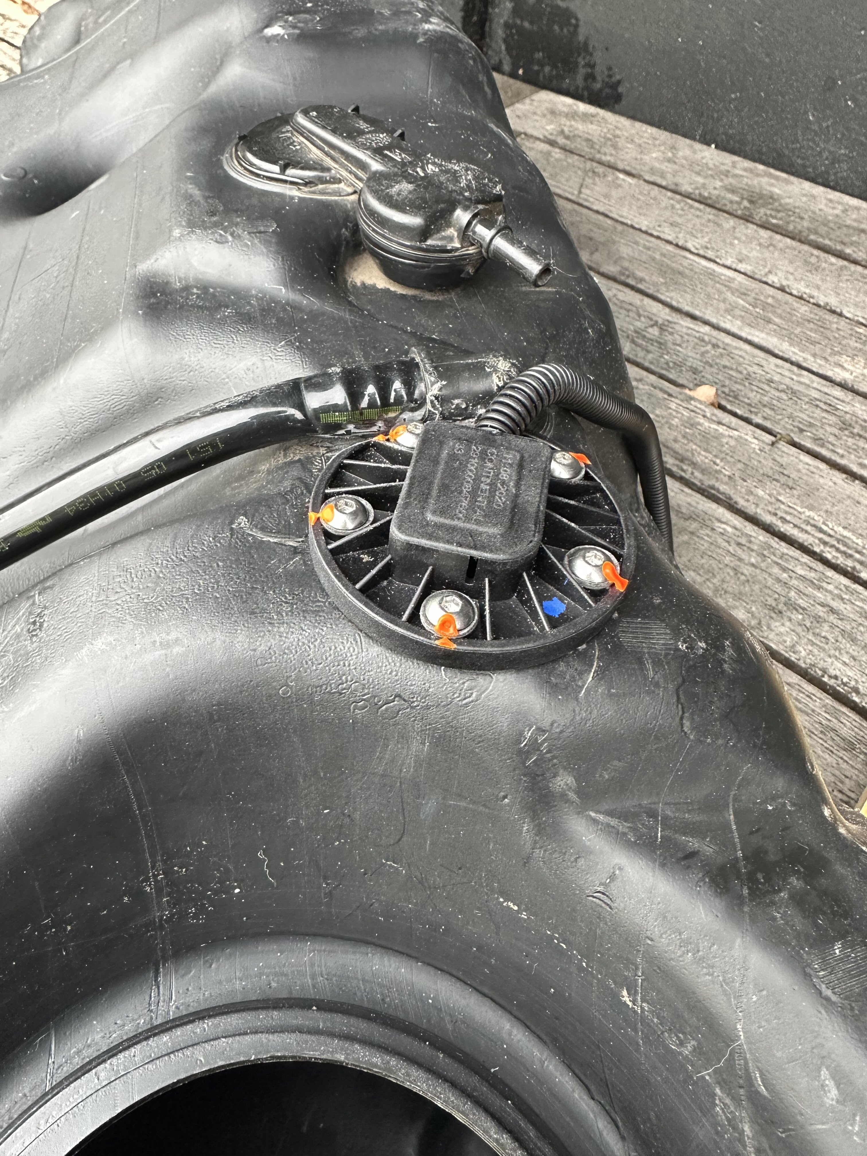

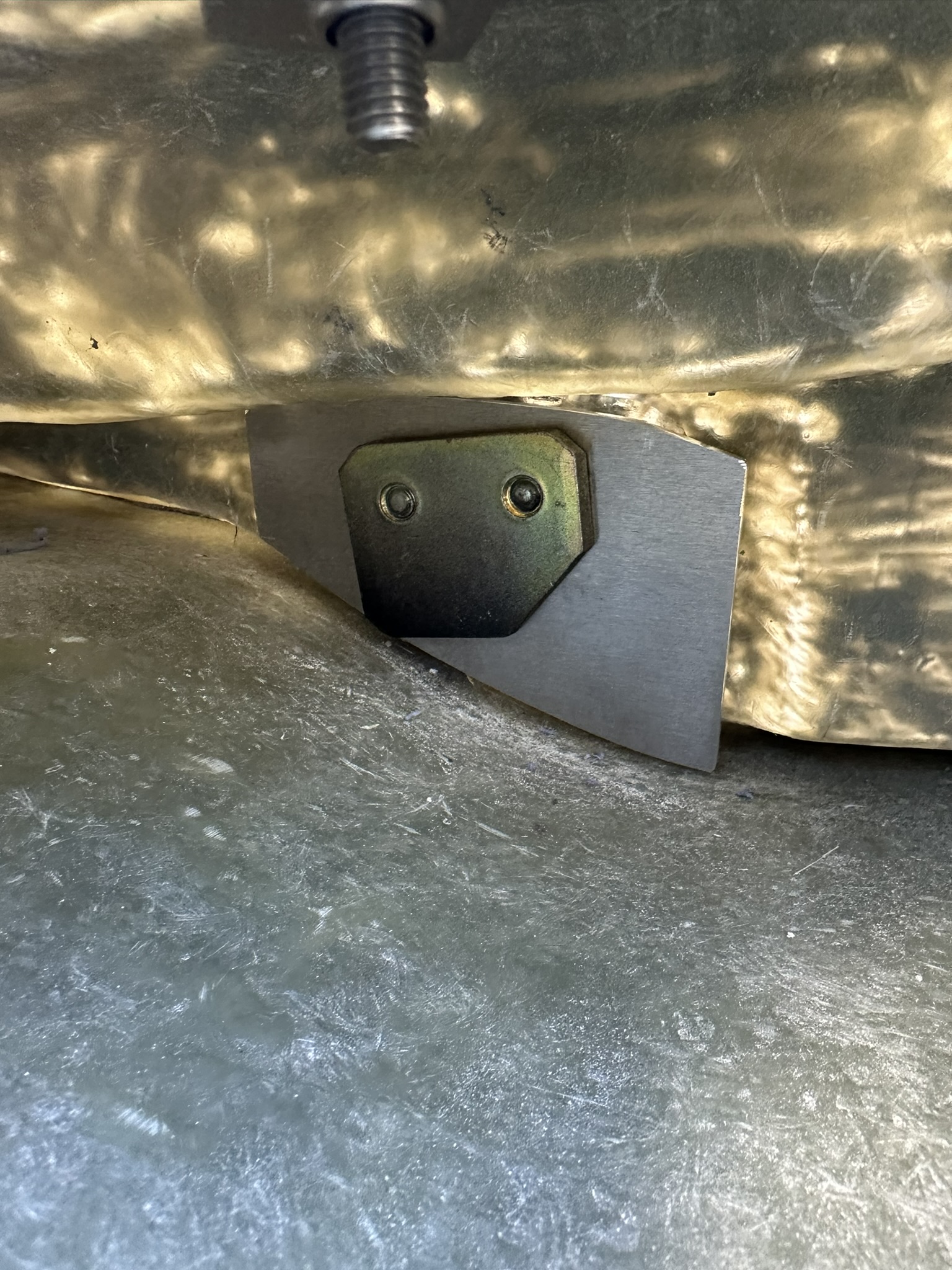

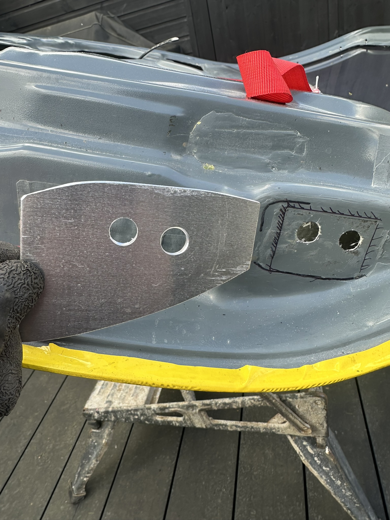

This seemed like an opportunity to sort out the fuel level sender too. As the tank is baffled with foam cubes the traditional float style sender doesn't work so I purchased a "dip tube" style sender to install somewhere in the tank.
Which needed some modification. I thought it would come with its own shroud but sadly not.
40mm waste pipe fitted perfectly!
...and a few holes drilled to try and keep the sensor as accurate as possible.
location found that seems to work
Calibrating this with the Aim dash will be the next challenge.

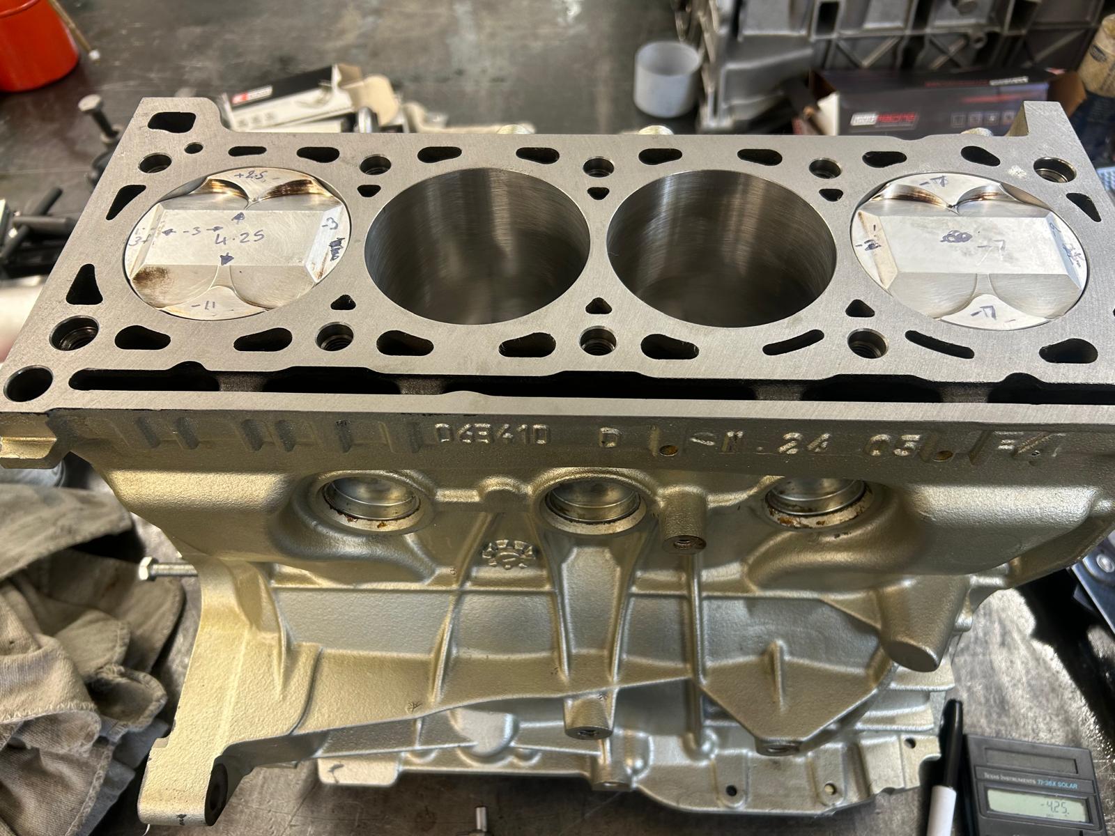

So in the meantime I started to prepare to build a new race engine. Taking 2 spare blocks over to Gosnays Engineering to have them bored to 83mm and ordering all the parts required.
With these now back and everything for the bottom end now acquired these have gone off to my engine builder who will select the best block to build with and we'll keep the other one for the next engine.
So while that's being assembled I'll start work on the top end and in between that we'll book the car onto the dyno with RobQ's engine so we can be ready for the opening round at Donington in March.
With the first race of the season booked. Donington on the 29th March, it's much easier to feel motivated! We also have a shakedown booked for Snetterton on Monday 9th March and before that a dyno session on the 25th Feb. So a bit to get on with before then.

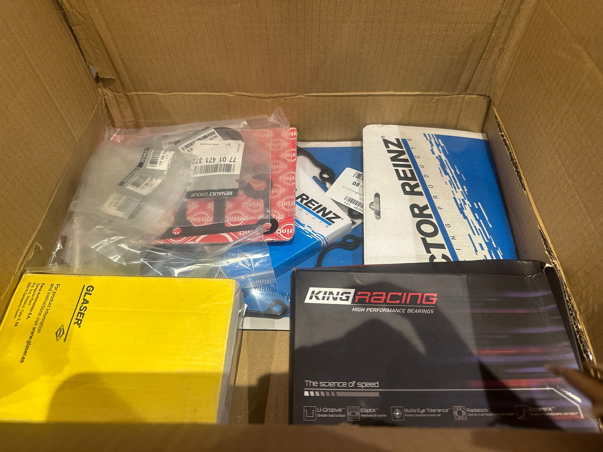

With the blocks now machined they went off to my engine builder with a box of new seals and bearings. He'll be checking through everything and will start the build soon but it won't be a quick job, so for the opening race at least we'll be running the stock engine.

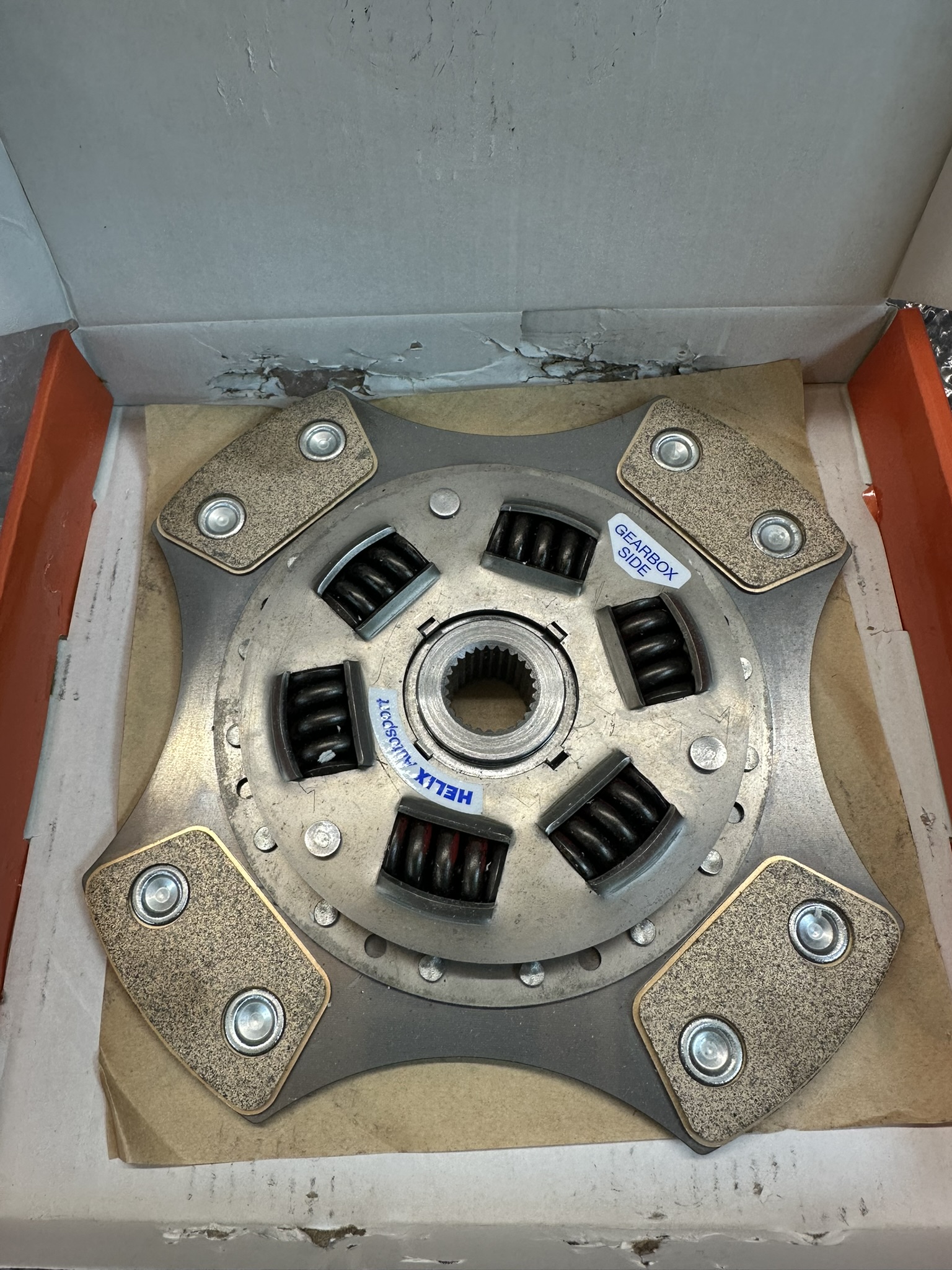

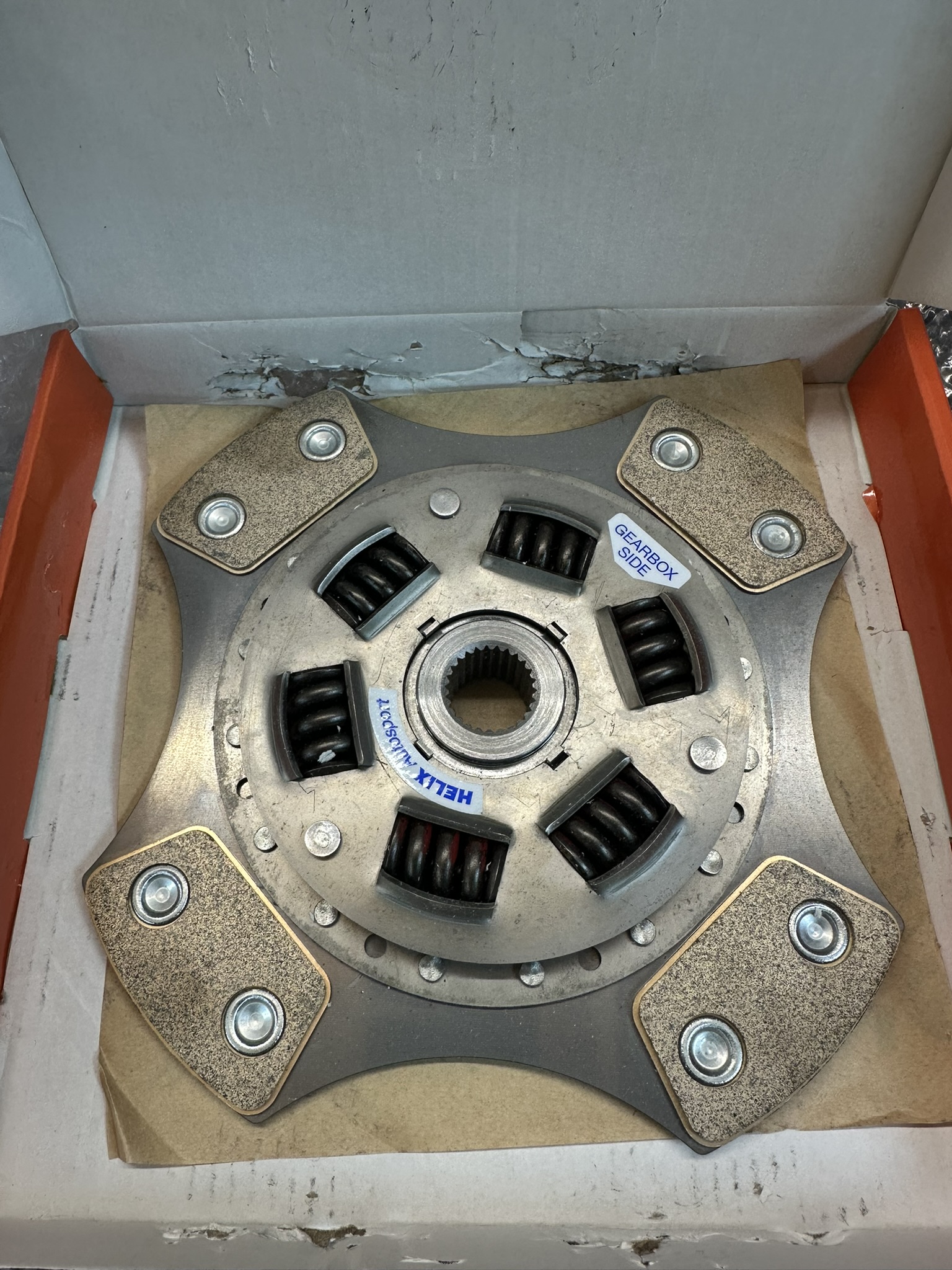

Along with the new engine I was going to send my Helix clutch off to be re-padded but after speaking to them and doing a few checks that they asked me to do it beame apparent that the clutch isn't serviceabe. So a new clutch was duly delivered by Kam Racing along with a release bearing. That will now wait for the new engine.

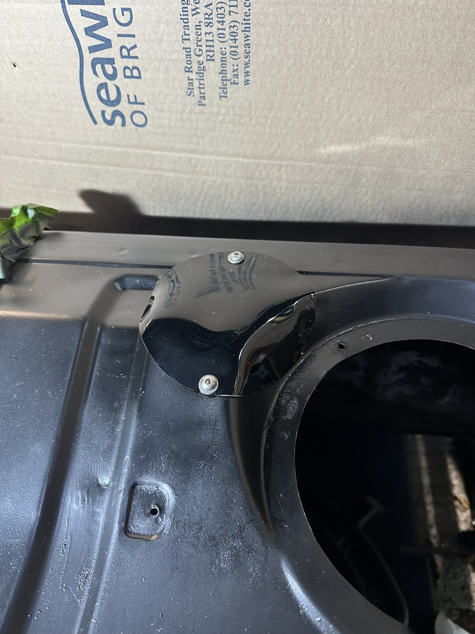

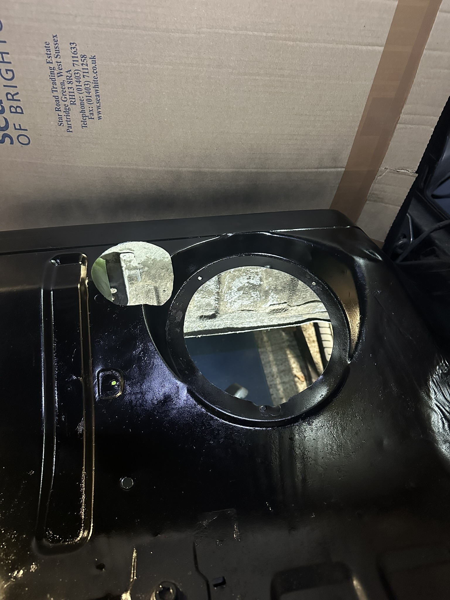

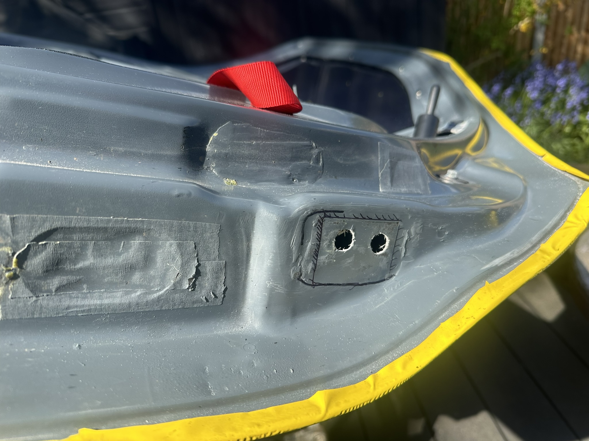

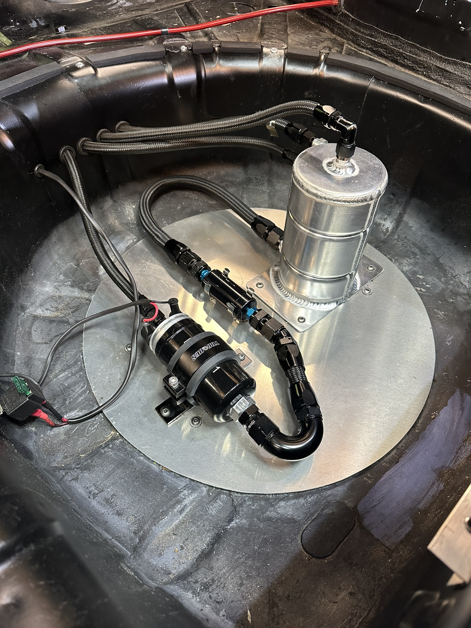

So, a few things more immediate to be getting on with, the first being getting the fuel tank back in the car. I'm not sure I'll have time to calibrate the new fuel sender before March but we'll see how it goes.

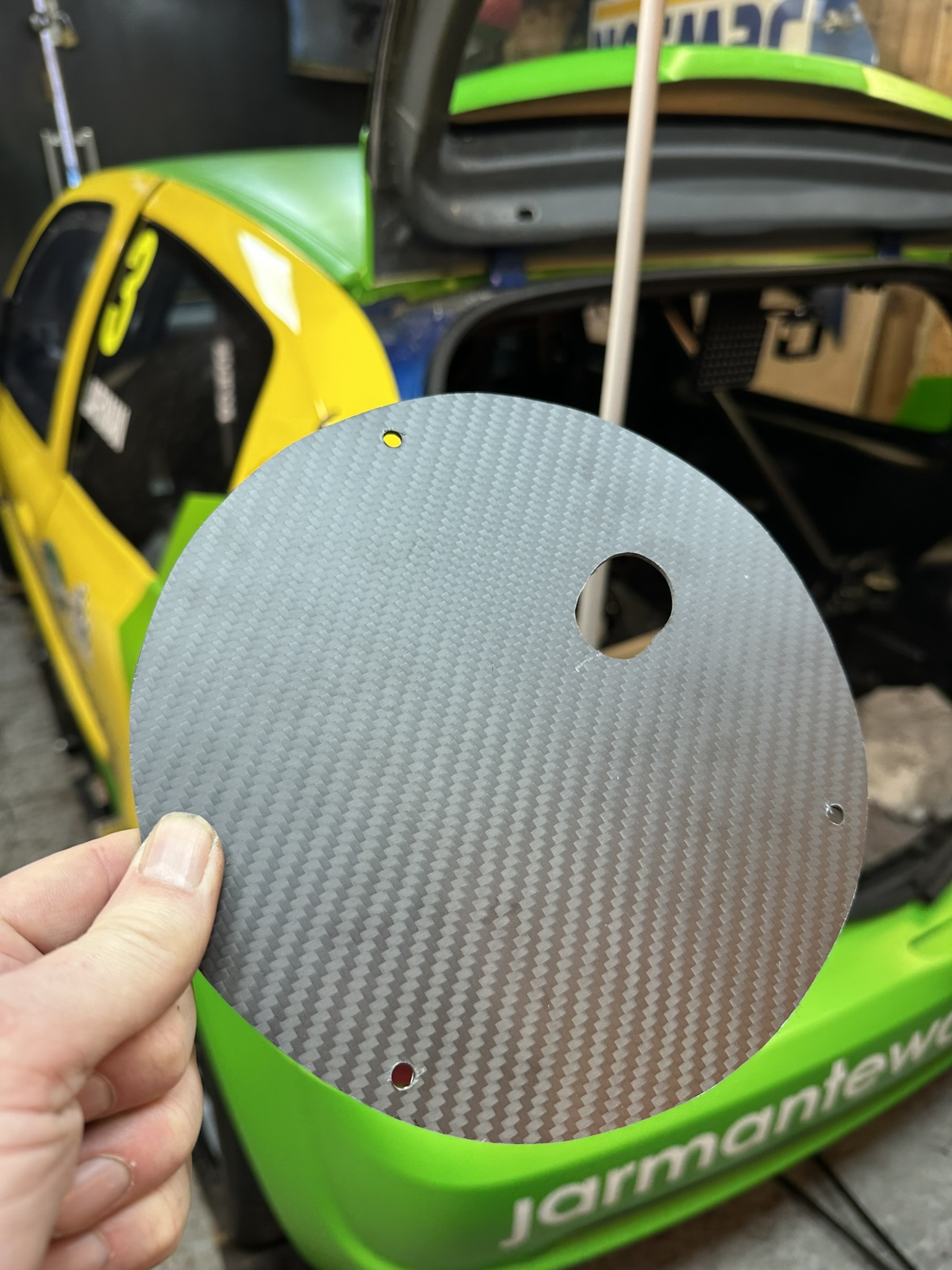

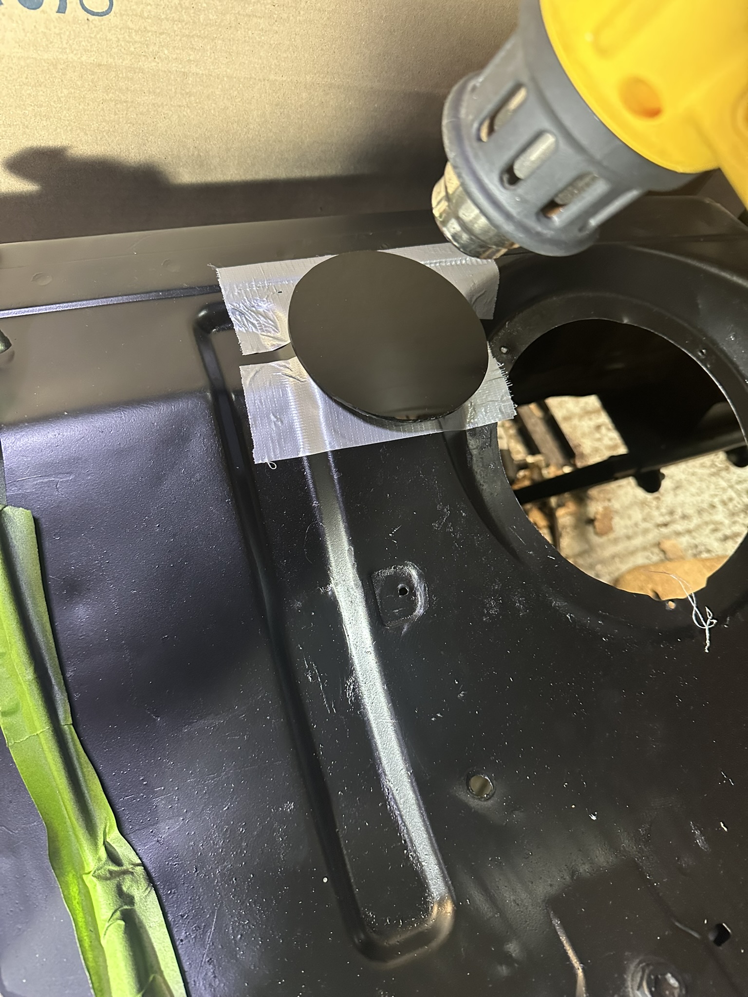

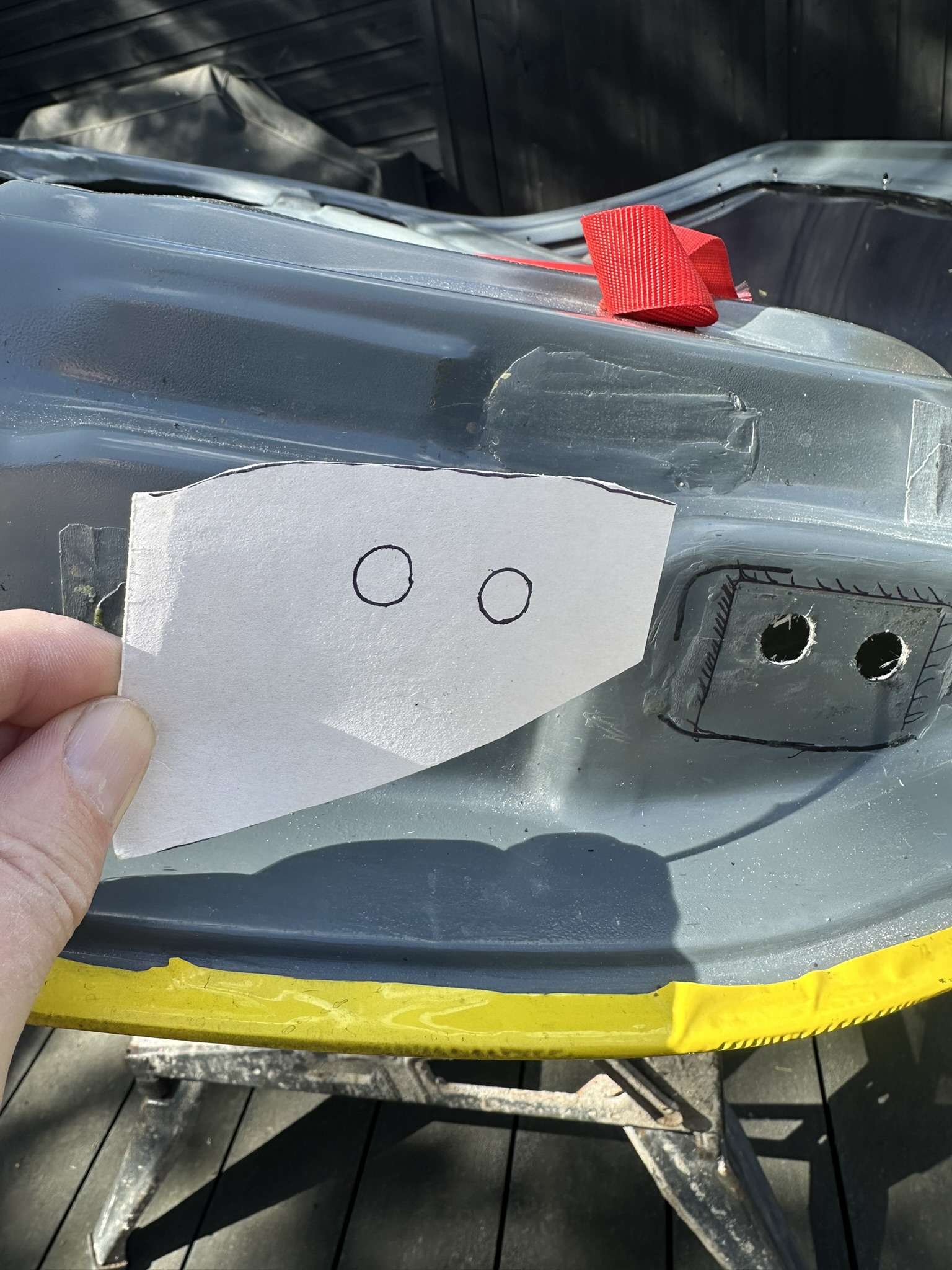

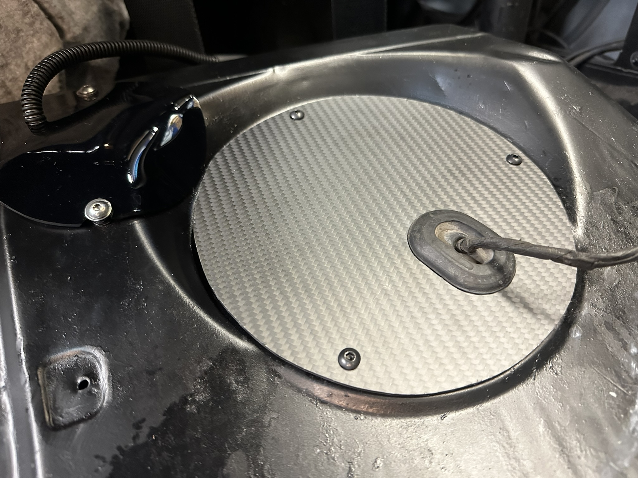

An access hole needed to be drilled through the floor for the new sender, so that was this weekend's job.
And then I bought some black acrylic to make a removable cover and heated it to mould into the correct shape.
Which came out ok..
I'll probably drill this and fit a grommet for the cable to come through if I can't feed it through with the lift pump wiring. We'll see.

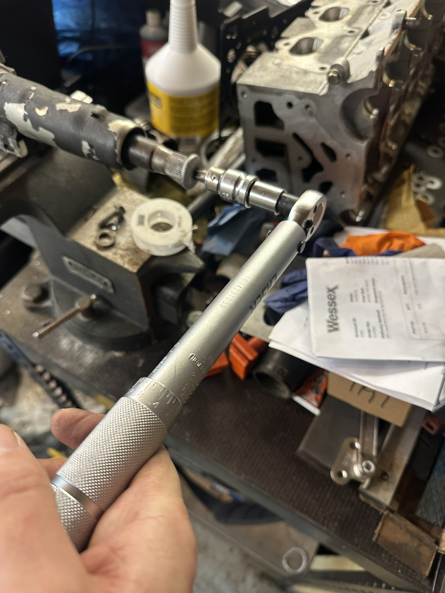

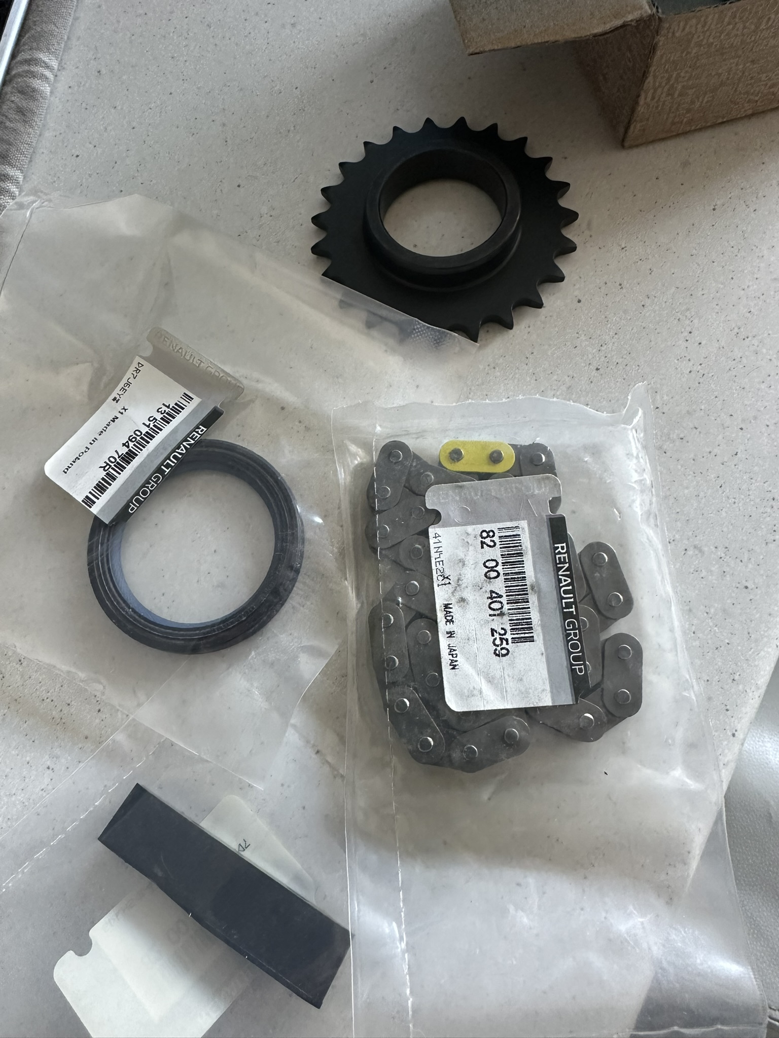

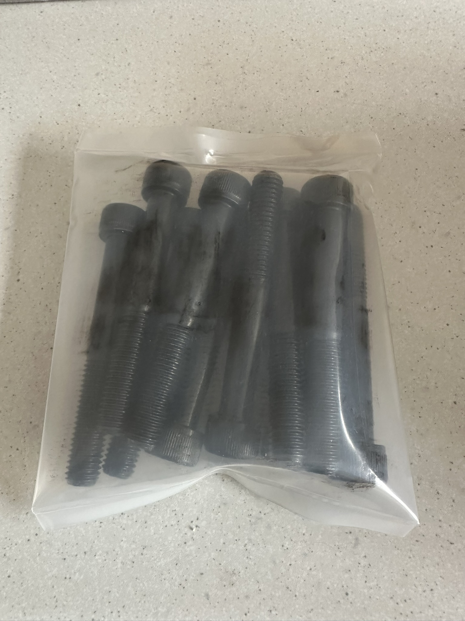

A couple more arrivals for the new engine. My builder is concerned about the centra main cap on one of the blocks in that its showing signs of being a little loose. So he's going to make some repairs and then line bore the bottom end. He recommended usng some ARP studs for this once done, so had some delivered yesterday alond with some new standard bolts for the other block which we're going to build up first.

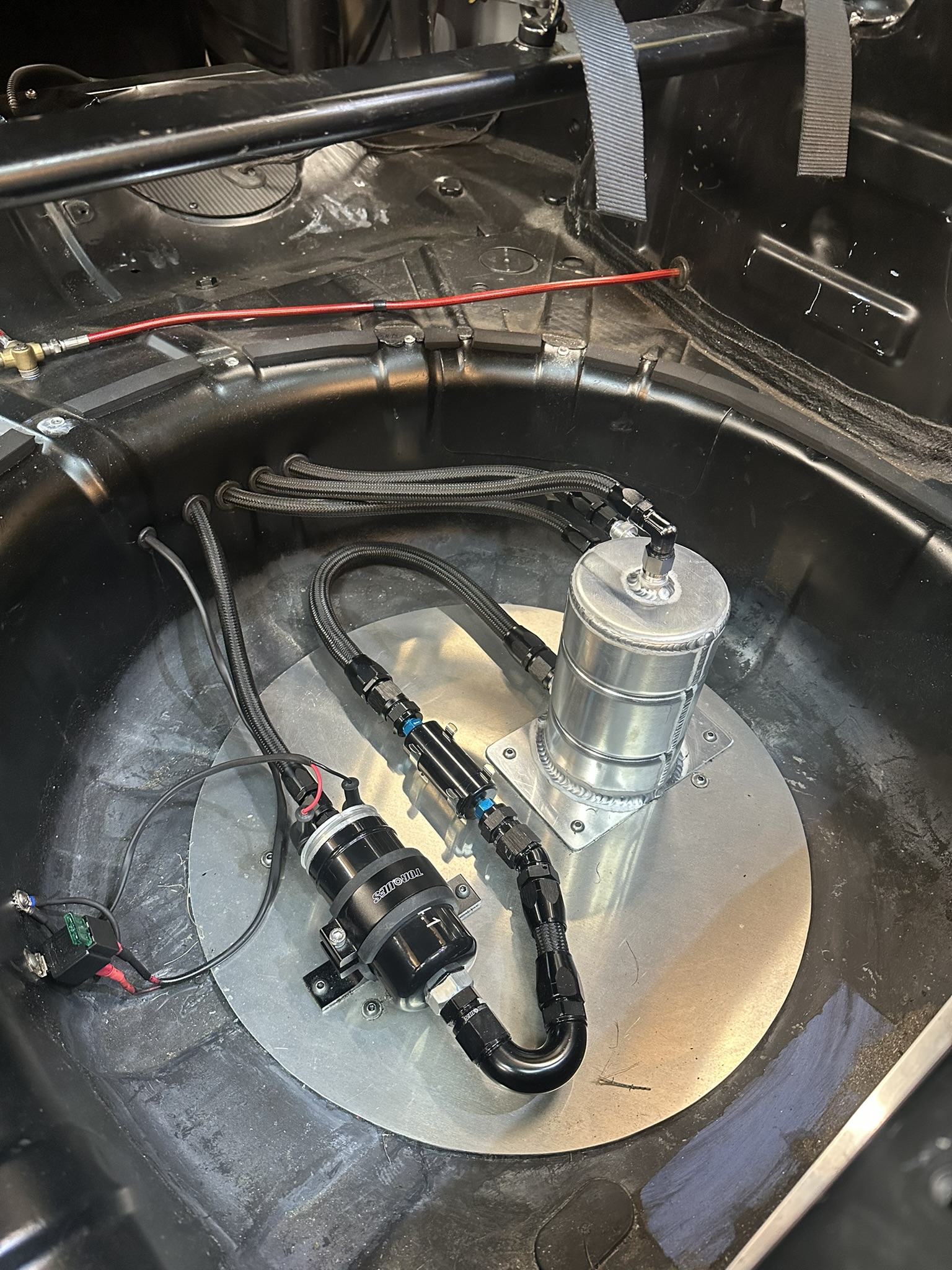

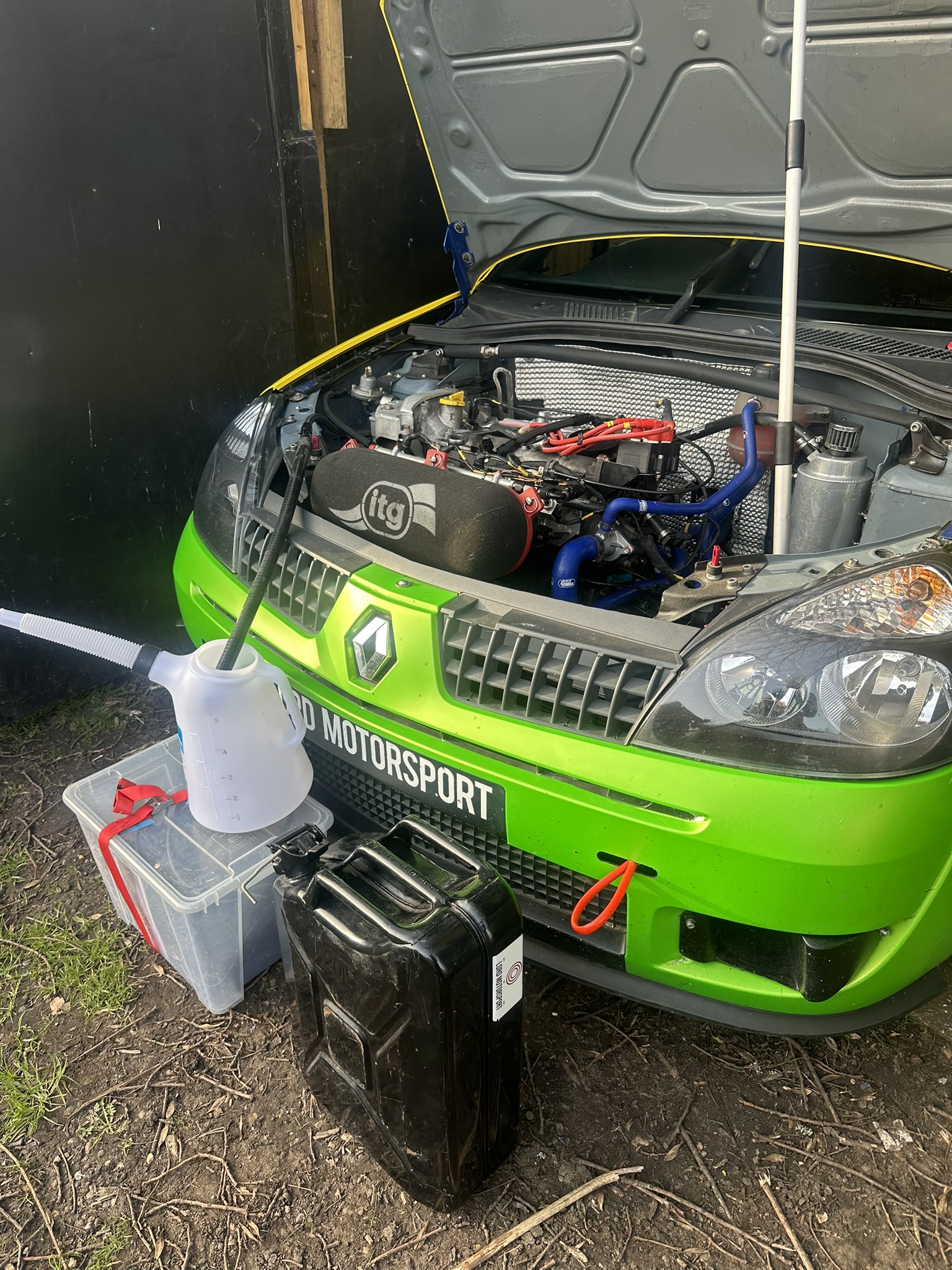

So, yesterday's mission was to make progress with the fuel tank. We got it installed over the weekend, confirming that the hole drilled for the sender access is in the right place.

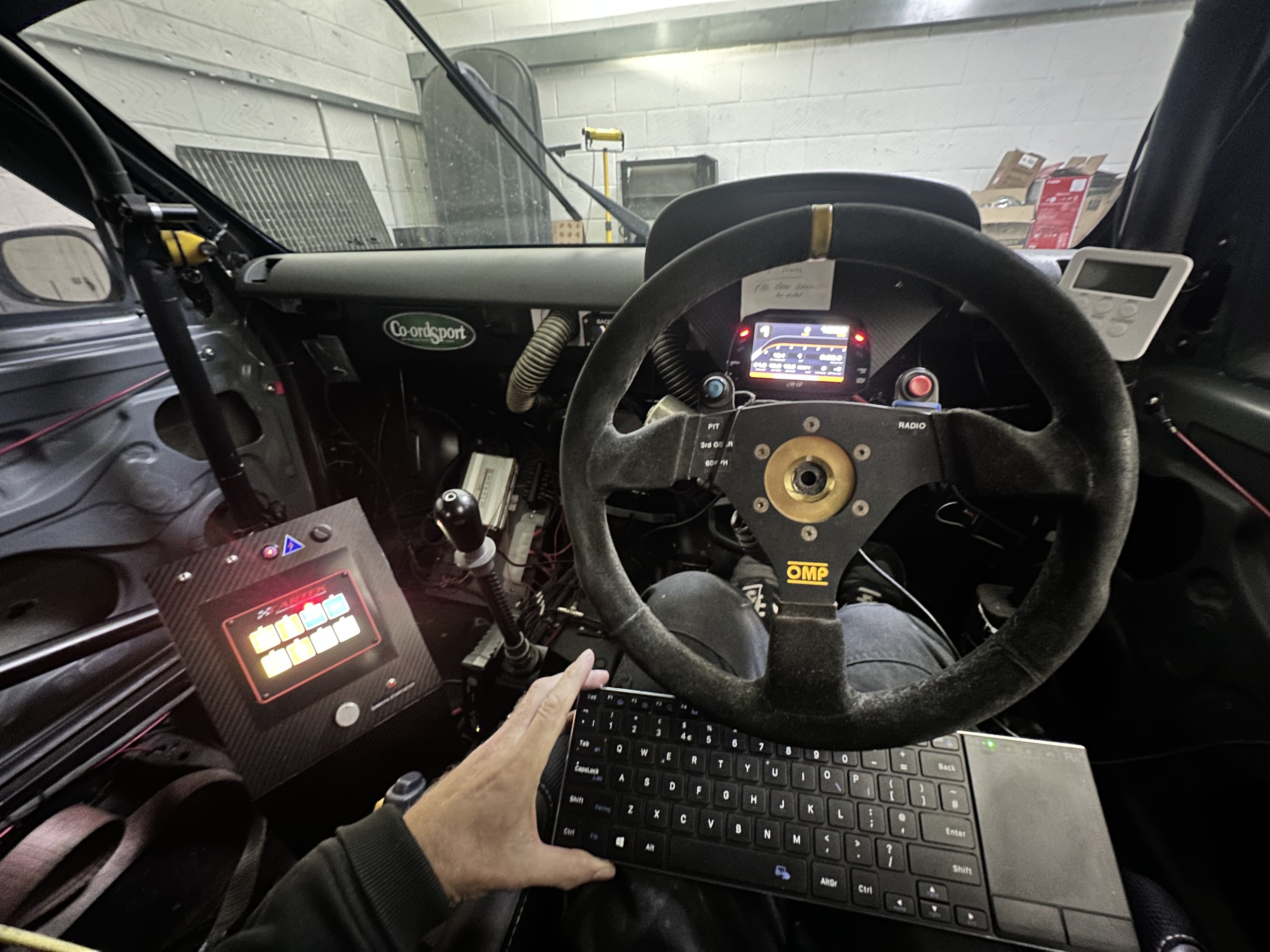

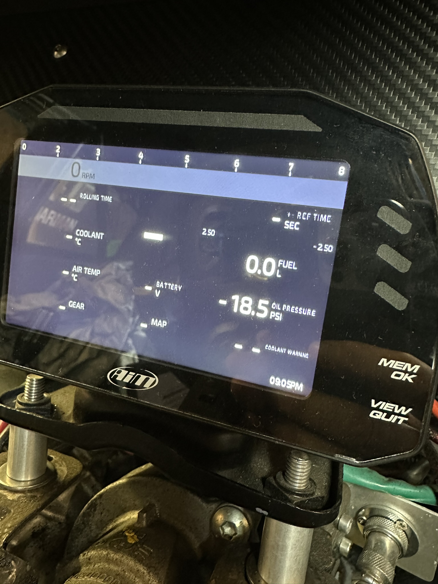

Following that I've spent a few hours reading up about wiring in and calibrating a custom fuel sender in the Aim dash. So, firstly I ran an Aim patch lead from the tank to the dash and then pinned it into the 2nd analogue input on the rear auxilliary plug.
Wiring in the other end was a little more tricky. It requires a resistor to be connected in line to allow the resistance on the float position to be read using a 5mV supply that the dash uses.
Following that it's al about calibration in the software. Lastnight I got as far as setting up the display on the dash and began a table to convert the millivolt reading into ltrs.
So, today's mission is to start filling the tank in 500ml increments and log the readings to build a table. As the tank isn't an even shape this is the best way to create an accurate conversion table. Then there's a bit of jiggerypokery to allow for slosh, although with the baffles in the tank I'm hoping that will be minimal.

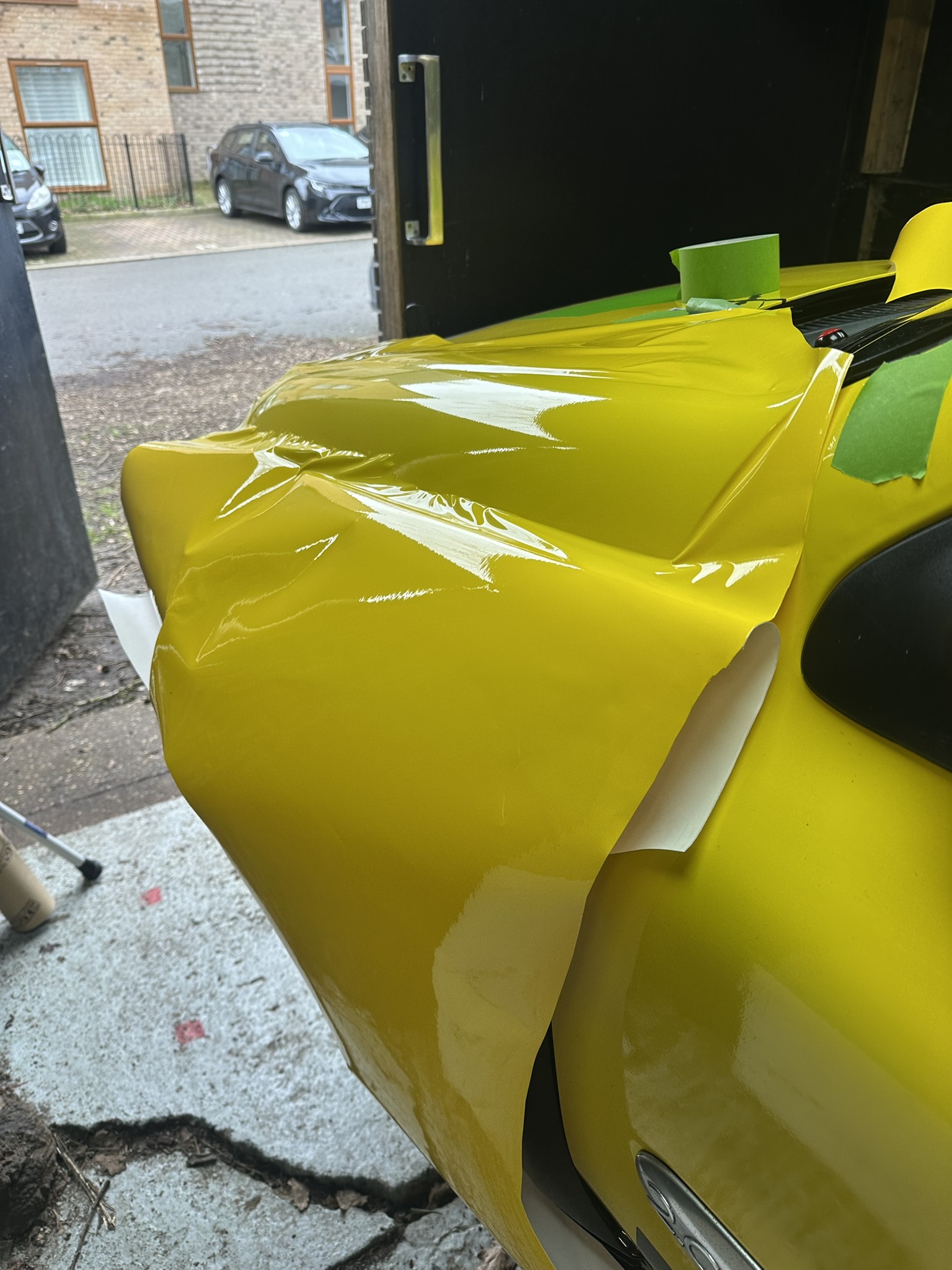

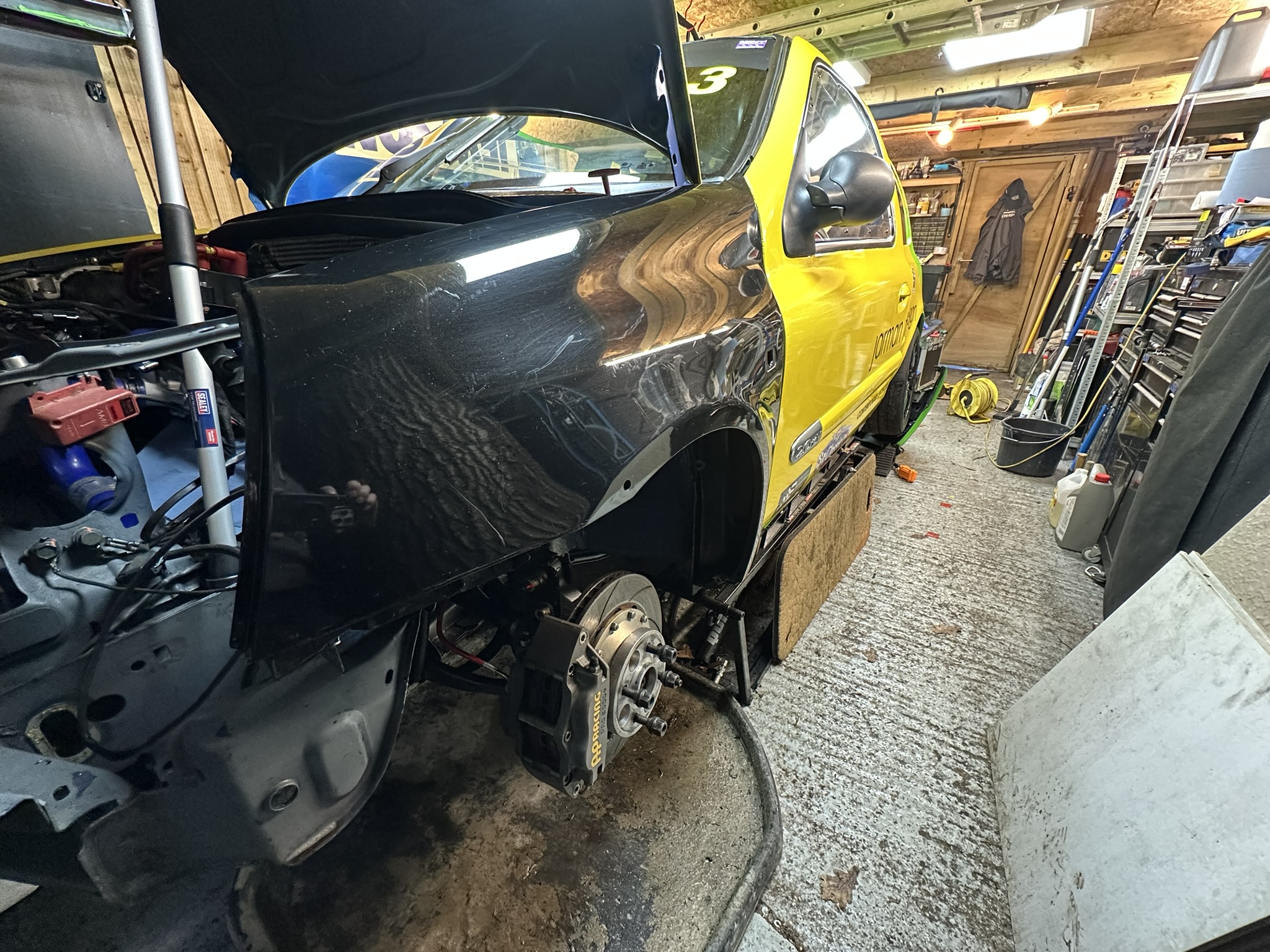

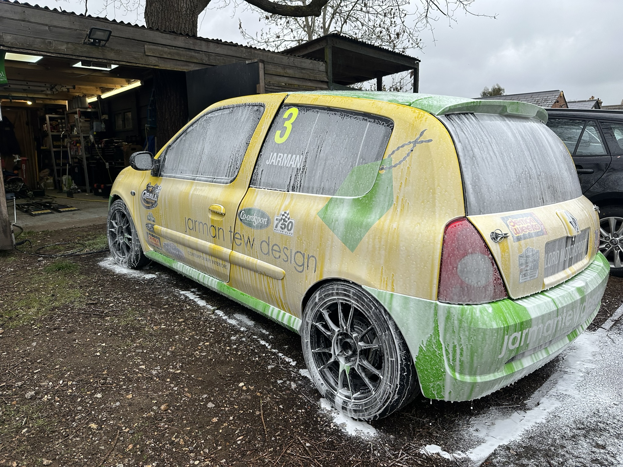

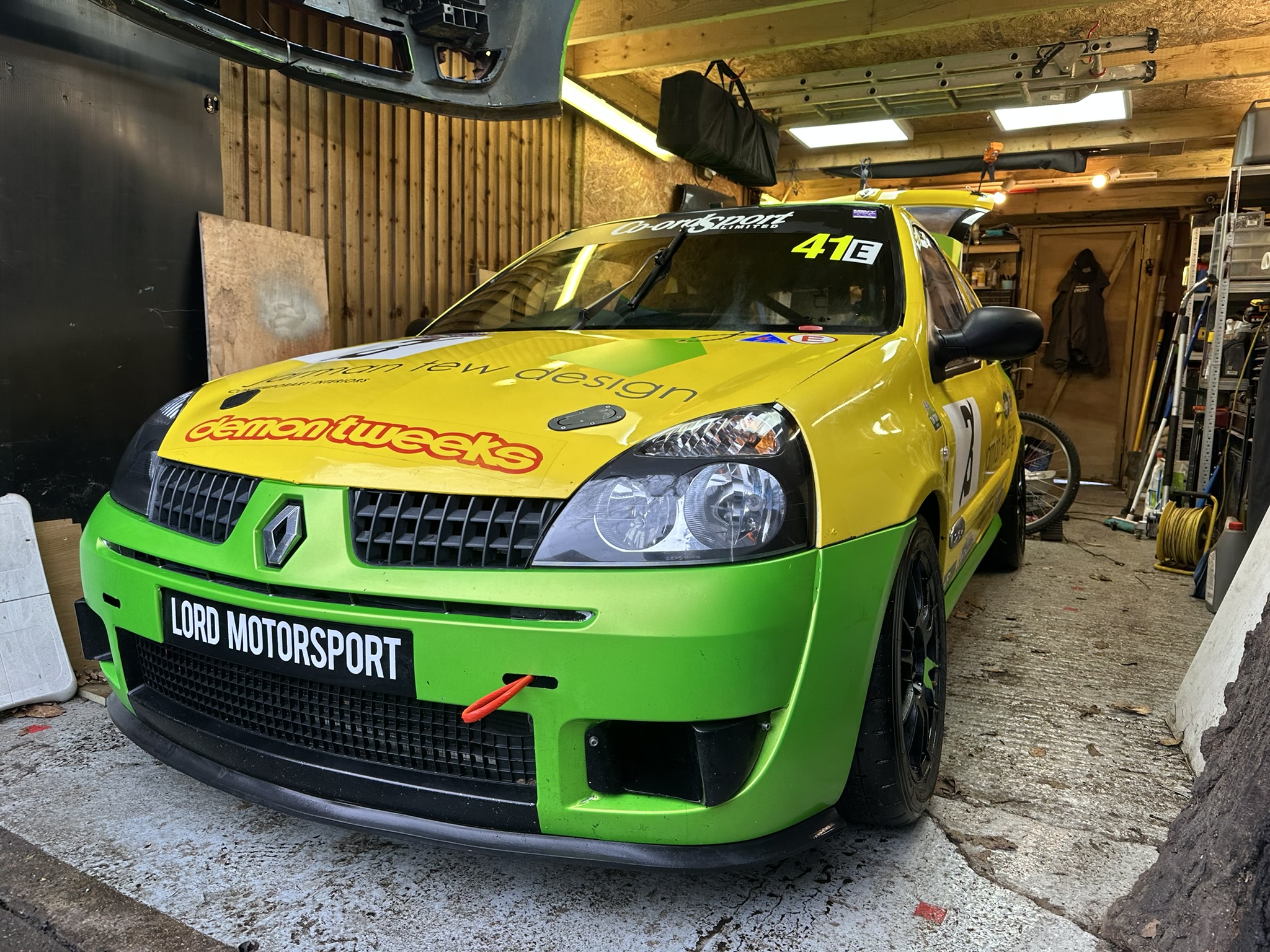

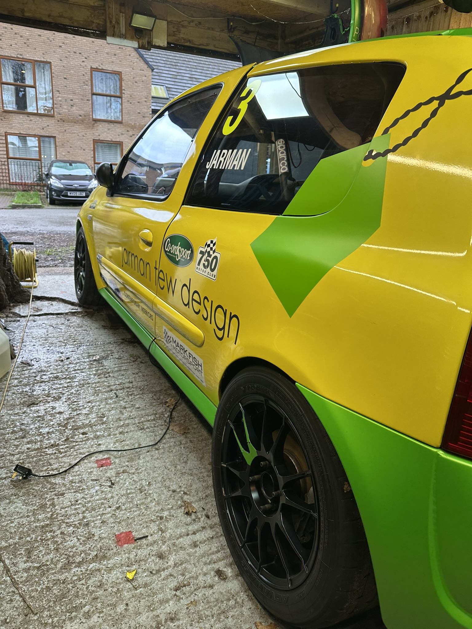

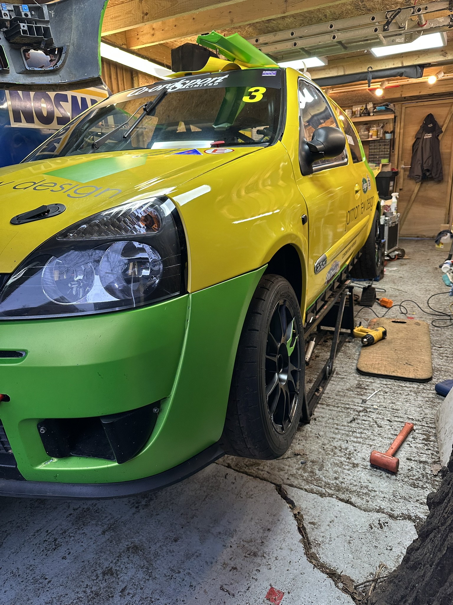

An overdue wash yesterday and today made a start on updating the livery slightly. Finally moving away from the traditional white number squares on the dors and bonnet and continuing from the Birkett with the more popular, these days - Yellow window numbers.
I've turned the car around so I can get to the near side wing and cill to re-wrap those to complete the tidy up.

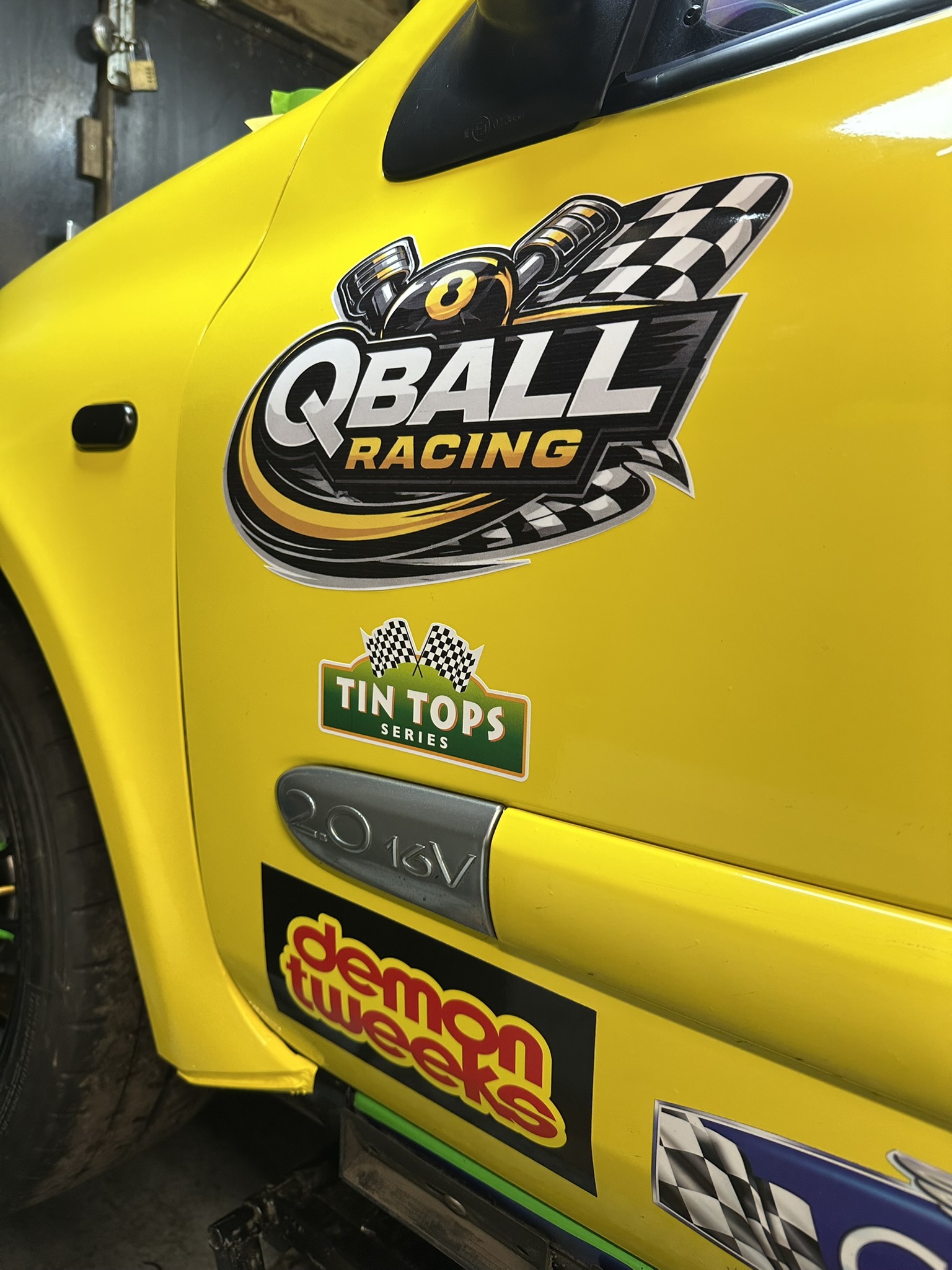

More cosmetic work this weekend. Removed the last couple of parts that still had the original wrap on from 10 years ago. They've weathered well in fairness but the wing still had some gravel rash on it from the roll at Craners 9 years ago!

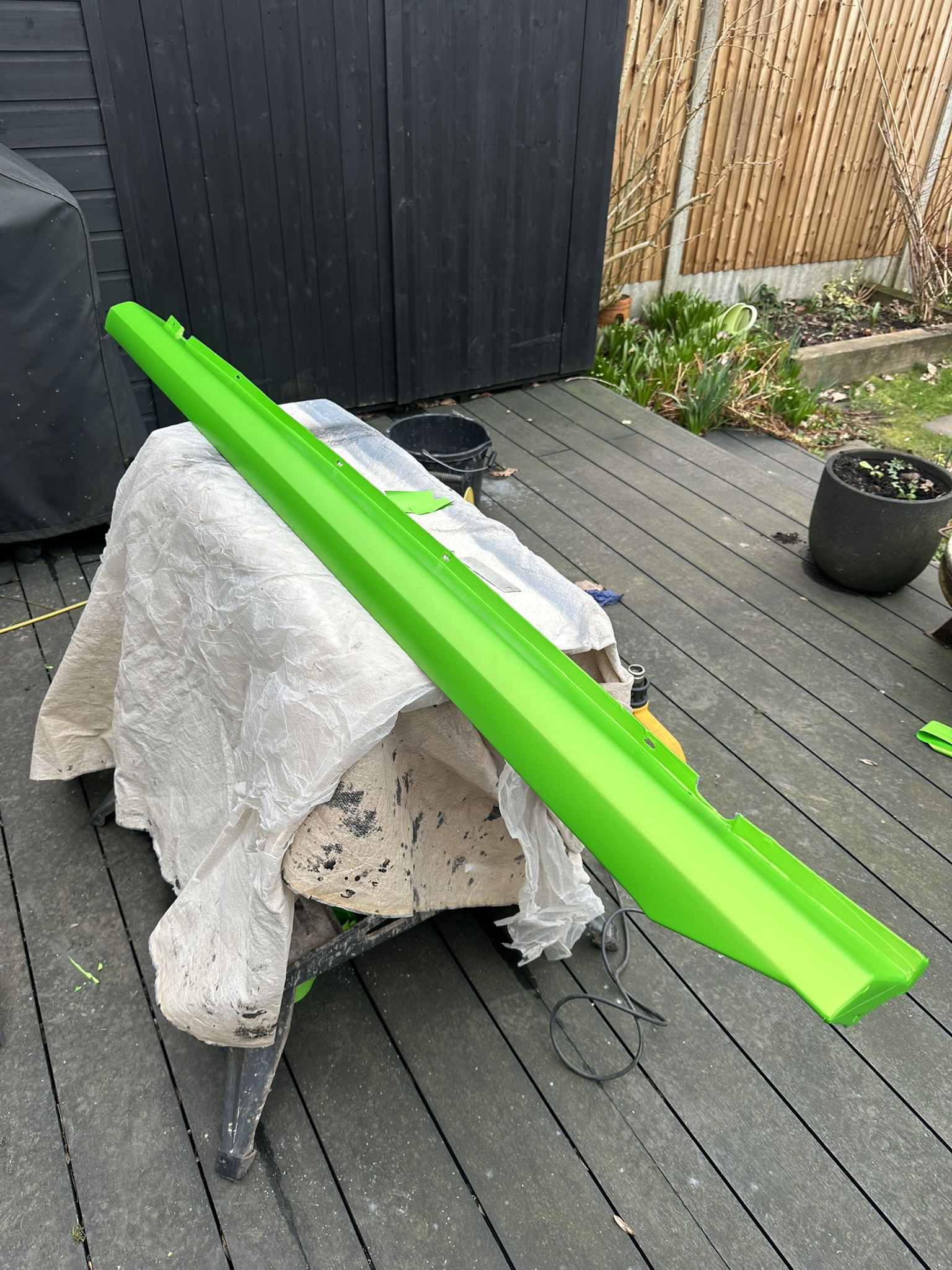

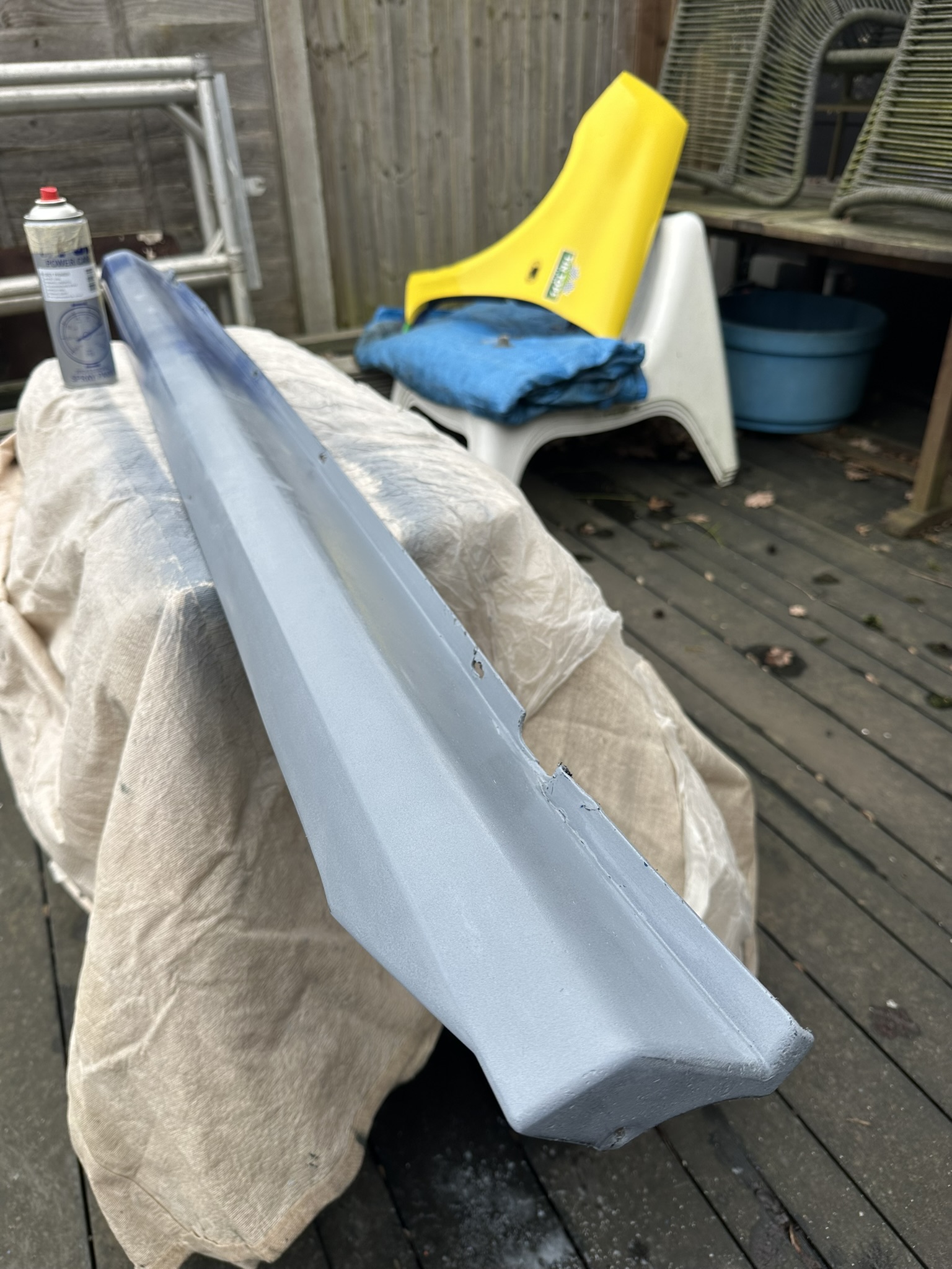

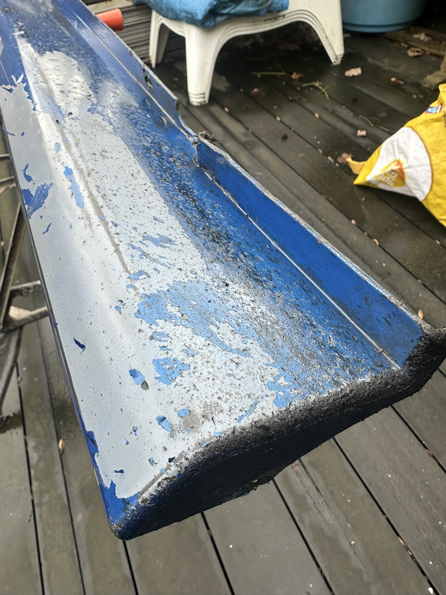

Equally the side skirt was pretty rough under the wrap and as a lot of the paint came off with the wrap it lookslike it had been painted in the past. So that needed a bit of attention before I could wrap it.
Anyway, a few hours later both were done along with sanding down the side repeater and spraying satin black the same as the other side.
Sunday will be completing applying some more stickers and finishing the cover for the lift pump.
The wrap on the skirt isn't perfect but enough for a race car!

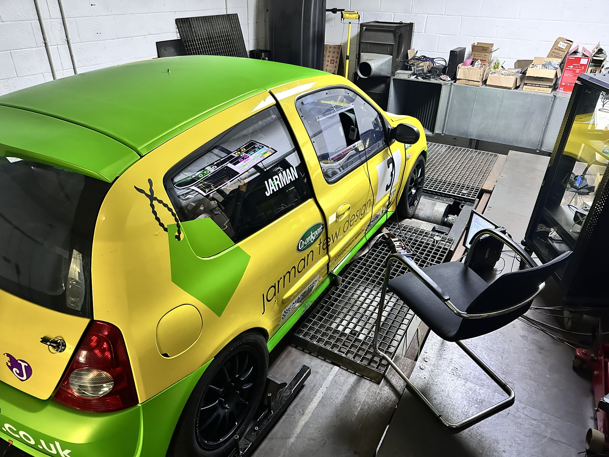

So, just to expand a little on the video posted previously. Dyno day was a success!
Being just a 20 minute drive away meant a fairly leisurely start as they didn't want me there until 10am and knowing the setup there now made getting the car off the trailer and into the dyno pretty plain sailing. By 11:30 we were strapped in and sipping coffee.
In fact this may have been the smoothest running dyno session I've ever experienced. No delays from a car on the rollers before me; no software or dyno issues and no gremlins with the car.
So we went right through pretty much without stopping. Building up the site maps from 1000rpm up to 3500rpm afterwhich you can set the software learning the nature of the engine and it populates the whole map ready to be tested.
Once the power runs started there was very little tweaking to do. The first full power run yielded 205bhp which I would have been happy with but Steve could see that the engine wanted more, so a bit more adjustment and we went again. This time 212.4bhp. Much more like it and almost identical to the same spec we ran back in the day and with 158lbft of torque it should be nice in an 850kg car.
I do wonder whether the race engine is worth the effort!
Decent numbers with a nice usable torque curve!

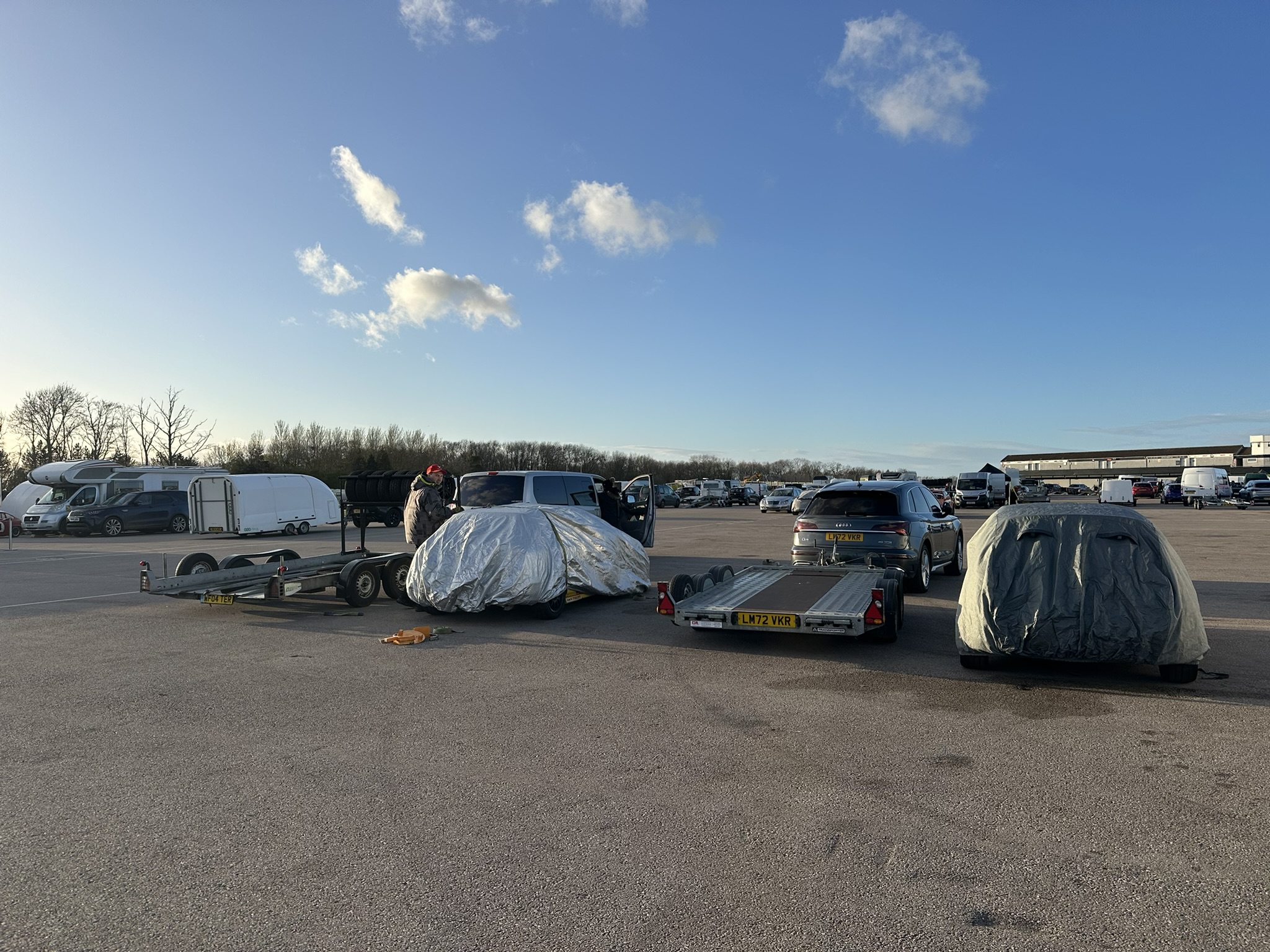

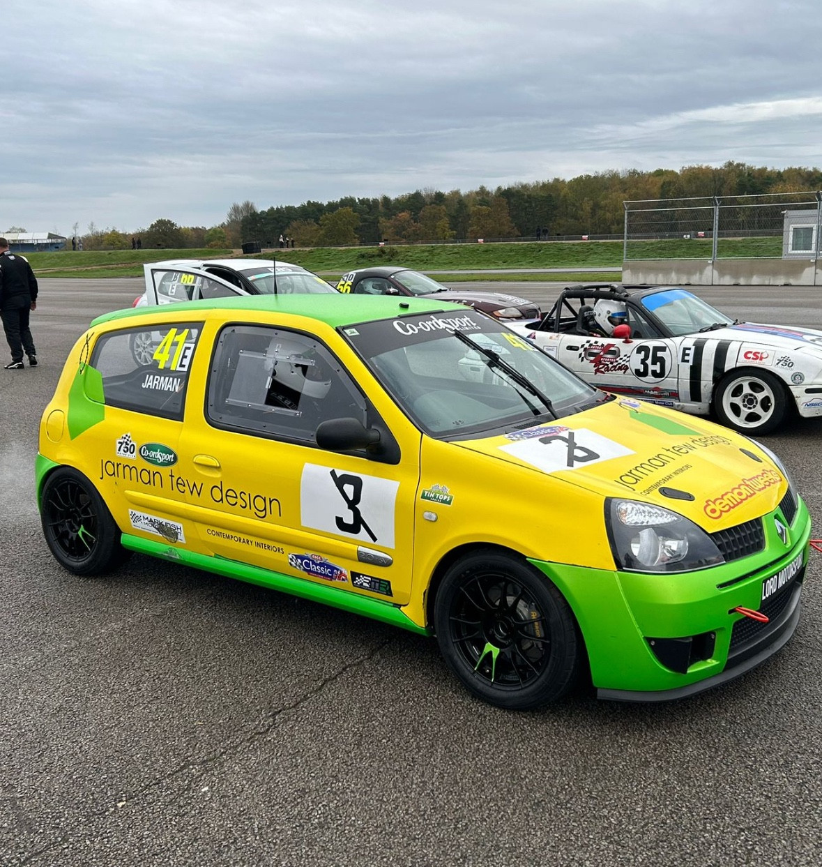

Its always a sign of a good day at the track when you can drive the car on to the trailer at the end of the day.
Weather wise, we couln't have asked for more and with a rare private trackday at Snetterton the day promised some good, clear track time.
If only the car behaves...
Not off to a great start when the car cuts out completely exiting turn 2 on the sighting laps! A strange one and a quick reset and it goes again and behaves for the rest of the laps.
Back in and swap the drive with Rob Q and he experiences the same thing. And again the car is fine after that.
So, we get sighting laps out of the way and the 3 of us begin a rotation of 1-3-1. (one out lap, 3 hot laps and 1 in lap). The car cuts out again on a acouple of occasions but other than that it behaves and we all start to get comfortable.
Despite a private day there are still 60 cars there (about half a normal track day) but they are mostly road cars and mostly novice track drivers which makes for some rather hairy closing speeds and unpredictable behaviour. All good but just needing to be alert and only Rob Q got a couple of clear laps and started making some progress.

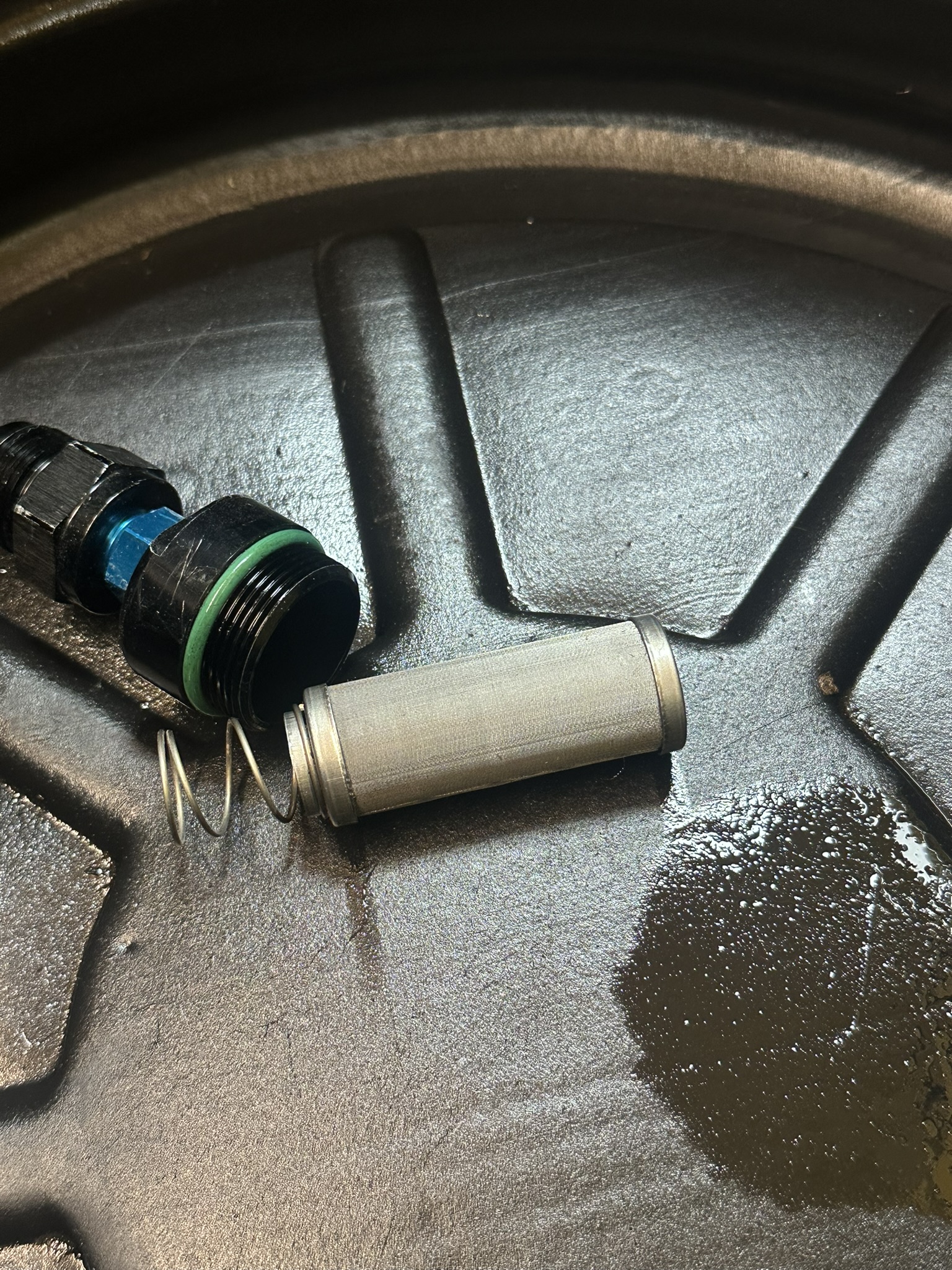

AFter some investigation, we adjusted the fuel pressure on the regulator and cleaned out the fuel filter, (it wasn't too bad) and then sent it again.

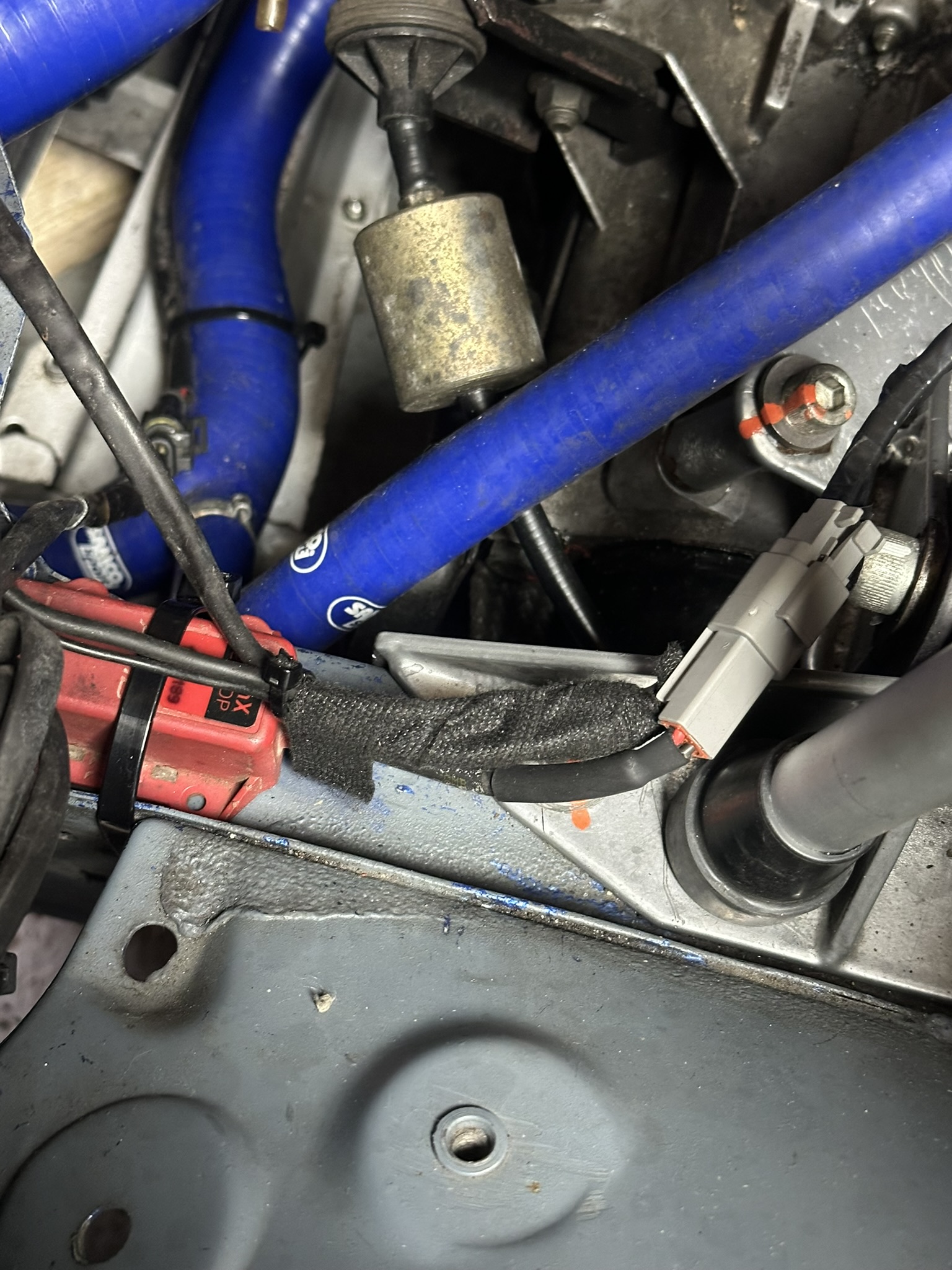

More investigation needed so we moved on to the engine bay. Injector wiring has been the cause of issues in the past so we stripped and checked all this. Nothing doing, except for a pin in one of the injector plugs wasn't engaged properly inside the body of the plug so we don't think it was properly connected to the injector. A quick adjustment and then out again.
Again, it ran great for a few laps and then... it cut out again!

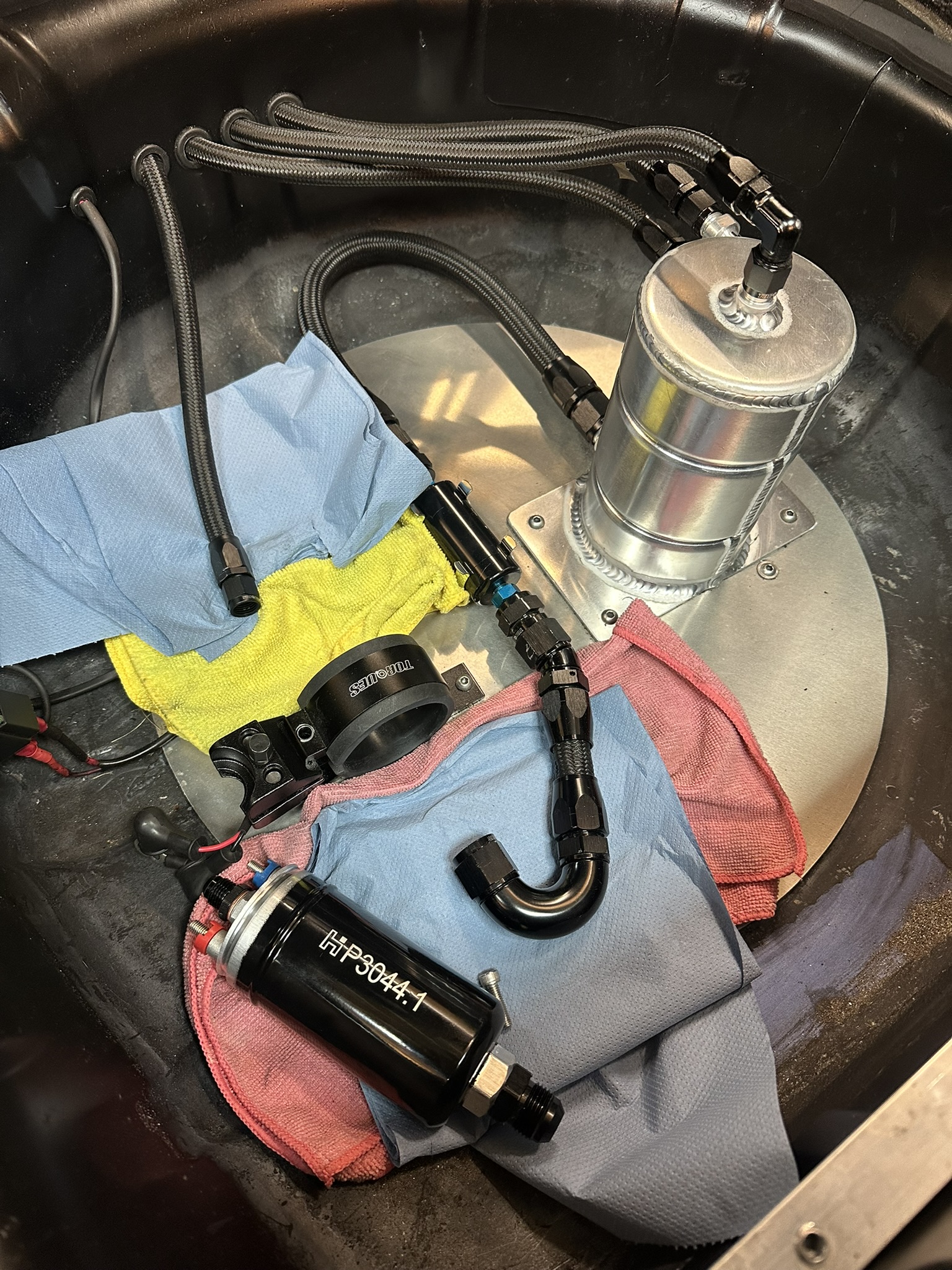

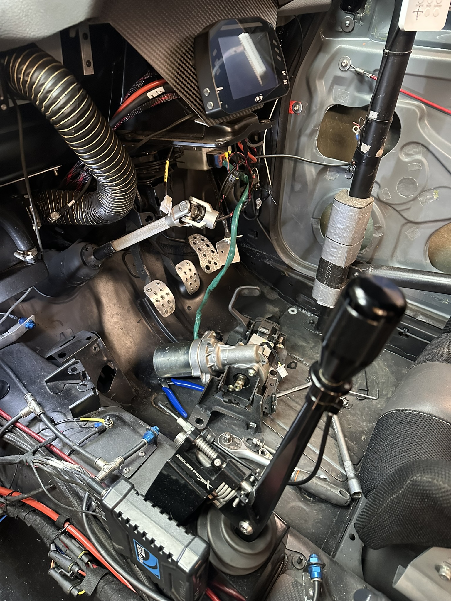

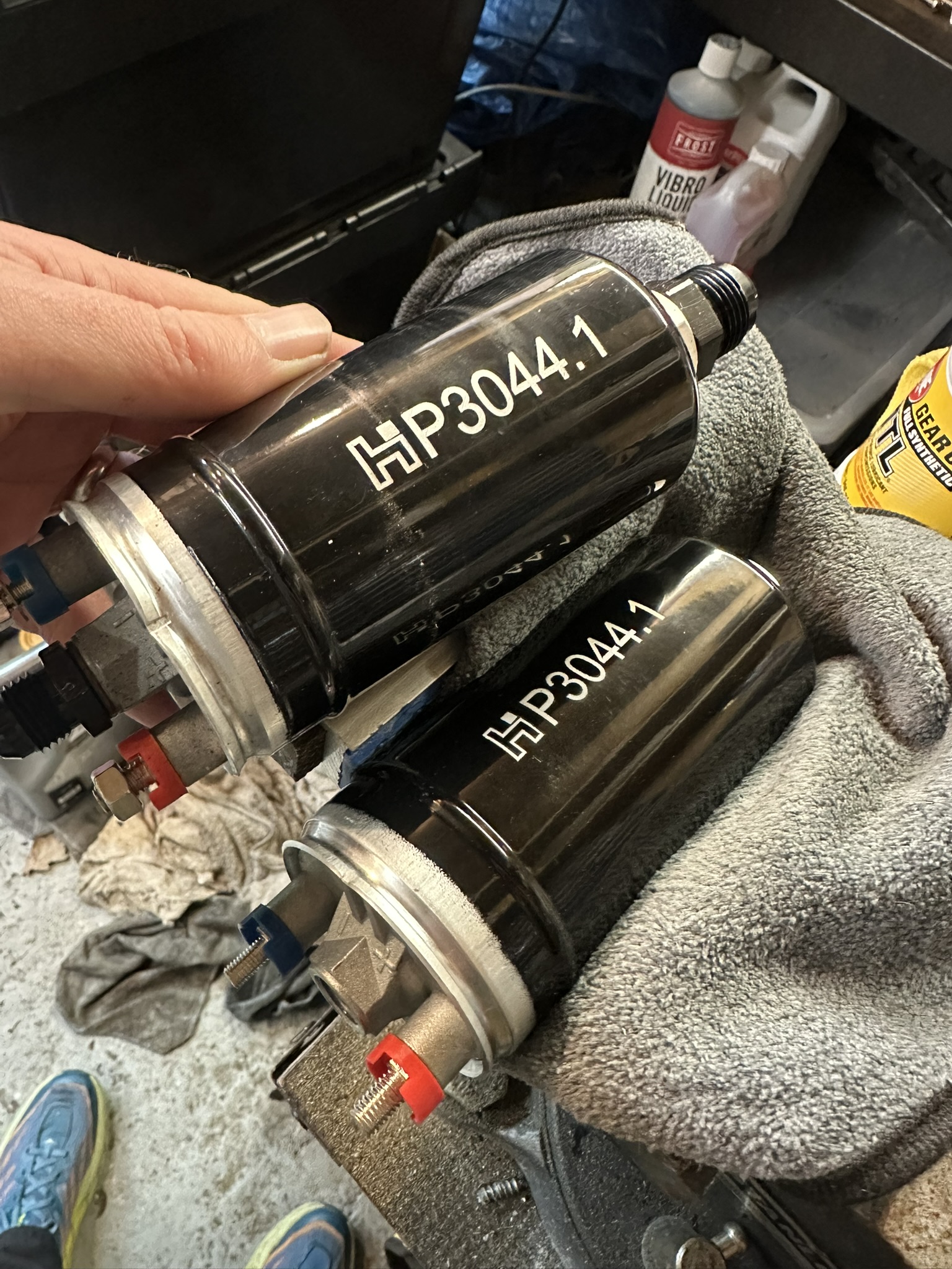

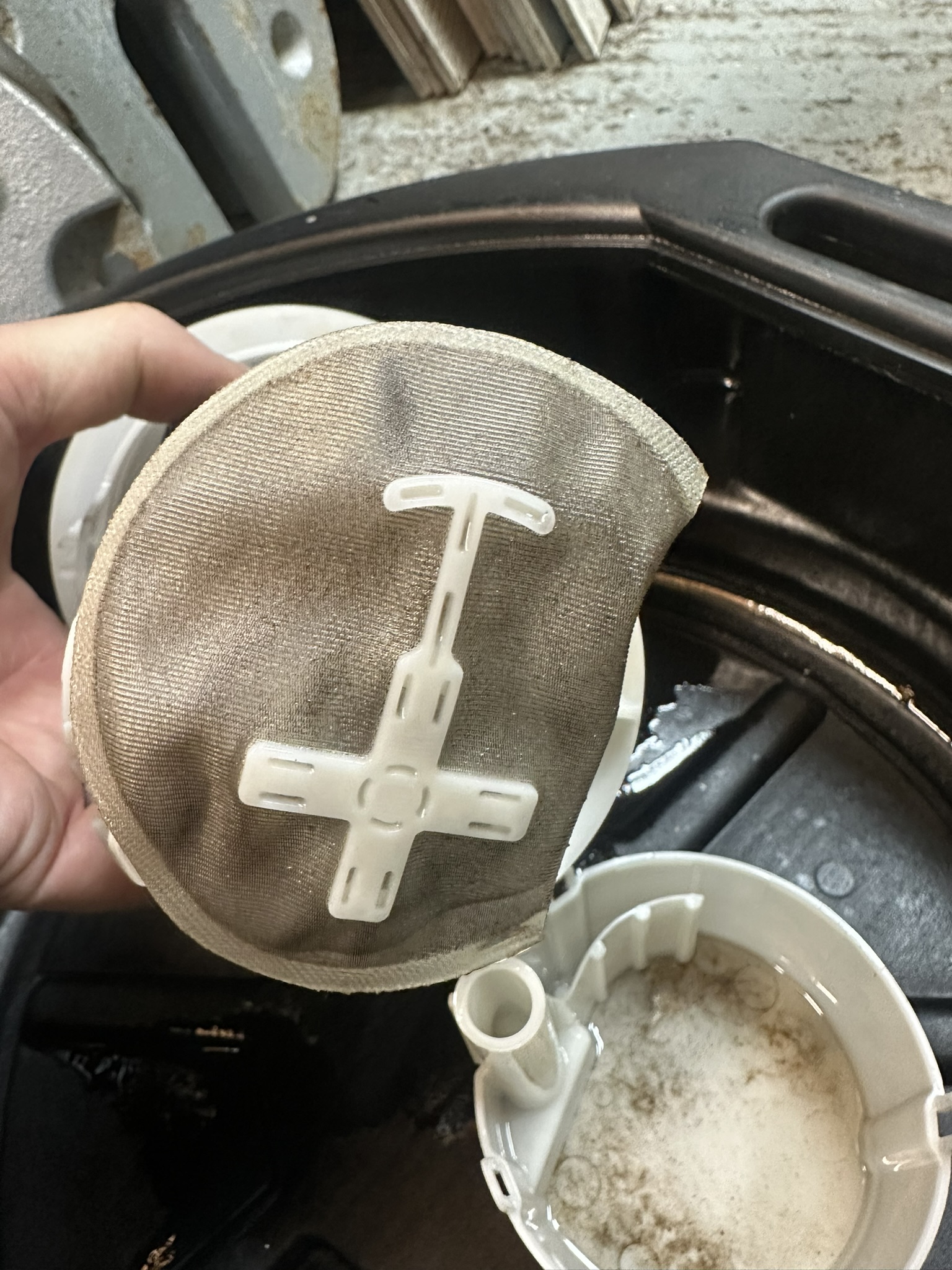

Had a bit of time on Saturday this weekend to start investigating our issues. First off was draining the tank so we can see what's going on with the sender and possibly look at the pump.

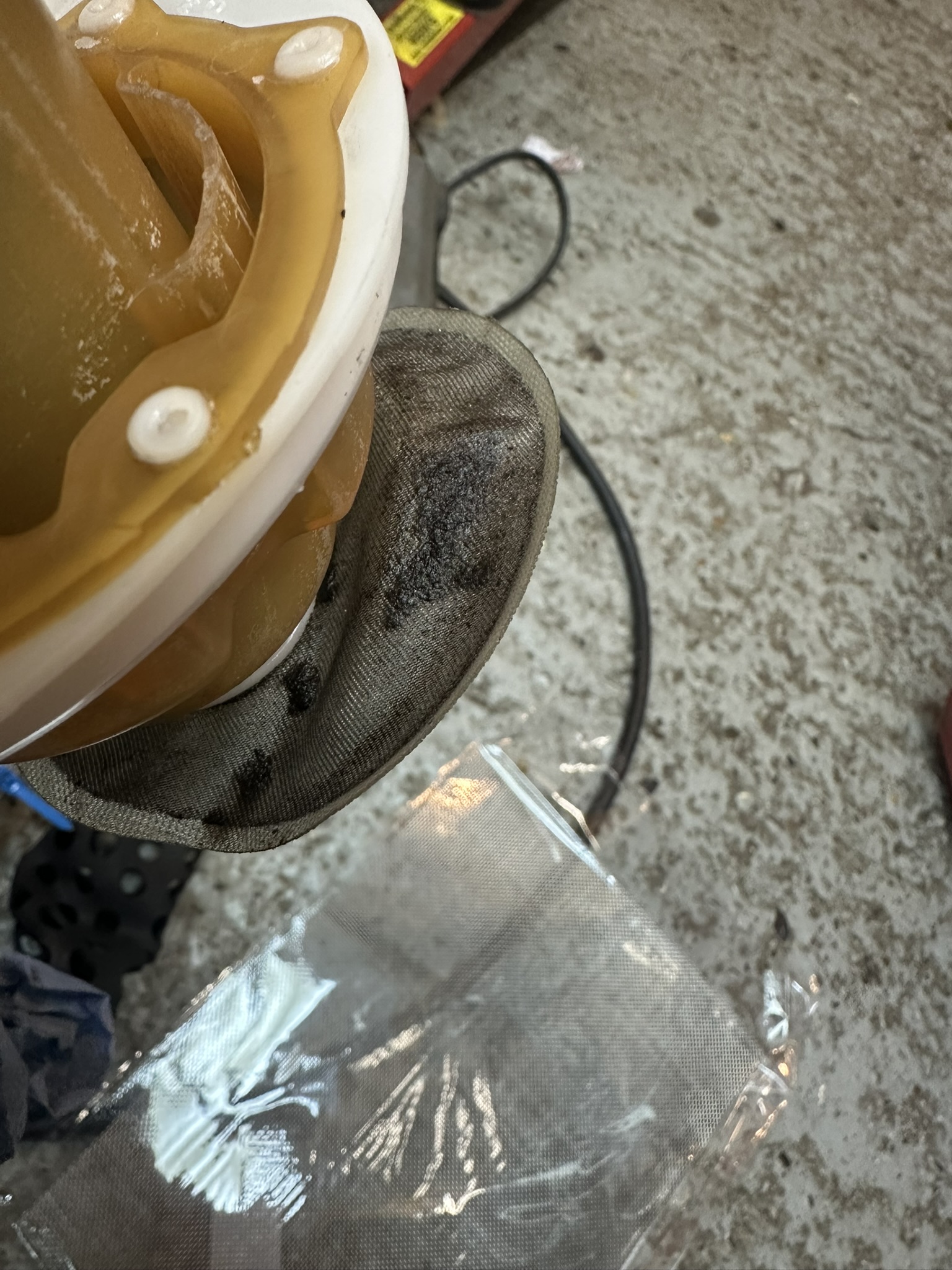

Once starting to pump the fuel it became apparent that there was air in the swirl pot. I only managed to lear it after repeating the priming process about 30 times! This could easily be why we had low fuel pressure and the pump was noisy. Once I had cleared the air, the pump emptied the tank without issue.
As a precaution though, I have ordered a new pump.

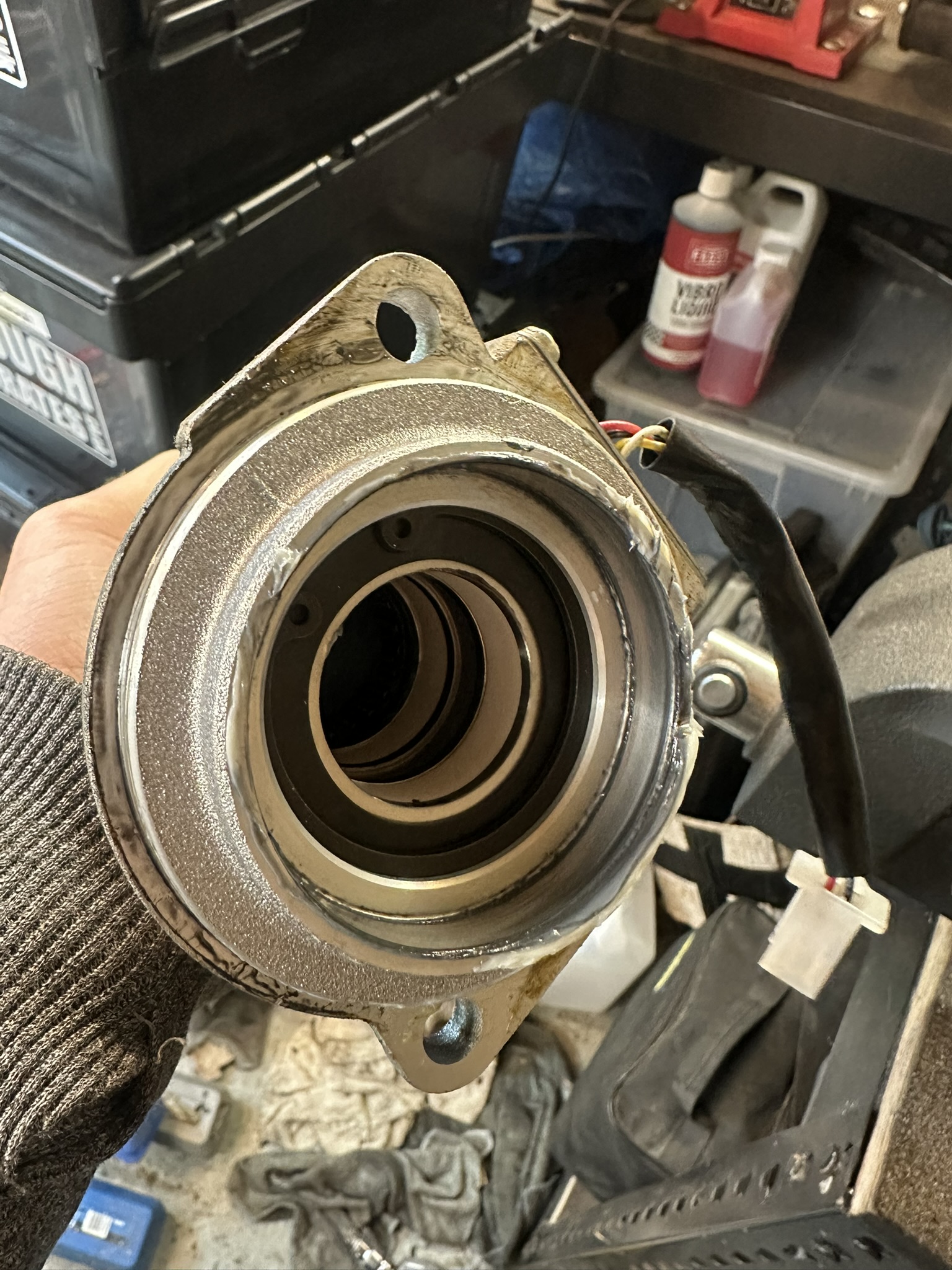

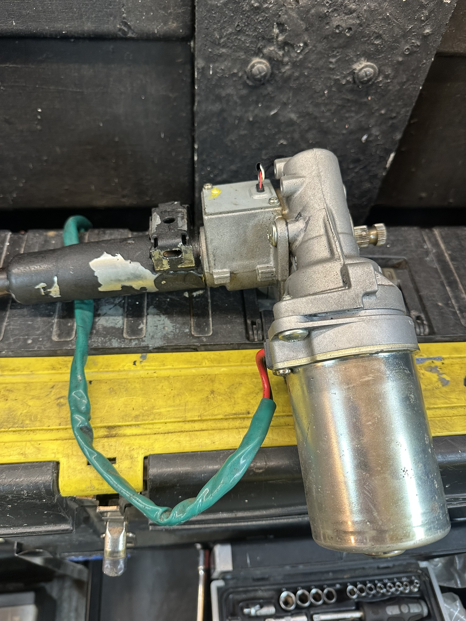

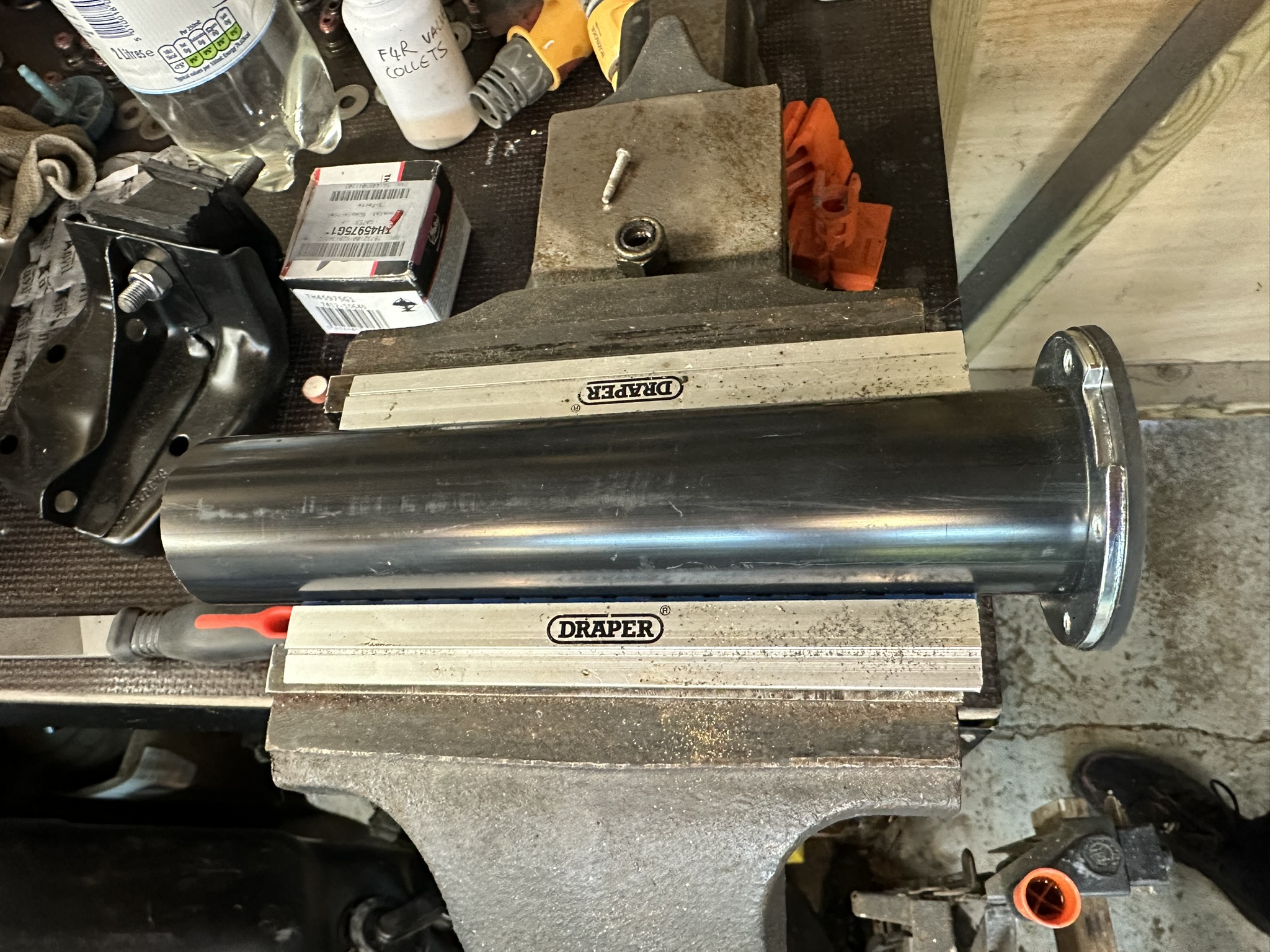

I then turned to the EPAS. It's difficult to test the Ebay controller kit but the rheostat adjuster appears to be working ok. Again, as a precaution I have ordered a new one. (Can you see a pattern emerging?)
I then stripped out the column to see if there was anything obvious going on here...
and dismantled it...
With the motor removed the column felt quite stiff but figure that might be just how they are as they have a worm gear inside. I tested the force required to overcome the internal resistance and measured just under 5Nm. But once apart, nothing internally looked awry other than a dry needle bearing at the steering wheel end which really isn't doing much anyway...
But... As a precaution I've ordered another one!
I'll pack a bit more grease in this one and reassemble it and when the new one arrives I'll check the force required to move that one as a comparison.

New - second hand steering column arrived. tested the stiffness and feels pretty much the same as the existing one. So, I've cleaned and repainted the existing one and for now that will go back in.
Also received the new controller
I'll look at replacing just the rheostat first as they appear to have changed the spec on that.
New fuel pump also turned up. I recon there's probably nothing wrong with the current one either now I know that it was air in the system but I've swapped it out anyway as if the pump ran dry for too long it may be on its last legs anyway.

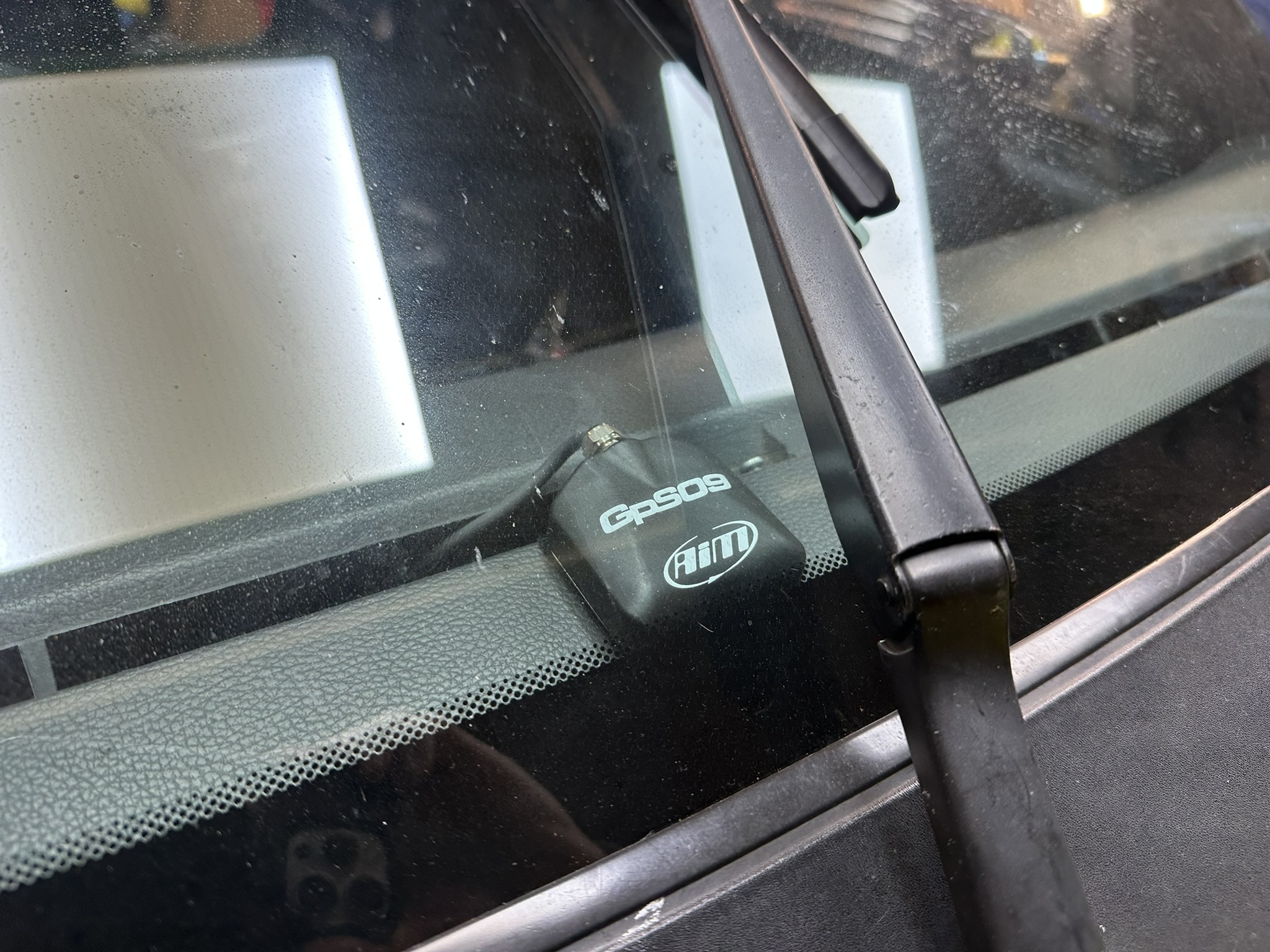

Also the GPS module arrived for the Aim dash so now we should have speed, gears and timing (although I have timing on the VBox anyway)
And finally, this evening I started to tackle the fuel sender and discovered that plastic domestic waste pipe doesn't like Super unleaded!
And also discovered there must have been some dirt in the new tank. This wouldn't have helped!
So back to the drawing board for this but I already have a plan that I'll implement tomorrow I think.

One other job ticked off the list was a stripped thread on top of the gearbox. One of the three bolts securing the mount. A common failure and luckily an easy fix with a helicoil.

I need to start preparing the head.
A quick bath this afternoon and then it will be onto the trailer tomorrow before heading up in the afternoon.

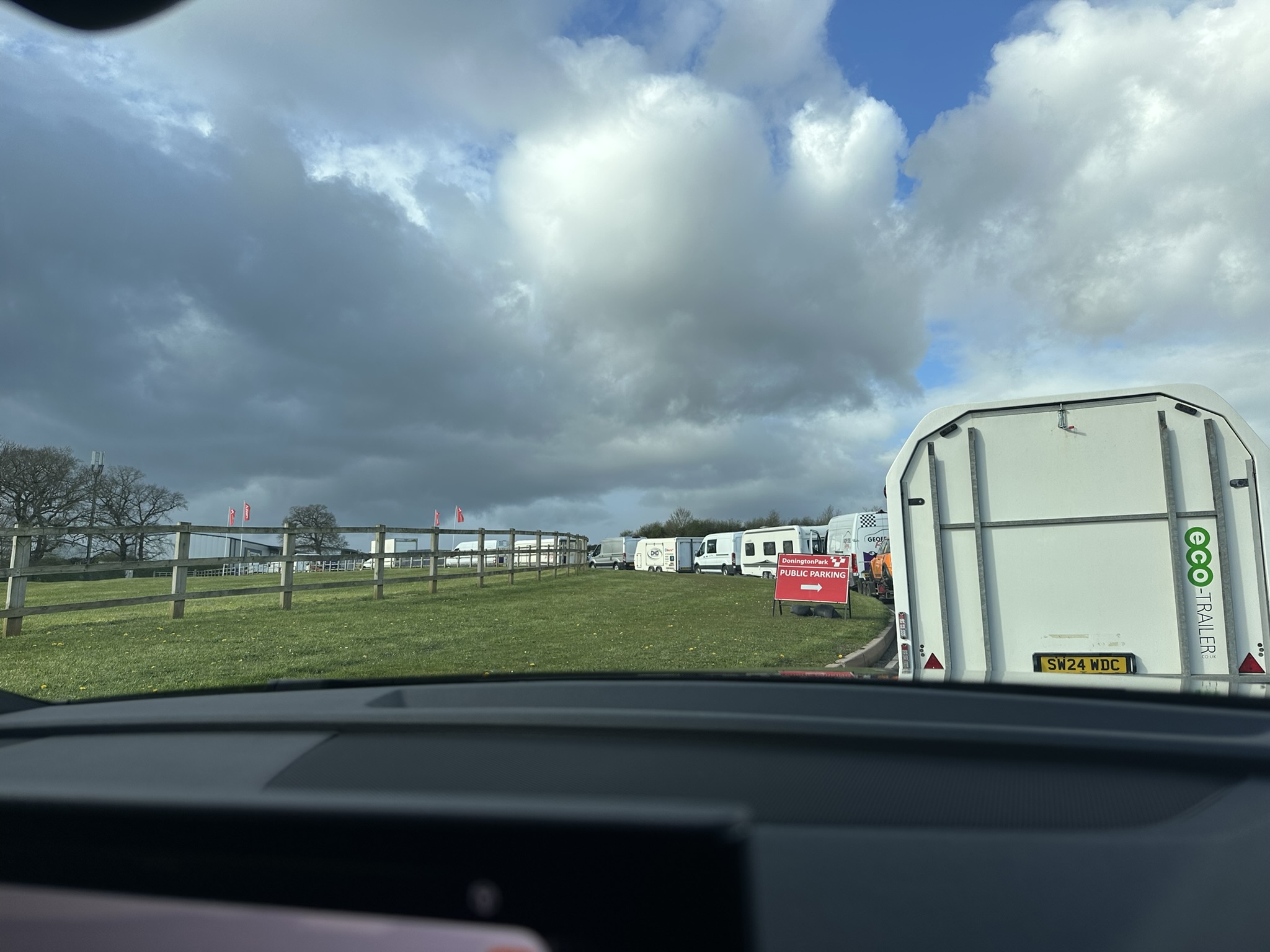

Packing tetris complete, I began the 2 and a half hour drive up to Donington on Saturday afternoon with a view to getting a good spot in the paddock, unloading the car and then heading to the hotel for the evening.
An uneventful journey followed but they weren't letting any Sunday competitors into the paddock until after 5pm, so I joined the queue up to the main gate.
once in, there was plenty of space and I pitched up next to our friends at Recycled Racing who surprised me with their "Jarman" broom. so named apparently after i borrowed it from them many years ago after an excursion into the gravel and duly ruined their nice new broom!
With the gazebo arriving in the morning, it was just a case of dropping the car beside the trailer to reserve a spot for the night.

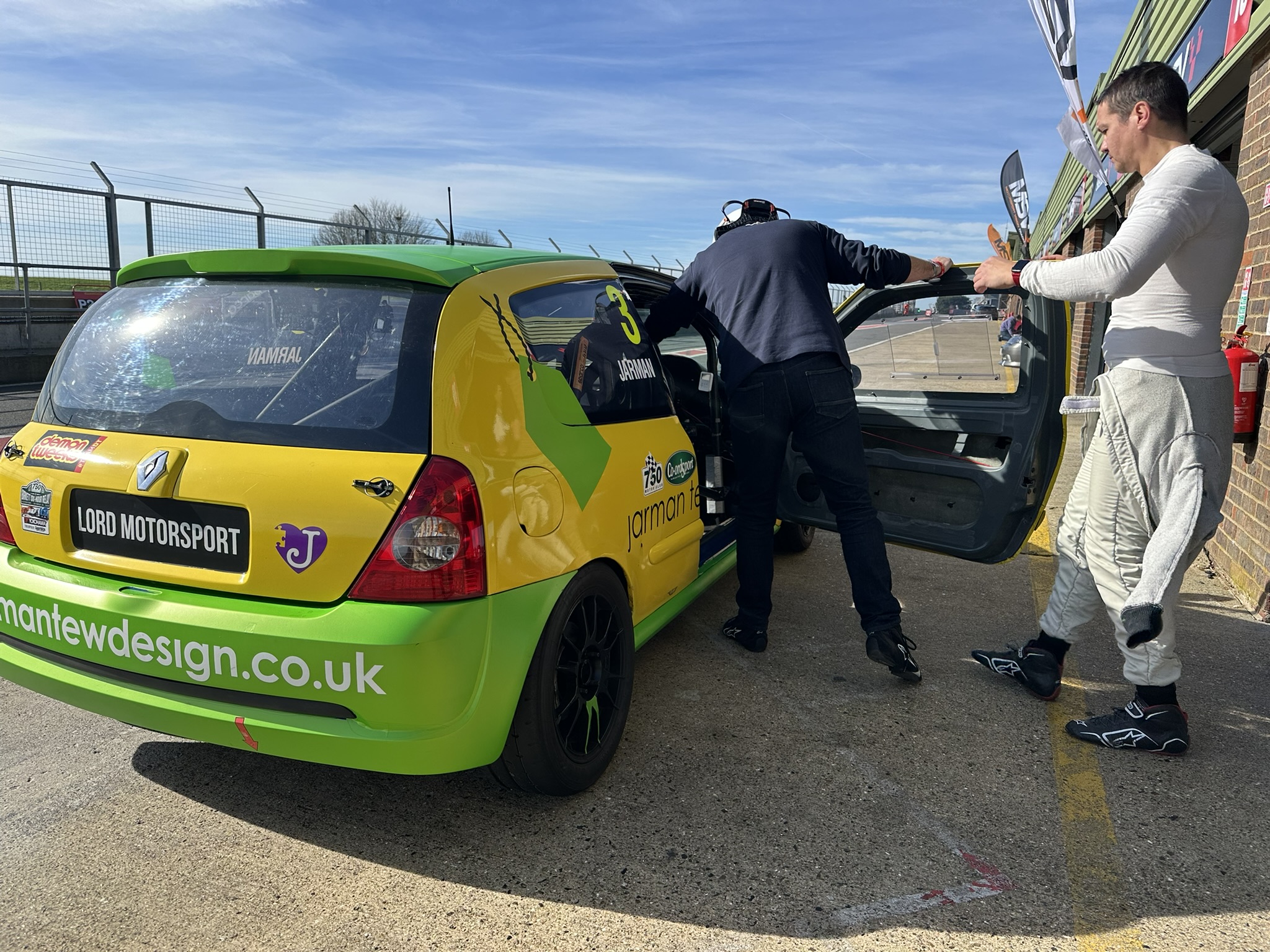

With new brake pads in it was decided that john would take the first stint, bed the brakes in and then build speed and settle in. He was nervous having never raced at Donington. (although he's done many laps of testing there)
This is what a nervous John looks like!
john's stint went well and he set a decent time that would put us where we wanted on the grid so I took over with the hope to improve if possible.

Just when we thought we had sorted everything it started losing power at the top end and I decided to pit just before the end of the session as i clearly wasn't going to go any faster. P3 in class which was good enough.
As the race wasn't until 5:20 we had plenty of time to trouble shoot the issue and i was pretty certain it was fuel again.
By this time the rain was coming down and with the wind the gazebo wasn't giving us much protection. Pretty miserable conditions to be working on a car but at least we weren't crawling around underneath it!
After isolating the high pressure pump we wanted to confirm fuel was getting out of the tank. but priming the lift pump wasn't showing any fuel at the rail.
Next we disconnected the line from the swirl pot and found fuel was getting there fine.
more bashing heads and a decision to check the filter again. ( we did this at Snetterton already)
Sure enough though it was clogged! The new fuel tank must have some crap still in it. Once this was cleared fuel was flowing nicely.
Problem solved!

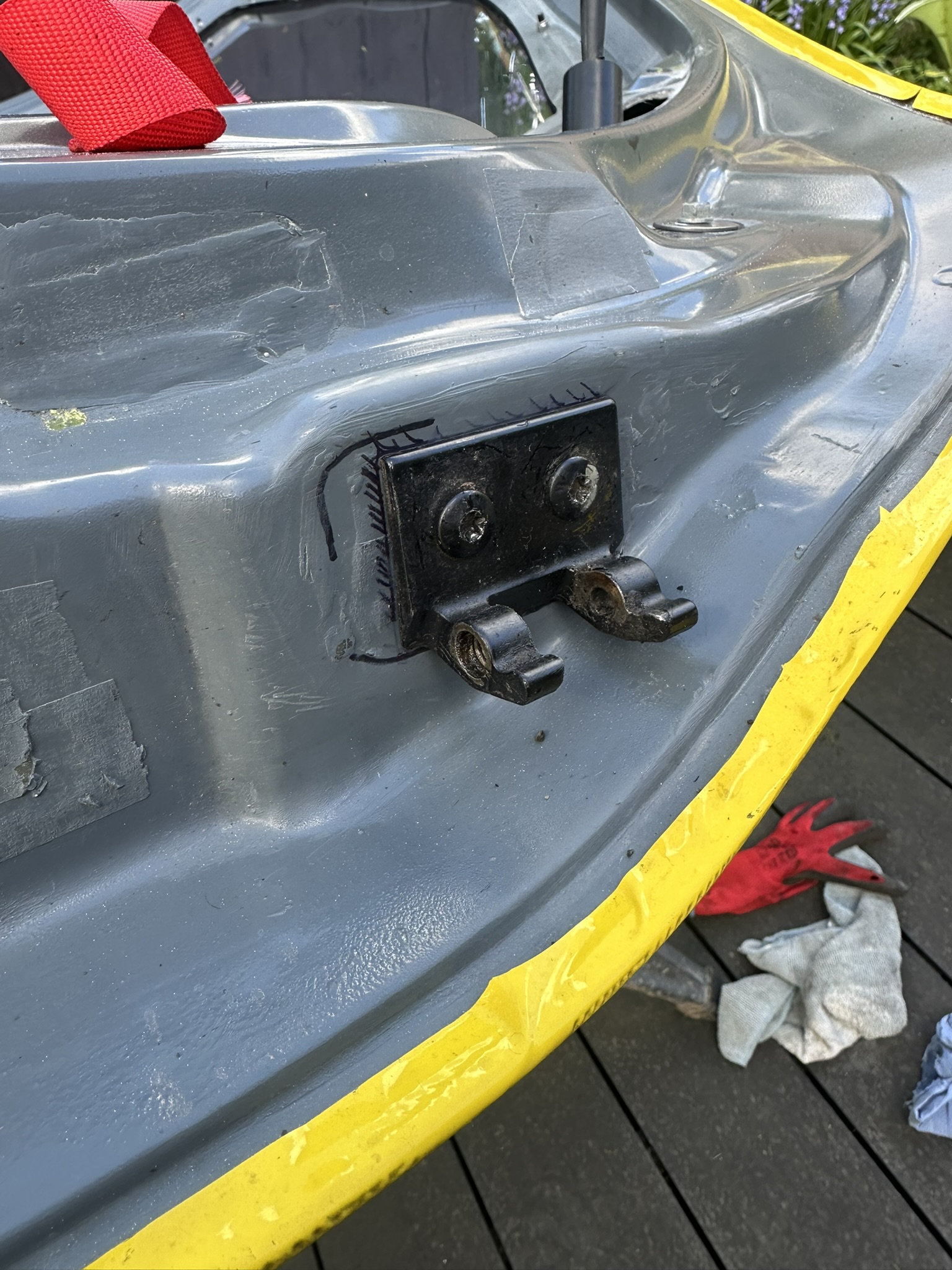

Second is the passenger door which is sagging somewhat and it looks like the hinge area of the fibreglass needs some reinforcing. I want to address this before anything fails completely.

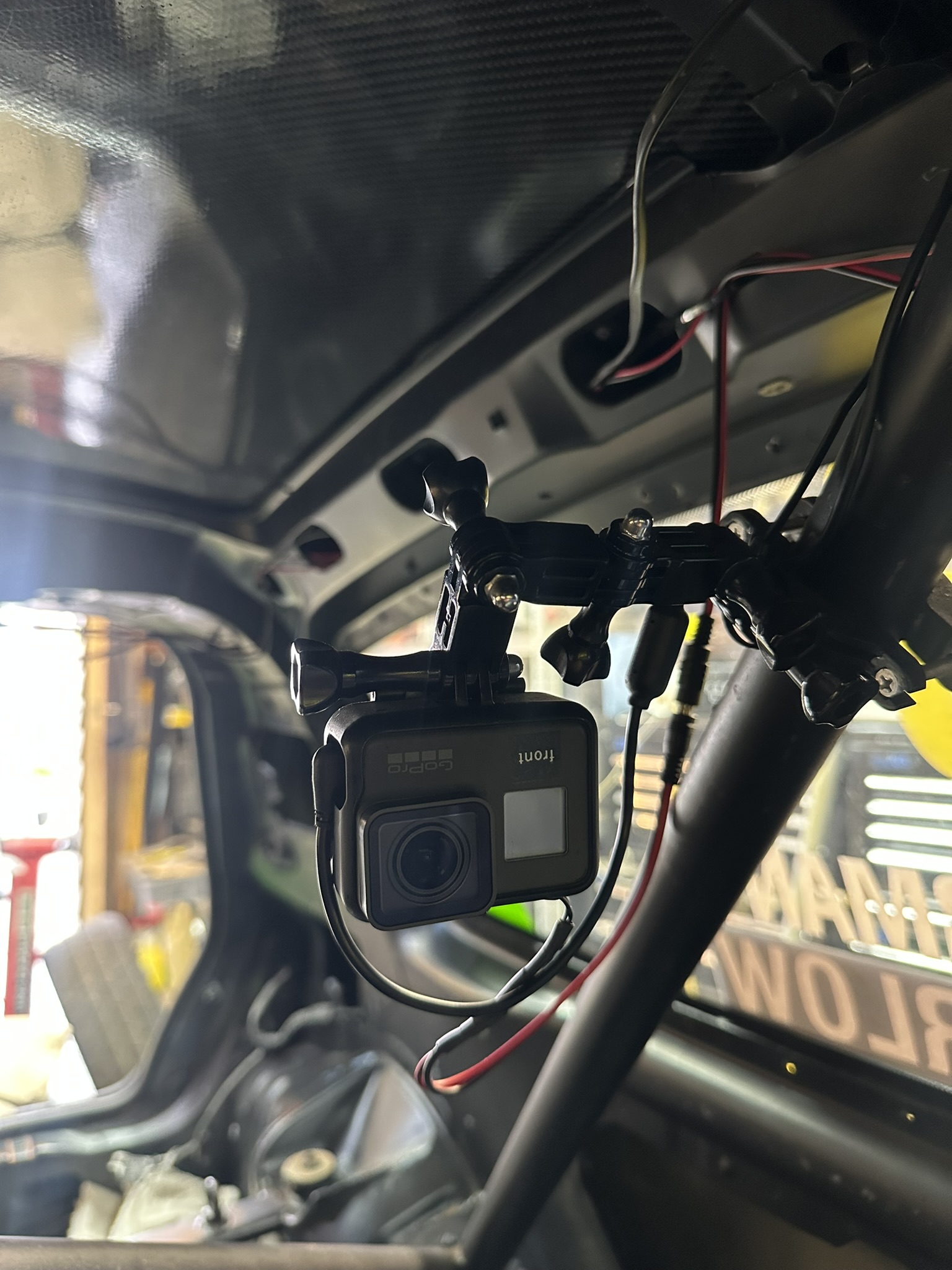

The rear GoPro has alway only worked on its own battery. The remote start and stop works but it is always prone to running out of power. So an adapter kit has been purchased to deal with that.
The GPS module on the Aim dash didn't work at Donington. It wasn't picking up any satellites. It looks like I hadn't installed it properly in the software so that's now done and we'll test that at the trackday.

Finally, the race engine is almost complete. My builder messaged me to say that the oil pump chain and sprocket were looking a little tired so new ones were aquired and they will be the last piece of the puzzle before the bottom end can come home.
Pre Brands Hatch prep has started today. Hinge reinforcement being first on the list.
After removing the hinge from the door it was clear that the fibreglass was starting to fatigue with some noticeable flex.
Definitely needs reinforcement although to be fair its lasted this long, so it can't have been too bad.
rather than getting into the messy business of building up the fibreglass I opted to make up an alumnium spreader plate to mount on the inside.
So this has been bonded into the door and clamped through with the hinge.
A good improvement that will hopefully last.

Sadly for Mark, the Nissan's engine had other ideas with a rod leaving the chat within half an hour of starting!
Not an outcome I'd wish on anyone of course but the silverlining being that we had the garage to ourselves for the rest of the day. (we did help them push the car onto the trailer though, and I bought them coffee too)

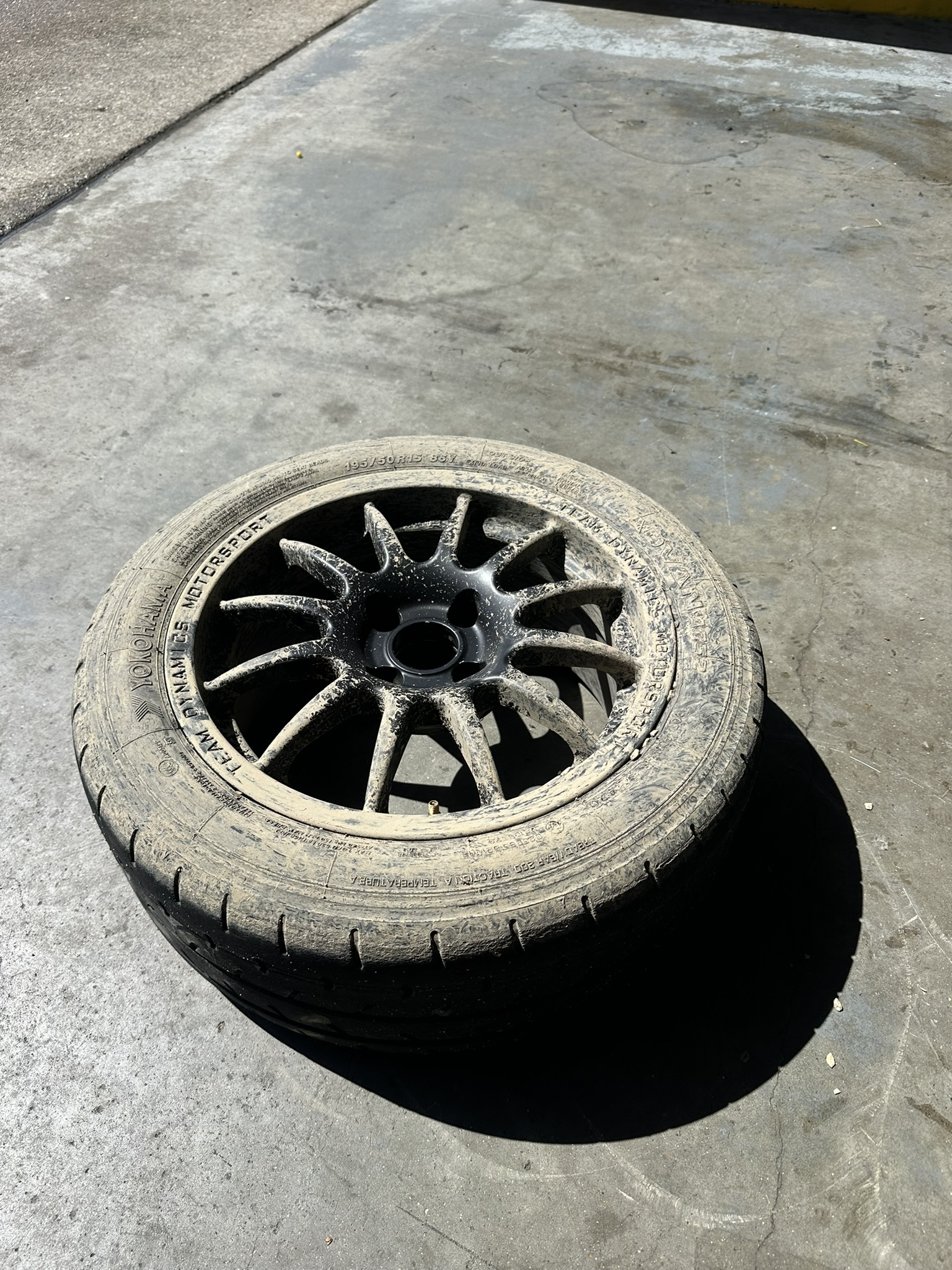

During a stint on a damp track John, unfortunately outbraked himself up into druids and ended up in the gravel. Nothing too serious but the usual gravel clearout lost us a bit of time.
But it was business as usual after half an hour or so.
We both set our best times in the morning while it was dry, with John just 0.4s behind my best time. A quick review of the VBox data at lunch revealed he was losing all his time through Surtees and Mclaren, so we firgured he'd be able to work on that during qualifying next week.
We called it a day at about 4pm as there was no sign of the track drying out and we weren't learning anything more.

Back in the workshop today, I've strated working through the, thankfully quite short list of things to address before next weekend.
With the remnants of the trip into the gravel still evident under the car I started with getting it up on the Quickjacks and giving the underside a jetwash.
After that it was oil change and start of a spanner check.
Oil looked healthy which is good news. Other jobs included rewiring the plug to the transponder which had broken at some point. One of the cameras in the car has lost a power feed for some reason and only runs off its battery. that still needs investigating.
I still need to check the fuel filter so we don't have the same issue as at Donington if there is still crap coming out of the tank.

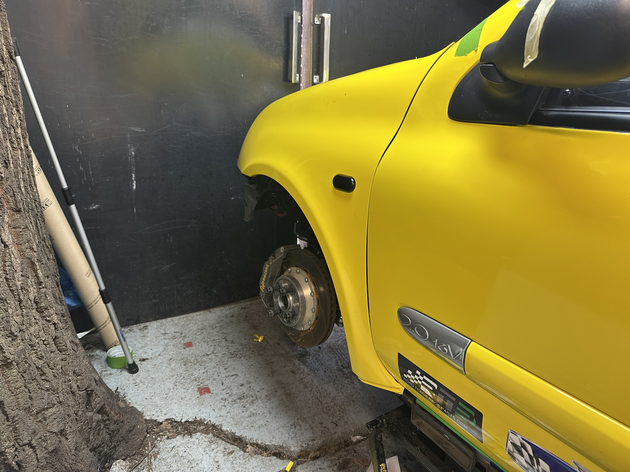

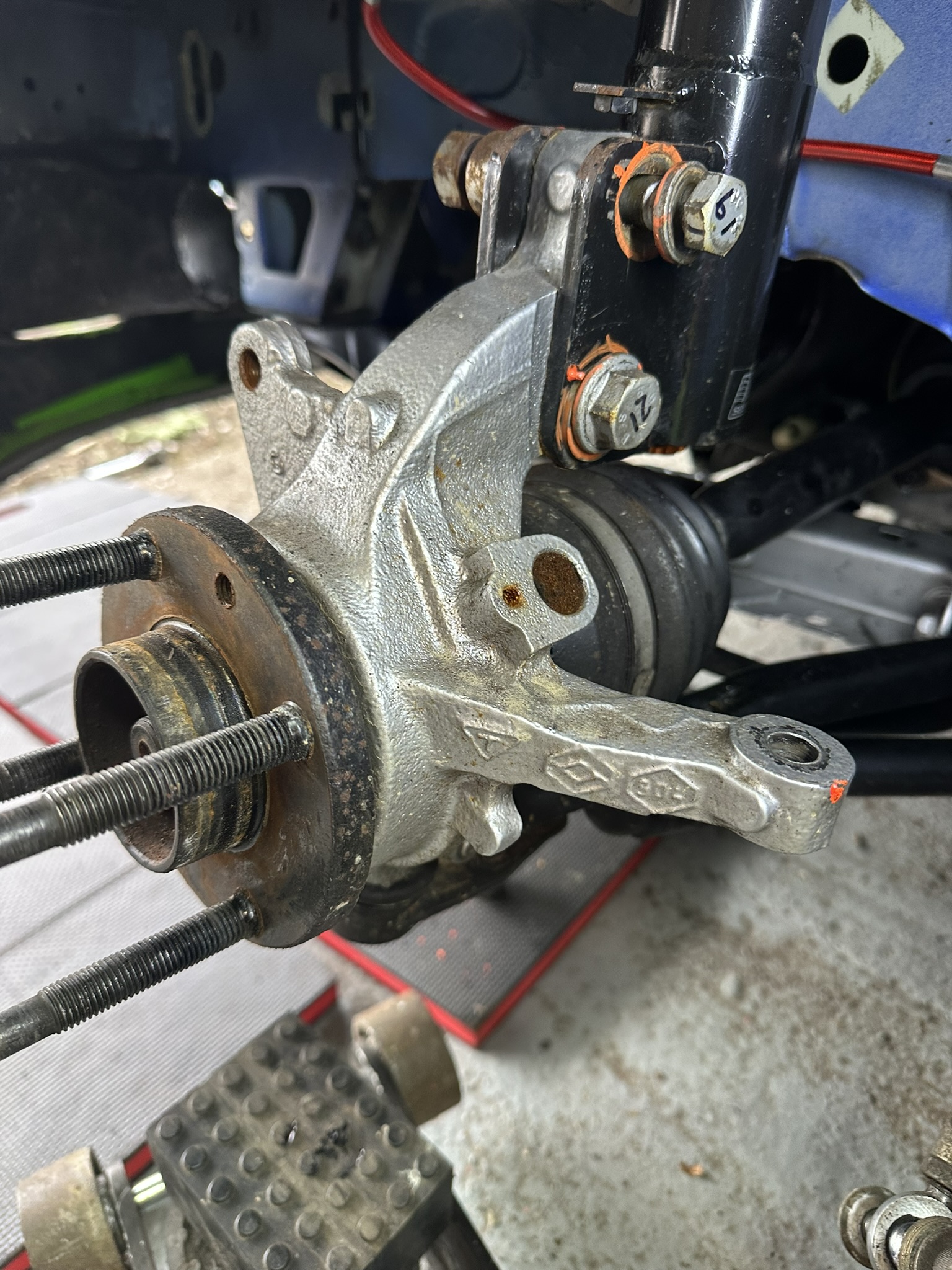

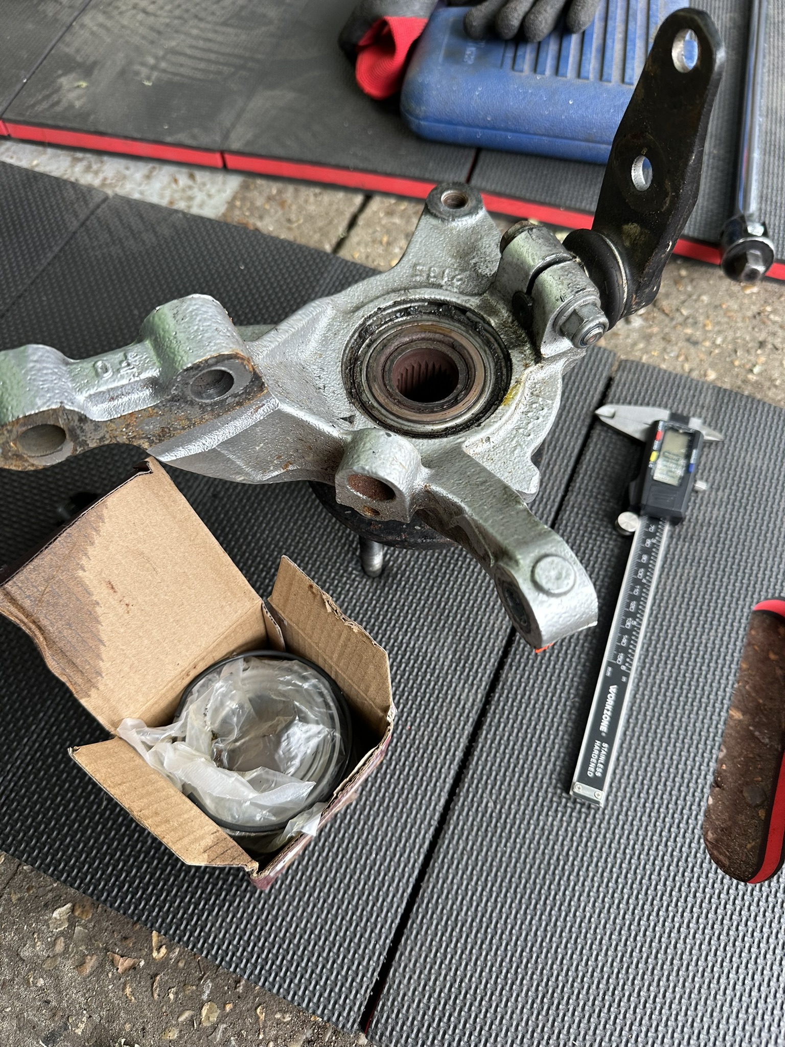

More importantly though is the failing wheel bearing I discovered while refitting the wheels. Not in the plan but thank god I didn't leave this wrok until next Friday!
Hub was stripped out easily. (Only 7 bolts) and my mate will collect it on Monday to press in a new bearing which i had on the shelf fortunately. I've ordered 2 new ones from Nick at PMS as well. just in case the other one fails soon.
Should have the hub back Tuesday eve so I'll jump back on the car mid week and hopefully have everything done in plenty of time.

After finding the filter blocked at Snetterton a couple of months ago and not checking it at Brands last week I was expecting it to be clogged again. So after the tedious process of pumping the fuel out of the tank I stripped the filter once again only to find it was clean as a whistle. Good news!
However, once I extracted the lift pump from the tank I found the sock filter there had collected a fair amount of crud.
The main reason for going into the tank though was to adjust the baffles which were, once again preventing the float on the sender from moving. I need to find a permanent solution for this but as its not a race ending issue, for the moment I repacked the baffles and reassembled everything.
Other items were, a new plug for the transponder which was not working during the first race at Donington and a check of the camera wiring as the front camera appeared to be only running from the battery at brands last week. Not sure why but after a wiggle of wiring it all seemed to be working last night. Something to keep an eye on.
Finally, after having no luck getting the AM GPS unit to work at Brands last week I contacted AIM a couple of days ago and they suggested just sending it back to them to inspect and repair. From the symptoms I described they seem to agree that it's not right. So, i won't have it back for the race but it's only a "nice to have", not essential.

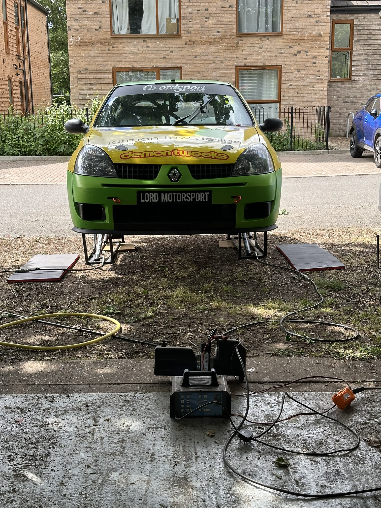

So, other than a check of the camber after reinstalling the hub and then torquing everything up I think we're ready!

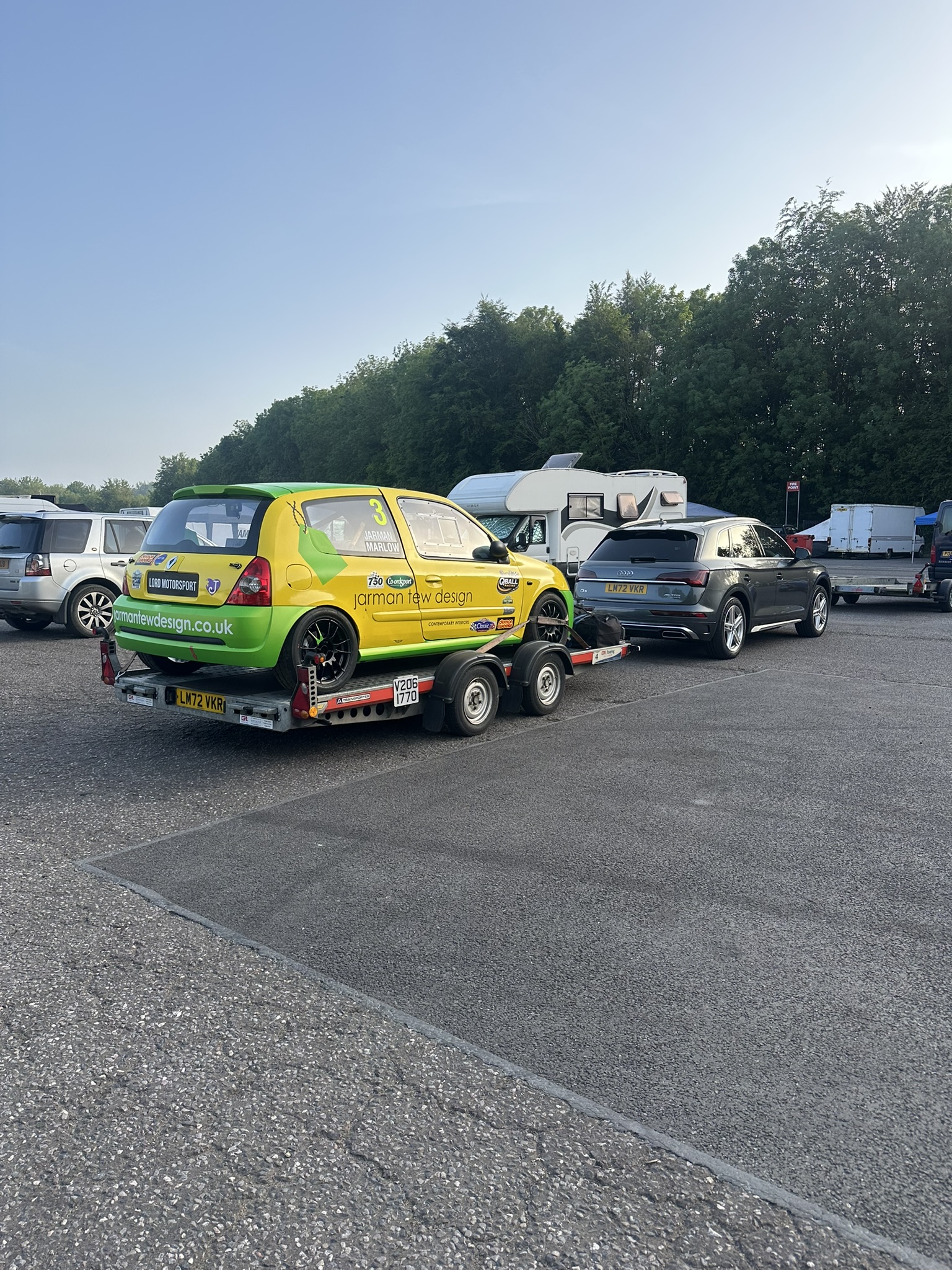

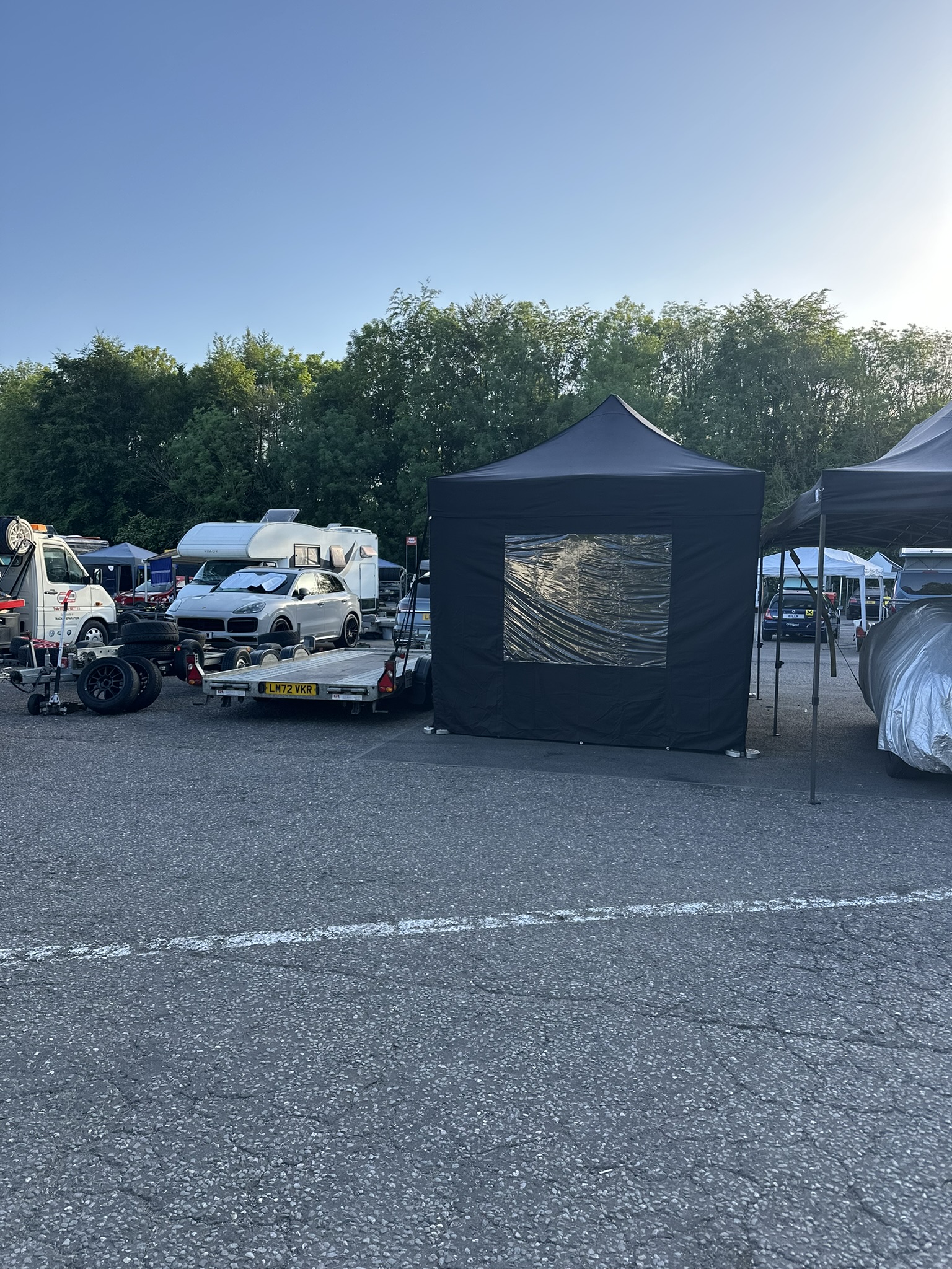

Sunday morning I was in the paddock at 6:20 with a decent space for the car, trailer and gazebo and at that time in the morning not too hot to start setting up.
An hour later, once people started waking up I got set up in time for John to arrive with his mate to help! Thanks guys!

So qualifying crept up on us and before I knew it I was sitting in the assembly area in a cabin reaching 60 degrees and it didn't get much better once on track. Everything was hot.

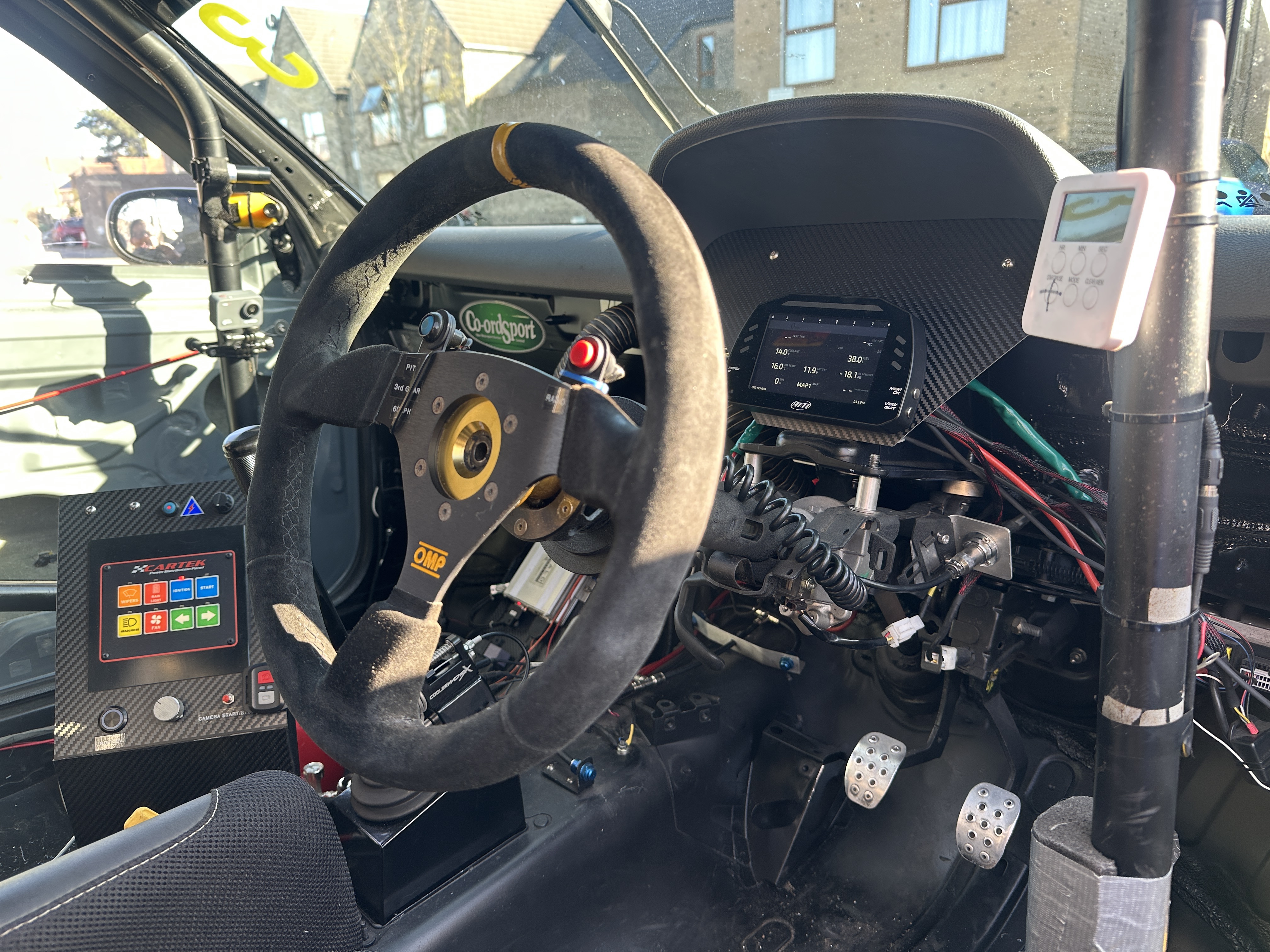

I very quickly discovered a major flaw in my dash calibration as the cooling fans cut in even once we were moving, which has never happened before. Great, you might think - just doing what they're supposed to do. Unfortunately I had set the dash to turn entirely red and flash a "Cooling Fan" message at me constantly. Useful in normal circumstances as it would normally point to a problem with the engine. The trouble is that with this message on the dash, everything else is obscured, including the actual engine temp. So I had no idea if the engine was about to go pop or not.
After about 5 laps I pitted for a tyre pressure check and a for a few seconds the fan stopped so I could see that things were hot but not dangerously so.
I continued out to carry on with the 25 minute stint running 2 hot laps followed by 2 cooling laps just to be safe.
The track was nice and sticky and I finished with a best time of 55.491 and 6th on the grid, P2 in class but just 0.087s behind 5th and P1 in class. James Wilson in his Pug 306. Pole was a 54.178 set by a DC2. With my race engine and an extra 30bhp I recon I would have been up there easily but there you go. (I could equally have blown the engine and not raced at all which has happened far too often too)

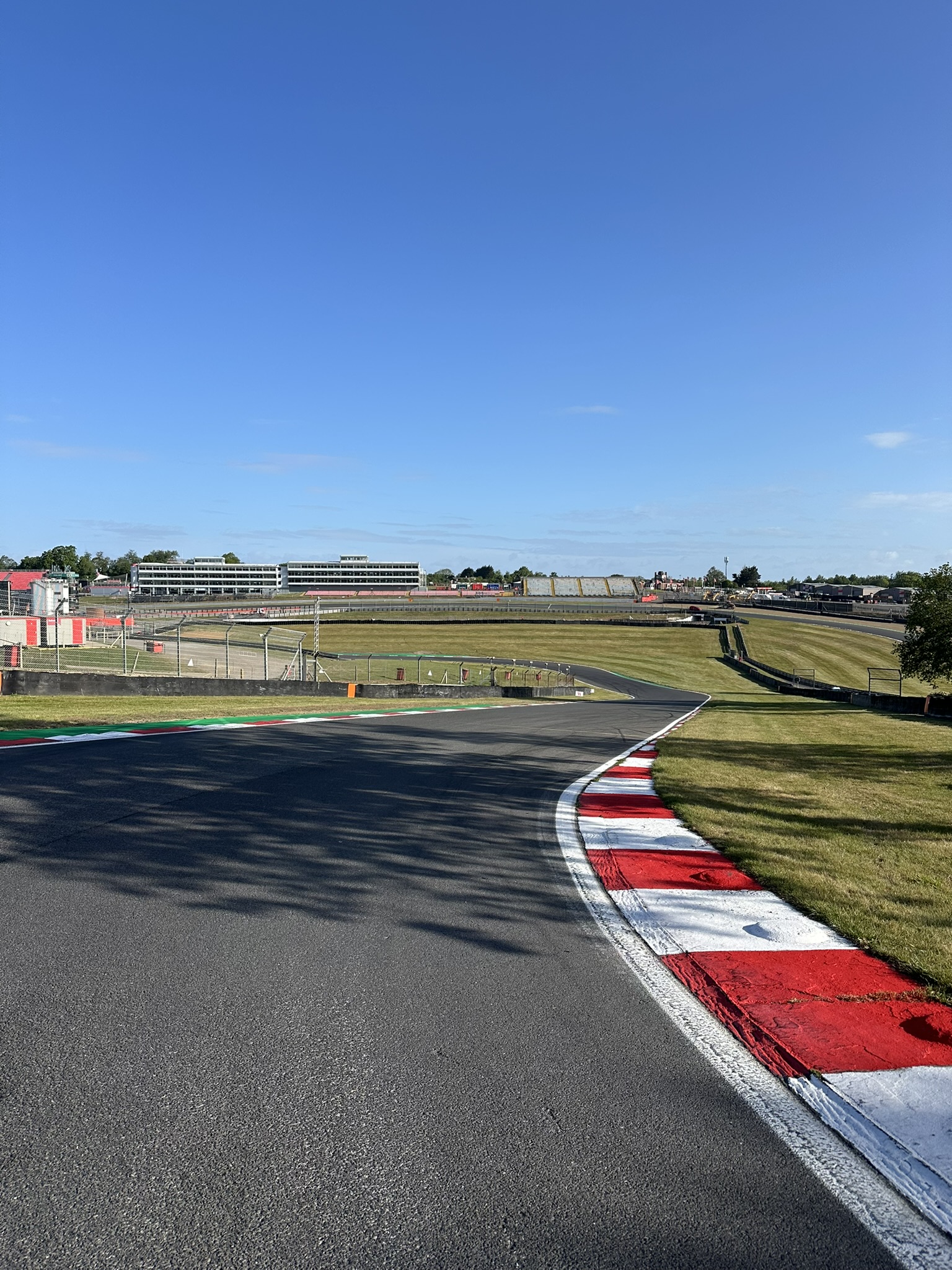

Race day came all too quickly and again by 6:30 I was back on the paddock. Too early to make noise so time for a track walk.
I've walked plenty of times around Brands and you cannot underestimate the value of walking a track. You see small details that you subconsciously lock away and somehow your brain utilises that information the next time you are behind the wheel. It sounds unlikely but its amazing how much more accurate you can become.

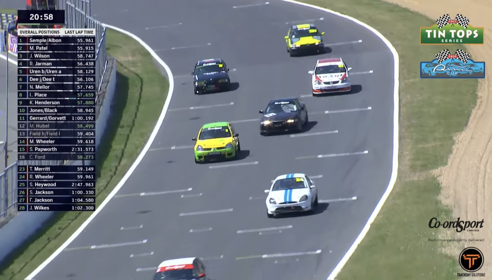

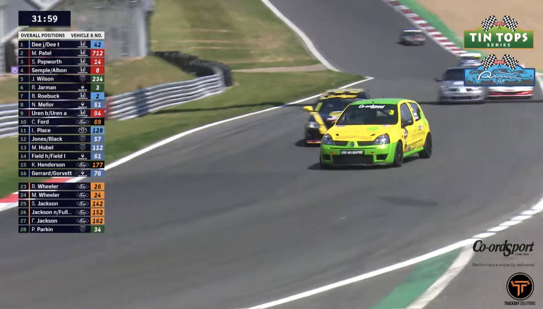

Eventually we headed out straight into a green flag lap and a rolling start. It was hot already!
Obviously the start is the most nerve wracking part of any race. So much can go wrong but also things can go really right sometimes too. The main goal is always to get through the first corner and at Brands that's Padock Hill Bend, a notorious corner at the best of times. I was on the outside of the track making me vulnerable to be pushed out into the gravel but it can also be a chance to get around the outside as most people squeeze up towards the apex.
The start went well though, with no dramas for anyone. Wilson who was right beside me at the start missed a gear and dropped back but the Civic behind me used his superior power to come past me through the centre and squeeze ahead once we were out of Druids at the top of the hill.
Coming out of Surtees, further around the track, Alfie Jones in another Civic running in 2nd pulled on to the infield as his engine let go which brought out the safety car just a lap later.

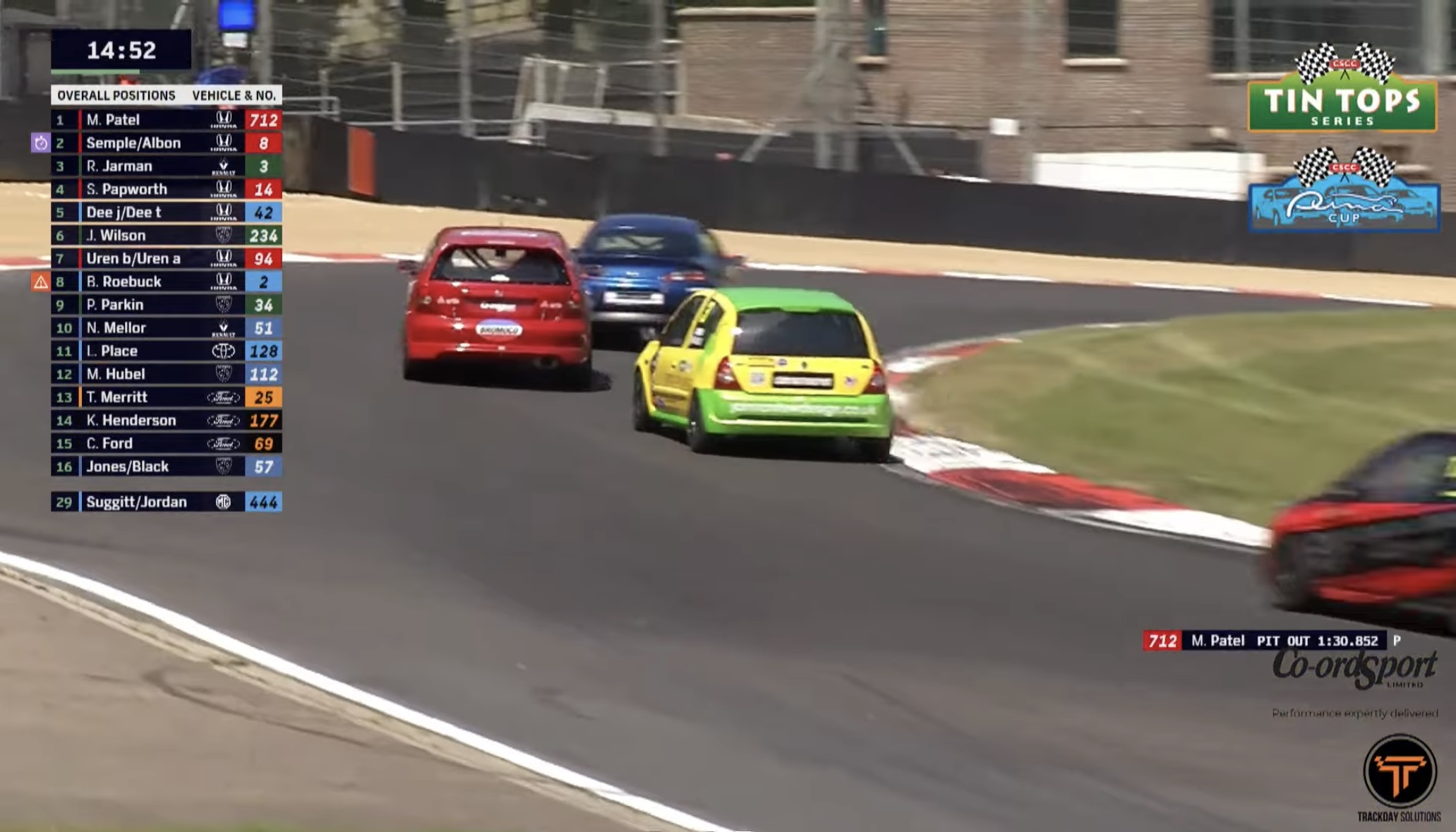

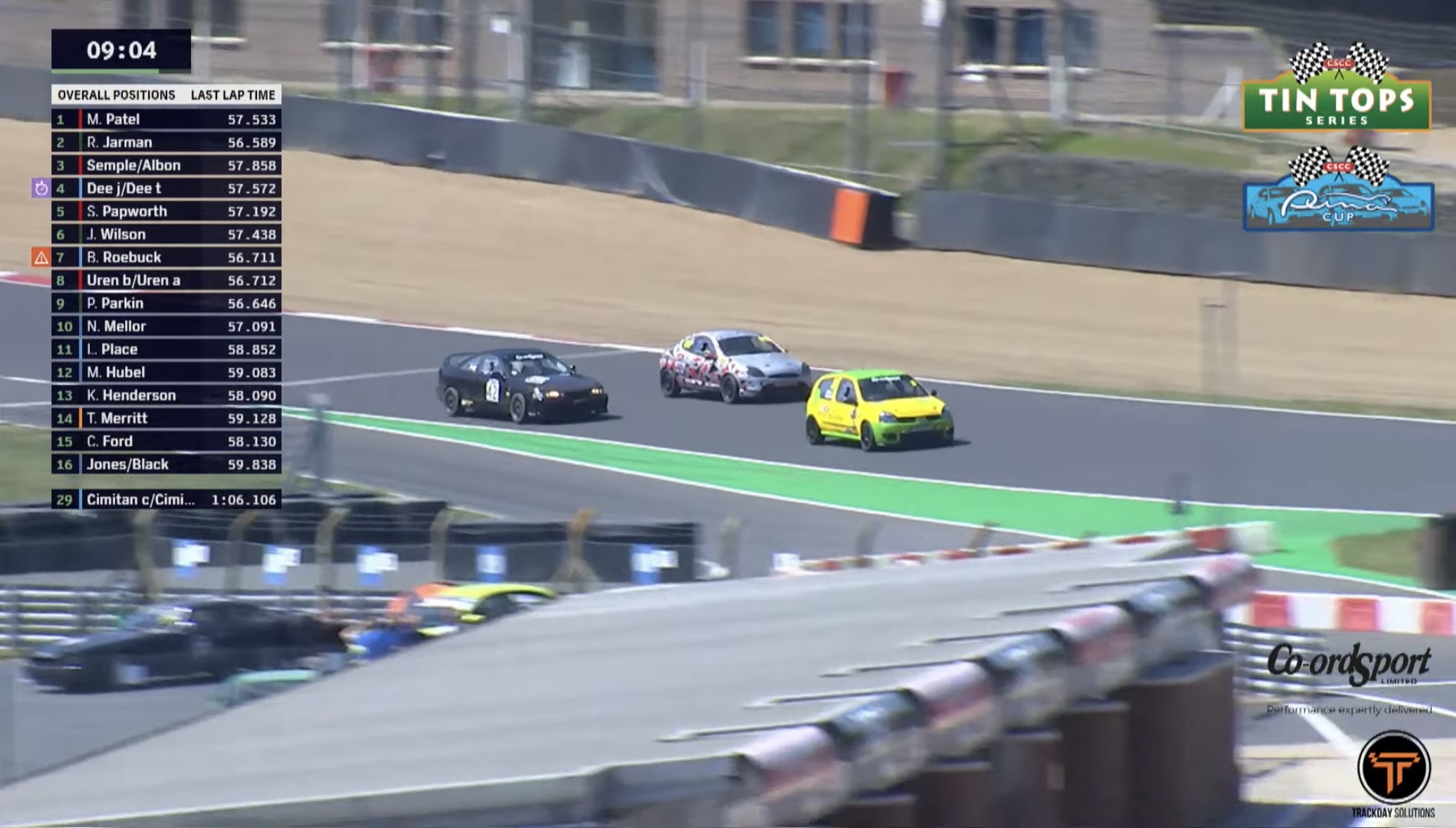

Once that pulled in the race continued and I ricocheted up and down the top 6 having various battles along the way, especially once we started meeting the backmarkers.
With just my stock engine I was seriously lacking straight line speed but i was making up for it in the corners and under braking which is one of the reasons there was lots of passing going on. It was great fun.

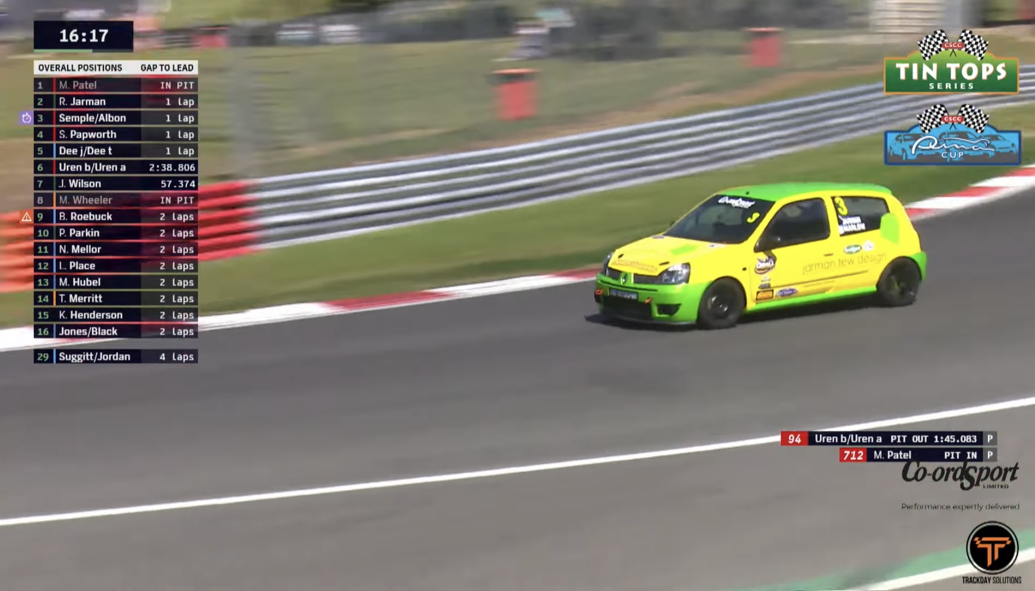

After most of the pit stops had been done, including ours I soon found myself in P2 overall. Although P1 (another civic) was a long way ahead and lapping quicker and I knew John and Tom Dee in their DC2 (the pole sitters) were catching me fast after they dropped back due to a trip throught the gravel earlier it was looking like a P3 might be on the cards.
I didn't know it at the time but our pit stop had been short. With a minimum pit time (entry to exit) of 1:30 it's critical to try and time it right so that you are released and heading down towards the exit, ideally so that the clock clicks over 1:30 just before you exit. It can be tricky and this time our stop was a 1:29! which meant we were hit with a 30 second penalty.
However, with about 7 minutes to go I started to have another problem. The car started to stutter...
It was clearly a fuel issue and as it started to get worse each lap it was clear I was running out of fuel!
Our radio wasn't working properly either so I didn't know how much time as left and all I was getting from the pit board was my position.
2 cars passed me and then another and then in the distance, in the mirror I could see James Wilson in his 306 slowly catching me. Finally as I came onto the start-finish straight, he was on me. In front of me the chequered flag was waving but he just pipped me on the line! Oh well, I thought. P2 in class - not too bad. And then I heard about the penalty.

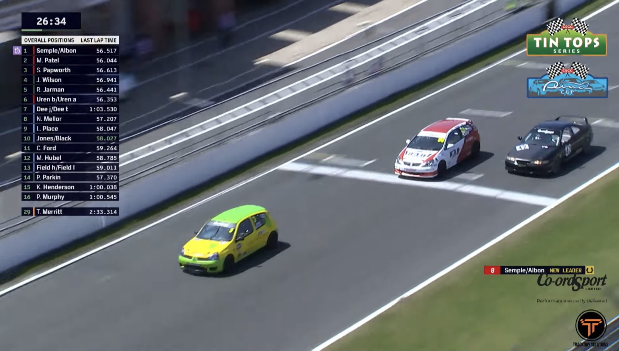

So, a P10 finish overall and P3 in class but a hell of a fun race and the car came back in one piece.
There was a live feed on YouTube of the race. The link below and the race starts at 1hr 27 minutes. There's a good amount of coverage of me, especially when I'm running in P2 and the commentators realise I'm about to get a penalty.
https://www.youtube.com/live/Bx3Hszql7_w?si=Mfypj3udLze3S1D7
