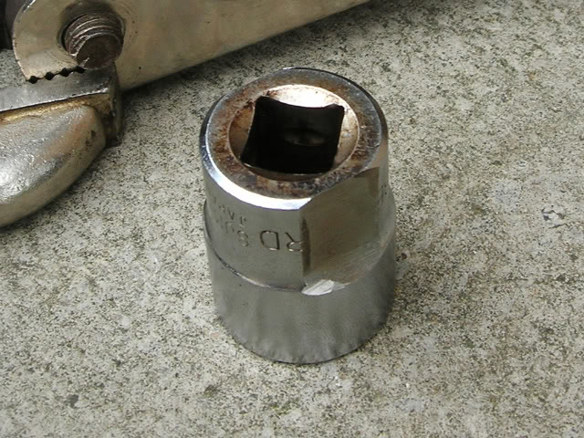

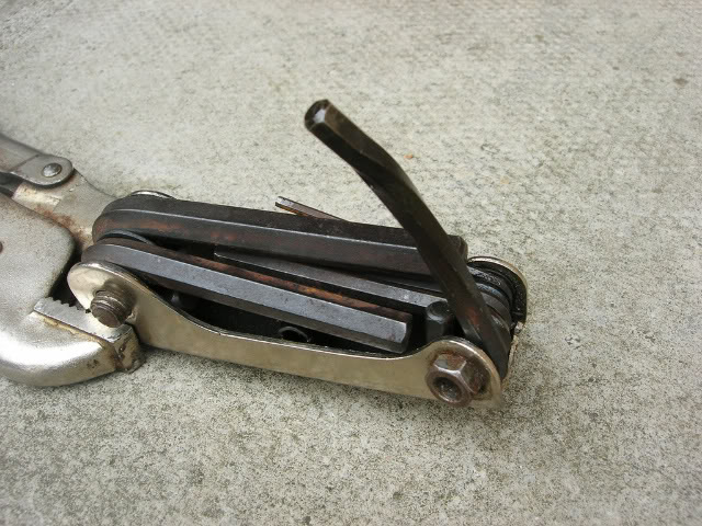

My solution. Bl0ody great adjustable on the flats i ground onto the socket and allen driver through the middle:
Edit; it was quite tight!
lol i had to make one of them sockets for my mk1 clio 19mm spanner on that , and then a 6mm allen key on a ratchet through the middle worked a treat lol . gets borrowed quite a bit too seems like a handy tool .
