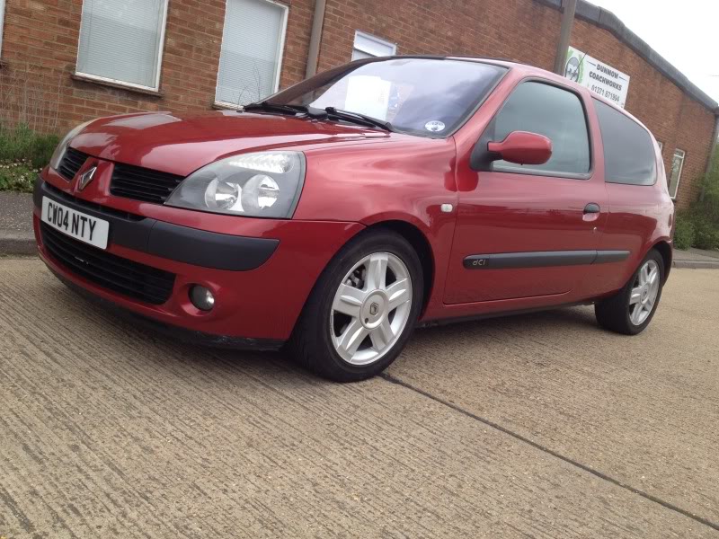

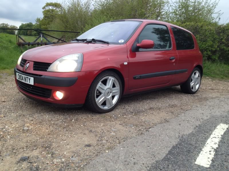

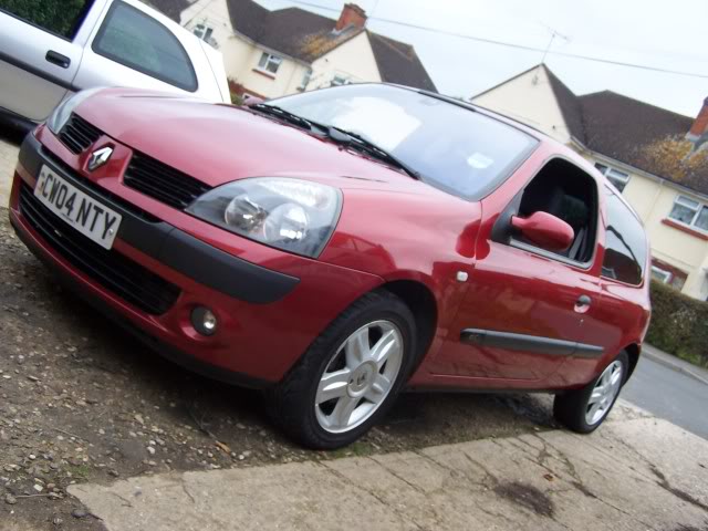

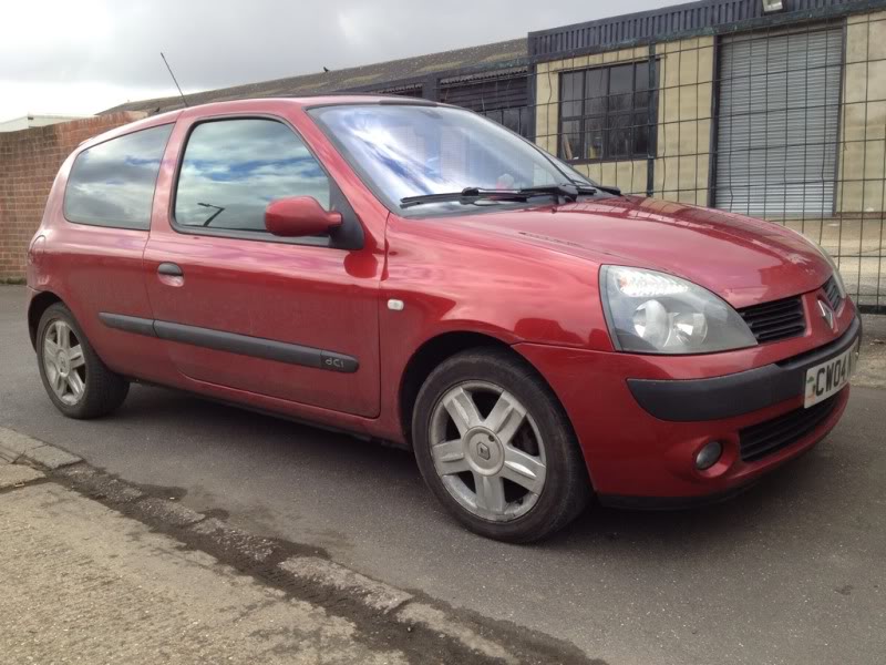

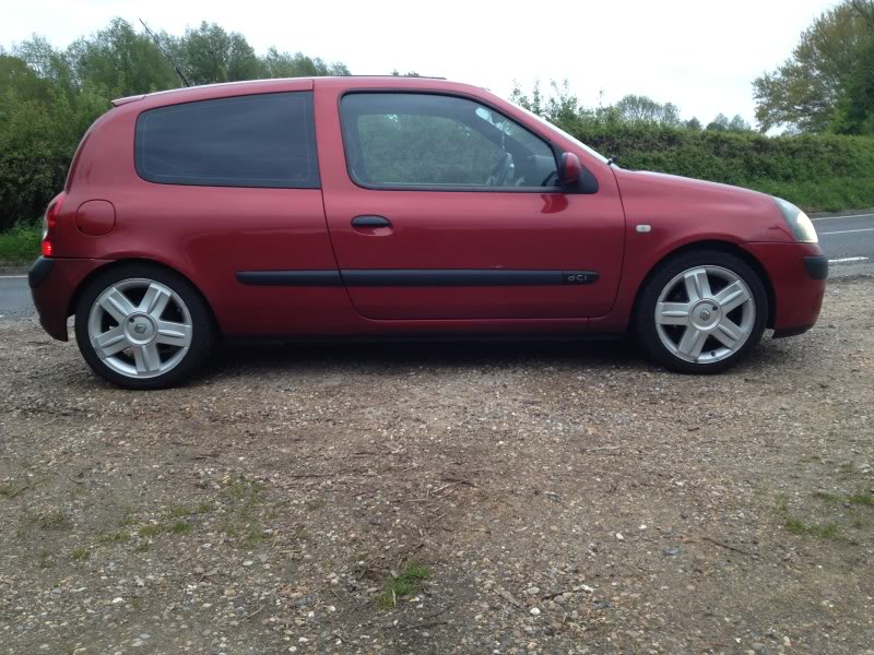

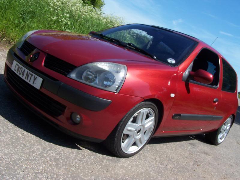

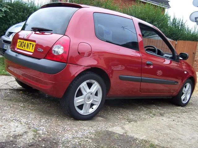

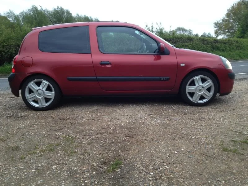

Bought this in 2011, Paid £1300, Was okay money for a Okay car, bit tatty but otherwise good, 142k miles.
Looked like this, including welsh flags on number plates (Spent its 7 years in Wrexham)

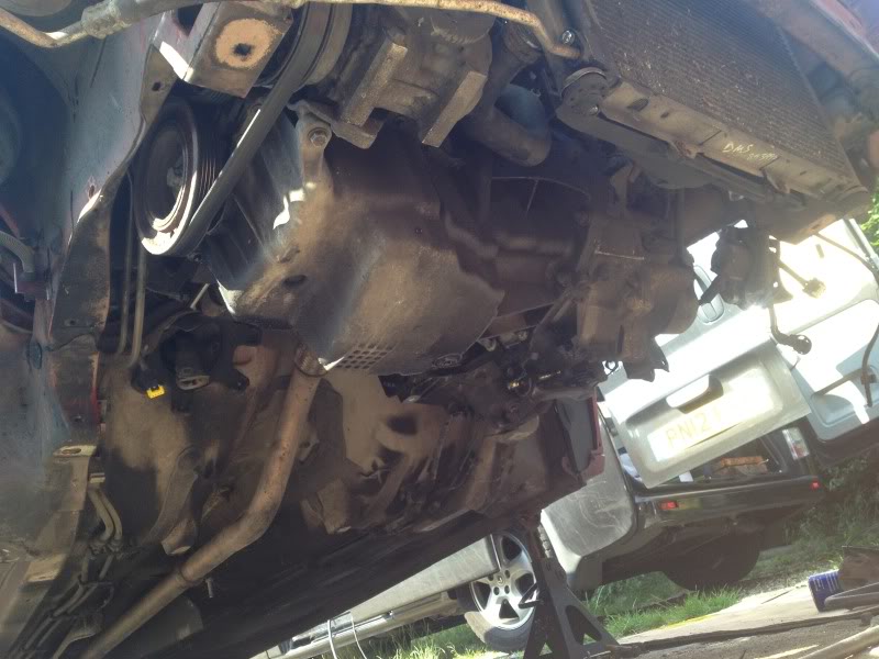

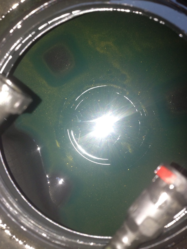

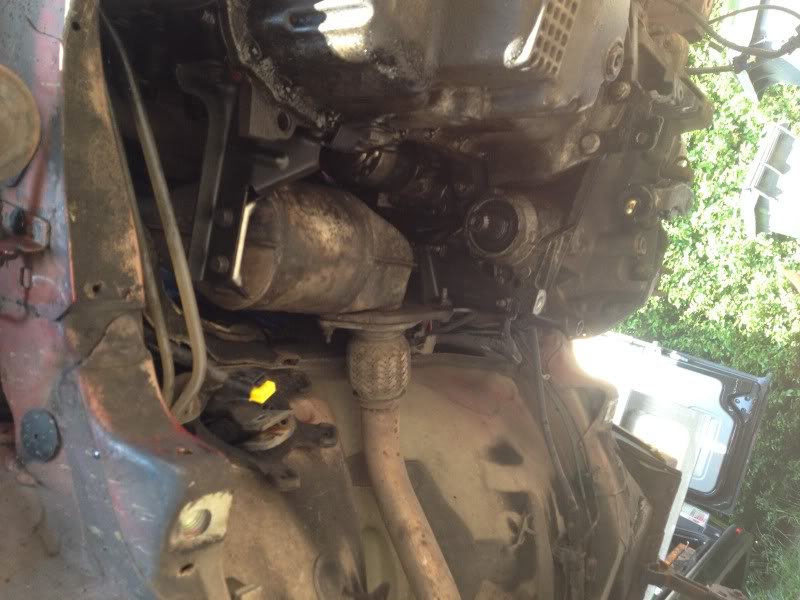

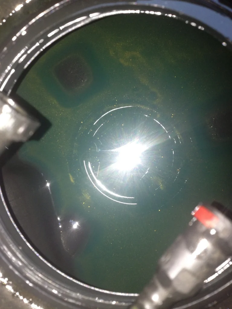

Two weeks, and one thousand miles later, It left me at the side of the road, due to the below
Common fuel pump failure, With other cars and projects, I let this sit until Jan 2013 when I decided it was time to repair it, Replaced fuel tank, fuel lines, rail, injectors and pump, total cost roughly £1000.

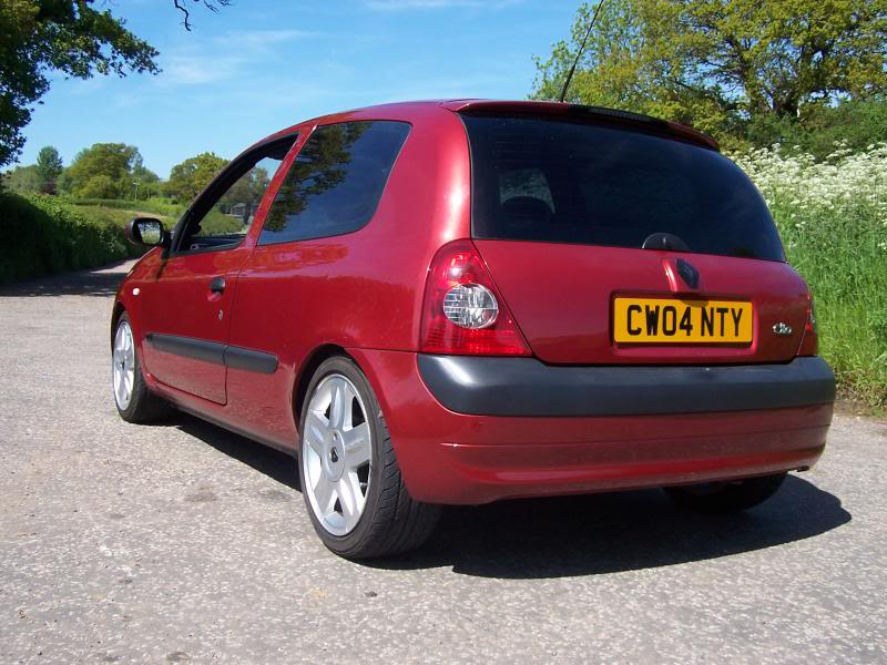

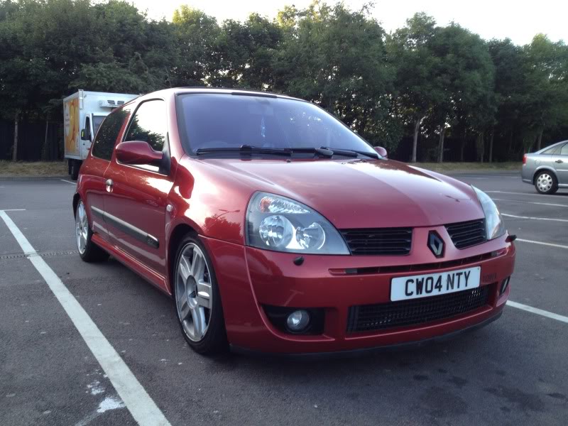

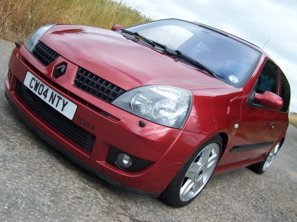

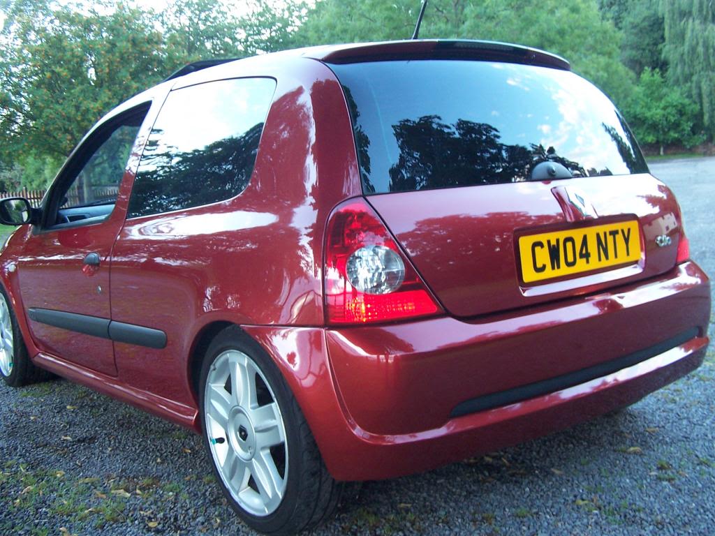

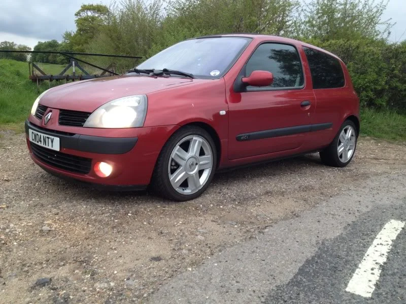

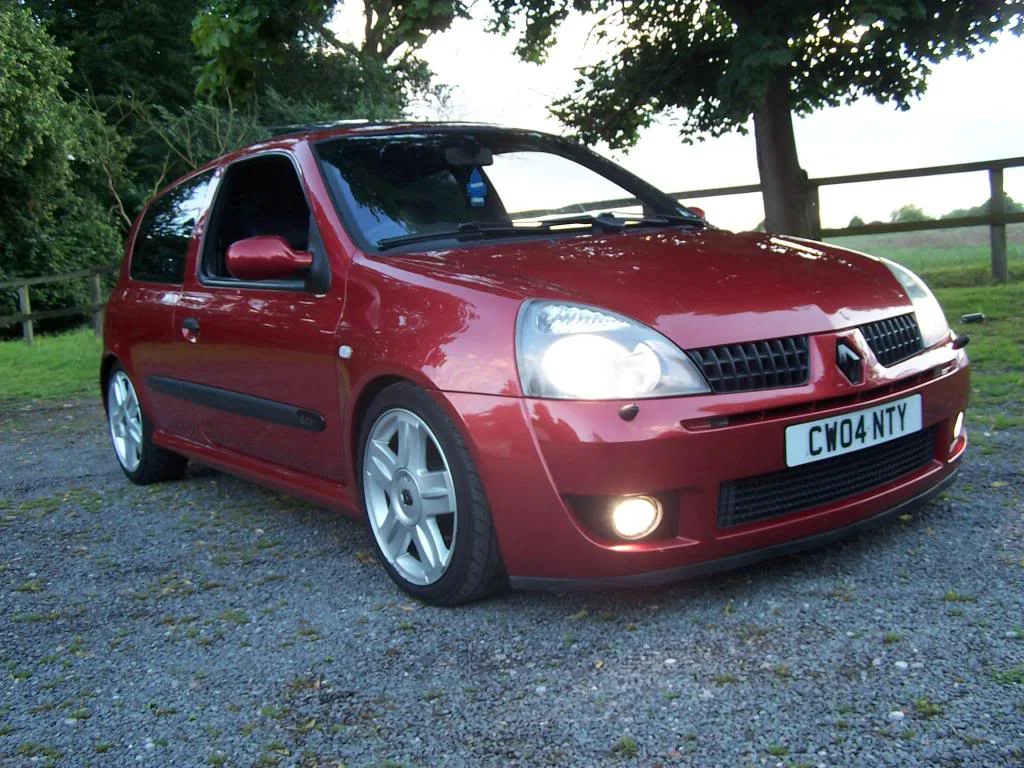

Then once I was happy with its relability, The mods came. First up I got a 3/4 height plate, silvertec bulbs and most importantly, lowered it (On s**t springs!)
Followed by 172 alloys...
Bought decent springs, so slight change in height...
Took a road trip (one of many in this car!) to collect this lot...

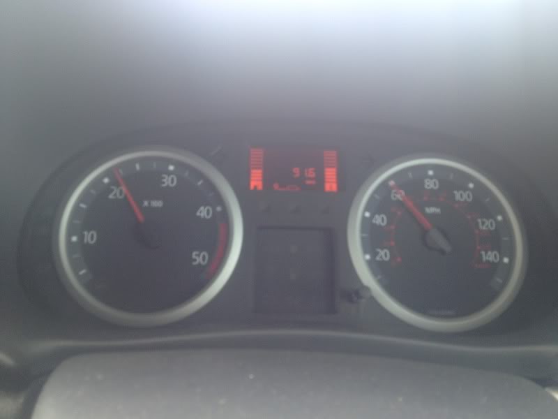

On the way down, the MPG I averaged... When I got home it was displaying 87.7mpg.
Fitted it all, Yes, I need grills, wide track, arch liners, rear bumper and side trims, but its a start.
That about brings it up to date.

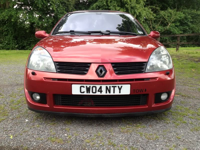

Picked up wide track conversion stuff, Just need polybushes, Braided lines, Caliper rebuild kit and lots of paint and elbow grease.
May notice above, I now have a lower grill :D, Just need an upper, eventually!
Its getting there, long long list still to go.

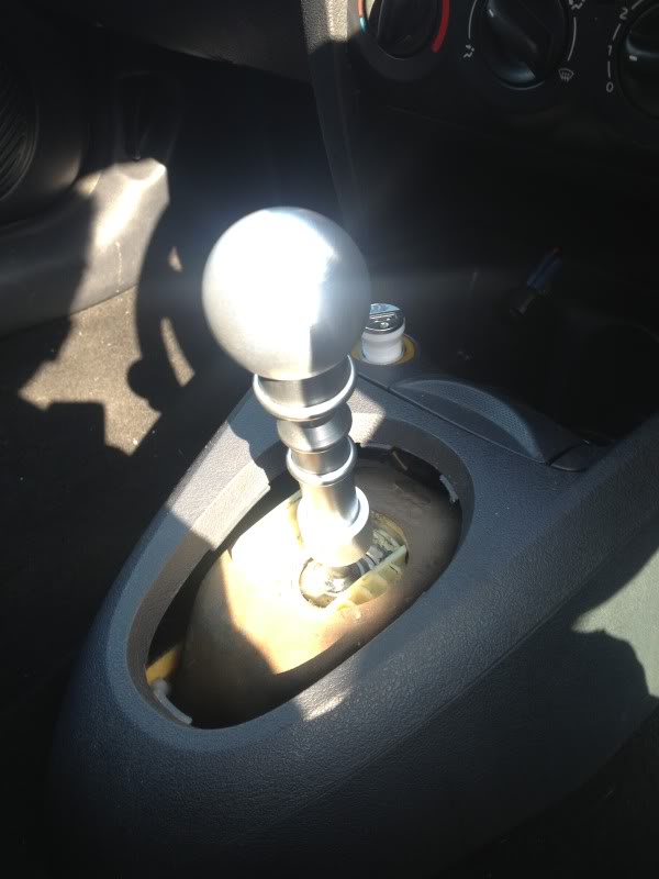

​Short shift turned up yesterday, fitted last night.
I freaking love it, bit of a PITA to fit though.

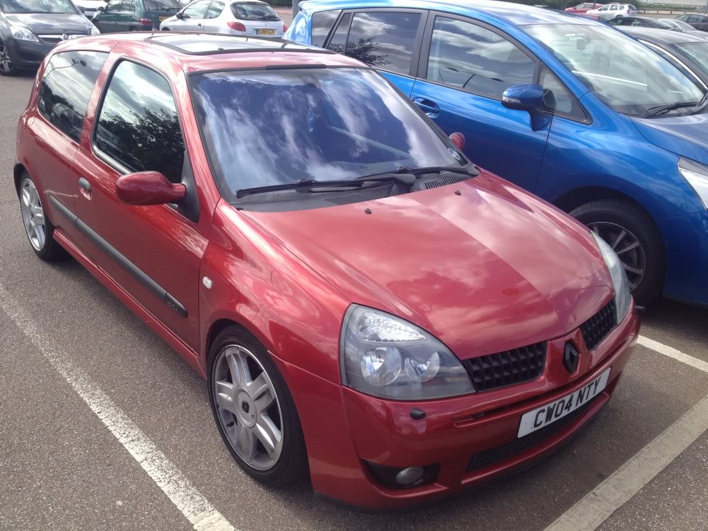

Wasn't going to bother posting this, but cleaned it this morning.

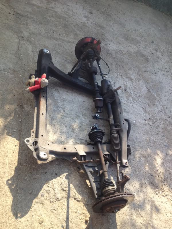

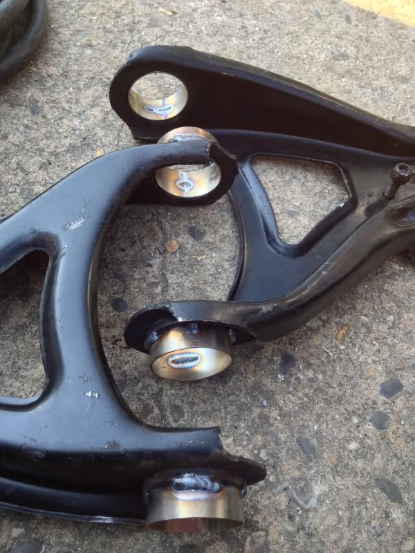

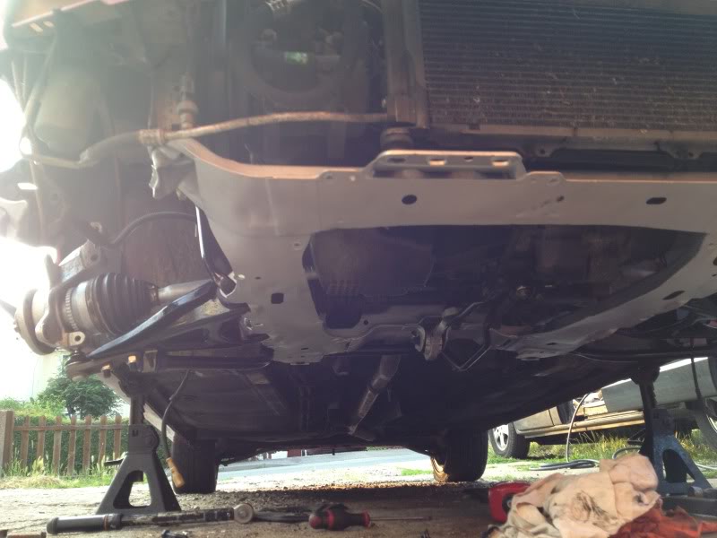

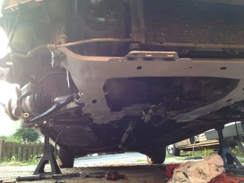

Yesterday my polybush kit turned up
Welded in the sleeves (filled insides after)

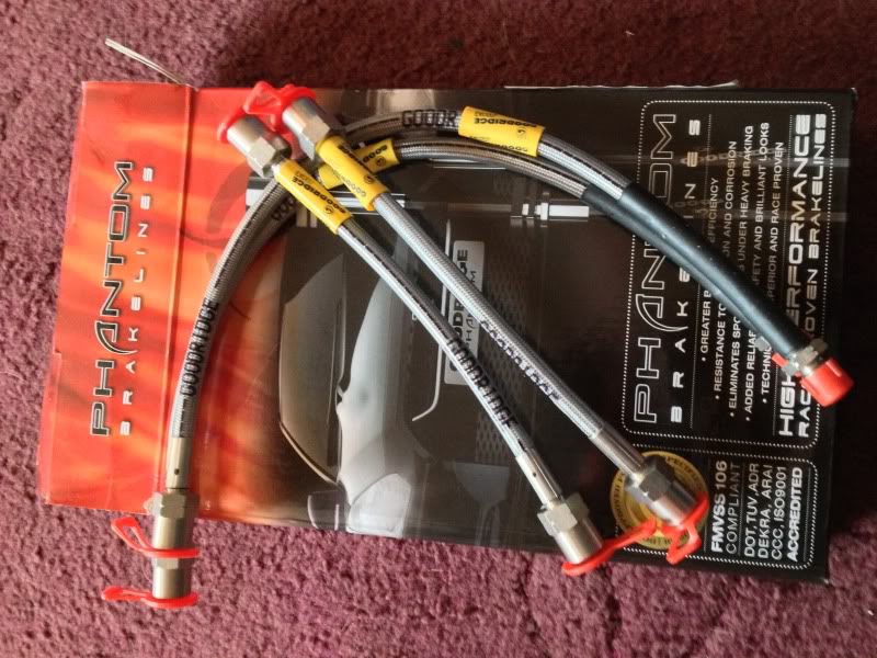

Braided lines also came, Went for these due to the stainless ends.

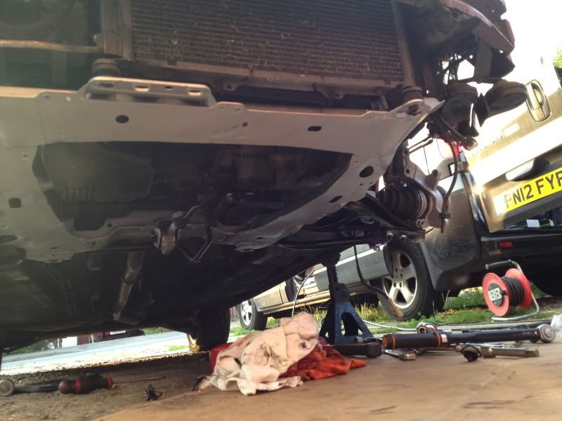

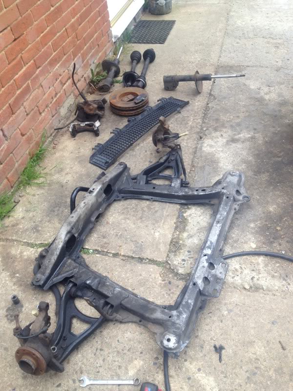

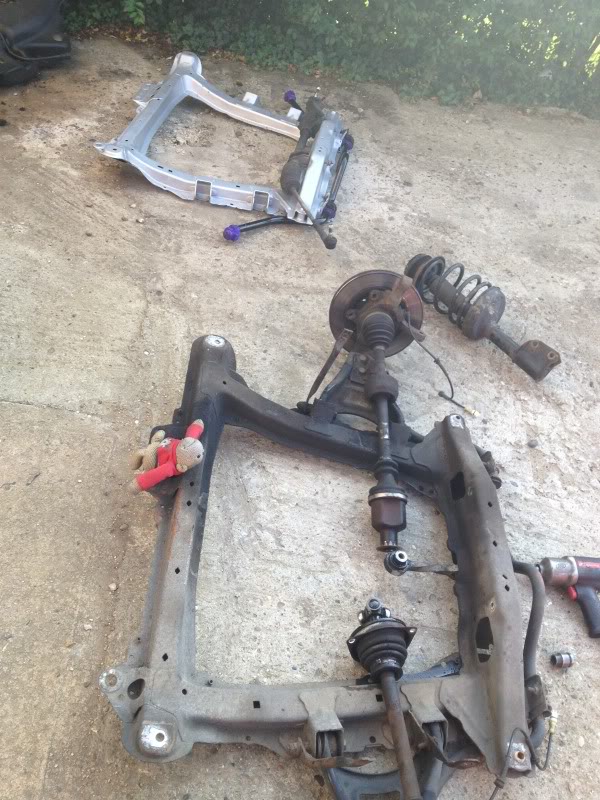

Planned to get the old front end setup off tonight, and refit the new one tomorow, insted I got carried away, and nearly finished it tonight.

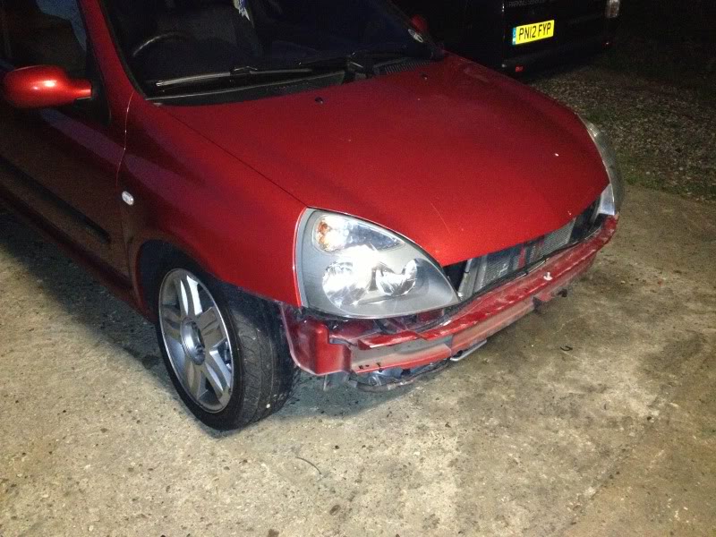

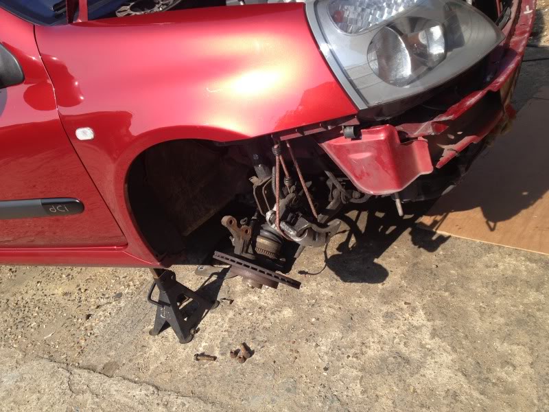

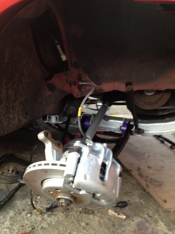

So, started by getting front bumper off, bit more room plus protects it.
Then wheels off, calipers dismounted, shocks unbolted and shafts popped out the gearbox.

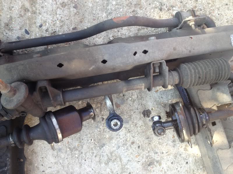

As if by magic, the subframe was off. This was a complete tard, out of the 4 main bolts holding it to the body, three, the peices of tin holding the nut in the chassis broke, meaning I had to f**k about getting a socket & spanner in there.
At this point, I noticed I'm glad I didn't order the steering rack bushes from Renault... There isn't any!
New meets old, swapping rack.
New one going on, lower arm on, hub, driveshaft, motoring along.
Brakes on, Braided lines on. Braked bleed up super easy.
I then got the shocks on, realised the ABS sensors won't plug in, wheels back on, gearbox refilled, and lowered it down.
All I have left to do is do the tracking, as you may notice, serious amounts of toe out, bumper back on, test drive!
  Many.
Looks good mate, is the subframe easy to remove?
Cheers bud. Hmm, It wasn't as bad as I was expecting at all! I got the old one off within an hour, including a battle with the main subframe bolts, but now I've done it once, I reckon I could have it off again much quicker!

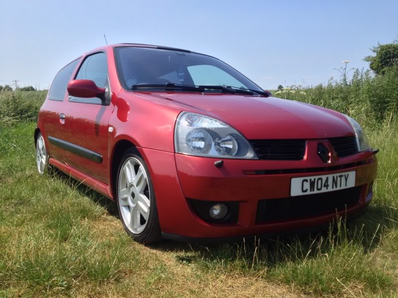

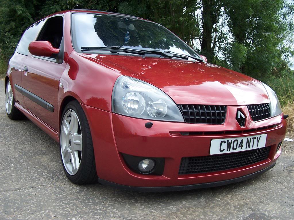

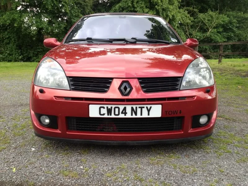

First up, got myself some 25mm front spacers and temporary front grill. Front wheels fit exactly how I want them.

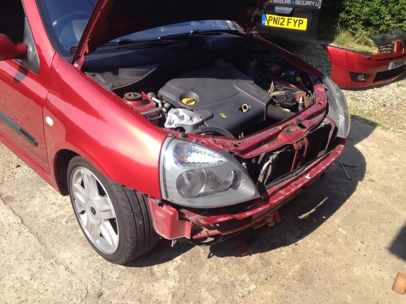

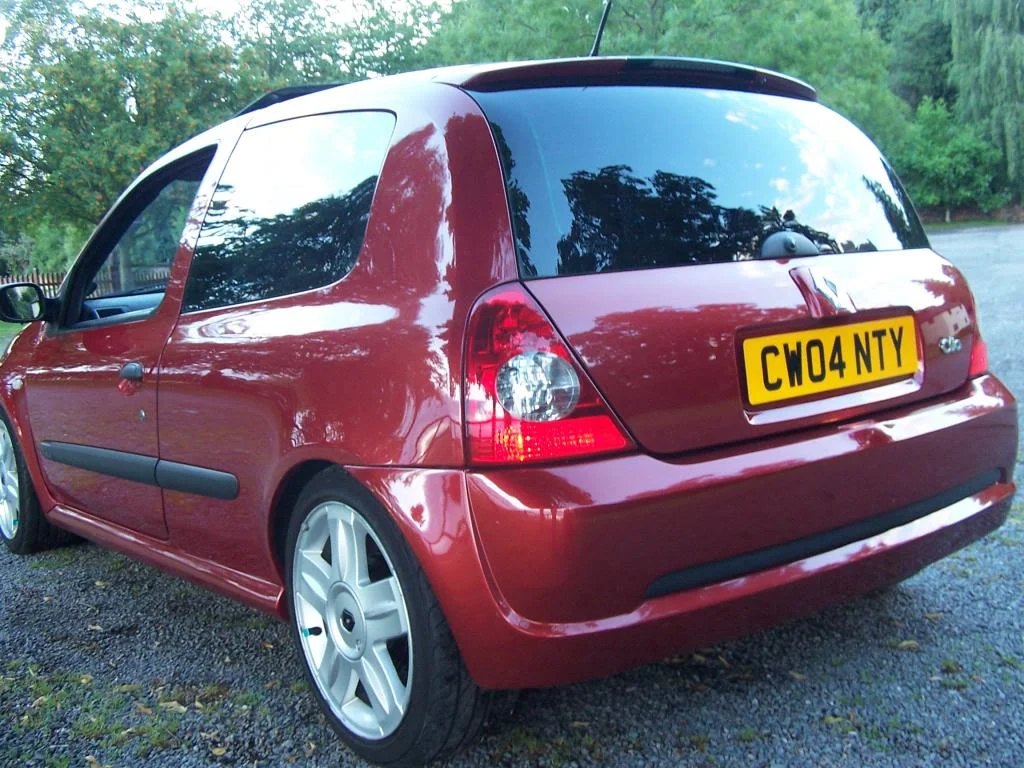

Secondly, picked up a flame red sport rear bumper.

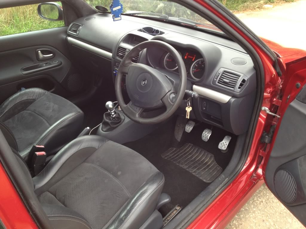

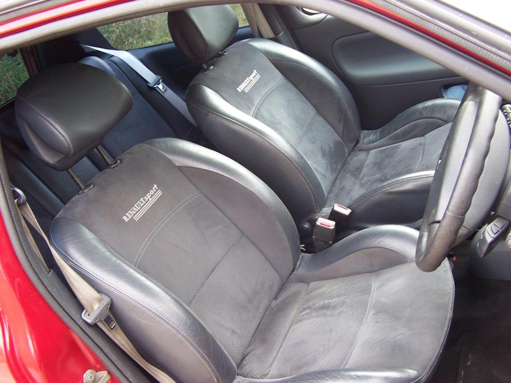

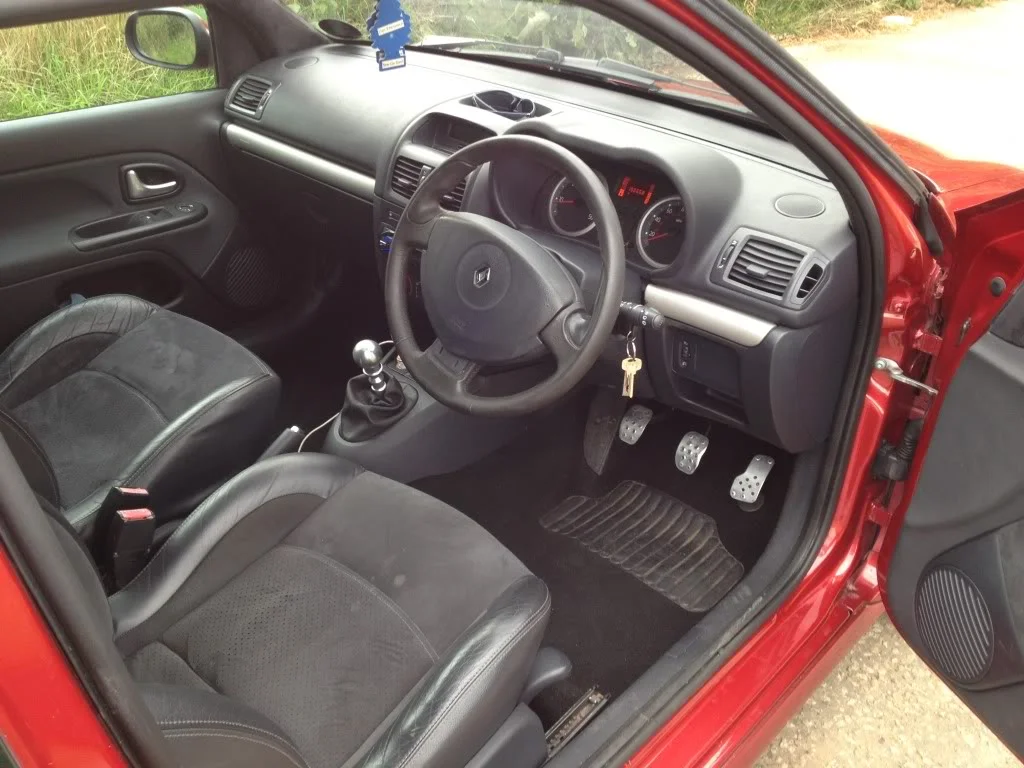

Finally, sport interior
Now the plans are to finish the sport rep-ness and then power.

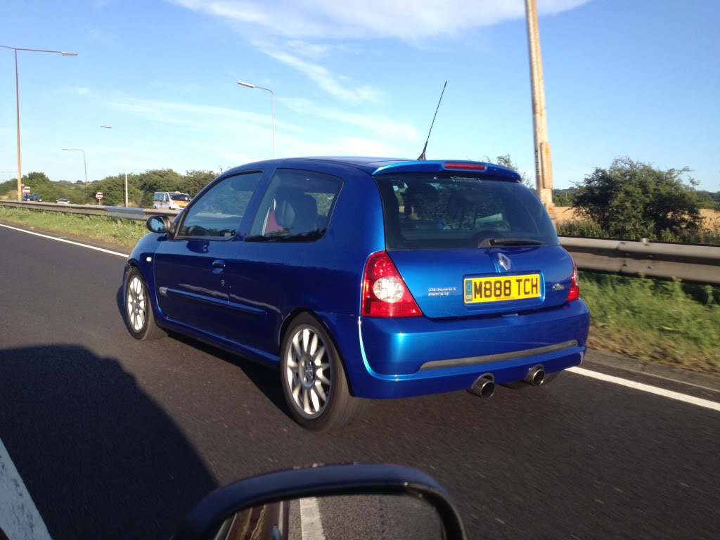

Saw this car today, looked brilliant as ever Alex!
Also thank you again for getting us out of the s**t with that circlip!! Commitment is an understatement when it came to fixing it :)
  Many.
Cheers dude :) And as always, not a problem.

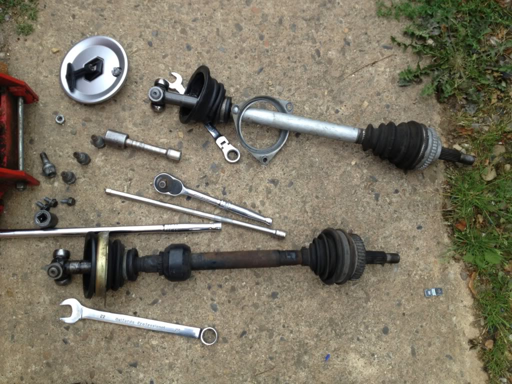

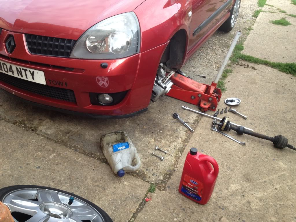

Then this morning, I was outside between 7am and 8am changing my N/S drive shaft due to a buggered outer CV.
Shiney silver one coming off, dirty one going on.

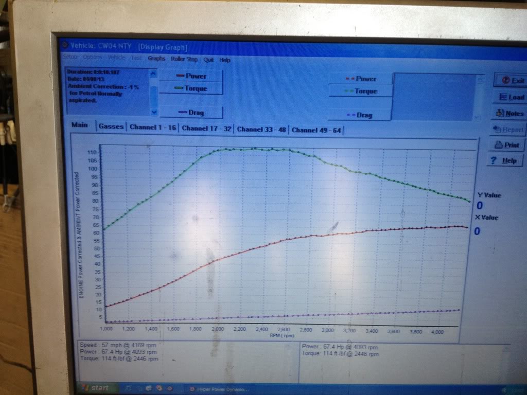

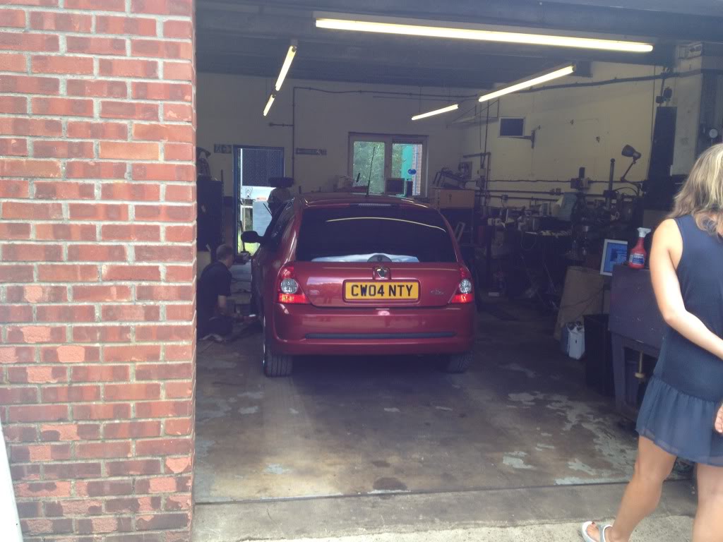

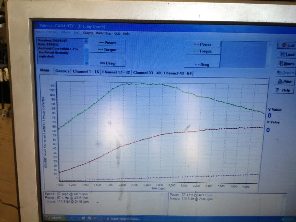

Then attended EA's Rolling Road day, Lots of awesome cars, mixed results, but a top notch day..
The DCi going on...
Screen grab I got
Everybody elses results:

I now, due to a trip to Dmallet's on saturday, have a sport steering wheel, sport pedals, skirt clips (mine are just glued on atm), rear beam to refurb, 10mm rear hub spacers, and finally a M/C and servo, as the M/C is slighty larger bore, and my servo is severaly rotten.

Shaft sorted it, lovely to be able to throw it about a bit and not have the juddering/noise of the outer CV munching itself!
Was a bit shocked with that power, I was expecting about 50bhp lol.

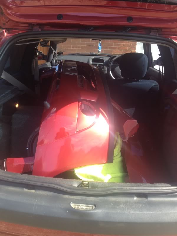

Hi do you have any of the old parts ie the bumper compete ?arch liner osf
  Many.
I do indeed, PM me if intersted.

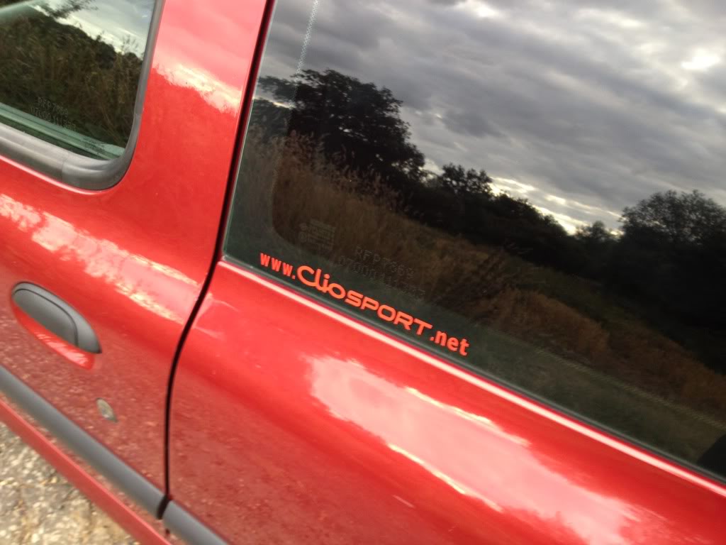

Finally got myself some Cliosport stickers
As recently mentioned, got myself a sport wheel, needs a refurb and the bottom trim, but its nicer to use in the mean time, plus sport pedals, feel a bit nicer to use.
Slowly getting there. Next update will most likely be refurbing the rear beam.
