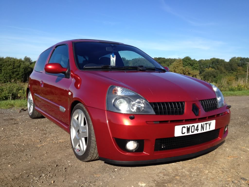

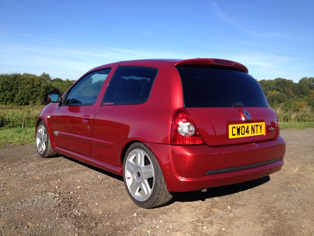

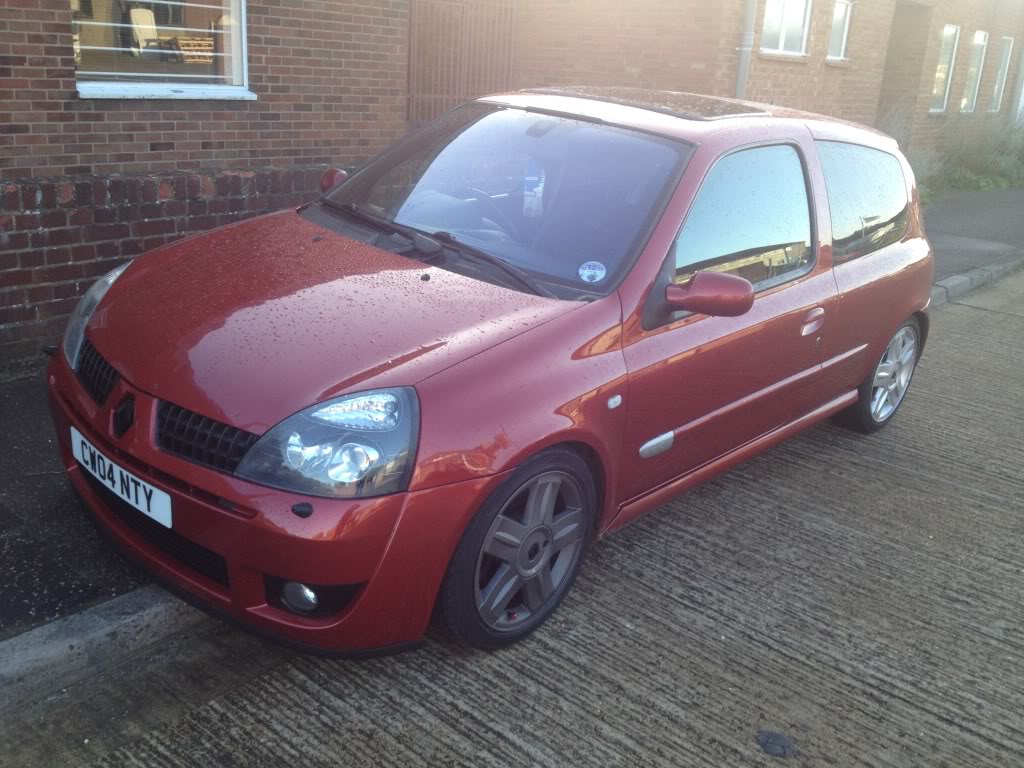

Flame Red DCi 172 Rep.
Great thread :)
Was interested what a stock non sport would look like on 172 alloys and this has answered my question!
Looks to be going well Alex! I admire your need to do it properly, hope it's all up and running in no time :)
I wanted climate more than it being a correct sport rep, look inside and you'll see incorrect dials that don't rev high enough!

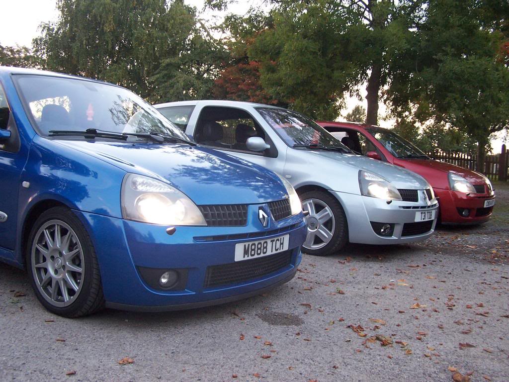

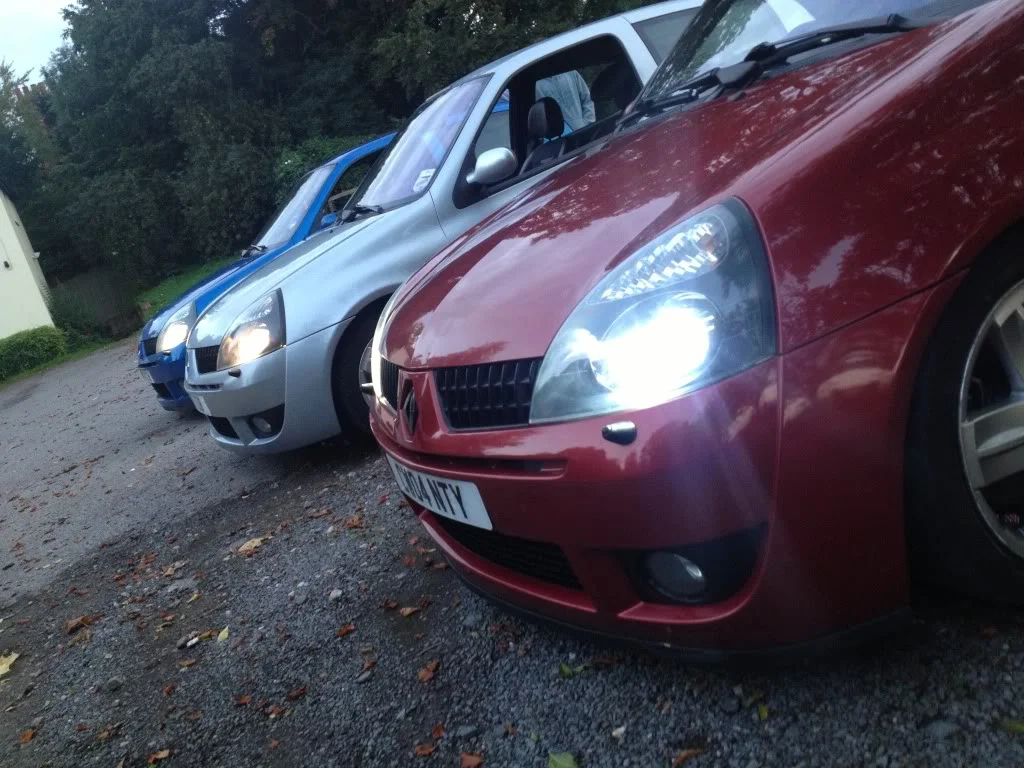

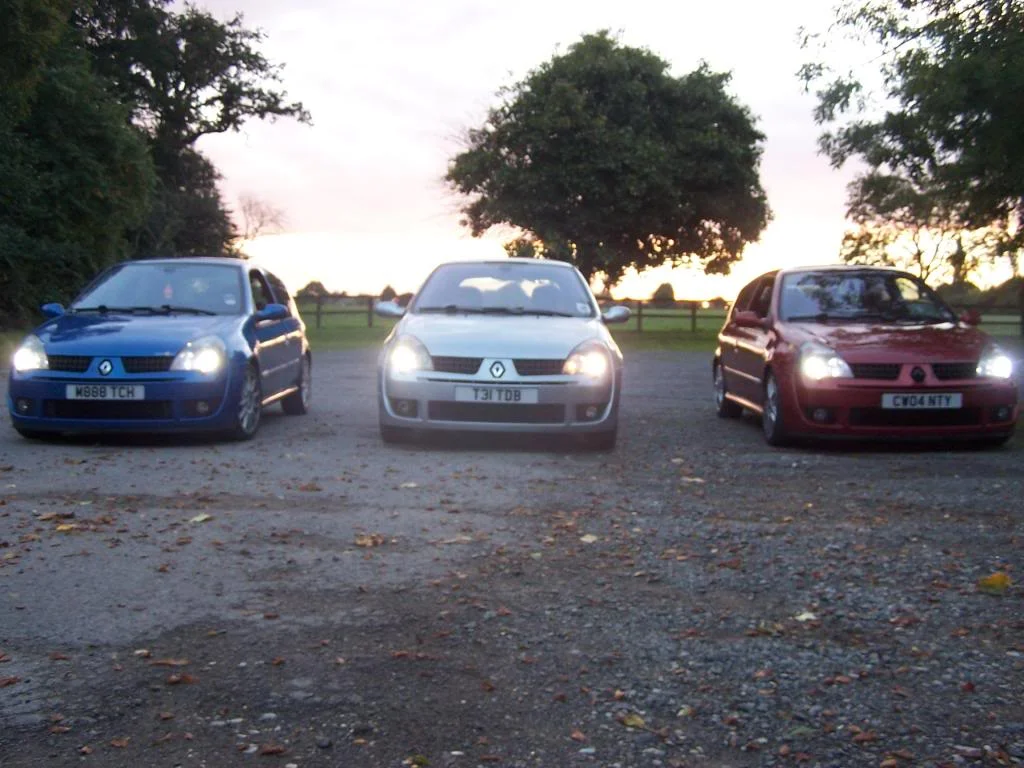

Quickly, Got a couple of pics with its Frwiends
Will have more to update soon
