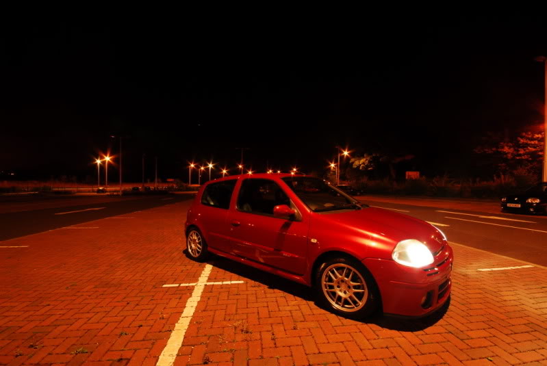

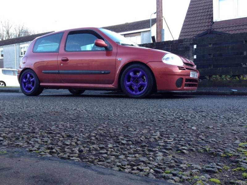

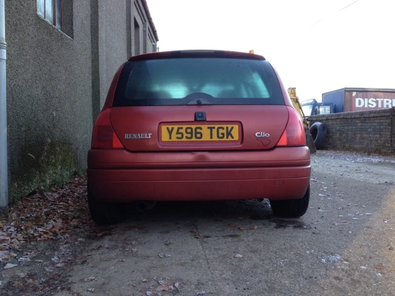

It's personal prefrence really mate, i like my ph1's non colourcoded (Bar the handles) and mostly original, its just the look i like. I would like to stress that this is very much a WIP, its no where near finished yet, i just like to keep a up to date record of how it's changing. .

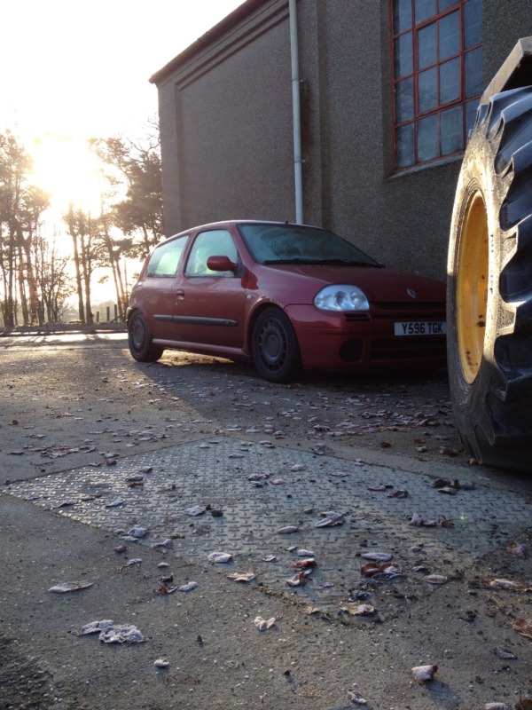

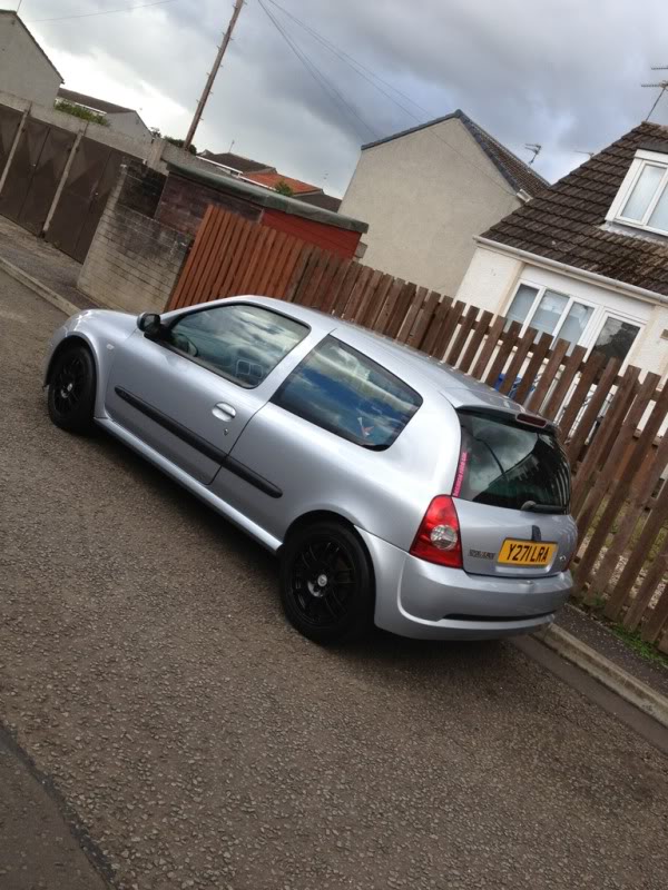

I've had one with colour coded side strips and i liked it but i didn't want this one looking like a clone of my last flamer Y534 which was more a OEM+ kinda car. I think that the dark strips go well with the dark wheels. I also run my partners car with ph2 bits, i just mix and match to what i like. (see pics)
What alloys have you got on the front here? Haven't seen any like them before, quite like them
The alloys on the front are Ph1 19 16v alloys.

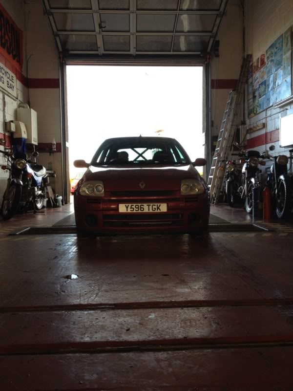

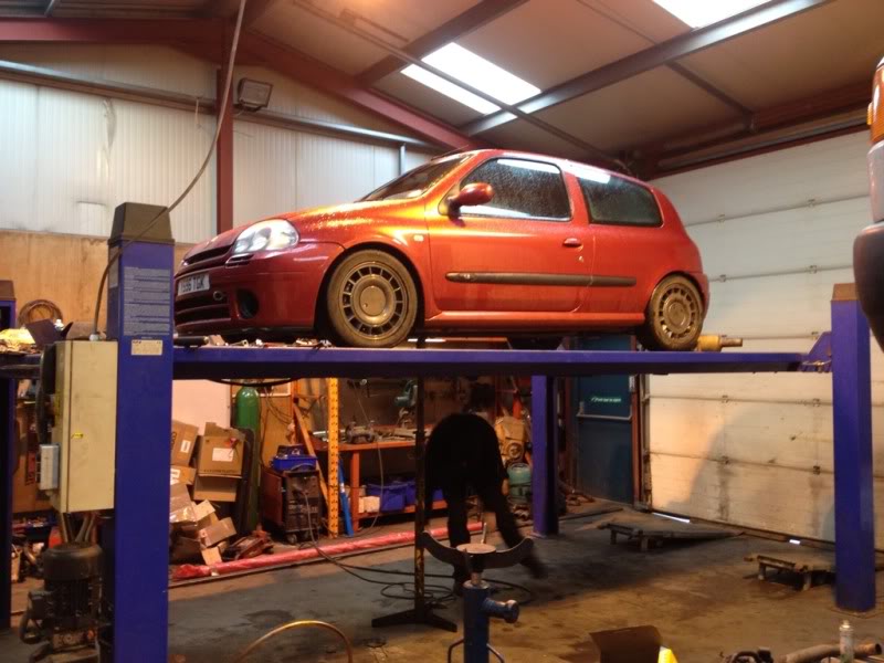

Been a busy day today for 596, spending most of the day on other peoples ramps. First off saw me visit Free Flow exhausts in Shotts to have my Orbisoud fitted up.

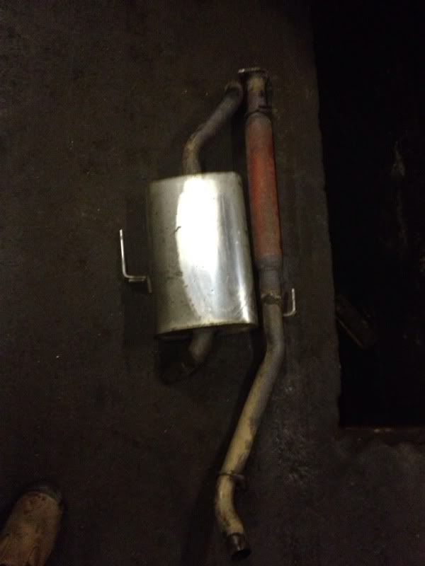

I had removed the old system a few days ago, just to save a little time on the day. Nice cherry bomb centre section there!
On the ramp being worked on.

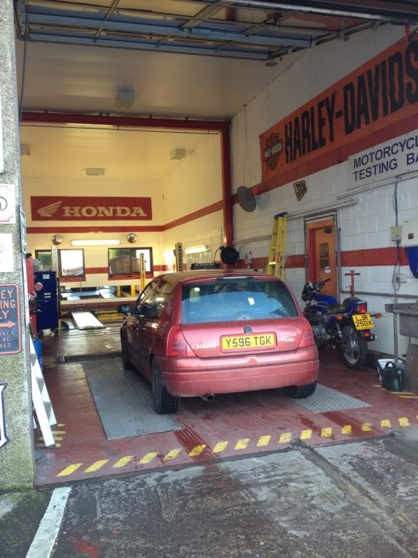

It was then swiftly driven from Free Flow to RCA for a MOT. This is the only after pic of the exhaust i have at the mo, more to follow after a clean.
A pass, had an advisory on a track rod end needing replacing and the lambda reading was a little on the high side. Over all i'm really happy with the Orbisoud, its pretty boomy around town but sounds lovely higher up the rev range.
Last pic, also shows the half cage in the back. Wasn't a hard job to do, just fiddly getting it 100% square. Huge thanks to Fraser and John who did most of the work TBH, somthing about drilling large holes in your own car made me feel a little odd. :p

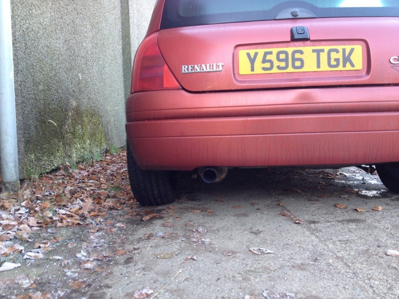

Tried to get a few better pics of the exhaust, still not great tbh.
A few of the car out and about, just because I think it looks awesome.

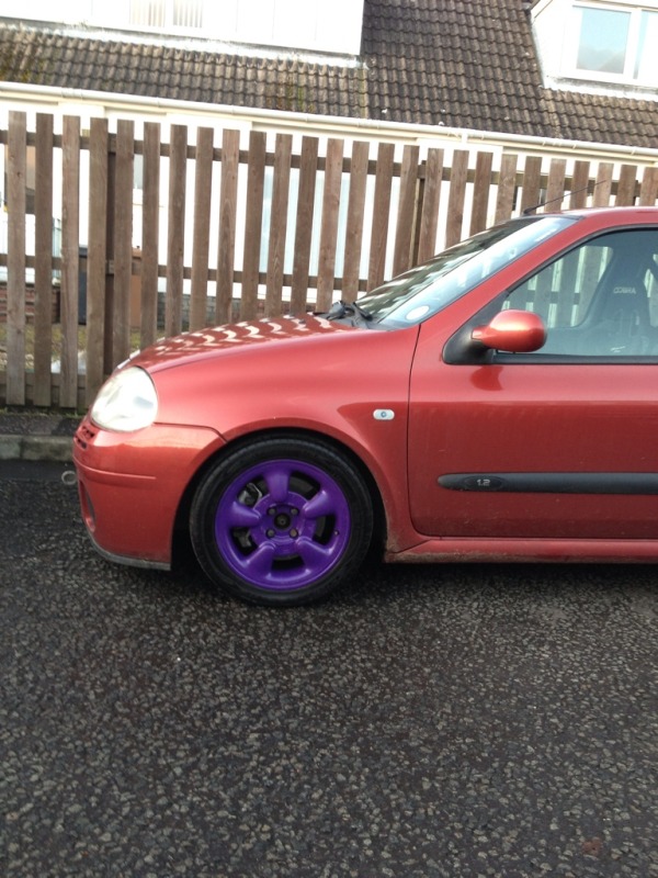

Cheers. It's a little low for track, and theres far far too much camber, but I'll have it sitting nice for the snow coming.
