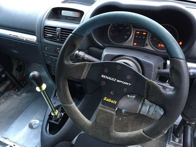

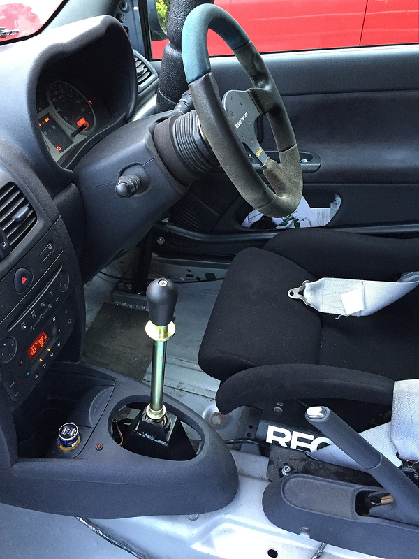

Tempted myself , gear change is way better.
Big brakes next for me , then steering wheel quick release .
How much was it for your setup @Fletcher excluding wheel.
Hi Mike. IIRC momo boss £50 and Lifeline QR around £200.

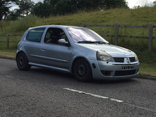

Done quite a bit to the old girl lately.

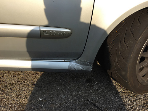

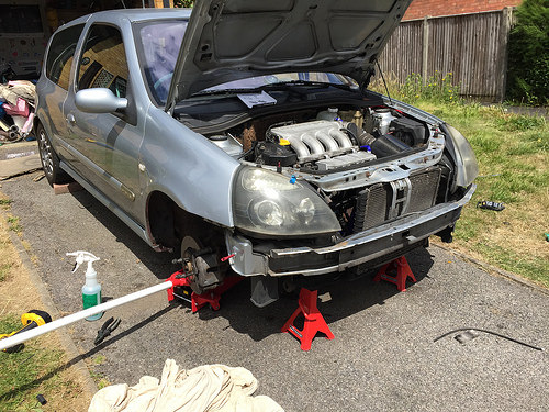

A few weeks back I had a mishap with the jack and damaged the side skirt. Ghetto fix with colour coded duct tape :wink:
Untitled by Fletcher Cox, on Flickr

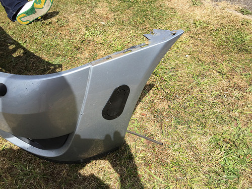

So I ordered a replacement, and @Christopher. came over to help me fit it (Chris did most of the work TBH) thanks again mate :smile: We also fitted aerocatches to the front bumper. Most of the brackets have been cut out and a couple of times the front bumper has popped off, so I needed something to secure it properly.

A week later I had it booked into to Rentech to change the lightweight PMS AC delete kit for a 172 cup AC delete set-up, a new handbrake cable, and new rear discs/ pads, thanks @Mike@Rentech... Also big thanks to @stevem42 for giving me the power steering pulley for free, cheers mate.
Next up, change the rubber on the white set of 2118s from the Yoko Parada spec 2's, to Hankook Rs2 that have been gathering dust in the attic. I also plan on sorting the headlights out and giving it a quick wash ready for CSS.
