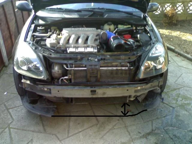

see this pic.
bumper off but archliners in place. i've drawn a line of where the front bumper goes so you can see the space left between that and the radiator [the arrows] loadsa room!!

i think i'll stick to the "bass ports" you can buy from audio shops for £5 and use normal piping ;) bit of spray...never tell the diff! lol.
go on then how hard is it to take the bumper off lo :) just want to know not sure which to do yet
Its quite tricky to reach the bolts that secure the bumper tho. As don't you have to reach in through the wheel arch liner?:eek:

just pull it out of the way, its only plastic [french plastic at that].
