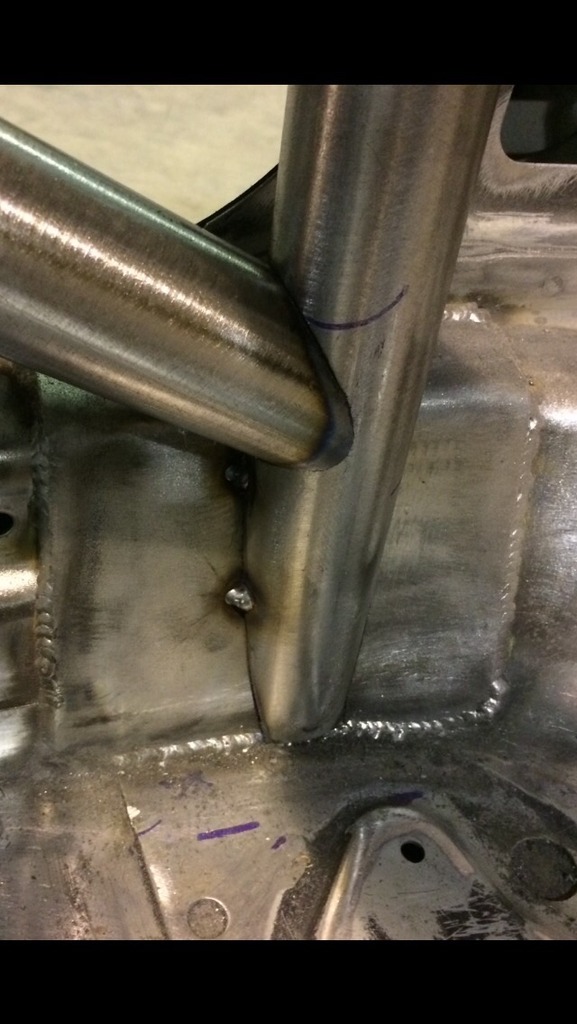

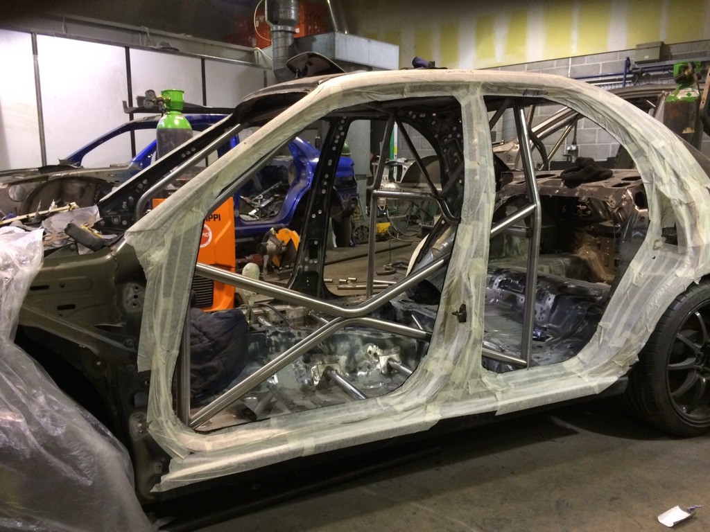

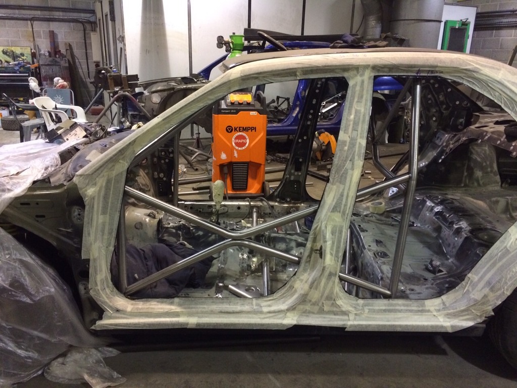

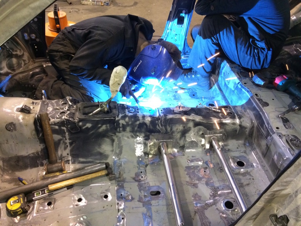

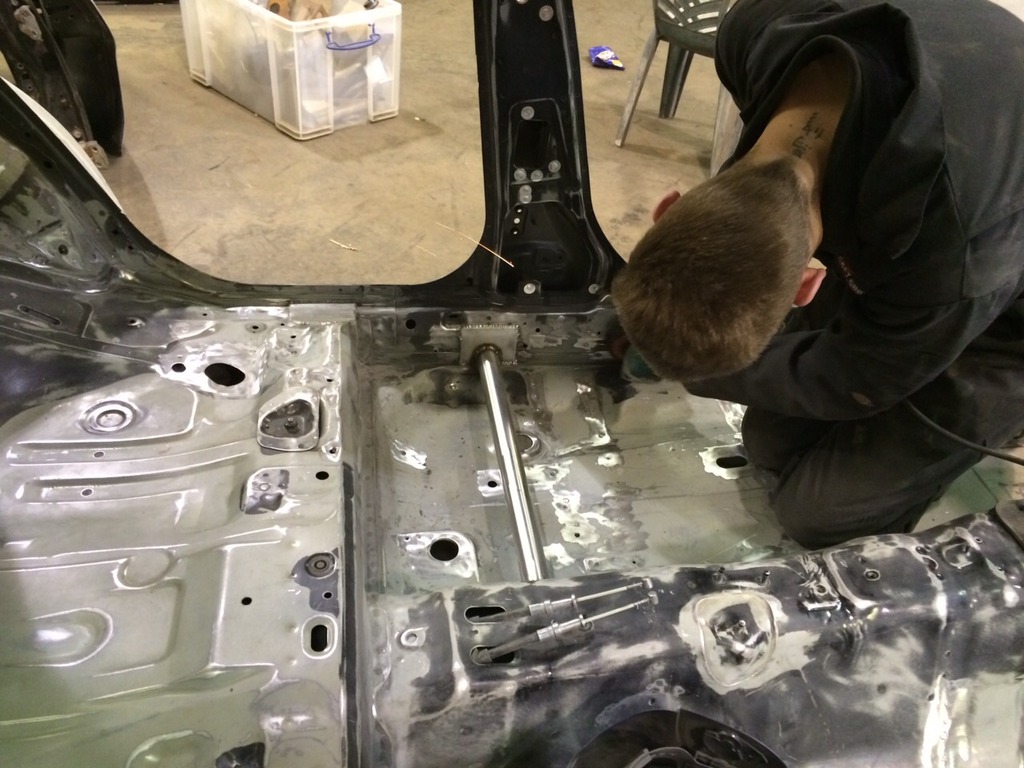

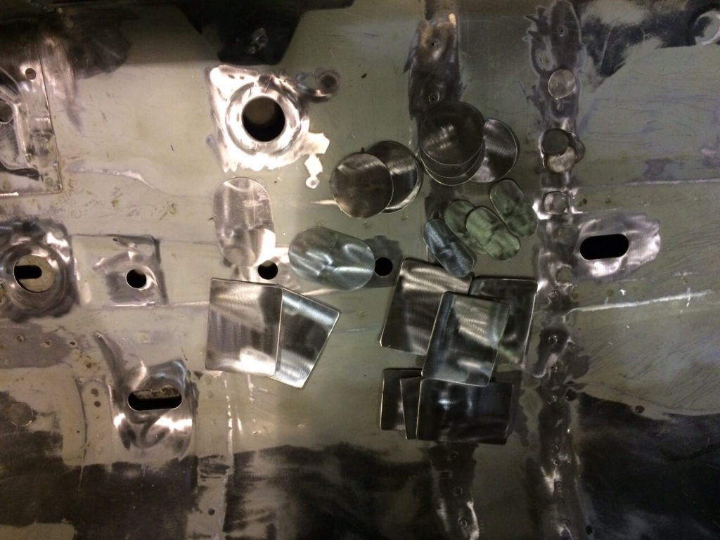

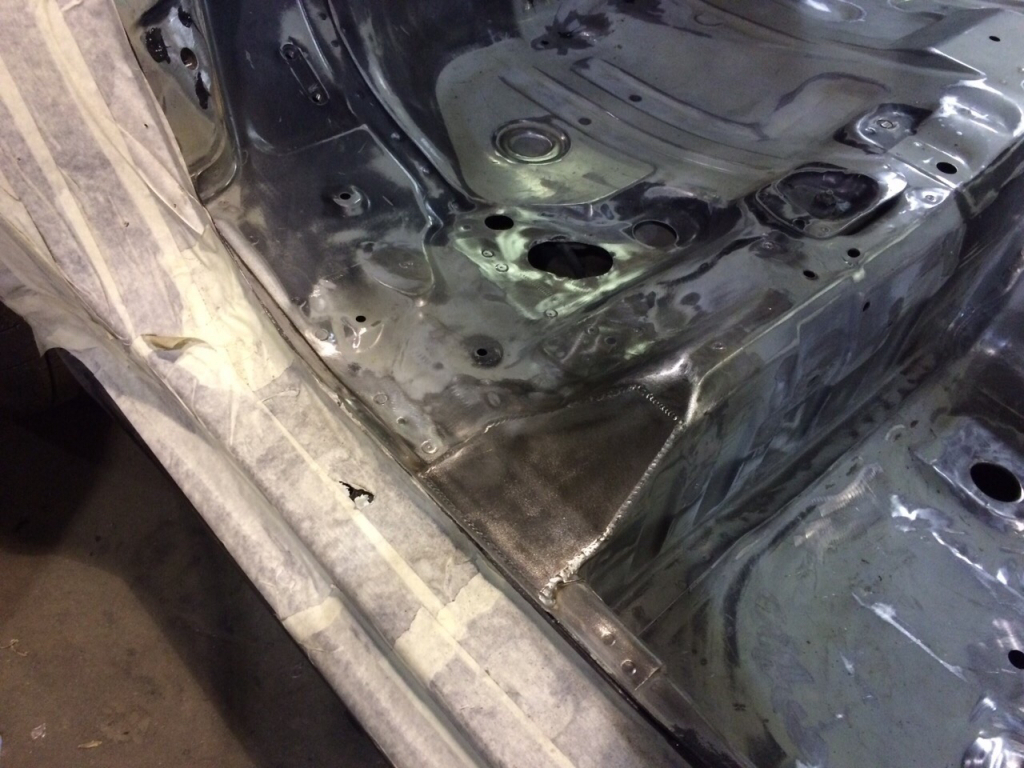

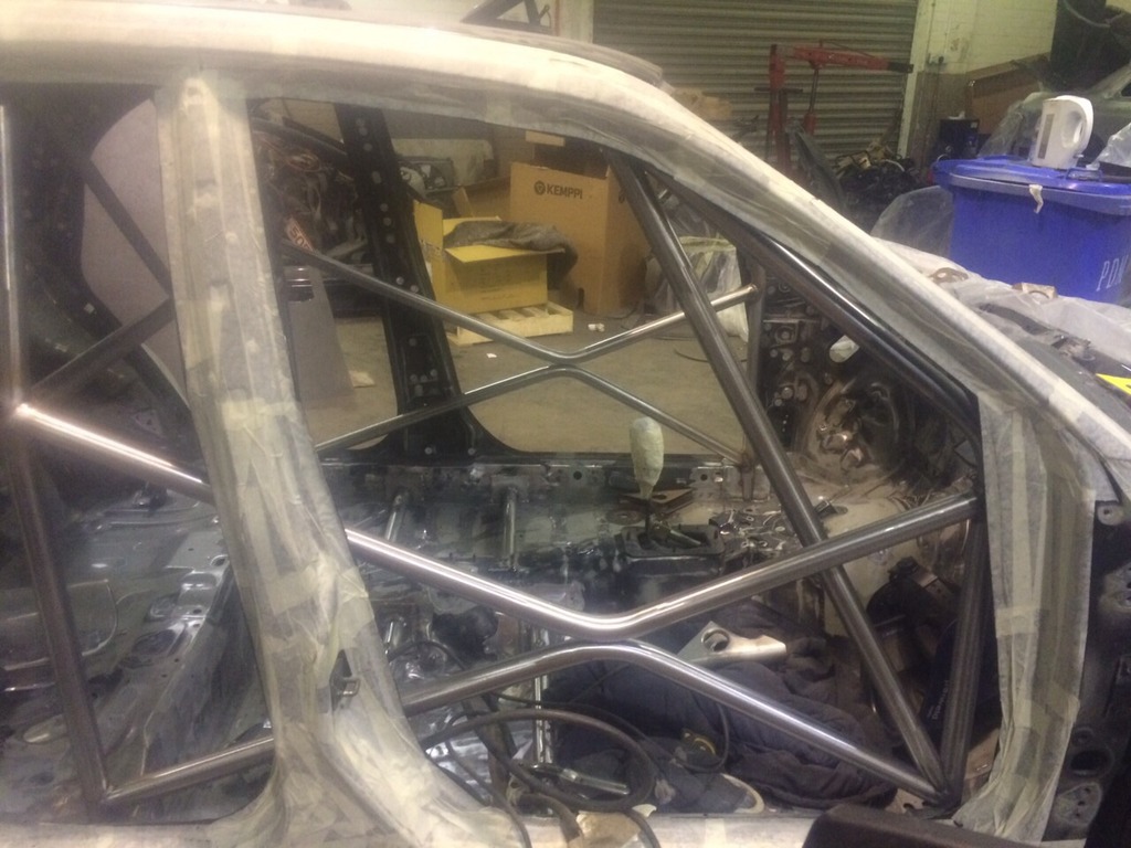

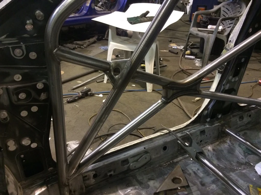

Cage feet and hole plugging today.
Pep
  M2,XJS,S1000RR

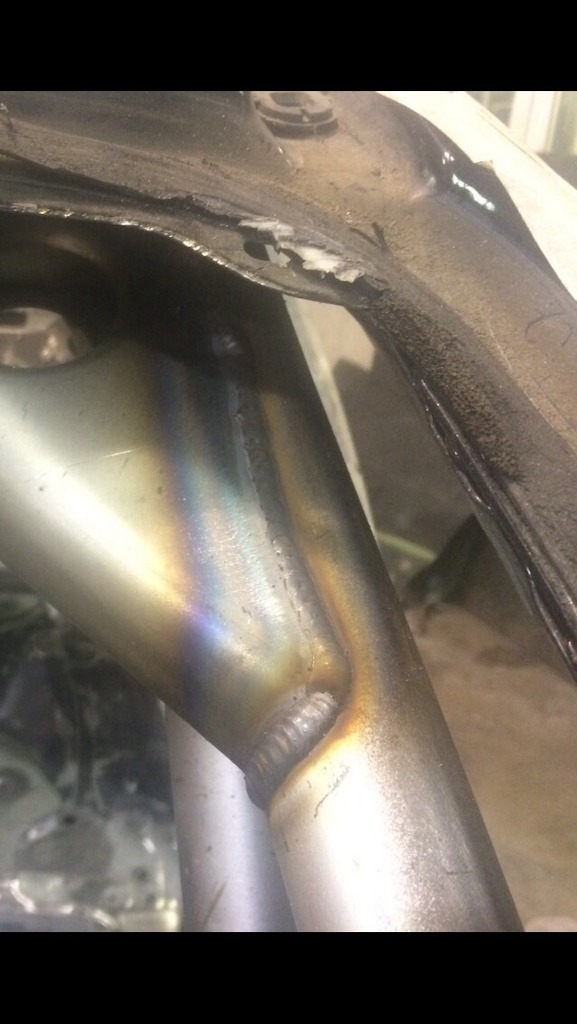

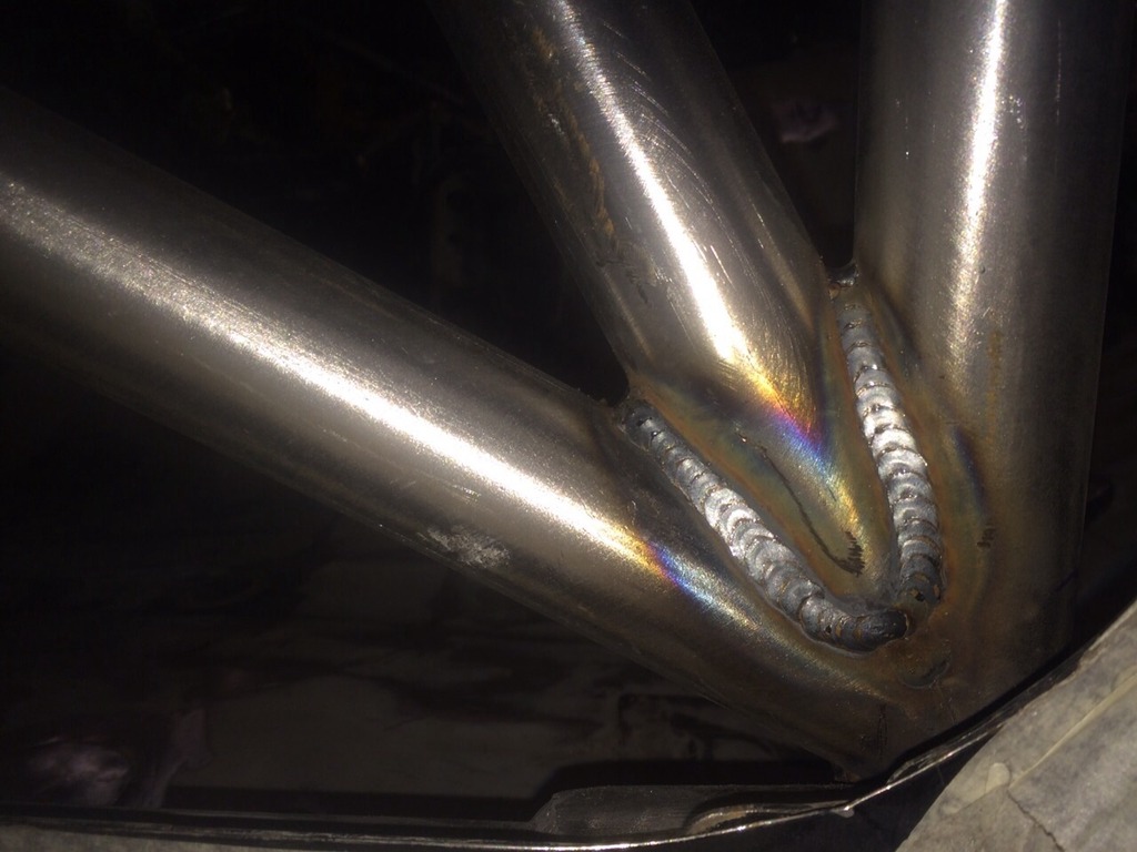

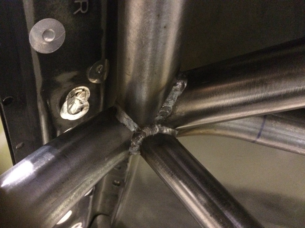

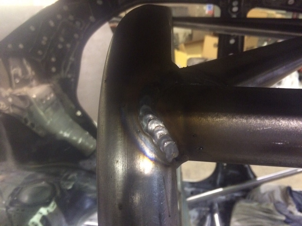

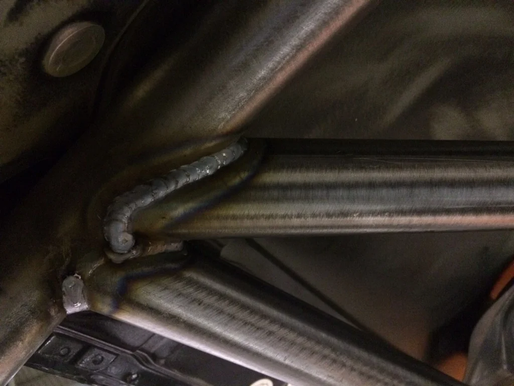

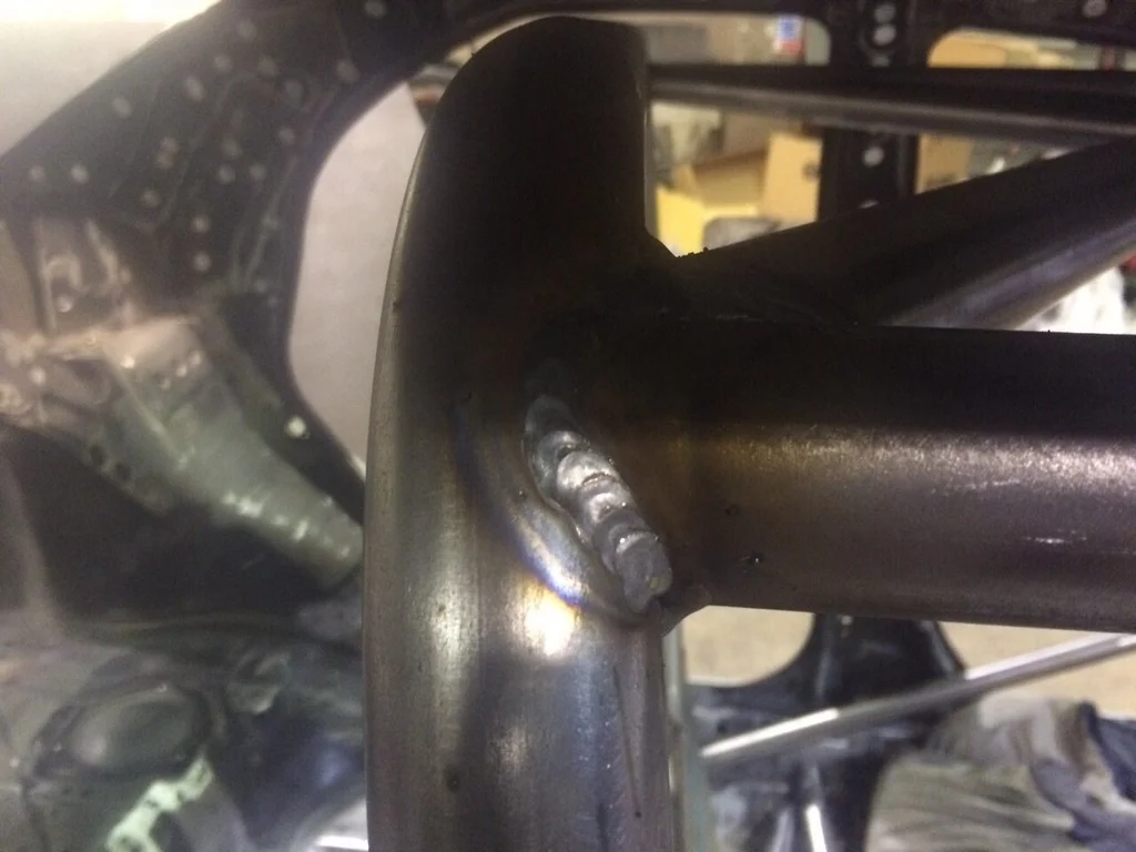

Looks epic, but should have got them to Tig it, so much neater!
frayz
Prodrive did extensive testing on WRC cages and MIG was proven better for the job at the time.
Besides, if the welds are as clean as that, why would I need TIG?

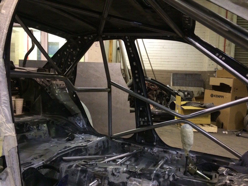

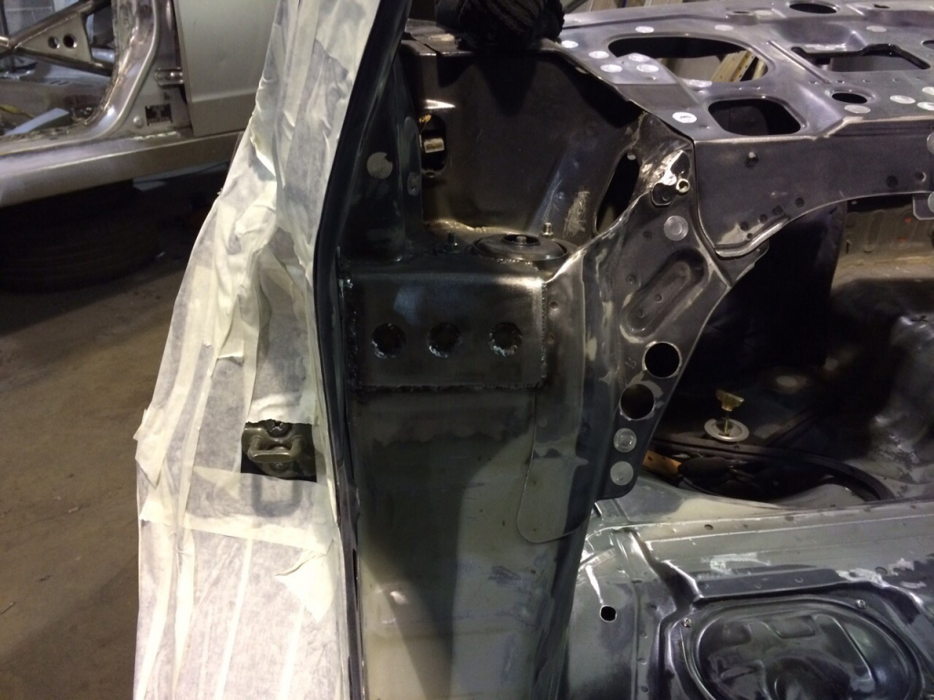

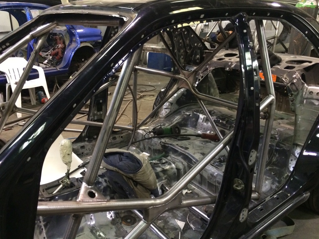

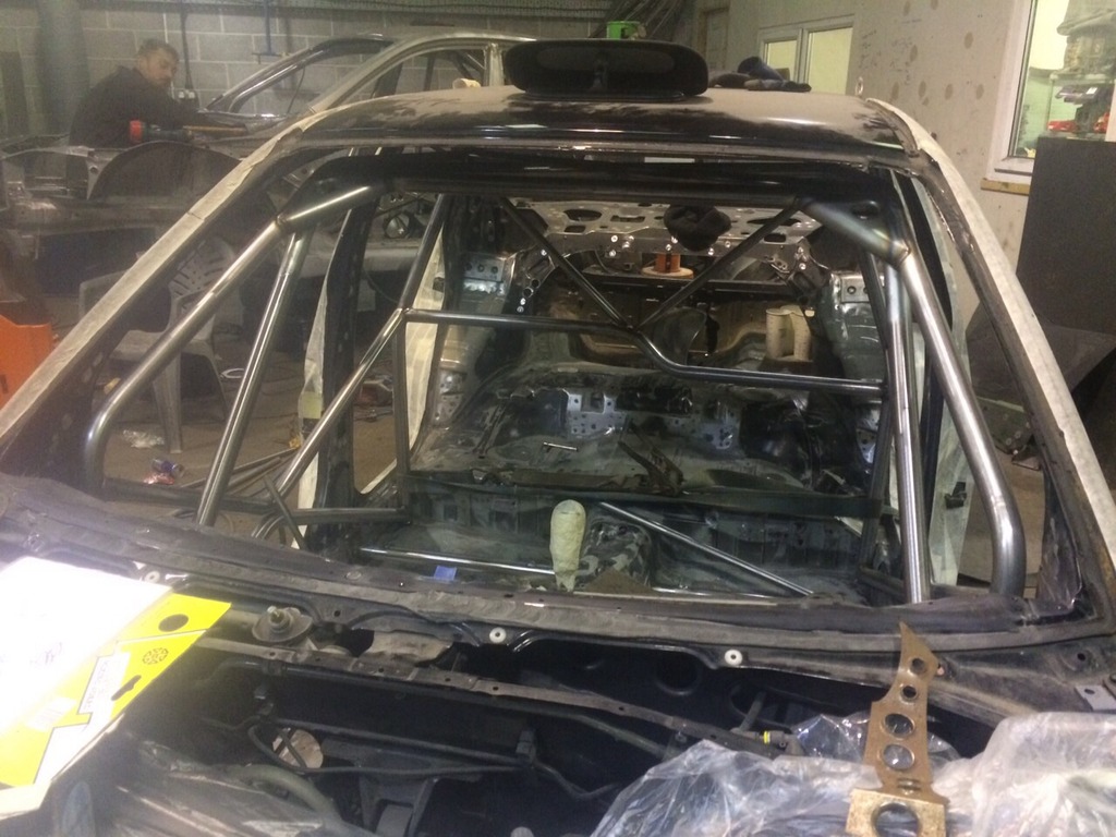

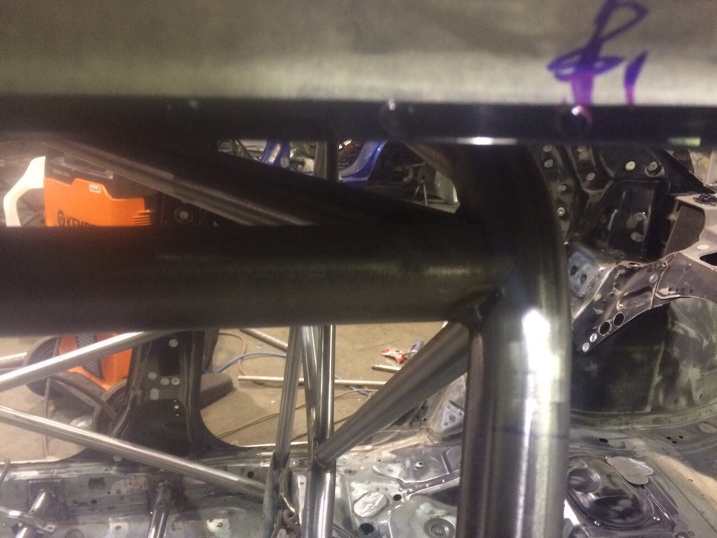

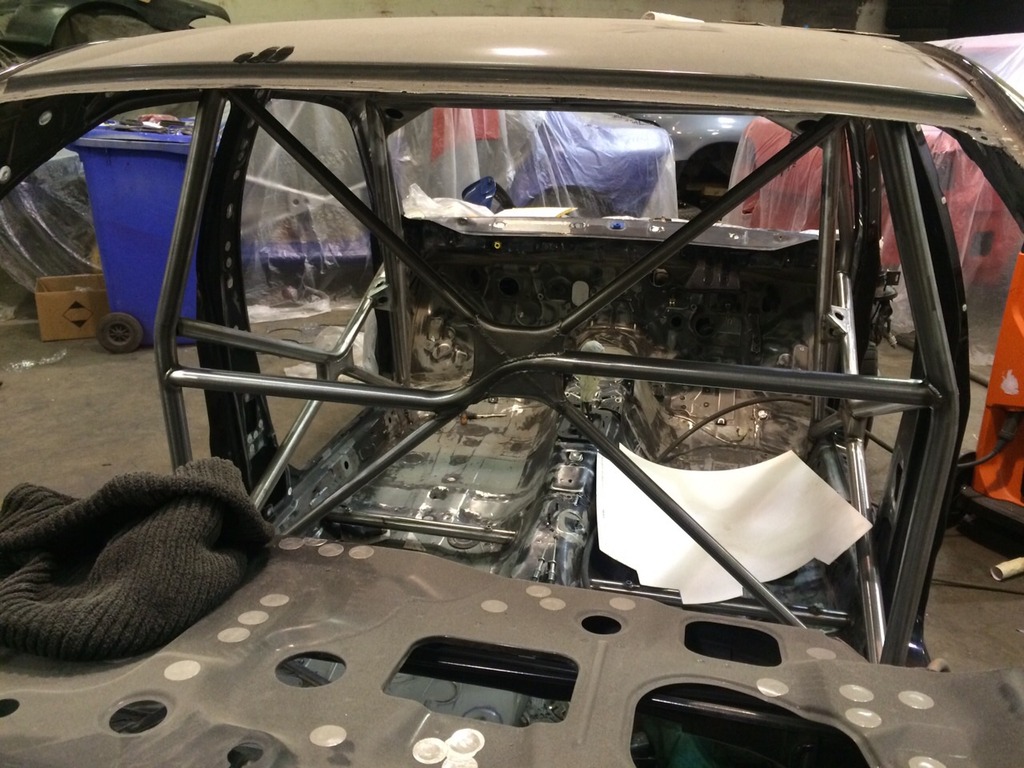

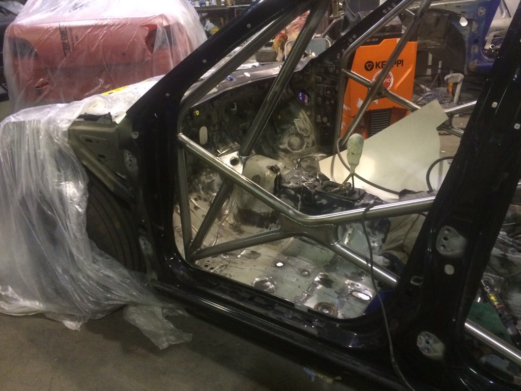

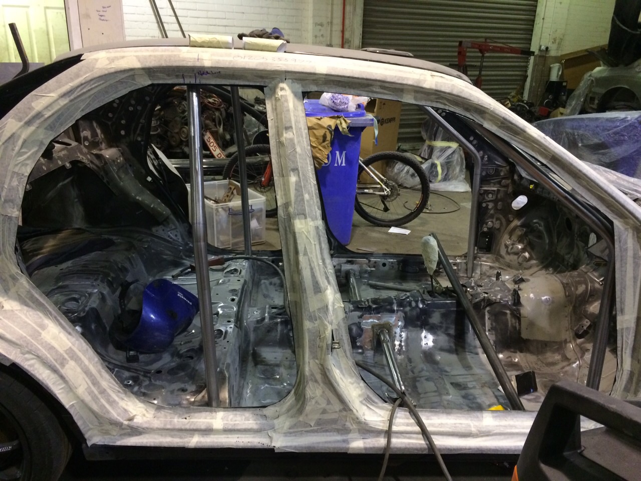

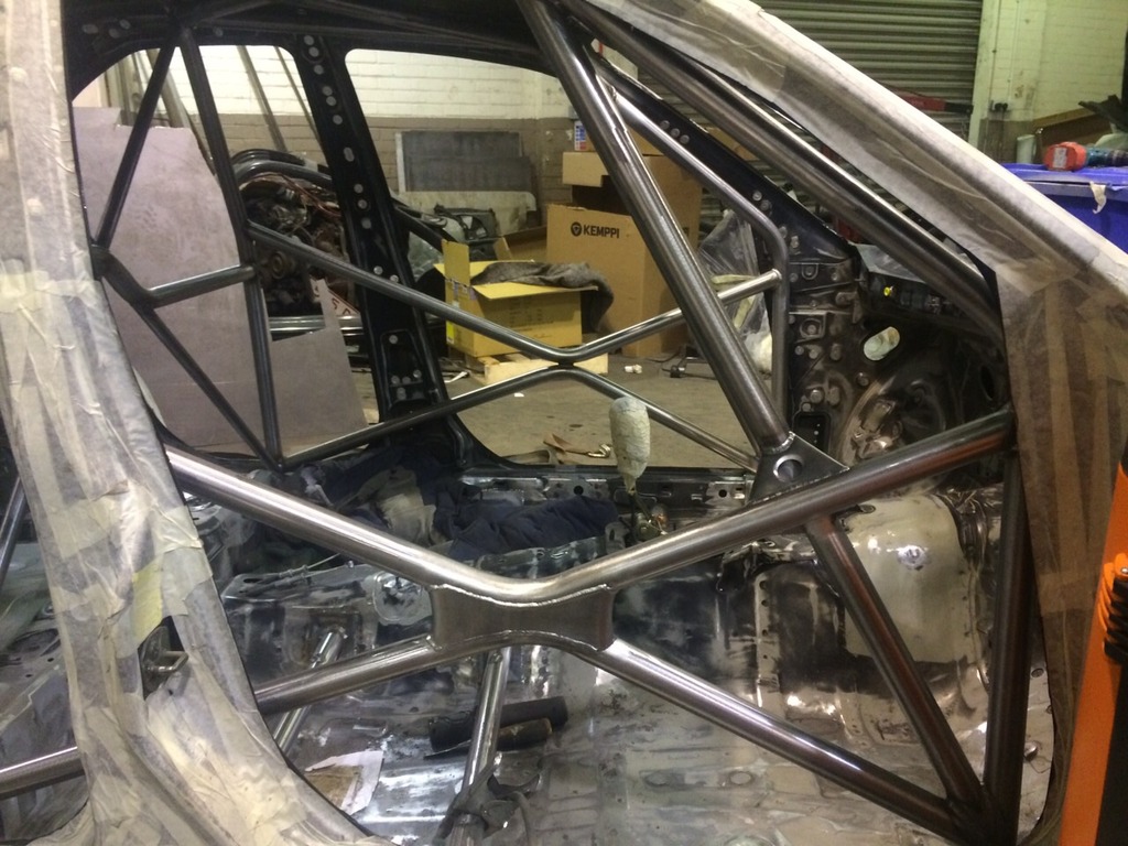

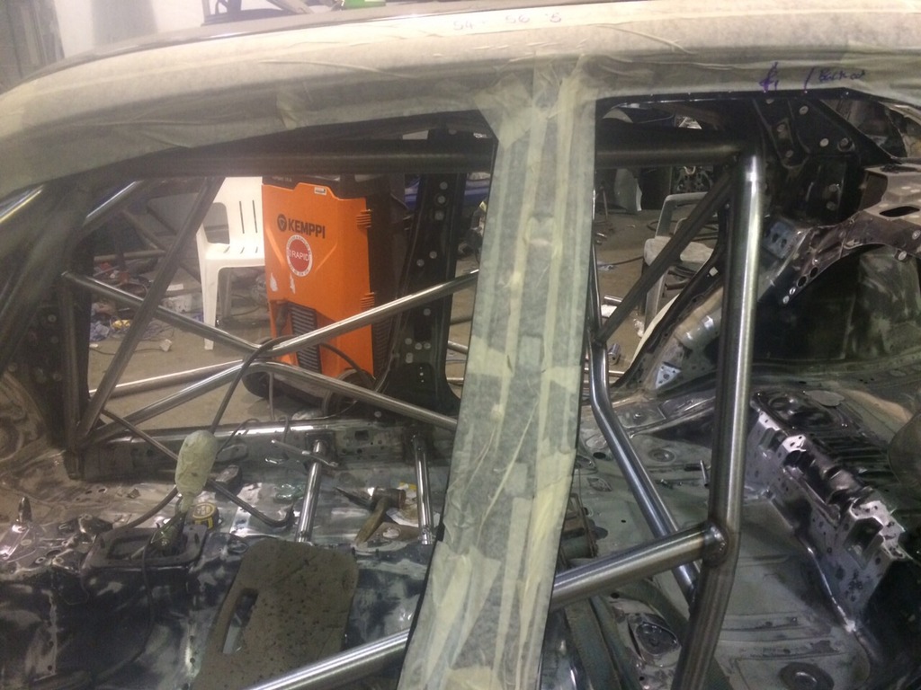

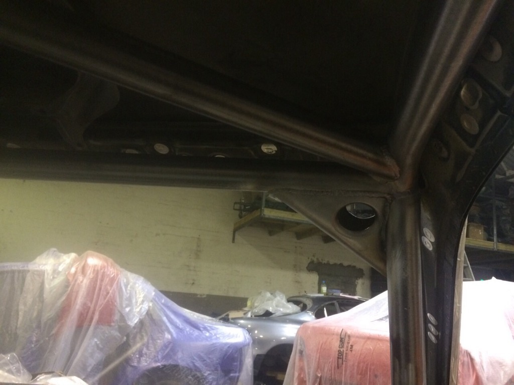

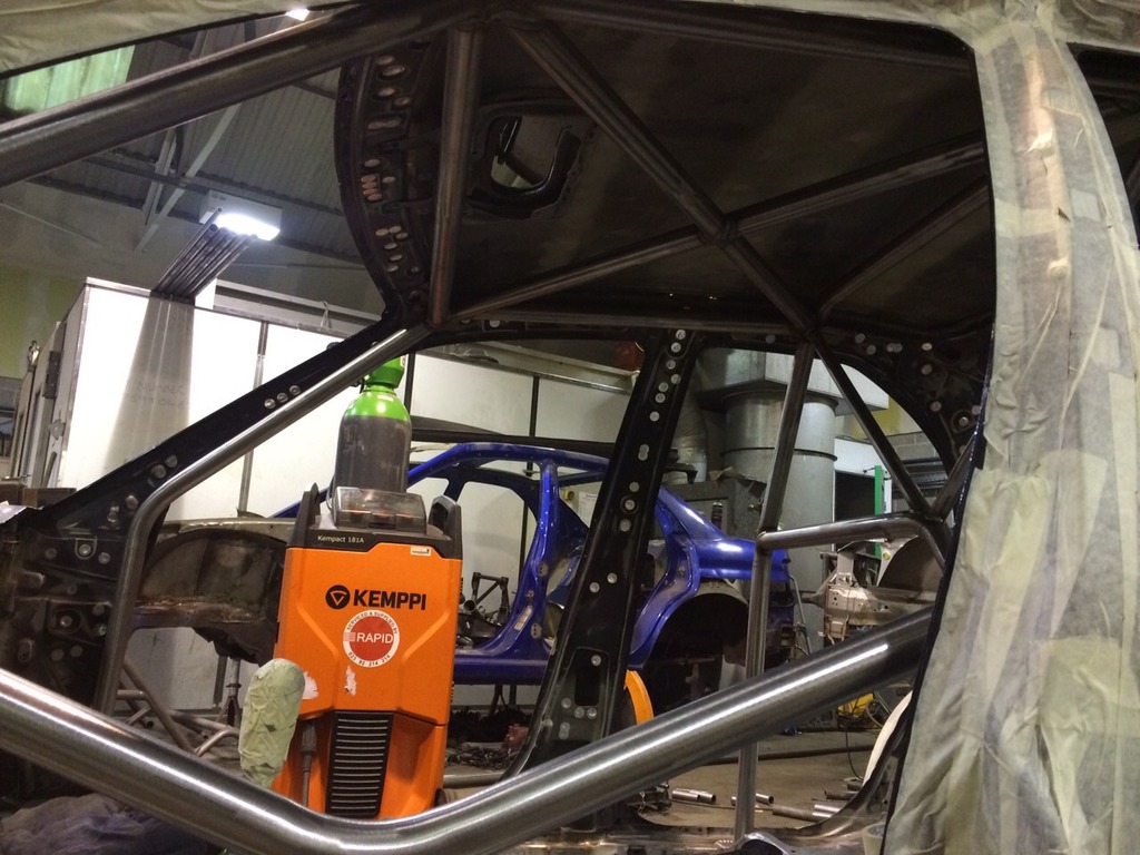

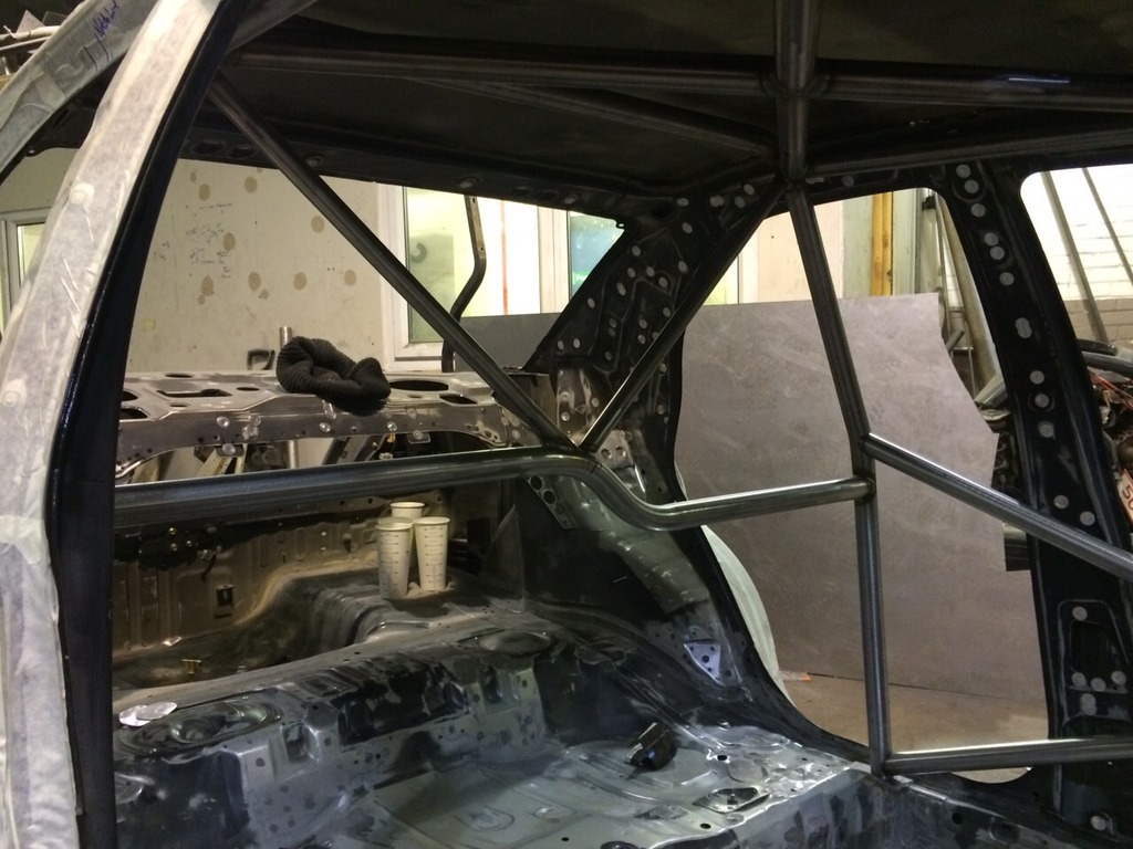

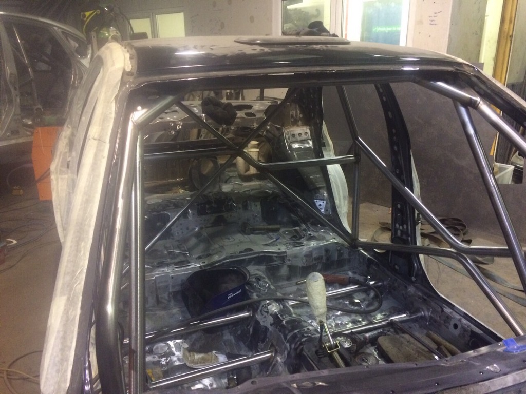

Big progress today. Cage was dropped to weld the tops and the screen got its corner gussets. Tomorrow the centre cross will be boxed in to the swan neck. But still my favourite part to come and they're the WRC a pillar gussets. :D

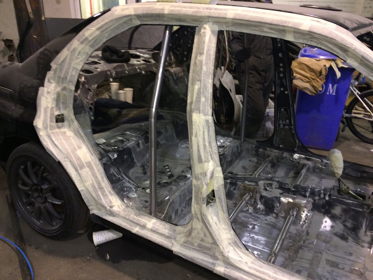

Can I ask..how does that pass an mot? Surely that's a safety issue no? Talking about the cage making it awkward to get into the car. I'd personally love it but don't see how it could pass?
frayz
Same as any WRC car gets its MOT. Since when did getting in and out easily be an MOT requirement?
I could argue that a very overweight person will have a tougher time getting out of a lotus Elise or VX220 than I will getting in and out of mine.
Every WRC car has an MOT and tax disc as they're driven on the road between stages.

looking fantastic mate - will the cage be attached to the bulkhead or possibly carried though to suspension turrets?
