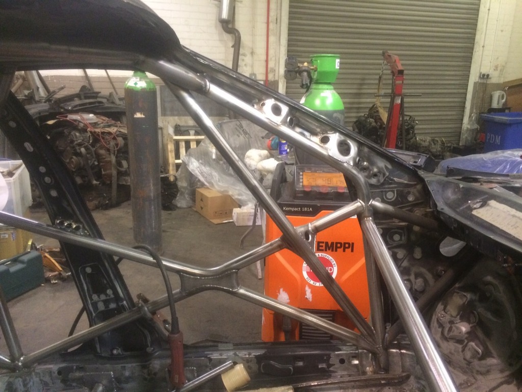

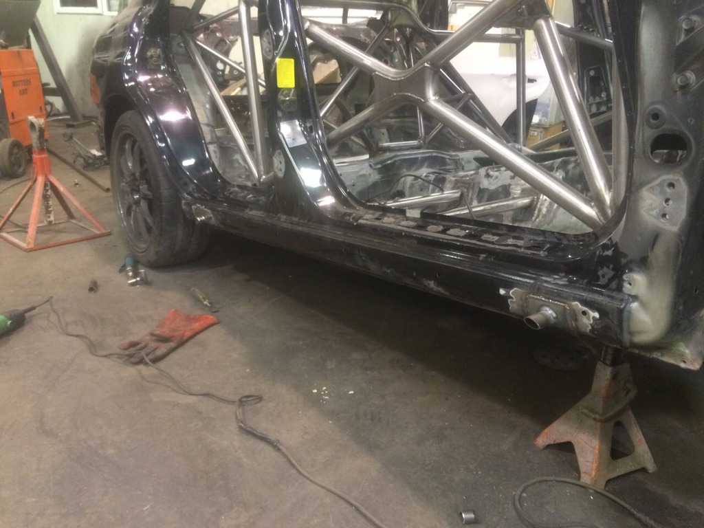

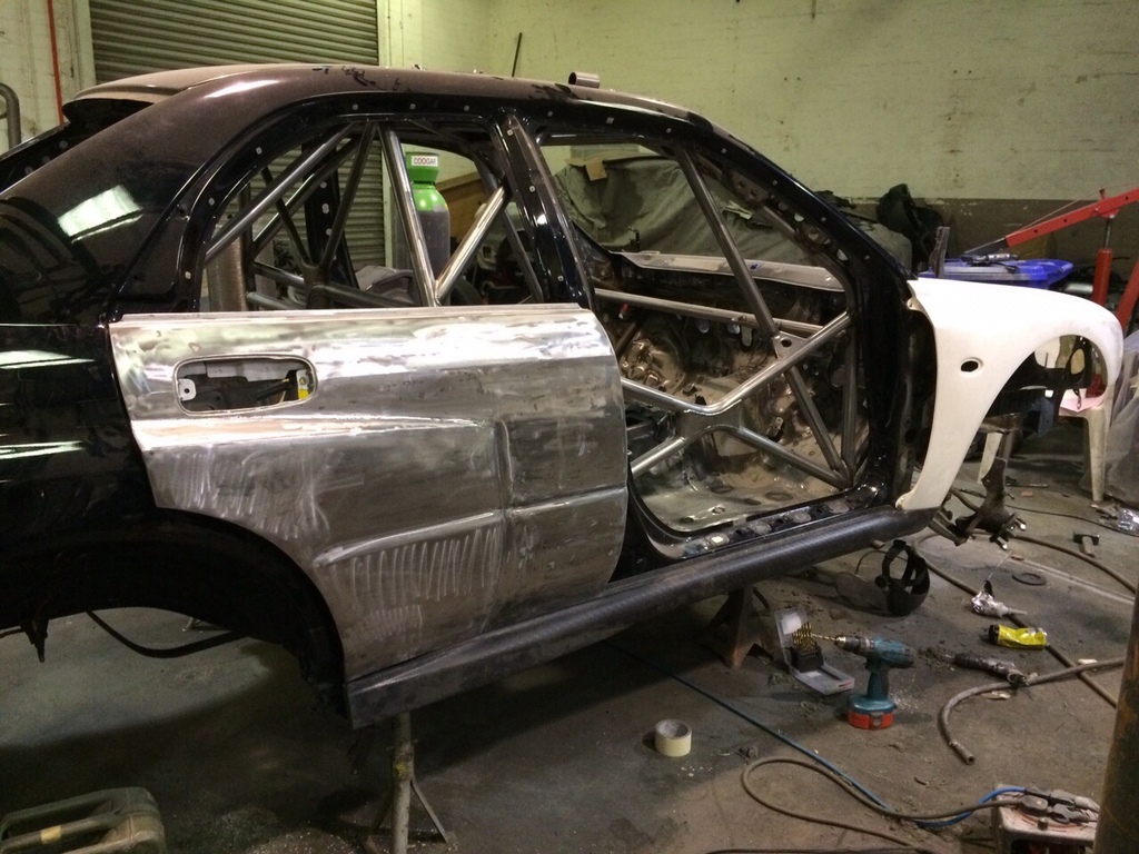

Dash bar and sill tubes in.

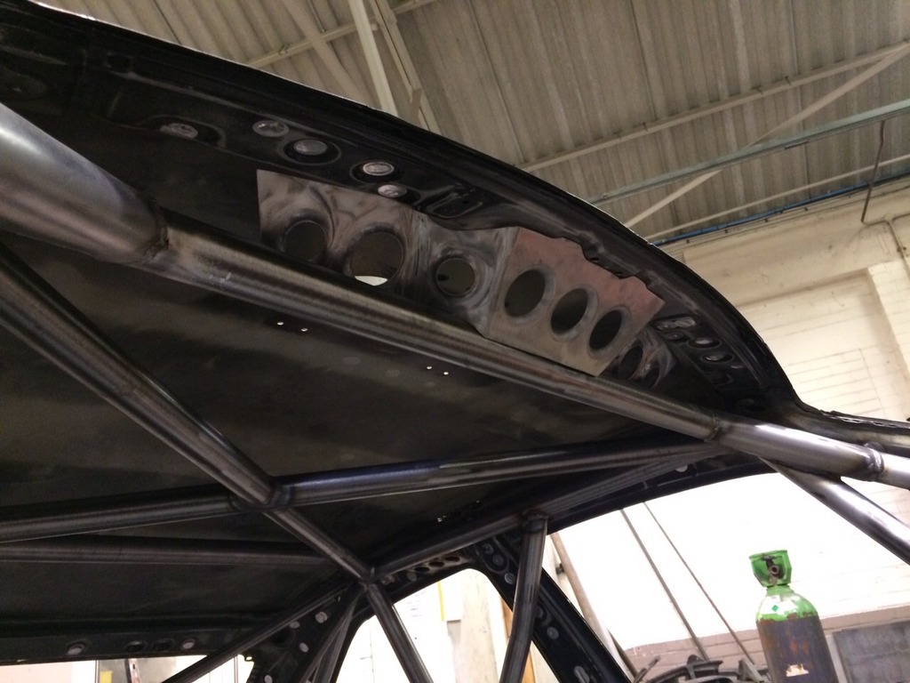

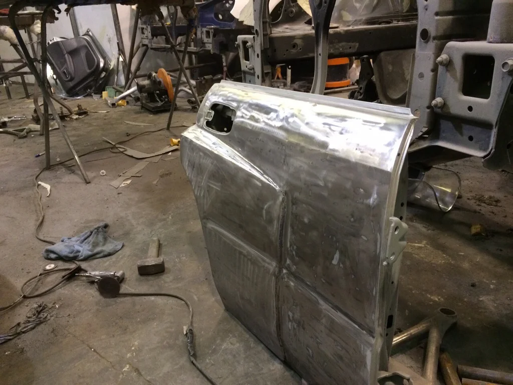

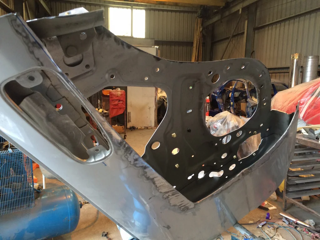

All sorts of odds and sods jobs being done still. Screen gusset is in progress, I think Daves still playing with the design of this.

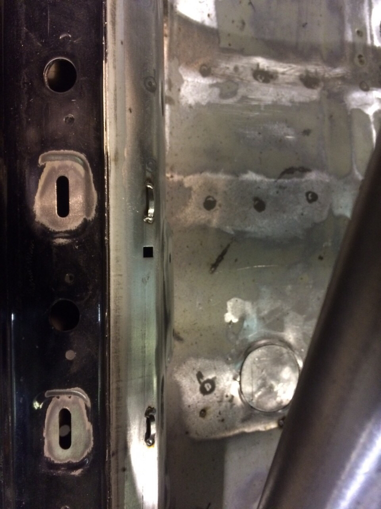

Also painstakingly spot welded in heaps of tiny little 20mm straps for all the wiring, brake lines and fuel lines. Little details like these take ages.

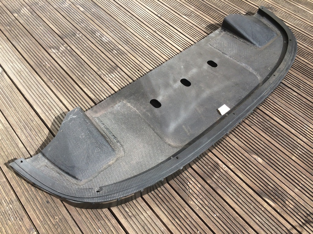

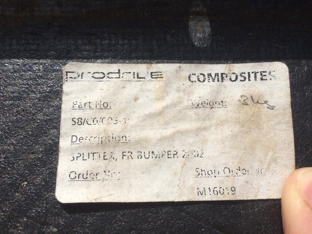

Massive thanks to Damien Bradley and Steven Darley for helping me source probably one o the rarest WRC parts out there for a bugeye.
Genuine Prodrive S8 Tarmac splitter/skid pan in autoclave carbon.
This is the real deal and will suit the car perfectly as it fits right up to the underside of the WRC front bumper. They only made the S8 cars for a year in 2002, then they only had this particular splitter on tarmac events, so there can't be that many of them around.

You can never ever sell this! Really excite to see the finished product. Great to see a car build in detail and one thats been done properly. Appreciate you posting pics and stuff - i know you don't have to.
