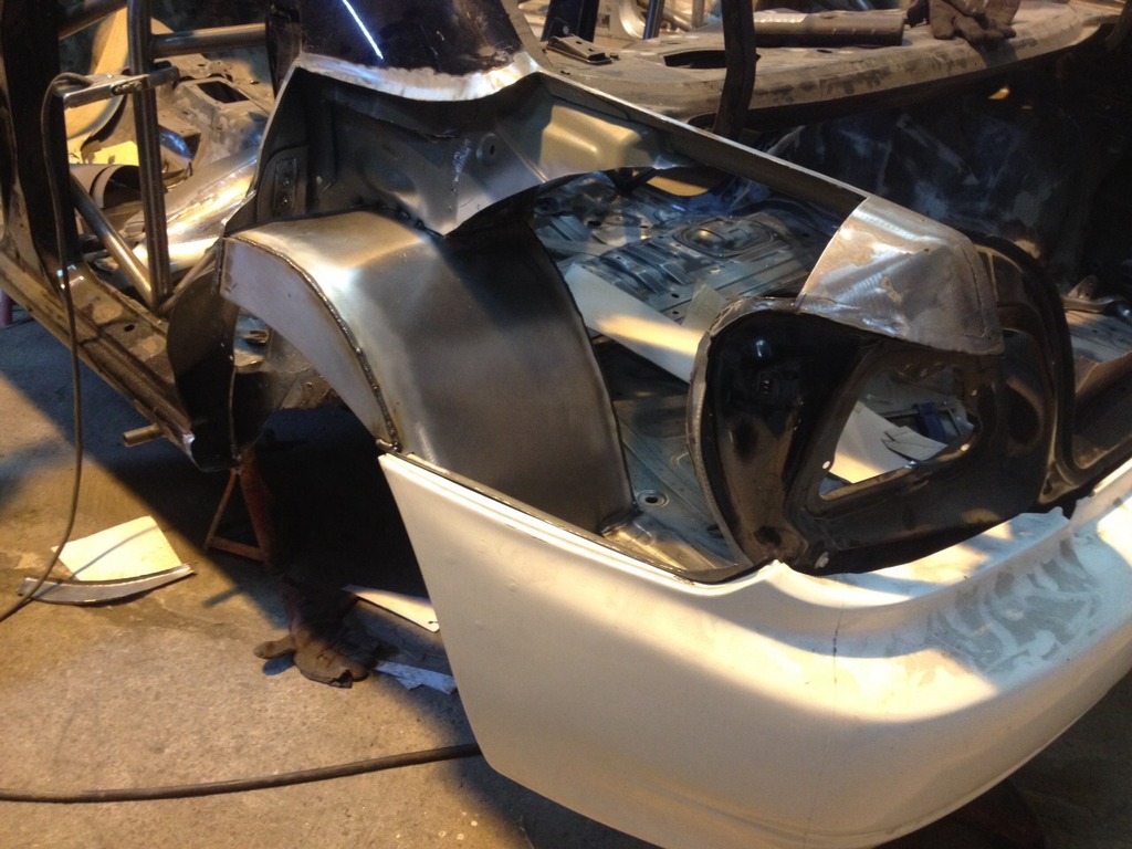

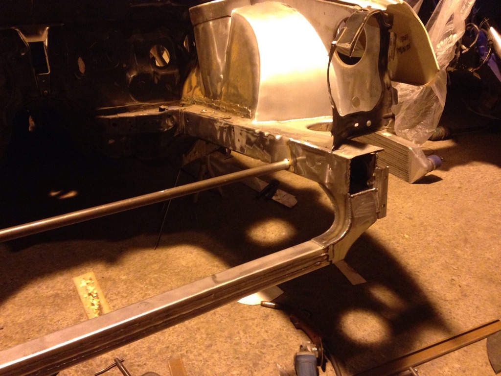

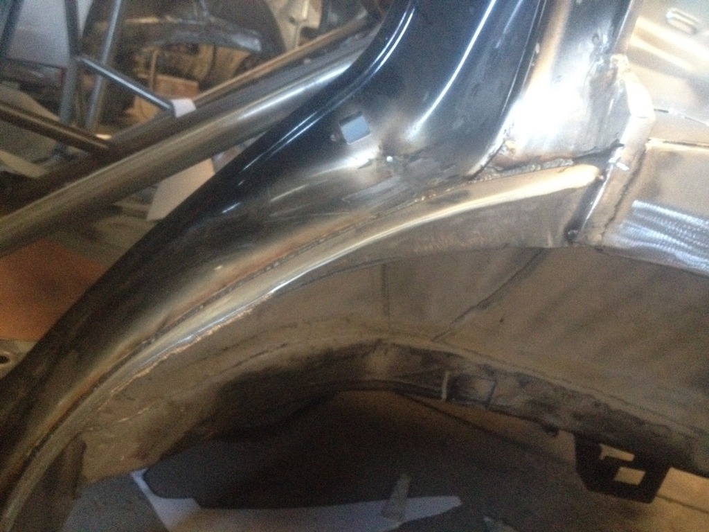

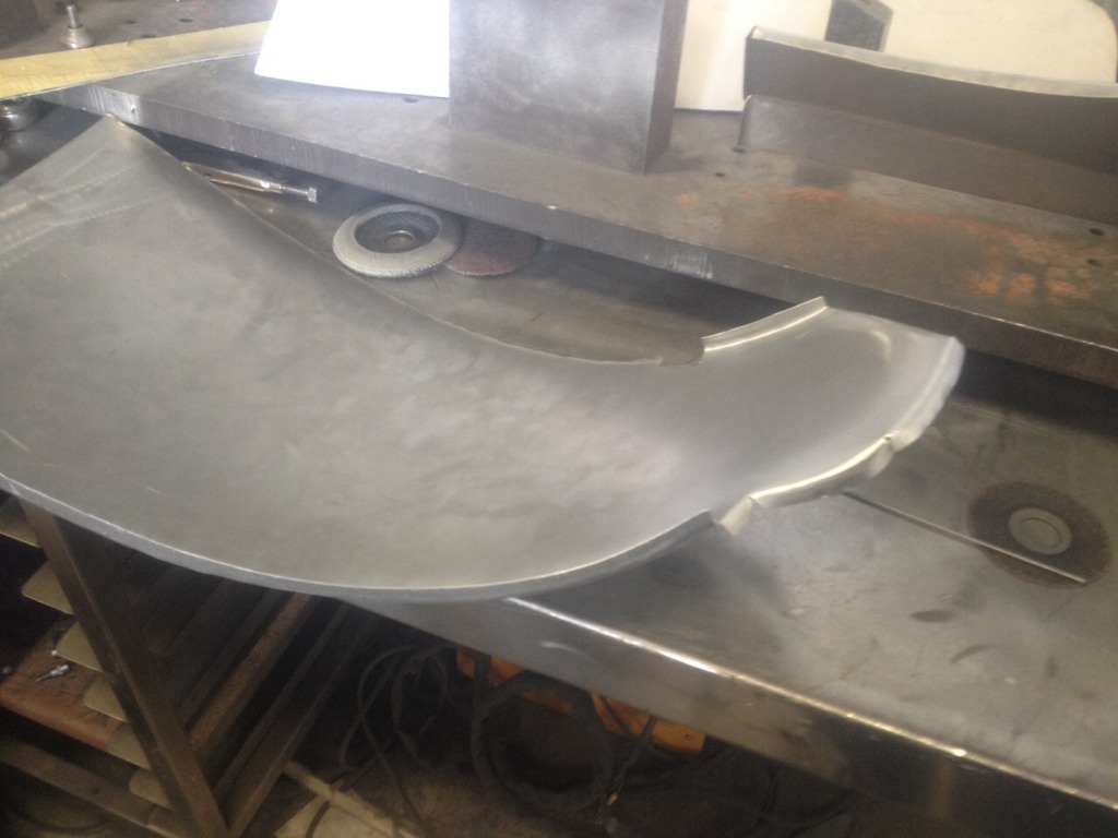

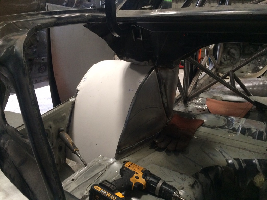

Last pics for this week. NSR tub almost done.
Great to see the car taking shape. Daves doing an amazing job. :)

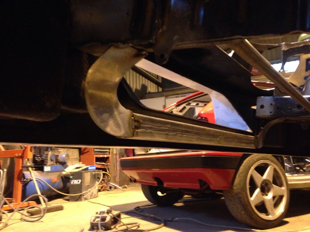

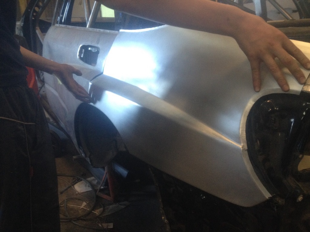

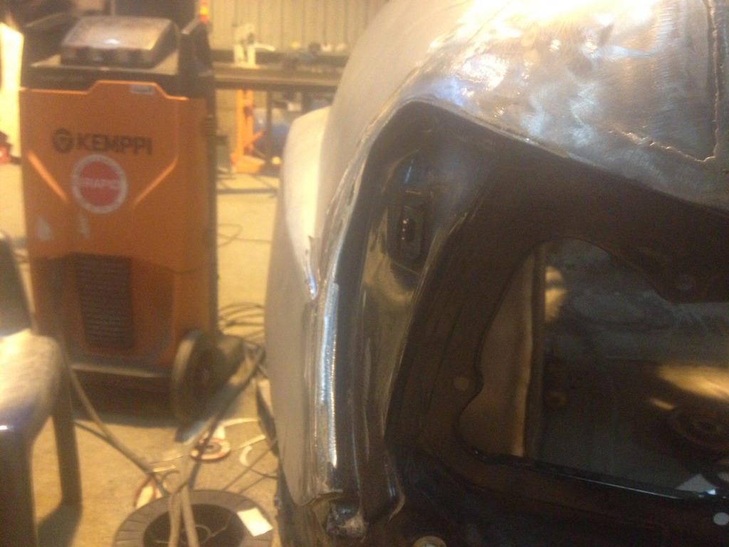

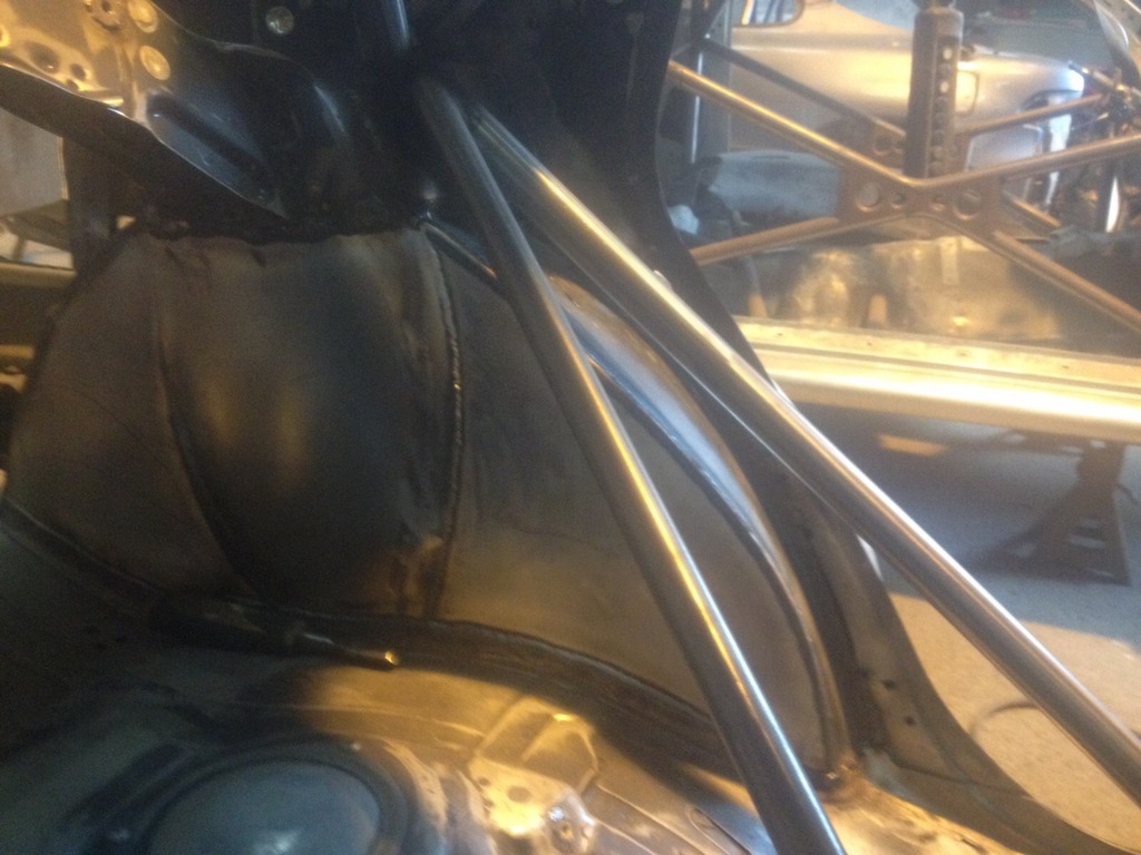

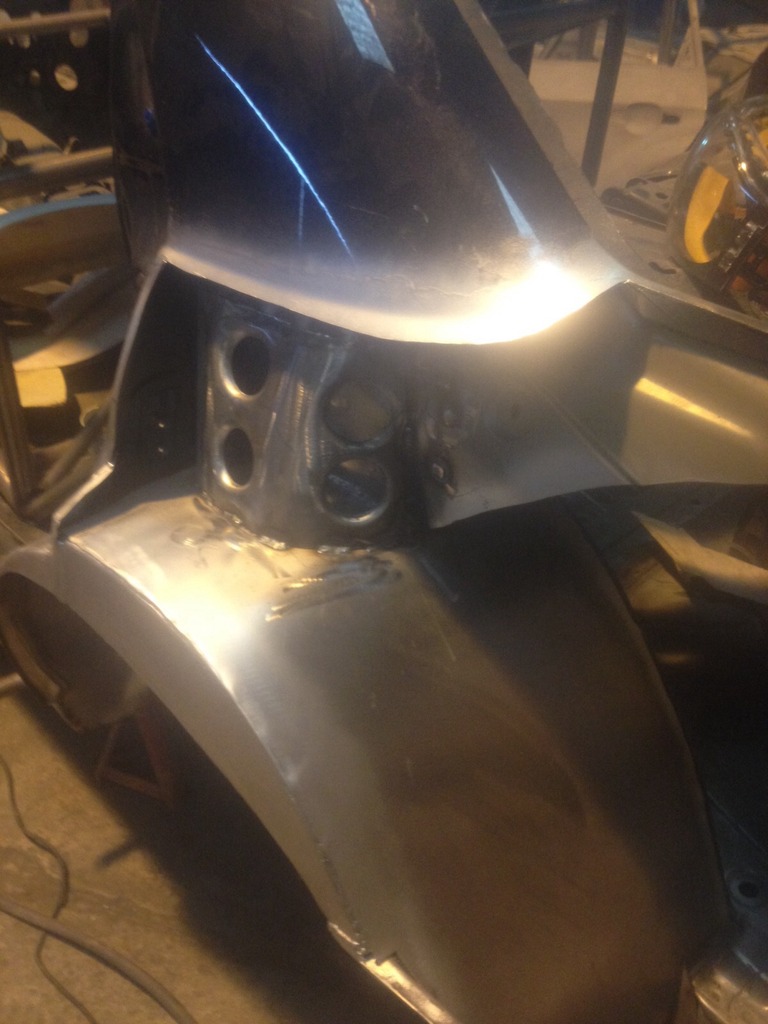

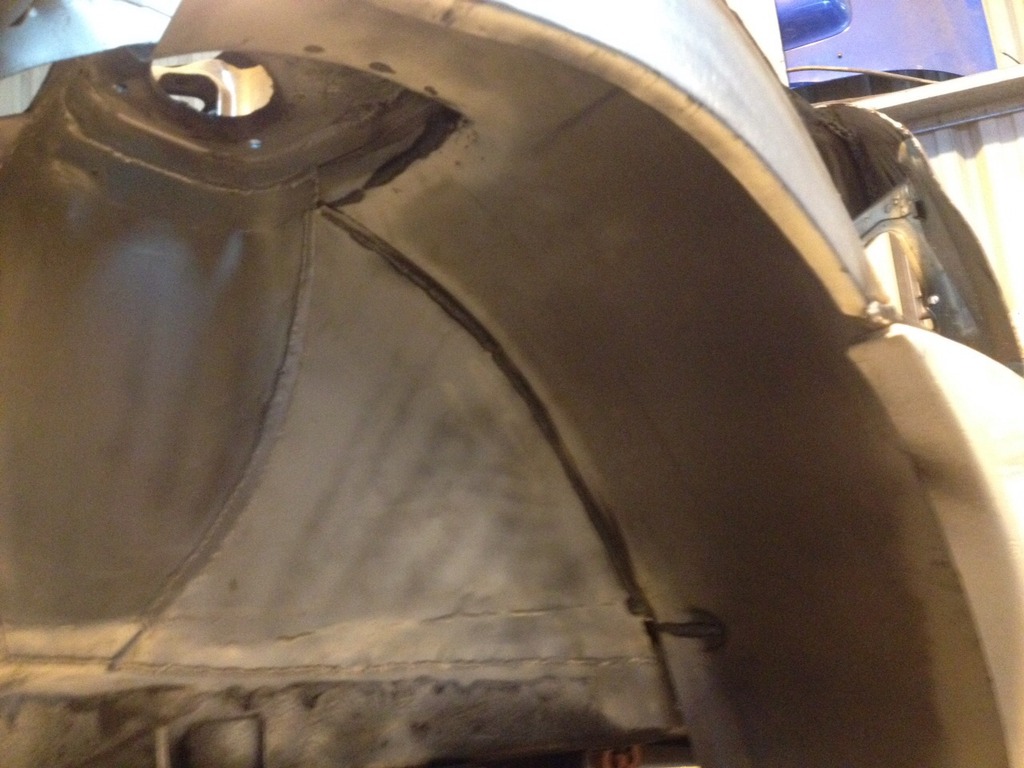

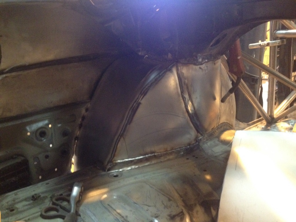

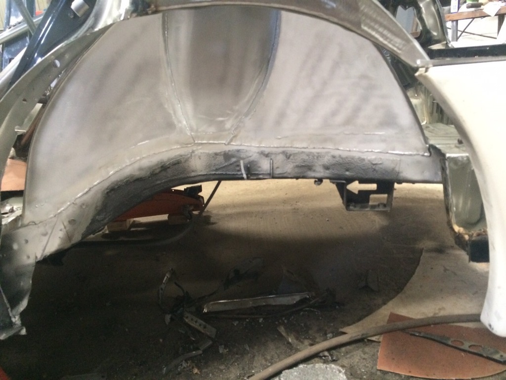

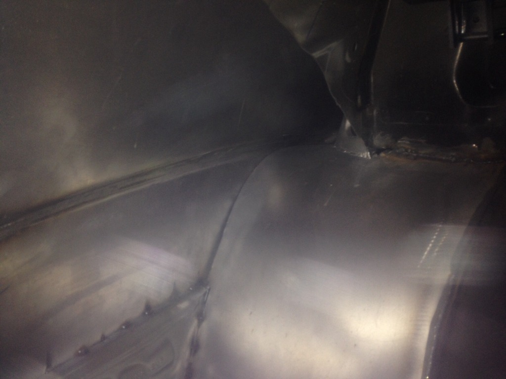

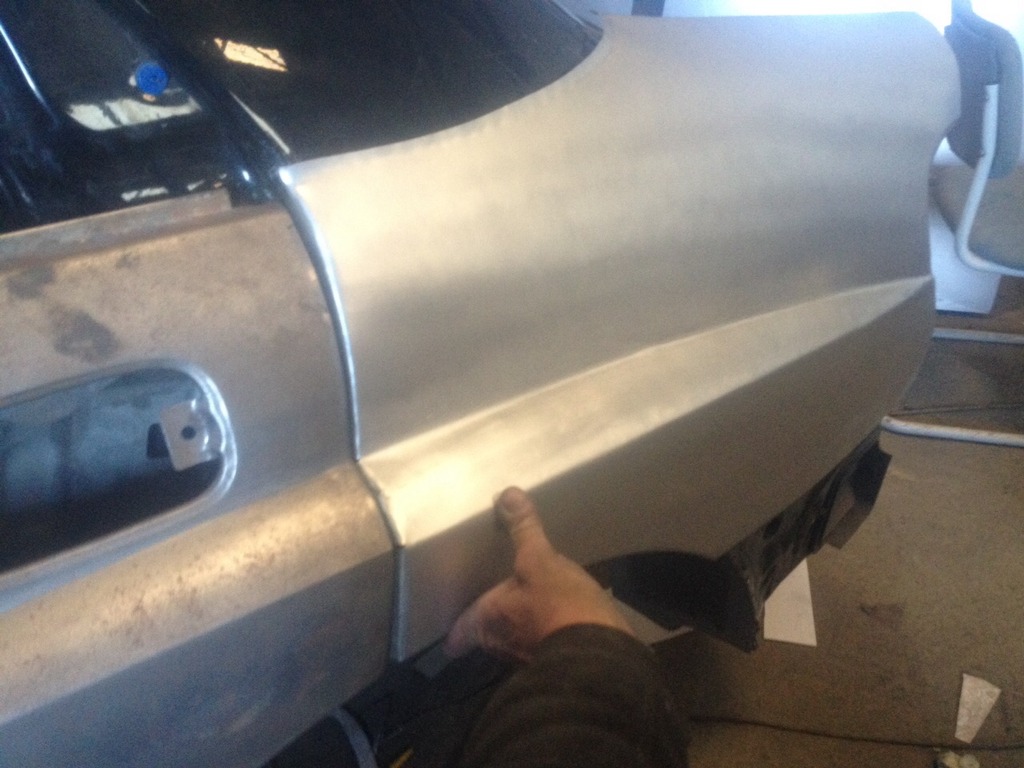

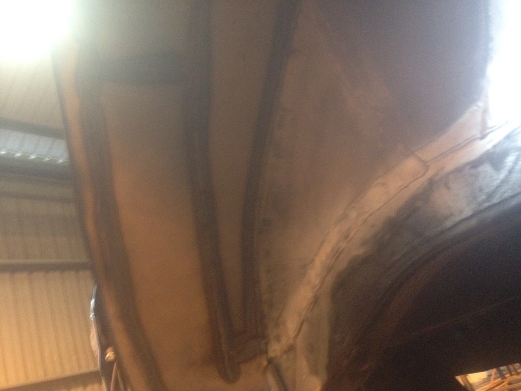

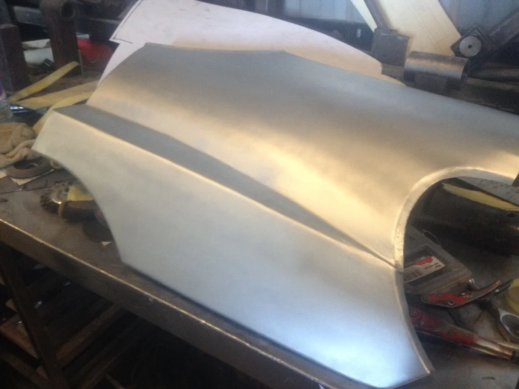

More forming of the rear door jam and its return. Here you can see how much of the rear wheel well comes into the door aperture again. Also how much the jam has come out to meet the wider track.

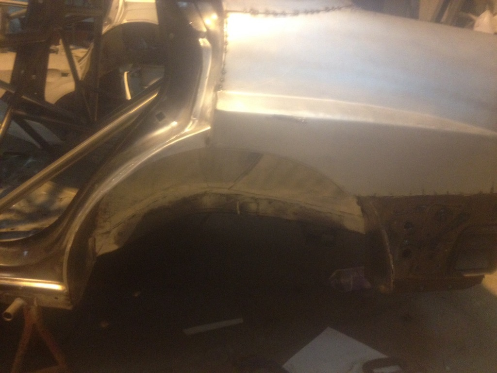

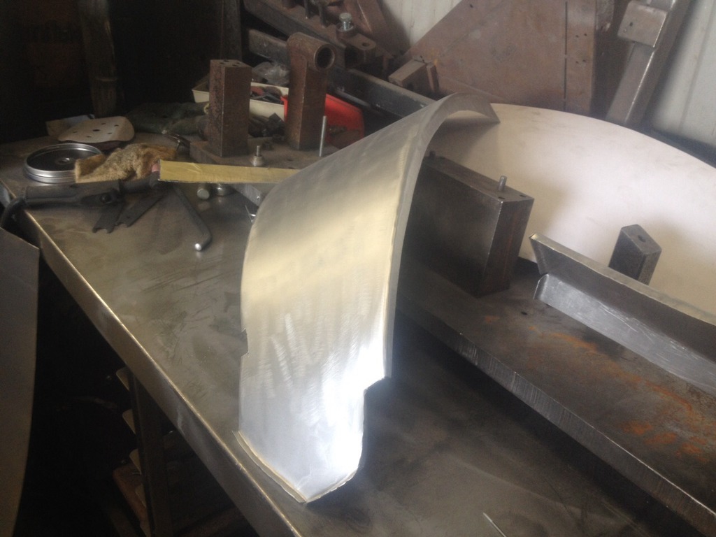

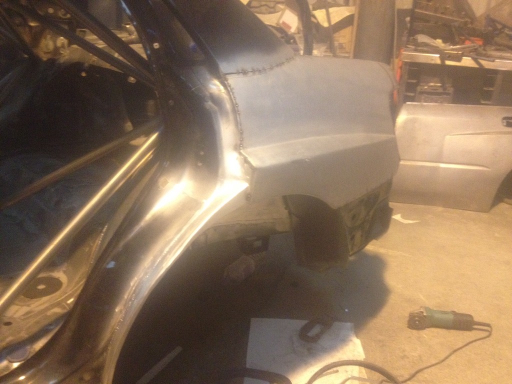

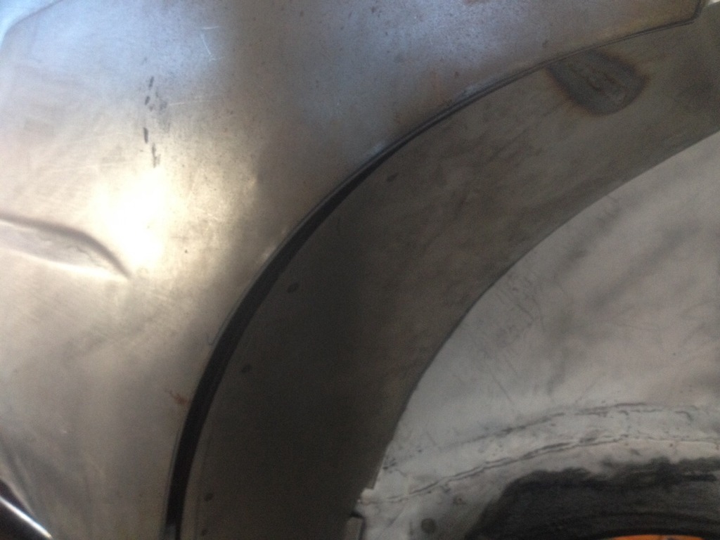

Also more fettling of the rear qtr panel. The rear qtrs aren't far away from going on now.
All of this will then get its final fit and finish along with panel gaps to be set before she goes for paint.

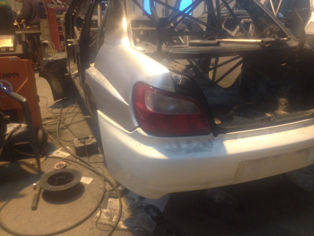

Rear quarters with more finishing.

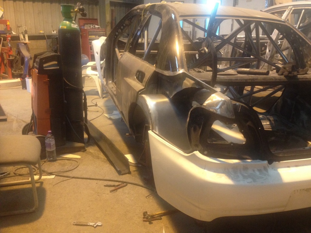

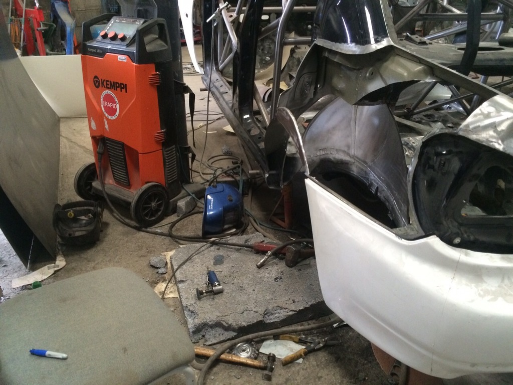

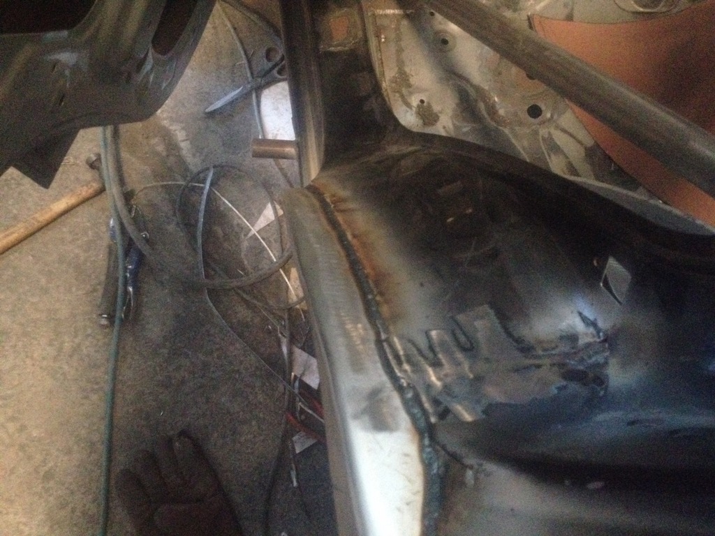

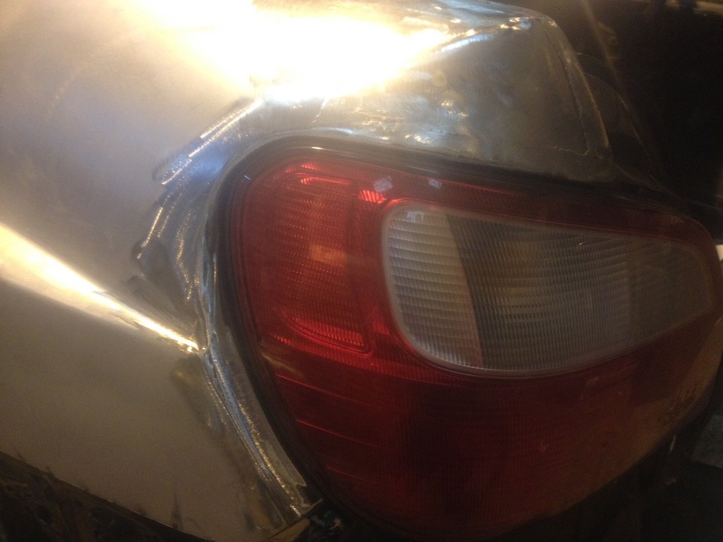

Well today she finally got a rear qtr panel stitched on. Looks so much better to start looking a bit more like a car again.
The panels are bang on the OEM panel gaps which unfortunately shows up how poor the bumper fits. This will be adjusted so it's perfect, rally boys don't care for panel gaps. But we do and it will be perfect.
Hopefully we can find a genuine ex works bumper and it should fit perfectly.

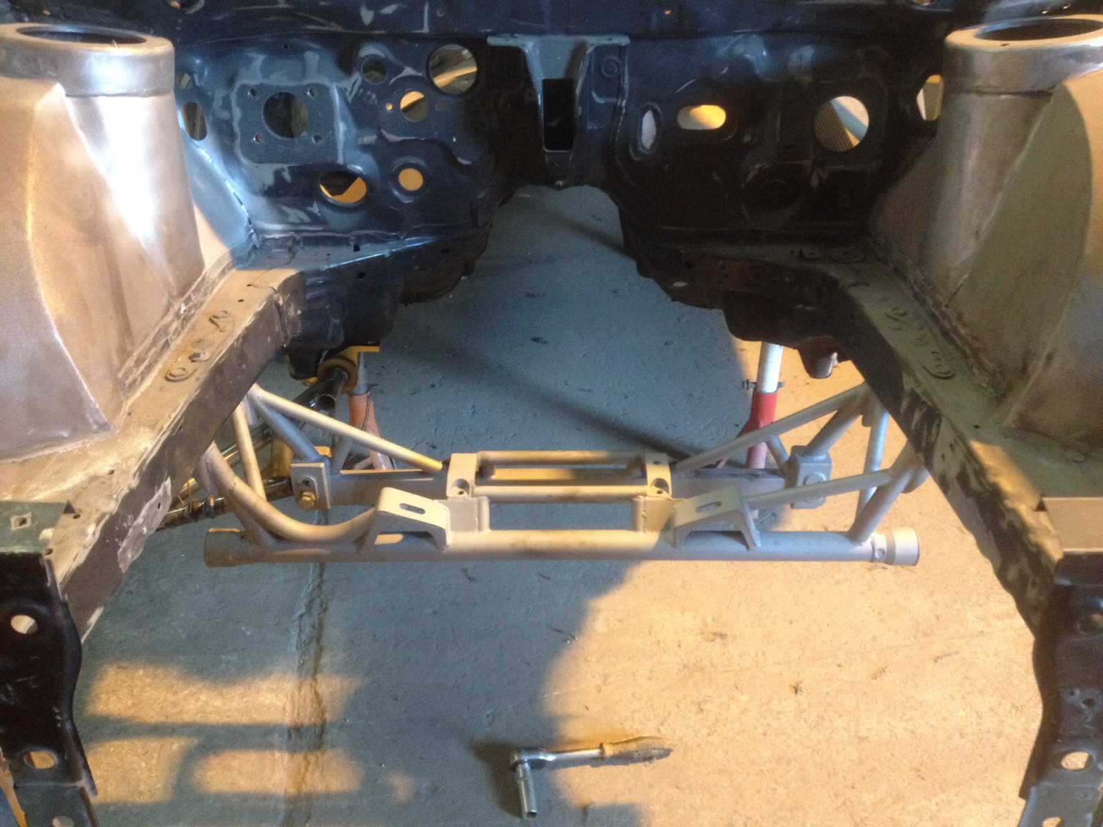

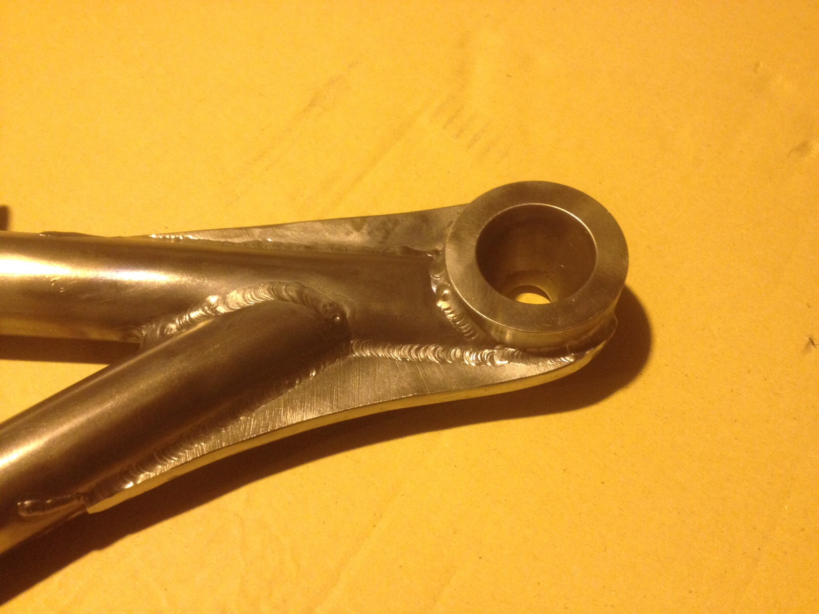

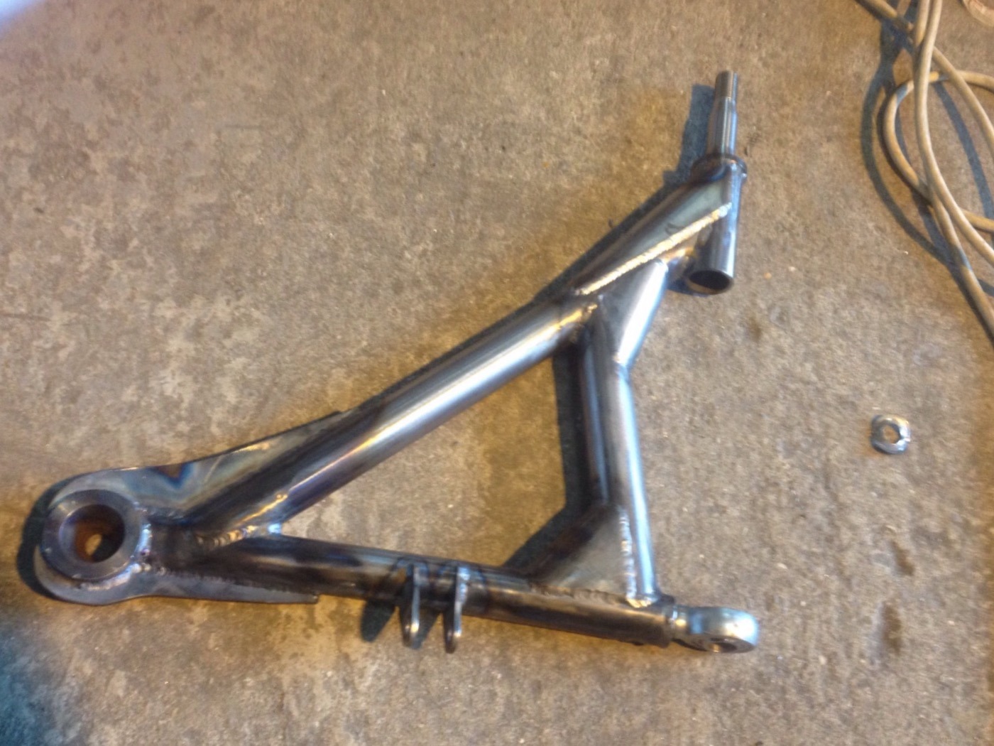

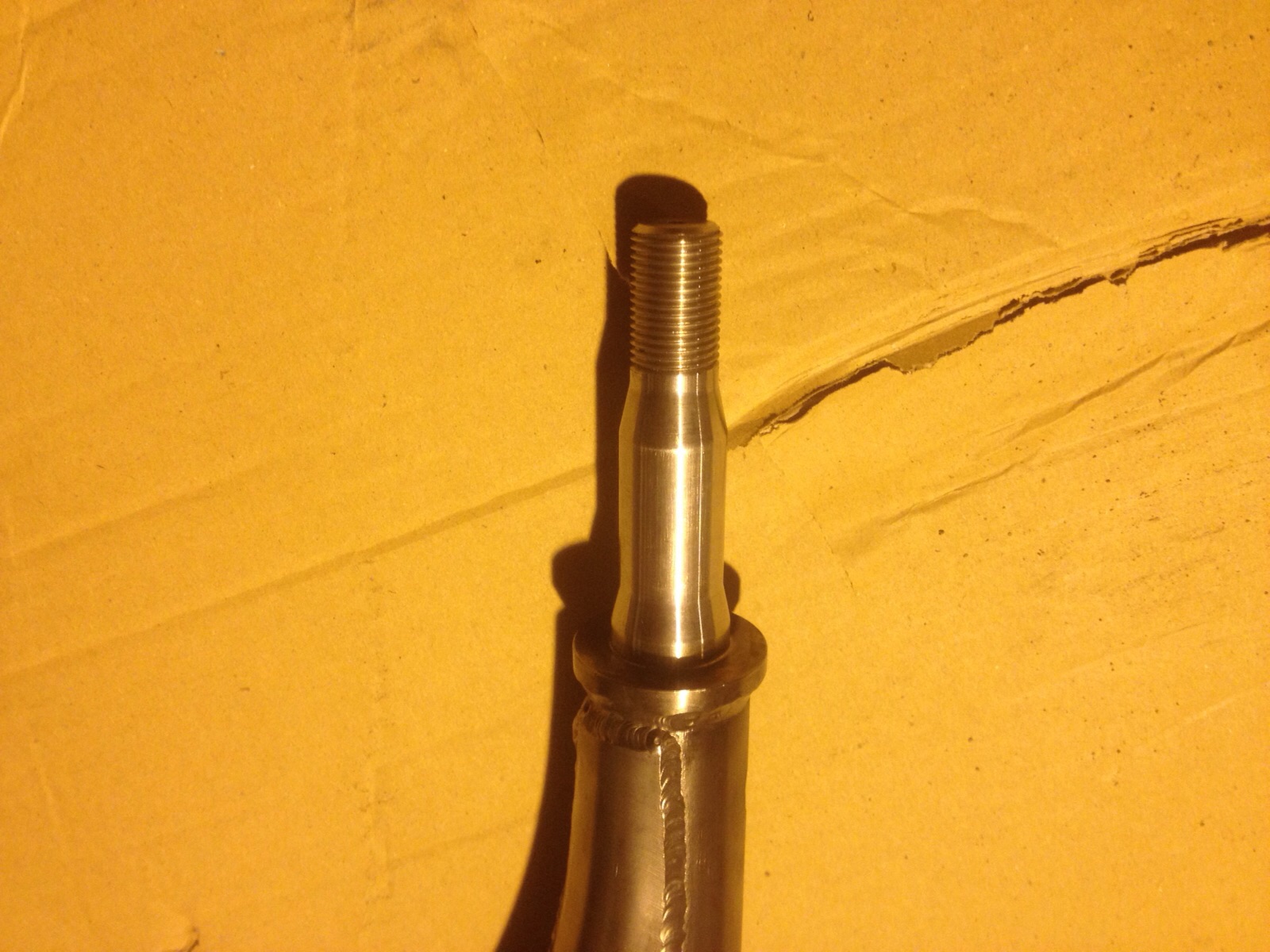

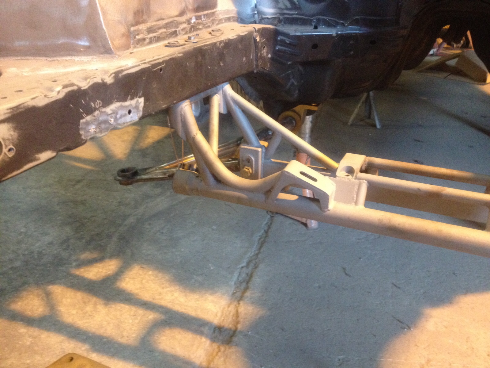

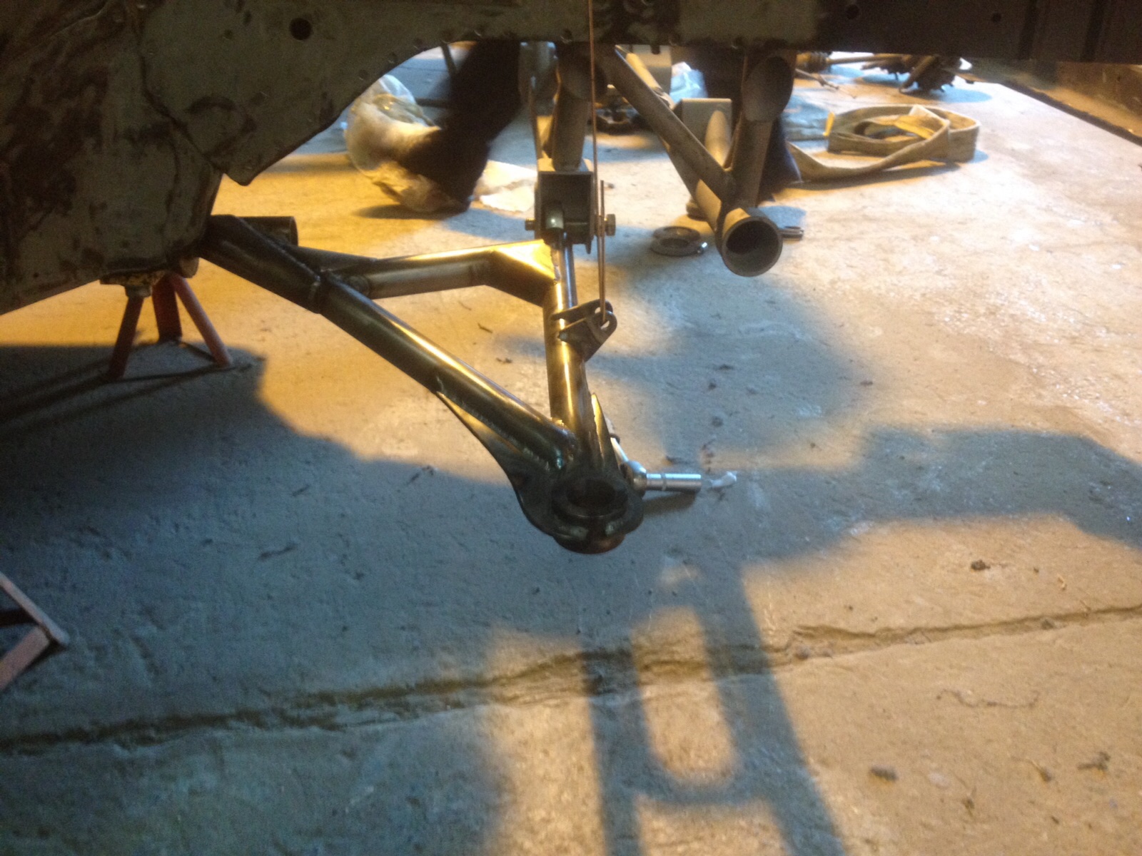

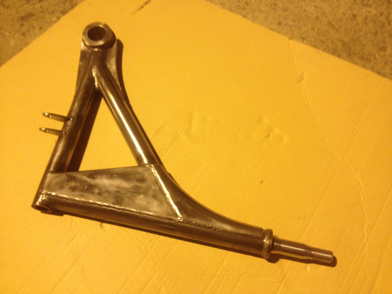

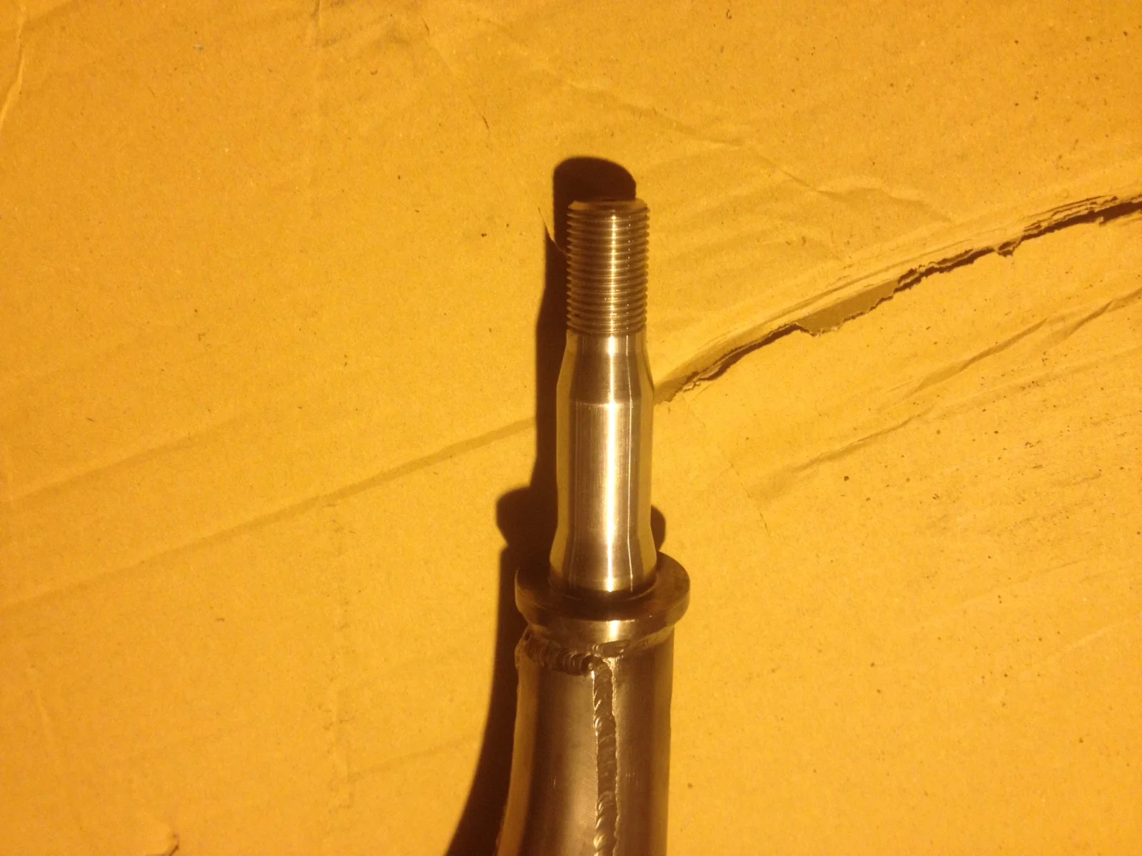

Check out my beautiful new WRC crossmember and S12b inspired TCAs. These are similar spec to the previous design but Dave decided to take a different route to reduce the chances of binding. Custom made to fit the OEM caster block, EN36 steel pins, T45 & S515 construction.
You'll see they're now hanging from a gorgeous T45 WRC lightweight crossmember.
Just love this stuff. :D

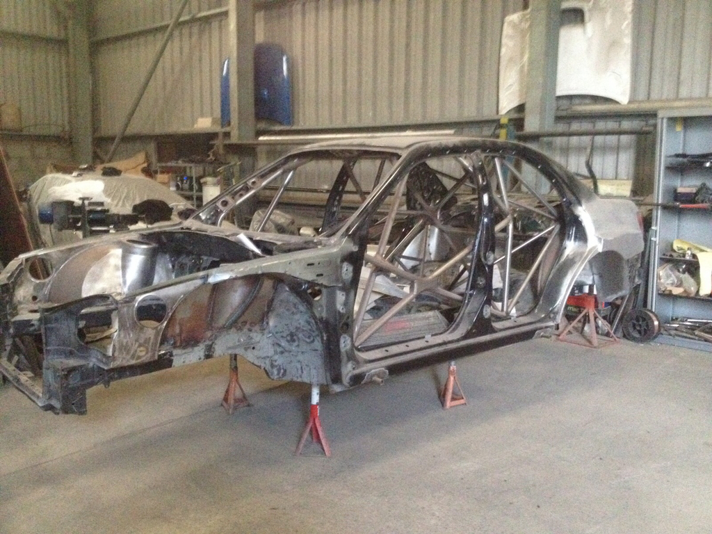

Long overdue sh*tbox update.

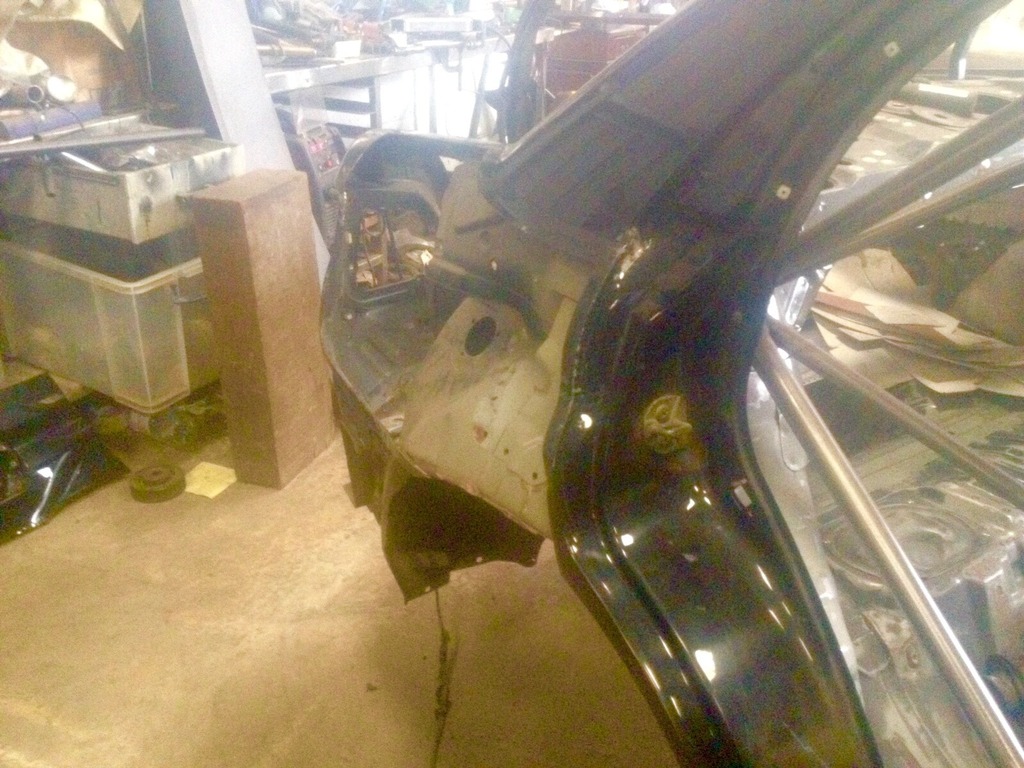

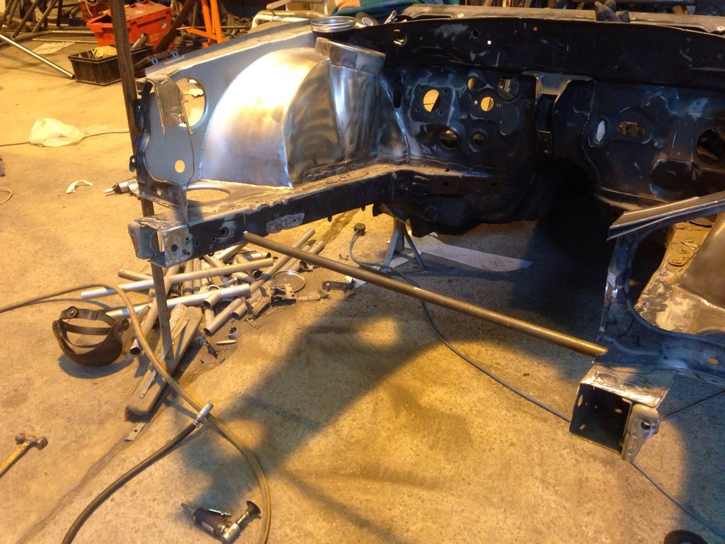

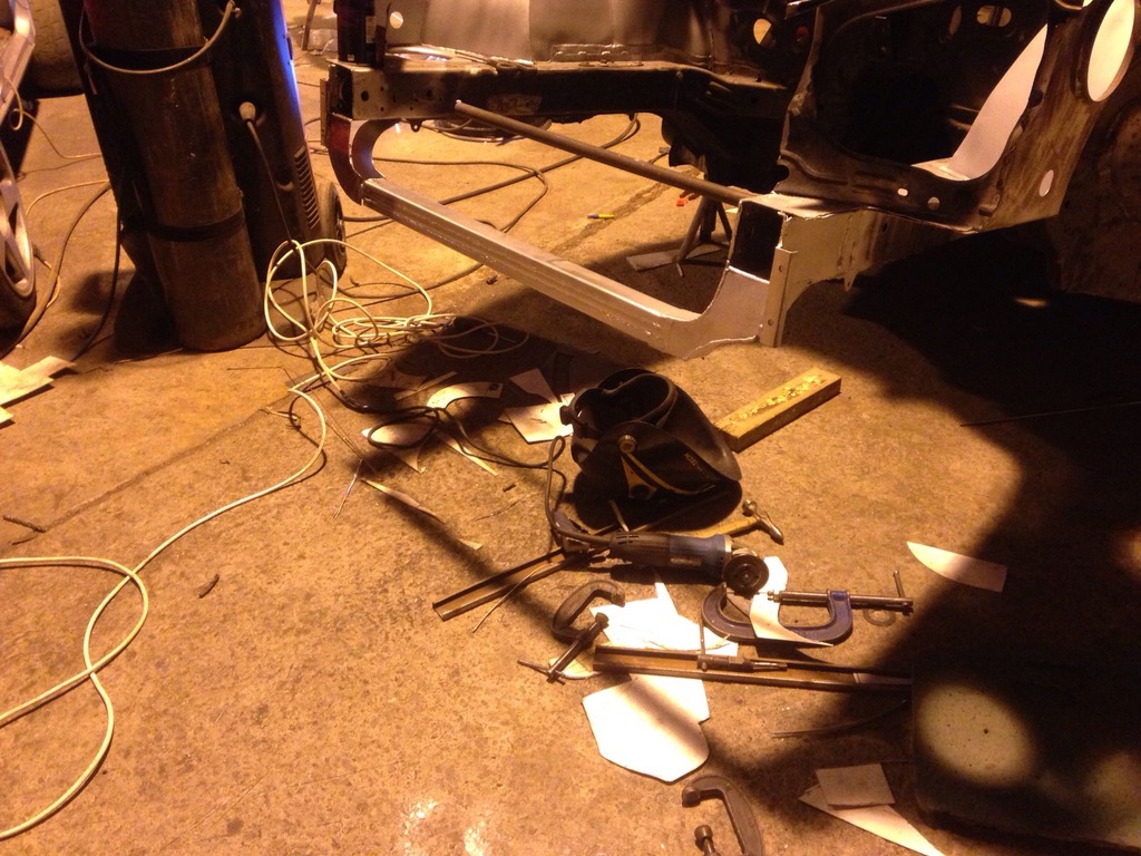

Surprise surprise, Dave bought himself a new grinder so naturally had to cut what was remaining of my front end off. Haha.

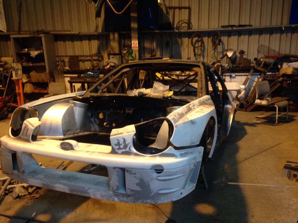

New WRC cross brace going in to hold the bumper and rad. Beautifully hand made in S515 steel by the man himself.

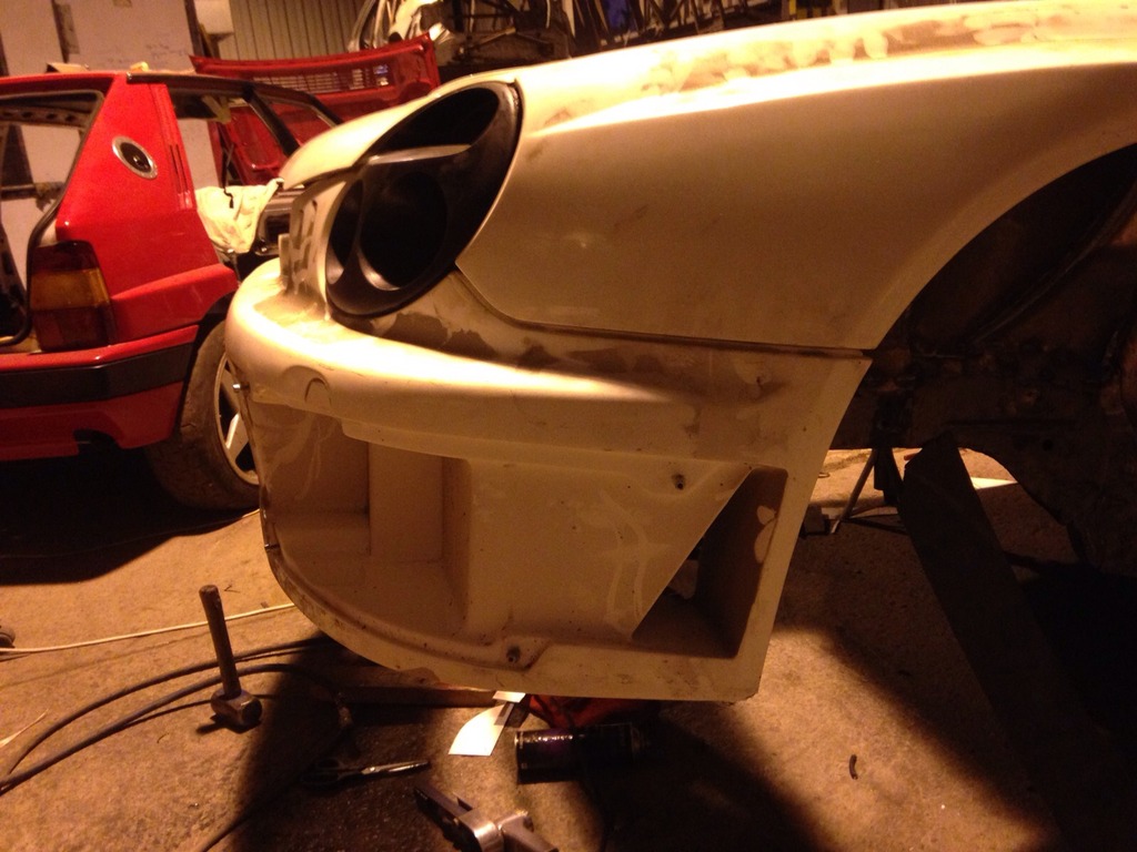

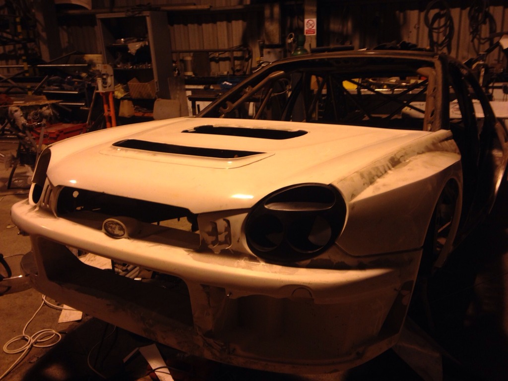

Also had a cheeky mock up with some panels. Obviously all just hanging in place and not fitted but nice to see some idea as to how she will look.
