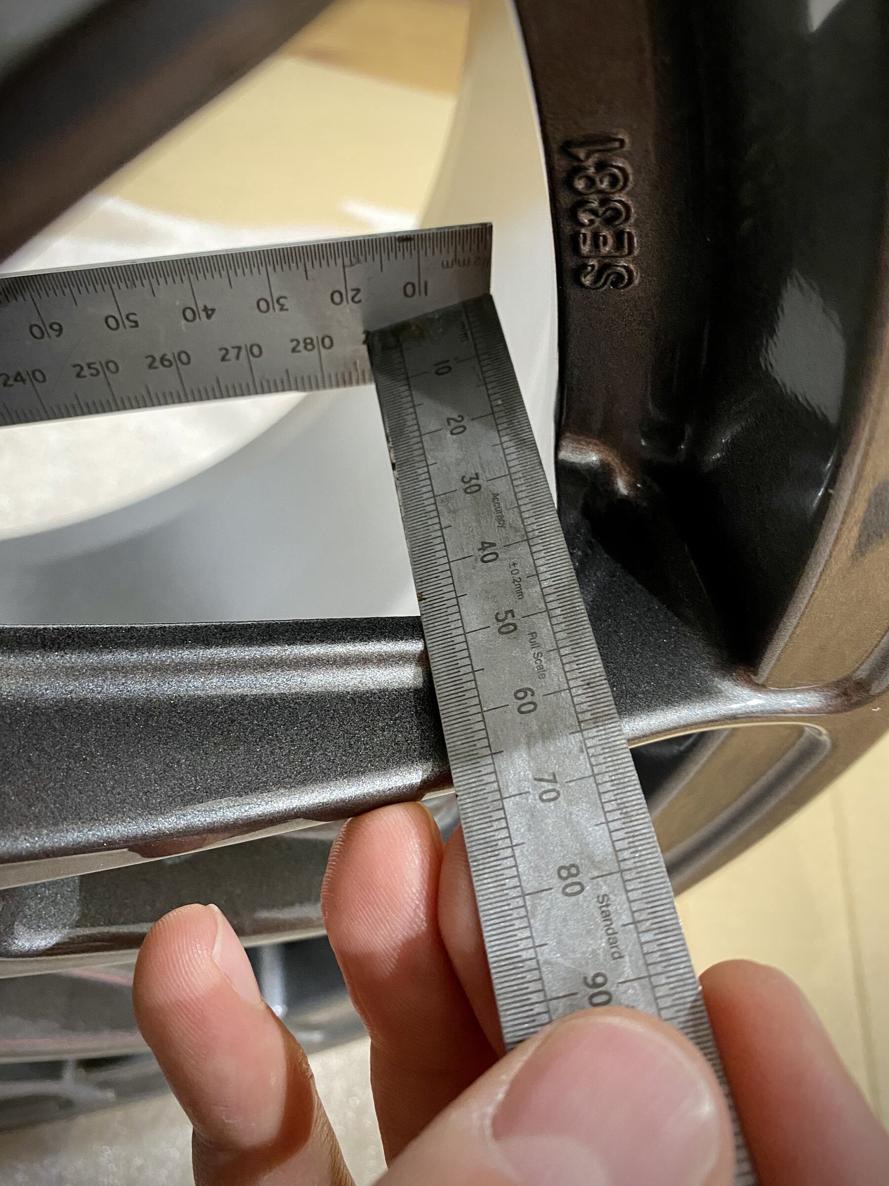

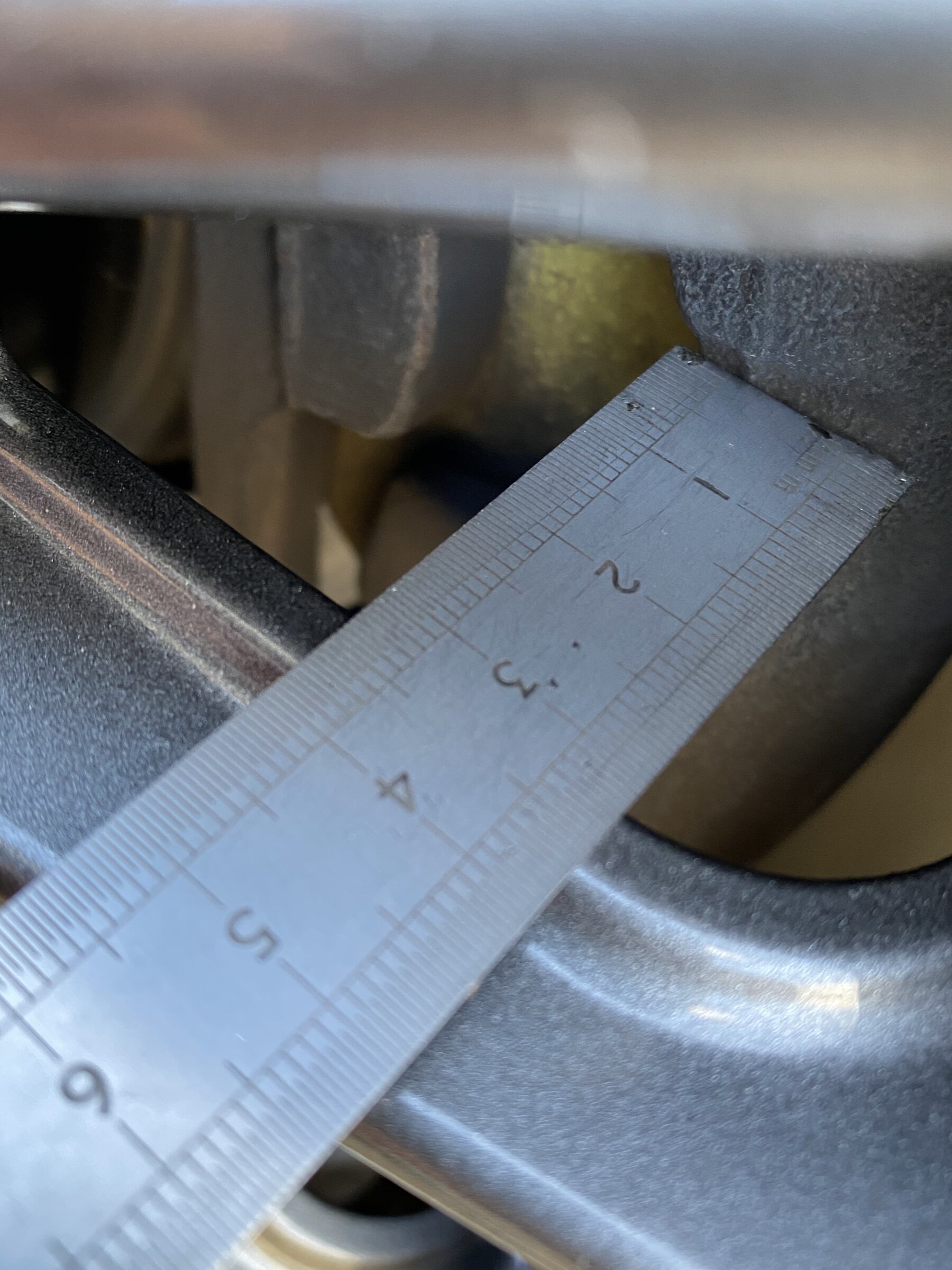

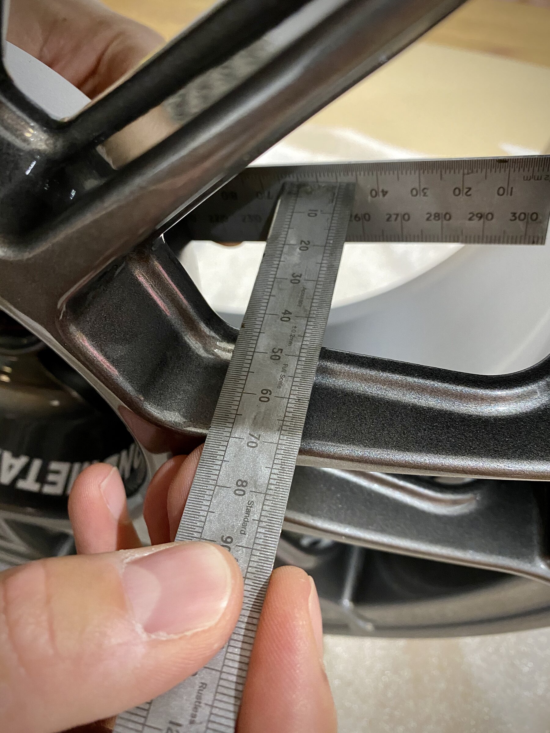

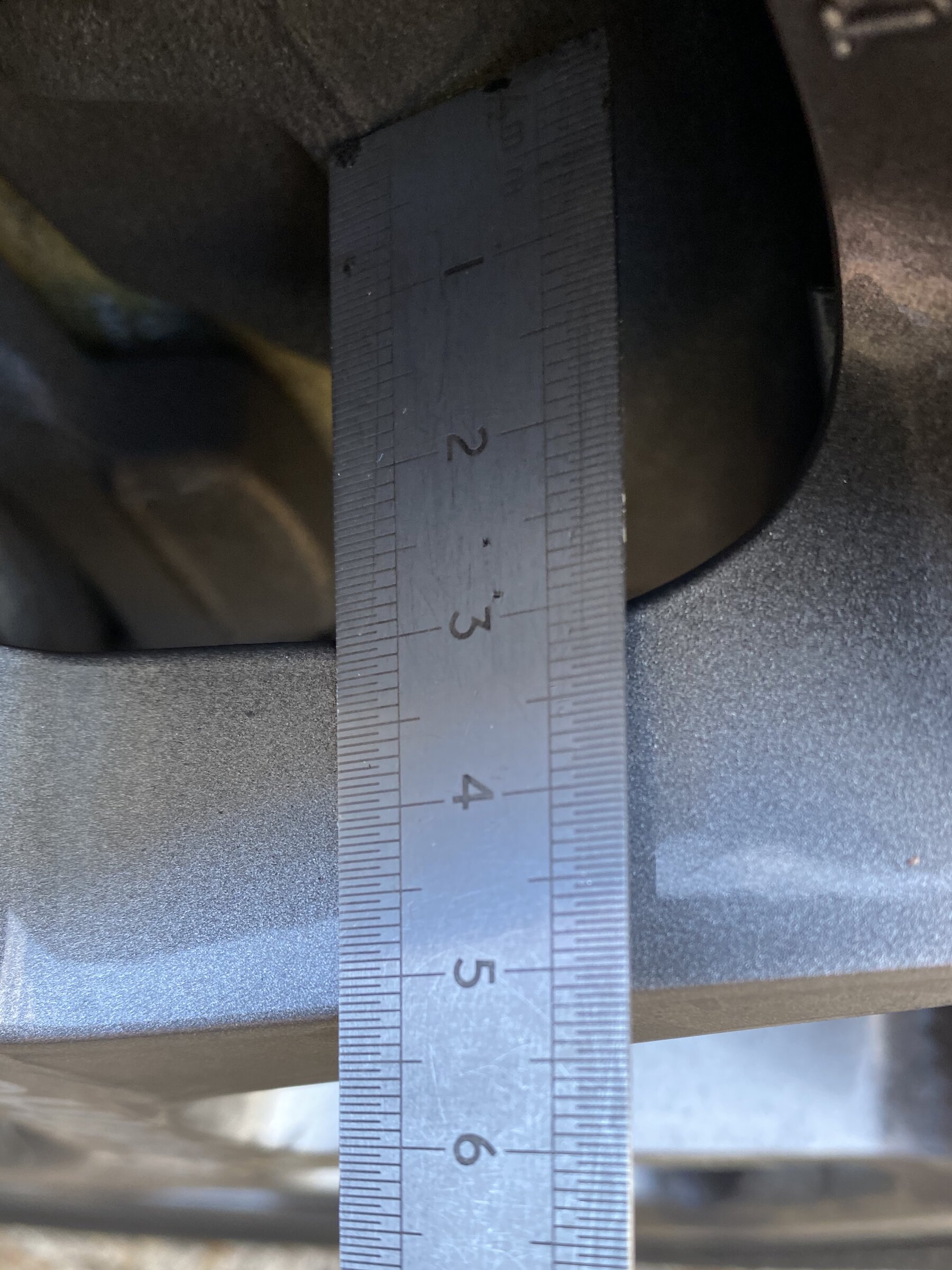

Hope these help dude, I took some basic measurements for you from the hub face.
These are 15x7 ET38.

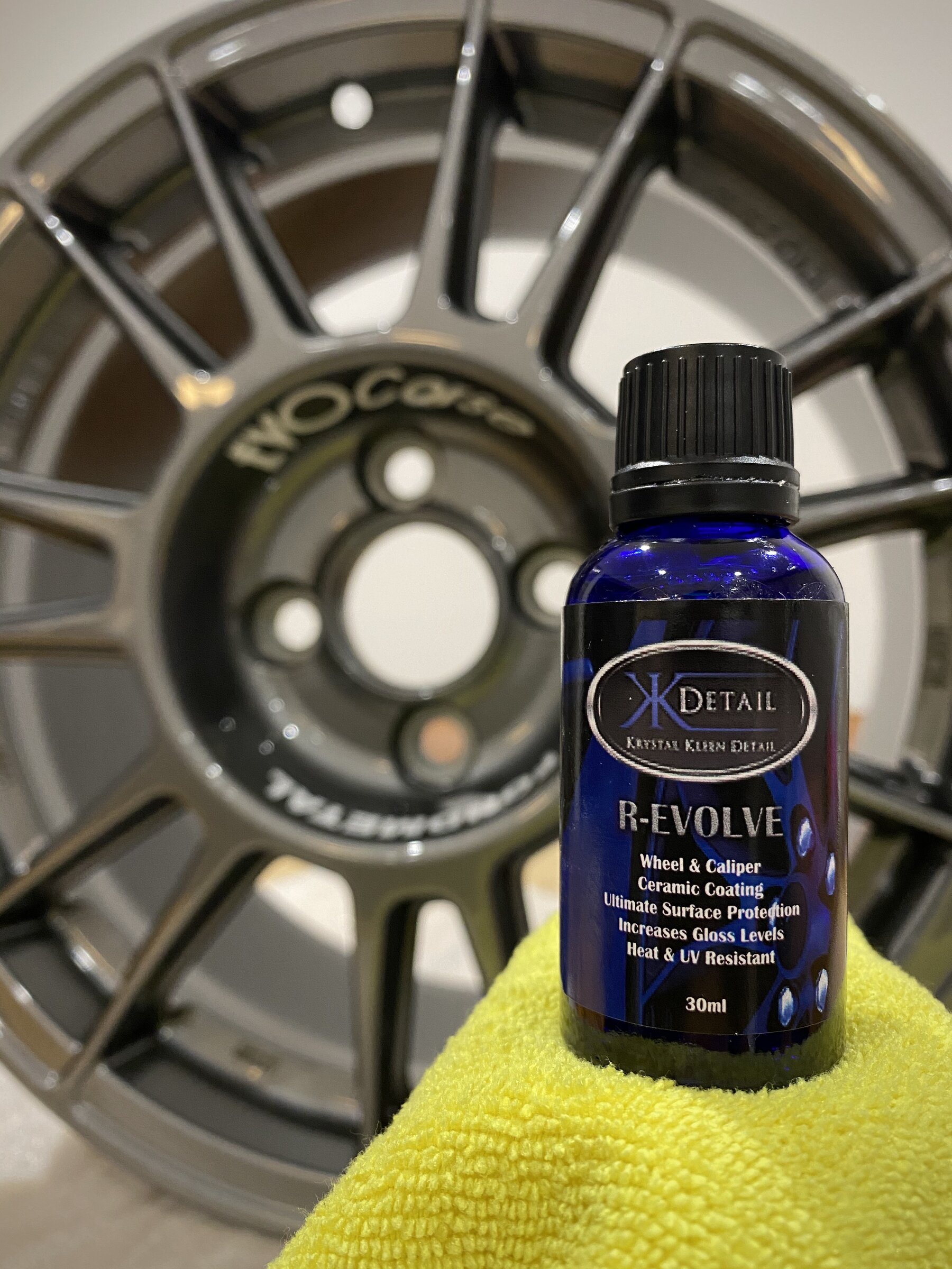

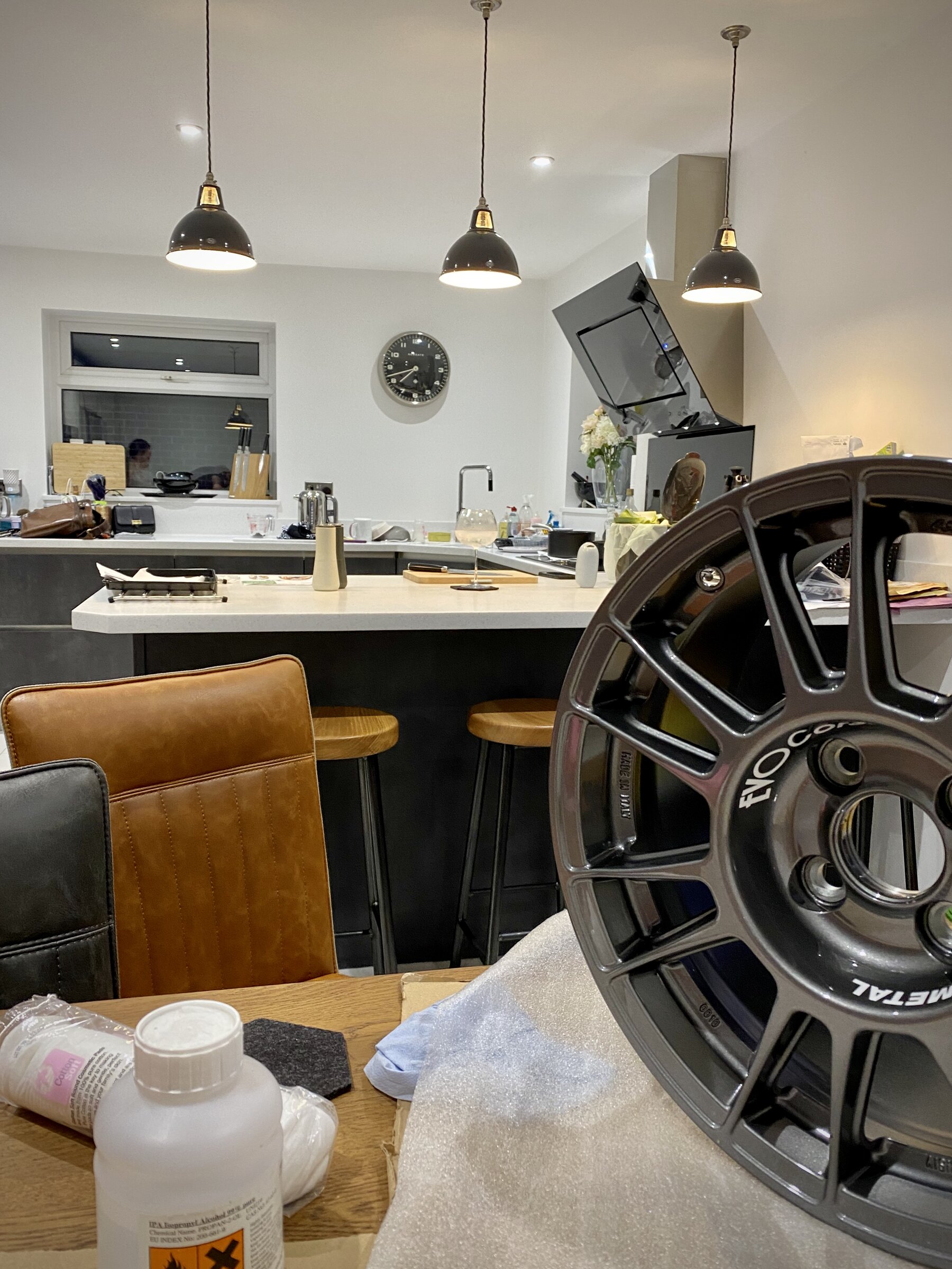

Also got them all sealed up with some KKD Revolve X. Kitchen makes for decent lighting, my Mrs doesn’t even bat an eye anymore. 😅

Gotta say they look superb on the car even without tyres and lows. Appreciate checking the clearance. I think with a 280mm milled mounting Brembo setup and a 10mm~ spacer they should fit fine.
Yeah i think you may even get away with a 5mm spacer for the Brembos. Brembos to me look like a rather bulky caliper so i think if i was going to go larger, id look at the offerings from AP, Wilwood maybe?
The Brembos only because of the plentiful pad choices available and the AP's for that matter. I had a set of wilwoods and from memory pad choice is somewhat limited in price value terms and also the piston diameter and pad size of the wilwoods in comparison to the Brembos are smaller. Having said that if you wanted a smaller profile caliper to suit a larger variety of wheels without having to run spacers they tick the box.
Agree pad choice is a big factor. Just wish the Brembos were a cleaner looking caliper. Having said that, the stock setup with good cooling has never let me down unless it has crap pads. I have no issues with the Pagids fitted except theyre dusty lol.

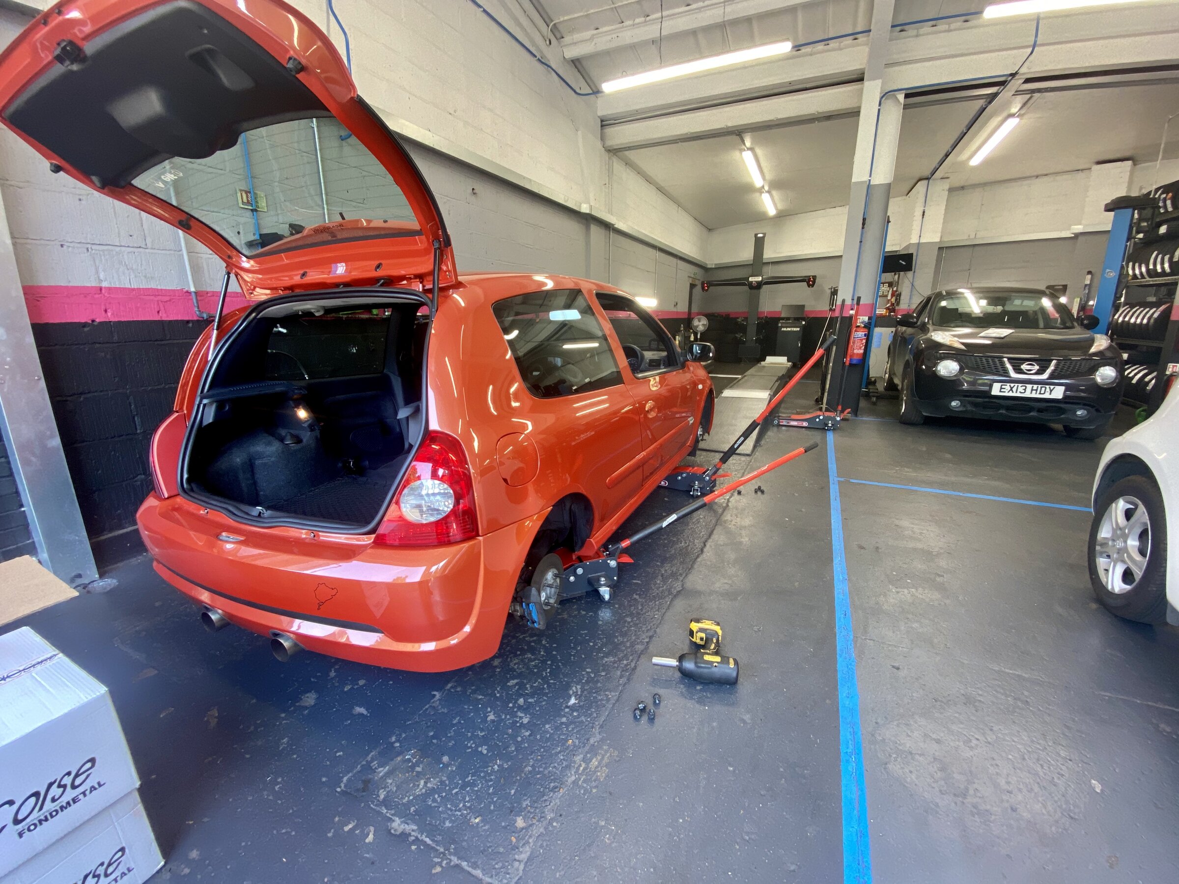

So then i removed the wheel myself and made the 3 hour round trip to Ruislip Tyres to get Rich (a mate of mine) to do a £10 puncture. All because i couldnt handle the stress of someone damaging them again.
Arguably these are only £800 a set but i still dont want the agro of sourcing another and trying to match colours etc blah blah.
Cost is irrespective, we all work hard for what we have in life, and i just want someone to do a proper job.

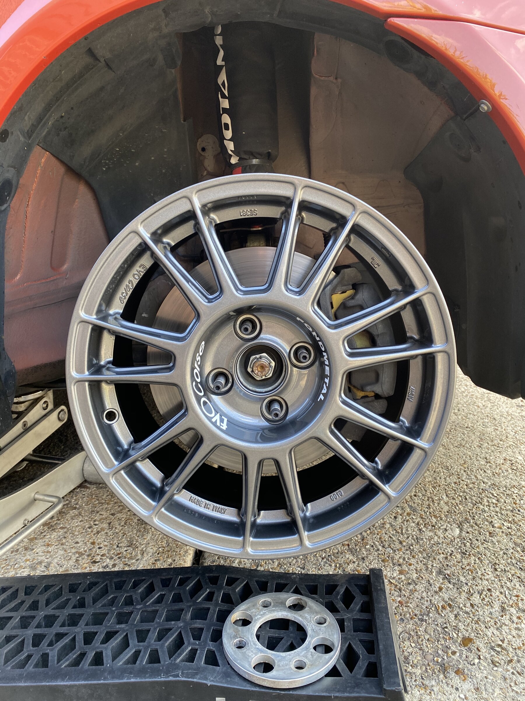

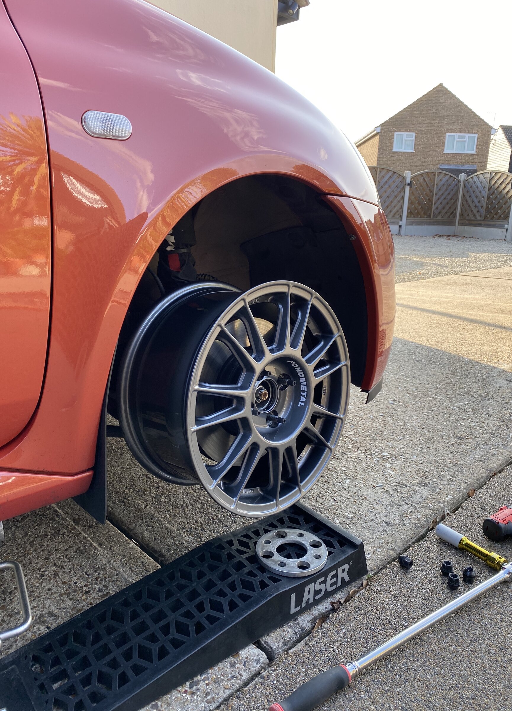

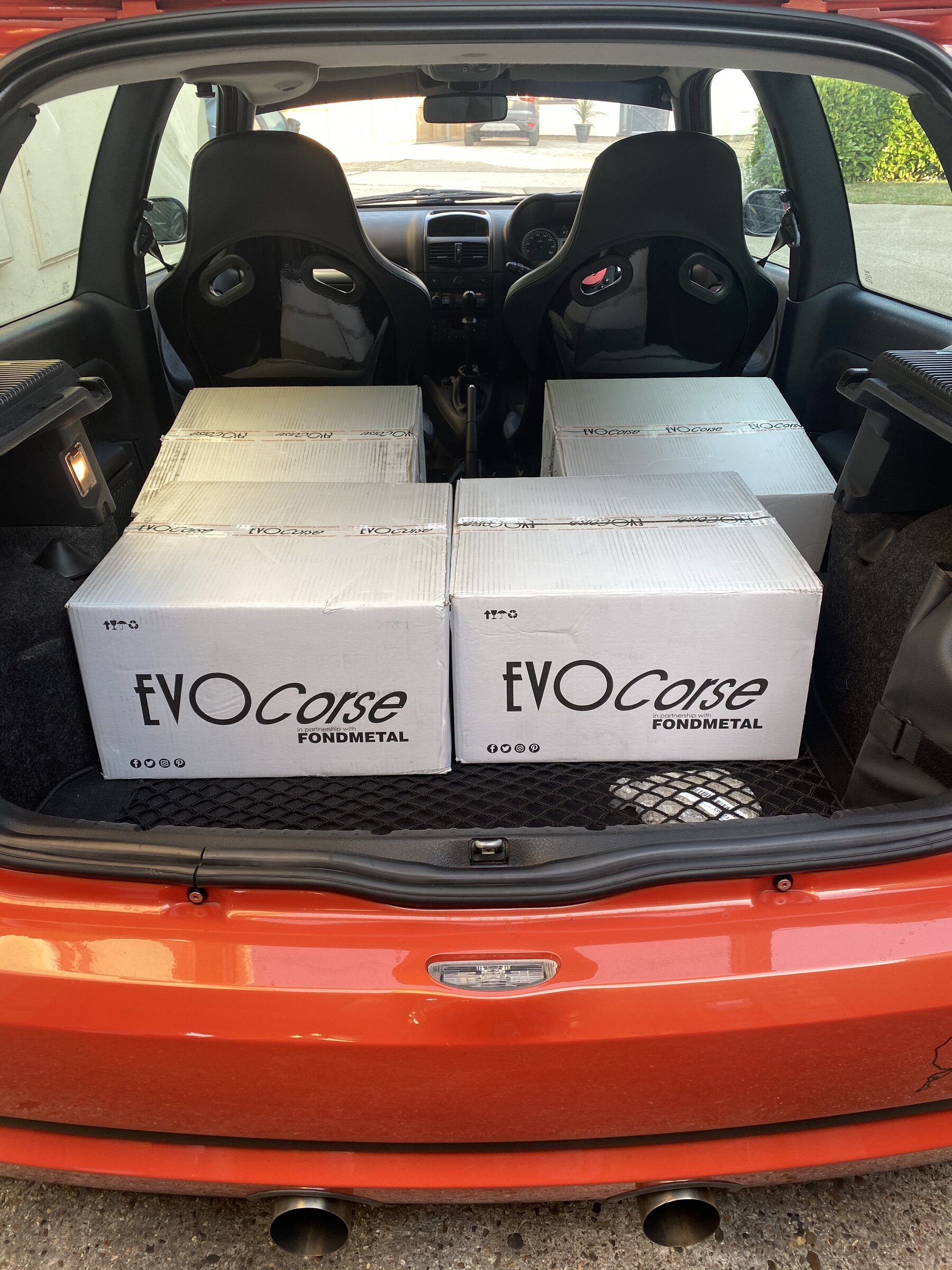

So the lunacy continues as i made the 3 hour round trip over to see Rich @ Ruislip Tyres today to get the EVOs fitted.
Exceptional service as always from him taking the upmost care in everything he does. If you're over that way i can highly reccommend him, as a good tyre fitter is like golddust these days.
Approx 3kg per corner lost with these over the 2118s fitted and i have to say, so far im rather pleased. Ive fitted new EVO Corse motorsport spec extended lug nuts too, however on the front these consume the whole stud, so i may add some longer studs here to utilise the whole thread in the lugnut.

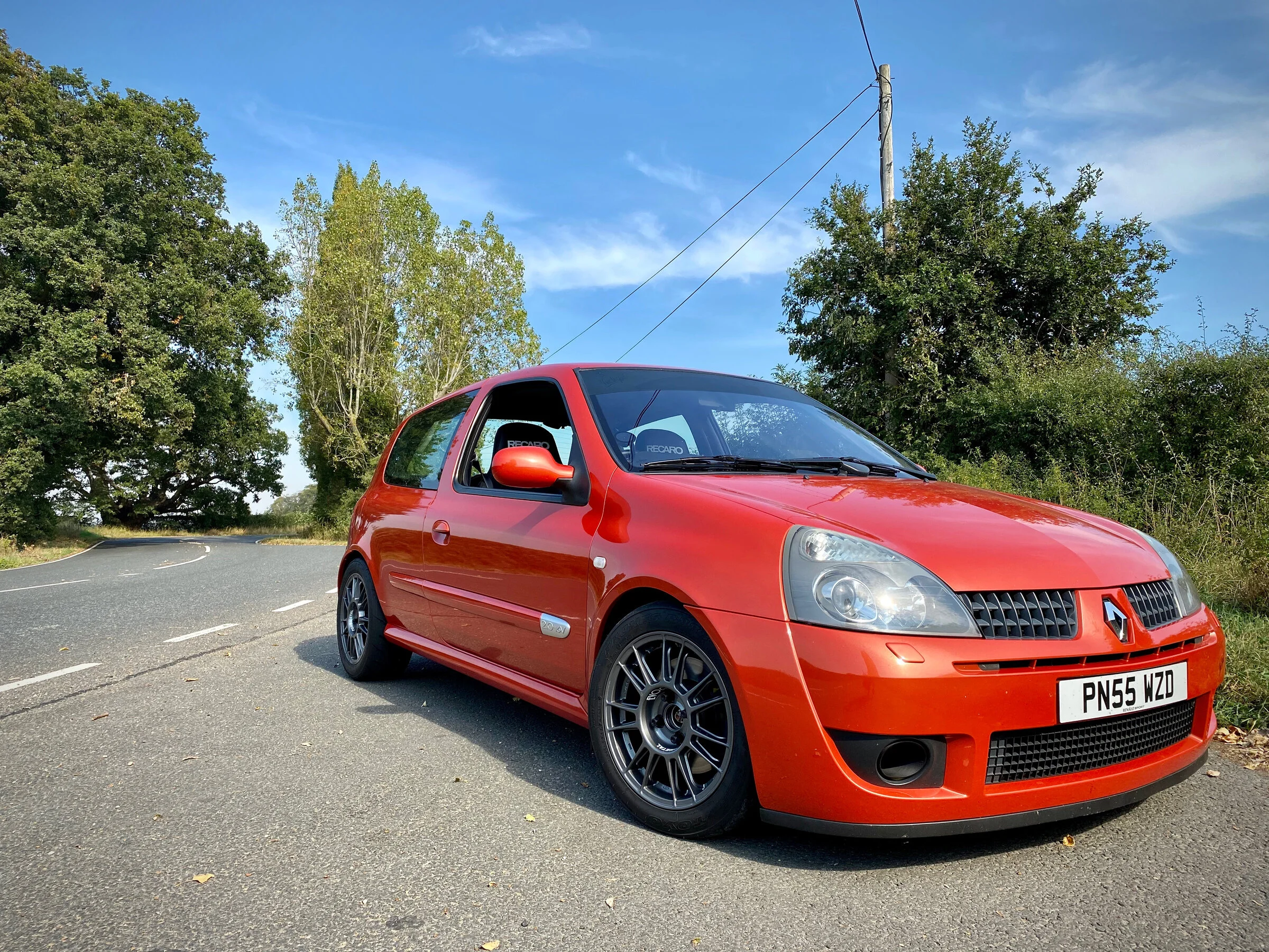

So I wanted to hate these wheels mate, but sadly I don’t! Bravo, the pontificating and homework worked wonders they look great.
kept us entertained though buddy! Made a change from the ‘so today I fitted a new air freshener’ drivel the likes of me post In their project threads 😂
seriously I enjoyed the thought process, it’s nice to see something new on a clio that actually works.

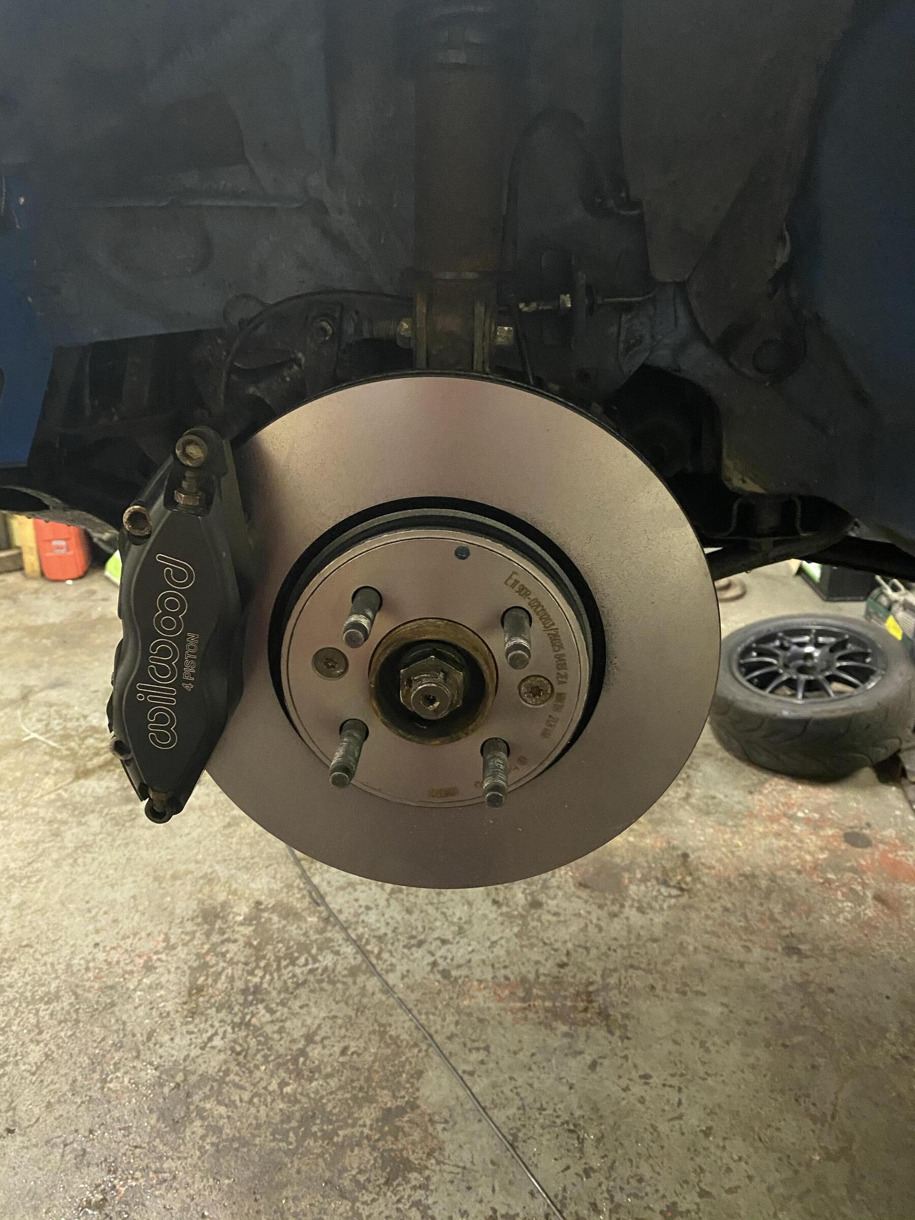

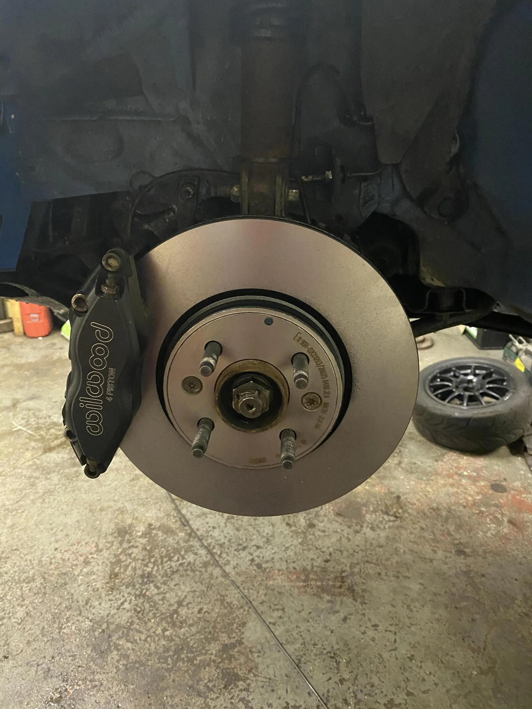

On the subject of brake callipers. I have a set of willwoods. They came on the car and to be honest I’m not sure I would have purchased them as an upgrade but they do look good.
I got a set of DS1.11s for them from RTR parts. They aren’t designed for the callipers but with some cutting down they fit no bother. So pad choice is an issue unless you have a grinder.

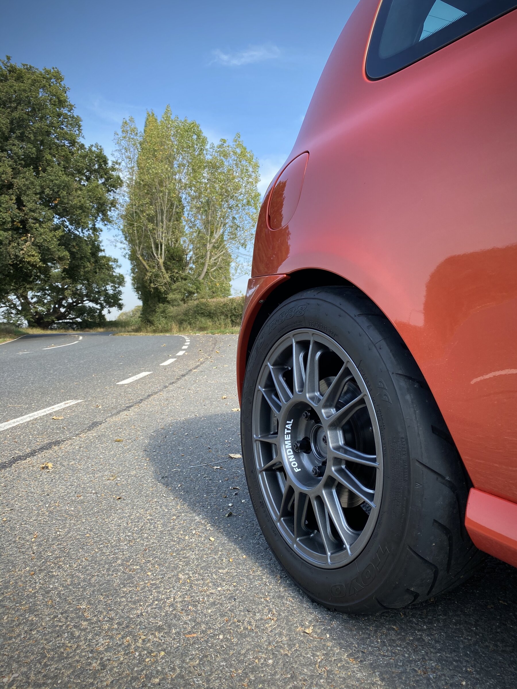

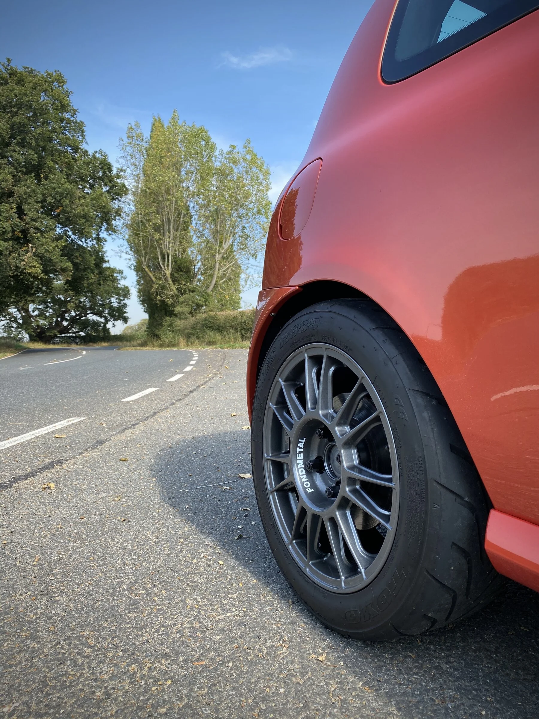

Ive only driven it back from Ruislip and into work so im really only going on first impressions. There are some country lanes near me with some quite agressive undulations, if you drive them *cough* briskly, you can feel the damper starting to lose control of the wheel and tyre. The car will have a skip and a bit of a shimmy. You feel yourself holding on to the steering wheel tightly to control the wheel mass from altering the cars line. Now you notice a significant improvment with lighter steering, more eagerness to respond to steering input and the damper isnt so out of its comfort zone. The car accelerates from standstill, even just pulling off with an ease it didnt have before and the whole thing just feels more responsive. I genuinely dont think its placebo either, its profound.
Overall im pretty pleased, only say overall as i could have gone lighter still, but frankly there isnt a wheel design that i both like and suits the mk2 Clio. Then theres the fact i do really love the classic 2118 aesthetic. Its a superb looking wheel that IMO suits the car so well.
I think youre right, the wheel design does seem to make the 888 look even fatter. Theres also teh fact that these are an ET38 as opposed to my 2118s which were a 43. So now we have another 5mm of poke which seems to really suit it.
The wheels look spot on, with that offset it does fill the guards nicely. I think it suits the car well and all that research has paid off.
