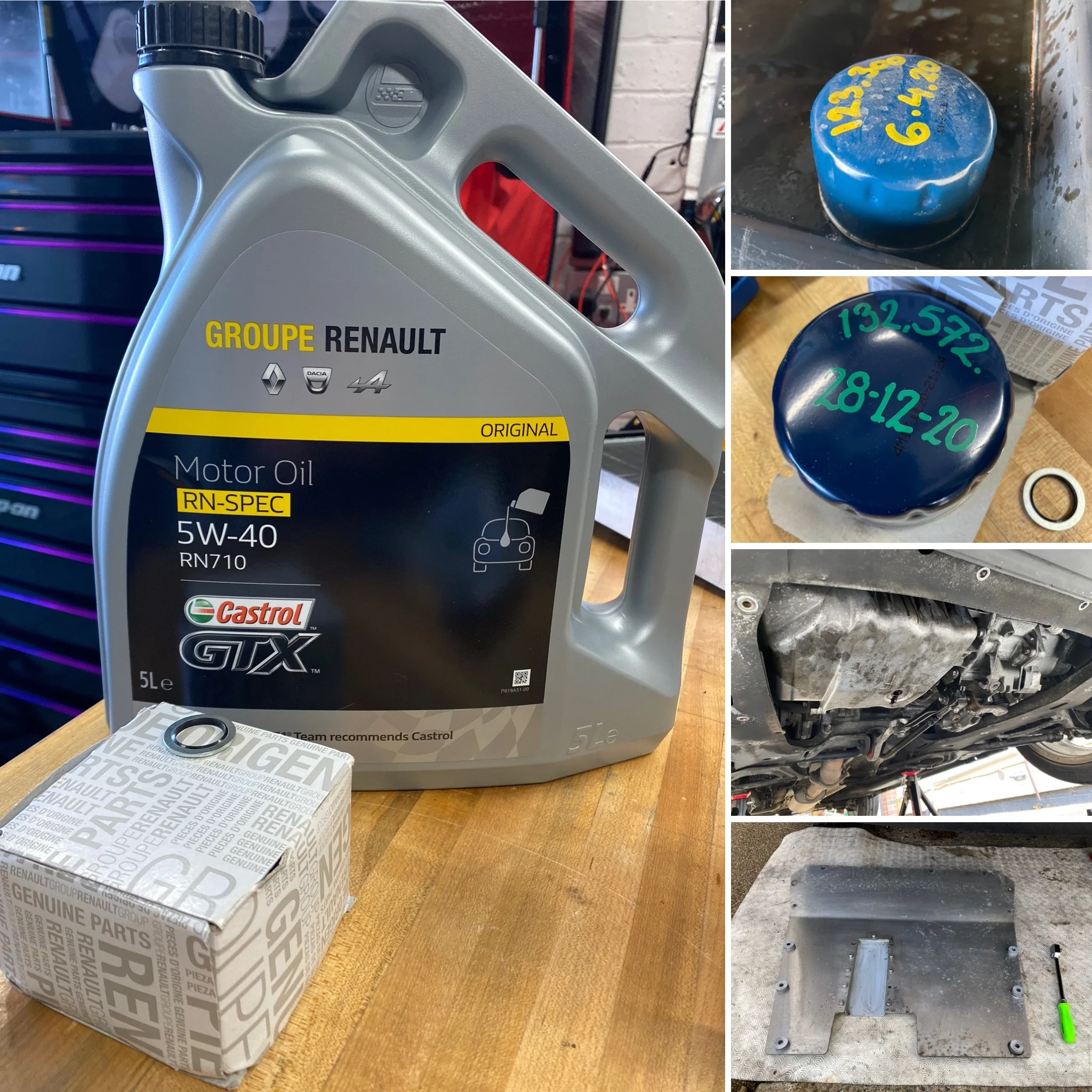

First up was just a straight forward oil service, no issues and the oil removed was still pretty clean.

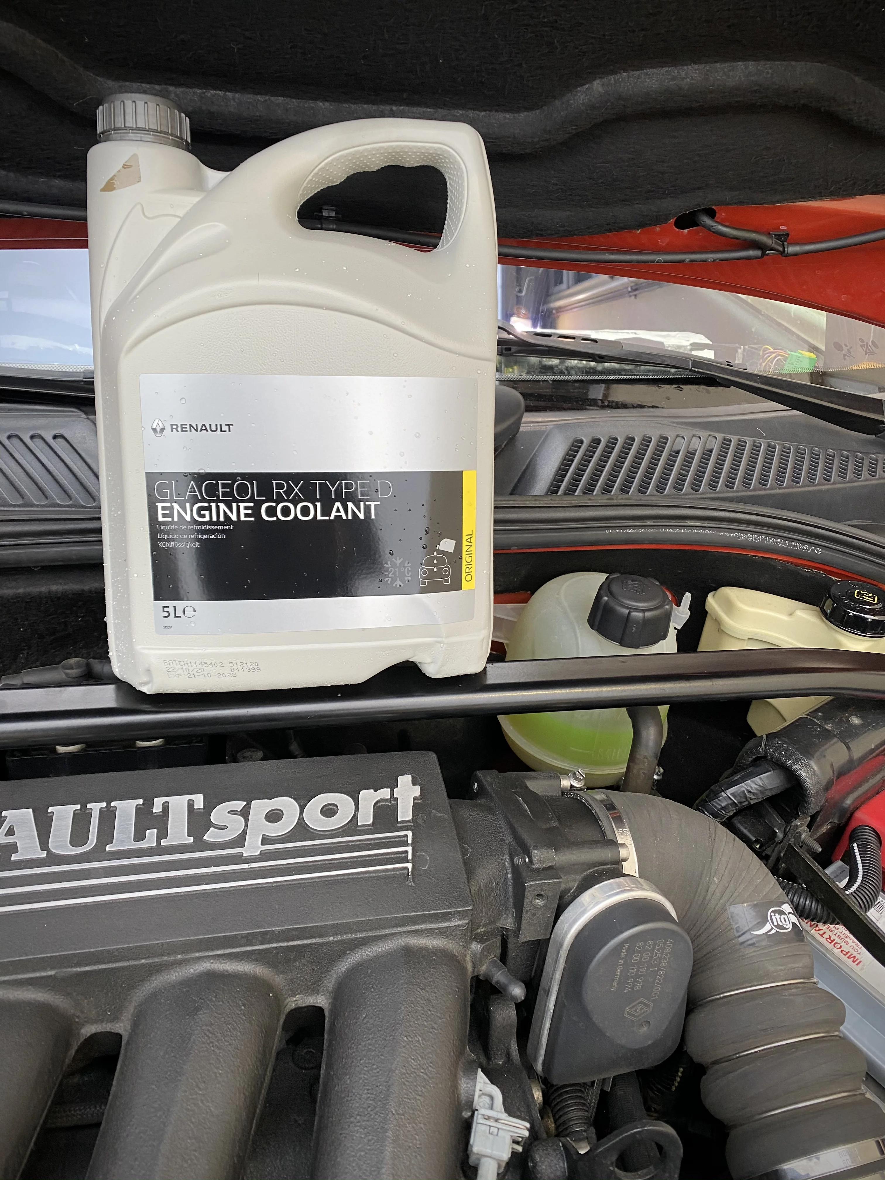

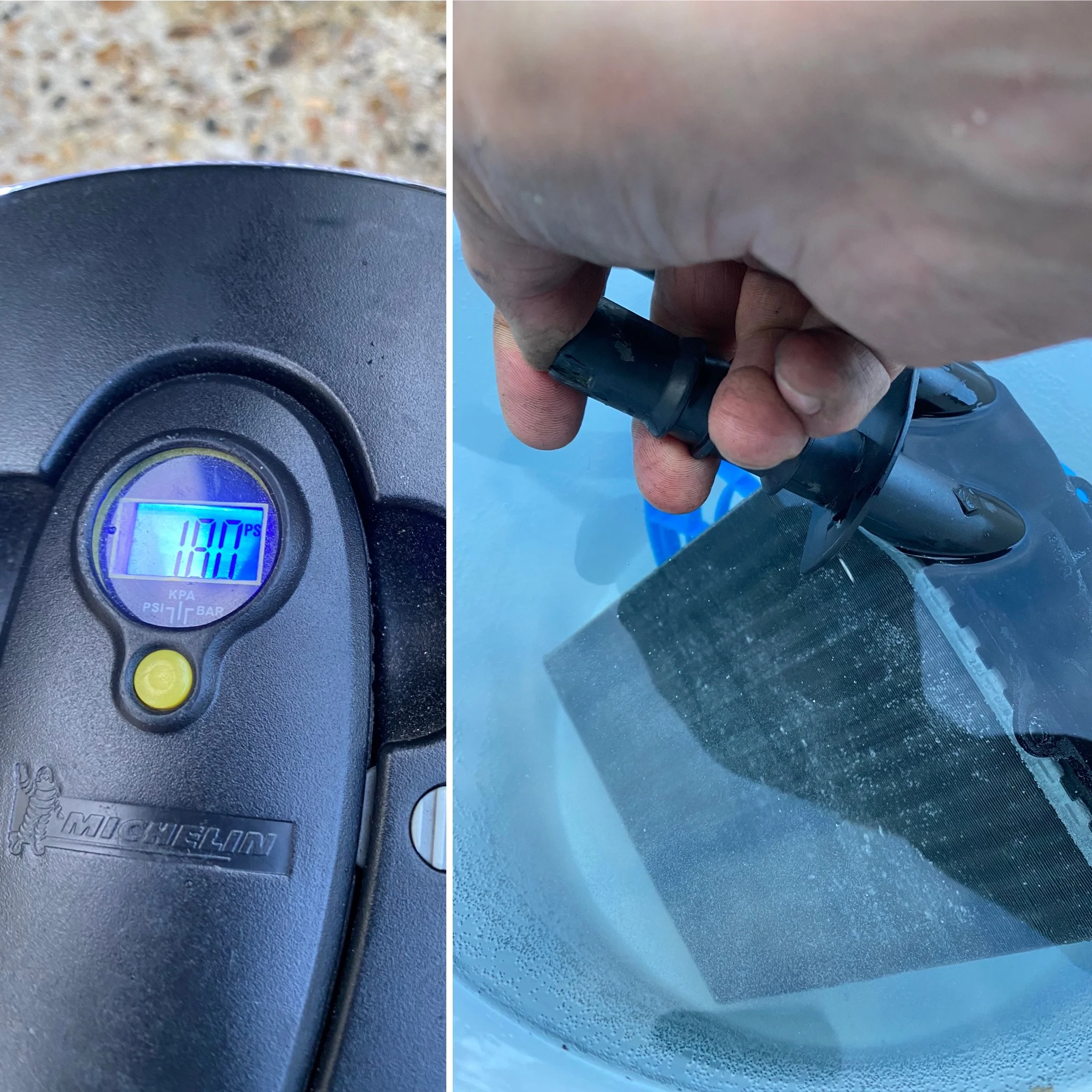

Secondly was a job I had been putting off, investigating a very very slight coolant leak (approx 1cm drop in the expansion tank in approx 3 months) and the occasional slight smell of coolant in the cabin. I have so far been unable to find a leak in the engine bay so put it done to a weep on the matrix.

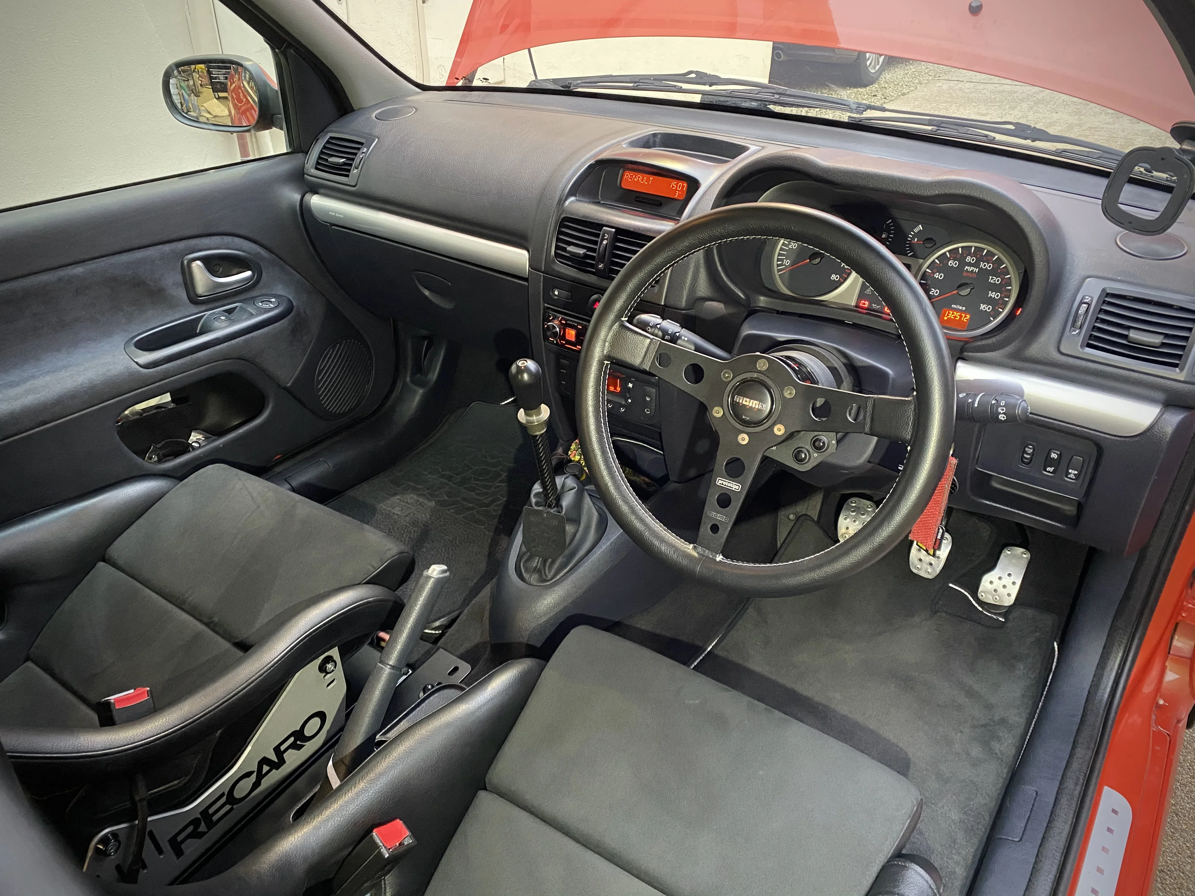

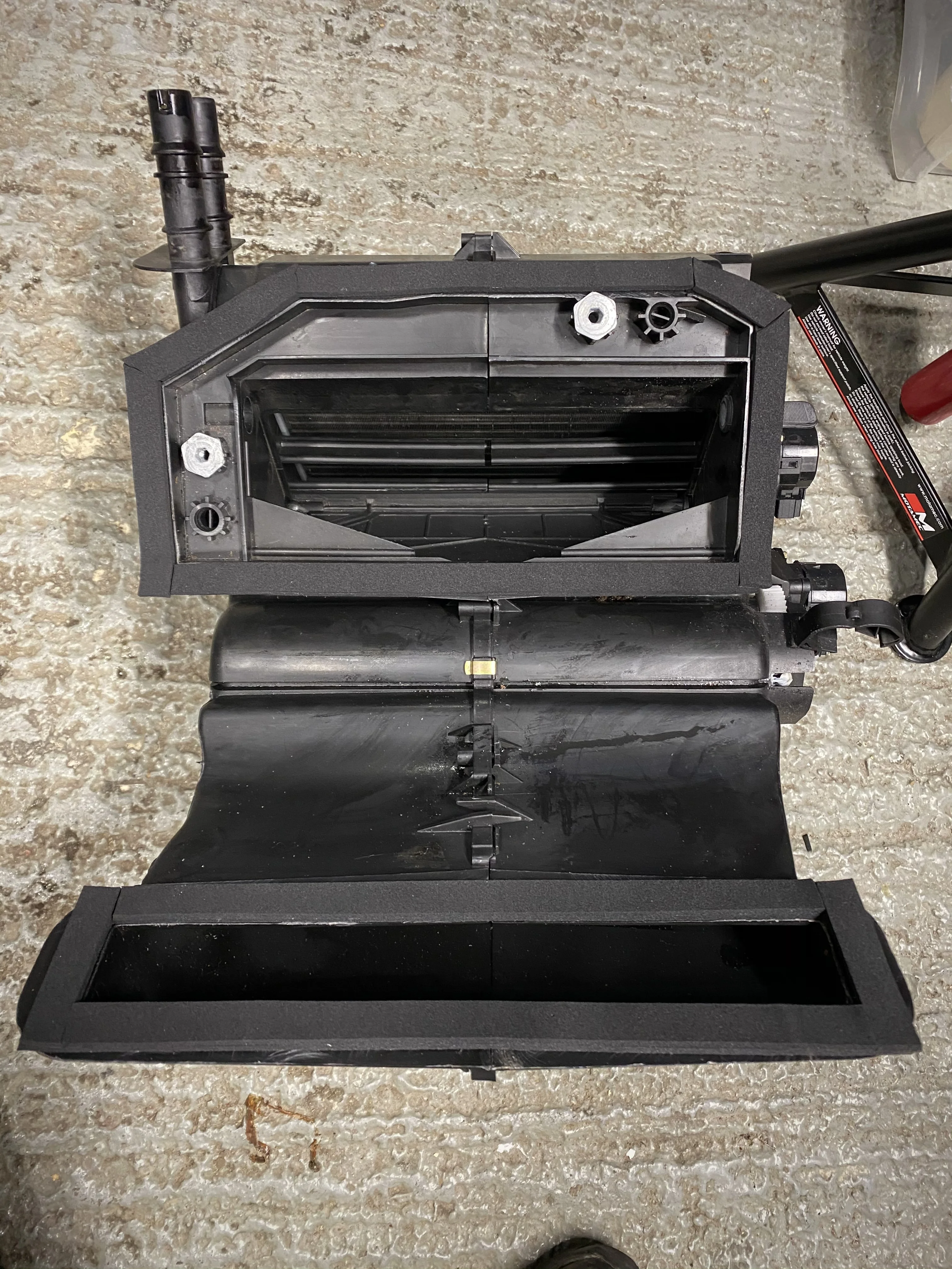

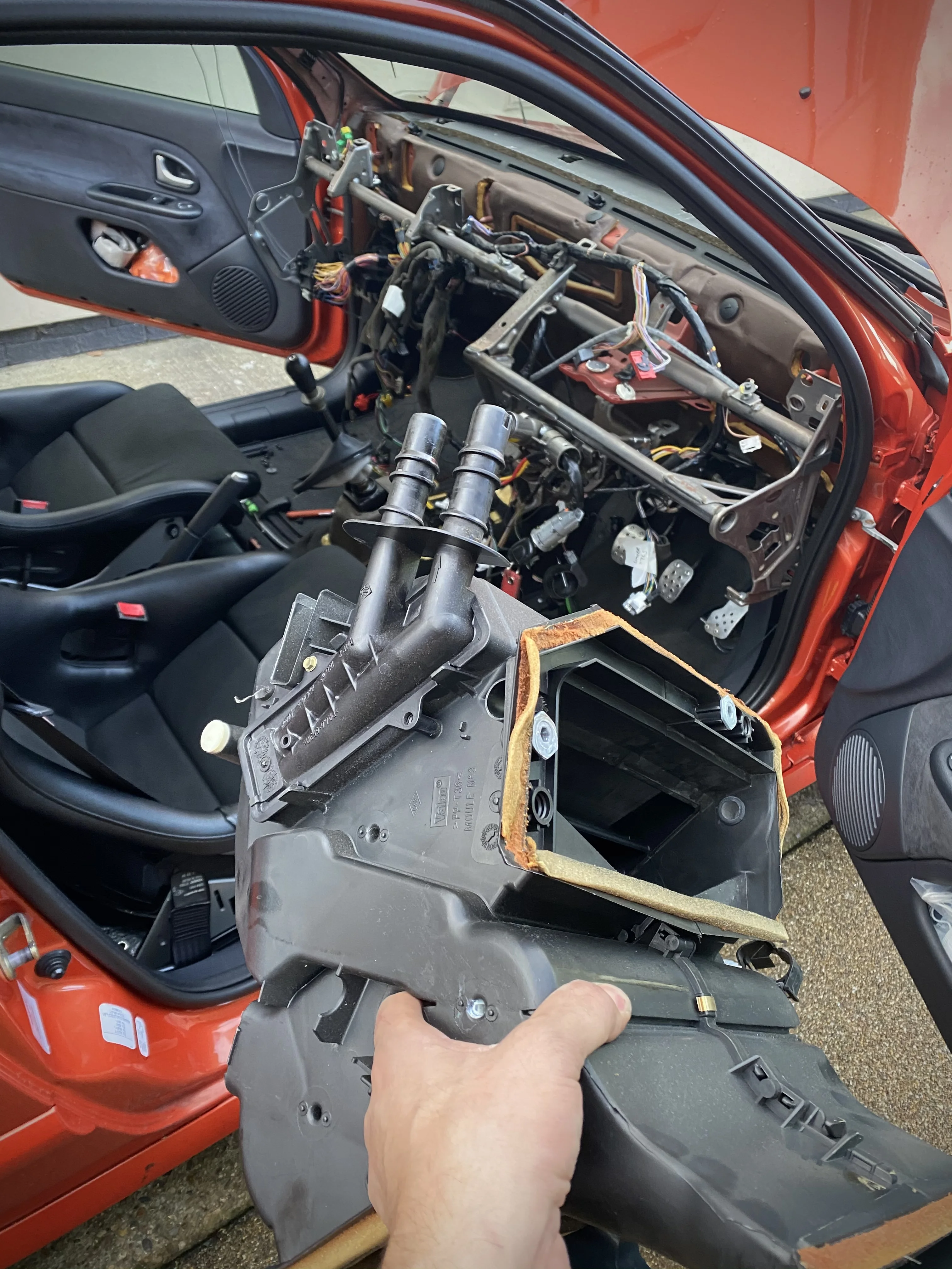

So I set about removing the dash and heater box. Not such a difficult job, but quite time consuming if you take care not to break anything. Unfortunately my efforts were somewhat wasted when I removed a prefect condition matrix. I confirmed this with a pressure test and it was holding a solid 18PSI with zero leaks. Somewhat frustrated I decided to at least give all the wiring a tidy up with some fresh fabric loom tape and added some foam in areas to cut down on squeaks & rattles. I also cleaned and renewed the foam seals on the heater box with some new high density foam strips. Since fitting my Recaros the rear HVAC tubes were removed so the heater box was venting into the centre console. As this is less than ideal I blanked off these apertures with some foil backed kevlar heat sheet. The foil sheet was also useful for sealing the ducting better to hopefully make the whole system more efficient.

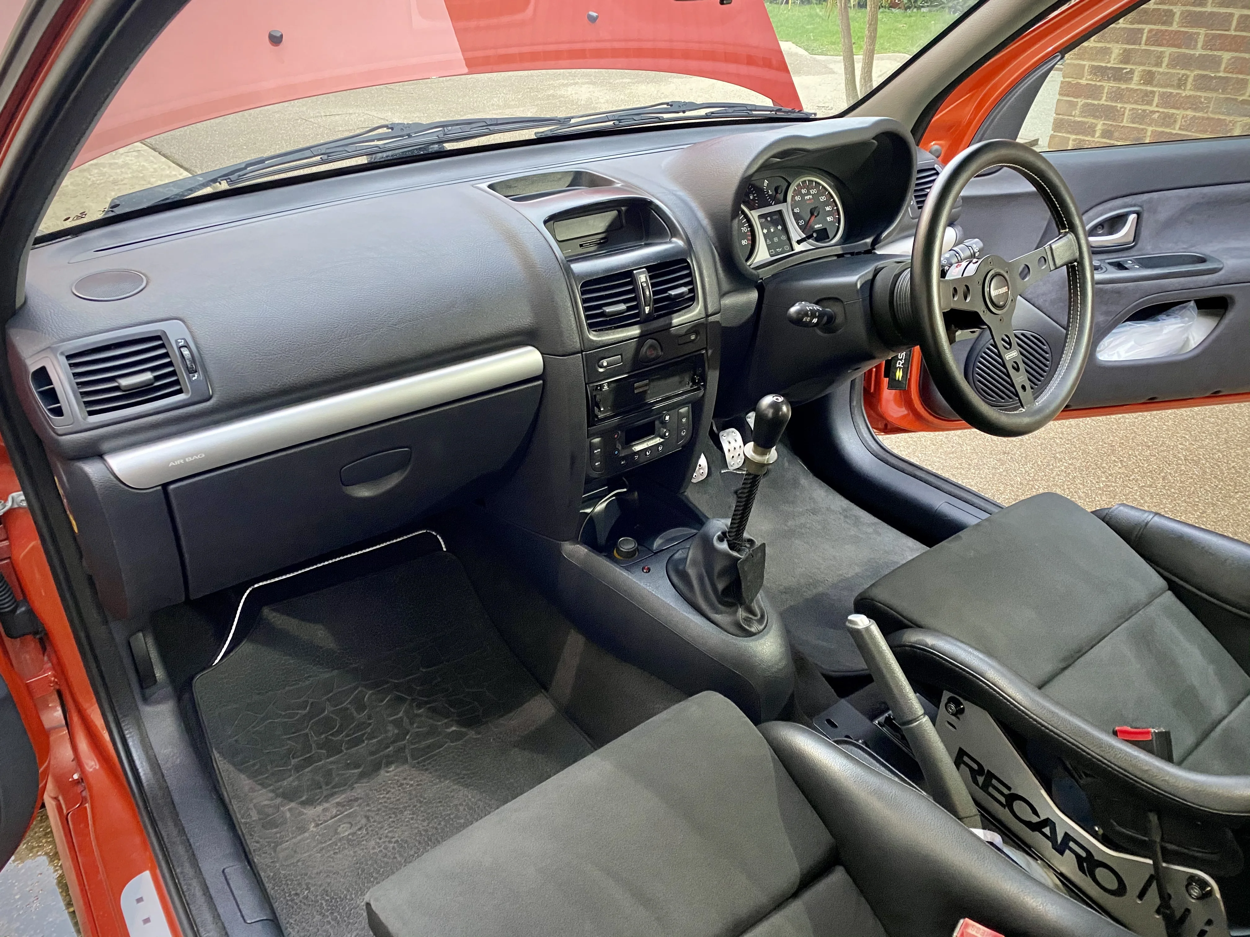

It was nice to be able to clean all the dash pieces properly before refitting, I even polished the scratches from the ignition barrel.
Refitted and filled with fresh Type D coolant I bled the system, however I have since found one small issue. The stepper motor for the temperature control is not recieving either power or signal from the climate control unit. The stepper motor I have tested and functions perfectly so this could well be a broken or damaged wire I will have to investigate.
So frustratingly it was a lot of work with an unexpected outcome and now a new fault to find and fix. However a small road test has proven my work on refitting the dash is now resulting in zero squeaks or rattles, so that’s an improvement at least.
To be continued...

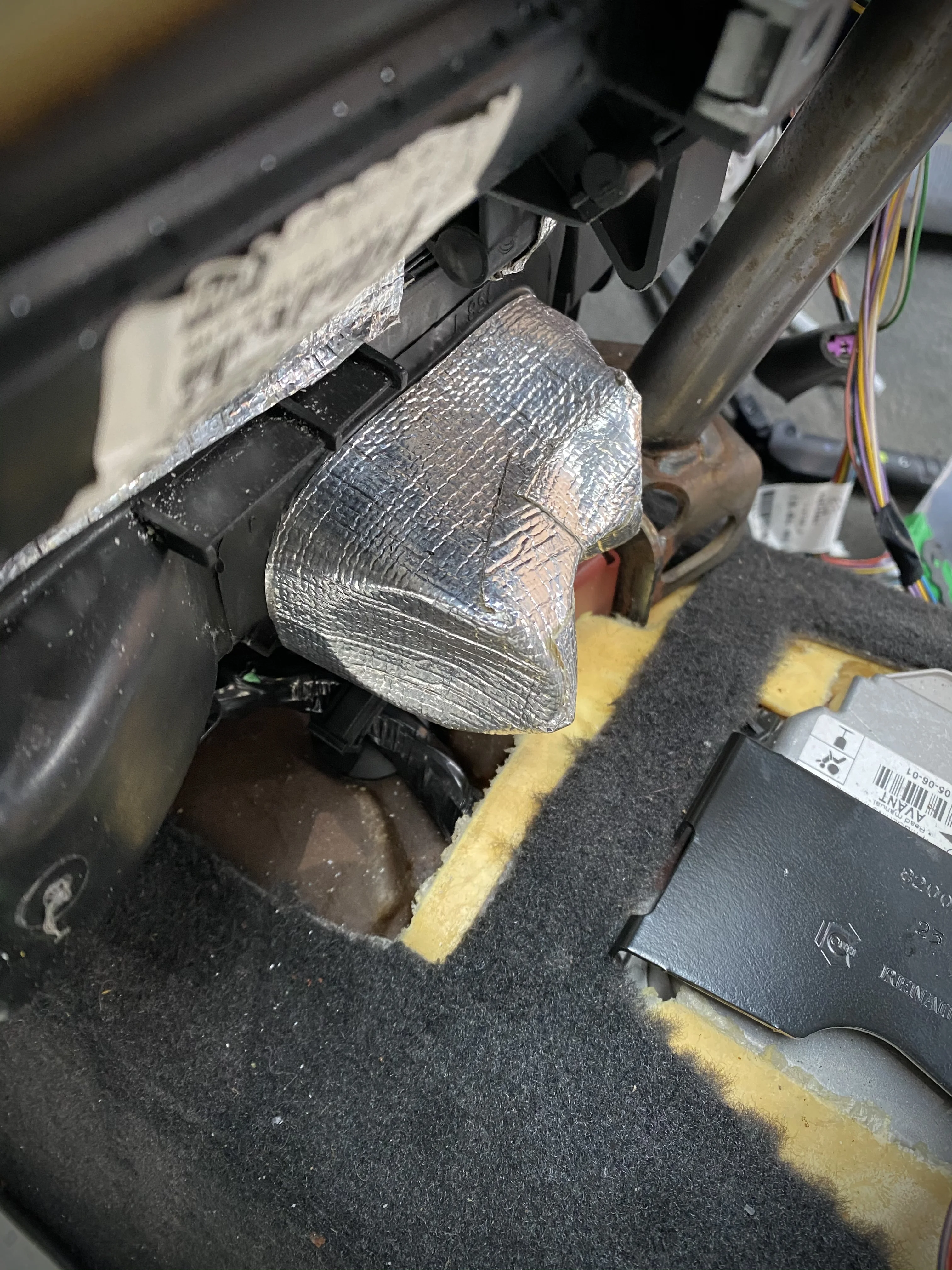

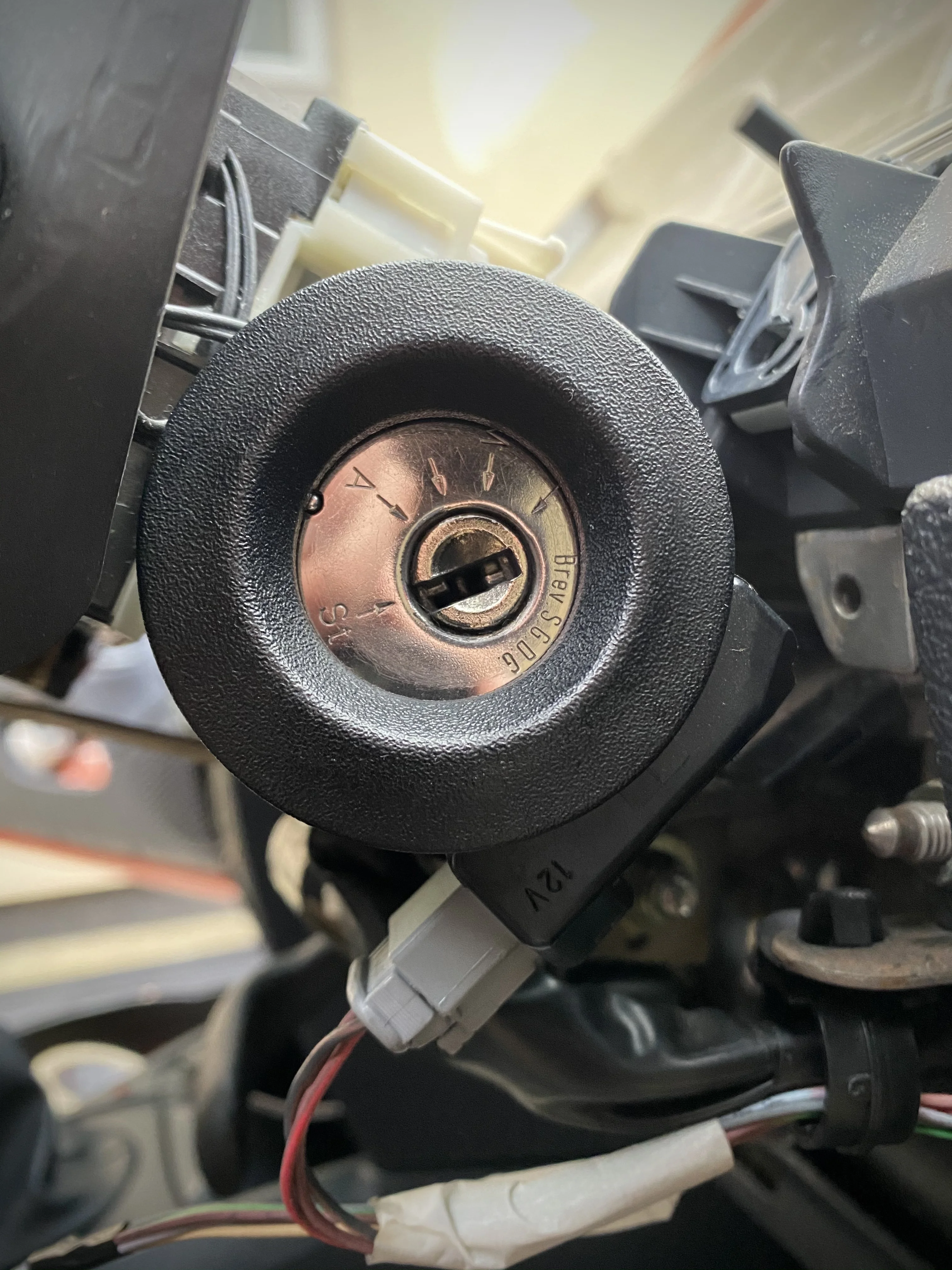

Okay so ive taken a look to investigate the non functioning stepper motor for the HVAC temp.
I’ve checked the wiring to both the stepper motor plugs and to the HVAC control unit for damage. I can’t find anything.
I know the suspect stepper motor is functioning correctly as when I connect it to the air diversion plug it operates in both directions.
However when I connect it to its correct plug (HVAC temp) it does nothing.
When I connect or reconnect either of the 2 HVAC multi plugs. The suspect stepper motor rotates clockwise approx 30 degrees and stops. It will then not responded to the HVAC commands.
If I then disconnect and re connect either of the HVAC plugs, it’s repeats its clockwise 30 degree movement and stops. Never once does it go anti-clockwise. It’s acting as there is no feedback to tell the HVAC unit of its position. Yet if I connect the stepper motor to the air diversion plug, it operates in both directions perfectly.
I have a spare HVAC unit so tried that too and still get the same symptoms.
The next thing to check was the cabin temperature sensor as if that was faulty I figured it would just try and achieve the max temp possible. I checked the temp sensor wiring but again, couldn’t find fault.
I went through the wiring and connections as far as I could without stripping the dash back to start checking individual wiring runs etc.
Then the most annoying thing of all happened.
It randomly started working again and I’ve absolutely no idea why. I did then disassemble the stepper motor to zero the gearing as it had lost its home position.
Thinking about it though, I believe this error signal is the main culprit behind the broken star drives on the heater box. I’m now thinking they’re a result of another issue. The motor loses its park position and gets lost. Then exceeds its usual range of motion and breaks the drive in the heater box.
For now it’s working perfectly, but frustrating it’s through luck rather than me finding and fixing the fault. 😕

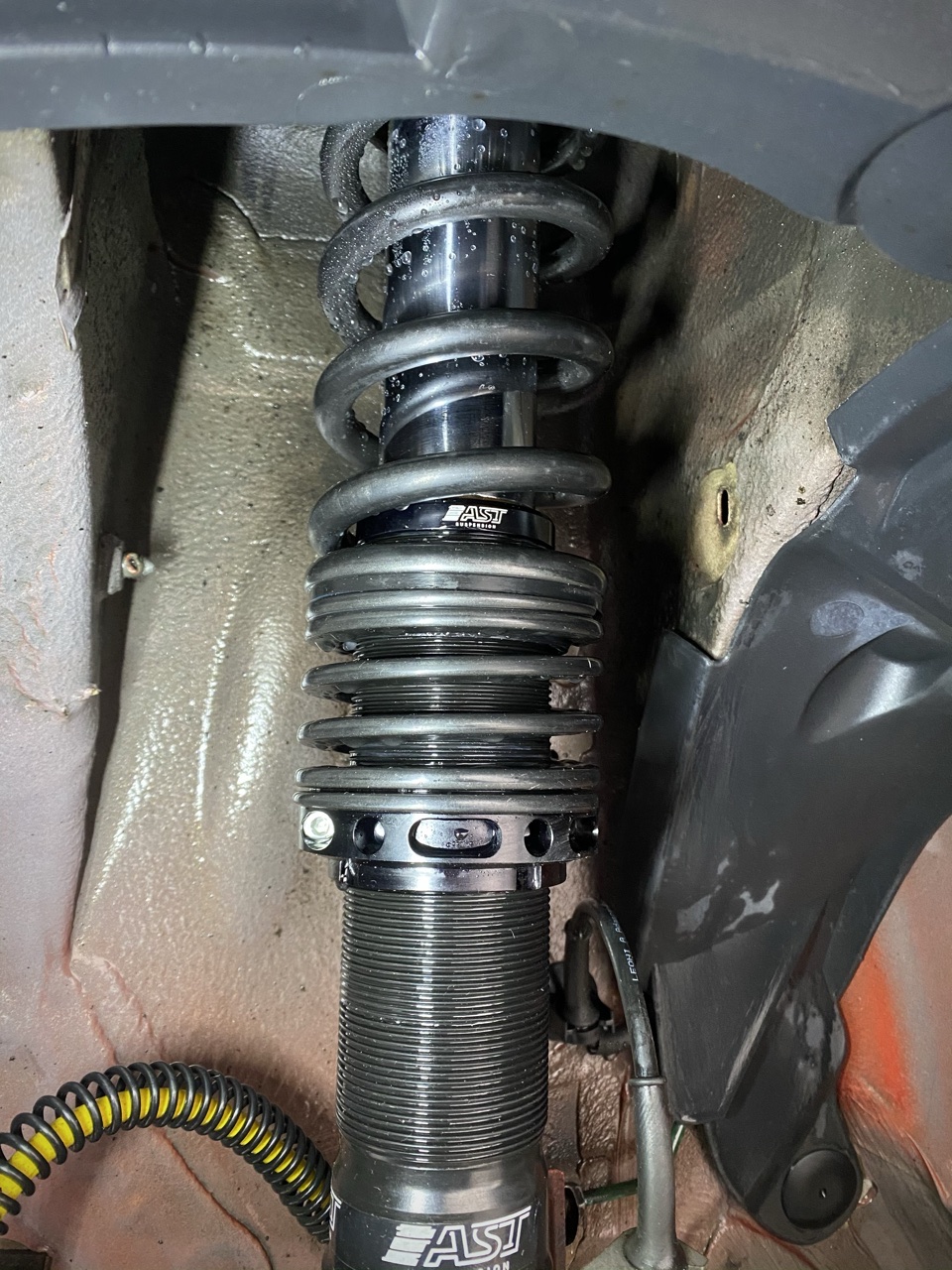

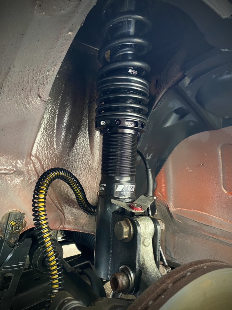

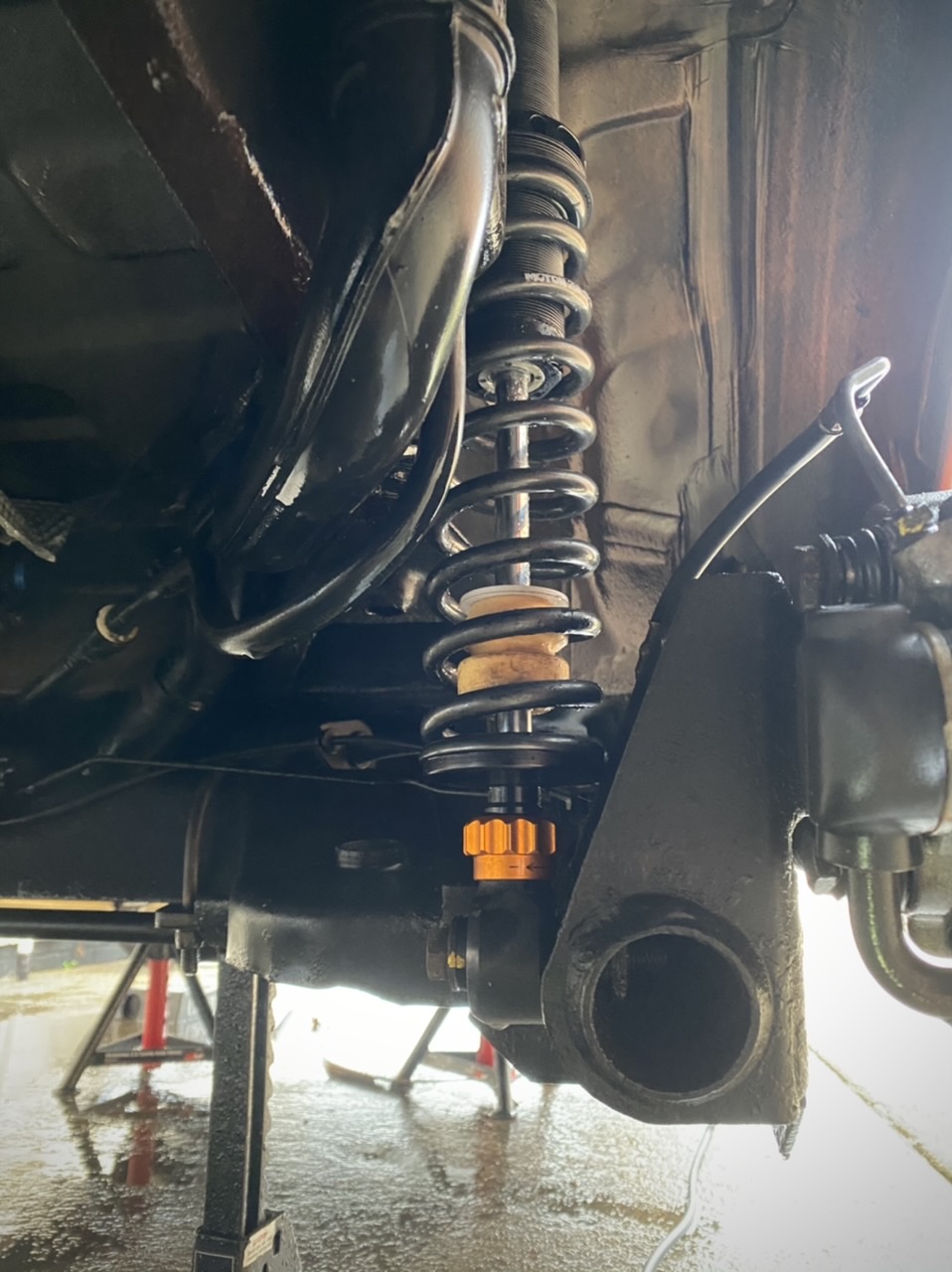

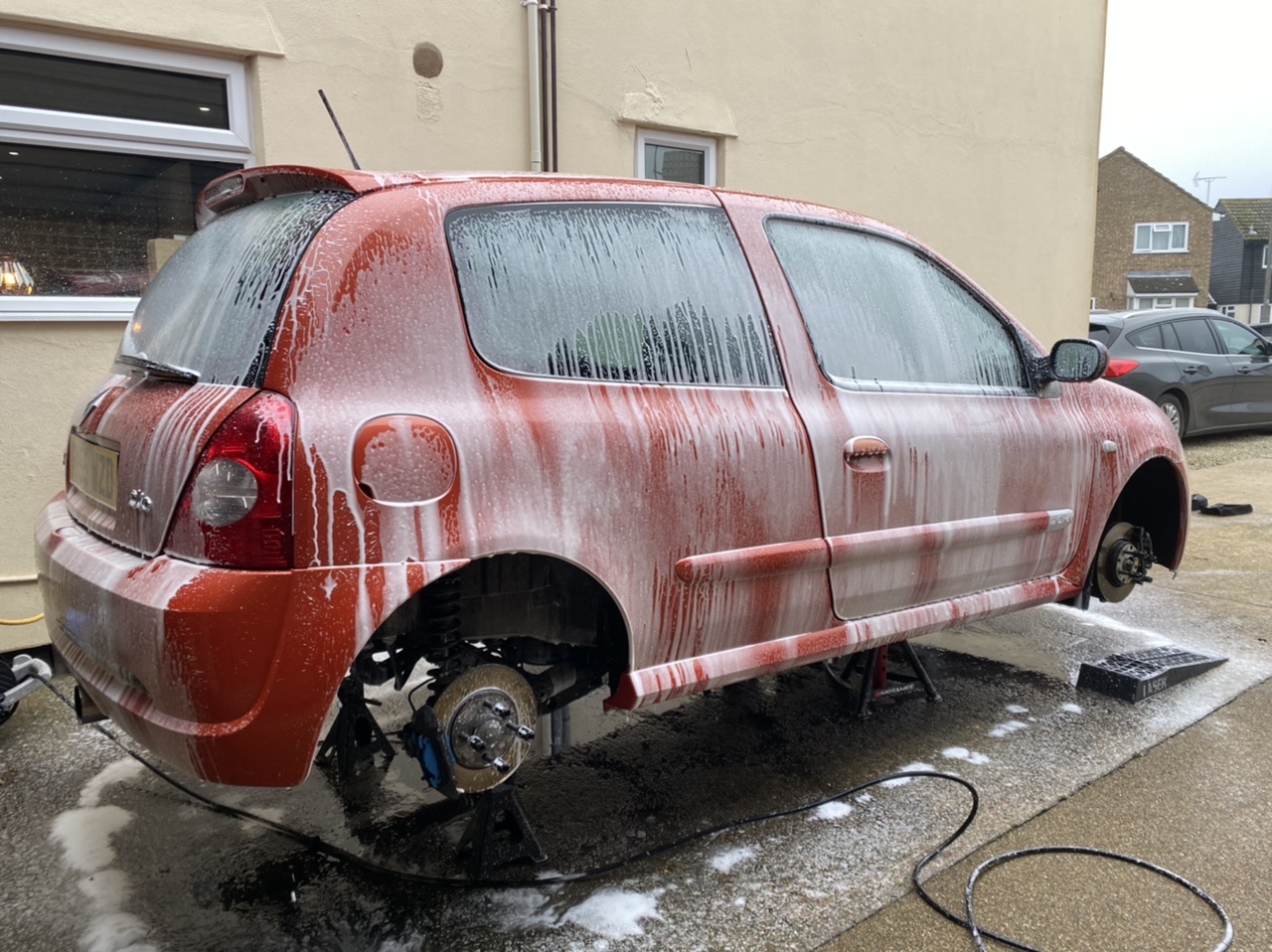

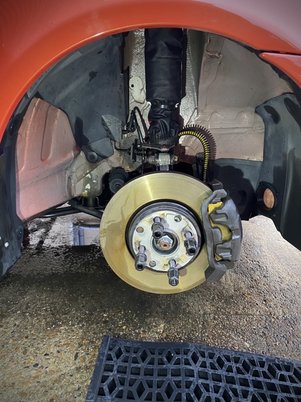

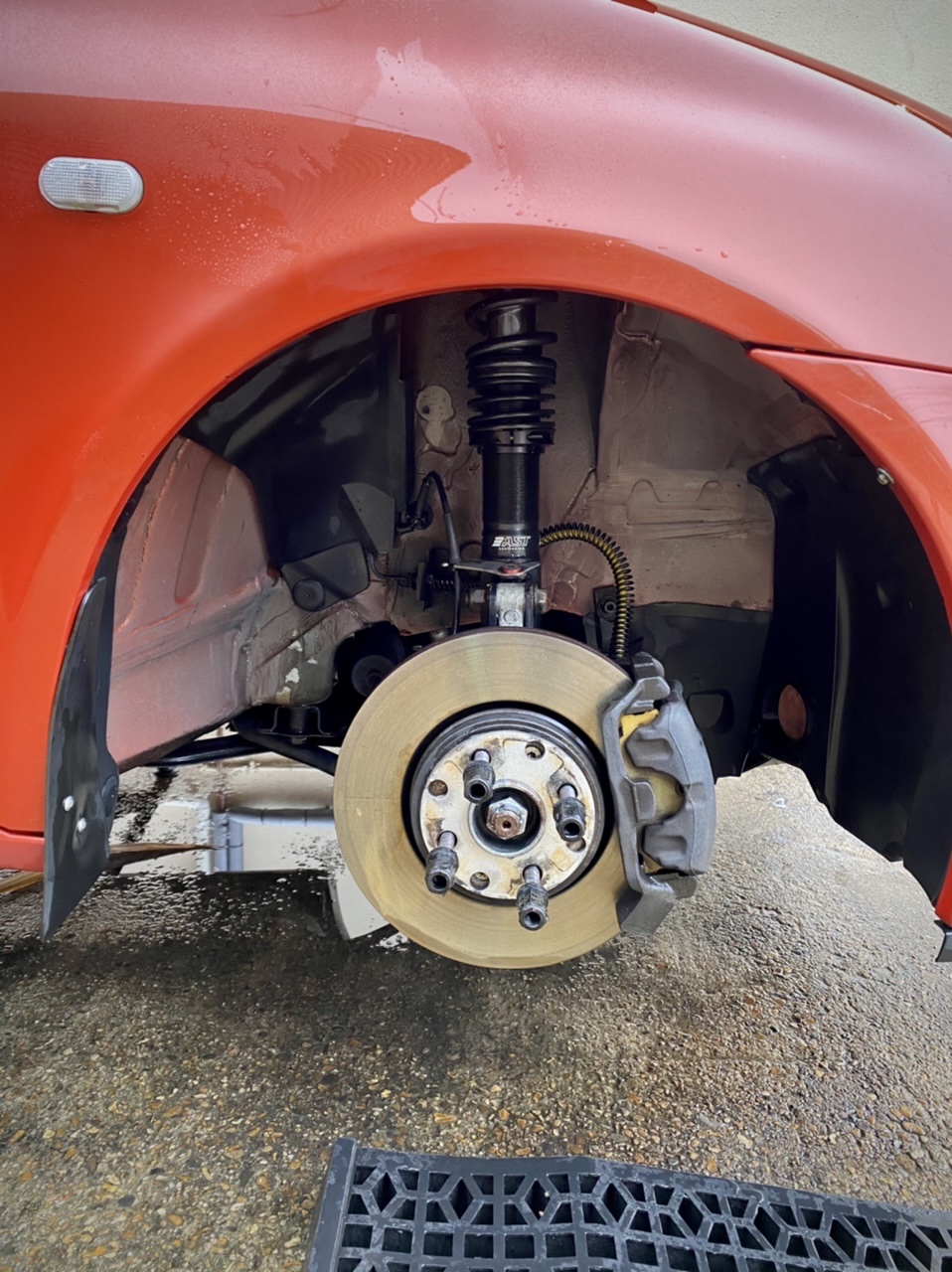

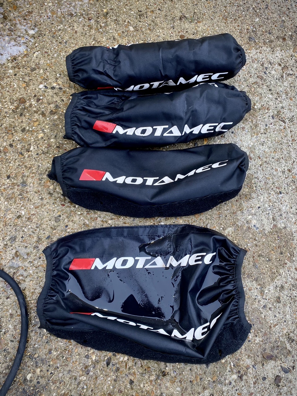

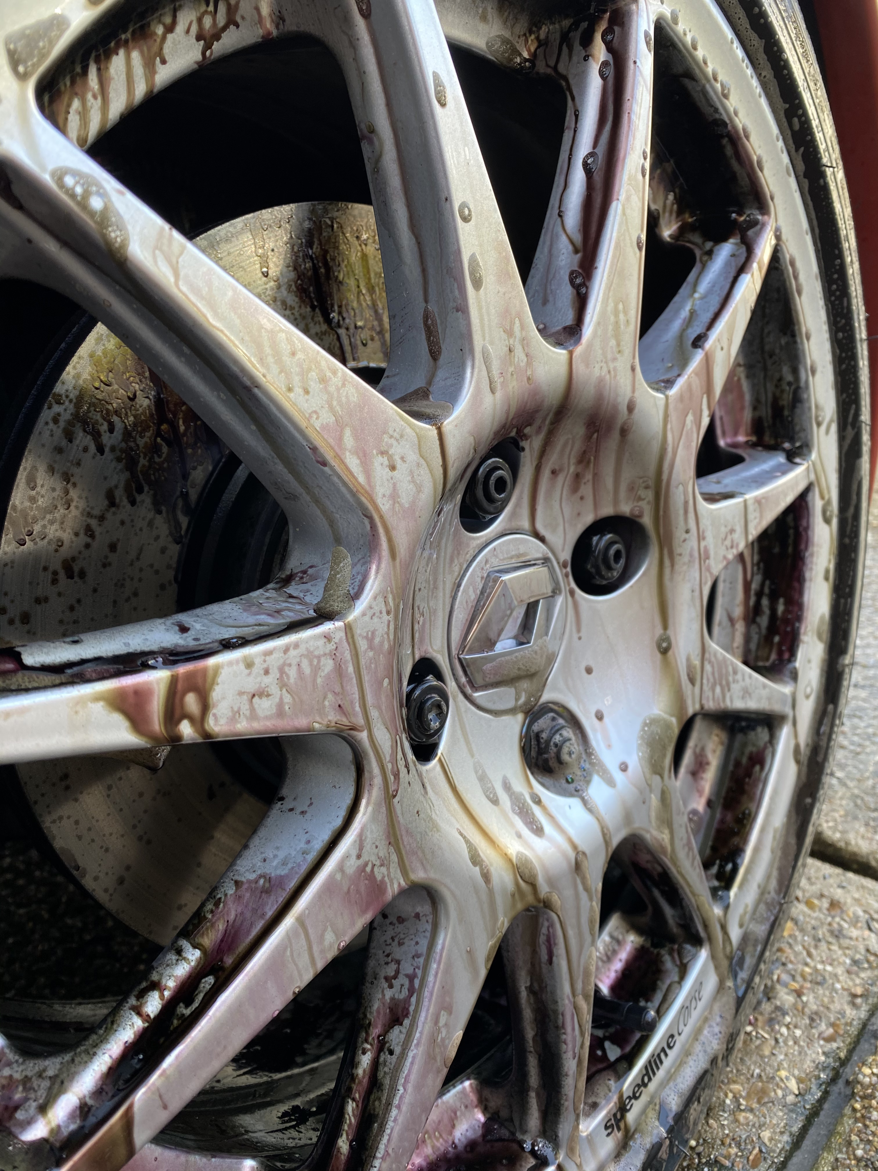

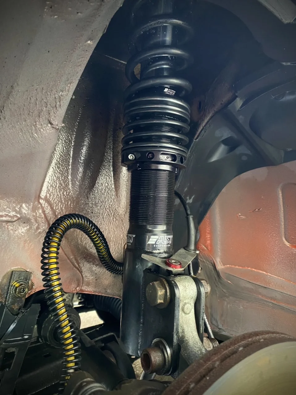

Managed to give the old nail a mid winter “wheels off” clean today. Mainly I wanted to give the underside a wash and dampers a good look over. They have been on the car for 10k miles now and I haven’t revisited them since fitting back in April.
It’s no secret my car is my daily driver and gets used in all weathers and conditions. When they were fitted they were liberally coated in ACF50 and then covered with Motamec damper socks. I was very pleased to see my precautions had protected my investment superbly, socks removed, they looked as good as the day they were fitted.
The socks and dampers were washed down, re coated in ACF50 and socks refitted.
Hopefully well protected for another 10k miles.

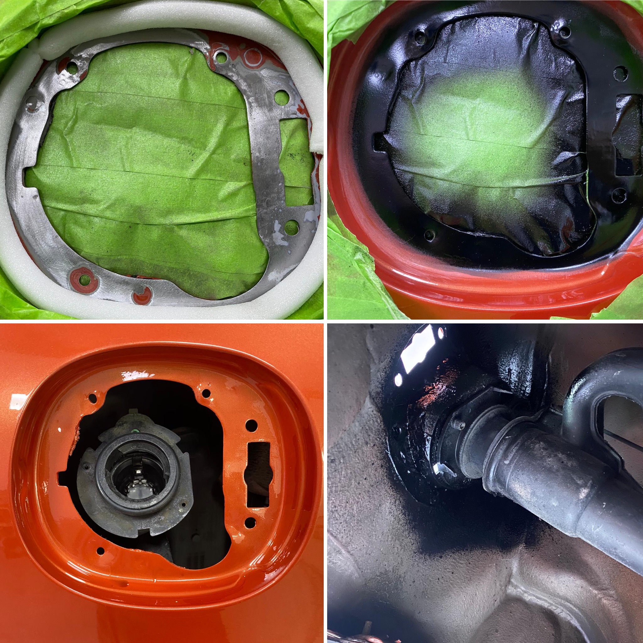

Must have missed the fuel filler cap and arch repaint. How much was that and how long did it take them out of interest?
Wasn't a cheap job, and barely any paint went on the car to be honest. £750, a couple of days.
I had some micro bubbles in the lacquer starting to appear on the arch edge, so i had it done before it became anything else.
Fuel filler was totally removed, bare metalled and epoxied, i bought a new genuine fuel door assembly too.

my neighbours must think I’m mental when I’m out there jetwashing the underside in the snow. 😅
Thanks so much. It’s hard trying to keep on top of it all when daily driving in this horrid slushy mess.

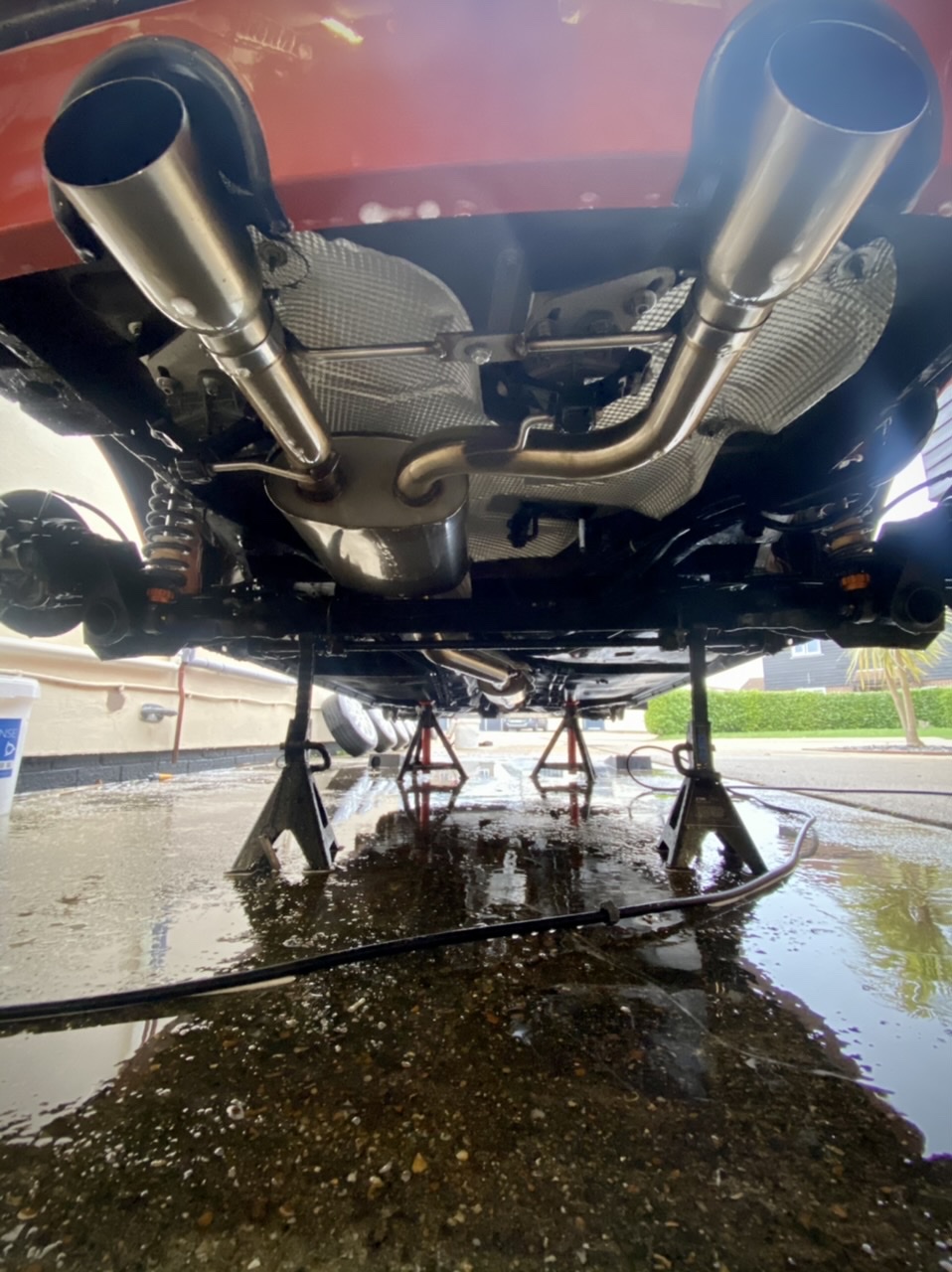

Have any of you guys tried lanoguard for protecting the underside of your cars? I'm keen on giving it a try for both my cars since it's clear, organic and is extremely easy to apply by the look of things. About £65 for a large (5ltr?) tub which should do a couple of cars.
I've been looking for this kind of thing for years!!
I haven’t but I’d like to know more. I’ll have a read. 🙂
Till then, i resorted to washing it for the second time in 3 days. 😅
