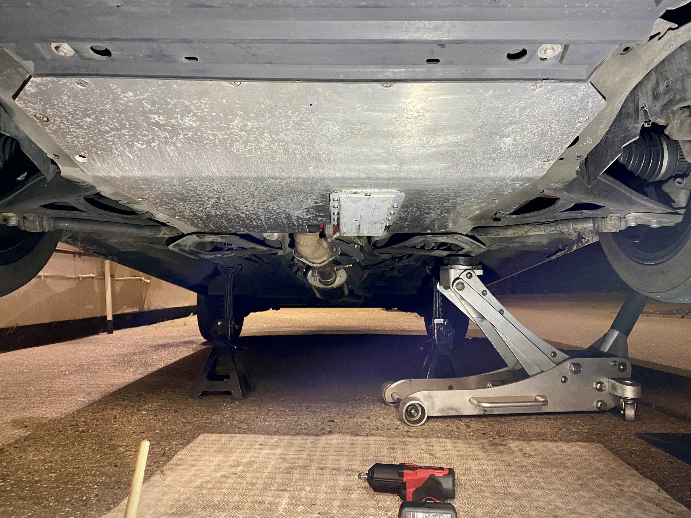

Something I’ve been after for a while is a PMS sump guard. I’m always mindful that the car is pretty low and when pressing on in the back of my mind about catching the underside on something.
Luckily one came up on eBay in good condition a few weeks back, so ordered new M8 RivNuts from Nick @ PMS, I already had stainless fasteners in stock.
Fitted it up tonight, which was going perfectly till one of the fasteners nipped up. I’m guessing either a burr on the bolt or insert thread. This then spun the insert upon removal and I knew I was in for some unexpected agro.
Drilled it out and carried on, however where it spun the hole is now so slightly oversized to accept a new insert. There’s so many fixings on it, I’ll live without that one. The rest I copper slipped before final fitting and bolted them up tight.
I can’t see any foul areas on it but I have noticed quite a increase in NVH from it, but not enough that I feel it’s fouling any of the transmission. I’ll have it off again tomorrow and double check for any witness marks. It’s got to come back off anyway as I’ve picked up a pair of Ktec/Vibratechnic engine & gearbox mounts for it.
Biggest surprise is how much it’s stiffened the front end. It feels a more significant improvement than the strut brace added, I totally didn’t expect to notice. I’m not expecting any issues with under bonnet temps but I’ll keep an eye on that too.
frayz
Had it off again tonight as I had a pair of Ktec/Vibratechnics mounts to fit anyway.
Found no witness marks at all on the underside of the sump guard but I did find of the bolts that hold the linkage protection plate was polished on the top. It was just touching the large M12 bolt head that mounts the dogbone to the engine.
Oddly those fasteners which hold the linkage protection plate are just nut/bolts which means they protrude quite a lot from the back of the sump guard.
I’m thinking either some half nuts and shorter hardware or adding Helicoils to the guard and doing away with the nuts completely.
Even with the new VT mounts I’ve no more sump guard resonance, but I’ll know better when I drive to work tomorrow. It’s nice knowing the underside has at least some protection now.

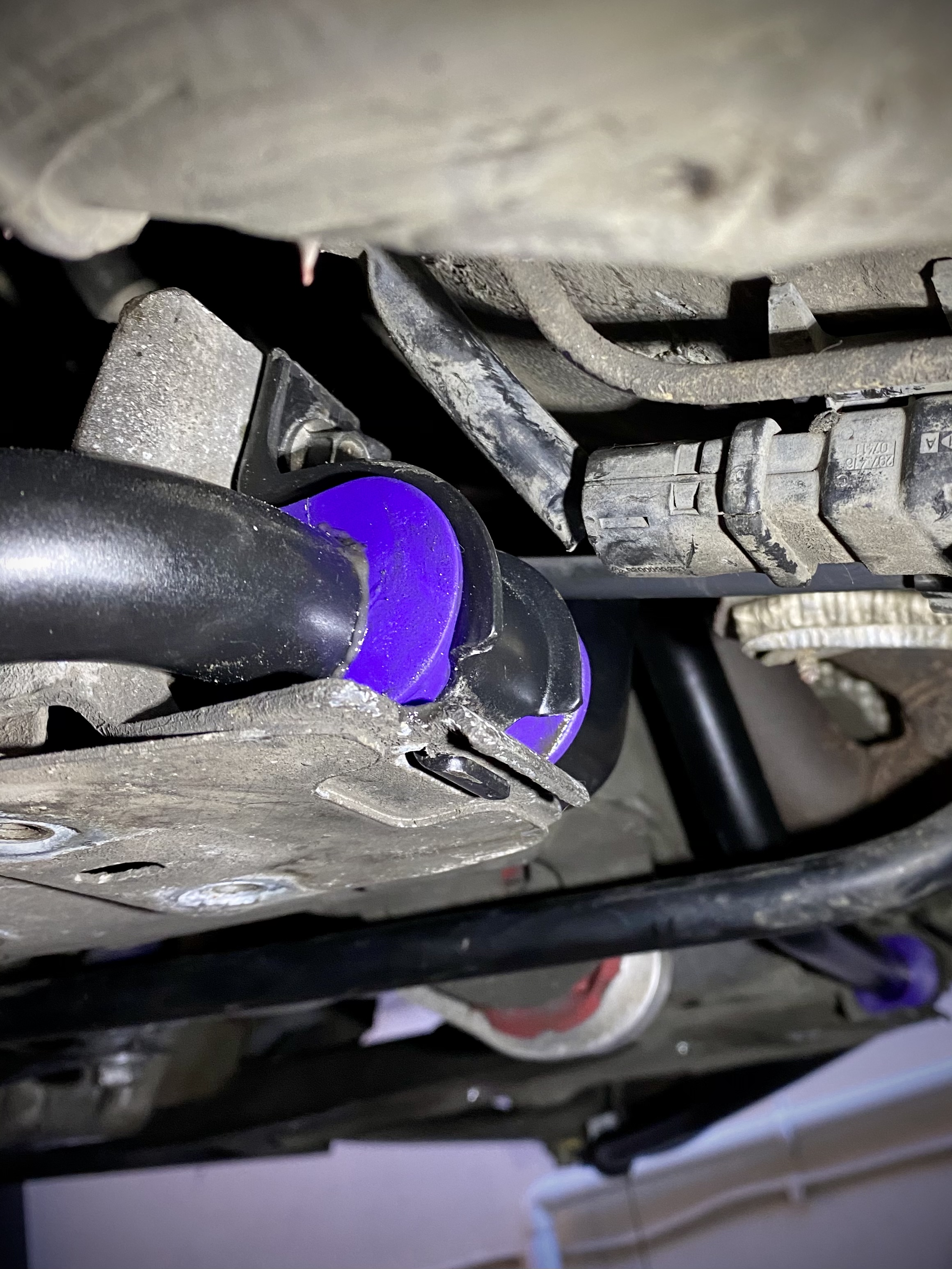

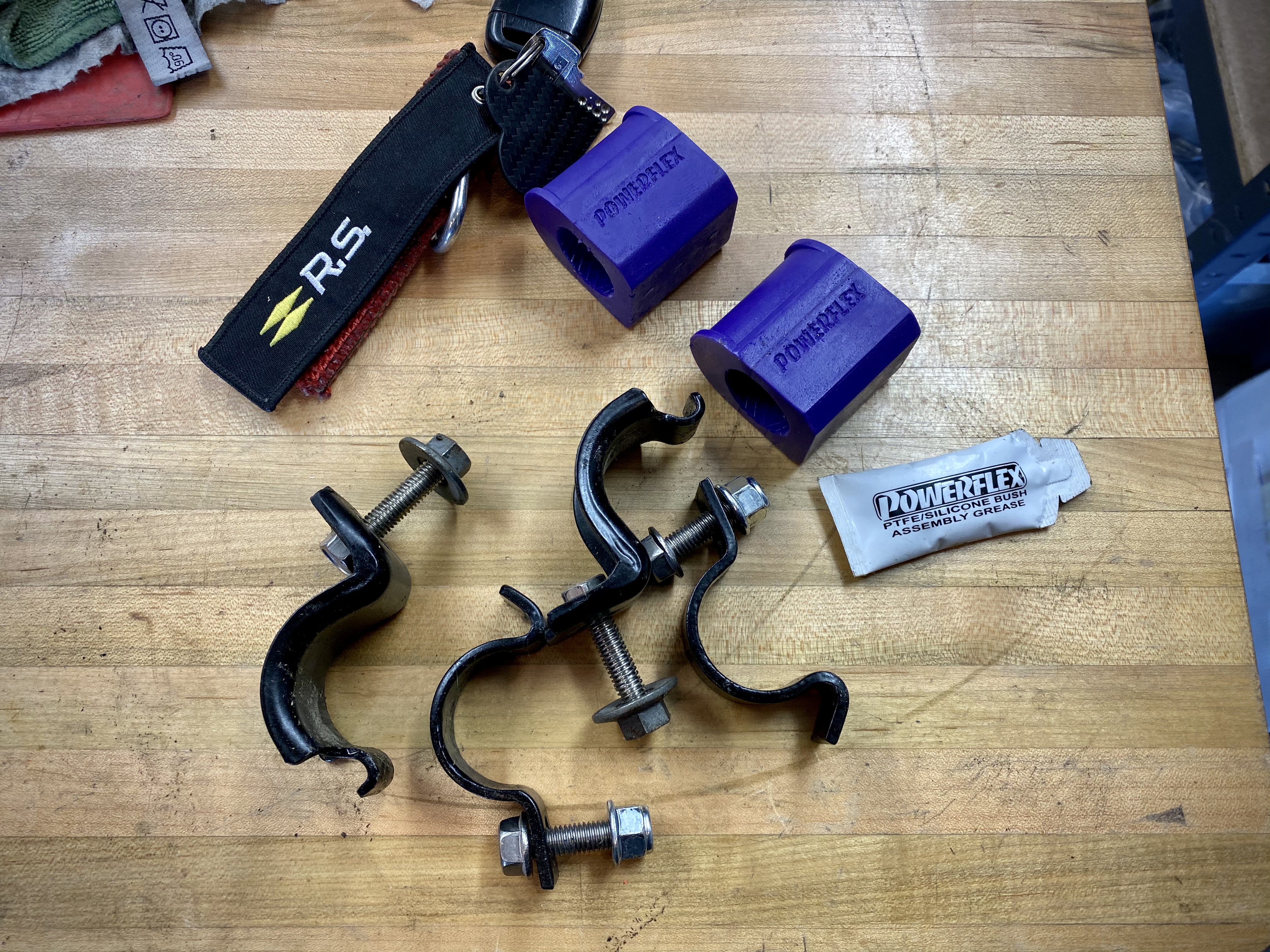

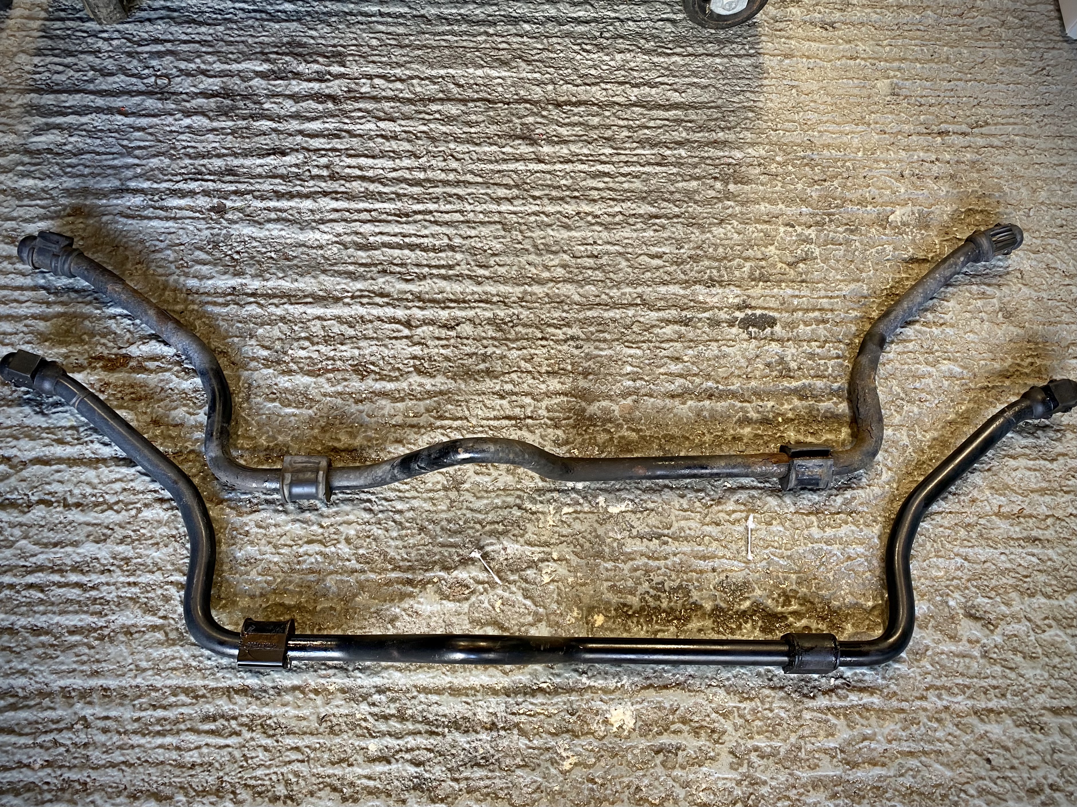

However something I’ve had for a while has been a freshly powdercoated front ARB I’ve been meaning to fit. The ARB bushes are literally the very last bush on the car to replace. I had been putting them off as they have a reputation for being a royal pain in the arse to fit.
Well after today’s experience I can say with 100% certainty, this isn’t exactly accurate.
I dropped the old bar and refitted the new bar and then proceeded to spend a solid 2 hours fighting with getting one clamp bolt in. Now I’m no stranger to working on cars but even I thought this was excessive. I was so deluded that I was bound to have a fight on my hands, that I made a schoolboy error. I was totally focussed on getting the clamp done up that once done up I knew it still wasn’t right. I text a friend (Alex @ AW Motorworks) with my troubles to which he promptly called me back to tell me what a t**t I was.
I had the bush fitted 90 degrees out and the radius part pointing up. I literally wanted to kick myself at such a stupid error.
I removed the clamp and had both sides fitted up in about 6 minutes. They really are simple when you fit them correctly. Needless to say it was all boxed up with new clamps and stainless fasteners and back in the deck in no time.
So the great ARB bushes debate, they’re easy when you’re not a total berk doing it. Thanks to Alex.
So now these have been changed, that’s every single bush, bearing, mount, joint and linkage renewed and upgraded within the last 12 months. It drives as tight as a drum and feels better than new.

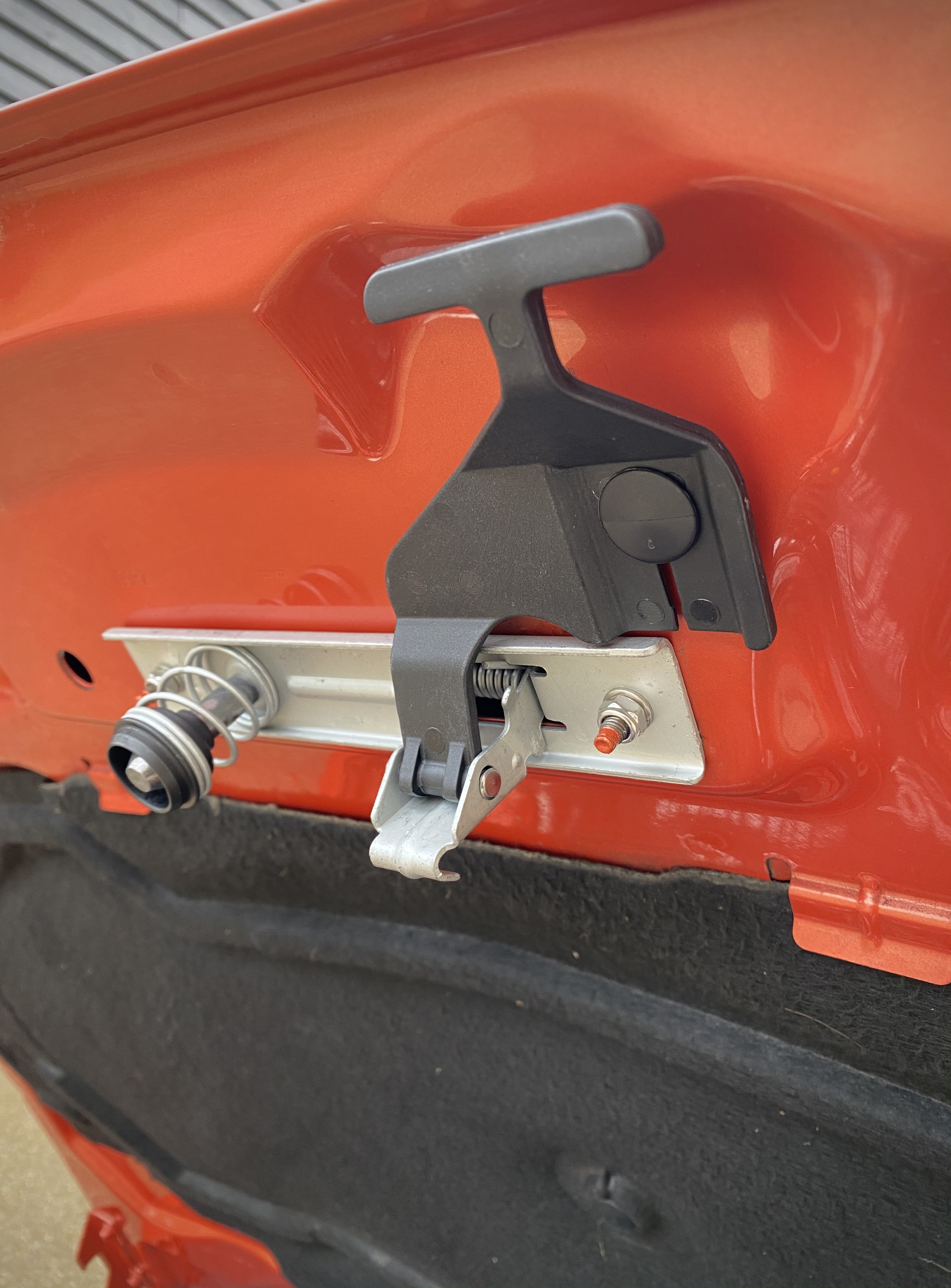

Couple of little “tinker” jobs on WZD today.

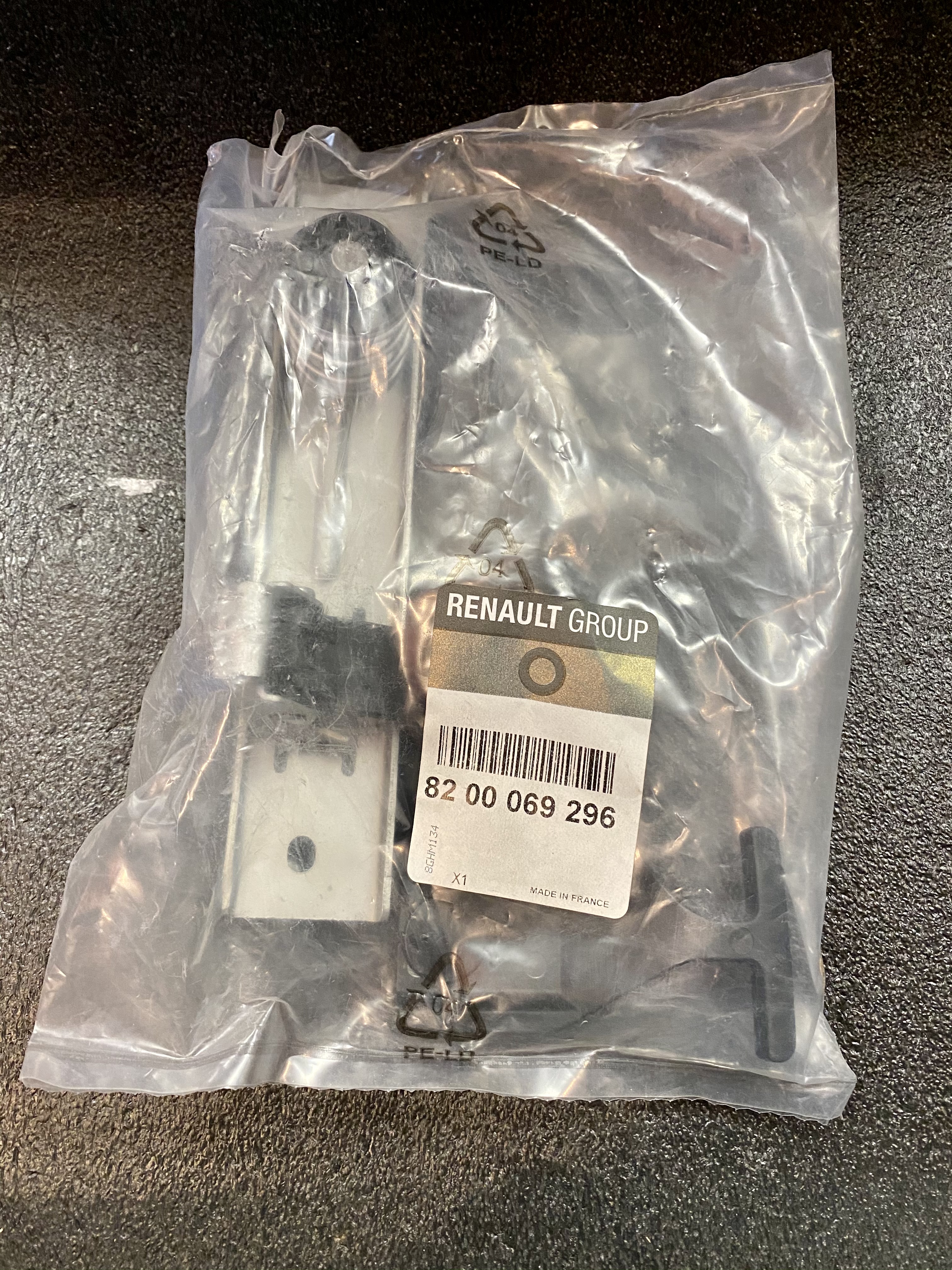

First up was a nice new bonnet release latch. I had planned to buy one and. Luckily found a new part on eBay for £10.50 delivered so couldn’t pass that up.
Because new bits. :D

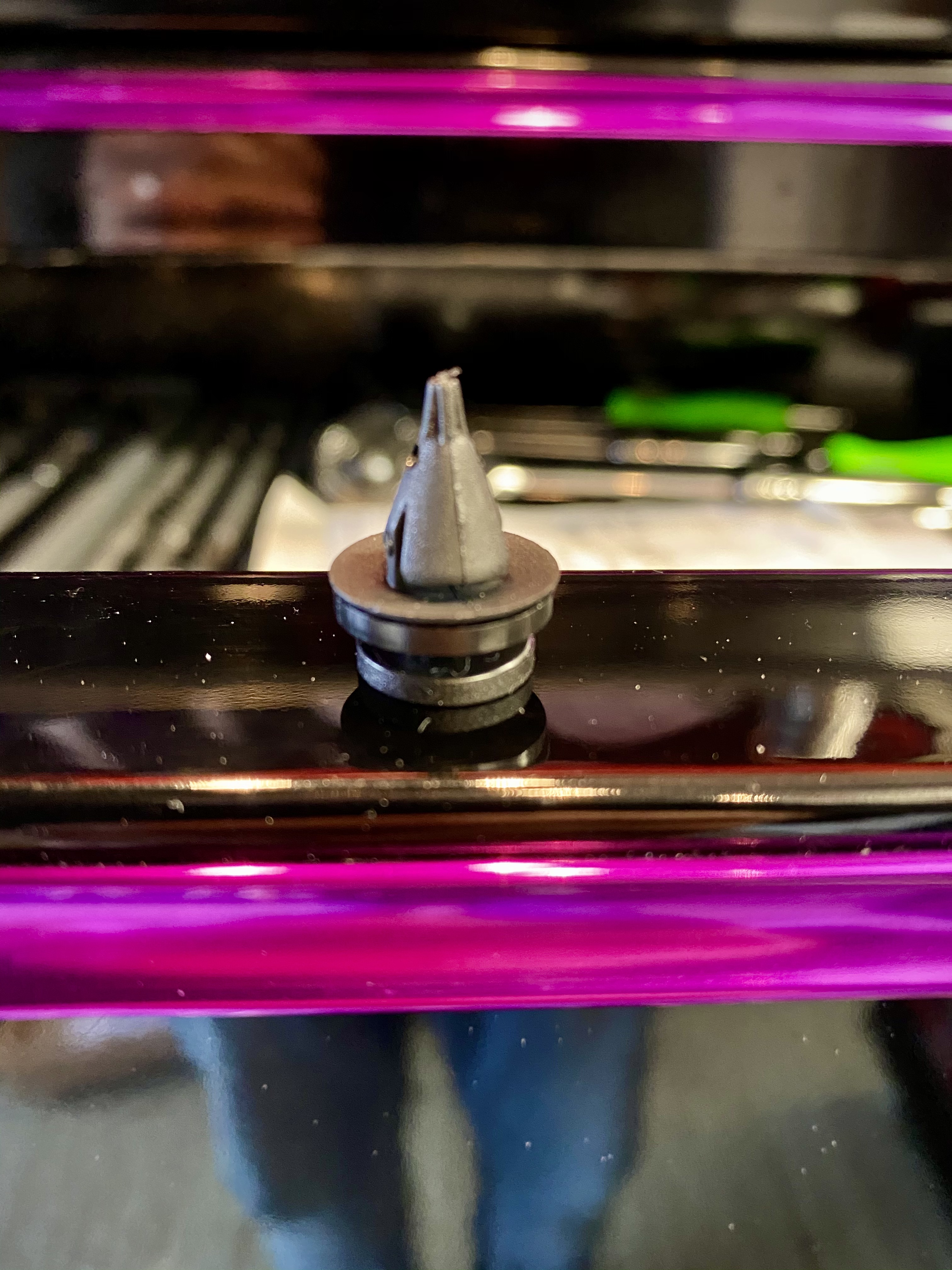

Second was replacing all the trim clips on the tailgate trim. I hate rattles and I’ve tried various tactics to shut the boot trim up, inc foam strips etc, however never replaced the clips completely. The old ones were obviously 15 years old and quite hard and brittle. The new ones are lovely fresh soft plastic, and it certainly feels more solid already.
Fingers crossed this helps.

Very nice. Little details like the new bonnet latch make a big difference. I’ve got a lot of surface rust on various parts in my infernos engine bay.
Tempted to clean them up and maybe have a go at using one of those passivates zinc plating kits.

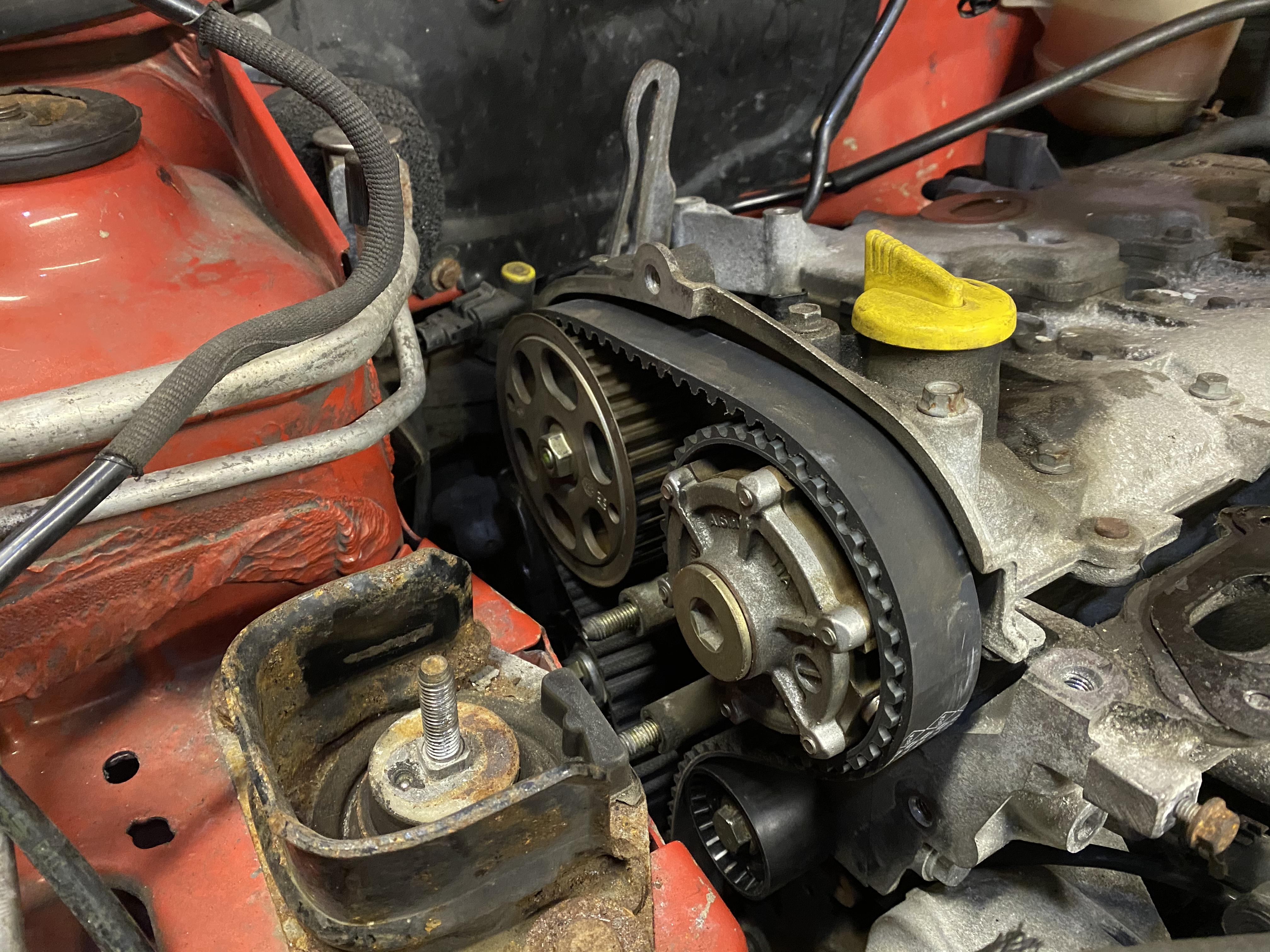

This engine mount and bolts. Will just replace.
Bonnet catch, bonnet pull and a load of the fixings on the slam panel. I’ve got a blast cab so will clean them up there and then try the zinc stuff. Just not sure what should be silver vs gold colour.

This engine mount and bolts. Will just replace. View attachment 1509729
