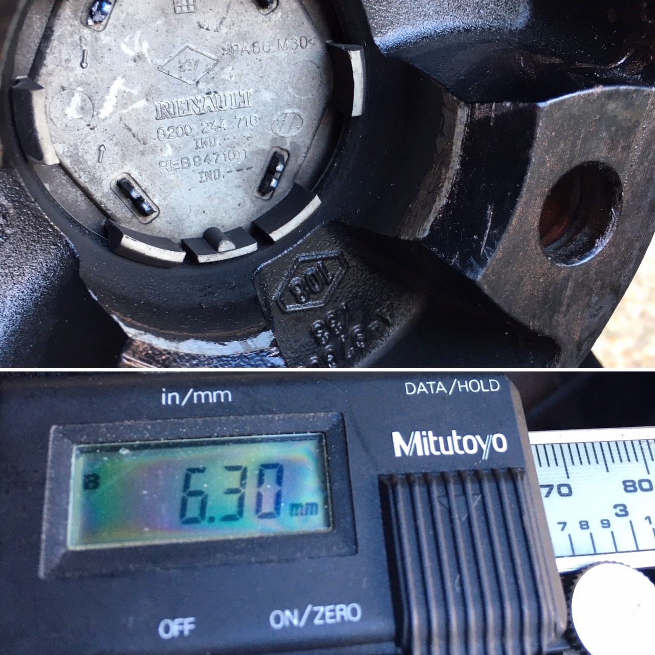

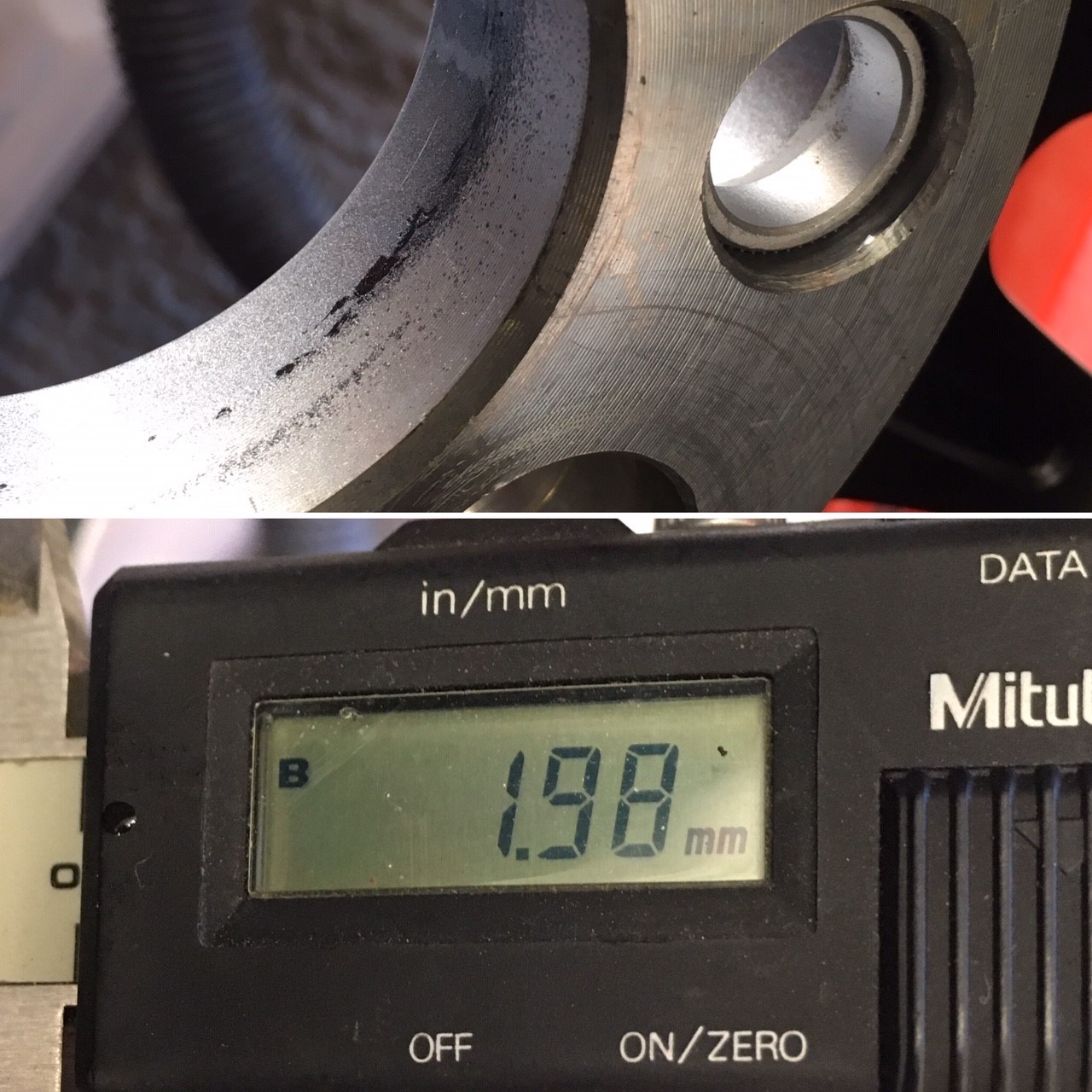

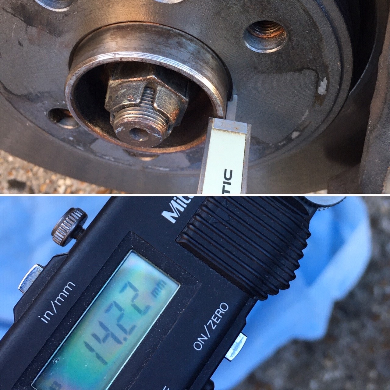

So Ive had a measure up for spacers and will add some pics here incase anyone else is interested. Mainly for the chamfer sizes on the rear faces of the wheels im using.
My stock cup chassis hub protrudes just over 14.2mm.
Speedline Cup Turini ET38.5mm has huge a 6.3mm chamfer.
Speedline 2118 ET43mm has a tiny 2mm chamfer.
So if i want one set of slip on spacers, my Turinis will only cope with a 5mm spacer leaving approx. 3mm of hub location, whereas i could probably get away with a pair of 10mm slip ons if i were just running the 2118s.
Hubcentric 15mm will push my current wheels (Turinis) out a full 15mm (30mm increase on the current track width).
However if i run the 2118s they will also come out 15mm but the increase over my existing track width will only be 11.5mm per side / 23mm overall.

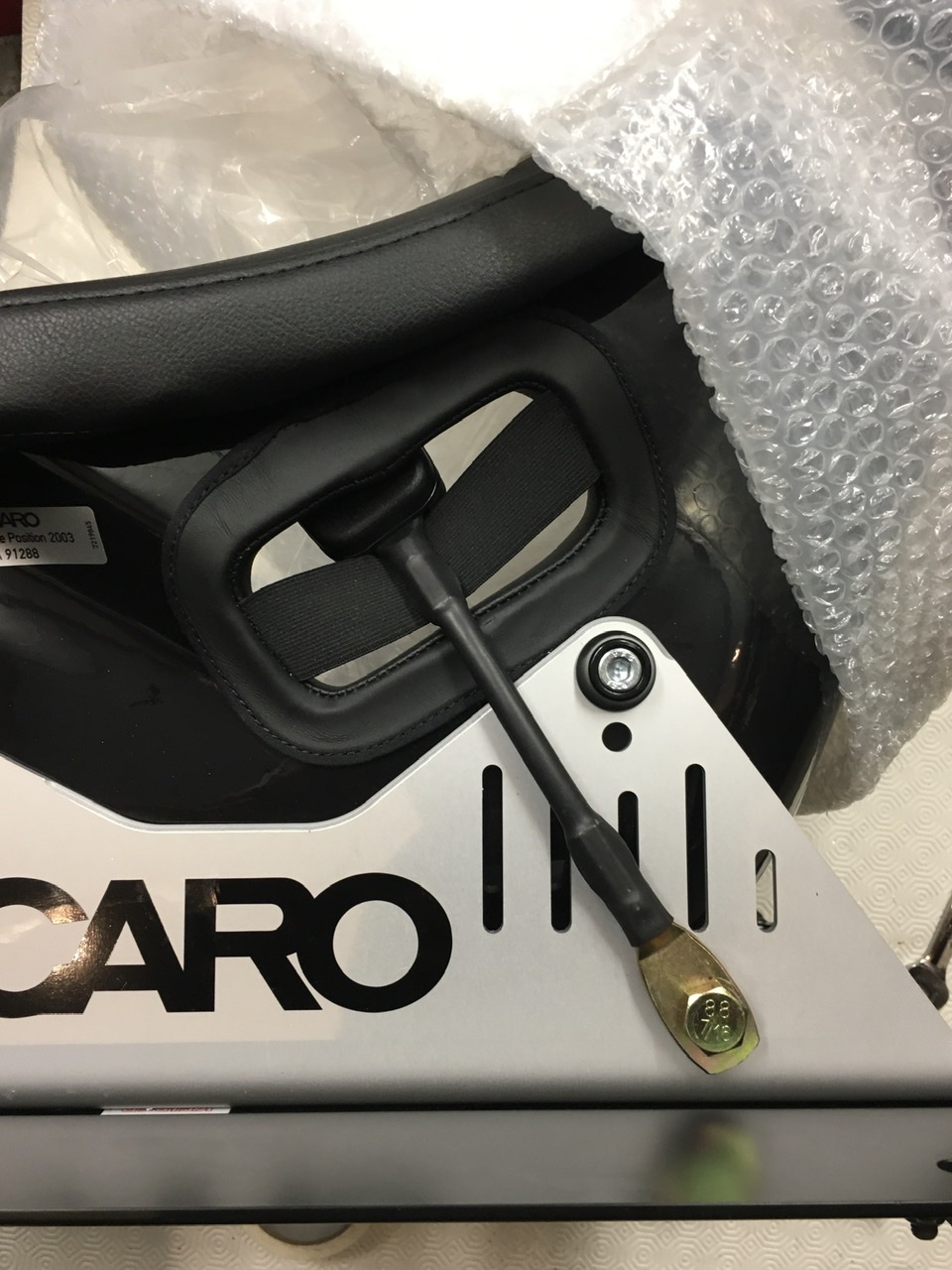

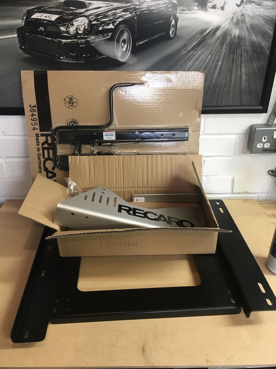

Few little trinkets arrived for WZD yesterday.

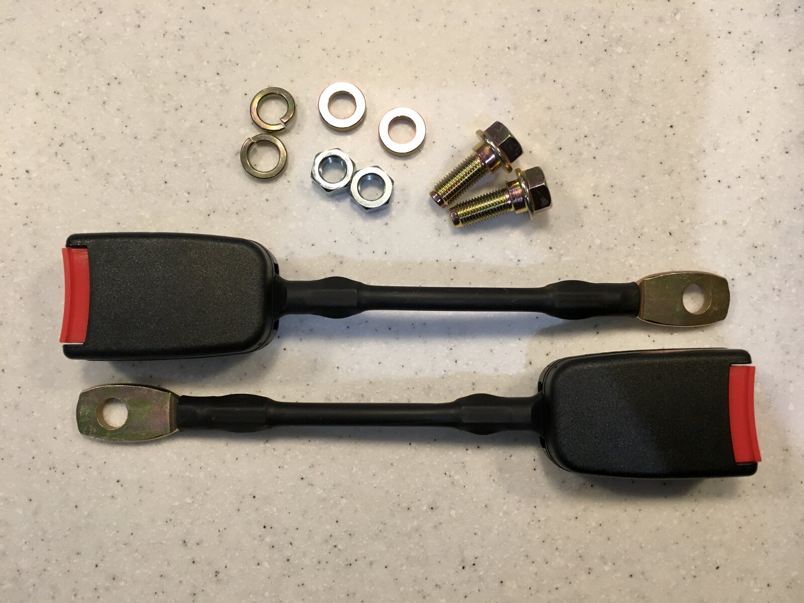

Seat belt receptacles for me to progress my Recaro install.

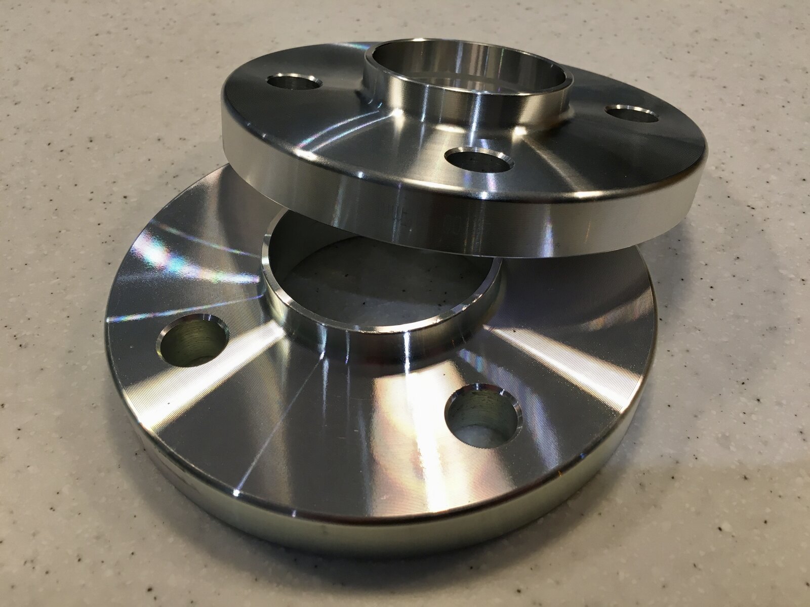

16mm front spacers to suit the 2118s.

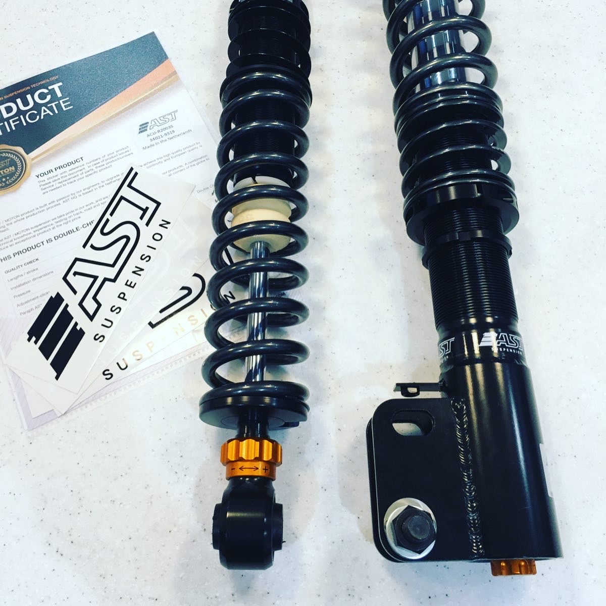

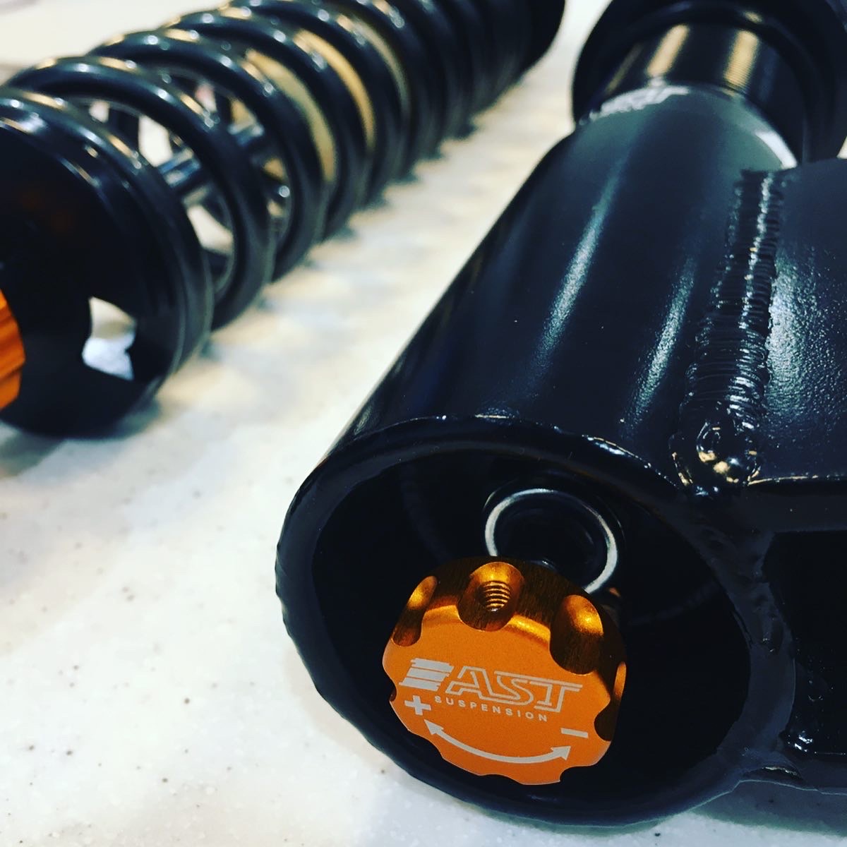

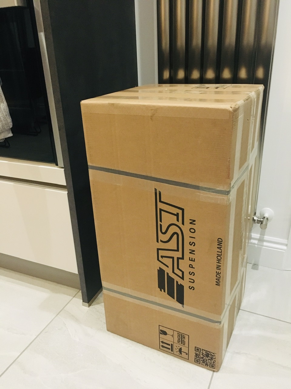

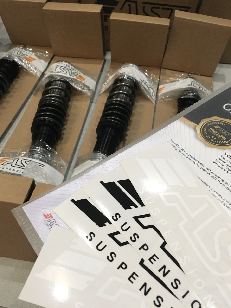

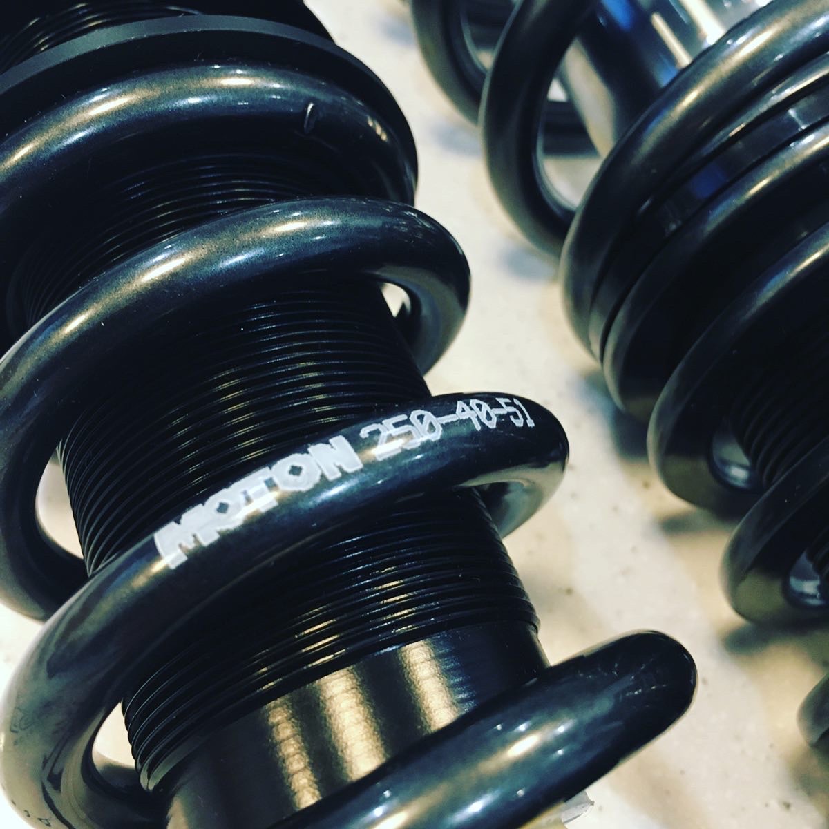

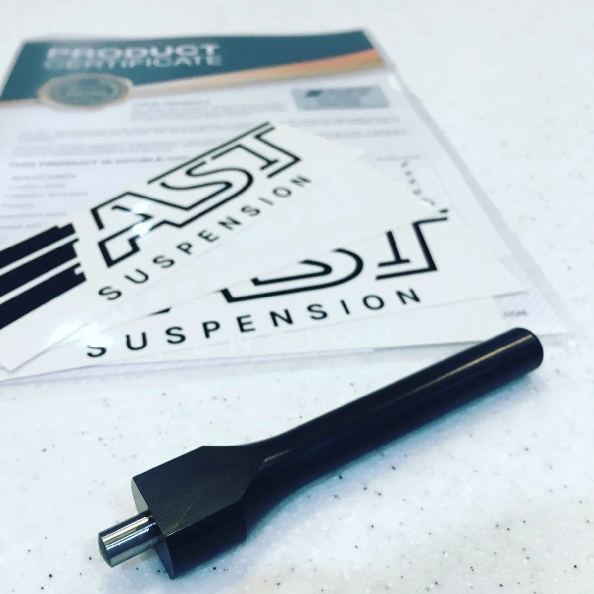

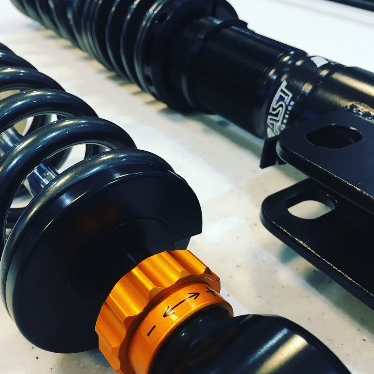

And lastly, a cheeky little dutch delivery from AST/Moton. Thought I’d get some detail photos before they go on as they’re unlikely to ever look this pretty again.
These will be coated in ACF50 before going on and will wear damper covers to protect them as the car will be driven in all conditions.

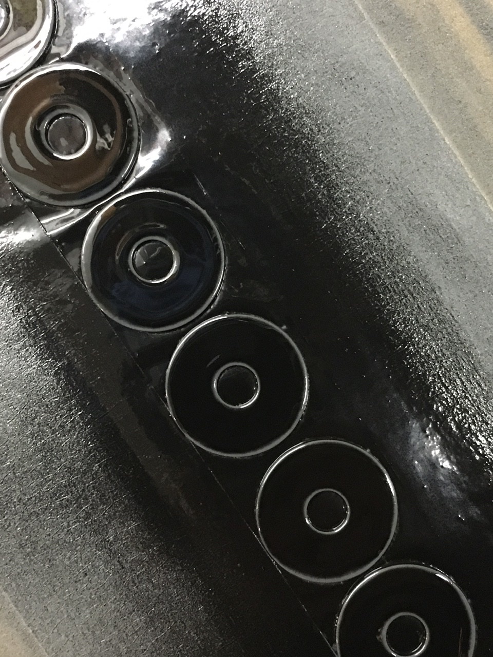

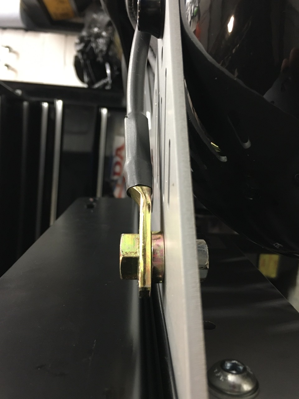

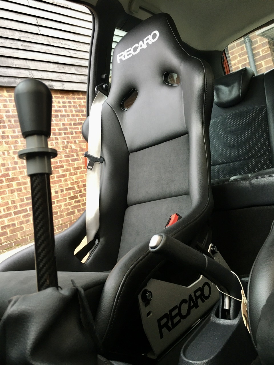

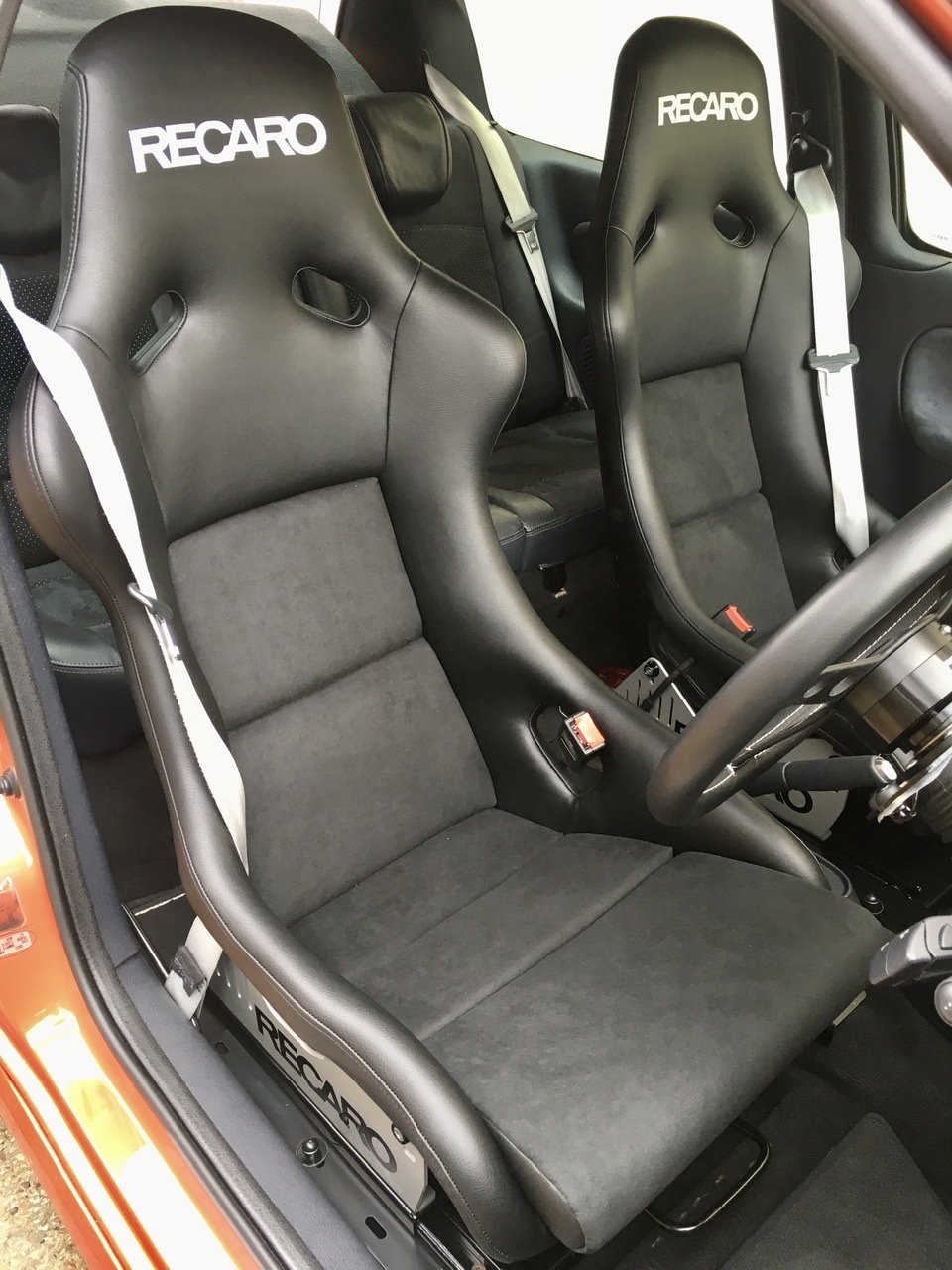

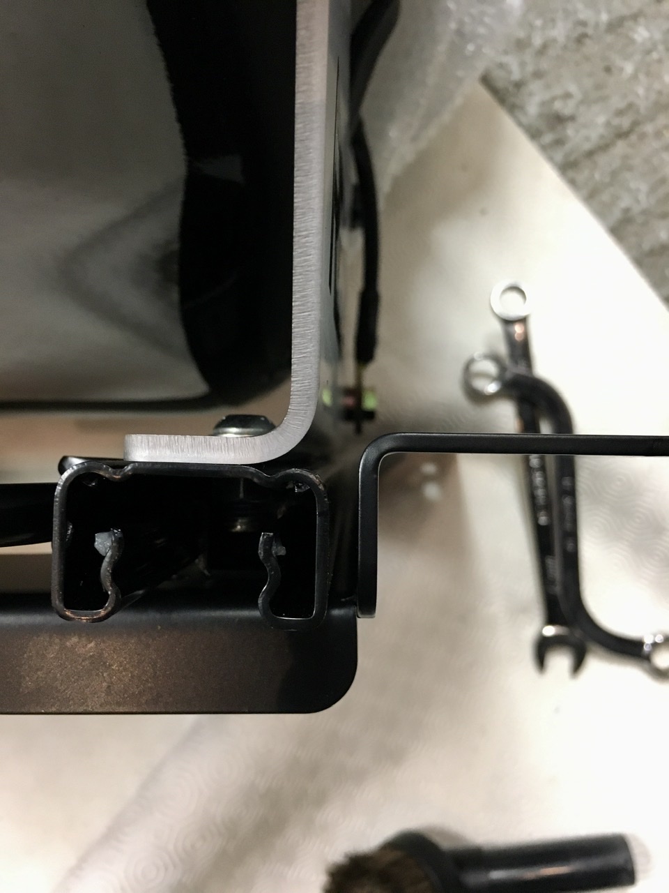

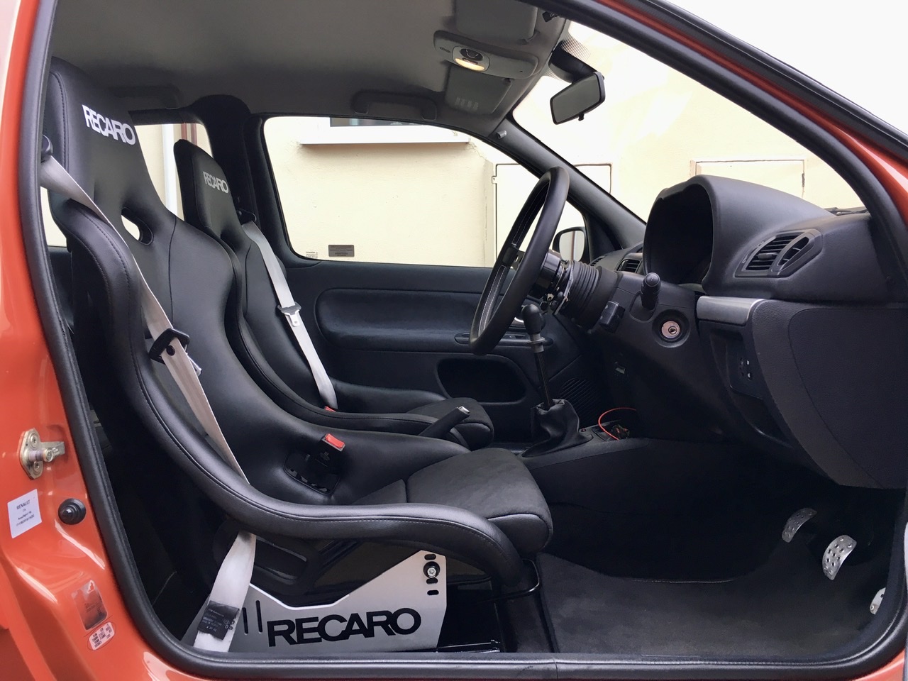

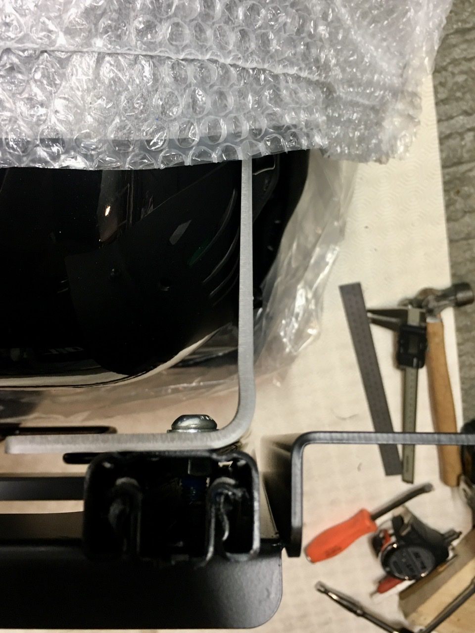

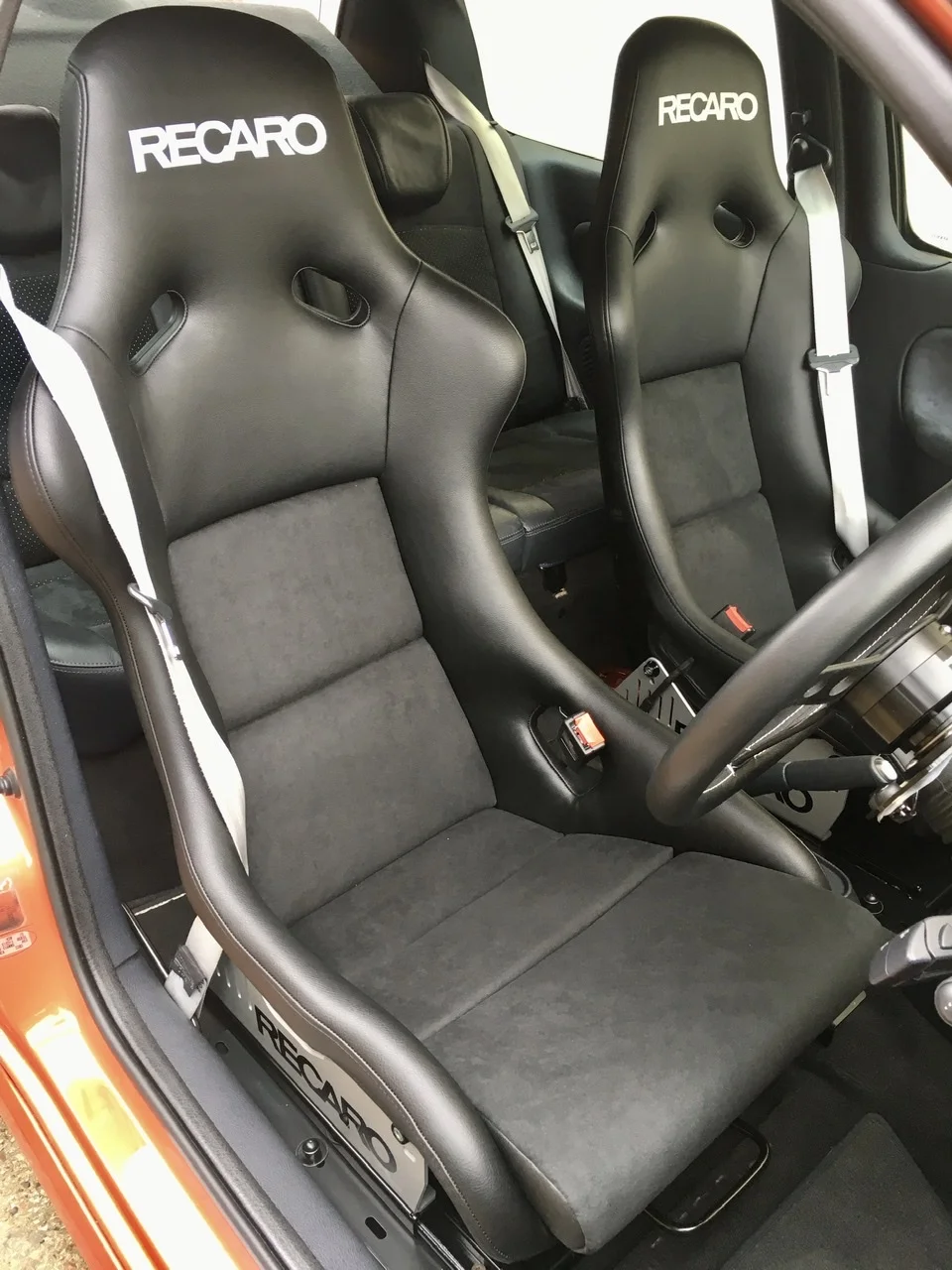

So I’ve been struggling to find time to get these in the car but finally pleased to say they’re in.

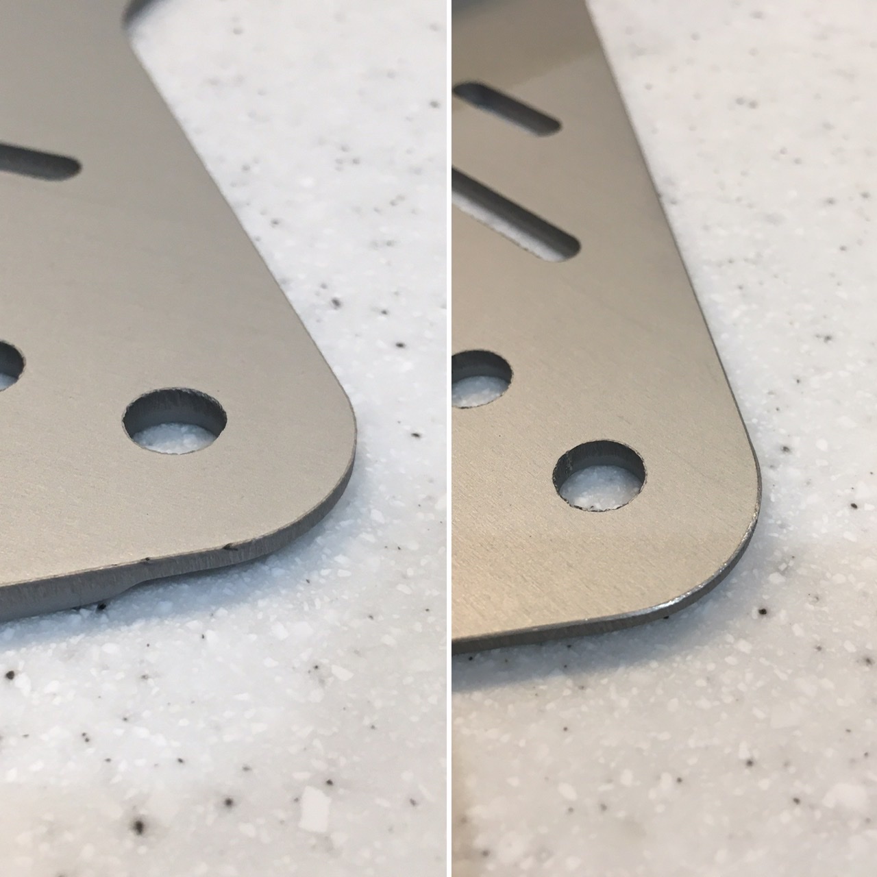

I spent time removing the birds from the side mounts so as to not scratch the shells, painting washers and capping bolts to make it looks as close to an OEM finish as possible.

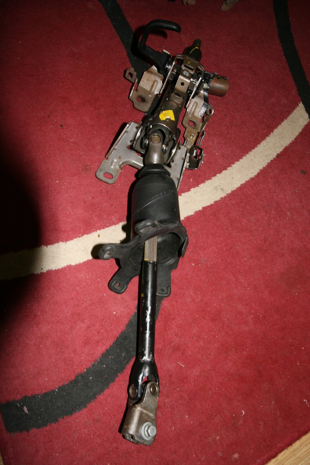

The car finally has a seating position that it should of left the factory with, although I’m going to shim the steering column down a few extra mm. It’s already down 5mm but I’m guessing 7 or 8mm will be perfect.
Not much else to say about them, I’ll get some nice pics when the cars clean.

Seats Look awasome! could you send me a link to the seatbelt buckles they look like a perfect fit and the way you've mounted them looks spot on
frayz
Seats look epic mate, pretty OEM style too!!
That’s the plan. OEM++
Awesome mate.
Those seats...
Also nice to see somebody else knows the virtues of ACF50 (y)
Indeed. Hopefully try and protect as many components for as long as possibje
Cheers dude, dropped you a PM with the buckles. Tried to make the install as clean looking as possible
Absolutely perfect 😎
Thanks chap

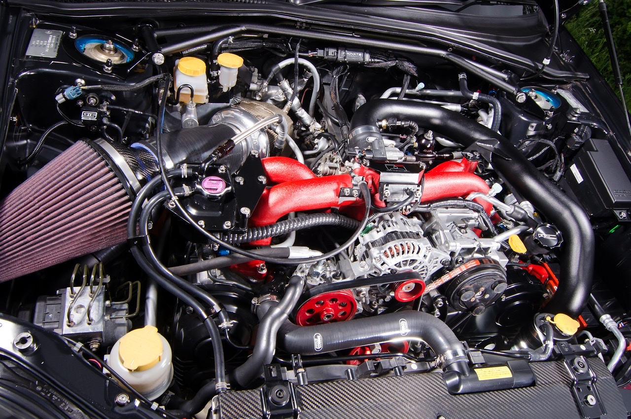

Totally agreed. I've had a couple of modern turbo motors in the last few years (Golf R and Meg RS) and, while they are impressive, you can't really use them on the road, even in standard form. To feel on the limit in the Golf, you had to be really tanking it, to pretty dangerous levels. When driving normally, you may as well have been in a 1.6 TDI, because it just didn't feel special at all. The Meg was better, as it at least felt a bit more special, but even a car like that can't really be stretched on the road. I ran the Golf alongside my old 172 Cup for a while and the Clio was way more fun in real life. Every time I got in it, it put a smile on my face, whether I was 30mph or 130mph (not that I would do that unless on a track of course). Sometimes slower is definitely better. Give me something with a bit of personality any day.
I don't think I'd ever have a turbocharged Clio, unless it was a 220T. If I wanted a turbo Renault, I'd buy one. Part of the appeal of the Clio is the normally aspirated engine. If I was you, I'd probably just build up a spare motor when you can, maybe a set of cams and some light porting/polishing etc to refine what you've got, and enjoy it from there. If you can get it somewhere near 200bhp, that's plenty in a road car.
This is the thing. Modern cars have become so capable and with performance so exploitable by the masses. Often this is at the expense of neutered feel, feedback and enjoyment. Cars are more impressive than they have ever been, theyre all things to all people now. A modern hot hatch will run rings around many of the Supercars of only 10 years ago.
Granted the Impreza was exciting, but exciting in a wide eyed and gritted teeth way. It would happily show a clean pair of heels to a mates LP640 even on low boost.
Certainly in a straight line, the Cayman wouldn’t see which way it went, yet the Cayman feels special every time I turn the key, every time I lay eyes on it, every movement of the steering wheel feels like you’ve been plugged into the front axle. The whole car feels just so right with the right amount of everything.
Side by side with the Impreza, I’ll take the Cayman every day. I also think it speaks volumes that I pushed so hard to get my little Clio back, even when I have arguably one of the finest chassis I’ve ever driven sitting on the drive in form of the R. The little 182 offers a driving experience that I don’t think anything has matched since or probably ever will now
In addition to that, I owned the Clio alongside the Impreza and even with 400hp less, I never had any less fun in the little Clio than I did spitting flames at 2.1bar in the Impreza.
One just cost a whole lot more to run. Lol

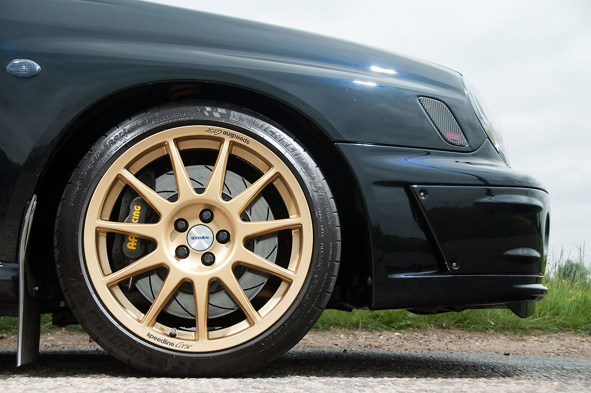

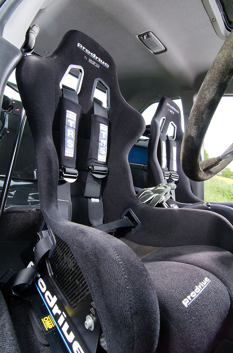

Looks mega mate,love the colour and wheel combo.what colour is it?.looks like a very dark blue?
Its called blue/black pearl. Black in almost every light but in direct sunlight it was a dark blue pearl. Was a stunning colour to be honest.
They made 1000 Prodrive editions, 900 in WR blue (02C) and 100 in blue/black. (08V).
Wheels we’re 18x8 Speedline Turinis as I’m sure you’d already recognised.
