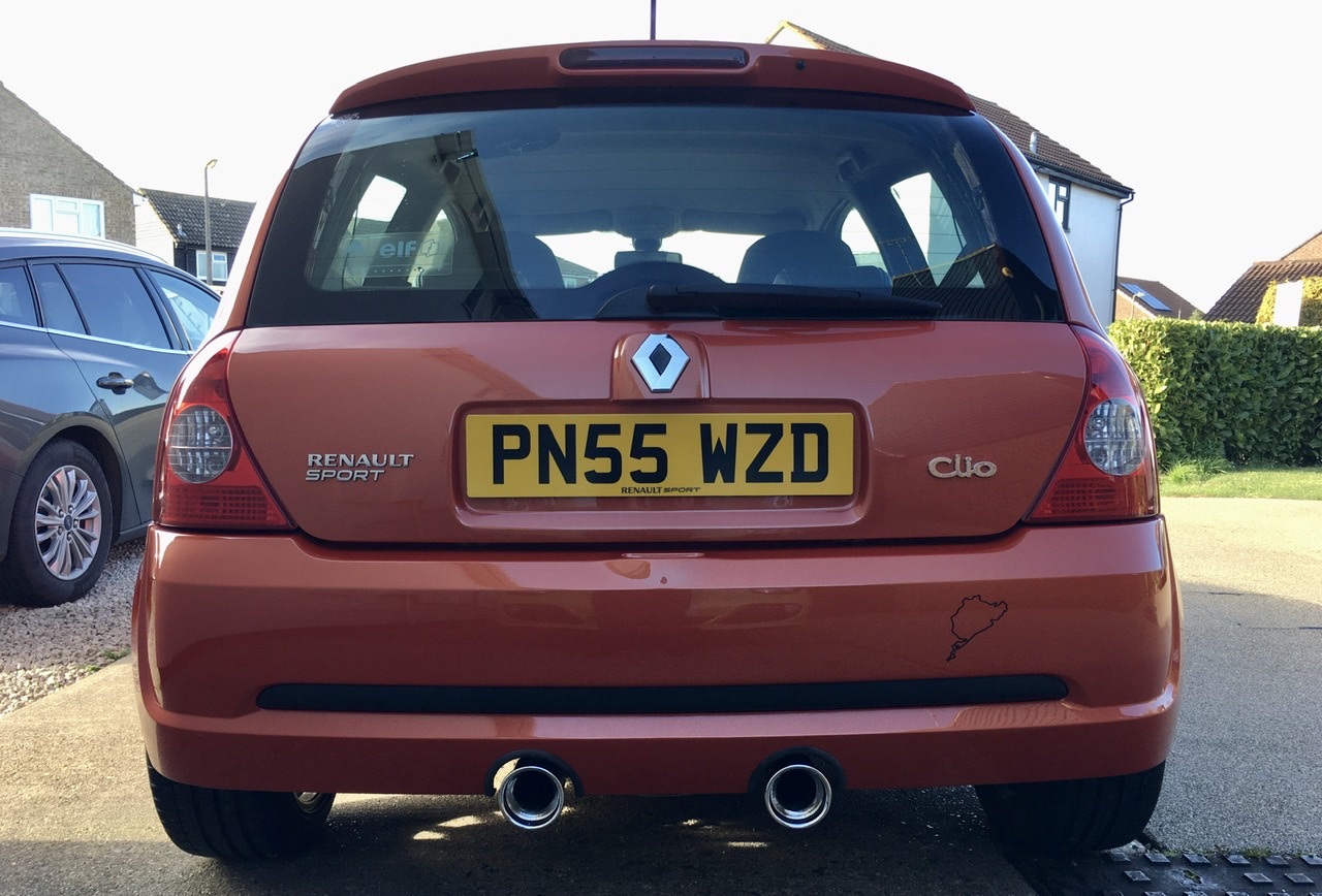

Hi @Darren61,
Is there any guide on the correct location for the original badges on the back of a Clio??
Those look in the right location, but wondering what you used for reference?? Got a set to go back onto my Clio RB and want to try to get them back in the original locations correctly??

Cheers mate, it’s coming along nicely!
Being totally honest, I just fixed the badge on by eye, looking at pictures on here of where it was applied from the factory.
So I’ve either got a very good eye or just got lucky 😂 I remember taking my time with it though..

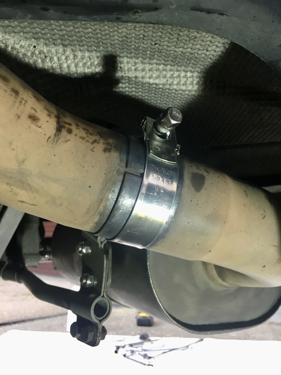

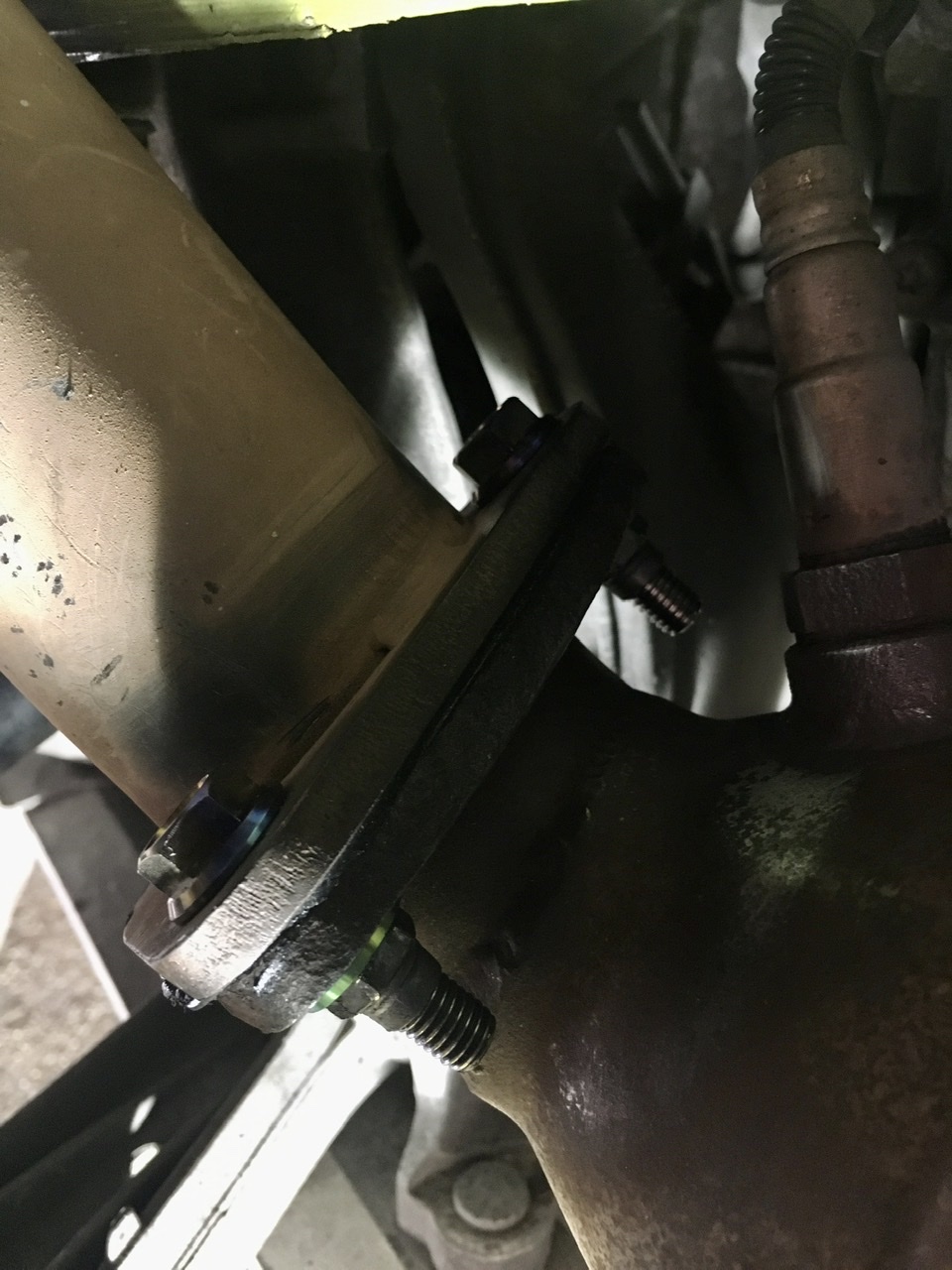

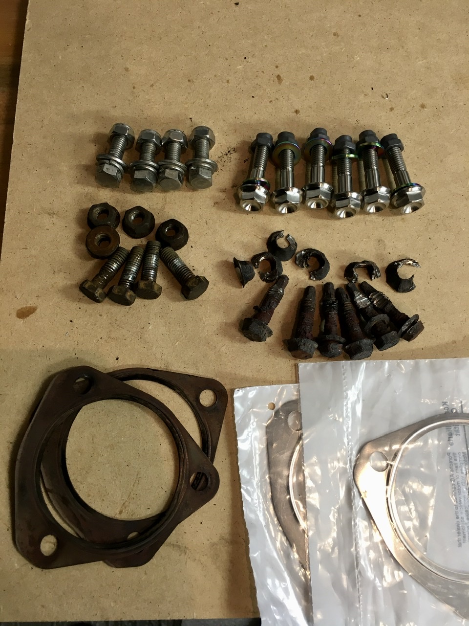

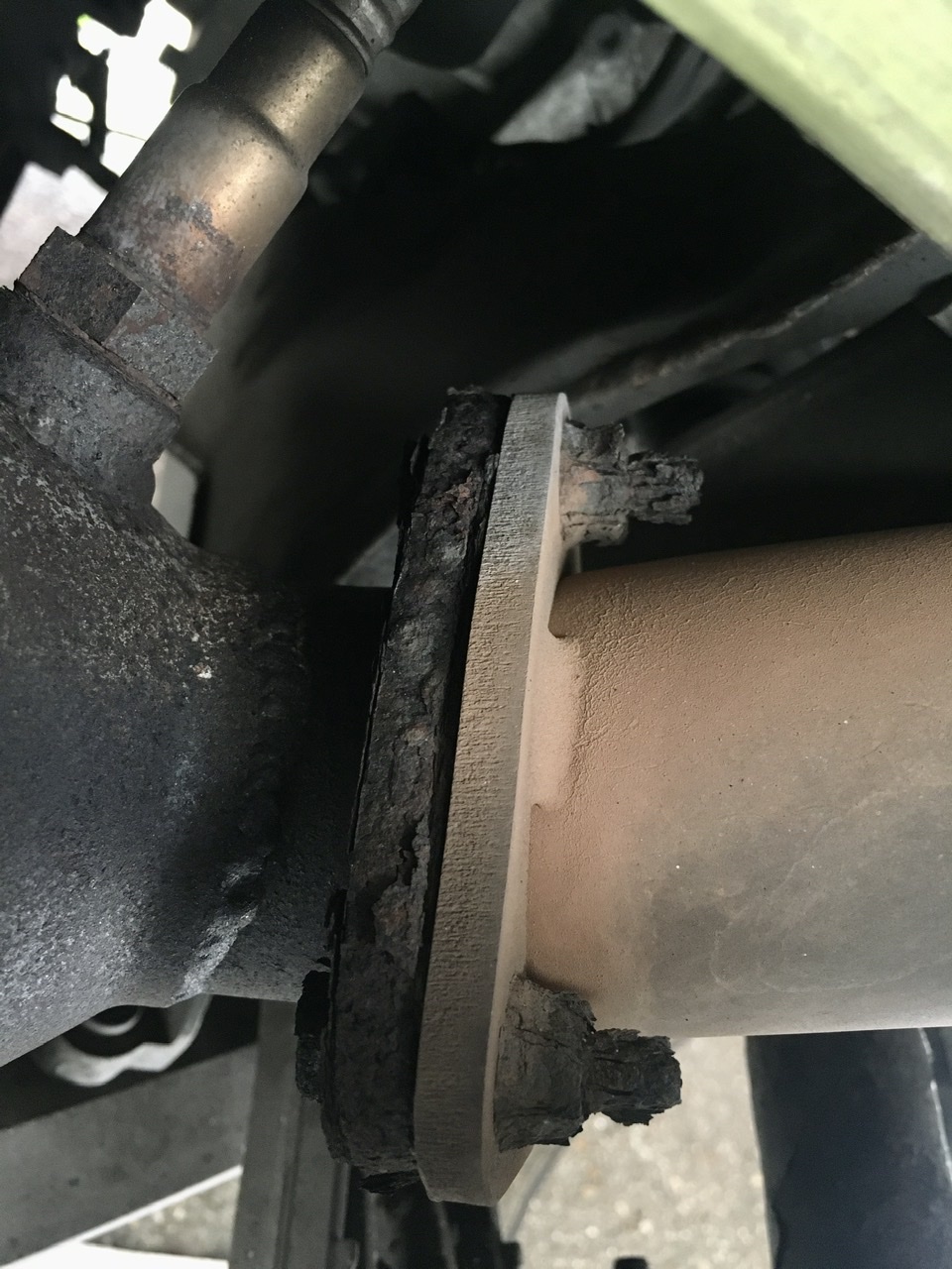

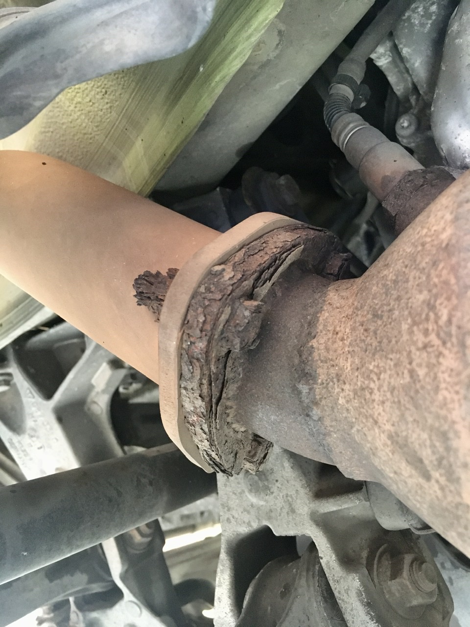

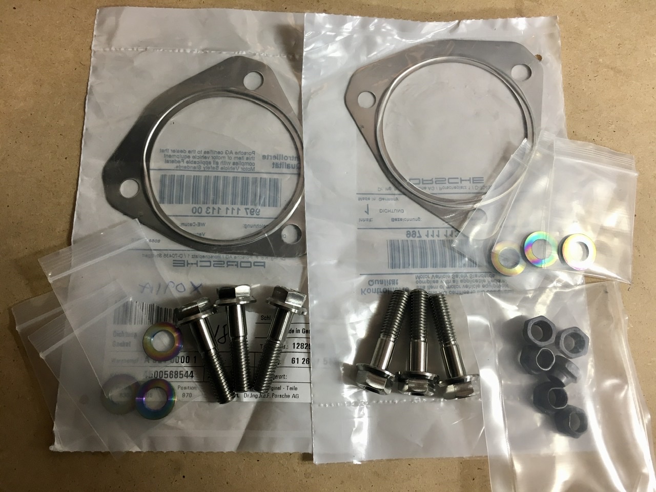

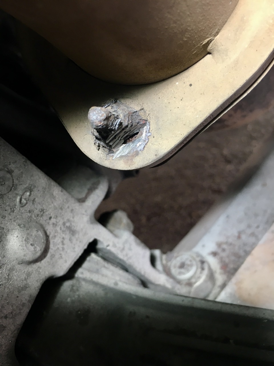

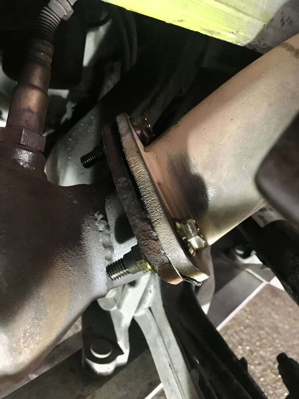

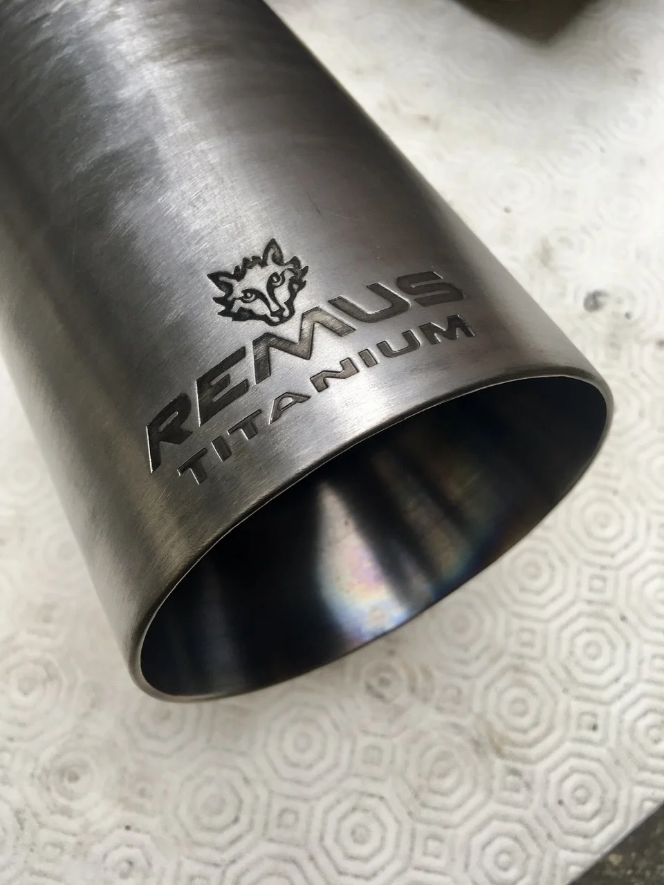

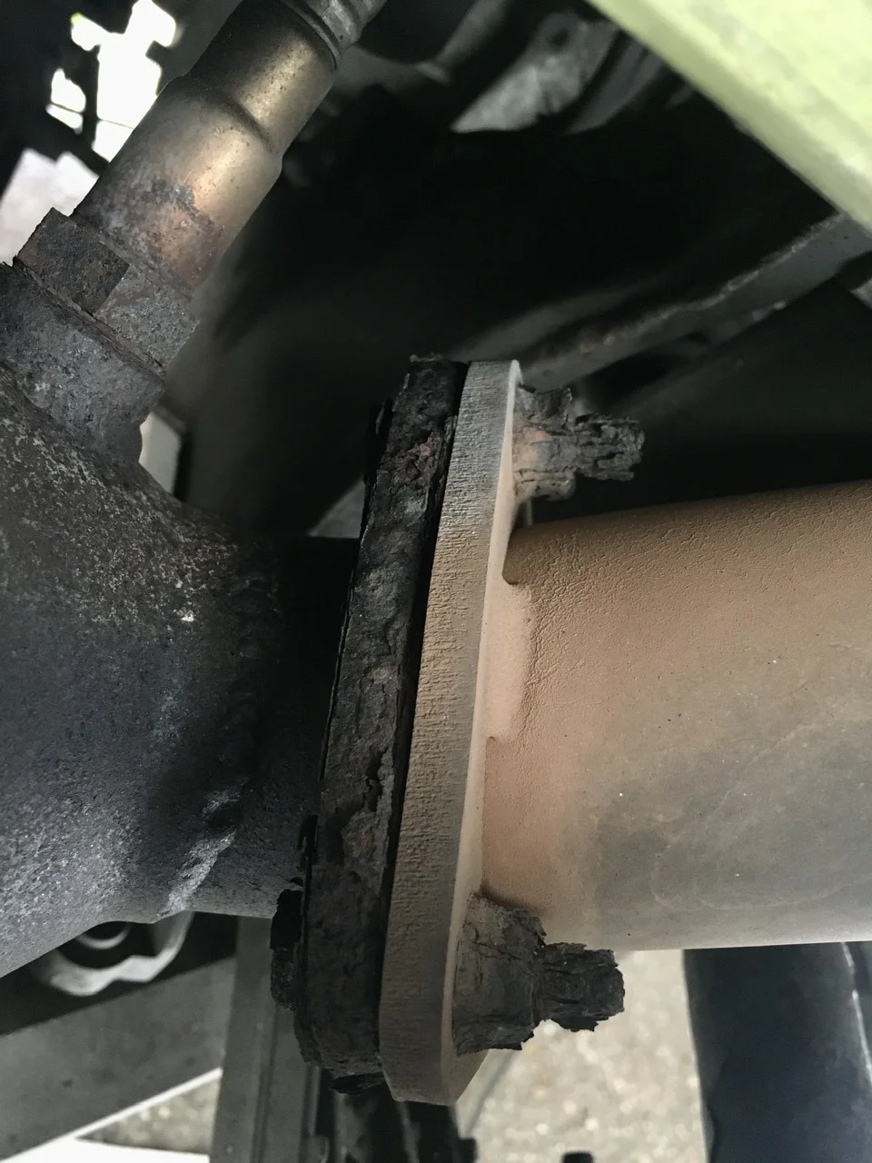

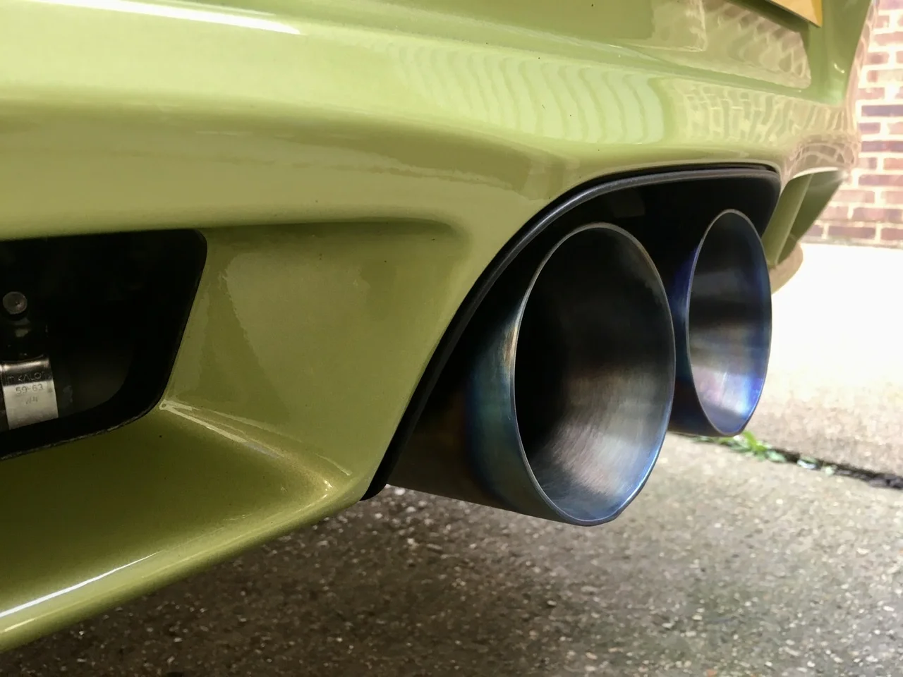

The Cayman wears a full titanium exhaust from Remus coupled to Fabspeeds race headers. Now I’m not too sure what kind of “stainless steel” our friends over at Fabspeed use, but it’s the usual s**t American quality and I could get a magnet to loosely stick to it. Subsequently the 3 fasteners holding the headers to the rest of the system resembled 3 Twiglets as opposed to any meaningful hardware.
At some point in their not too distant life I’m sure they would fail, so I decided to take preventive action and change them all now. Didn’t even bother putting a spanner near them, just went direct for the mini disc cutter.
Scalloped each nut out and tapped them off with a chisel. Dropped the system which is thankfully stupidly lightweight so I could properly clean the flanges.

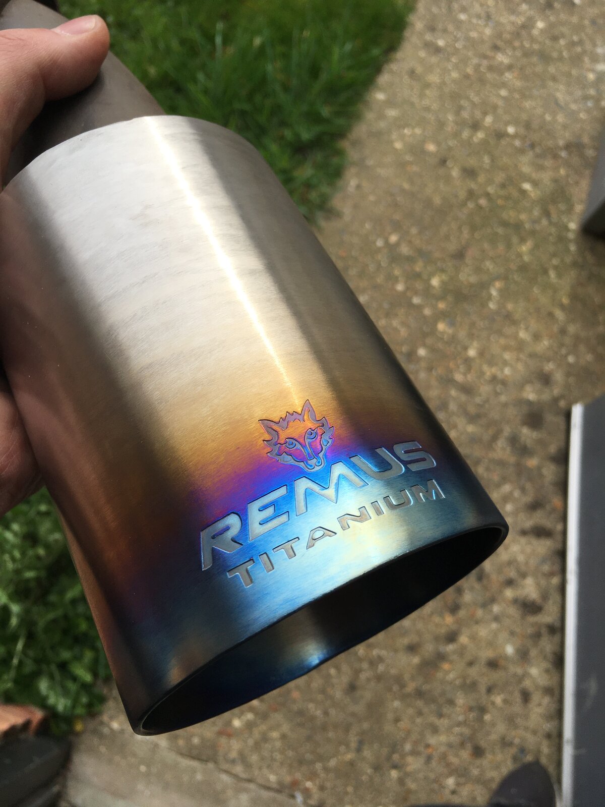

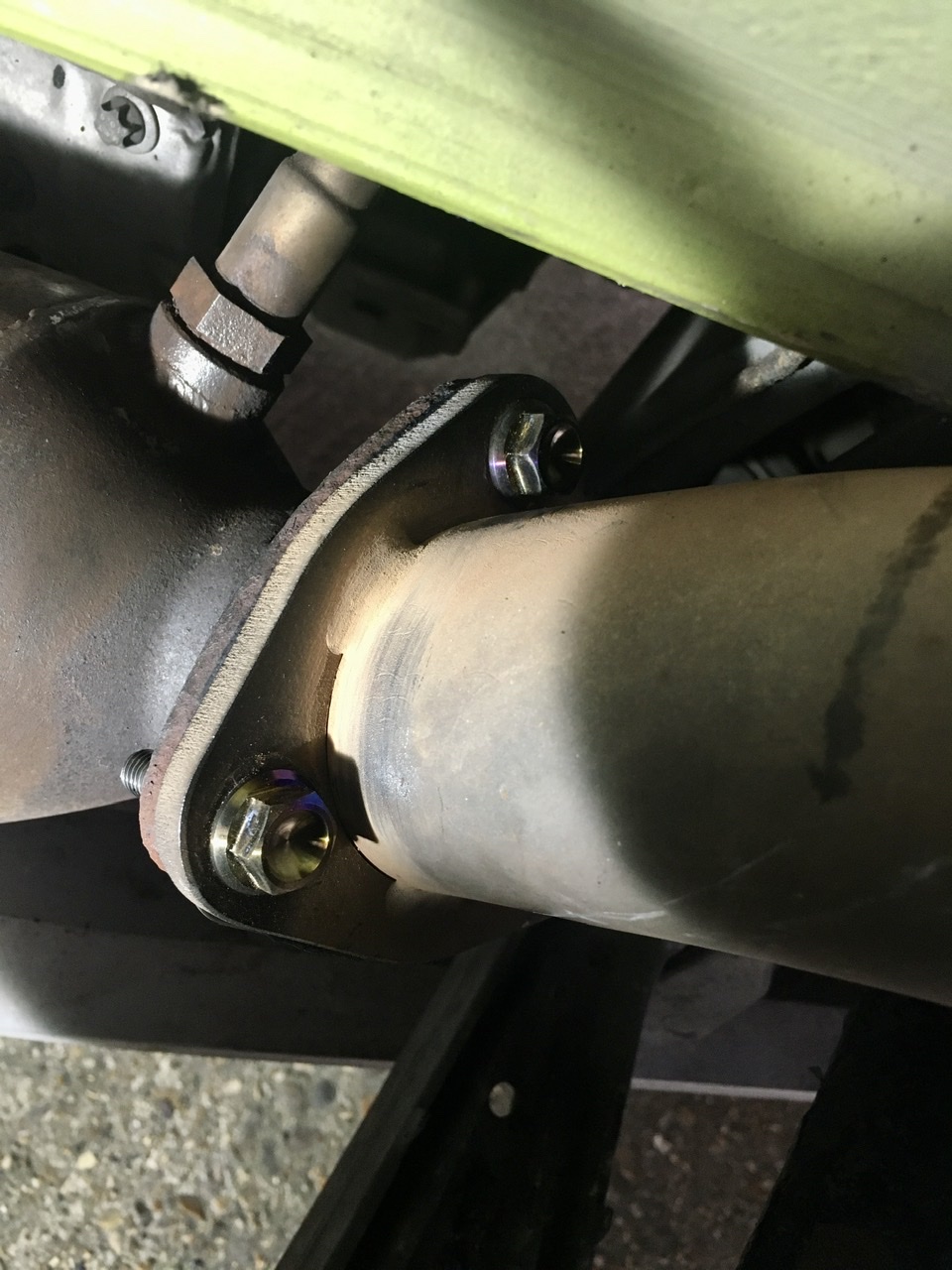

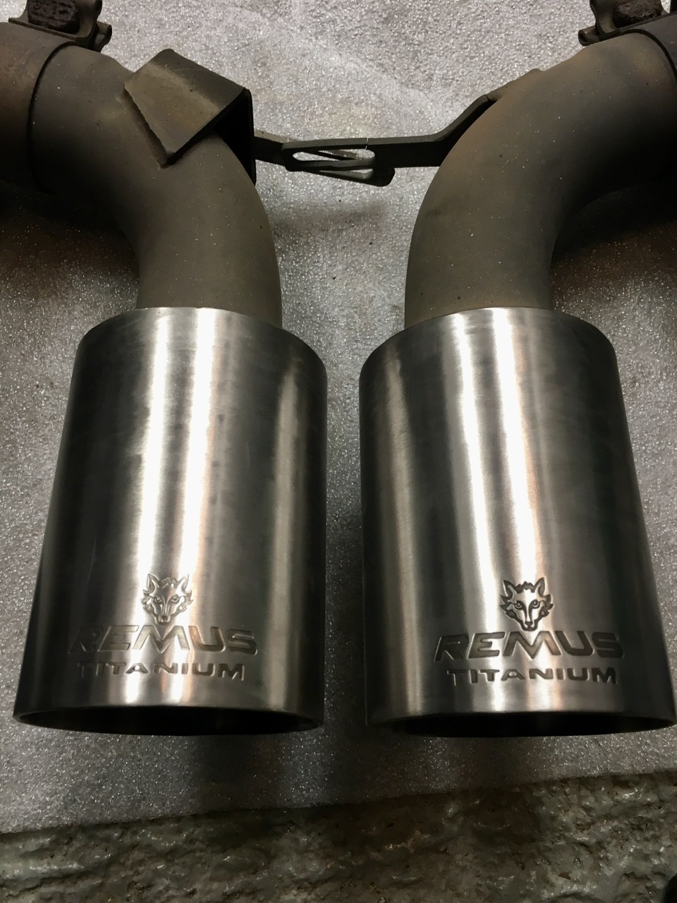

I’ll attempt to clean up the system before refitting it with all new titanium hardware and genuine gaskets. Made a start on the tips. The rest of the system will probably want glass blasting.

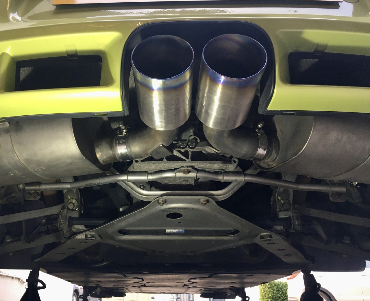

System stripped, cleaned, refitted and realigned. All new titanium hardware includuding aerospace K nuts. Also fitted new all stainless Mikalor W4s clamps in place of the old Normas.
This should mean I’ll never have any kind of corrosion or fatigue concerns on the exhaust hardware again.
Tempted to swap out the 18x header fasteners for titanium studs too, as these are a known issue to break upon removal. However I fear that’s a can of worms to think about another day.
All fitted and tucked up tight.

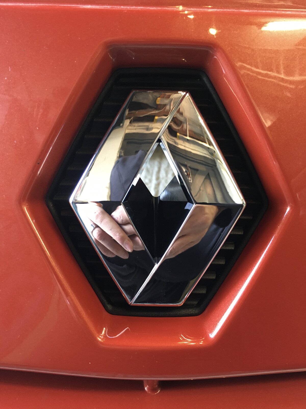

New genuine grille badge, amazing how much difference this has made as mine has a fine rash over it from 125k miles of enjoyment.

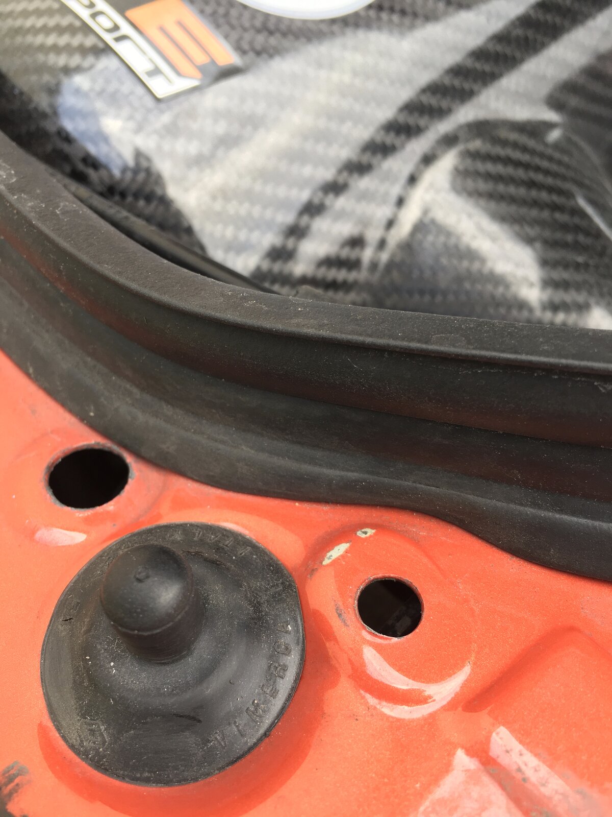

Next was a new bonnet sensor grommet kindly donated to me from a kind chap on ClioTrophy.com, you know who you are, thank you sir.

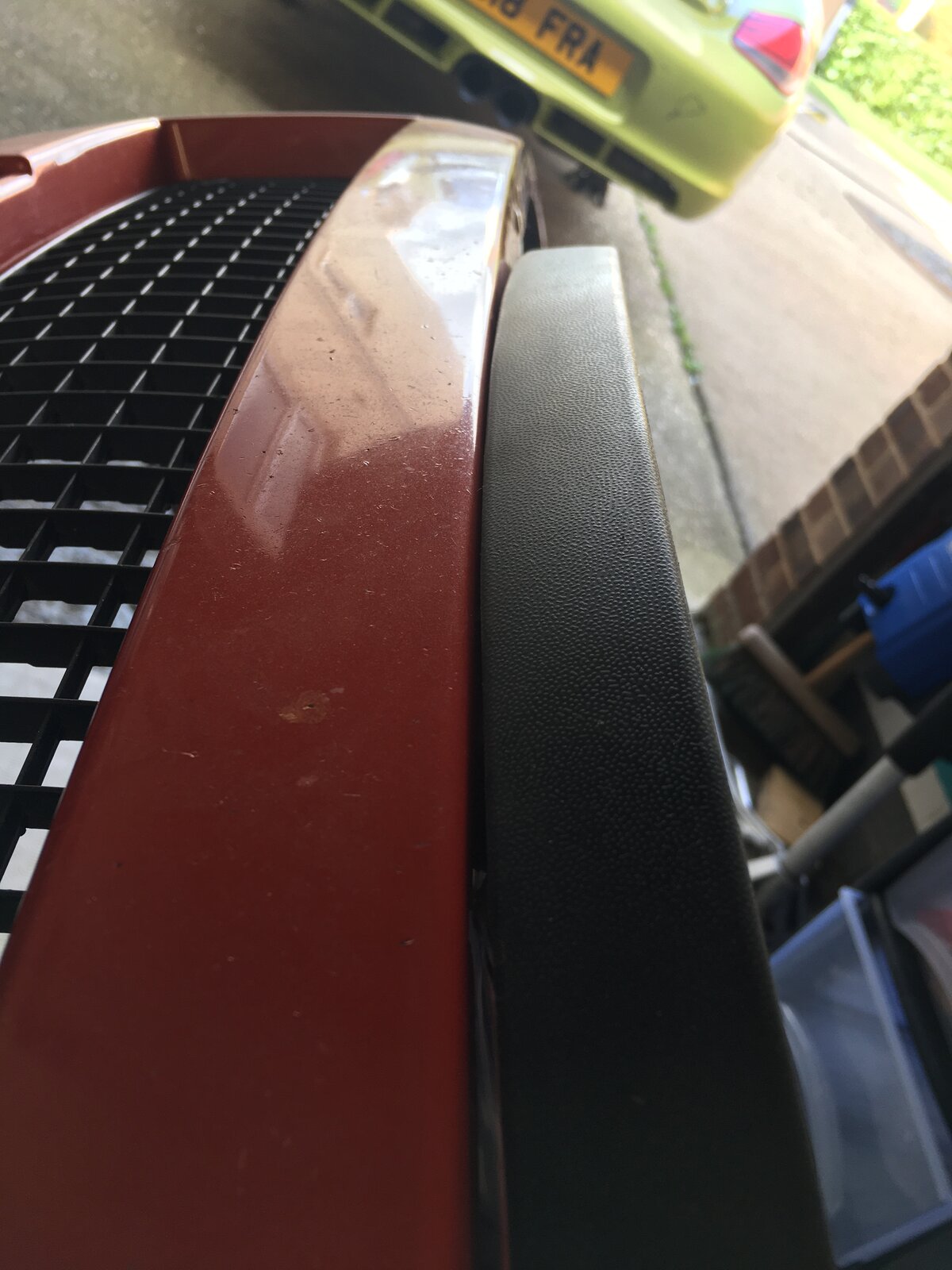

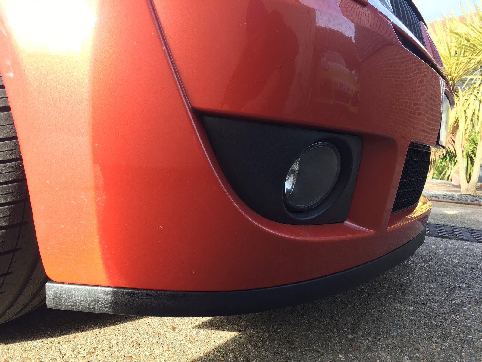

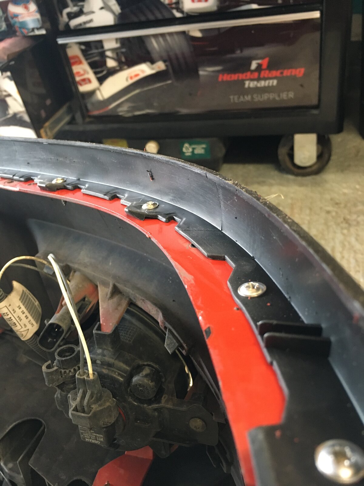

Removing a perfectly good genuine cup splitter to make way for a Fabia item.
Basically once the ASTs go on, the splitter will be even more vulnerable and at £250 for a genuine one, I think I’ll sandbag that in the garage for a £15 Skoda item.

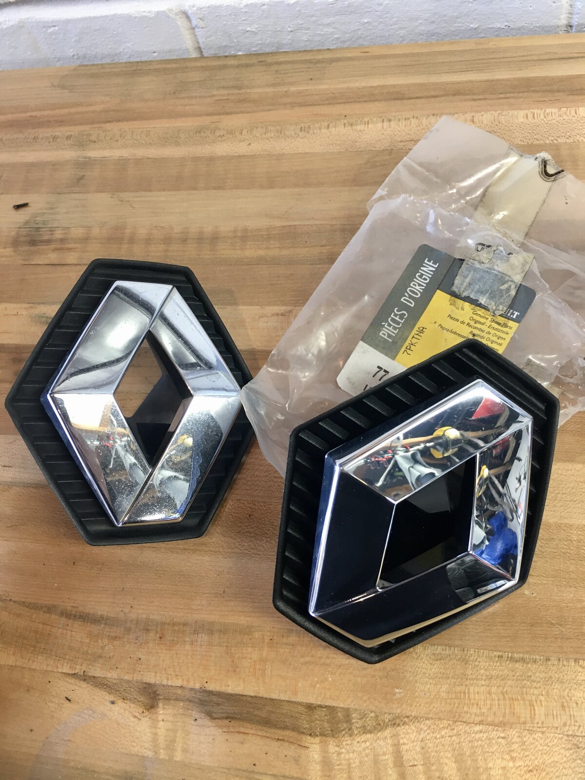

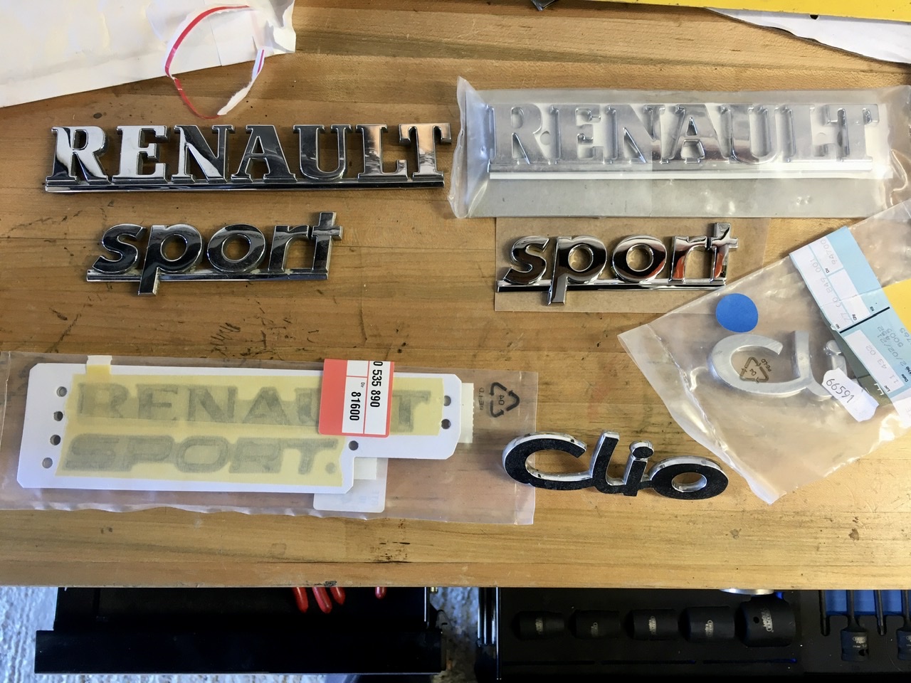

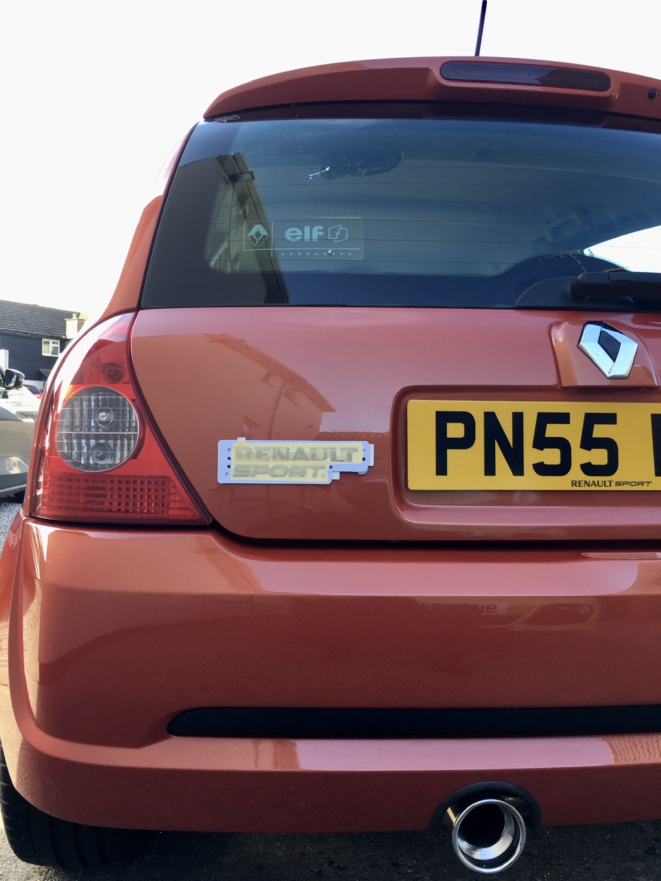

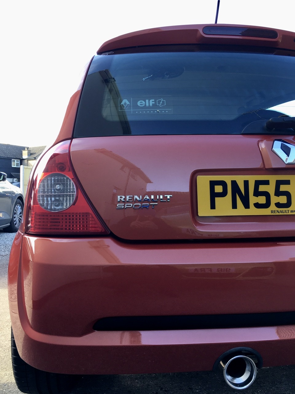

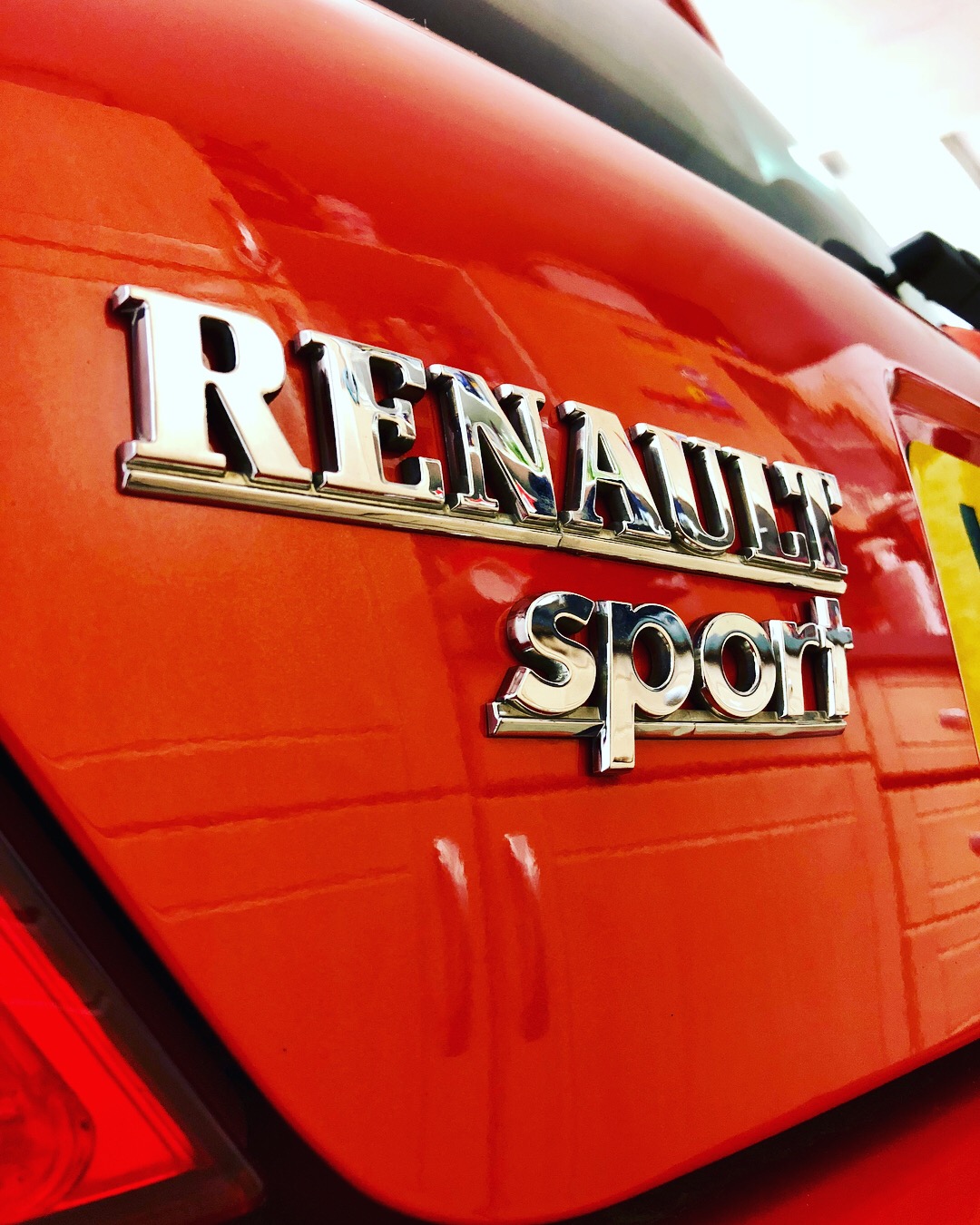

So, next little job was refreshing the tailgate emblems. I’d already replaced these about 7 years, but after 15 years the chrome badges were looking tired again.
I had deliberated at length over if I should fit the cleaner and more modern Renault Sport from the 197 cars. Or do I stay period correct with the original badges?
So much was this quandary I decided to buy both sets of emblems from Renault.

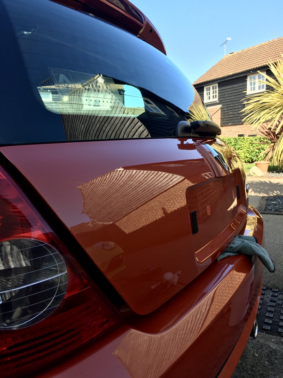

I haven’t polished the car since owning it as is just not had time. But with new emblems going on, the tailgate at least was a must.
So a quick soap, rinse, Iron X, and de tar. 2 quick passes with some Sonax on the rotary, an IPA wipe down and the tailgate was good to go.
I then spent probably another 2 hours blue tacking the emblems to the boot trying to decide what to do. Lol.
In the end I did opt for the newer emblems more compact, cleaner look as I fancied the change. I’m still on the fence about it just now, but I at least have the others if/when I change my mind.
