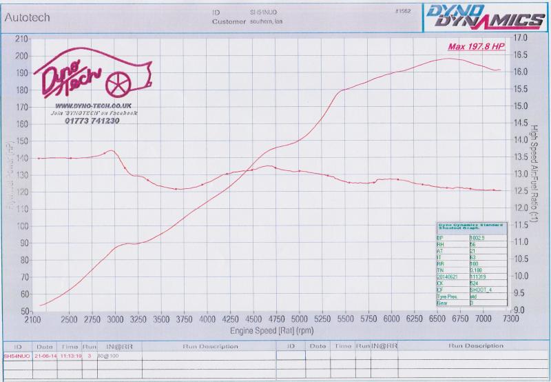

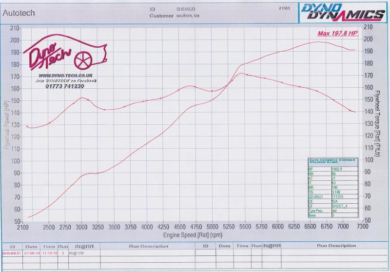

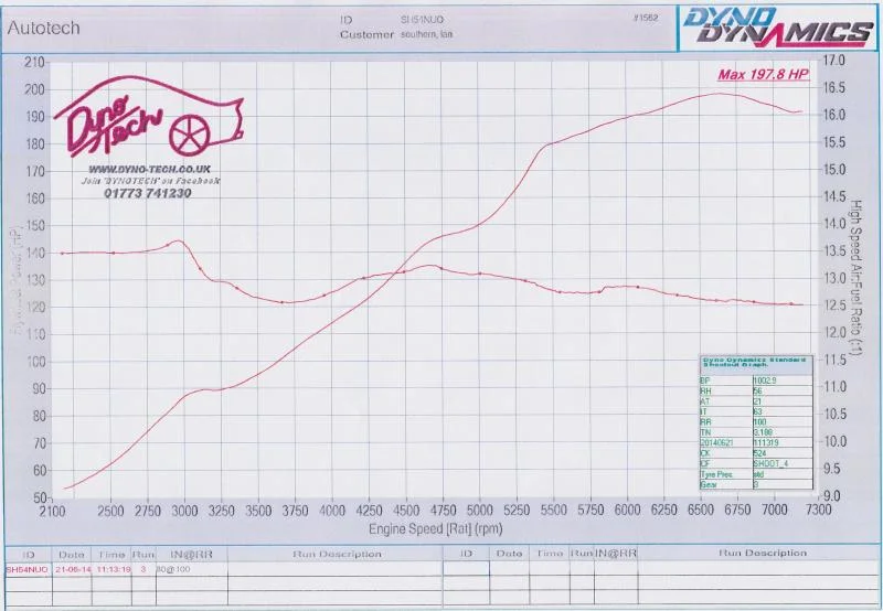

Had the 182 on the dyno with the east mids lads and got a bit of a suspect result:
Temp prob was placed behind the passenger headlight by the air filter. Is there anything with the dyno setup that could cause the result to be so high? The RPM syncing seems fine. The other cars got pretty much what they were expecting.
Mods are matched inlets, decat, Janspeed exhaust, RS tuner map and a cup racer style induction setup with a heat shield.
Its on 105k and gets thrashed everyday.

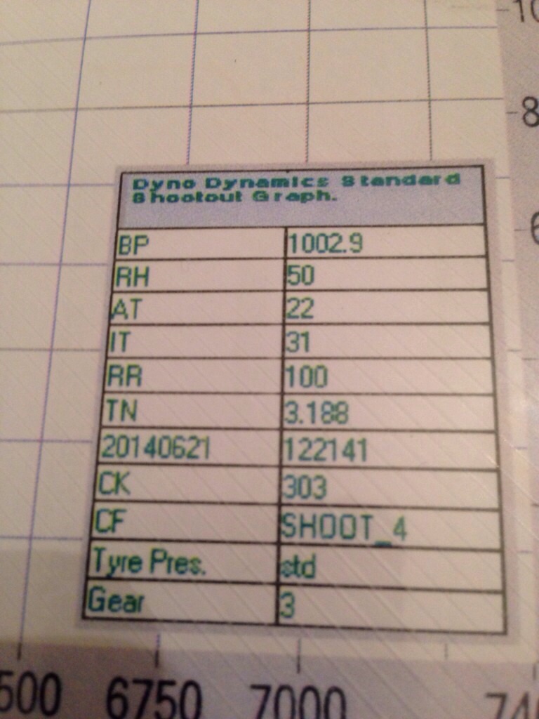

I think it's the intake temp that's caused the increased figure. The figures in the table bottom right are the correction figures and are used by the dyno to calculate the power. An increased IT would give a higher than normal result I believe. eg my Intake Temp was only 24 degrees which was 2 degrees above ambient (believable with my intercooler).
I suspect the probe was in the wrong place or moved perhaps.

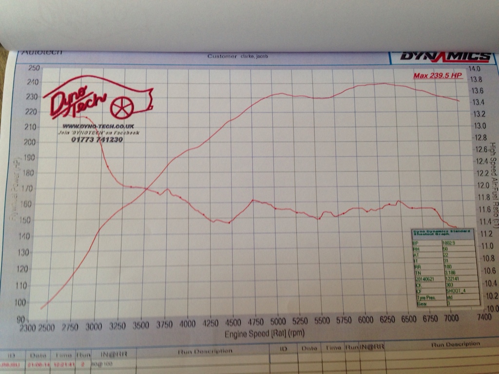

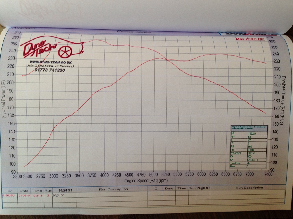

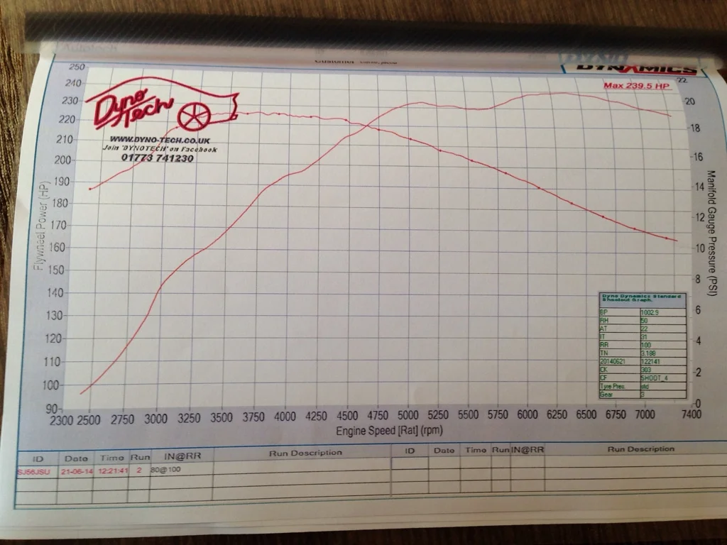

I'm going to put a pic of my graph up for you guys to look at.
Here's one of the IT&AT.
How does that look?

IT and AT are fine, 9 degrees above atmospheric temp is fine. Mine were 22 & 24. You're engine light is on though isn't it? Do you know why that is?
They do appear to have run the rollers in N/A engine mode however. The roller rate is set lower than in was on my run. I believe it should have been in SHOOT_4F mode, rather than SHOOT_4 like yours reads. This means the roller rate was set at 100 not 150 like my run was.
Might be worth checking Kierens graph to see what it shows as a proper comparrison.

That dyno graph is worthless with the correction been sky high because of the inlet probe.

I think he's referring to the OP's as his inlet temp is very high. The Dyno software uses this figure to correct the results. Basically it says car x has made 180bhp @ 50 degrees IT, however the AT is 22 degrees and will adjust the figure to allow for the difference between AT & IT (basically it'll increase the power figure as theoretically the car should produce more power with a lower inlet temp)
