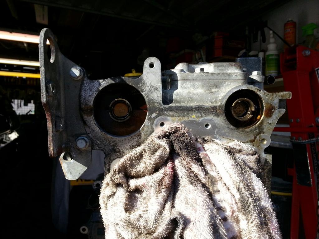

Im in the process of cleaning up everything first and was just about to take off my rocker cover and found out it actualy holds the cams in place ( bloody french barstards ) :p

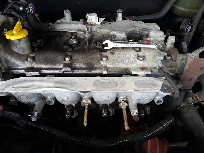

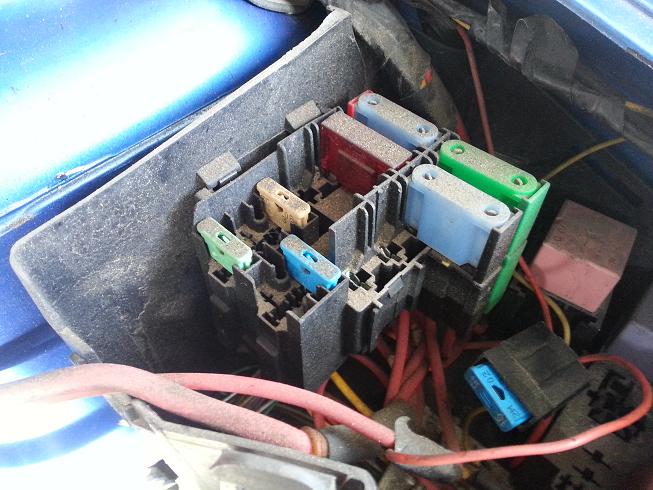

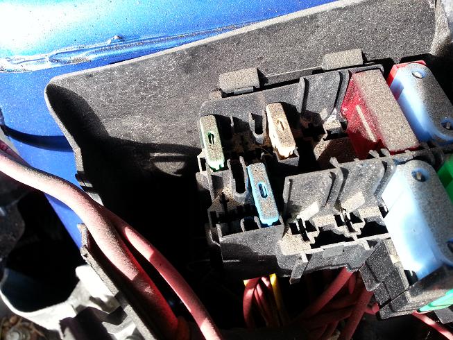

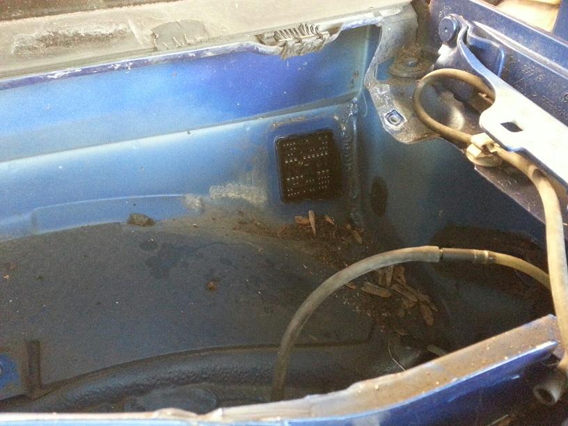

So to take my battery out and removed the fuse box cover to find it looking like this
looks like metal fillings, very strange, nothing the pressure washer cant sort out .....................;)

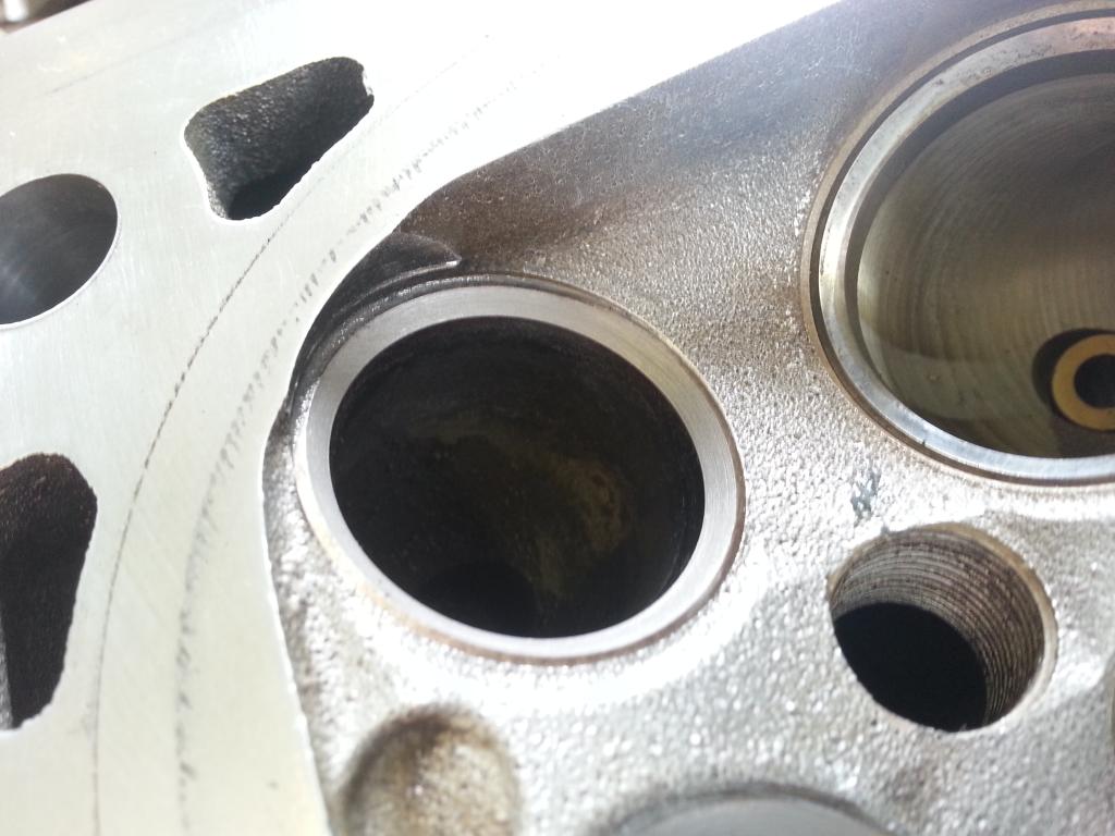

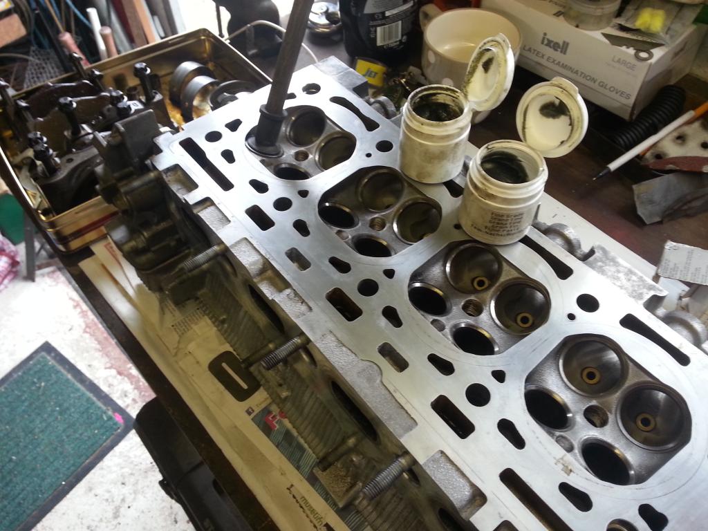

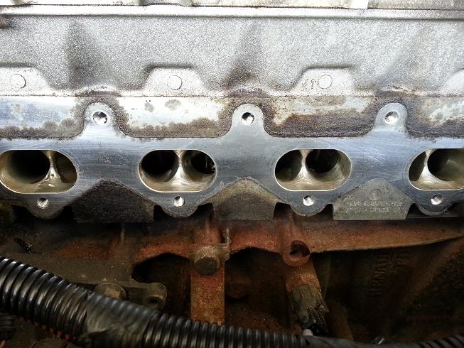

as i guessed .These look very very warn

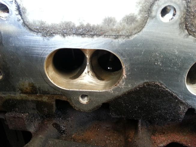

Never seen machine work like this before in the inlet ports, looks very wavey
When having head work done do most machine shops smooth these out a bit

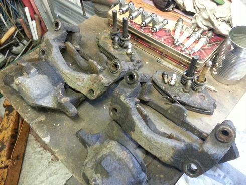

Took the front calipers off for a re-furb, drain all the brake fluid as well as it must be mostly water by now , i dont recon its ever been changed, same with the oil :banghead:
the sliders didnt really live up to there names TBH.
Has anyone got a spare rubber gaiter that covers the sliders as one of mine has got a couple splits in it

are these calipers unique to the 172's and 182's ??
i dont think i need to actually change the seals as they still seem pretty good, just gonna clean them right up

The calipers should be fine after a lil bit of tlc. Just need a little rubber boot thats all.

just read the other thread. had a real laugh at the wrong transit. sorry. but look forward to your updates here. im assuming them ports are not factory? looks like someone has had a go at it diy method. the grinds dont go that far in so have they just done it in situ without the head off?? :S

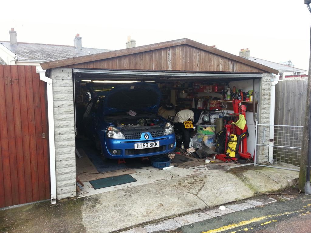

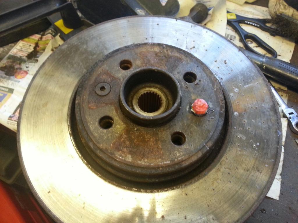

Well its a nice day so why not open up the shop for the day :
Went to take the Securing screw out for the disc, and guess what it didnt come out easy, weld on a nut , job done

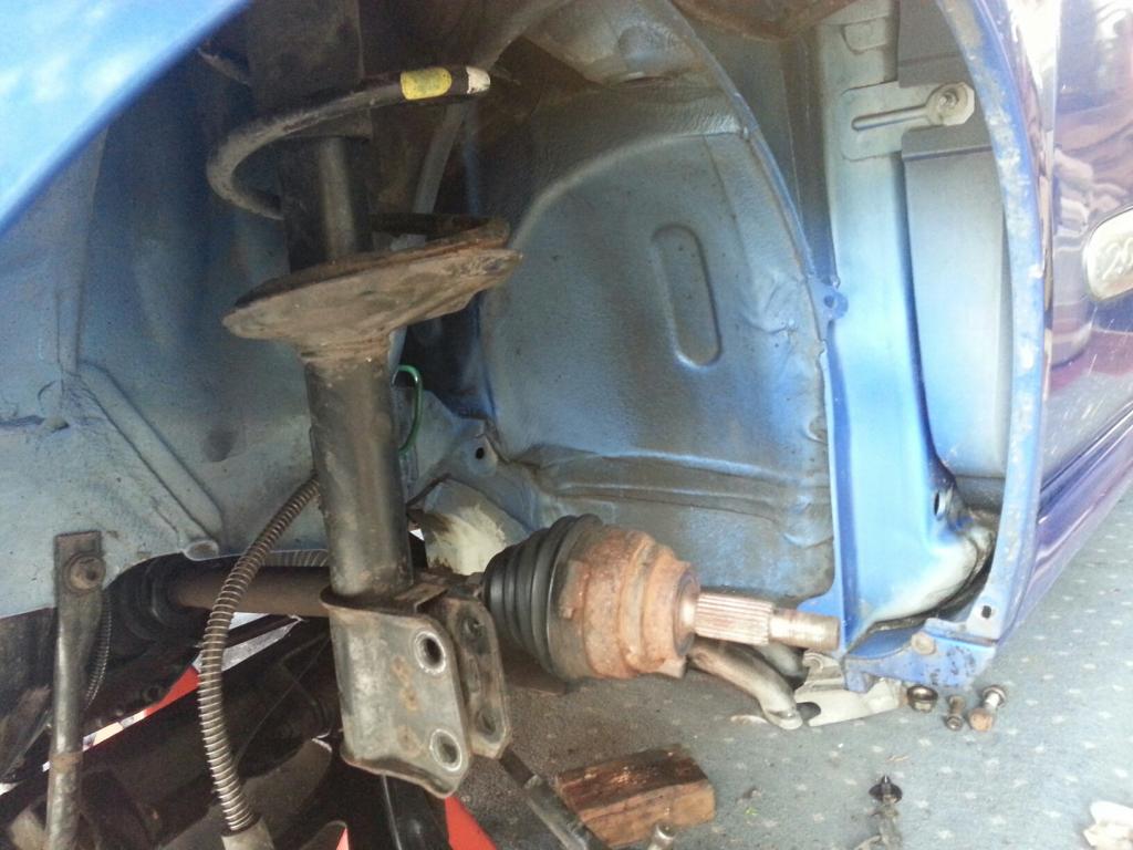

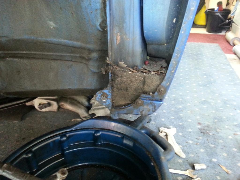

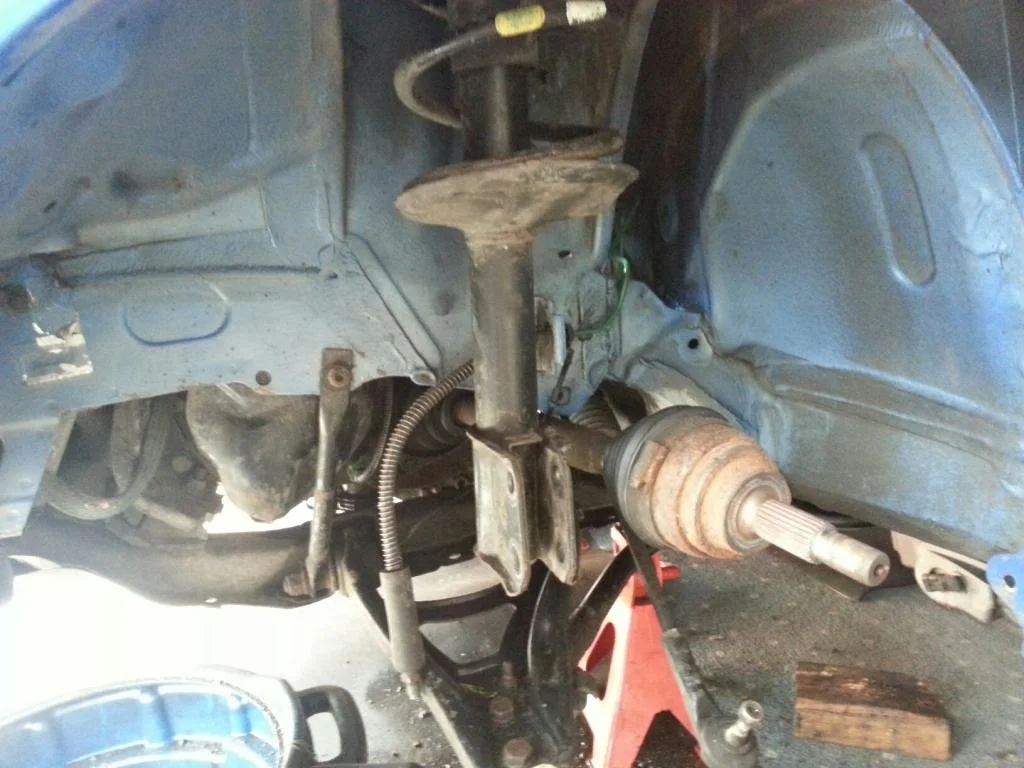

Took the arch liners off for a proper clean , found this mount of crap behind, must be as old as the car
Looking a but s**tty for my liking
Came upright TBH

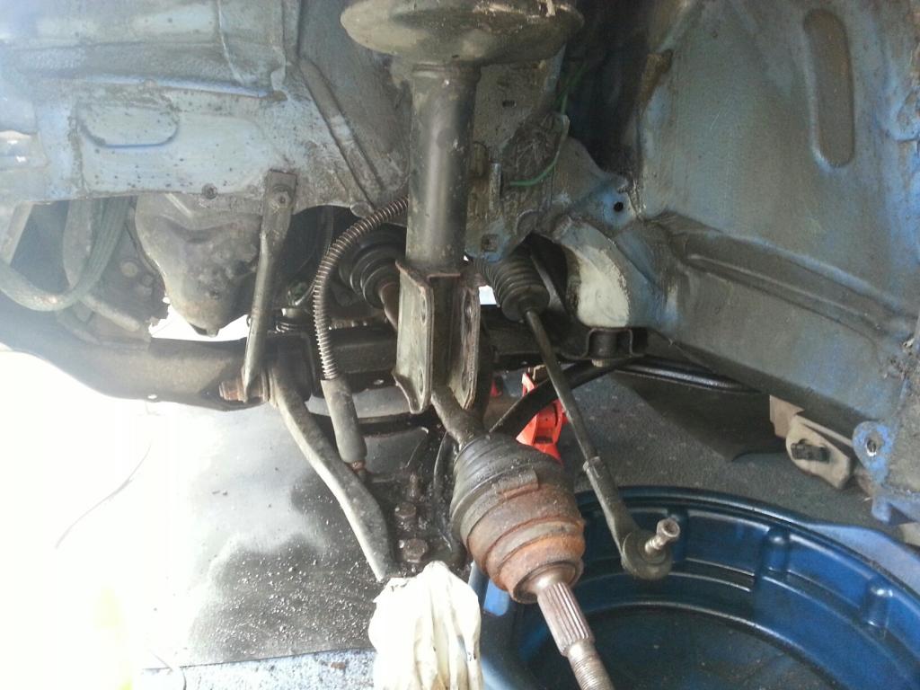

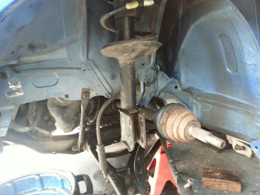

Dont know if renault use jubilee clips to secure there CV boot but this one is a beauty

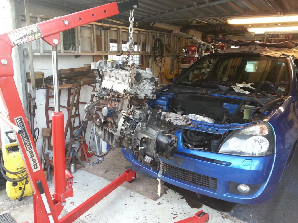

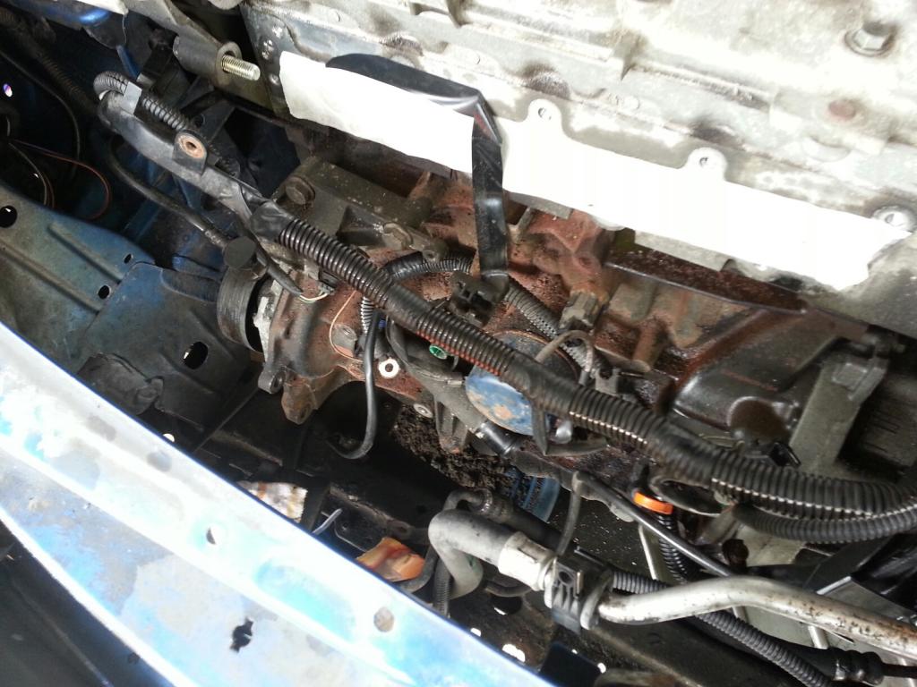

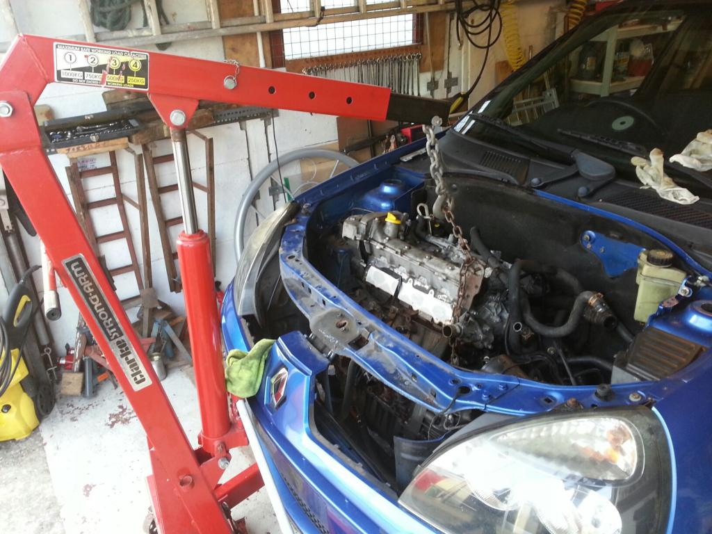

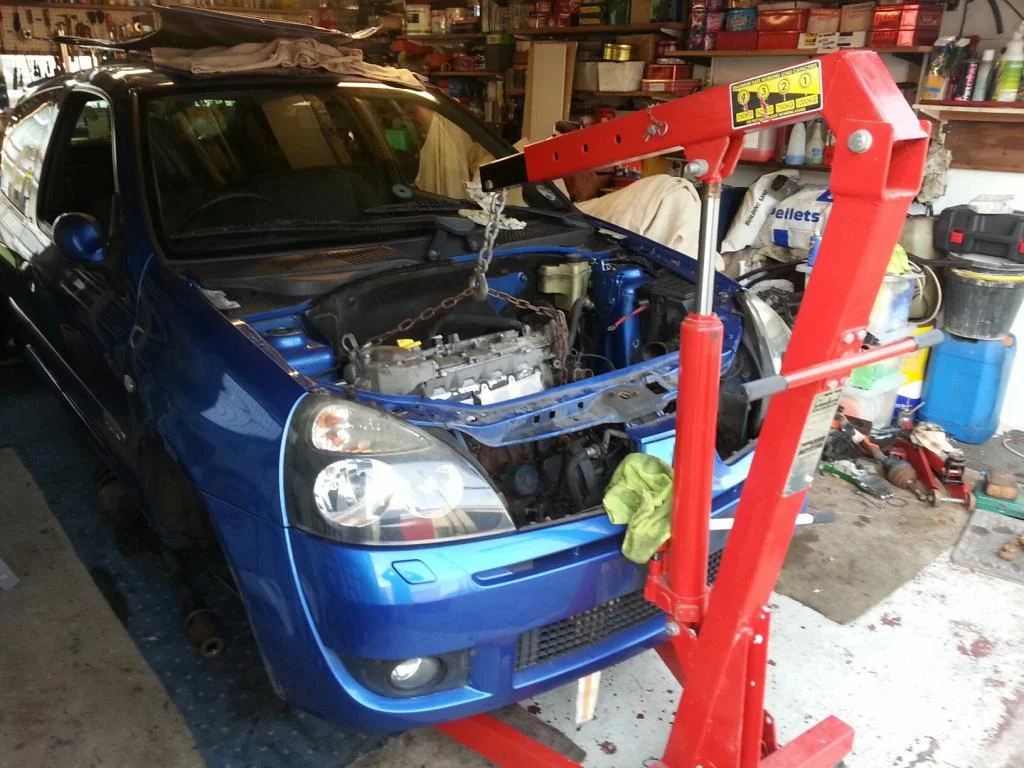

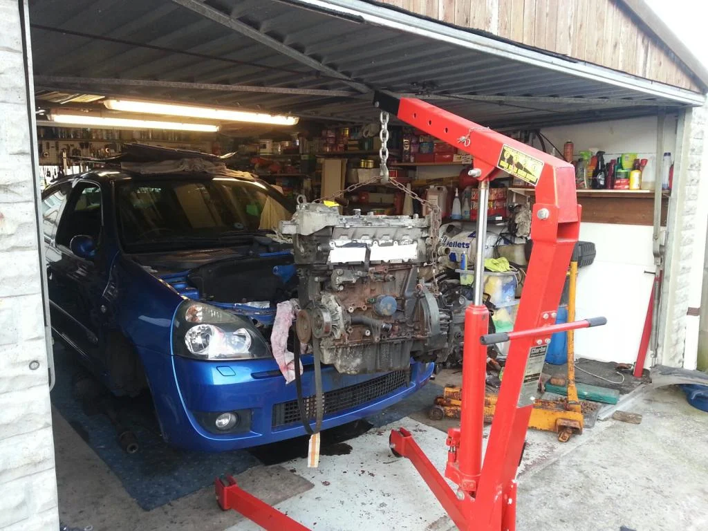

So after a week of nothing due to "Man Flu" I went into the office today and popped her out.
Everything is not to bad to be honest , just needs a good clean up
Found out the top engine mount threaded stub was totally ripped out from the rubber bush its self, another £56 there :banghead:

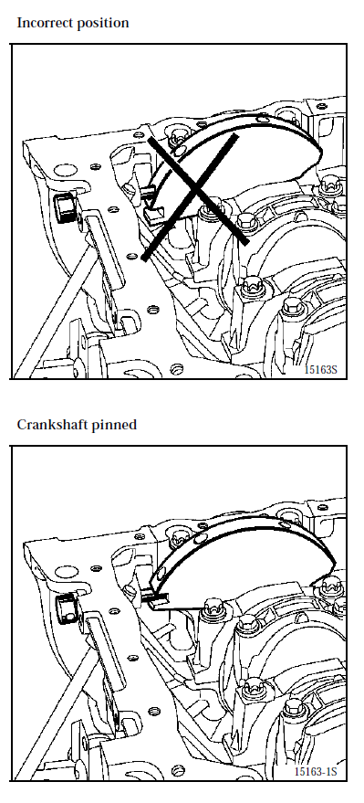

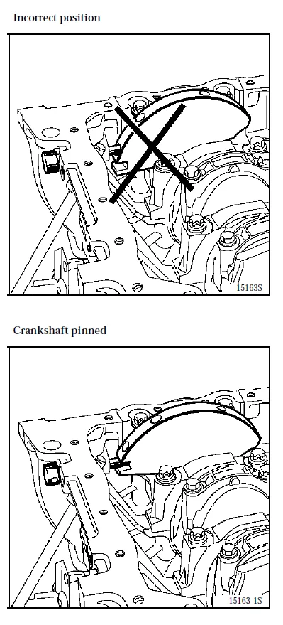

Well , dont know if this is right ? im guessing its not
Locked the crank and bottom the pulley was at the right angle
Then checked the position of the cams and found this ???
The timing coundnt be this far out could it ?
surely it would of ran like a bag of s**t ?

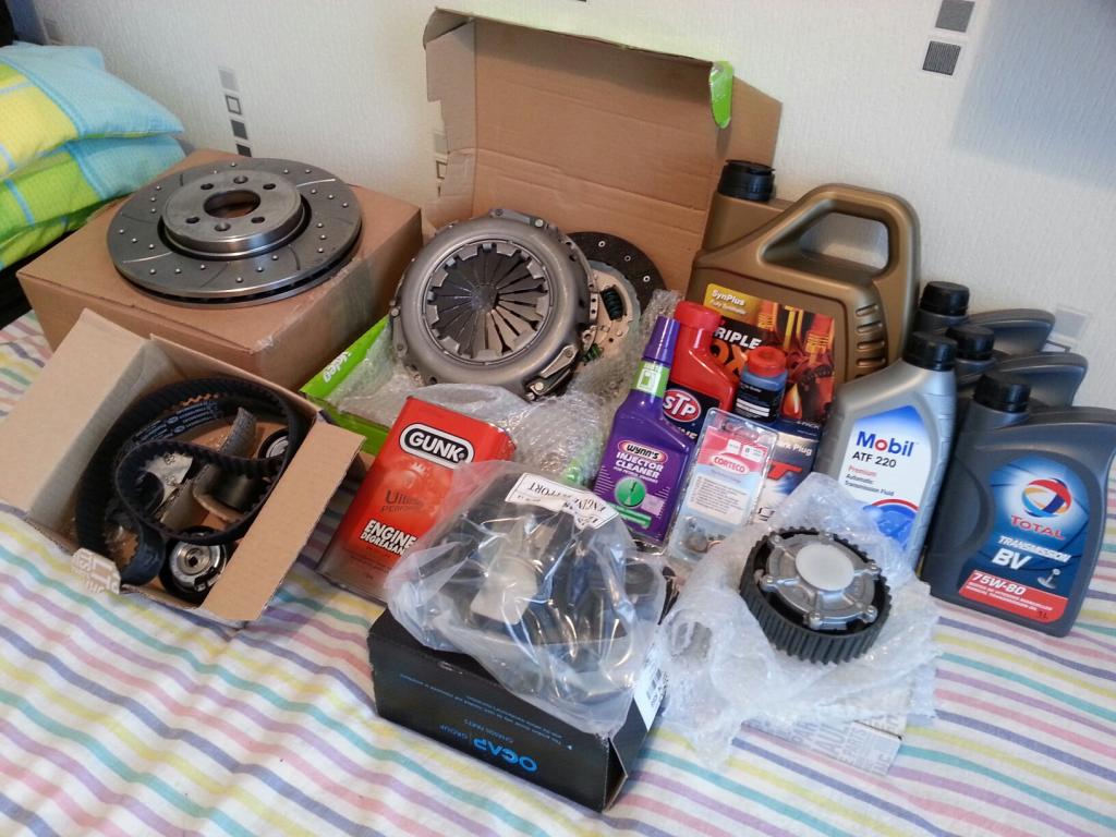

HAPPY BIRTHDAY TO ME
Everything seemed to just turn up this morning, best birthday ive had in a while :cheers:

my cam locking tools just turned up as well so im ready to go

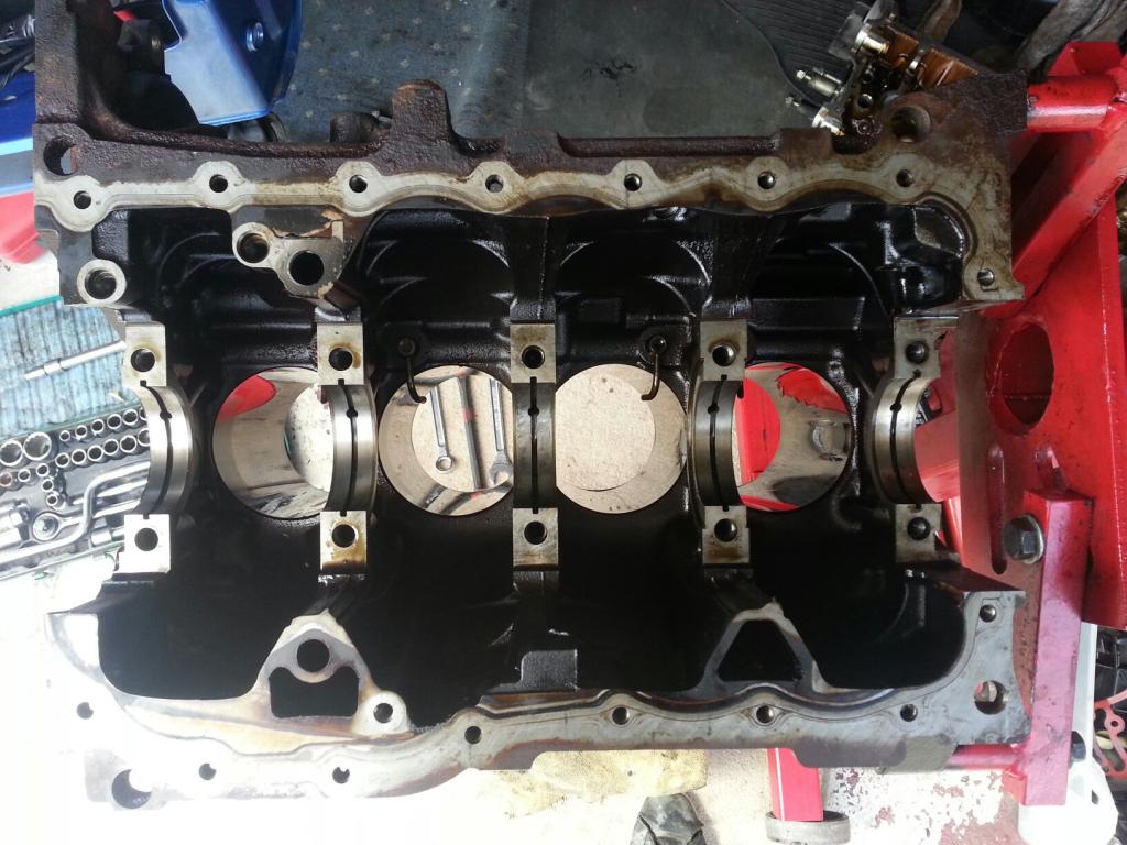

100 % locked correctly as i have the sump off. I personally think the crank pulley has floated round slightly when ive undone the bottom pulley

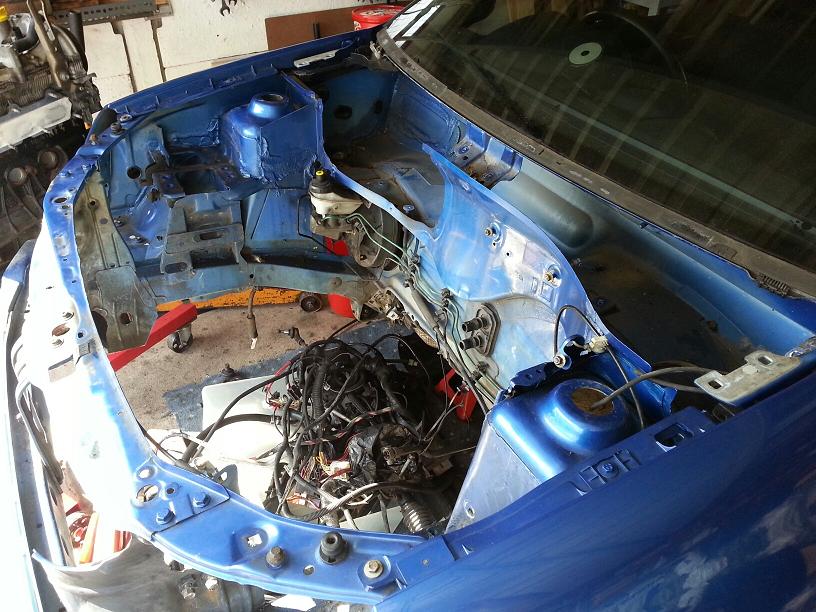

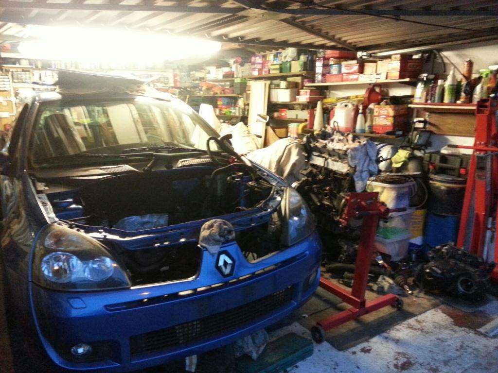

Thought i would pop a few pics of how she stands this morning

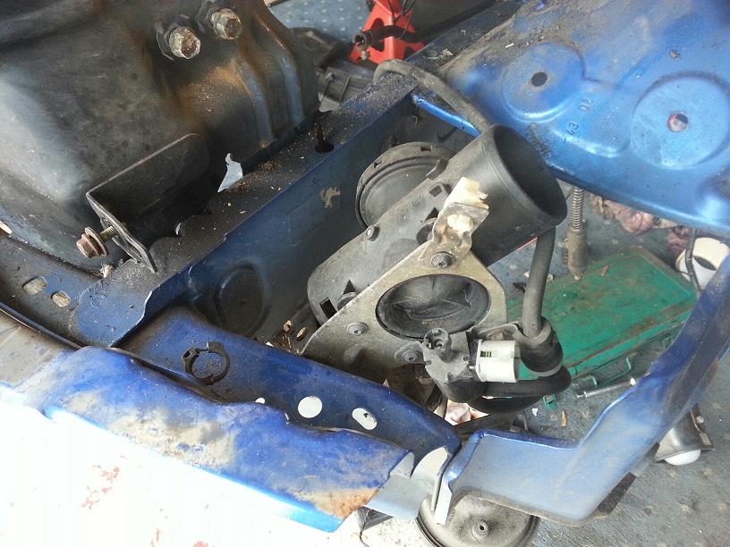

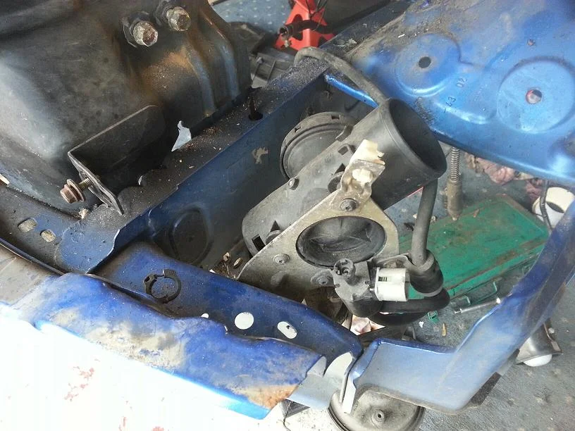

Do people fob this unit off, as it wasnt even connected to the intake anymore as the car had a K7N on it, it just had a vacuum from it to the underside of the T.B ??? Is it renaults version of a MAF sensor ?
Few more essential bits
Cheers Renault, makes life a bit easier
  Cup In bits
BTW you don't touch the 'bottom pulley' or crank pulley until you have checked the timing as it will slip. If you plan to do anymore without the sump off then remove spark plug no1 and put a long cable tie down into the cylinder so you can see TDC.
To answer your question yeah you can bin off the acoustic valve, it was only there to pass initial noise tests before leaving the factory.

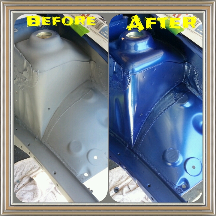

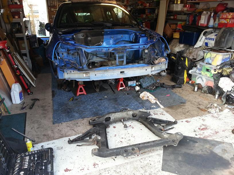

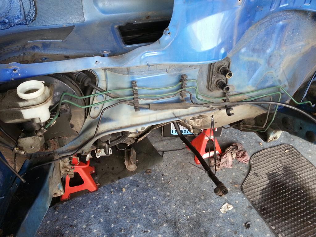

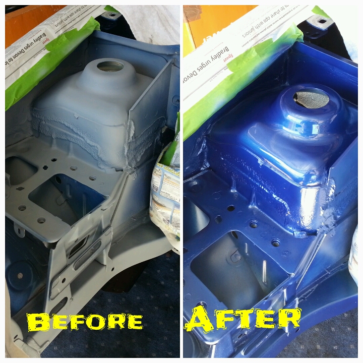

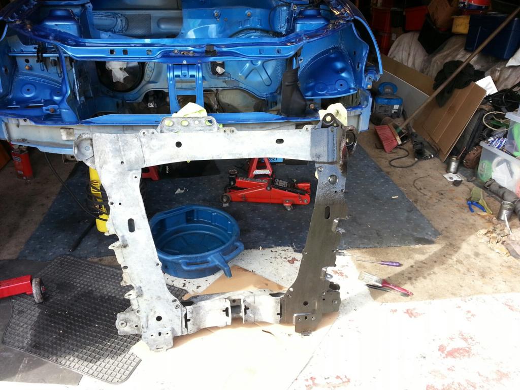

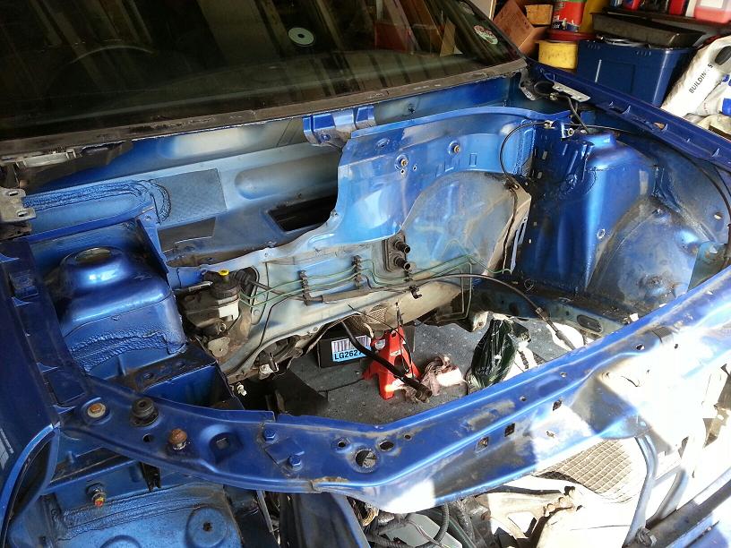

First things first , thought i would make good of the C.S tax disc holder as mine isnt really in need of it, well at least its on another french peice of s**t
Below is a before photo of how she looked when i took off the carpet/heat shield

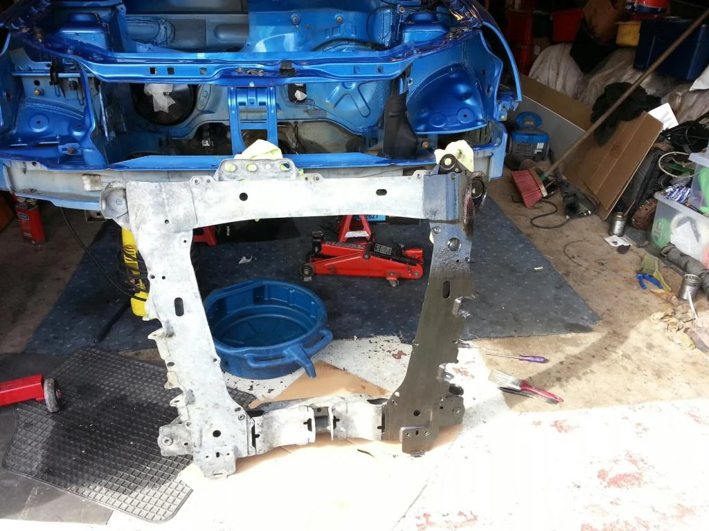

As you can see from the background it all came up nicely after a good clean, renault were a bit stiggy with the amount of paint they used under the bonnet TBH, and thats the subframe being painted after a good clean and preasure wash

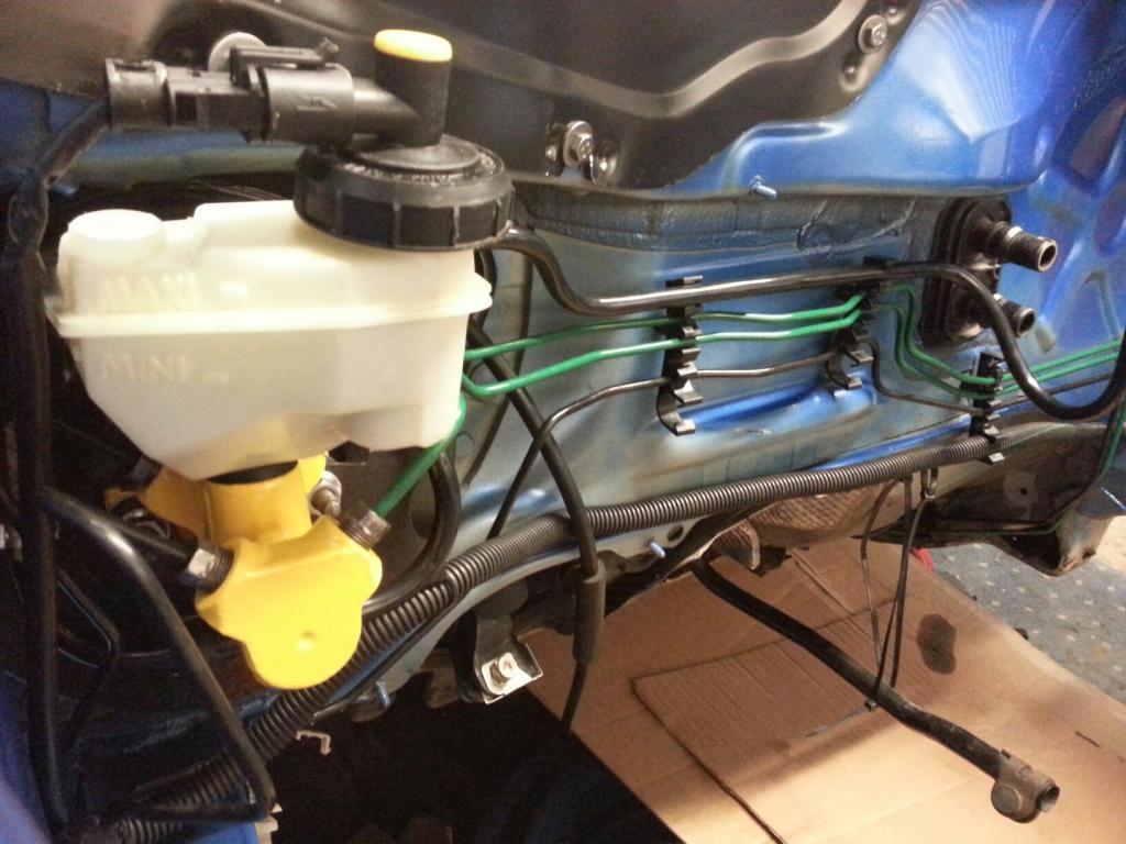

With all the lines taken off cleaned and all put back on this is how she now looks, Im even using the original master cylinder and bottle, they both came up very well after a bit of TLC

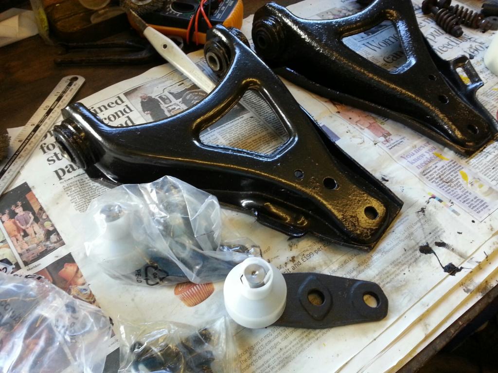

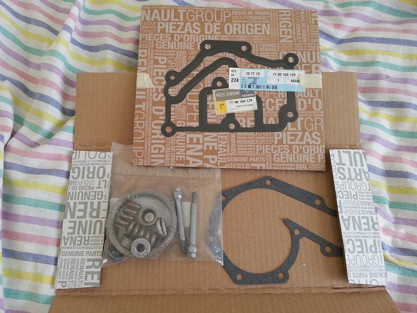

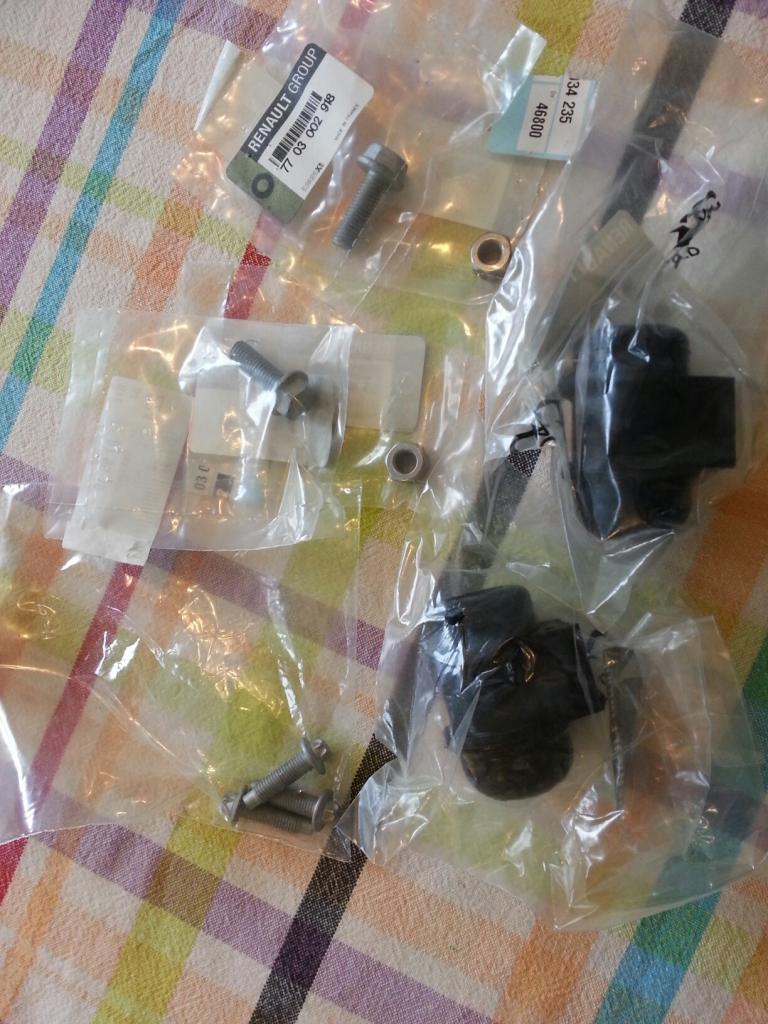

More Renault bits , what we have here is 2 new outer A.R.B bushes and bolts as one wanted to snap when I took him off and 3 sump bolts as they seemed to want to stay in the block !:quiet:
And then 2 new ball joints with new bolts and they also came ith 2 new pinch bolts , happy days

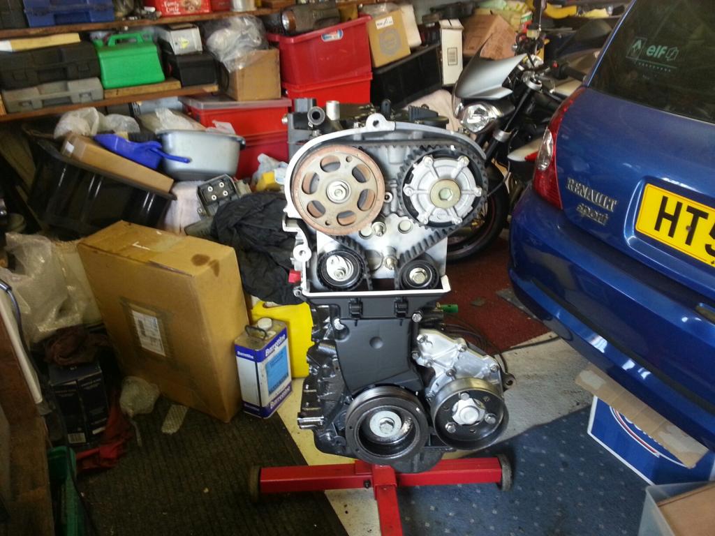

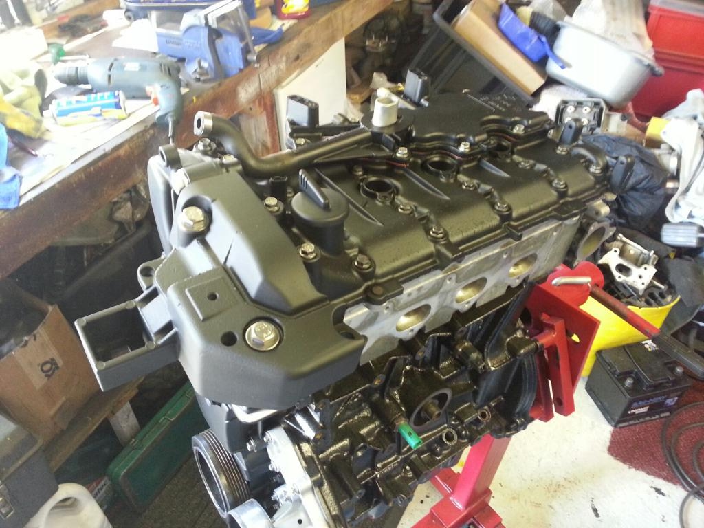

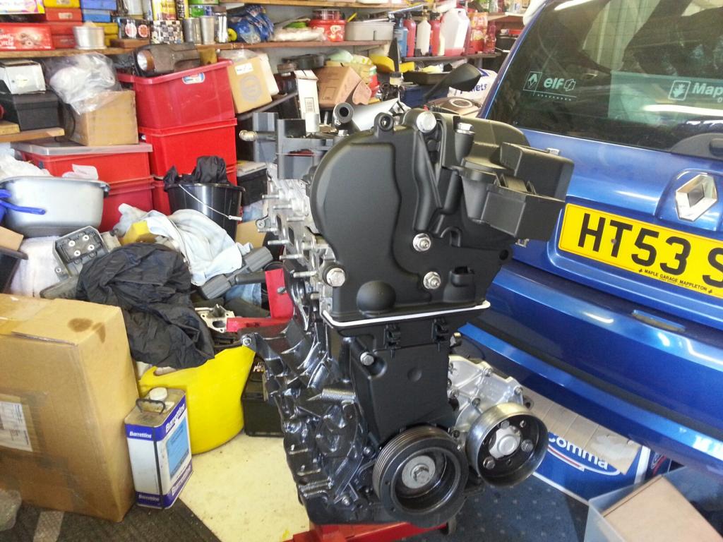

Quick little update .

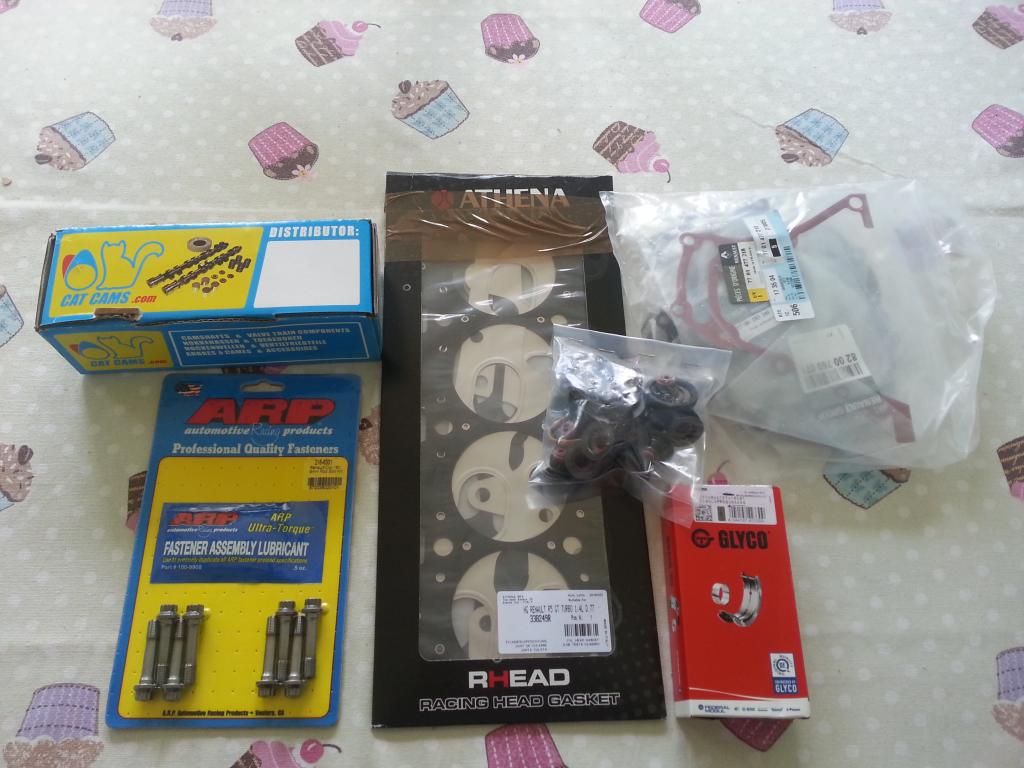

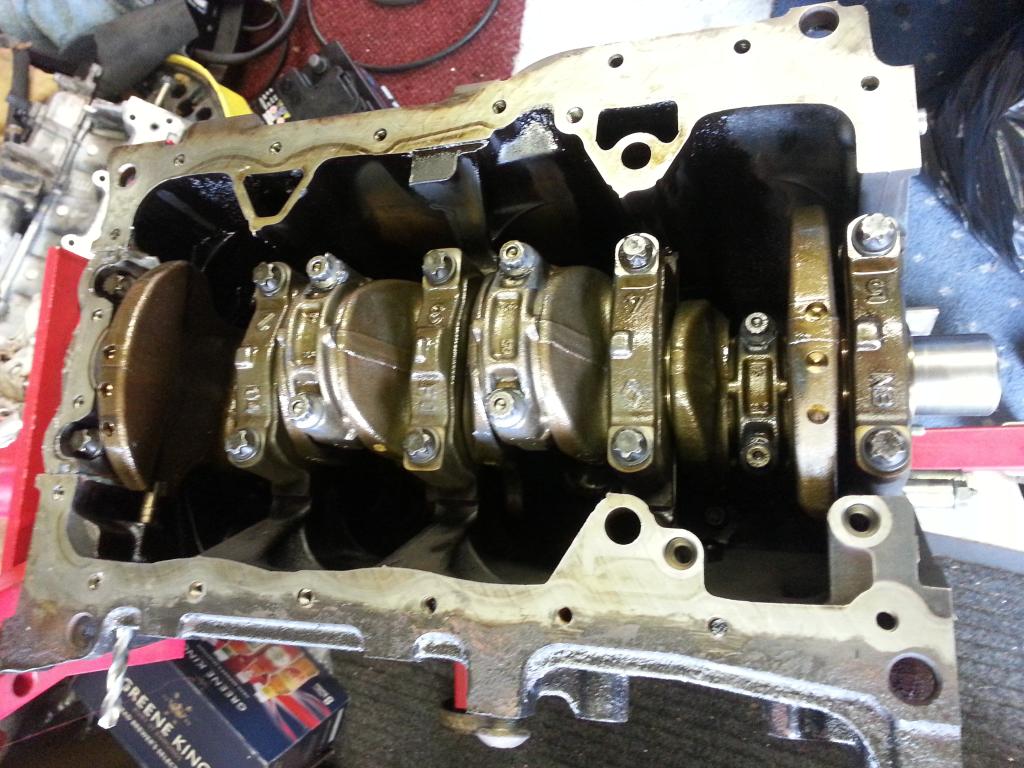

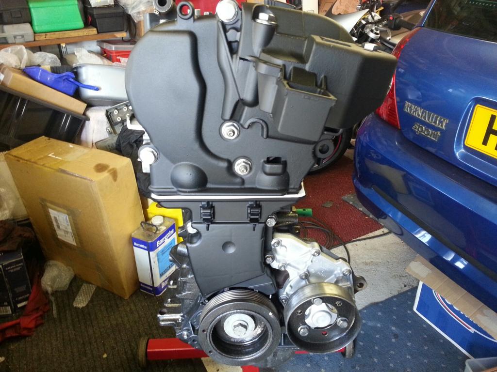

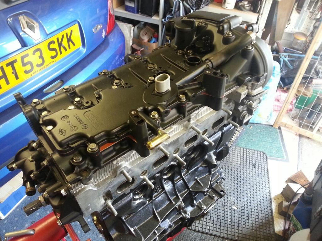

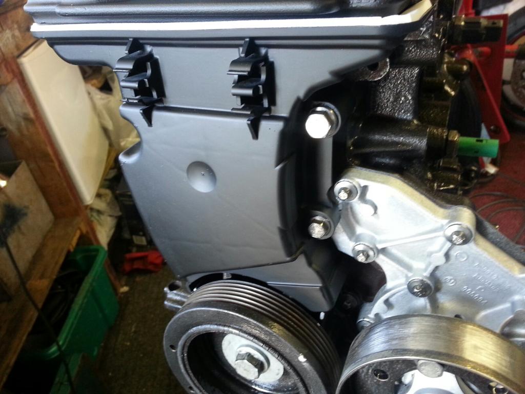

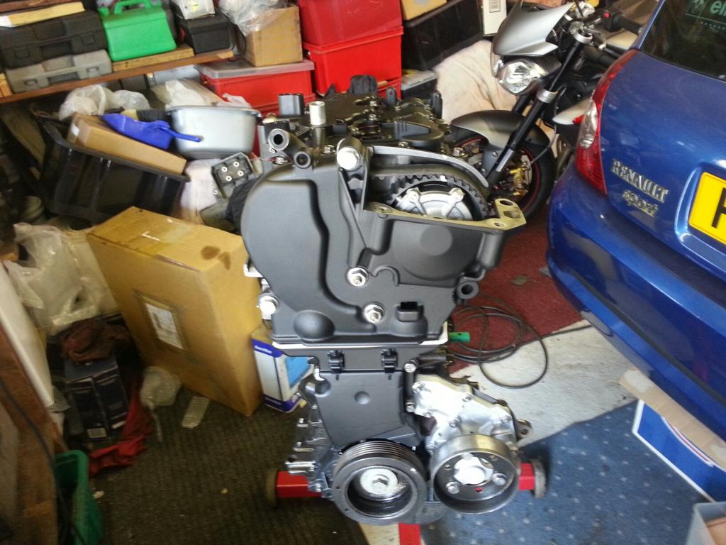

Just re-built my engine and more cleaning duties, progress has been a slow TBH with work and been on holiday for 2 weeks in Spain, but here we go

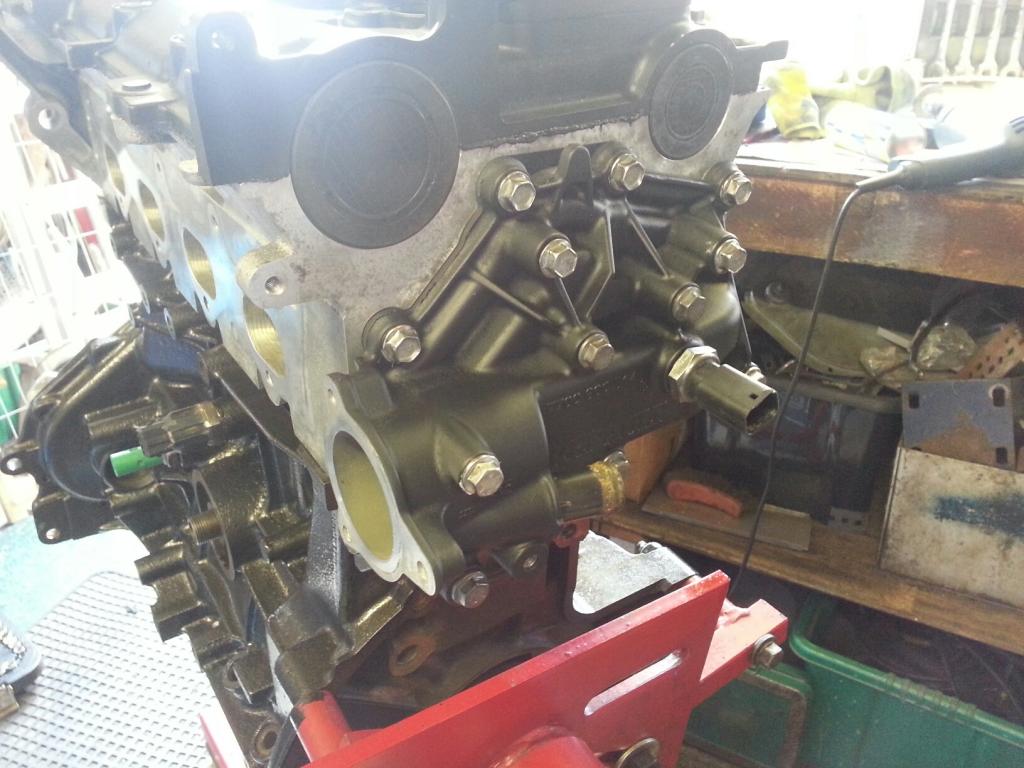

A good old set of ARP's
Ive spent a lot of time on this engine making sure everything is right and I think its really payed off with the results
