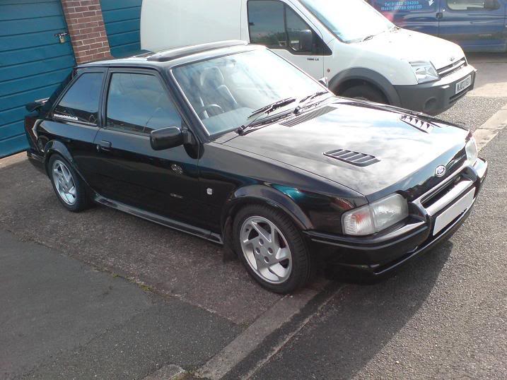

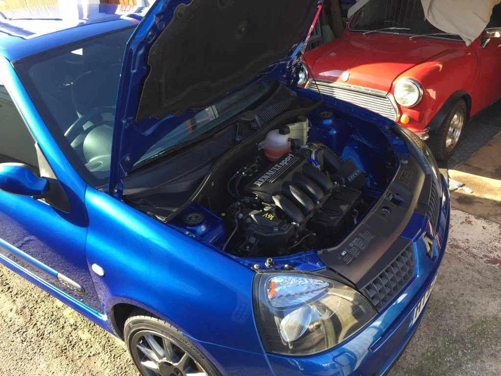

Im more interested in ya RS turbo mate. Any pics n spec ?
This is what it looked like before it went into the workshop. I've gone standard outside and spent time on the engine.
Spec
block bored to 1900
mercedes cosworth 2.3l pistons with triumph V8 stag conrods and 1.8 cvh crank (lightened and balanced)
Lightened and balanced flywheel
head fully ported and polished and matched to gaskets including throttle butterfly
stage 3 hybrid turbo
Ahmed Bayjoo mapped ECU
-31 actuator running 18psi
GRS twin pass intercooler
kent fast road cam and adjustable vernier pulley
Janspeed stainless straight-through exhaust
uprated and strengthened gearbox with a shorter 1st and longer 5th
I've also removed the ABS system - it's quite heavy and not the most modern system, although I don't have ABS now the brakes seem to be a lot better than before.
I think that's everything!
Once finished it should give more power than my cup and is slightly lighter too.

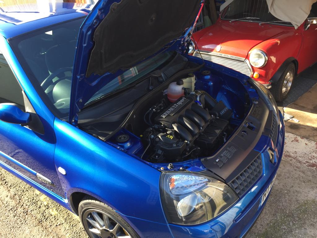

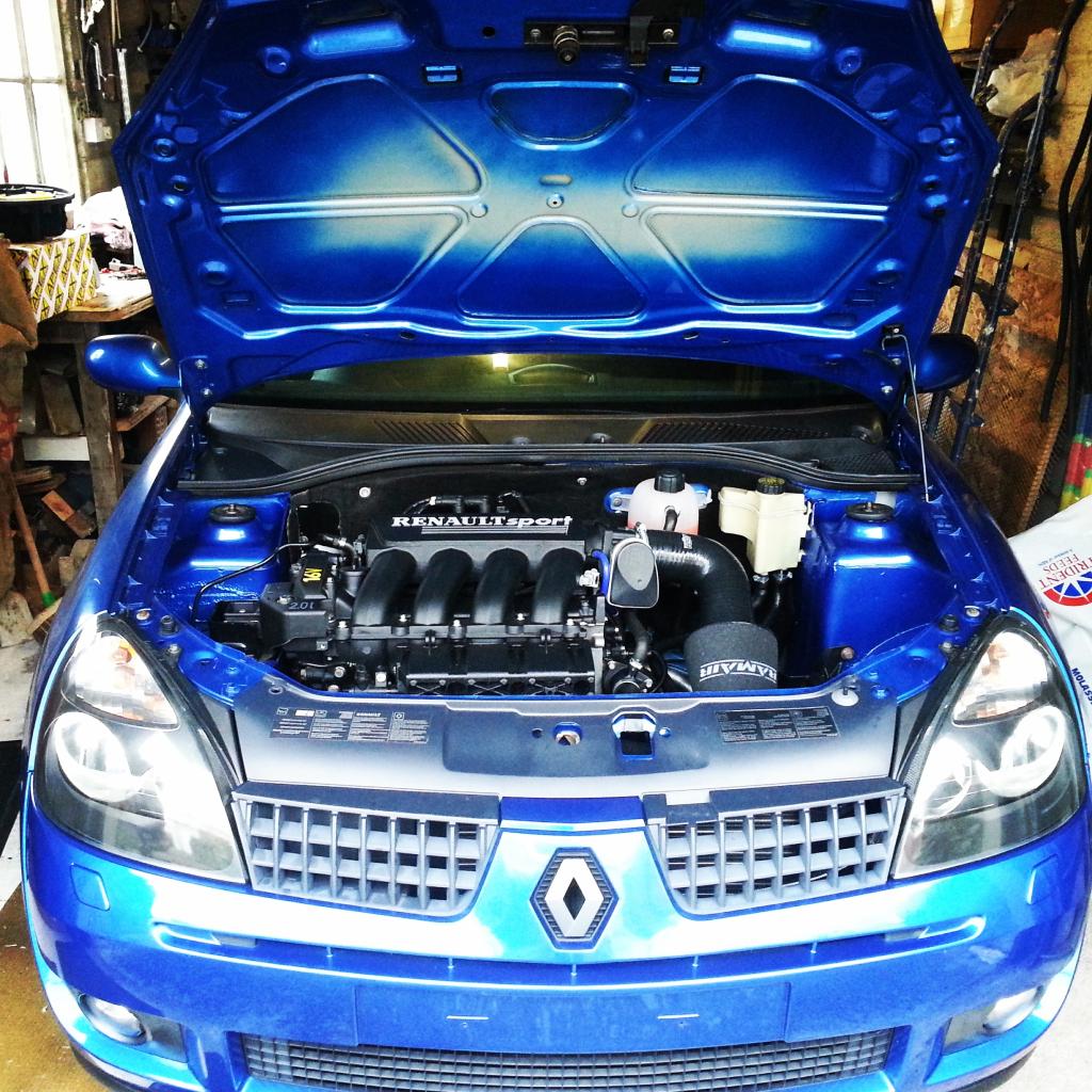

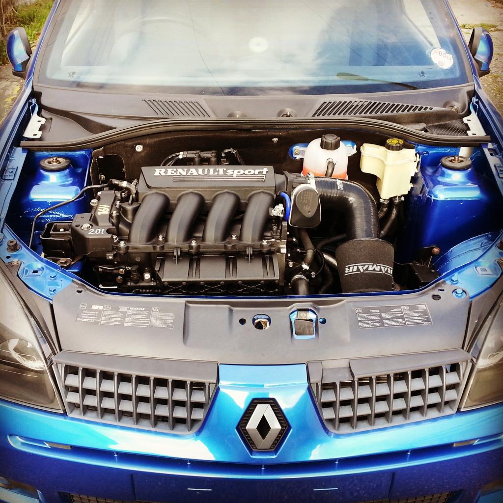

Have you thought about swapping your silicone elbow to a 45degree bend instead, will give a straighter path for the air to flow and I believe behind the headlight is the coolest air also
That looks mint. Some lovely refurbing you've done there mate.

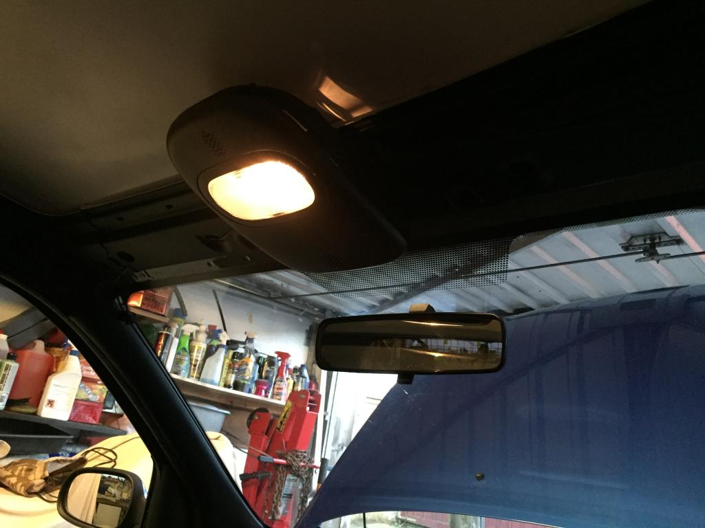

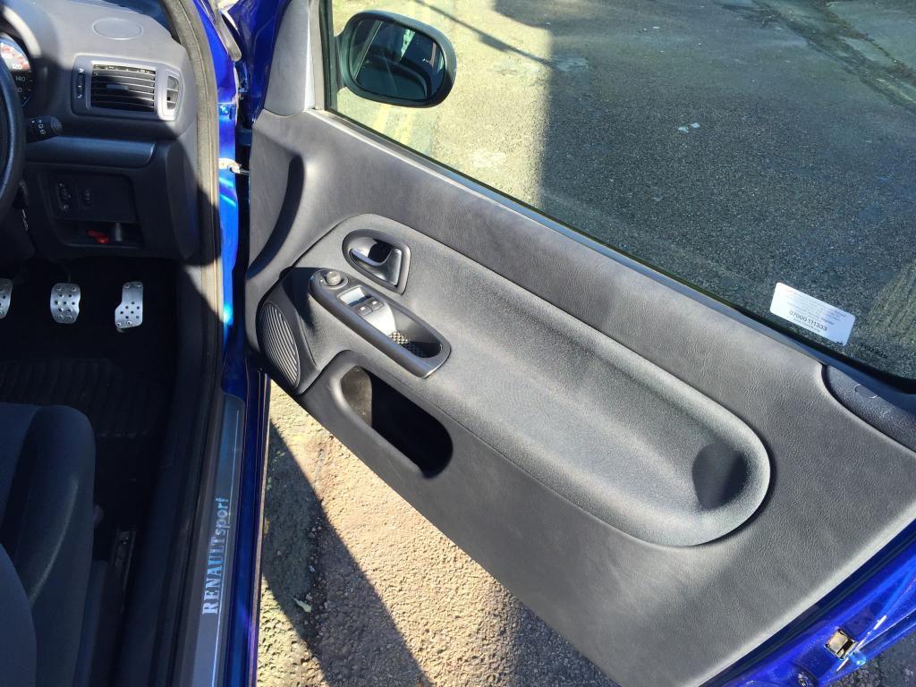

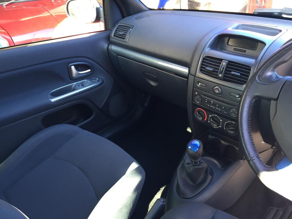

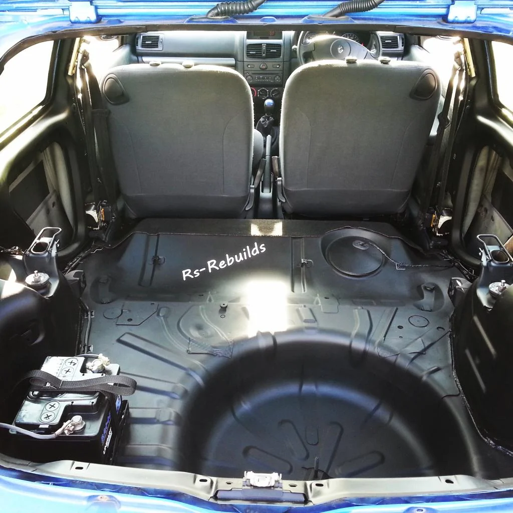

How did you do the rear interior, with a spray paint or brush? I recently got some spray paint but when trying it it came out awful so had to wipe it all off quicly. The paint was too runny and didn't stick at all.
  172
You need to use primer first.
  172
I've been messing about with cans for a few months now and have pretty much got it nailed.
I usually just do a few light coats of primer till its one solid grey colour, some people sand between coats but I tend not too and then do the same with your chosen colour. The tricky part can be the lacquering and the trick is to have the paint in some good light so you can see how shiny it is becoming.
To avoid runs just don't spray too close or apply too much at a time. I did some spraying today and I find impatience is what causes F ups! Earlier a gust if wind caught the kitchen towel I had my badges drying on and got it stuck to them which meant rubbing everything off and starting from scratch!
I wasn't even going to bother lacquering the inside. Didn't even cross my mind to be honest. Never spray painted anything before though so it's all new to me.

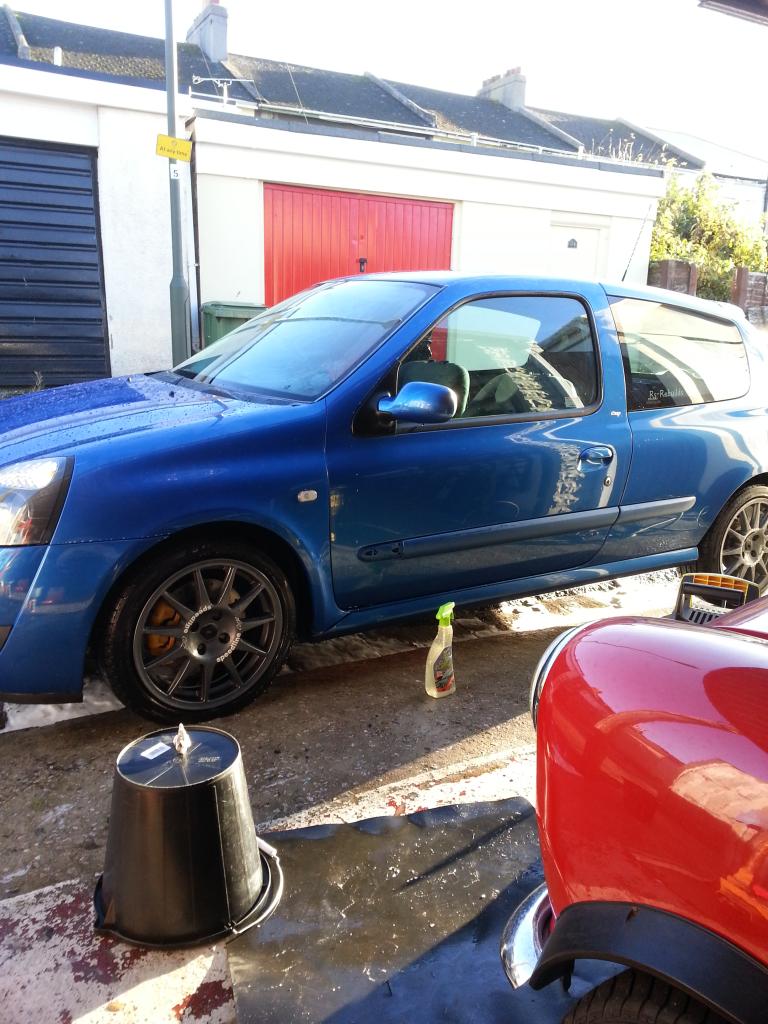

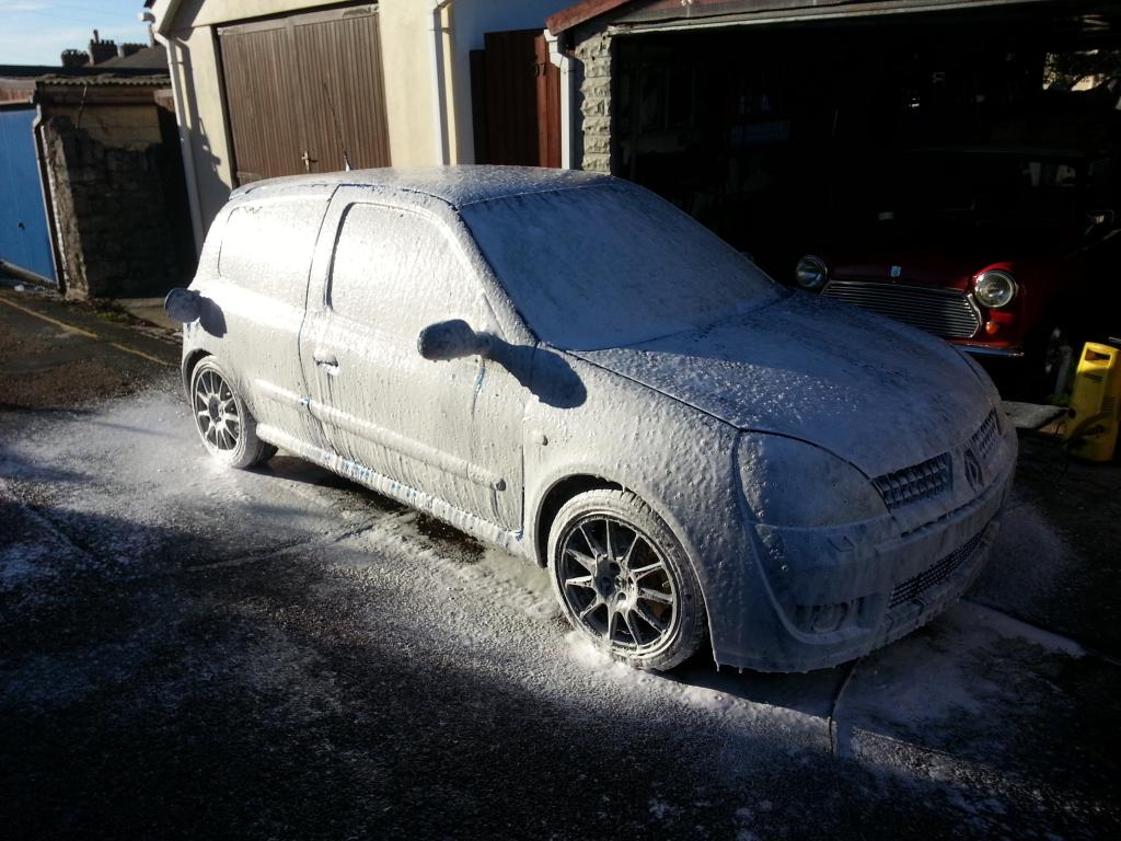

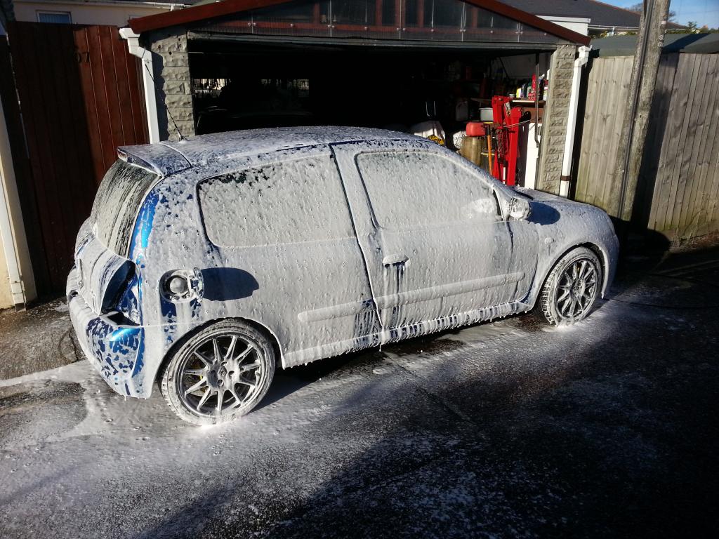

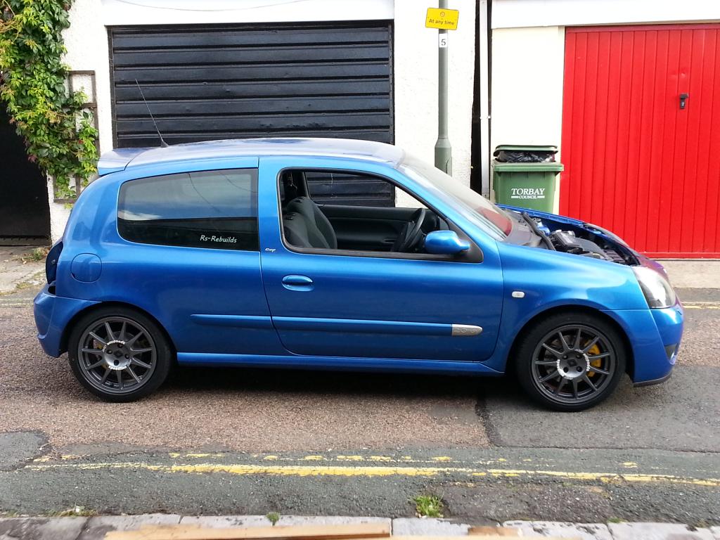

Sun came out so did the car
Started the detailing process
only managed to snow foam
Shampoo with no wax
iron x
clay
only gotta clay the doors and quaters to have clayed the whole car. Then get the das 6 and pads out. Already done the bonnet and bumper when they were off the car
but feeling like she is gettin there now.
MOT soon
Ben
  206,172 Cup,focus,X5
