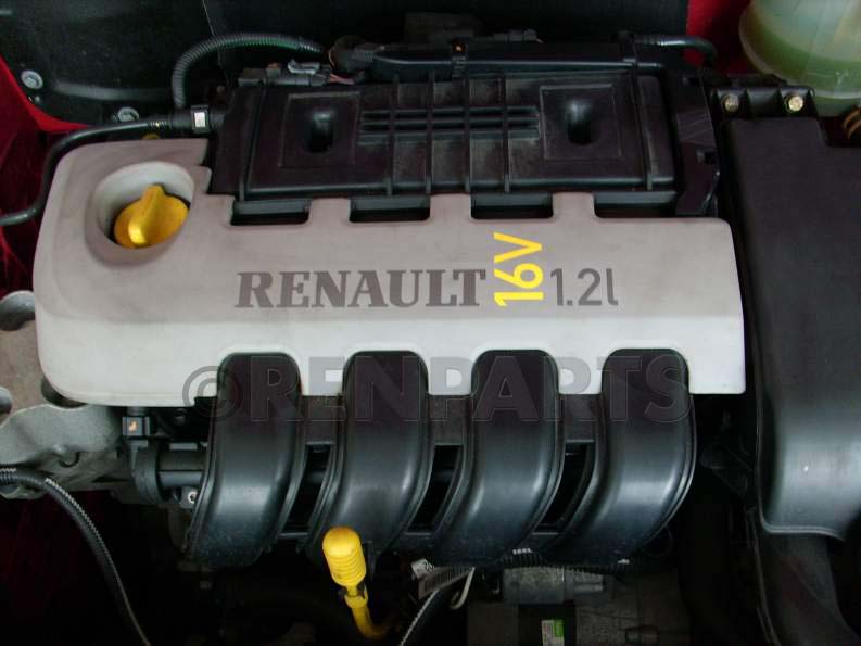

Cant illustrate it clearly on pic but, if you look at the Oil filler cap (yellow one). Follow it down and you'll see (just to the right of the engine mount, just after the plastic cover ends) a piece of plastic with a reflective mark on it (put by someone on that pic). This is your problem, it is the inlet for your fuel rail, often it is not pushed in properly. Make sure it is pressed ALL THE WAY DOWN. It takes a flat head screwdriver and a hammer to push it down properly. Doing my hand will only get you so far...

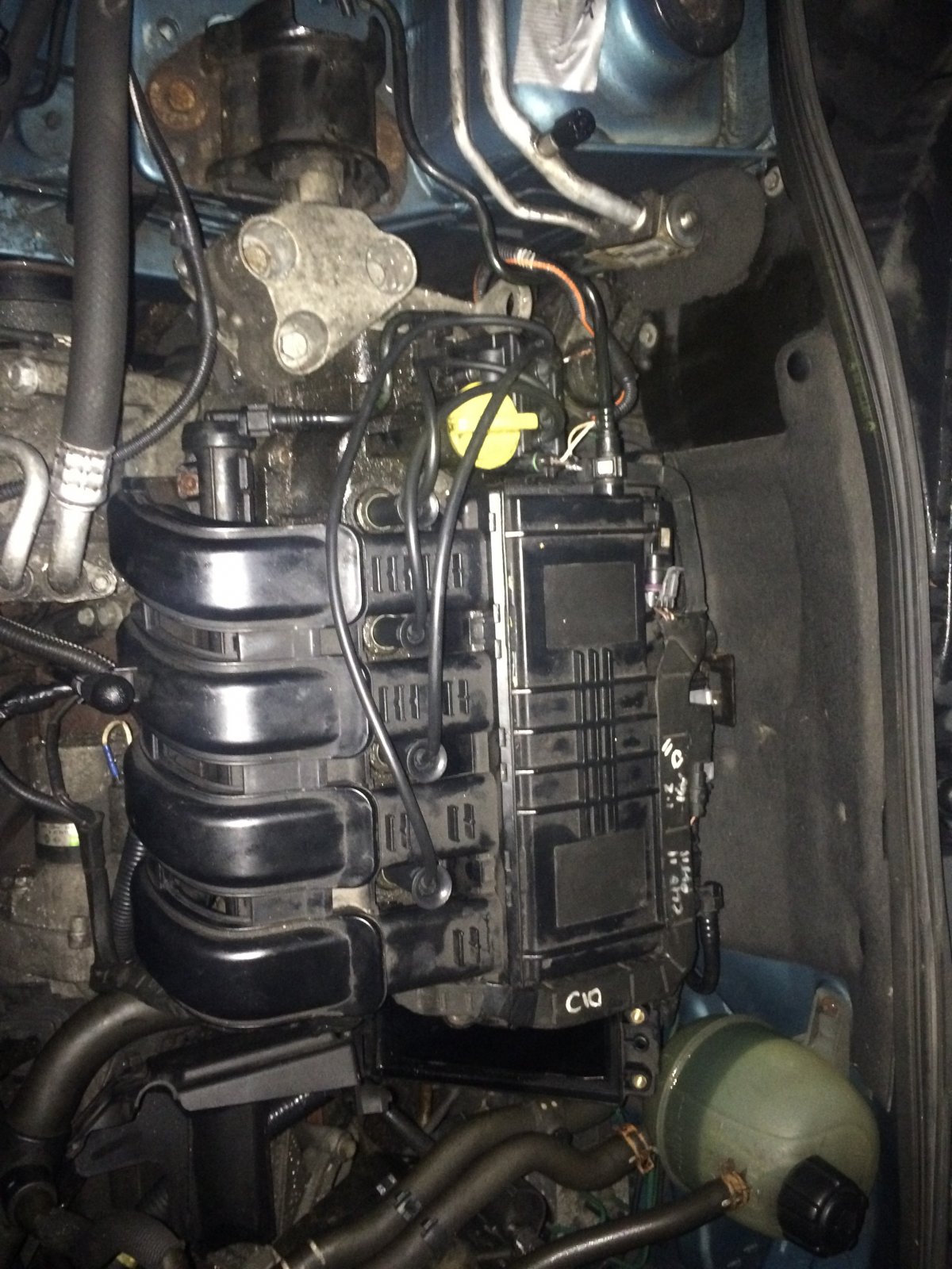

i did that and before ignition it makes this noise and i can see some fuel leaking, im worried if it sparks and theres fuel i presume it would catch fire? and this is the vid with the noise and such

from the video it appears your injector/rail is leaking. This could possibly be due to them not being fitted correctly or a crack in the plastic of the rail. I suggest taking it off and checking it. Also the noise in the video is that the noise you hear??
