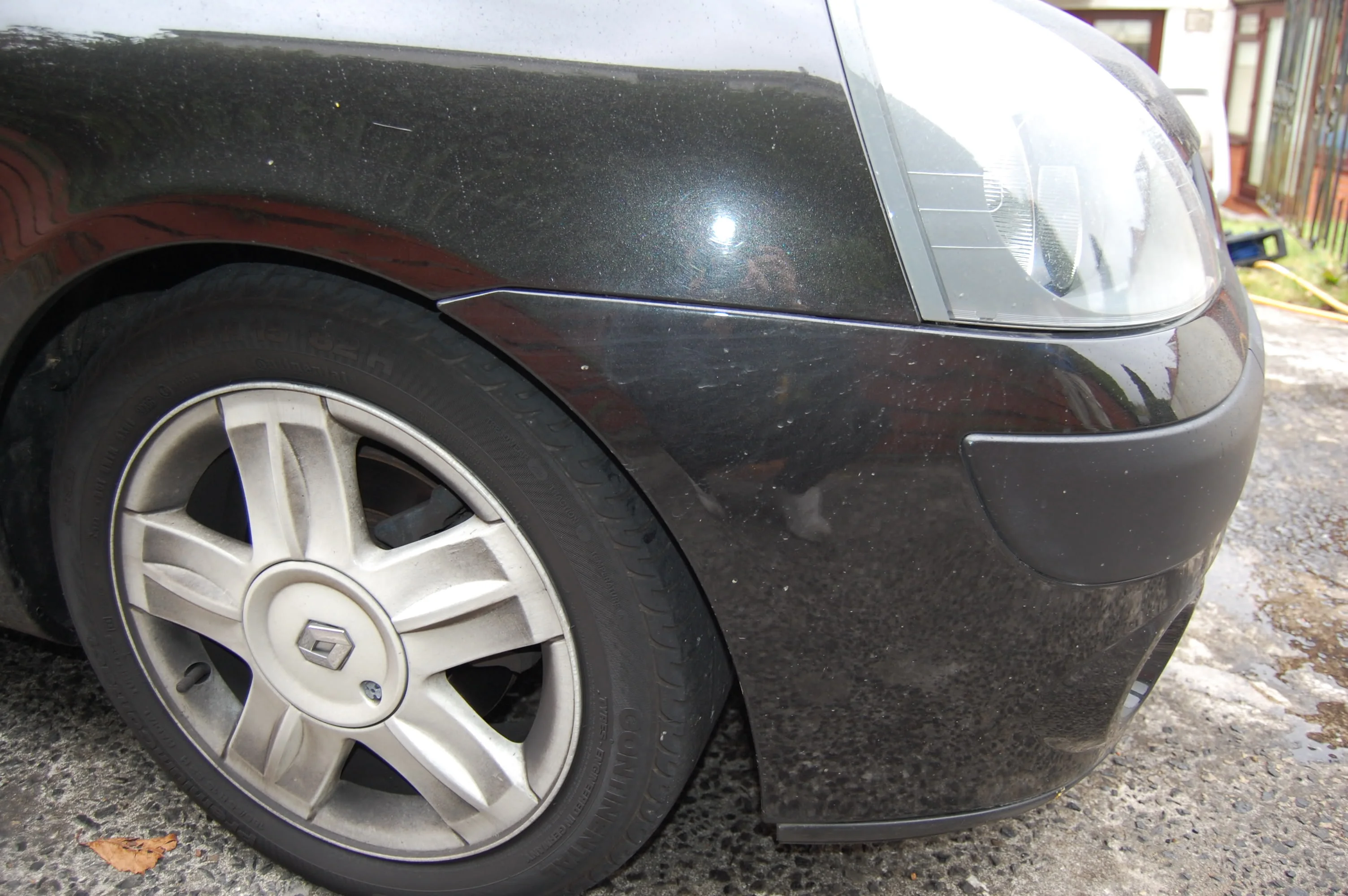

rite, spent today doing a job for dajones, who's a member on here.

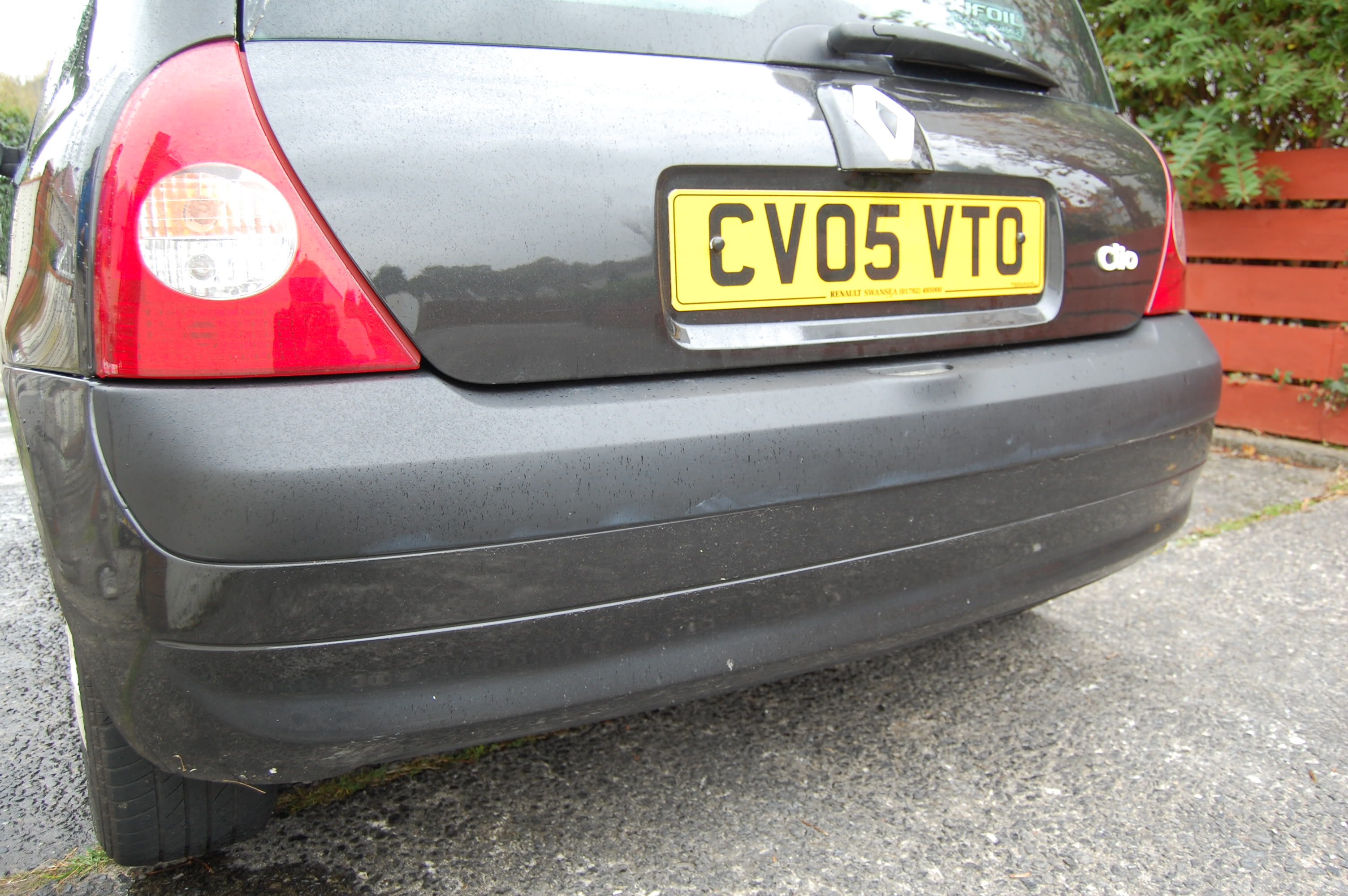

tbh the car was bit of a mess, came to me, hadnt been washed in a while, never seen a machine polisher and was full of swirls, and be'in a black car, it showed them off very well.
started off blasting all the crap off it with a week power washer. (got dan to do this as is a boring job, lol)
It was then giving a wash using TBM and sheep mitt, dryed with waffle weave

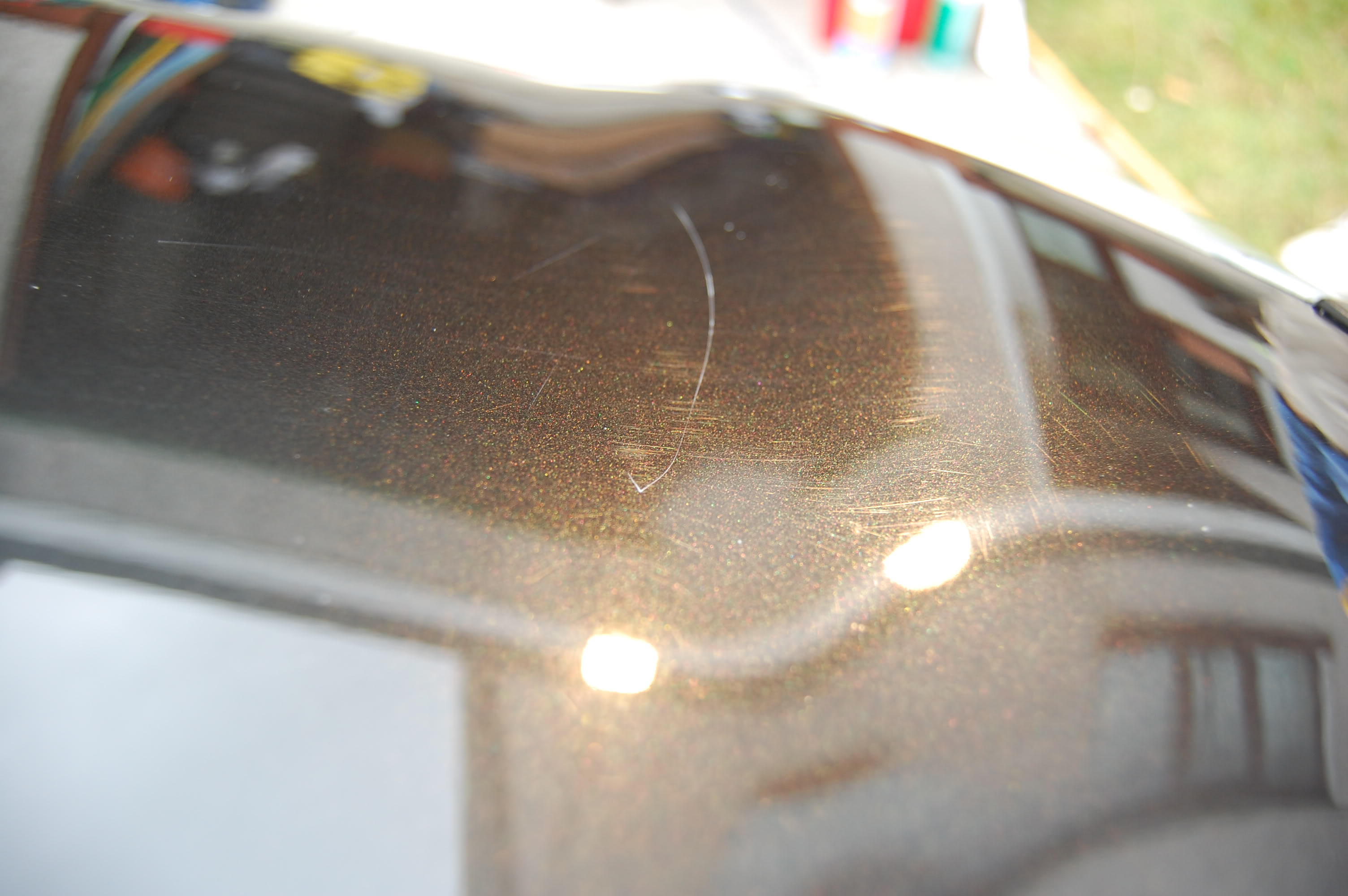

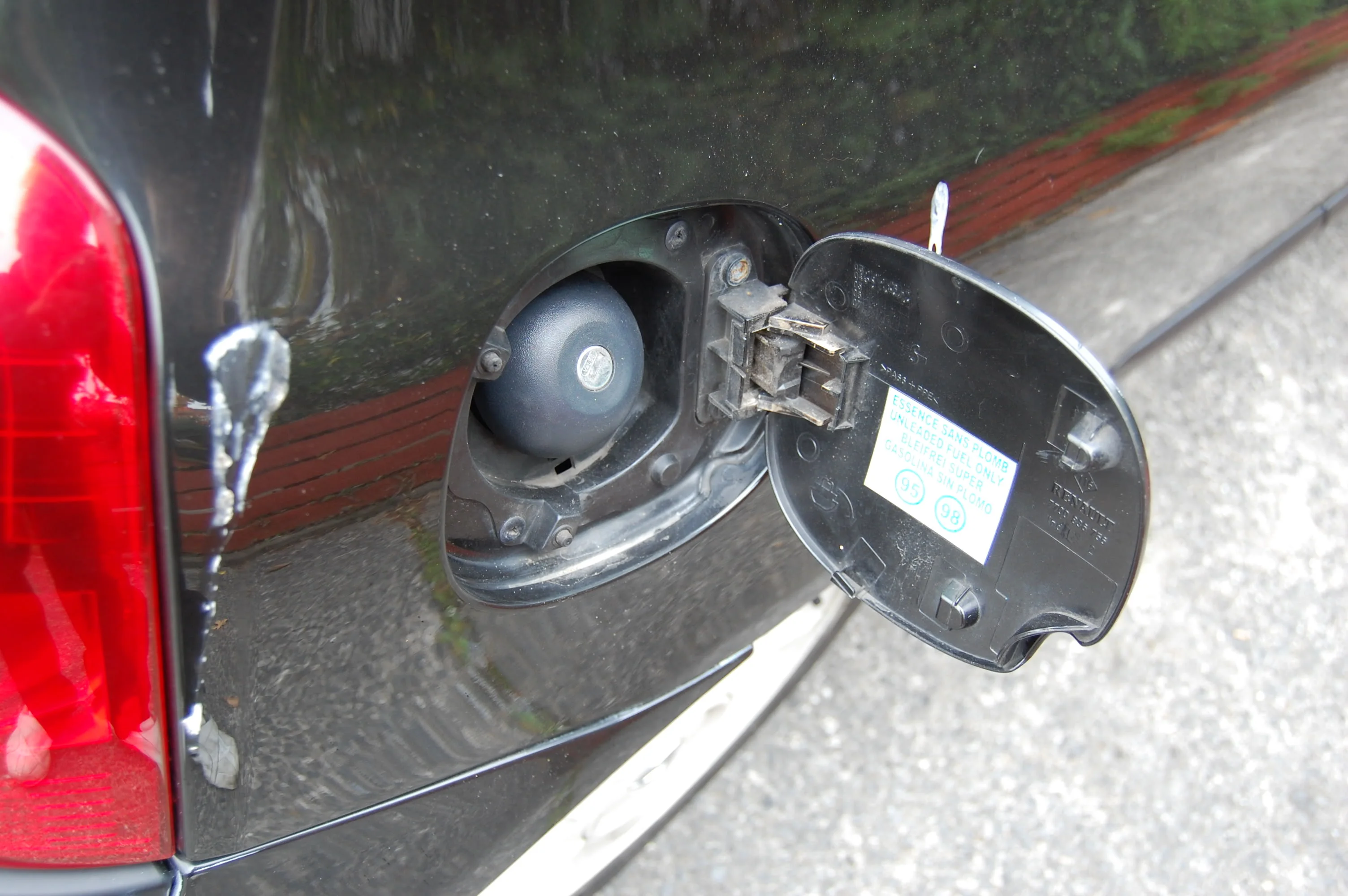

then the light was put onto it to show the damage to the paintwork
pritty bad as i think you'll agree

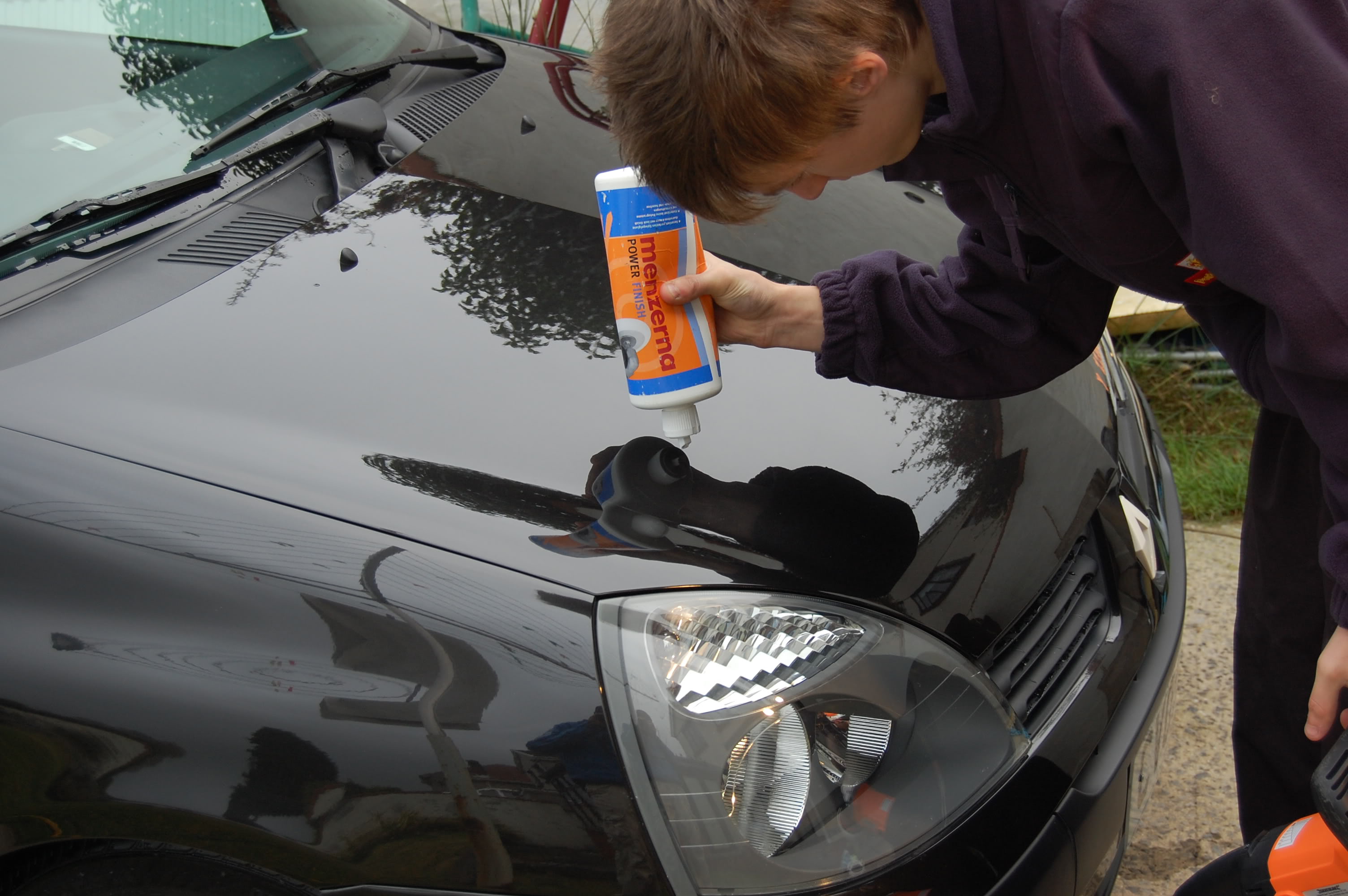

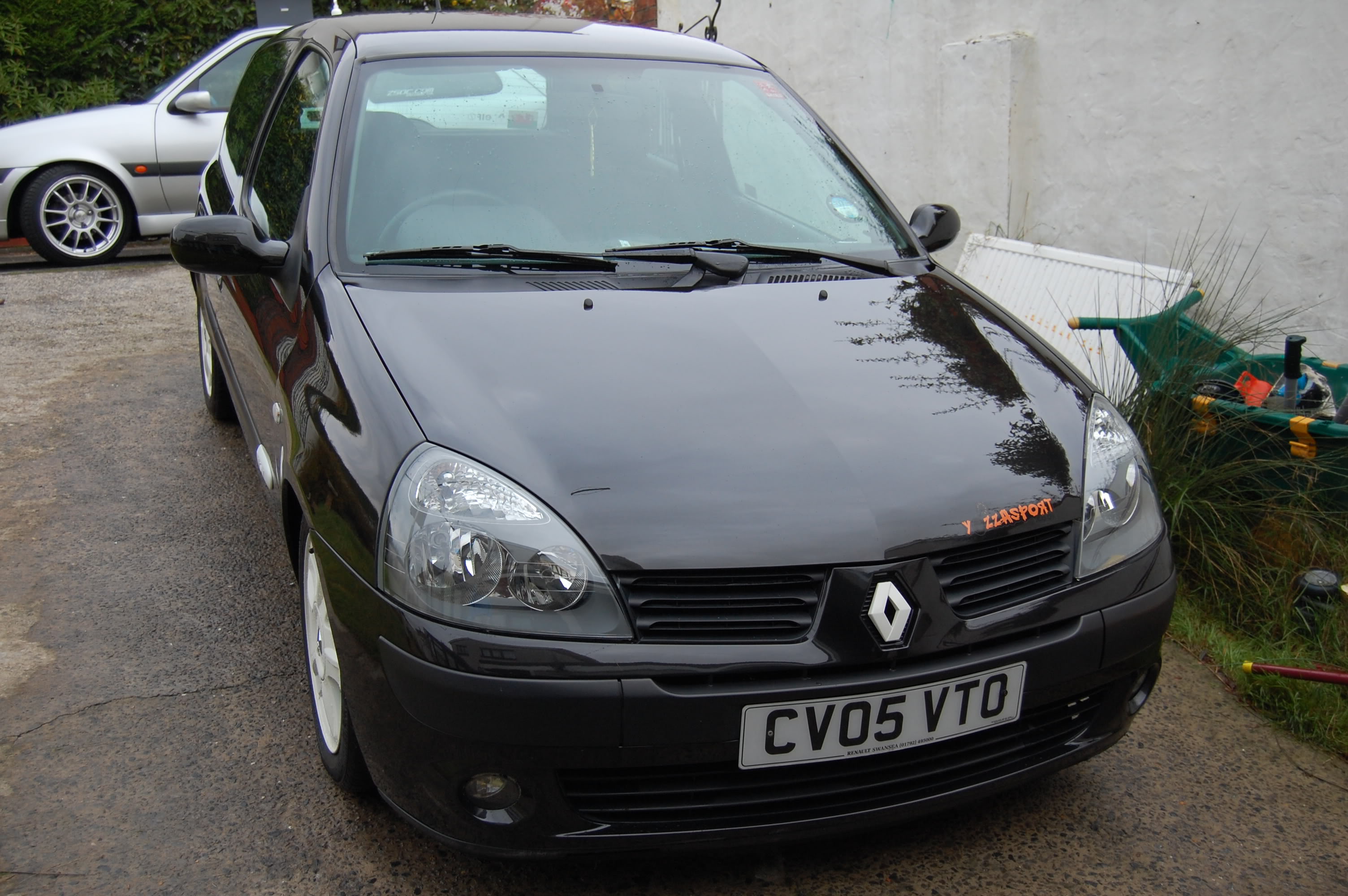

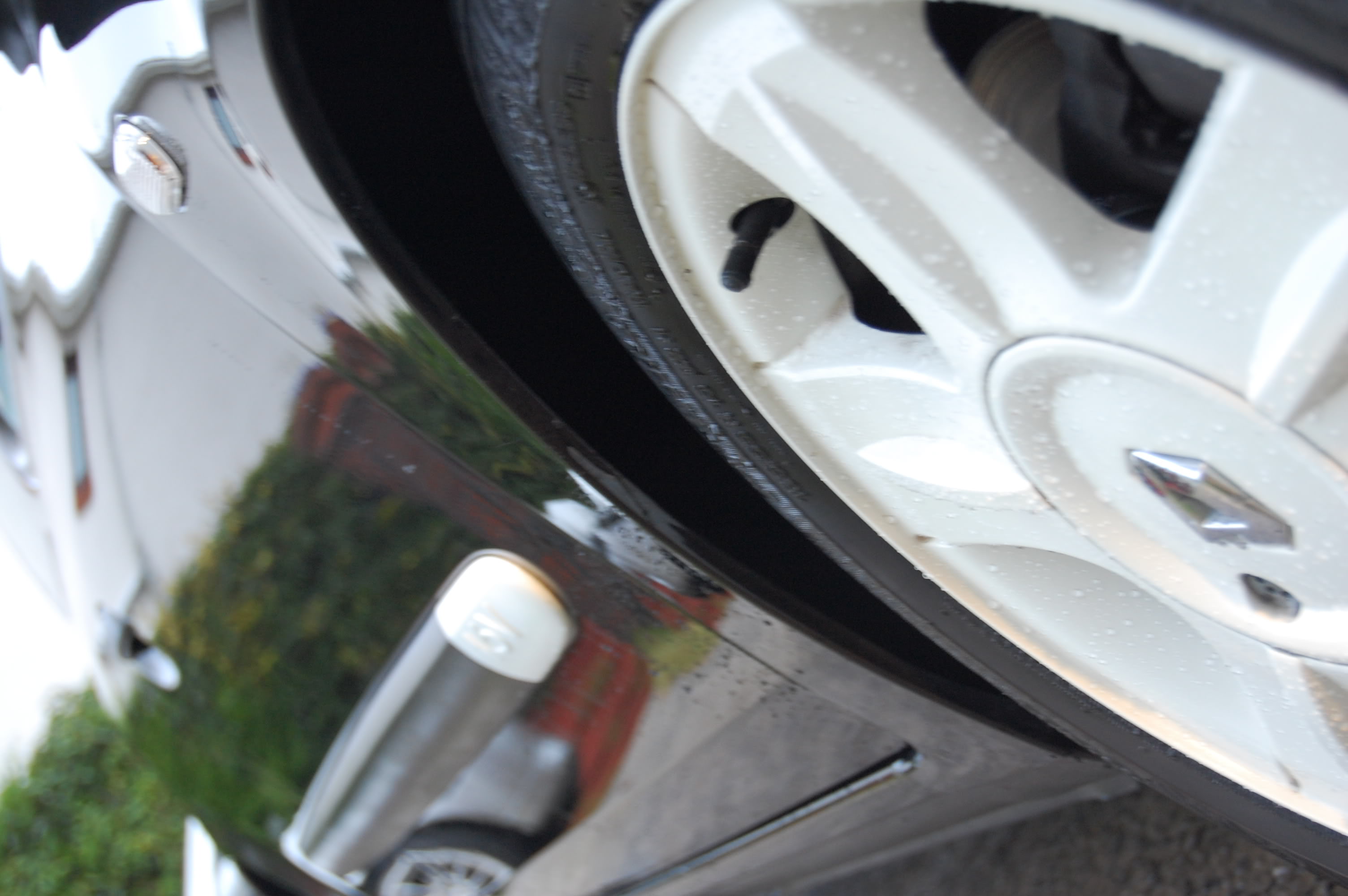

car was then gone fully over with a silverline polisher and menzerna power finish, followed up by menzerna final finish
car washed then washed and dryed again
followed by a coat or prime and dodo juice rainforest rub

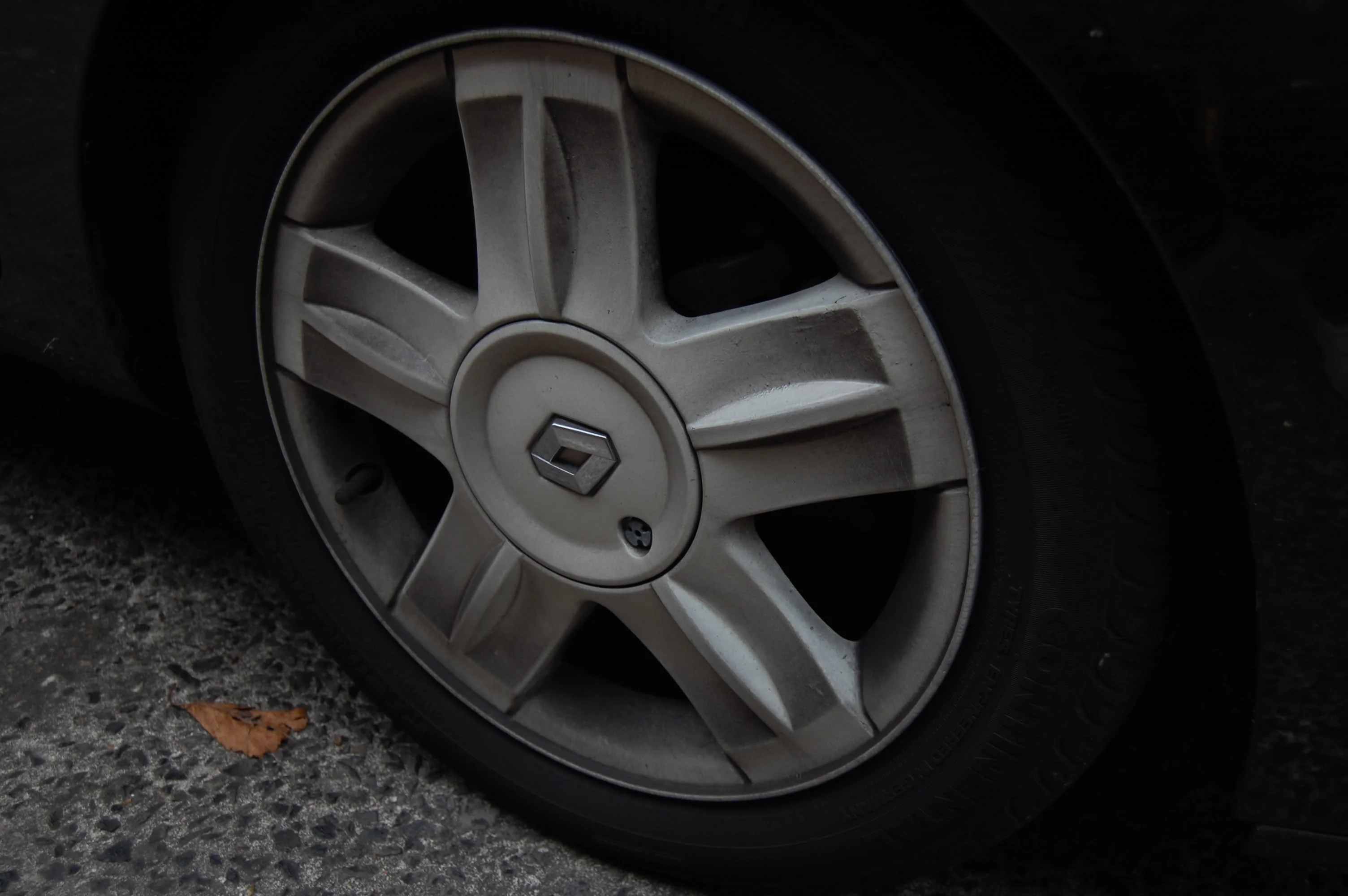

also the wheels were cleaned and dressed, and also the plastics were dressed

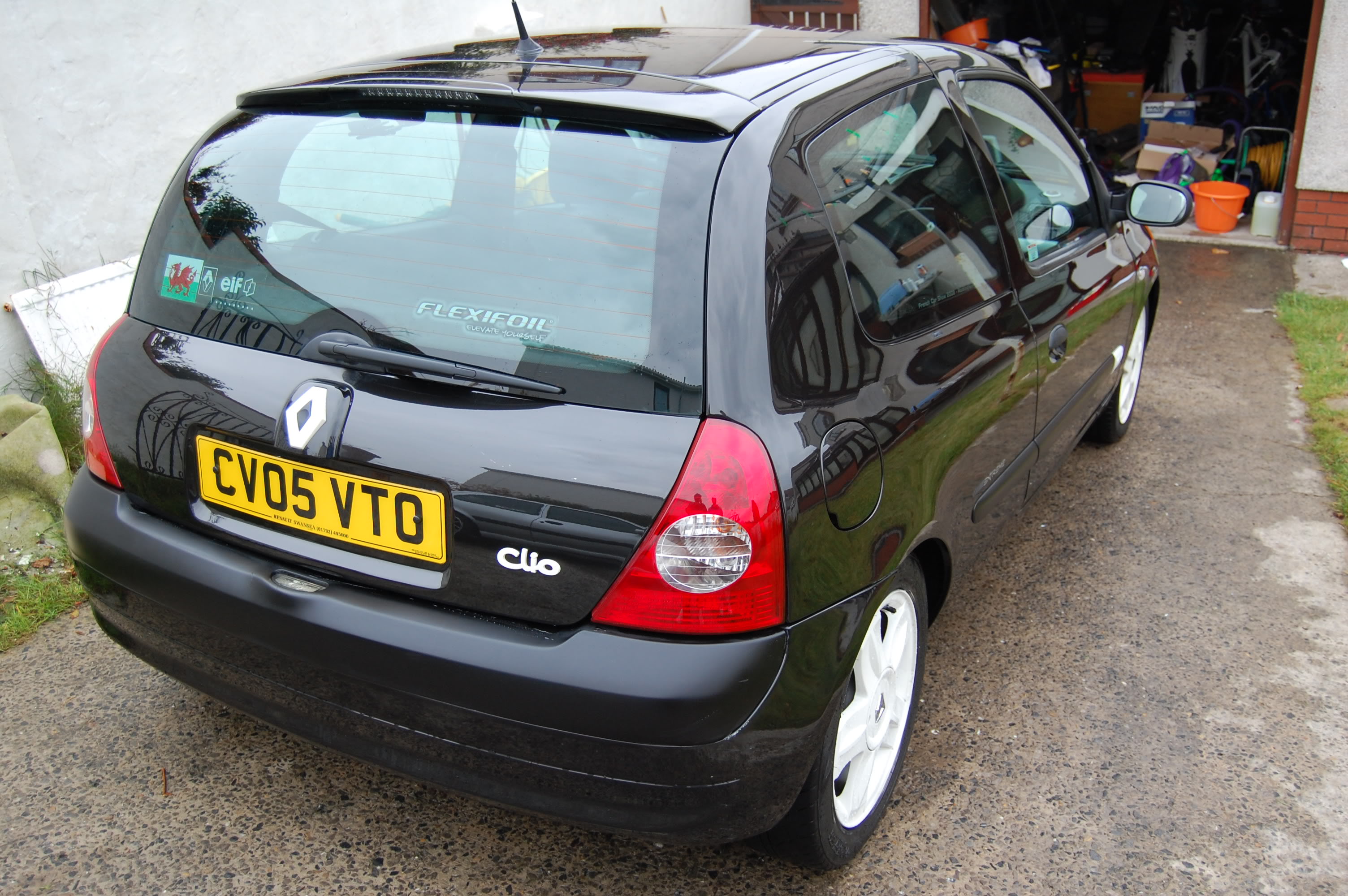

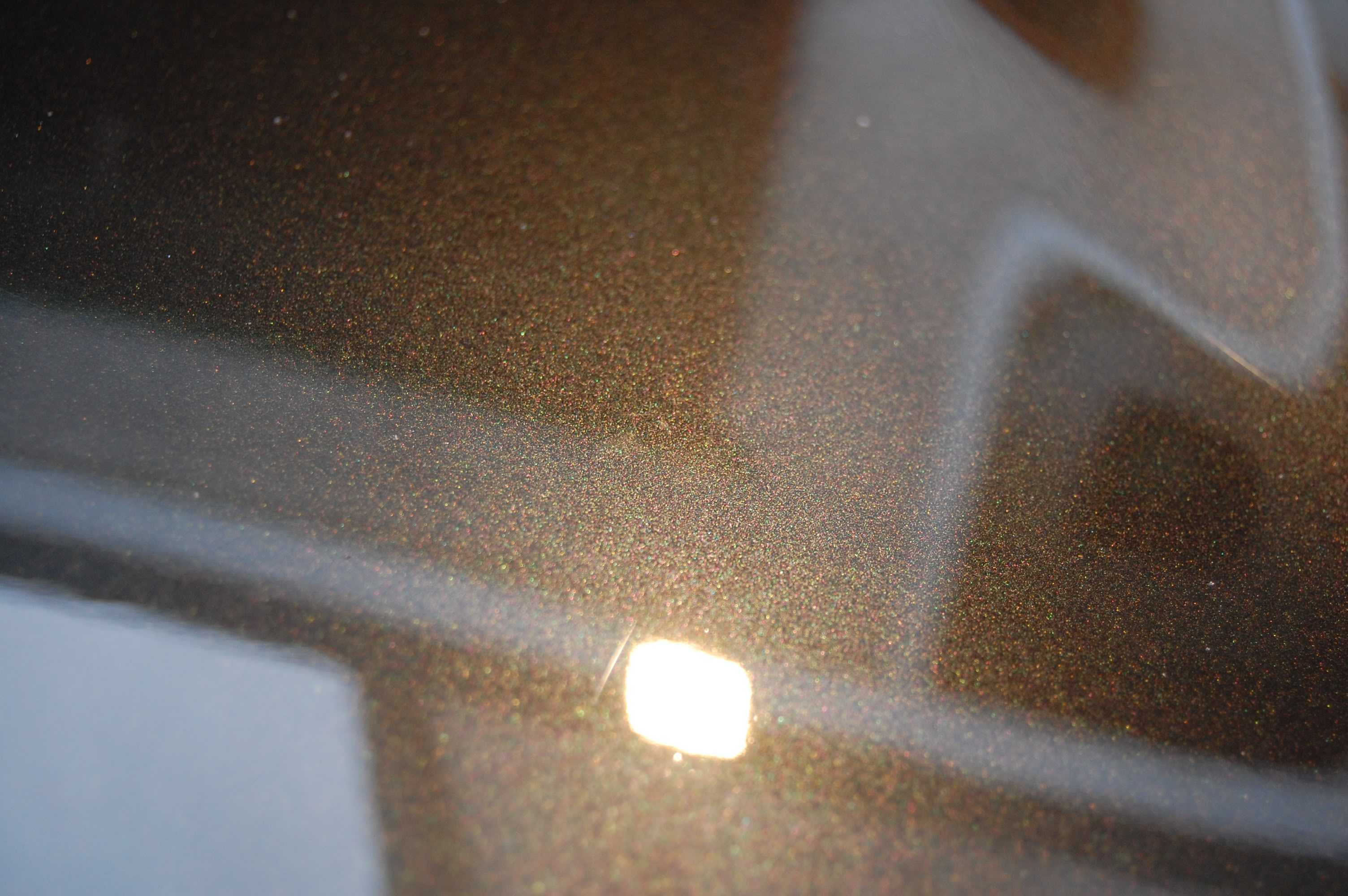

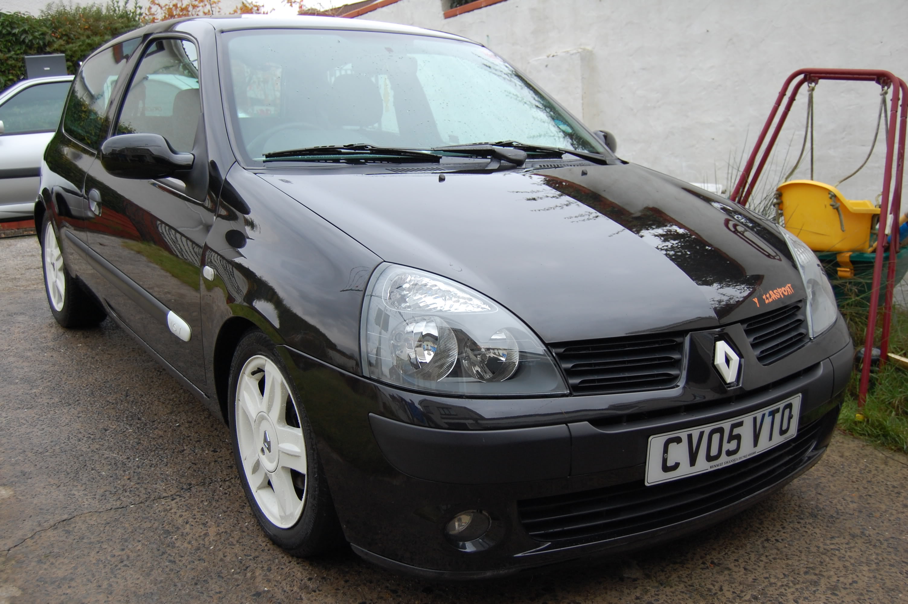

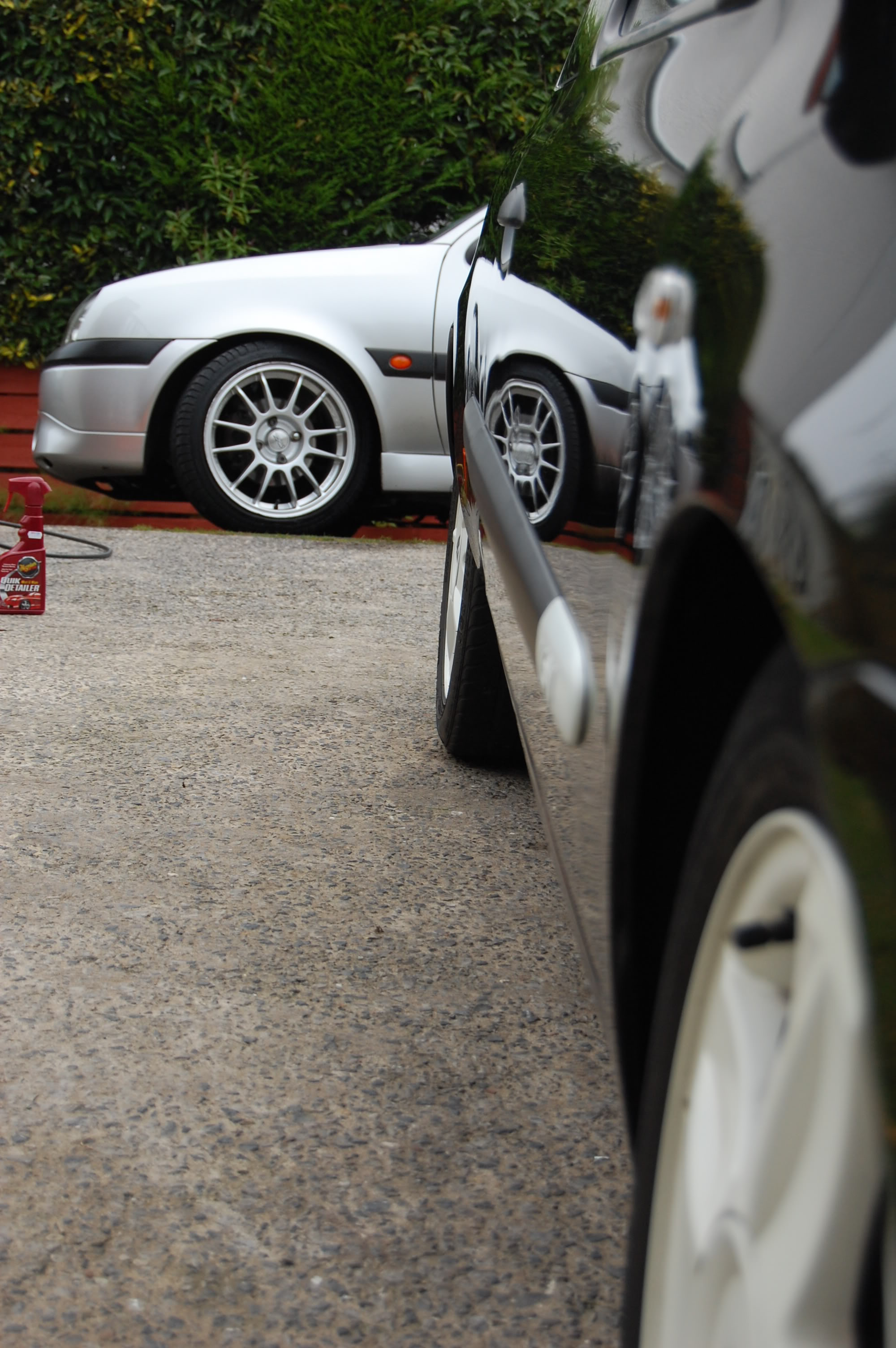

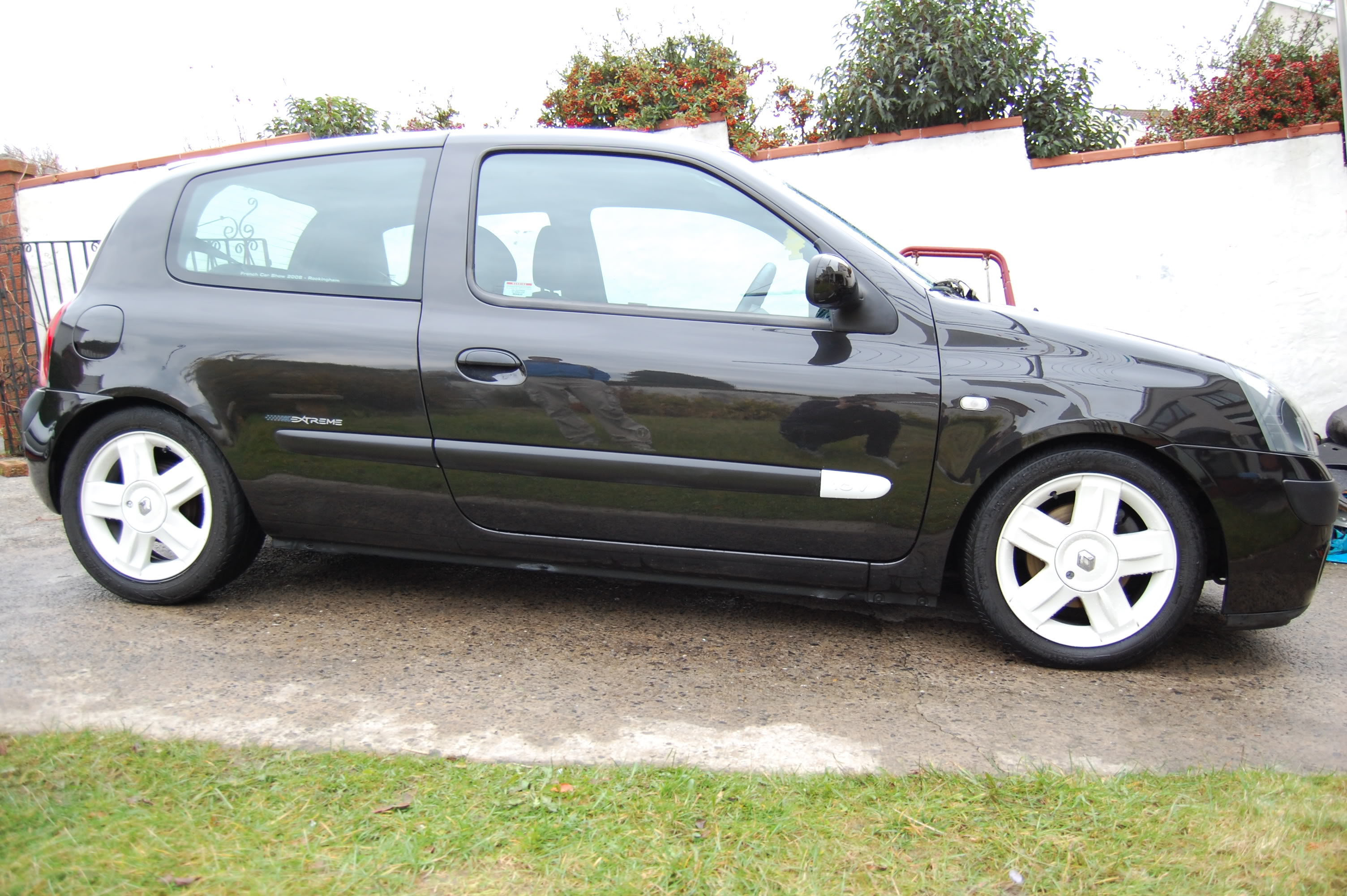

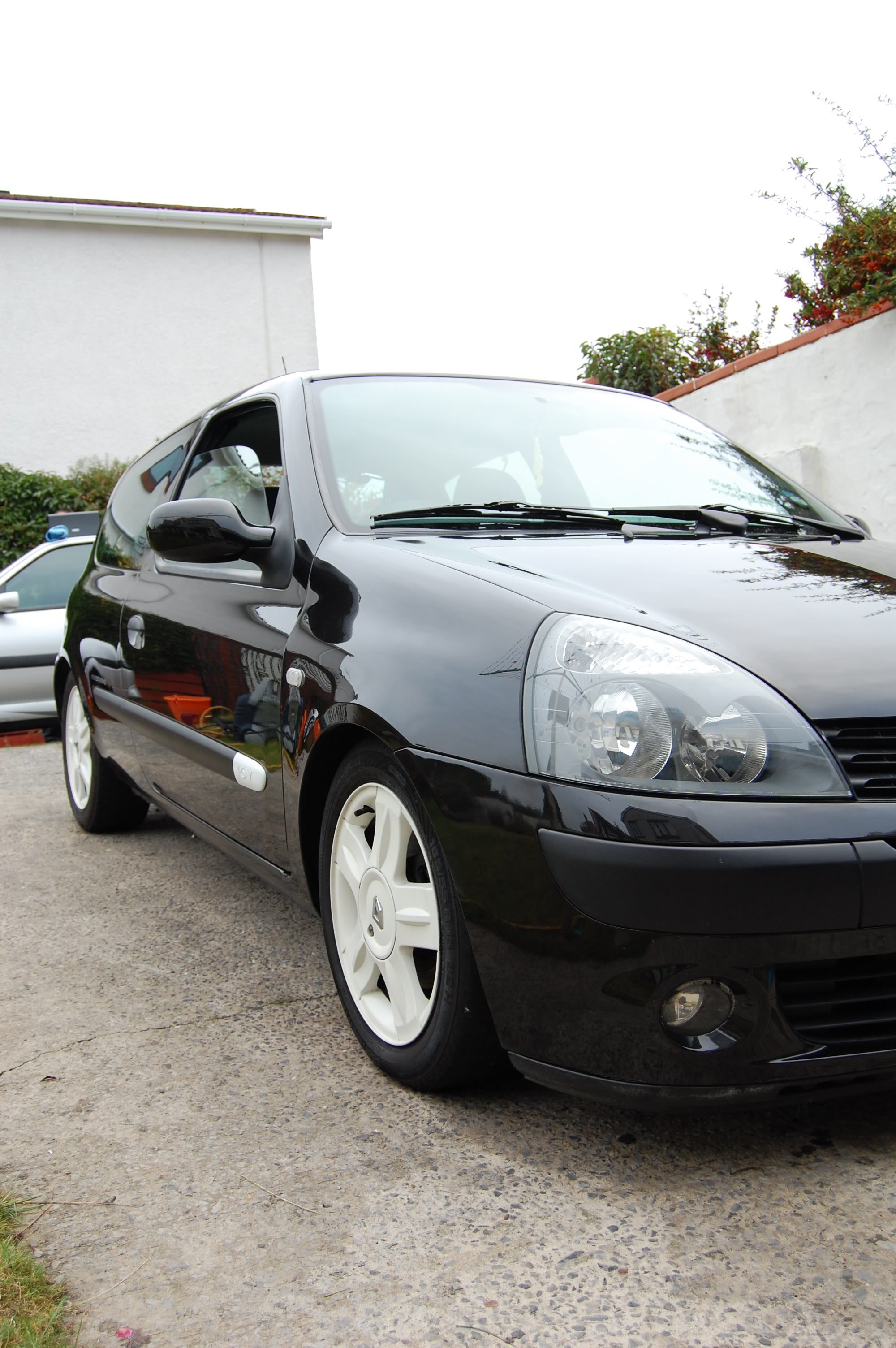

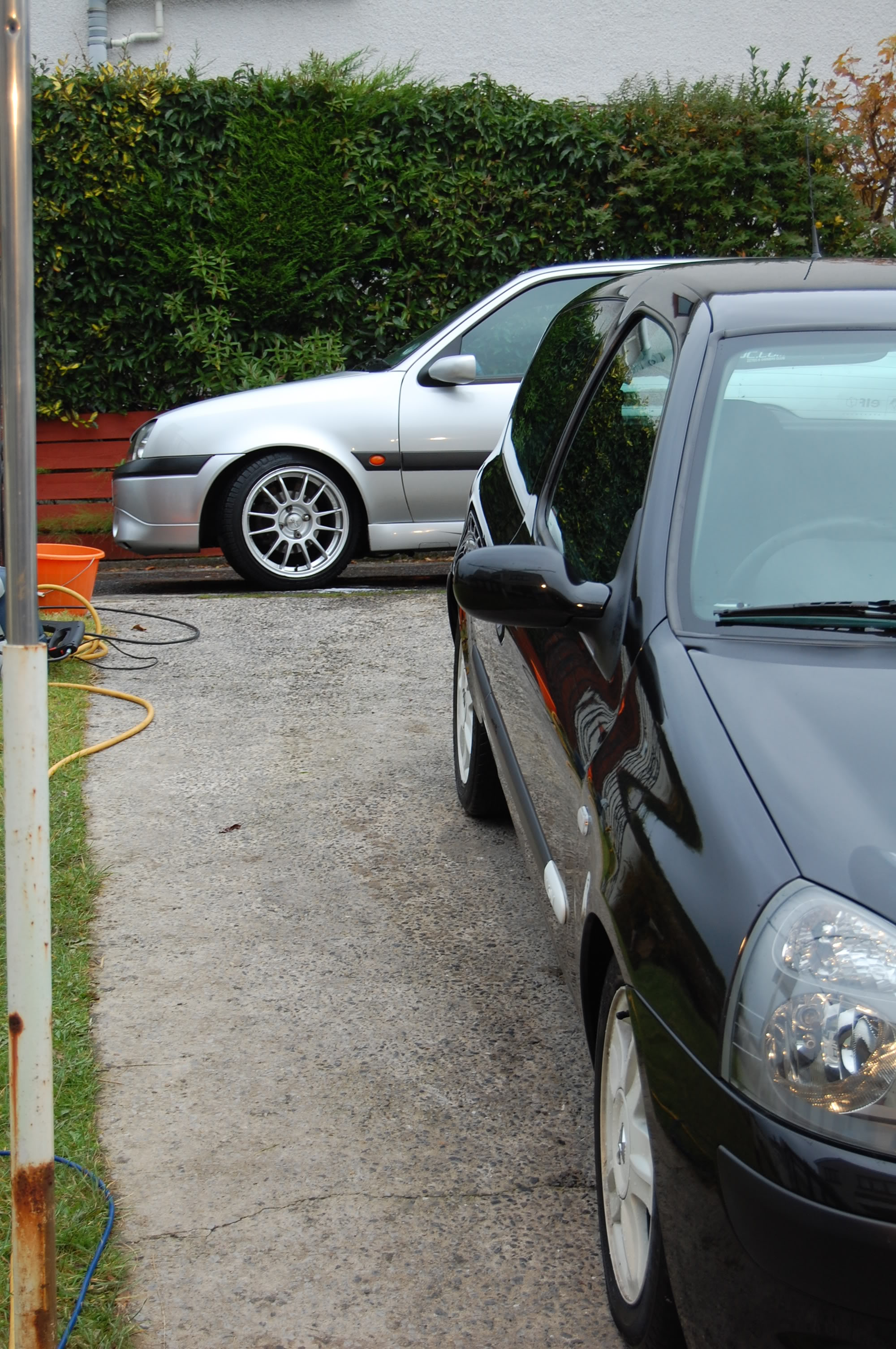

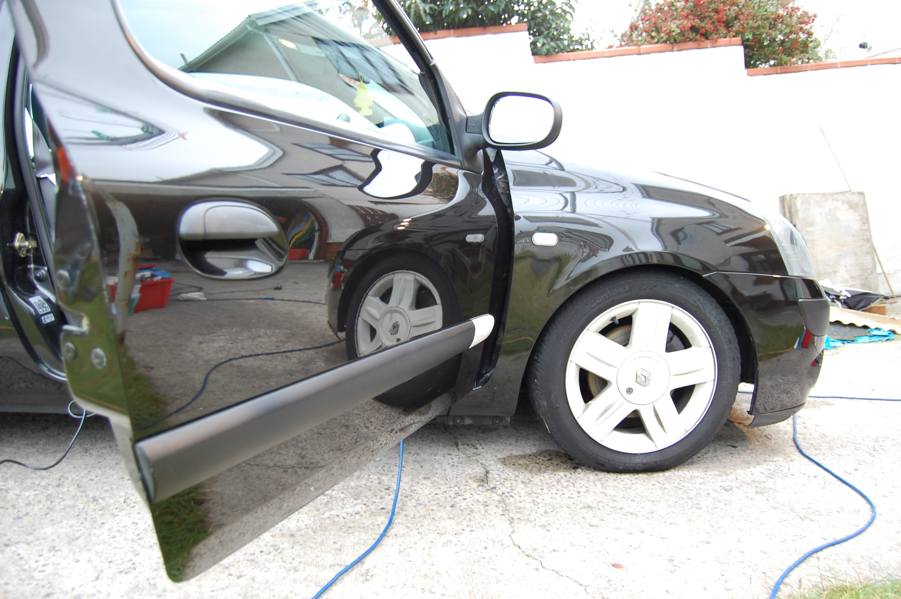

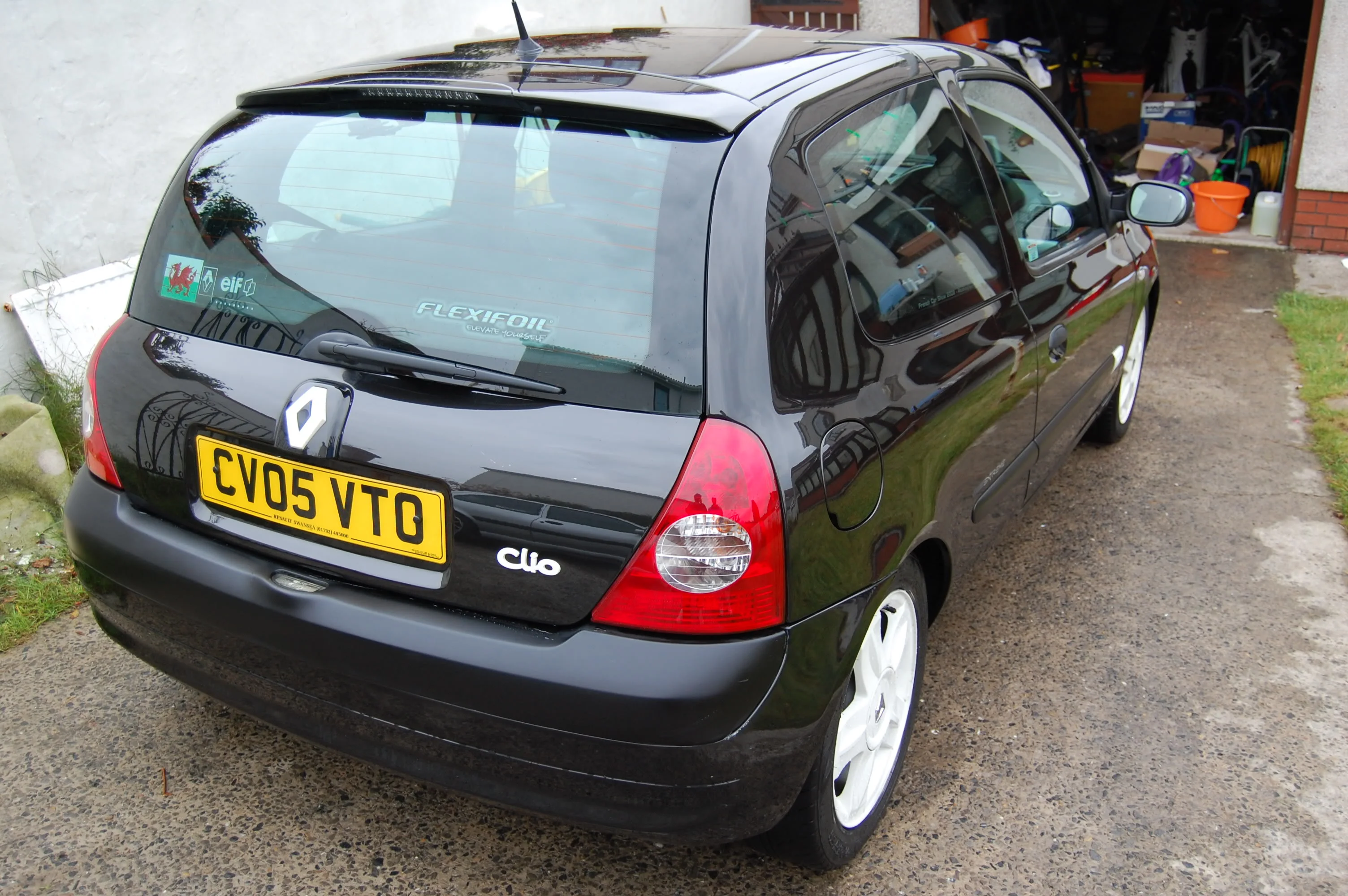

and heres the final pictures. only managed one coat of wax as it started to rain!

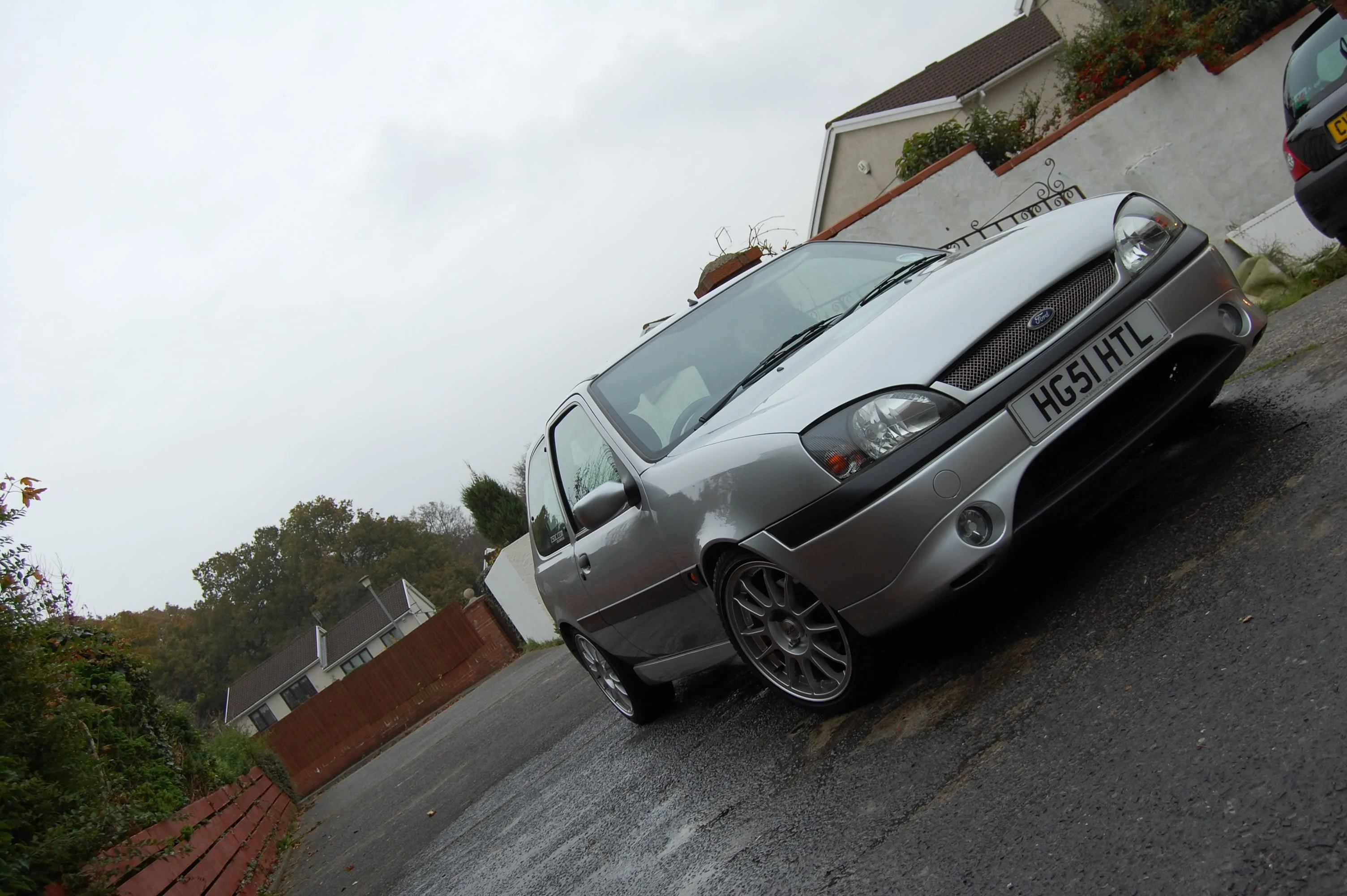

plus a pic of my new project
Very nice Chris superb job!, bet Dan is well chuffed, PS he looks like a Polish car wash imigrant with that lance in his hands FLOL,

Looks like you did a good job on the paintwork, you can see the metallic shining through now.

very nice, what do u use to keep white wheels clean?
on Dans car, he refurbed the wheels himself, they are not perfect so just used a mild solution of APC.

the silverline isnt the best rotary, but by far is the best for it value, if you treat it nice, it'll treat you nice. tbh you've gotta be a right spanner to do any serios damage to the paintwork using a polisher. i practised on a few old panels i had laying about before i touched a car though.
its not a case of what i use its just a pain in the arse you clean them and a day later theyre black but ive mixed a bottle up with wonderwheels water and car shampoo that seems to work use a wheel brush on it then
