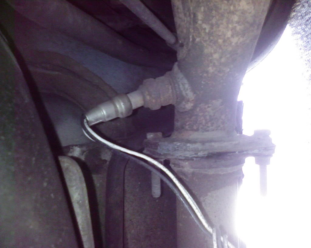

Is there anyway this could be related to the lambda sensor wiring underneath the car?

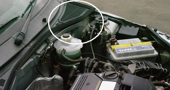

Here is where the fusebox is located on the valver:
This is so frustrating, i got it running for 10 minutres last night then the fuse blew again, there has to be something shorting it out in the engine area
