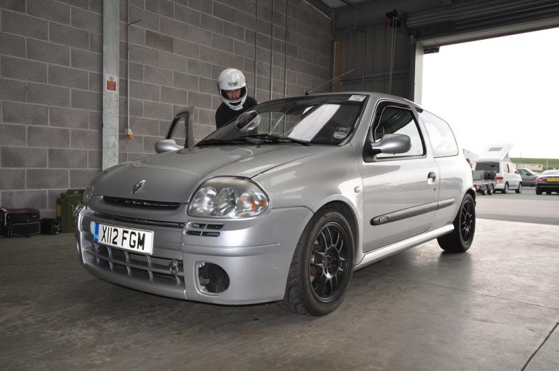

This is my car using them, lowered approx 50mm at the time, seemed to handle ok:
Have gone to KW now which I prefer, but they are a lot dearer too.
