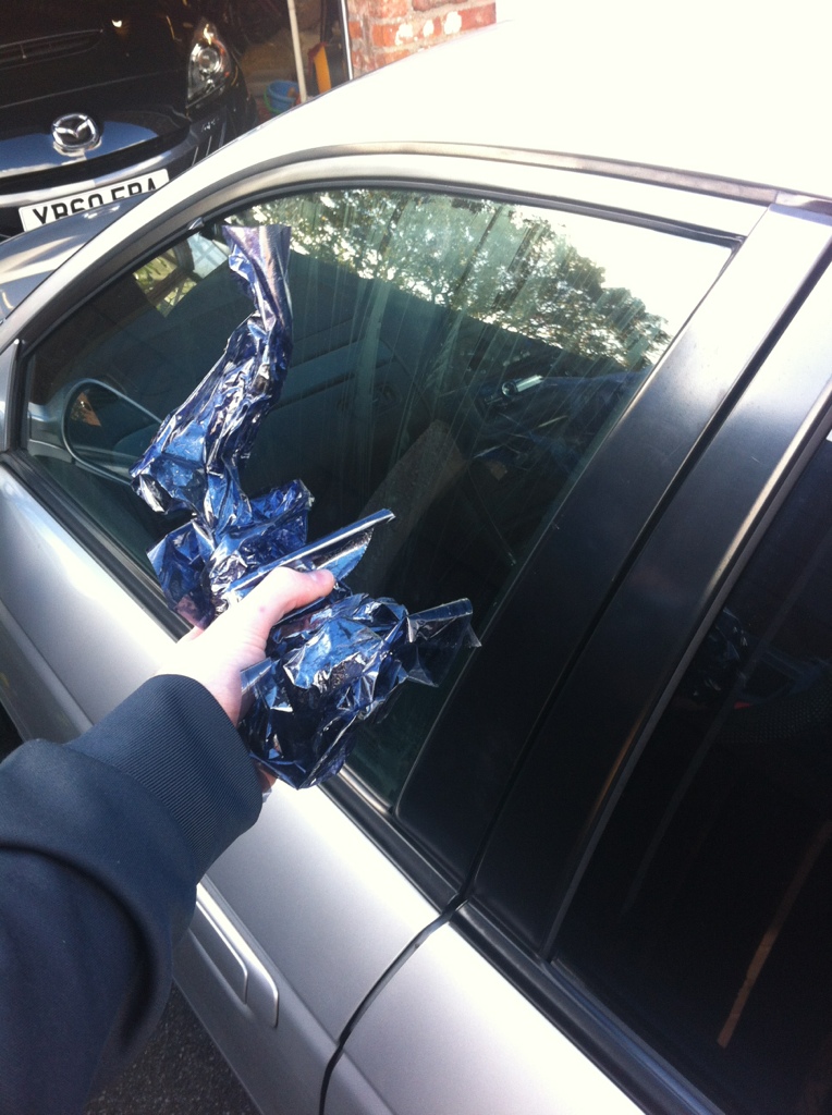

Ripped out the front tints today, they were asking to be pulled over and were far too "Bradford" for my liking.
Film ripped out...
And a boat load of pure acetone later...
Much better. I'll leave the rears as it's a crap job, and they'll help slow down the rear seat fade.

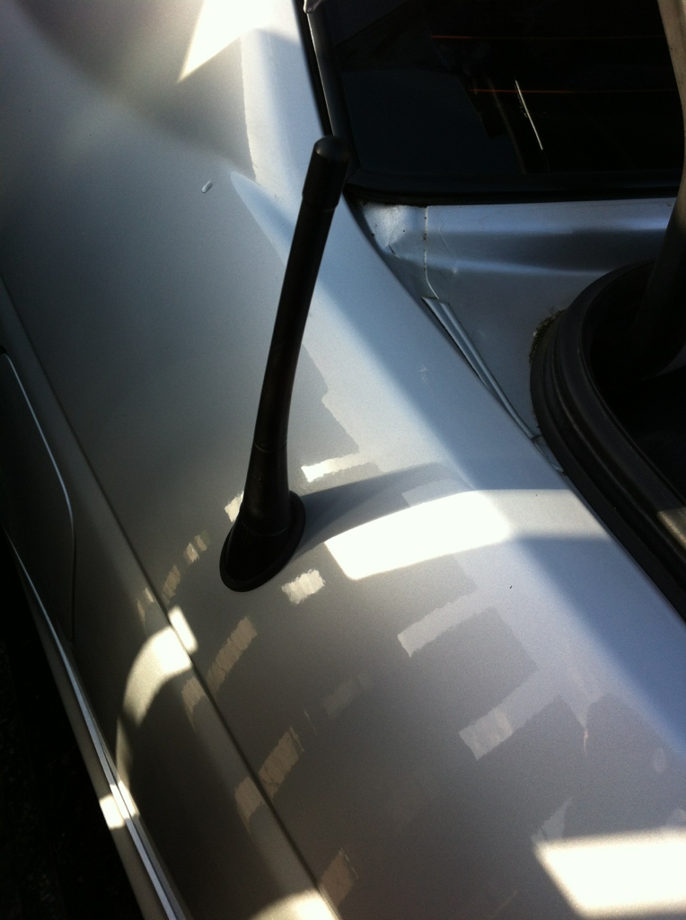

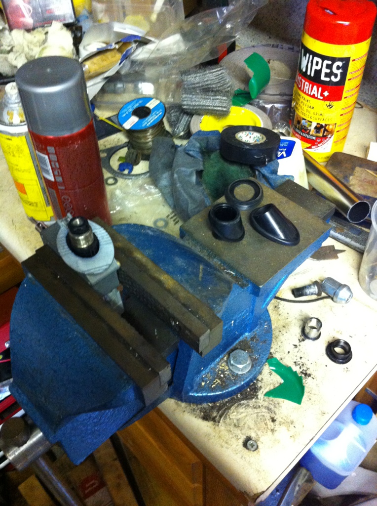

Instead of doing the fuel filter, oil filter, gearbox oil & cabin filter today, I decided to fit an S2000 Aerial as my electric dong mast sounded horrendous. Not a bad job, only takes about 30 minutes.

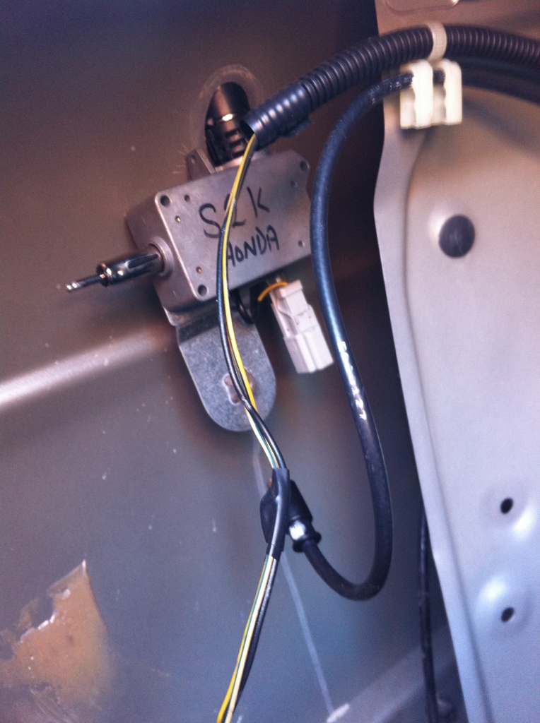

After a bit of b*****disation of various components and a home brew bracket, that's the end result. I chucked some water over it and it appears to seal. If it starts leaking I'll just tiger seal the s**t out of it on the inside. All I need to do is get an aerial cable adaptor, and find the old live to the aerial to power the signal amplifier.

Finished off the S2000 aerial conversion today (still haven't sealed it, seeing as it hasn't leaked despite taking it through the jet wash at work). Used a 99p screw type aerial adaptor from Halfords as per the existing guides, then found there's no screw fitting. So I've taped it in place, which works fine. I then brutalised the old wiring plug to remove the aerial power feed pin (blue & white wire), slid it onto the pin in the S2000 aerial connector, and jobs a good 'un, found another 5/6 channels that couldn't be picked up with the power disconnected...

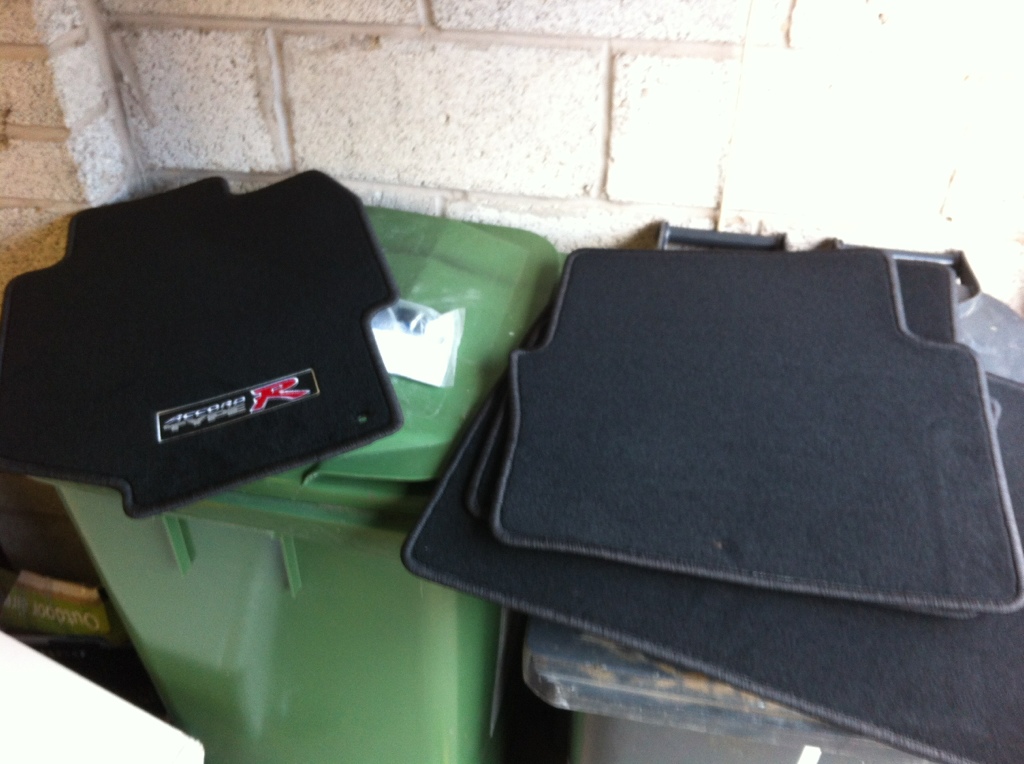

Also chucked in some new OEM mats as mine were past their best...
