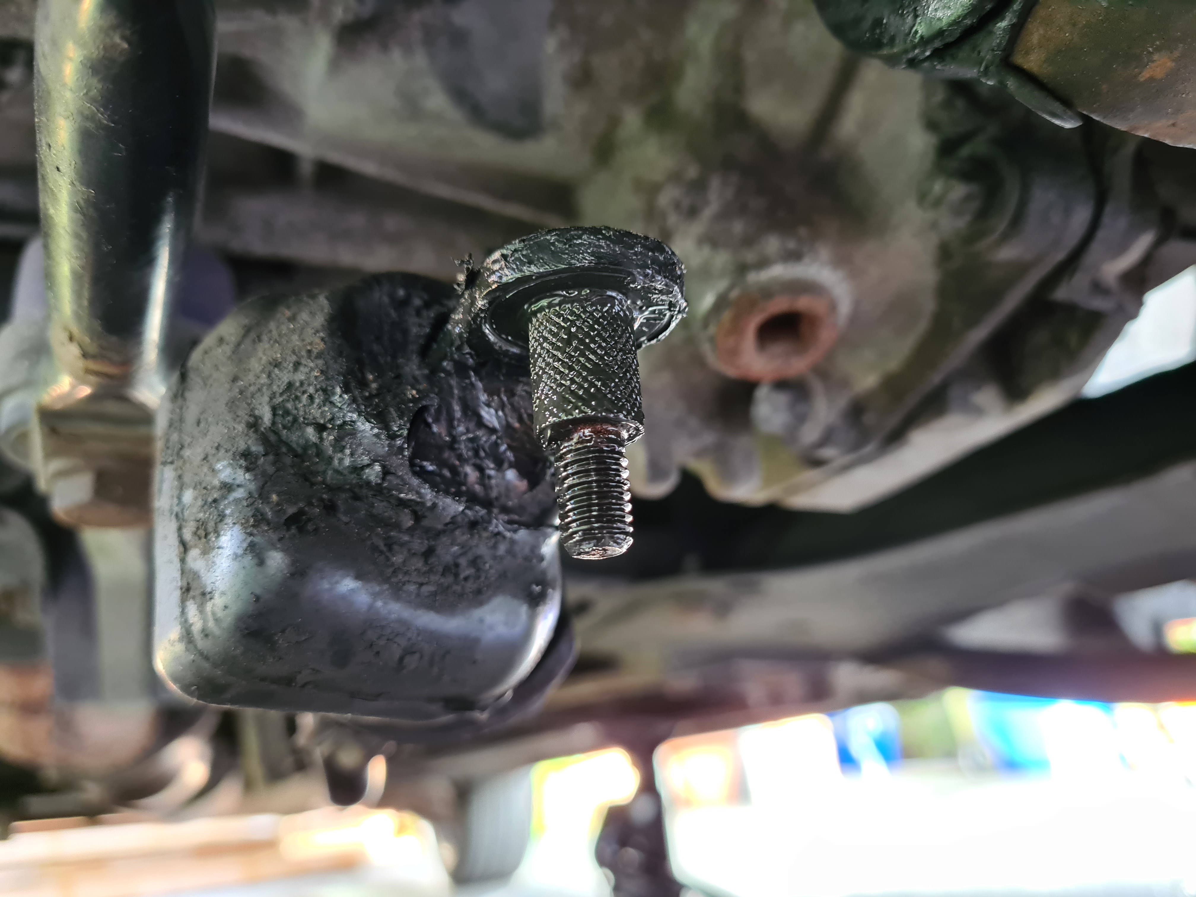

Had a good look around recently and found a lot of play where the gear linkage attaches to the pivot underneath the gearbox but can't really find any info on this. Would this cause the play described? If so what parts are needed to sort it?

Looks like a nylon or rubber sleeve still in the joint there? Must be able to get a new one I'd think, or have one made, that'd be a 10 minute job to knock something up if not.
It must be, looks like whatever is there has worn away by the knurled bit which seems to be in fairly decent condition. I might try to knock the bush out and see what it's made of.
That knurling looks like what youd normally bond a rubber bush around so I'm guessing its split away from the centre
If its just the centre bush you can get away with, leave it with me. Possibly got a couple at home! 🤞🏻
Maybe it is, I'd have to take it apart again to check. Would make sense.

I have exactly the same issue, I've replaced the bushes under the gear knob with some brass ones from @plees which has made it slightly more solid but i still have so much movement around that pivot point.
I didn't have a bush around that knurled section but I've got no idea if there's supposed to be one there?

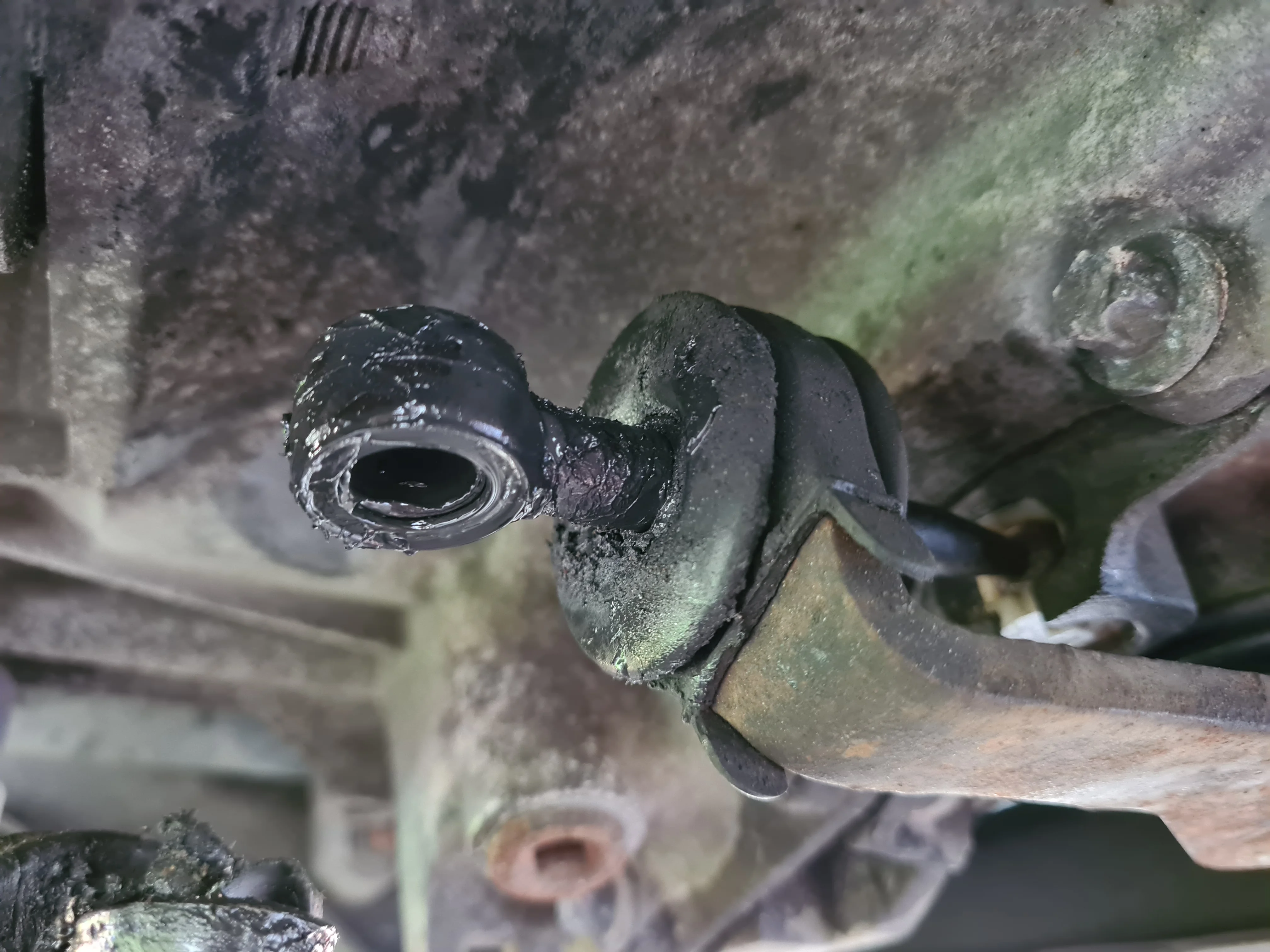

In the second picture it looks like there is some sort of bush in the front pivot.
Maybe those are still available from Renault and come with a new bush pressed in.
