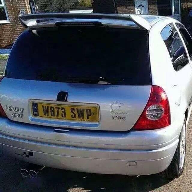

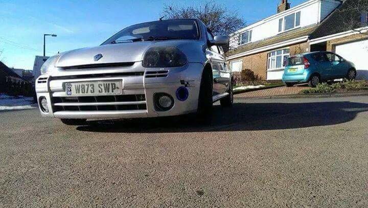

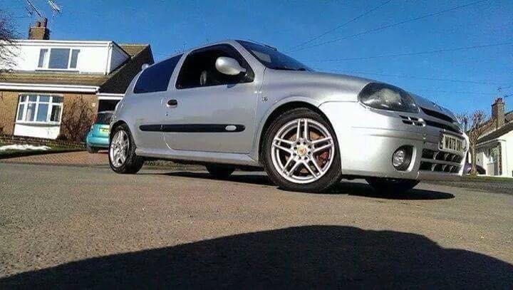

just so we all can see how much of a barry owned the car last here are some badly taken pics of it lol ...

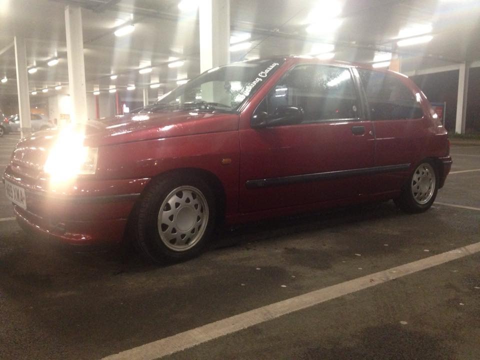

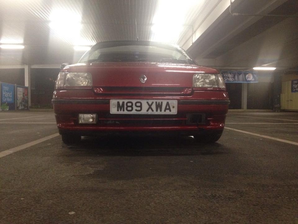

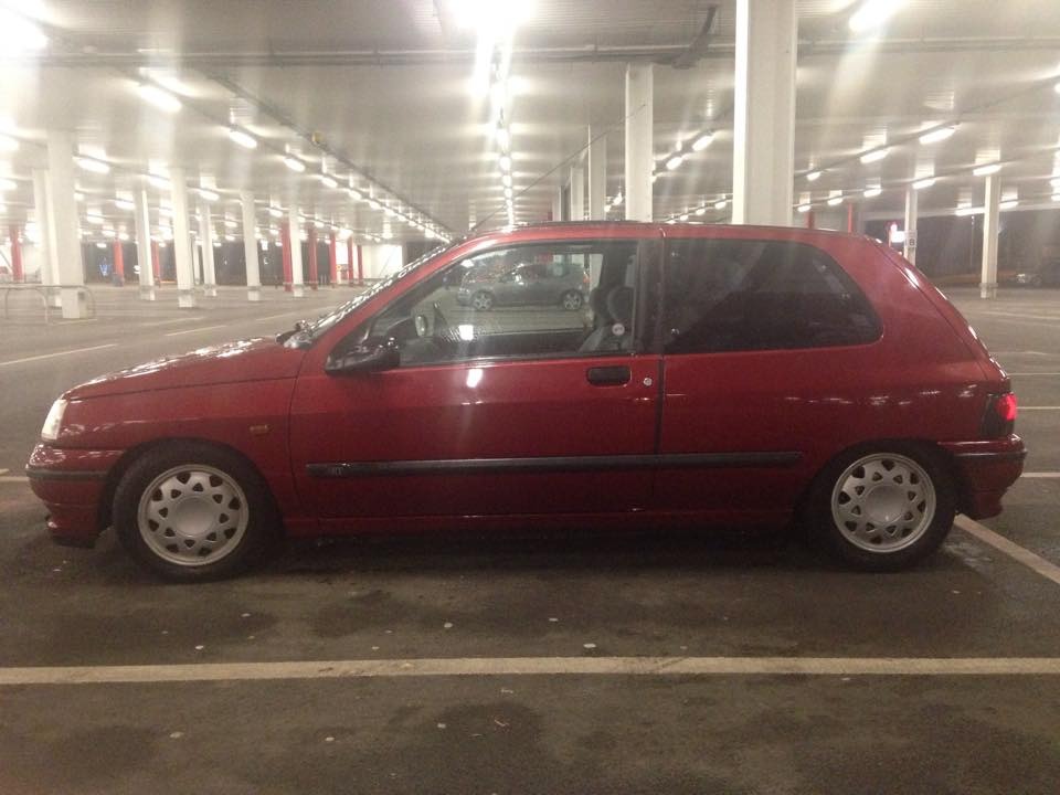

and this is the automatic heap I swapped for it .... *lol*
Spoiler is now removed and I hate the wheels but it was a fair swap ... just need to know if that flywheel will do because it's uber cheap

At least that back bumper hasn't been cut for the dodgy exhaust by the looks of it.
