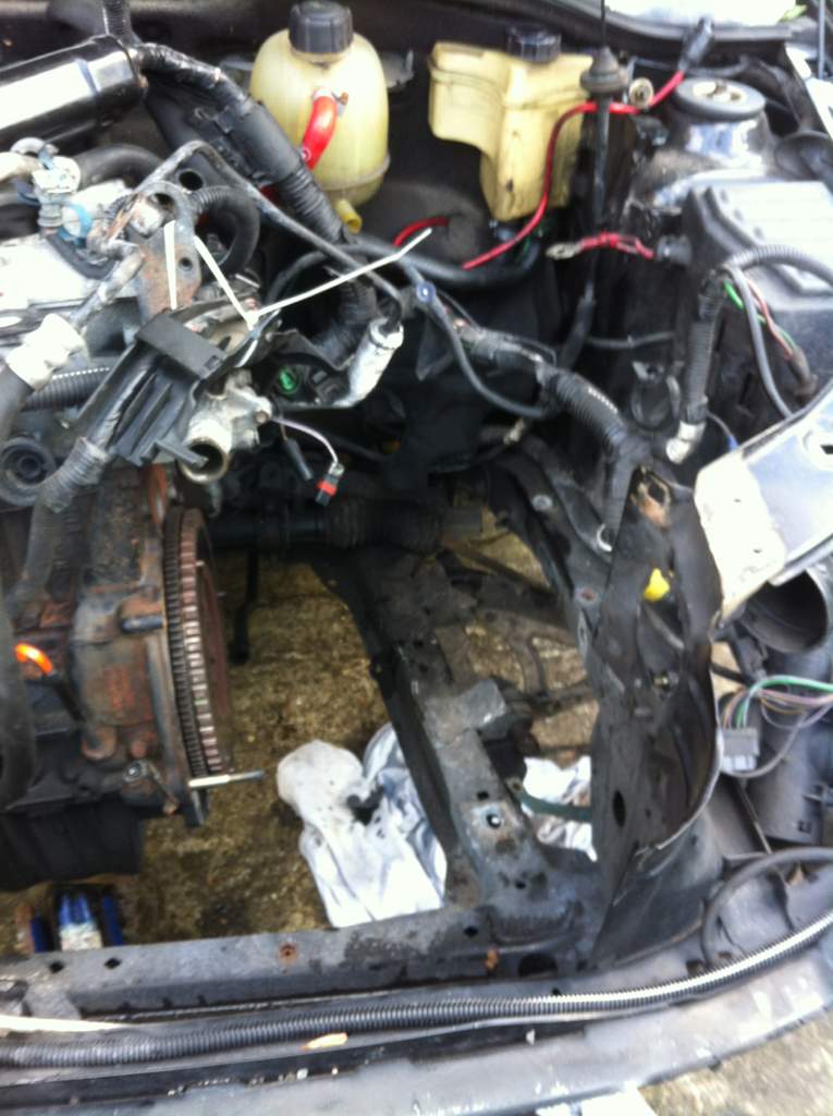

Gearbox out the bottom - Help me review my plan!
Having had the subframe off my clio, I'd much rather do that than take the box out the top, subframe comes off so easy, even if the captive nut clips break, Took me just over an hour iirc.
Plenty of room:

Sonny dont even attempt out the top tbh mate, I had a look at it while doing that last box and its a near impossible task without scratching/braking everything. Disconnect the ball joint on passenger side, shaft out, all frame bolts out incuding the pinch bolt for column, dog bone mount, gear linkage and the 4x 16mm rack mount bolts (leave the rack hanging) Jack under engine on the sump (block of wood) and remove the top gear box mount and lower engine/box down to an angle, remove bell housing bolts and starter bolts. You should manage to avoid removing drivers ball joint and shaft from hub if you swing the subframe towards the drivers side some more (no big issue if you have to remove it)
Box out and and opposite for back in, obviously remeber to drain oil first and any small clips for looms, coolant pipes and so on.
