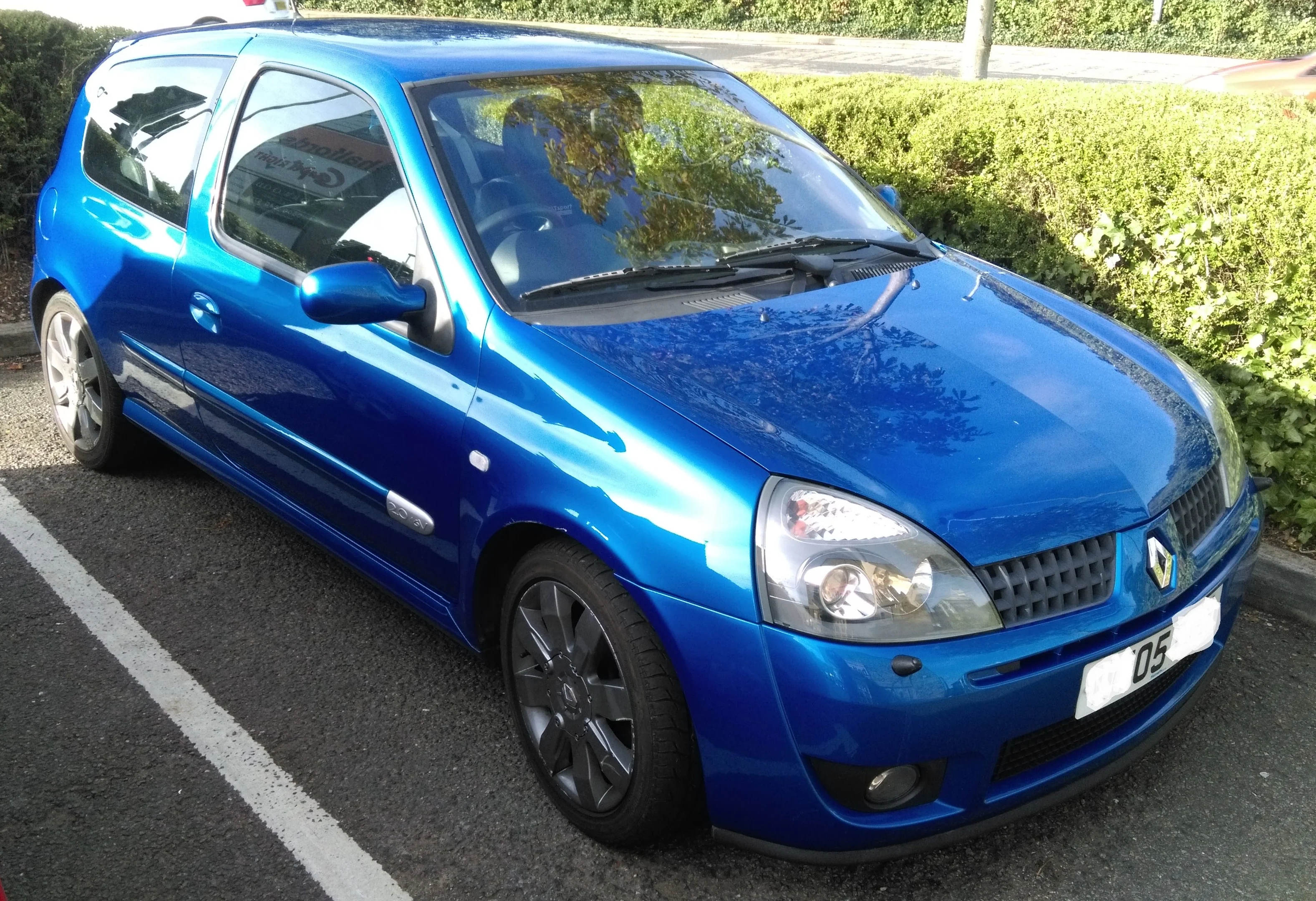

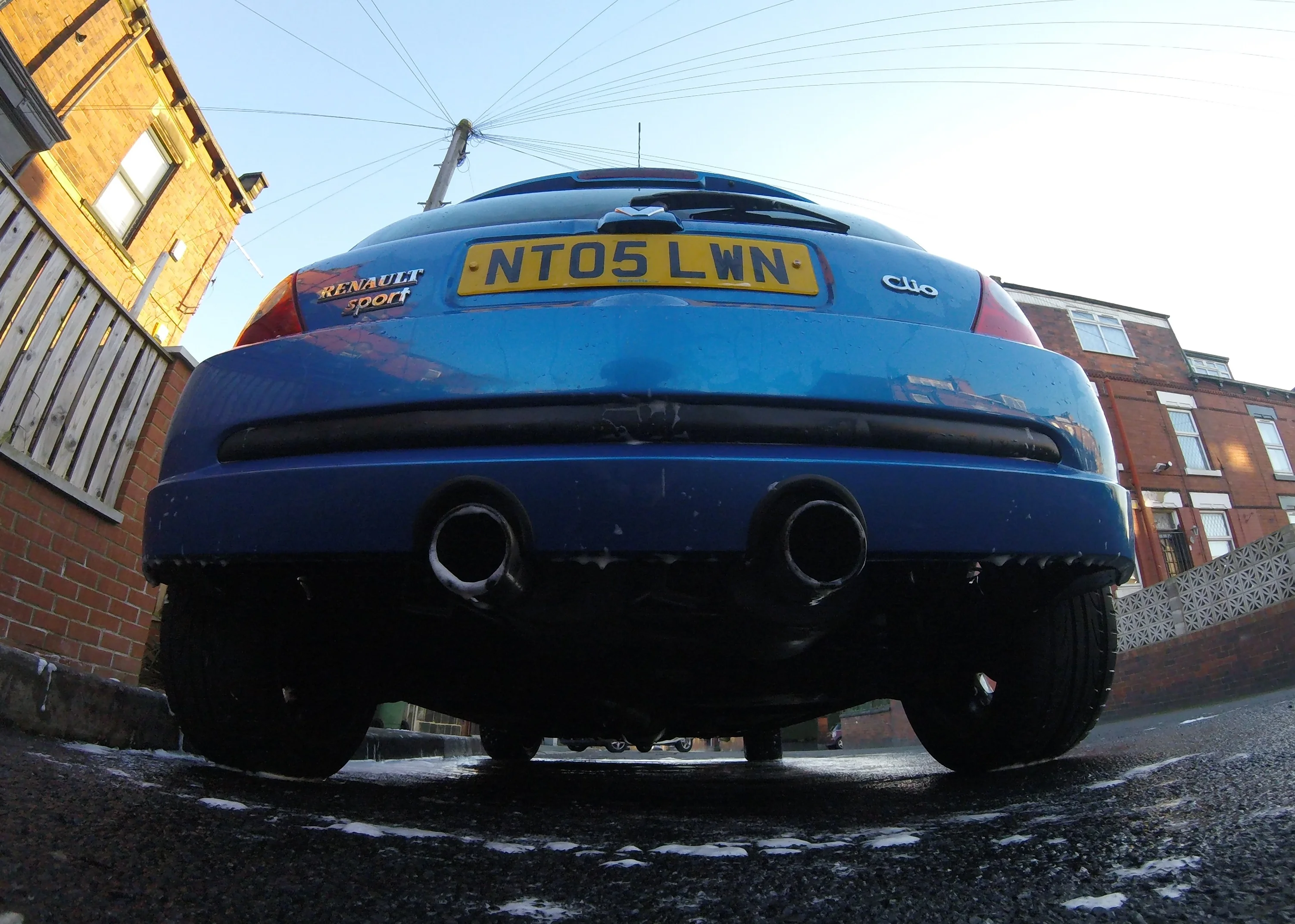

Post-clean, pre-wax shot, and another one of the exhausts because I was dicking about with my gopro:
Exhaust looks quite mis-aligned in that one, doesn't look that wonky in reality I promise!

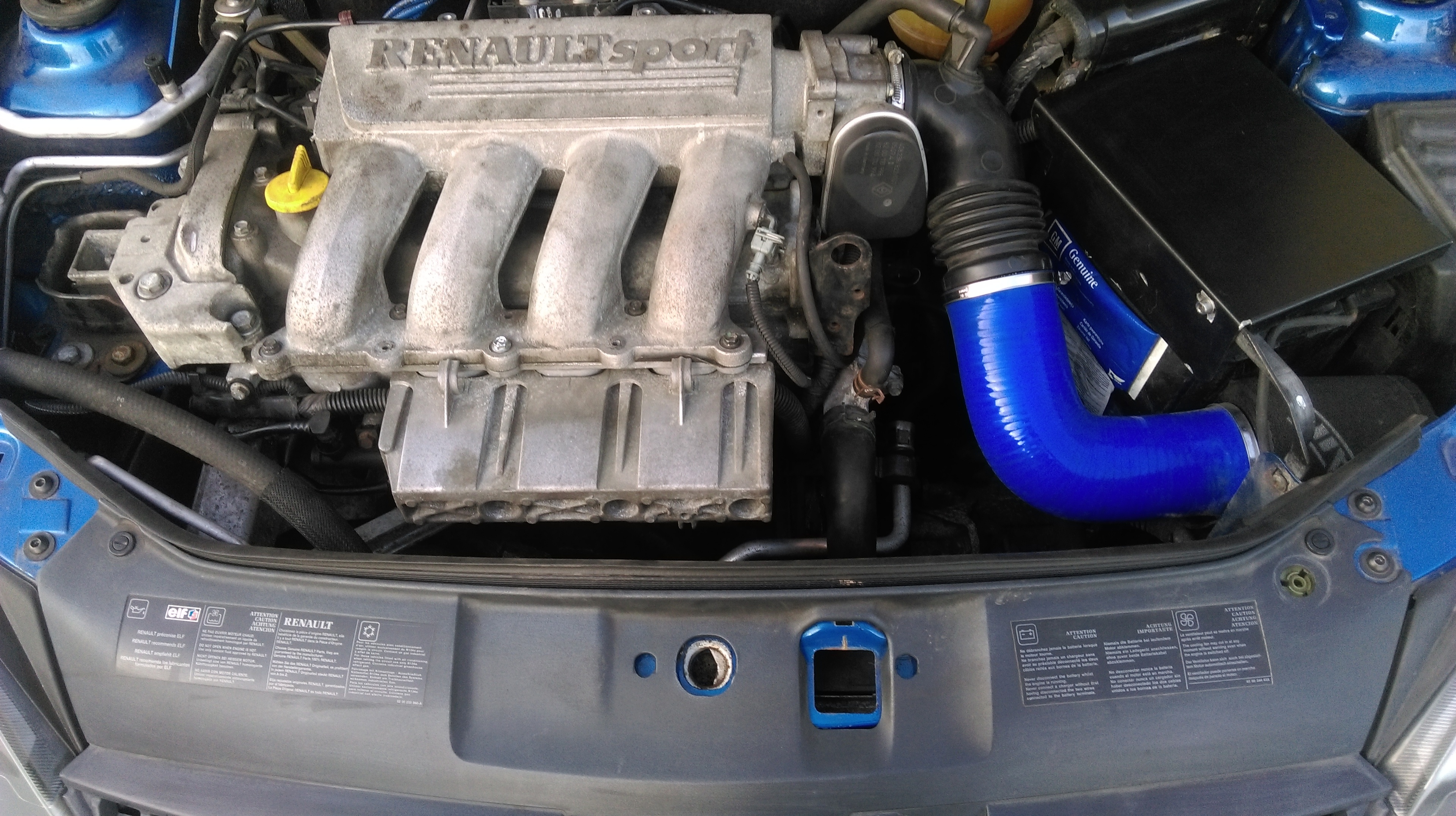

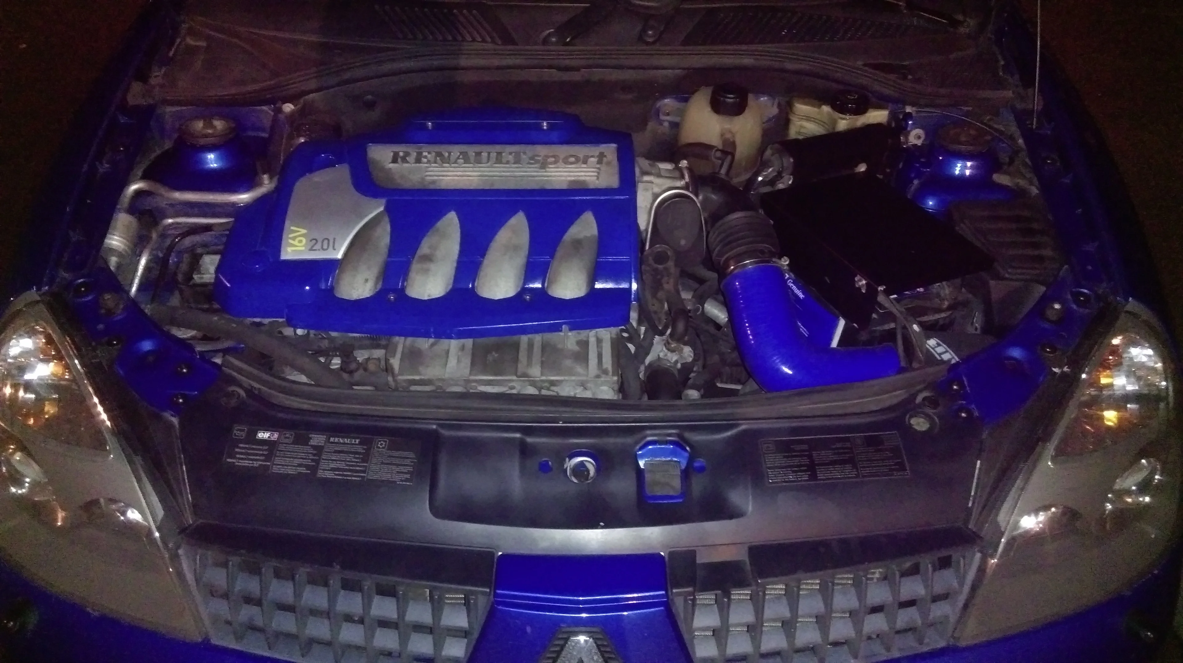

Got her some fresh oil and filter in, along with fitting the Fatty's induction setup. Also (badly) sprayed the engine cover and fitted a battery cover:

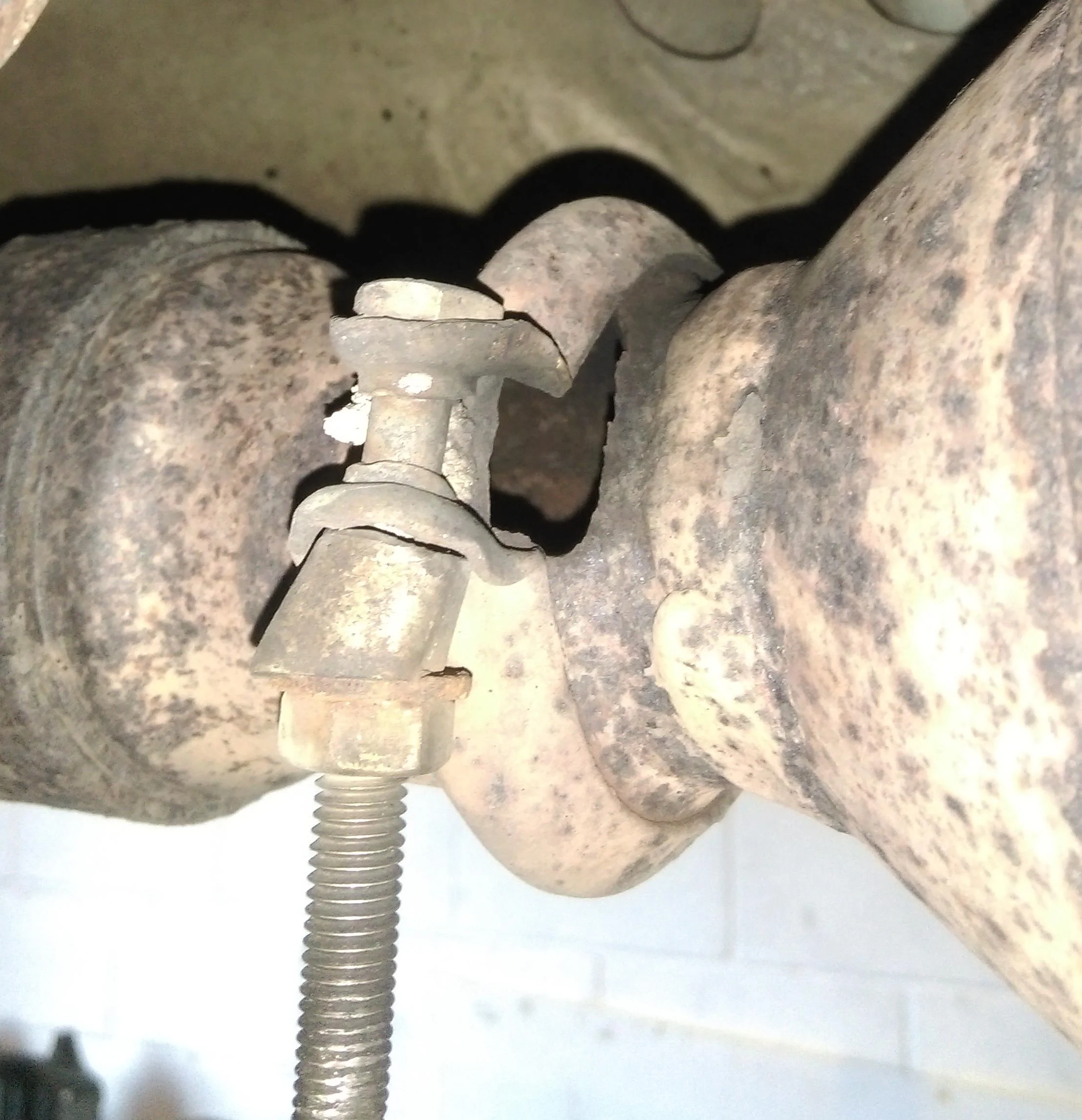

Next came an ever-increasing growl from the exhaust - not in a good way. Turns out there was a large hole in the joint of the catalytic converter to the mid-secton. I don't know who last had the cat off but I think they put it back on in about 3 minutes with their eyes closed... not good:

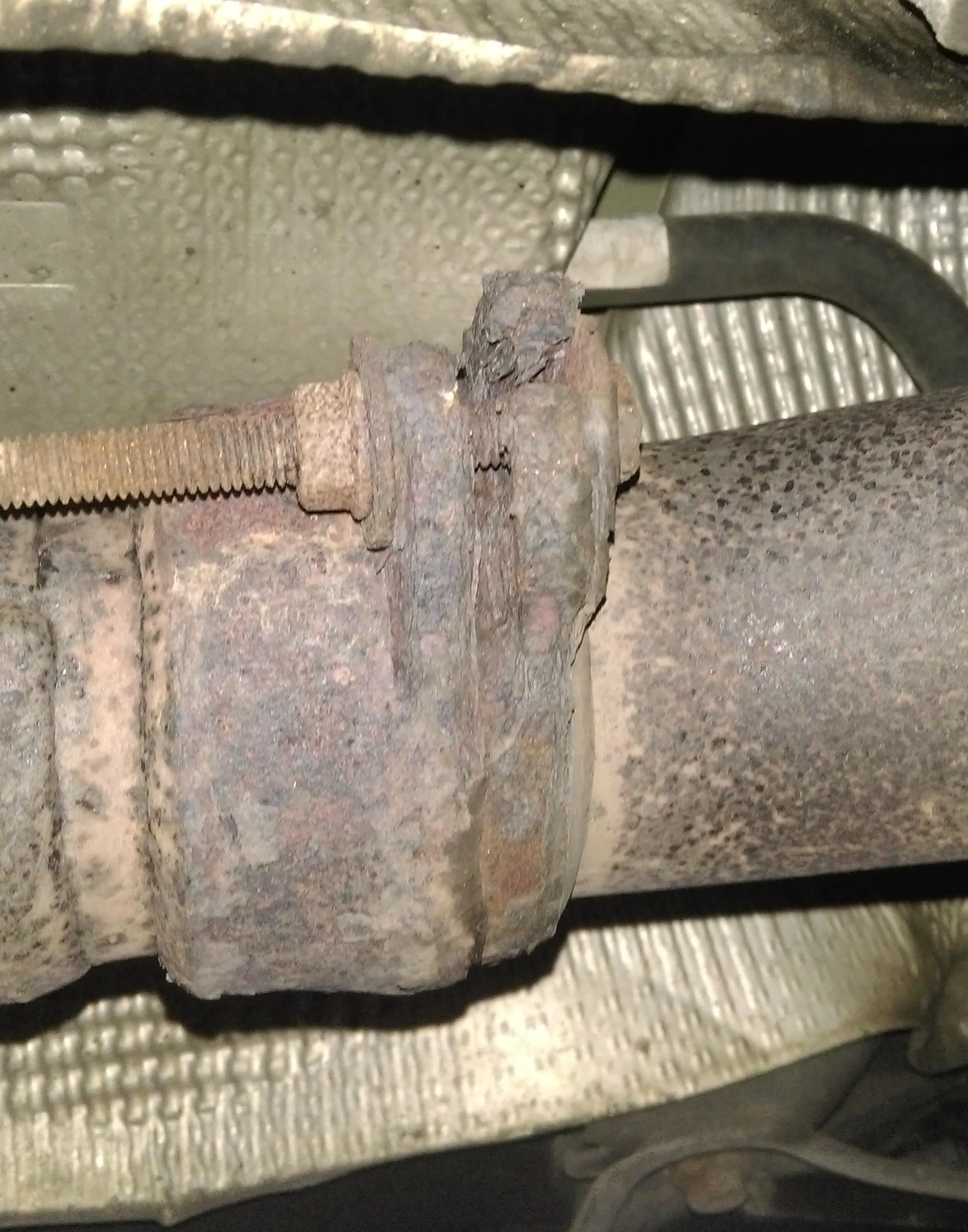

And the join between the manifold and cat wasn't much better looking:

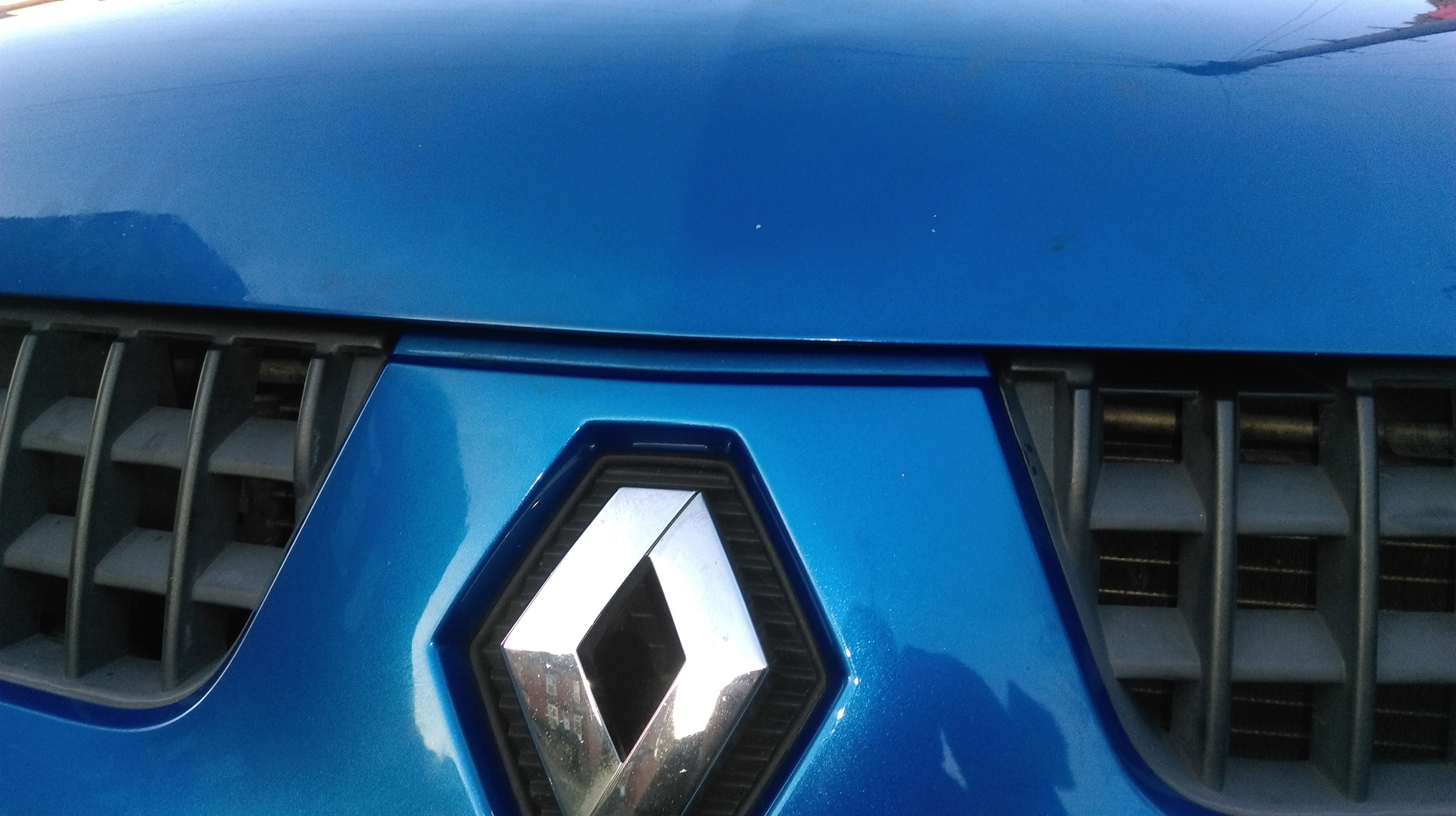

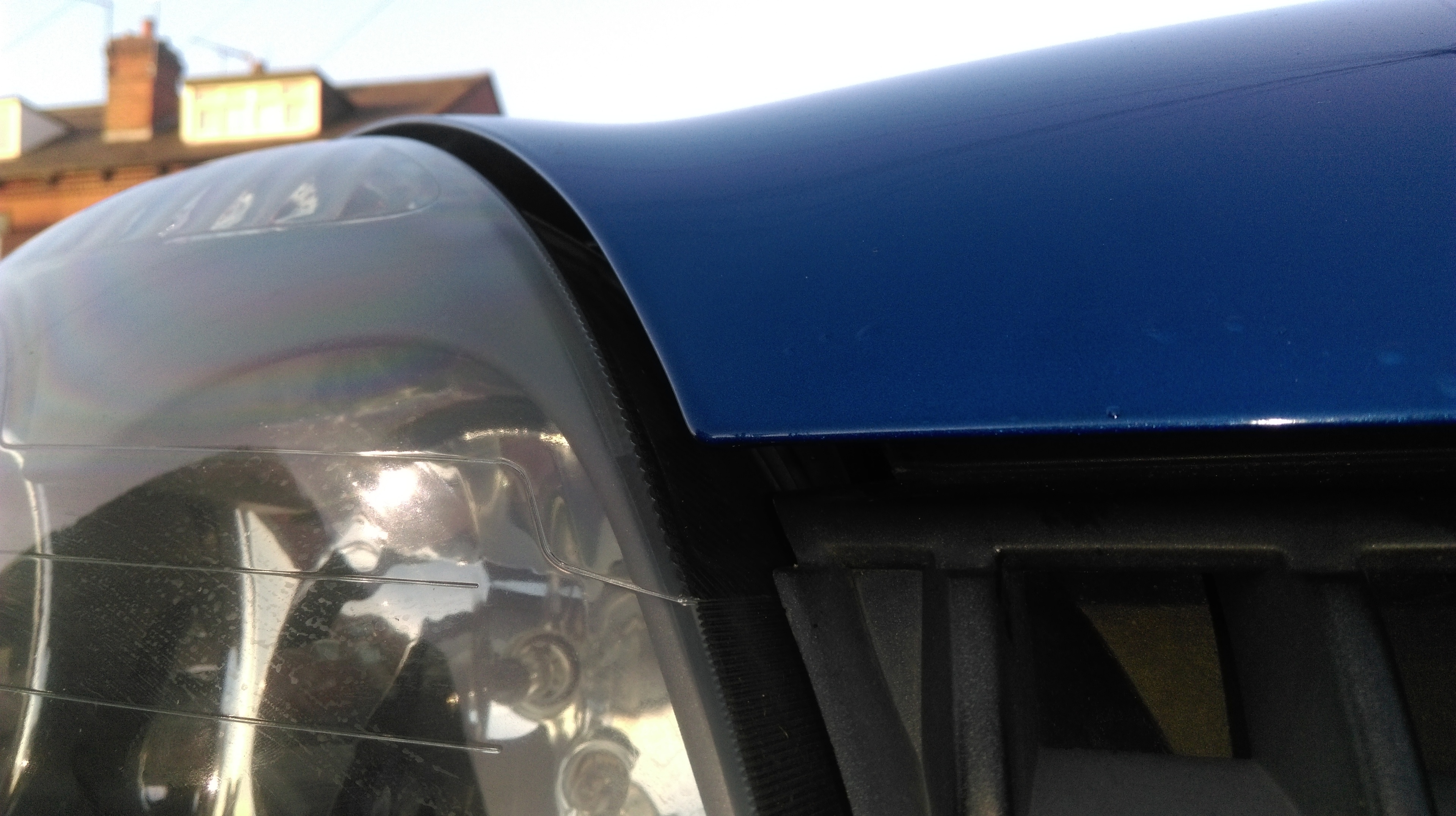

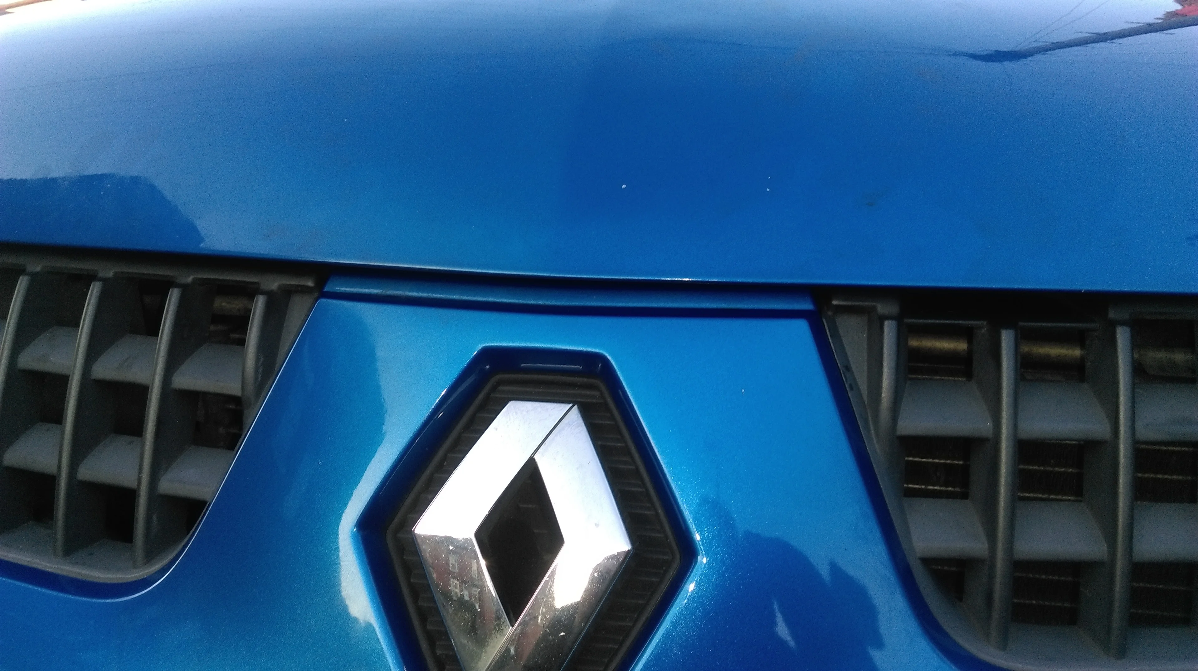

Had an issue recently with the bonnet catch, it was sitting higher than usual and wouldn't shut properly without me leaving something heavy on the release catch:
Having read a thread on here with someone having similar issues, I removed all the catch mechanism from the bonnet, along with the slam panel, gave everything a clean and re-adjusted. All fixed and fitted back up now, and bonnet's sitting back where it belongs:

It was quite clogged up with crap yes, but having thought about it further, I think the cause was this:
I loosened off the slam panel to get the fuel rail cover off easier when doing an oil filter change.
When reattching the slam panel, it was screwed in slightly to one side (there's a tiny bit of play in the left-right alignment in terms of where you can screw it in)
This, combined with the stiff catch mechanism meant the catch couldn't engage properly because it couldn't push the catch across just with downwards pressure.
Hope that makes sense, just in case it can help someone else out with the same issue

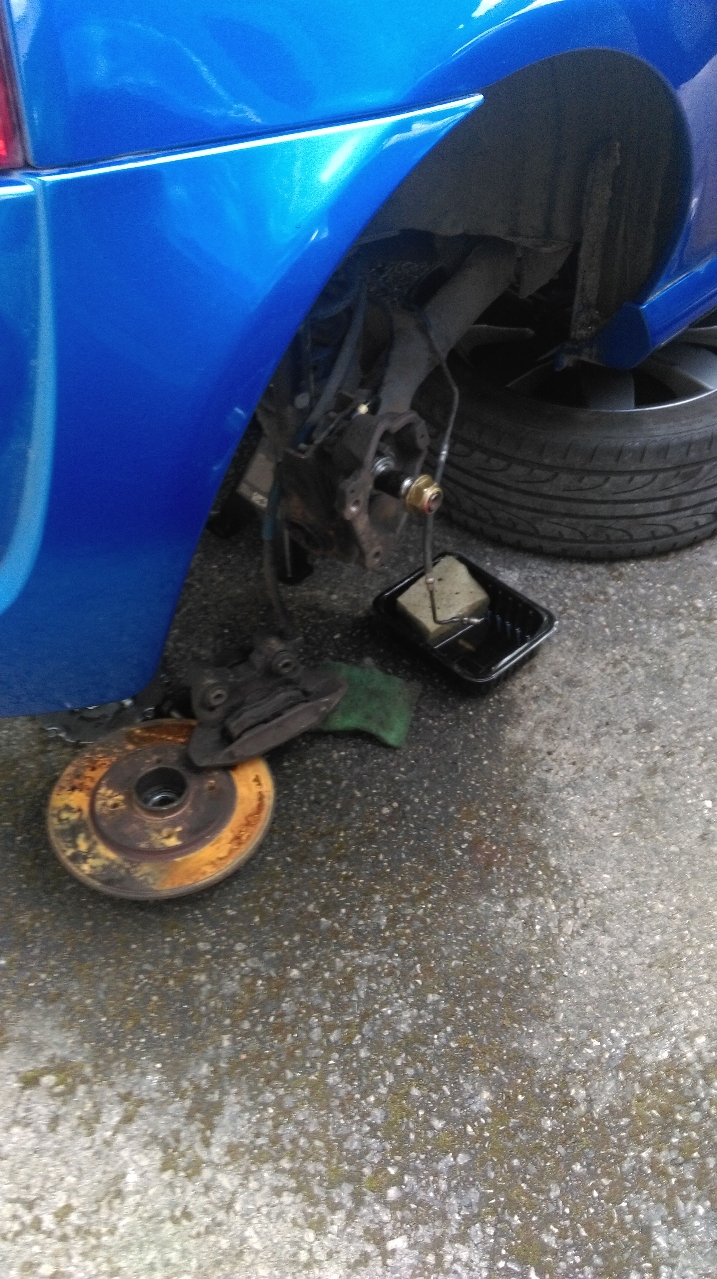

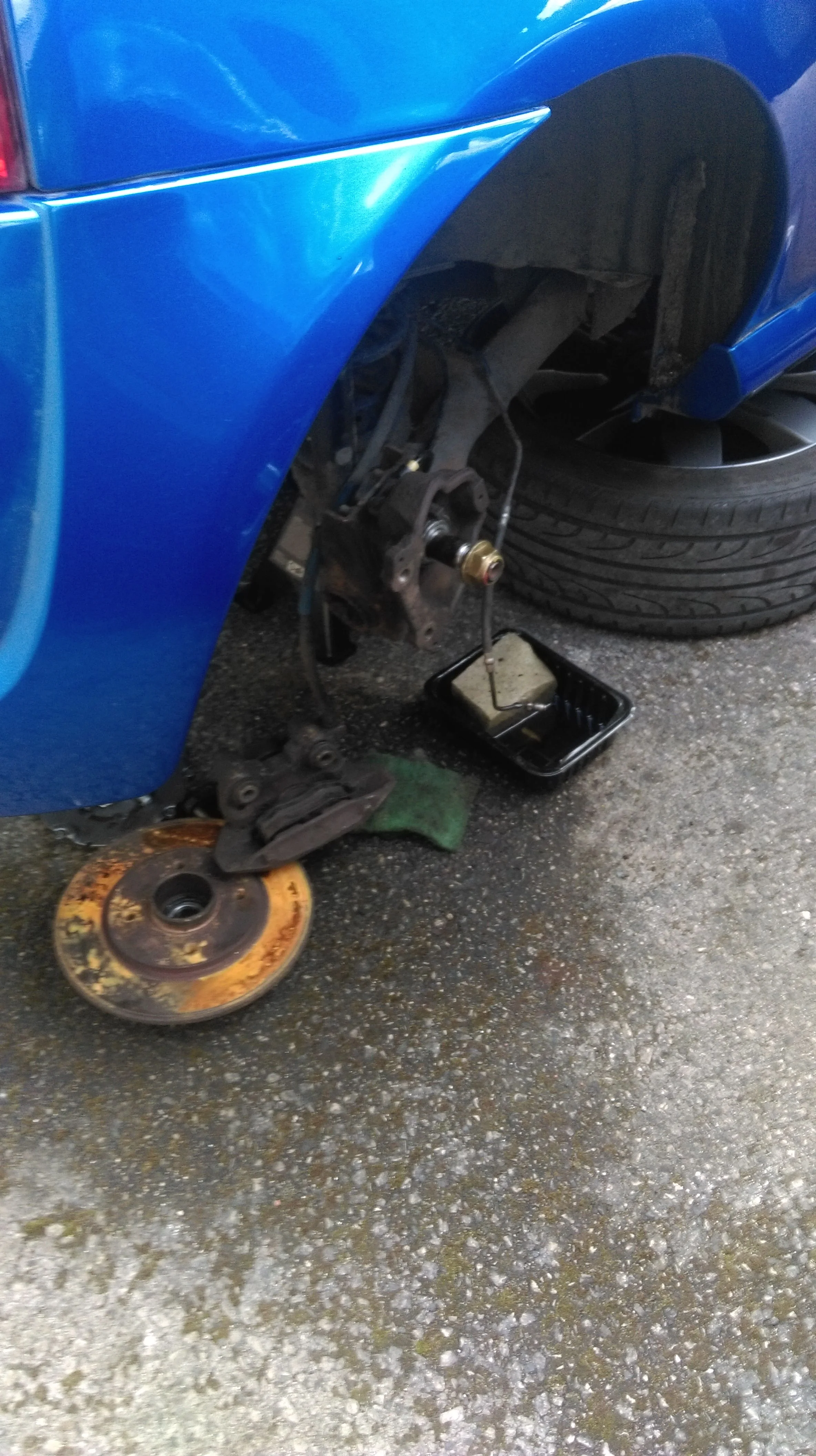

Due partly to the rusted over calipers and partly to my lack of mechanical precision, I ended up ruining the thred of one of the bleed nipples and splitting a handbrake cable.
Simple enough solution was to grab a new caliper from eBay, scrub it up a little and chuck it on in place of the now ruined one. It meant the car was on stands for a few days (hence the massively rusted old disc!) but only cost £27 and was actually a surprisingly easy job to do, as long as you accept you'll lose most of your brake fluid down the pan when you unplug the brake line from the caliper. All refitted, air forced out and new Dot4 bled in all round, and the brakes marathon was complete.

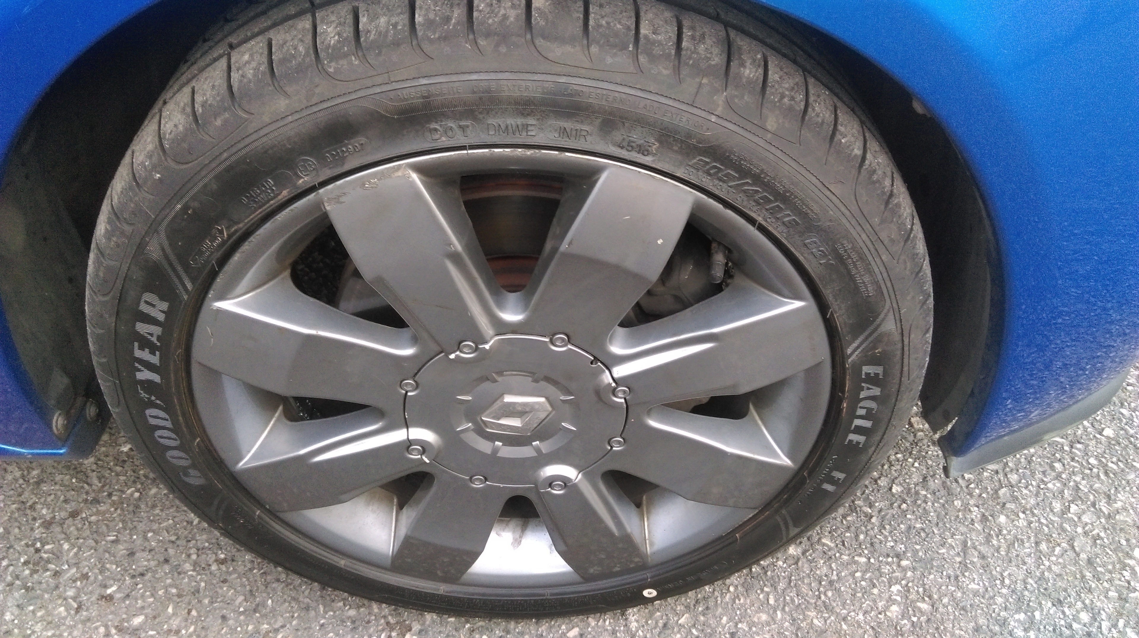

Fresh Goodyear Eagle F1s fitted up and feeling good, these are rarely mentioned here but have recieved some good marks frm reviewers, and came in at decent value from Blackcircles.com

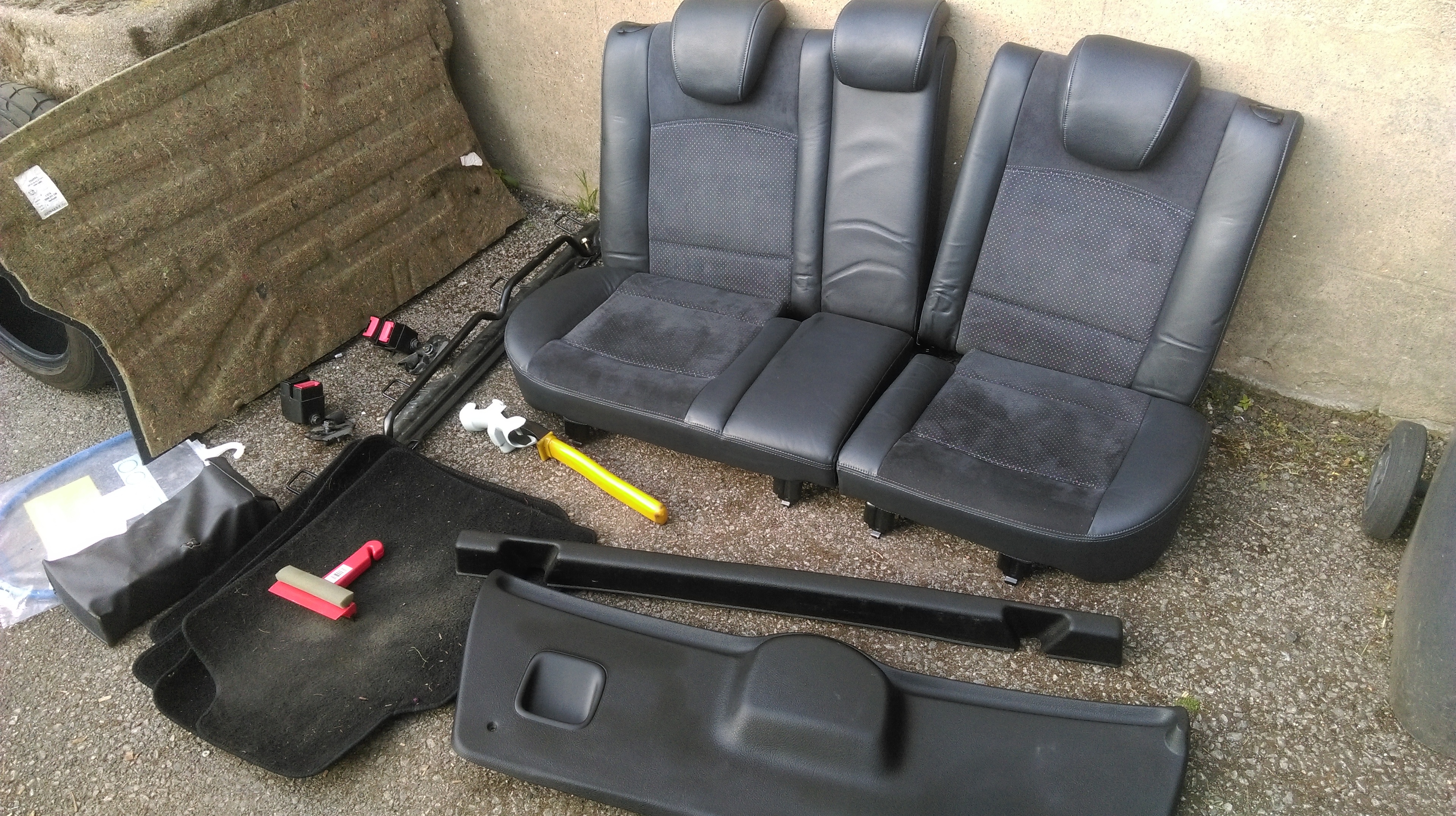

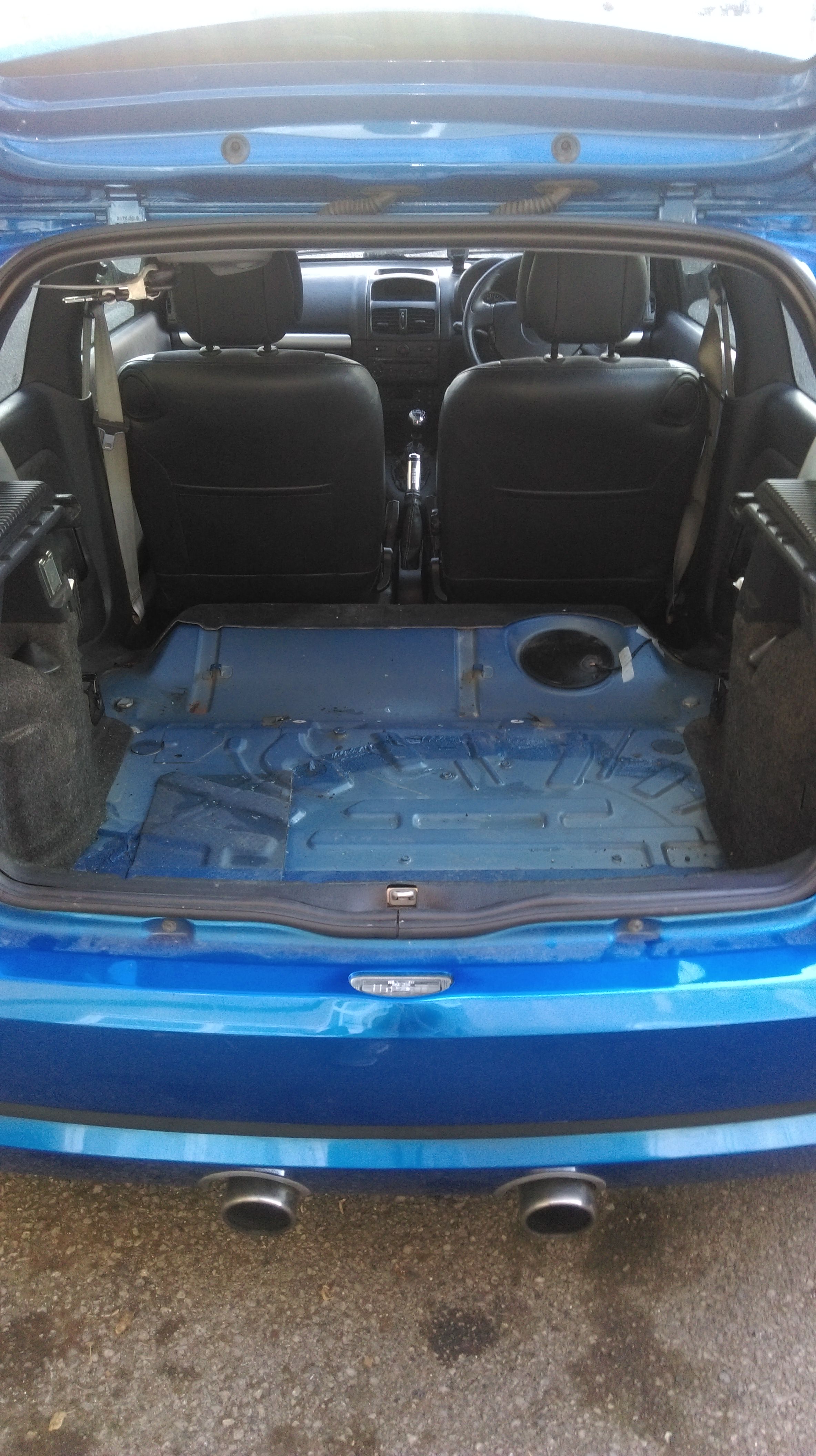

Finally (and this really has to be a temporary measure for track fun) the 182s been on a diet at the back end, shedding back seats and carpets - hopefully a decent bit of weight saved and unleashes the noise of the Miltek cat-back! Double bonus!
Quick cleanup of the back left her looking track-ready and exciting:
