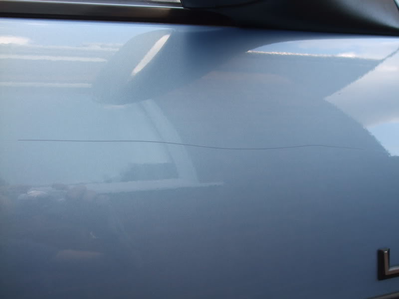

looks like someone has been down it with either a key or caught it on a bike - you can slightly feel it with your finger nail!?! anyway of geting rid of it with out a pc?! ive tried scratch ex and it feathered the edges but didnt get rid of the main mark!? wet sanding!??! im not that brave?!

what do you think rich?! some very thin wet and dry soaked over night?! and try to polish it back up with Scratch X?
its not down to the primer but close?!

Depends how brave you feel. 2500 paper soaked over night and some big balls maybe required!

Just give it one light pass with the 2500 and then polish up and see how it looks then ?

yeah thats what i thought! one other thing is i think the wing has been painted at some time in its life so what also scares me is i dont know how good the repair was (think it had a little bump sometime in its life)
Ill get some wet/dry and have a go! see if i can loose it a bit!
and movements - up and down / side by side?! cicular sp moation :S

only jokin its a respray mate .you can tone it down but its never gona go away .
you could touch it in then get a good cutting compound and mop it back may look better

On a more serious note I had a small scratch like that on my clio, nowhere near as long as that, a branch caught it. I managed to drip some paint in there using a cocktail stick, didn't look too bad!

can you put your nail in it if so its gone to primer /metal broke the paint barrier . youll prob just have to live with it ive got a little key mark on myne but cus its a clio im haveing it done and at a trade price its 150 because the whole quarters gota be done and flicked in .
your prob looking 150-200 depends on how good you want it

LOL you get dafter! i might get away with not putting any paint in to the mark as its not that deep and its not down to the primer :S ;)

:( ill have a go with the wet and dry first! very gently ! :)
Use the cocktail stick method then wet nd dry then polish I would if its down past the clear and paint...

Edit: have you got any touch up paint for it id do this before the wet and dry and minismise clearcoat removal.
