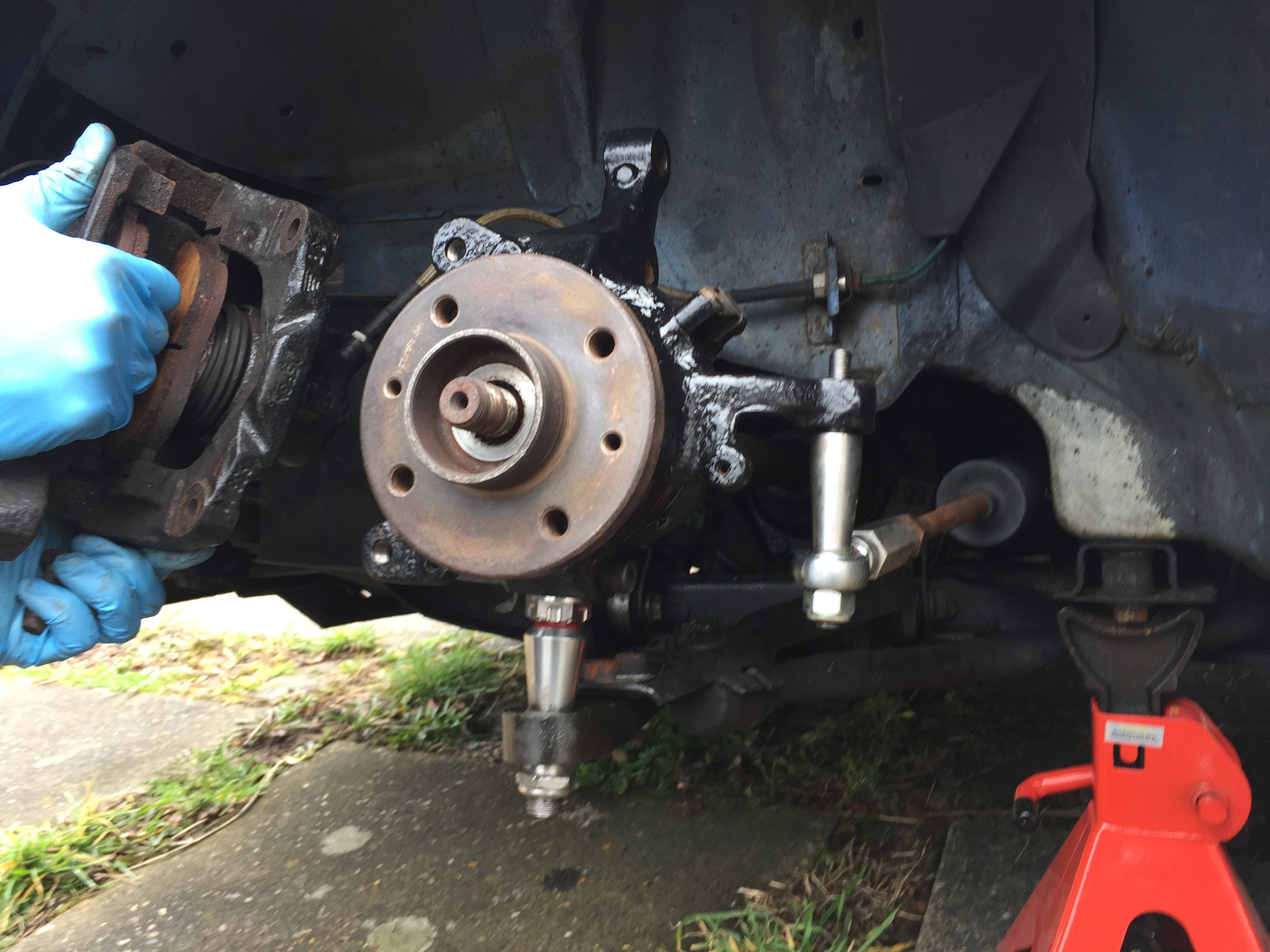

Roll centre kit - I'll be totally honest, I found it strange at first as the car felt super twitchy and the back end felt mega light. After doing a few sessions though it was clear what was wrong...my driving. The kit really has transformed how the car handles and it's a case of point and go now instead of the previous point and hope it turns. I have had to change my driving technique to look further ahead, and now because I'm not fighting understeer the wheel movement is much less than before. At the start of the day I was throwing it into corners, oversteering and drifting! The harder turning had been absorbed by the springs and then turning the car before I fitted the kit. Now all the effort was going into steering the car so a more subtle and smooth style absolutely sees the best results. Druids at Brands was definitely the most noticeable difference, sooooo much easier to get a tight line now.

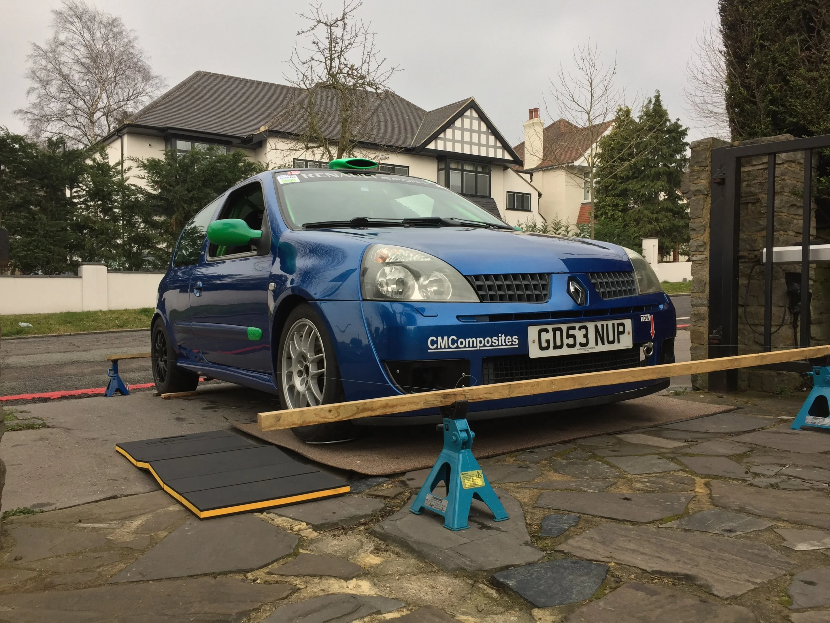

Most interesting was to get the car on the scales. It's much lardier than I thought and it weighted in 996 without me in and about 3/8ths of a tank. I'm not too botherd though and would rather have the safety of a super extensive cage than a few less kgs. I was very very happy to see perfect 50% cross weights with the AP coilovers although they're coming off to be replaced this weekend by ASTs. I've booked Snetterton for the last weekend of this month, again with Mart and Rich. Having never done the circuit before I'm really excited to give it a go, especially with the ASTs.

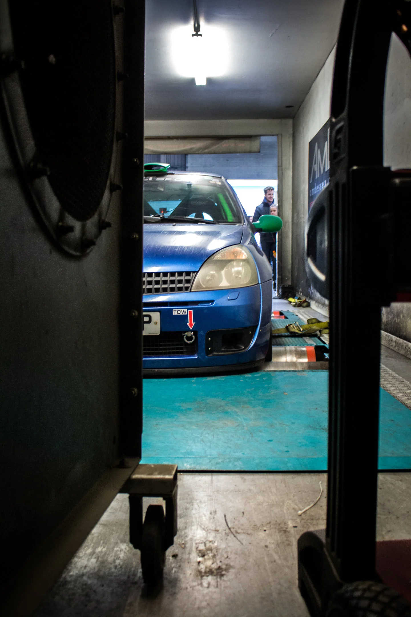

@GrahamS power/torque did it make?
There was an issue with the rollers so whilst the paper says 212bhp it’s of course not possible without throttle bodies or a little snail under the bonnet! I assume it’s the same as when I went to Surrey rolling road which was 196 bhp and 170 lbft.

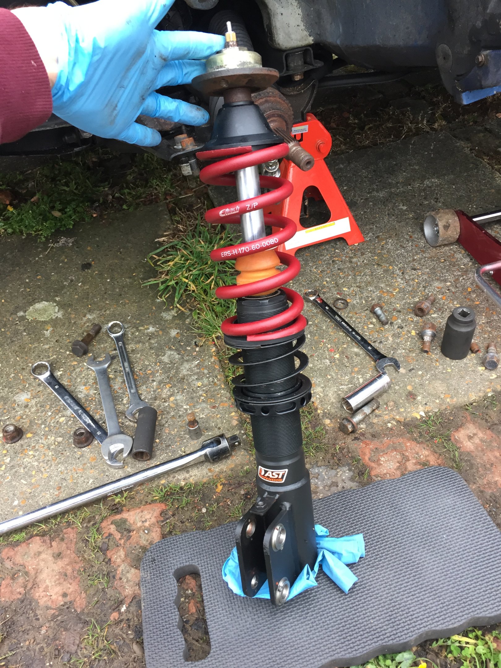

Then I needed to finish off the ASTs. Mart had them from new and as expected had looked after them perfectly. Once I'd wiped off a few bits of grime I then set about re-coating them in Bilthammer Dynax UC to prevent any future corrosion. It says to apply in thin laters to prevent it going yellow but I wanted to make sure it was very well protected to slapped loads on. As a result the coilovers are sticky with wax but they're definitely very well protected and should stay looking new underneath. A whole day later we got the coilovers fitted. To try and maintain Marts corner weighting set up the heights were set the same as they had been on his car. Part of fitting the cup hubs meant the existing tie rods weren't long enough. some FTR5277s later and I was back in business. The change was also an opportune time to sort out the steering rack boots which had always been the wrong size as they were from a 1*2 instead of a DCI rack.

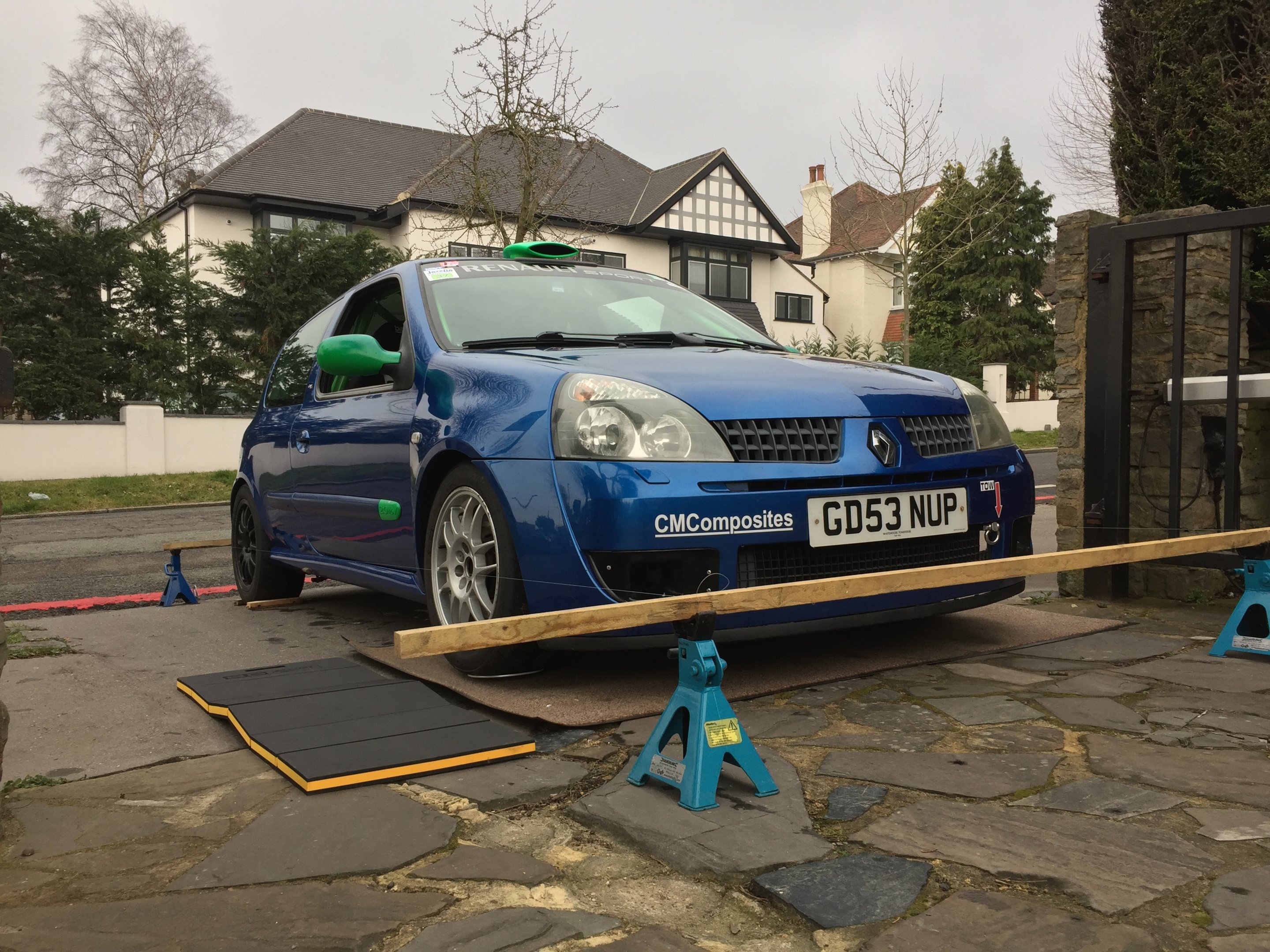

Once the coilovers were fitted the car needed tracking up. We did a rough job at Marts and then to try and get rid of some weird torque steering I did it in the garage one evening with a micrometer to make it as precise as possible. I bought a set of turn plates, the concave type, which has totally transformed how accurate stringing the car is now. I still haven't fully resolved the steering issue but hopefully will when the new cup shafts are fitted.

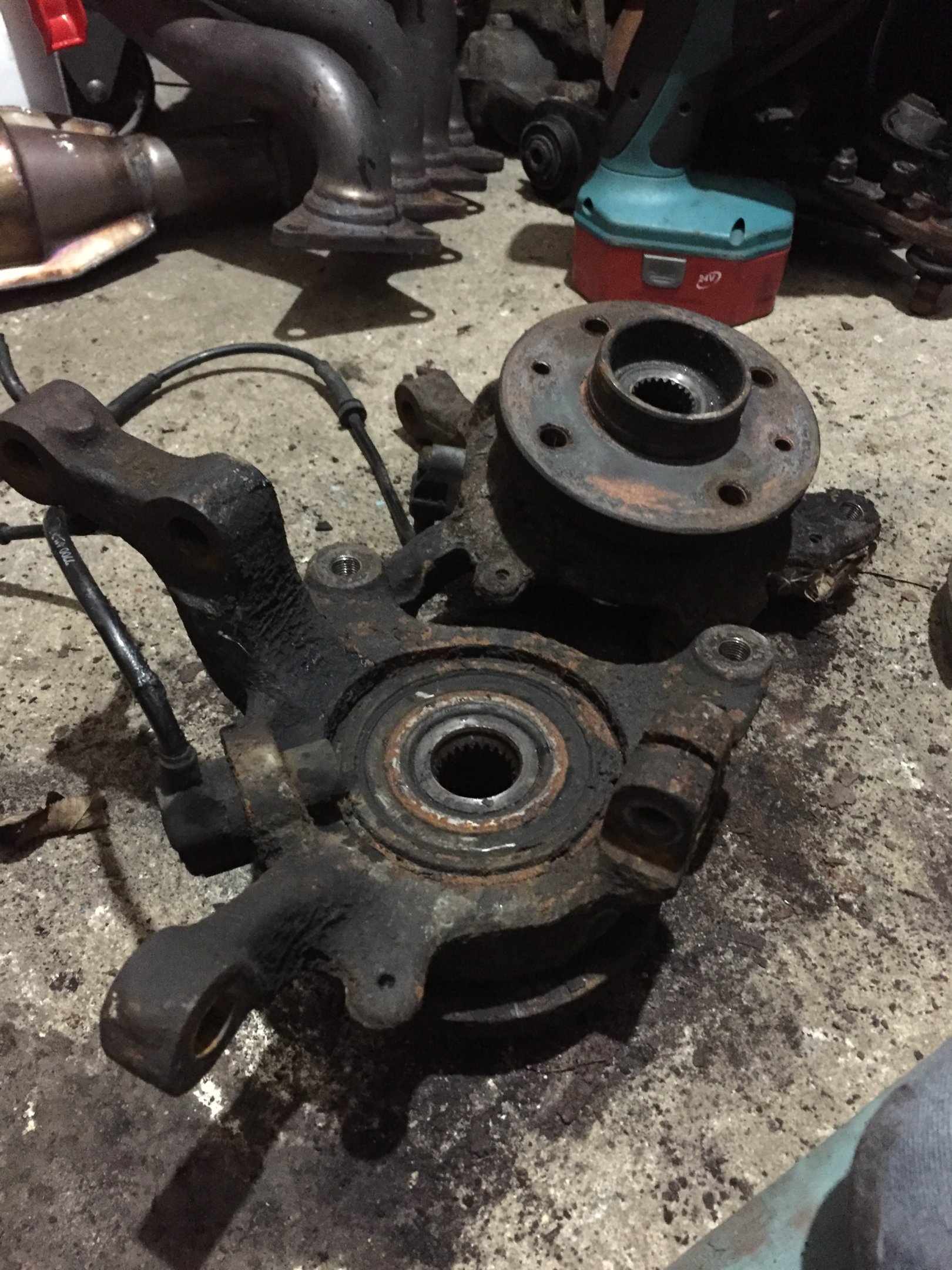

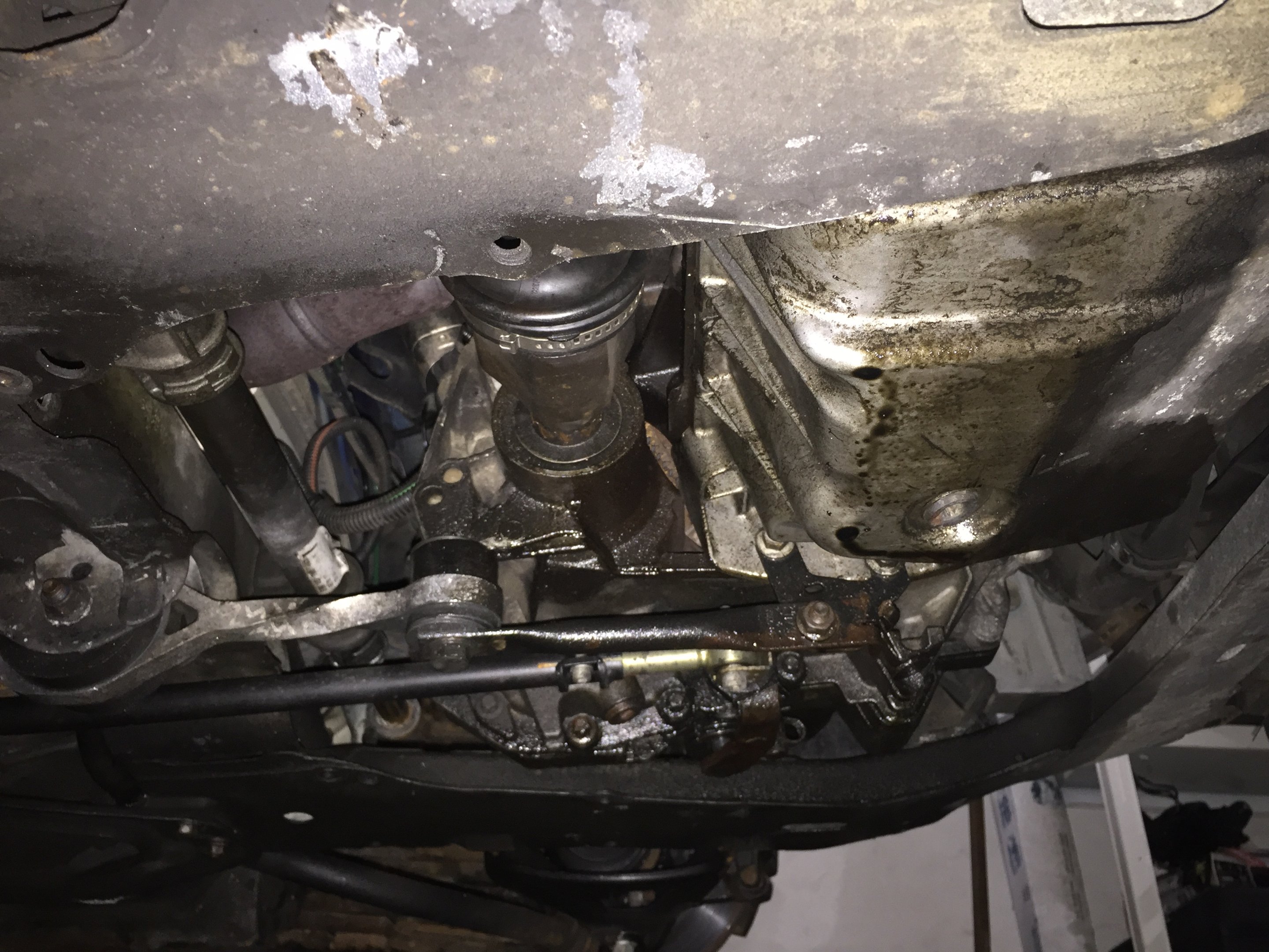

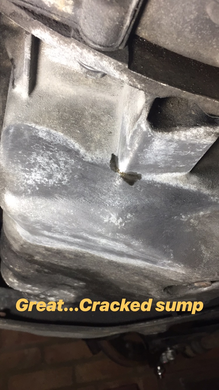

Then it all went down hill. I looked under the car for the first time in a while and found a shed load of leaks coming from almost everywhere. Now I knew it had leaks but they had clearly got a lot worse. The sump gasket, rear main seal and gearbox are all leaking and oil from the cam cover is coming down the back of the head. Worst of all the sump has a crack in. Fortunately I have a spare sump (of course I do!) but it's a right pain to do. Now I've been to Snett the car is off the road until all these leaks are sorts to the tune of about £500 :(
Snetterton - Honestly it was the worst track day I've ever done. I went with Mart and Rich, it was soaking wet and all our cars were getting rings run round us by a standard 172. The car was really twitchy and difficult to drive and even though it looked fun, I was done with the day by about 10AM. The trackday was run by Javelin and has again cemented in my head to never use anyone apart from MSVT. The breifing you could barely hear and the photography was seriously amateur. Even though it's all waffle I've heard before I thought it was rather bad show. Usually I buy a photo or two to chuck on here or the instagram but it would have been worse than my own half rate photo taking.

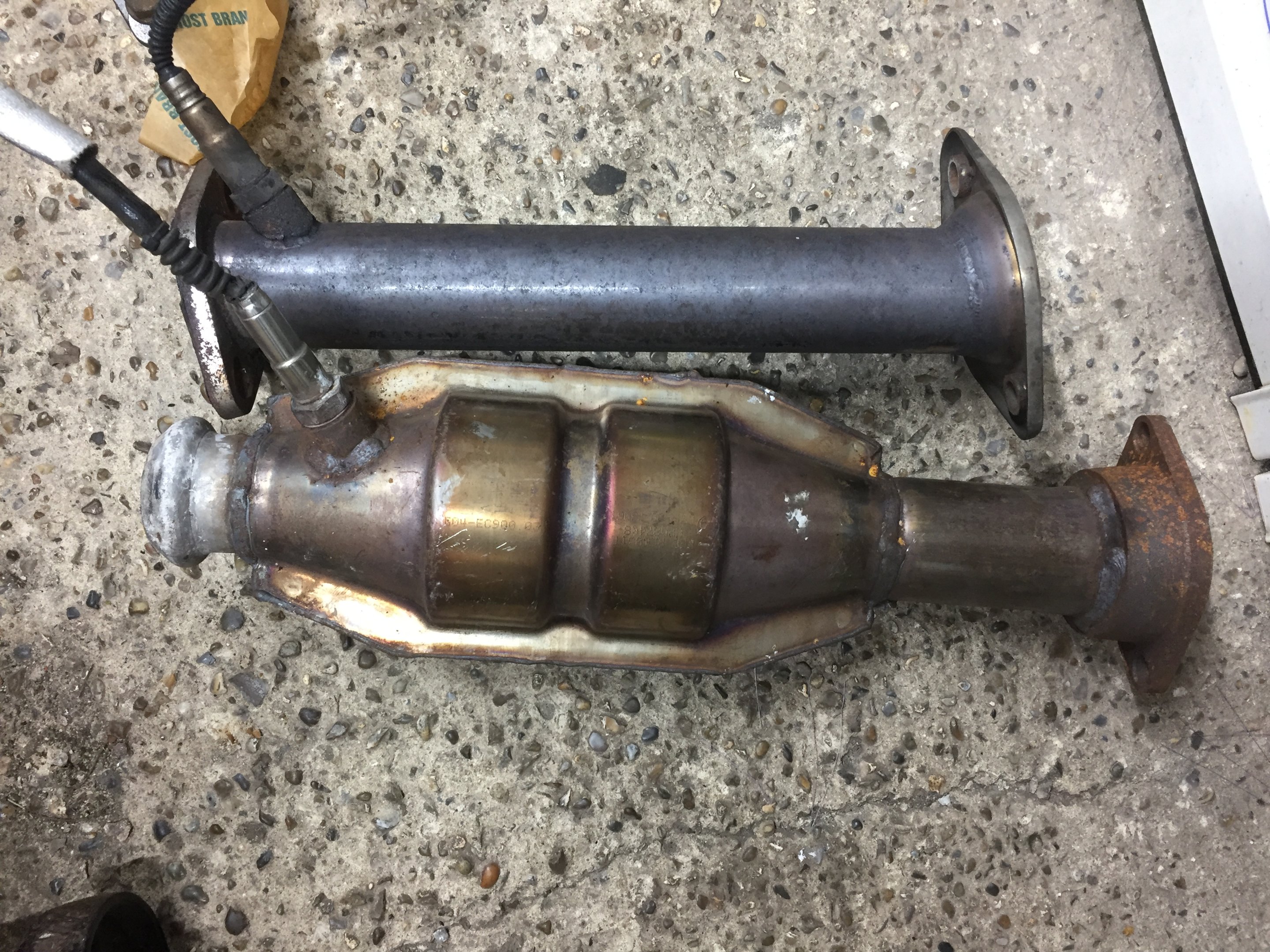

  • 182 manifold-2-172 rear section cat - Had Alex at AW Motorworks make this up for me. If anyone remembered I used to swap the 172 manifold over every year and it had become a total waste of a weekend. This cat takes 10 minutes to swap over now so works a charm.

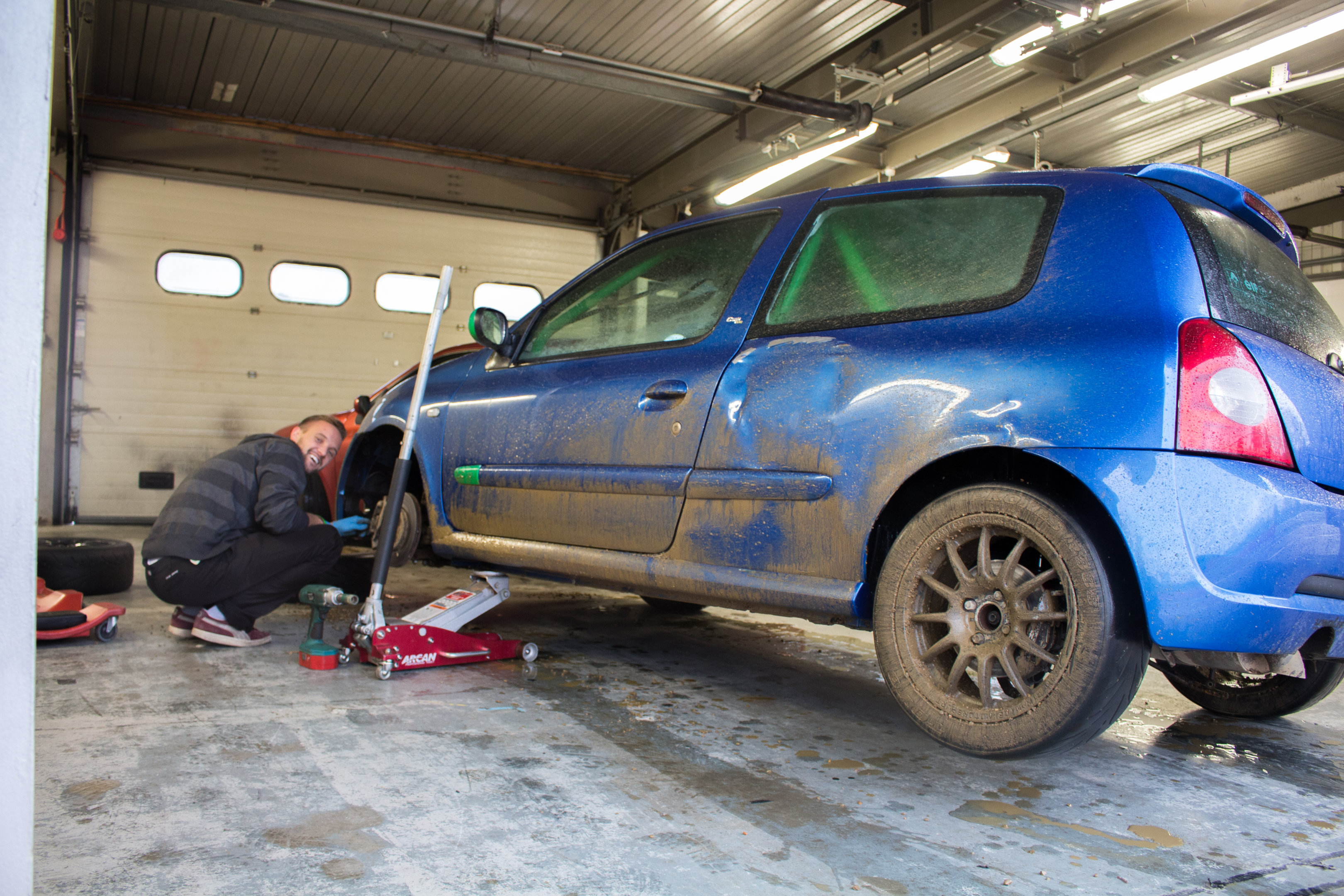

A red flag, quick tow and a short drive later we were able to assess the damage. Mud and stones absolutely everywhere but no real injuries to speak of. The subframe took a small knock but the tracking was OK so who cares! The local hand car wash were very accommodating as it was raining and let us use their beastly pressure washer for a fiver. The local tyre shop equally helped us out a lot and downed tools to clear the stones out of the N/S wheel beads. After an hour we were back sorted and on track.
Look how happy he was with the stones in the brakes ?
Throughout the afternoon we tried a load of different tyre combintions and settled on using some fresher R888.
