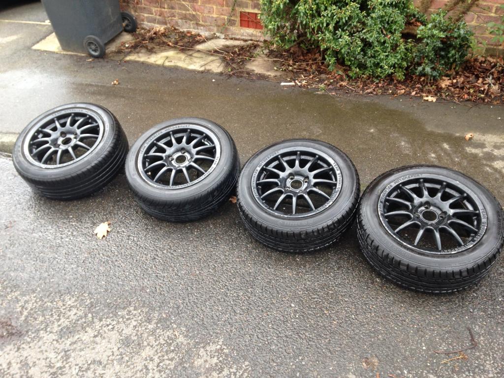

  • R-Racer alloys and uniroyal rainsport 3 tyres

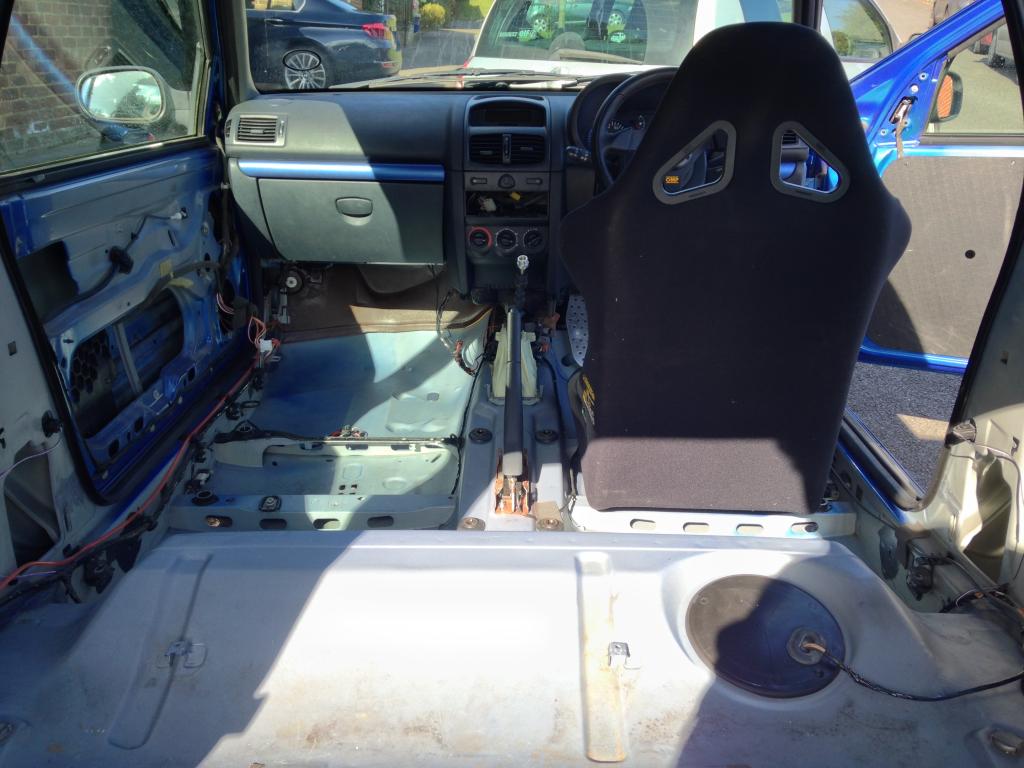

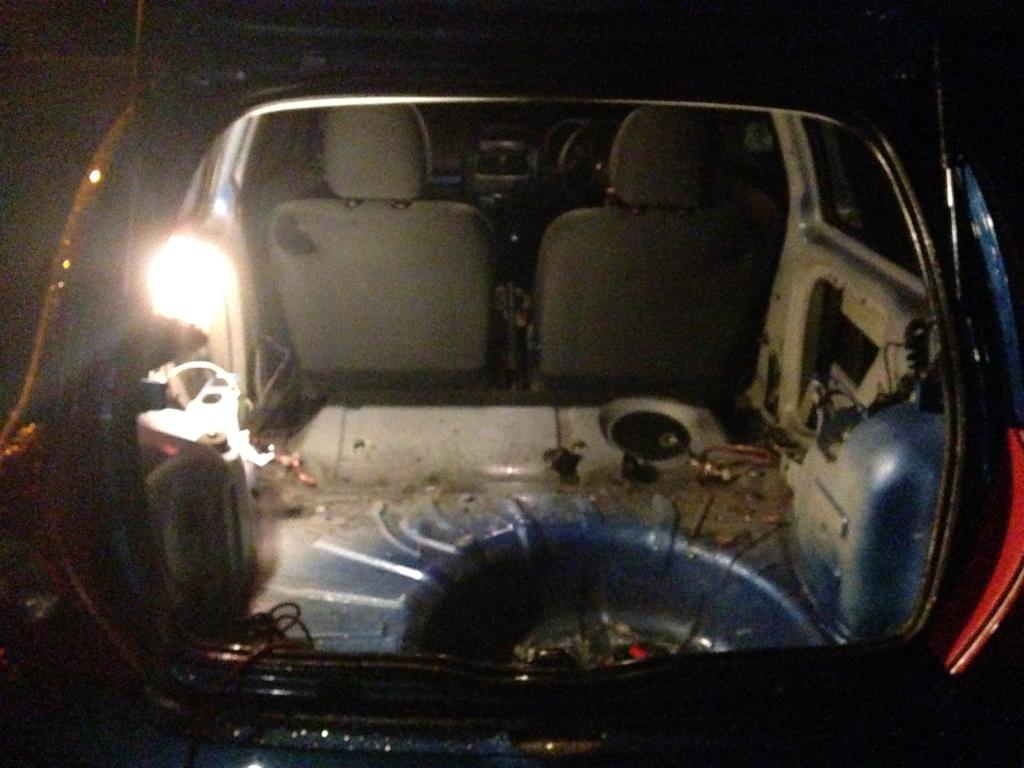

Made a start on stripping the car today. As I was last time, I'm surprised at how much there is to remove. Weight must add up to a fair bit. Rest of it will come out over the next week. It was just a little too wet on the ground today to get under and take the seats out. Wow this is an awful photo.
Does anyone have any suggestions on removing the tar from the inside of the c pillar and rear quarters without damaging the paint on the outside.

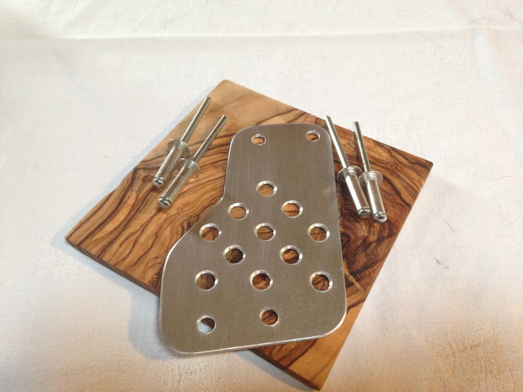

First was the heal toe throttle pedal from @NorthloopCup

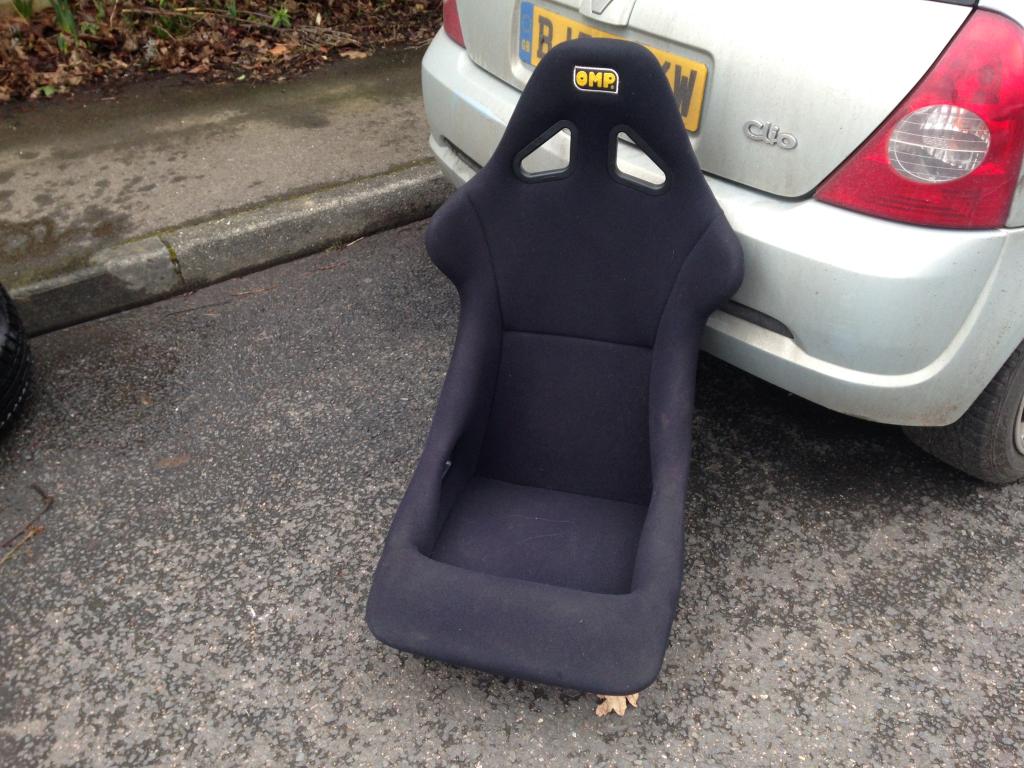

Then an OMP eco seat. It's base mount which I'm not too sure about but we shall see! Will be the passengers seat with the drivers being a Bimarco when a little more money comes through.

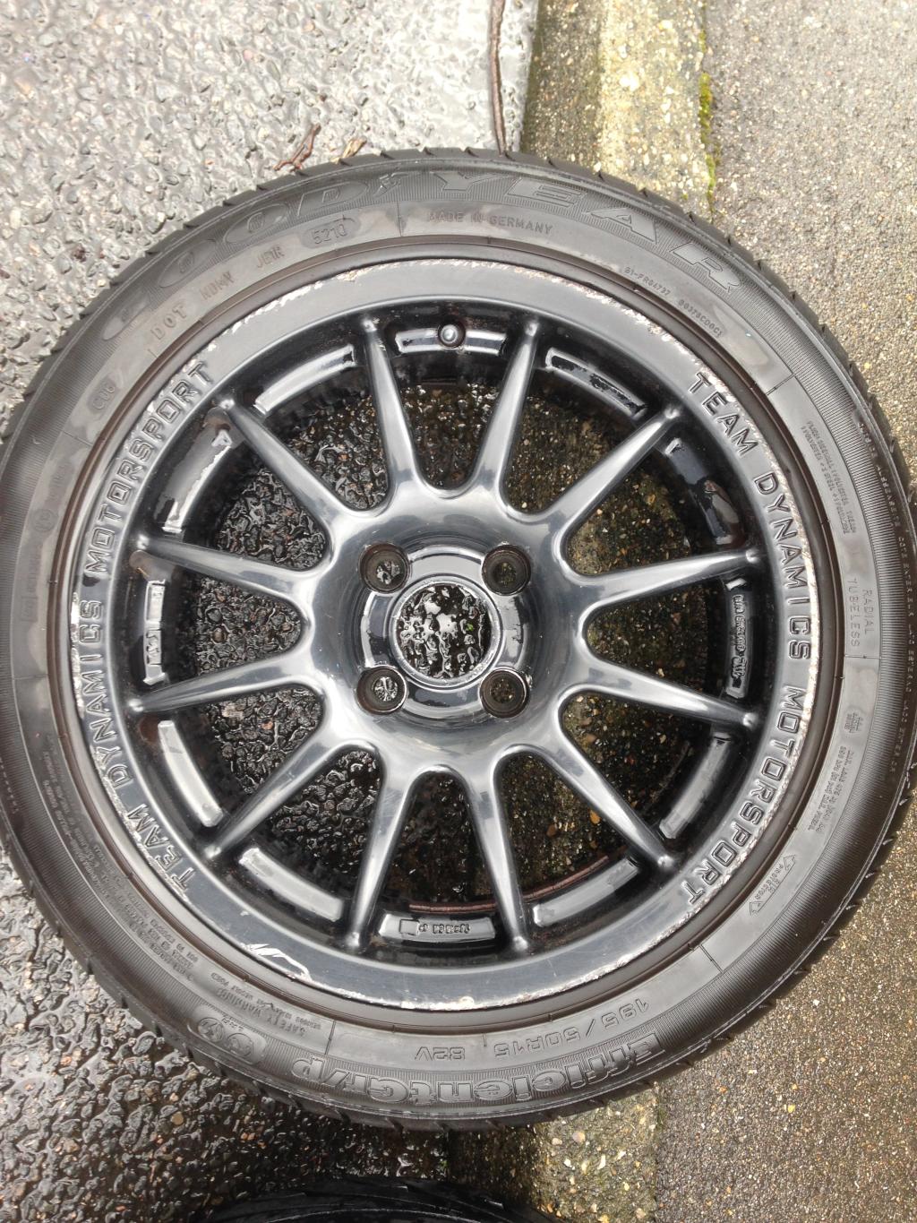

Last but not least I got an absolute steal on these team dynamic pro race 1.2 after I spotted them for sale on facebook last night. Got good tyres; 2 are okay and 2 are brand new. et 41 which is okay but I'll probably run some thin spacers for them. I'll put the semi slicks on these so I don't have to change the tyres on my winter wheels.

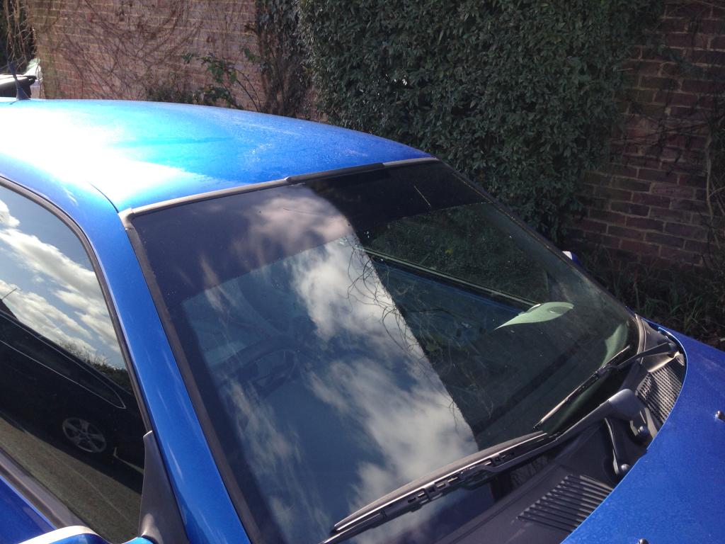

Tomorrow is my birthday and I've asked for a foot rest cover, sunstrip (when interior is out) and side mounts for the bucket seats (this is the problem with the OMP seat).

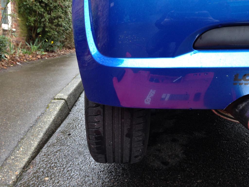

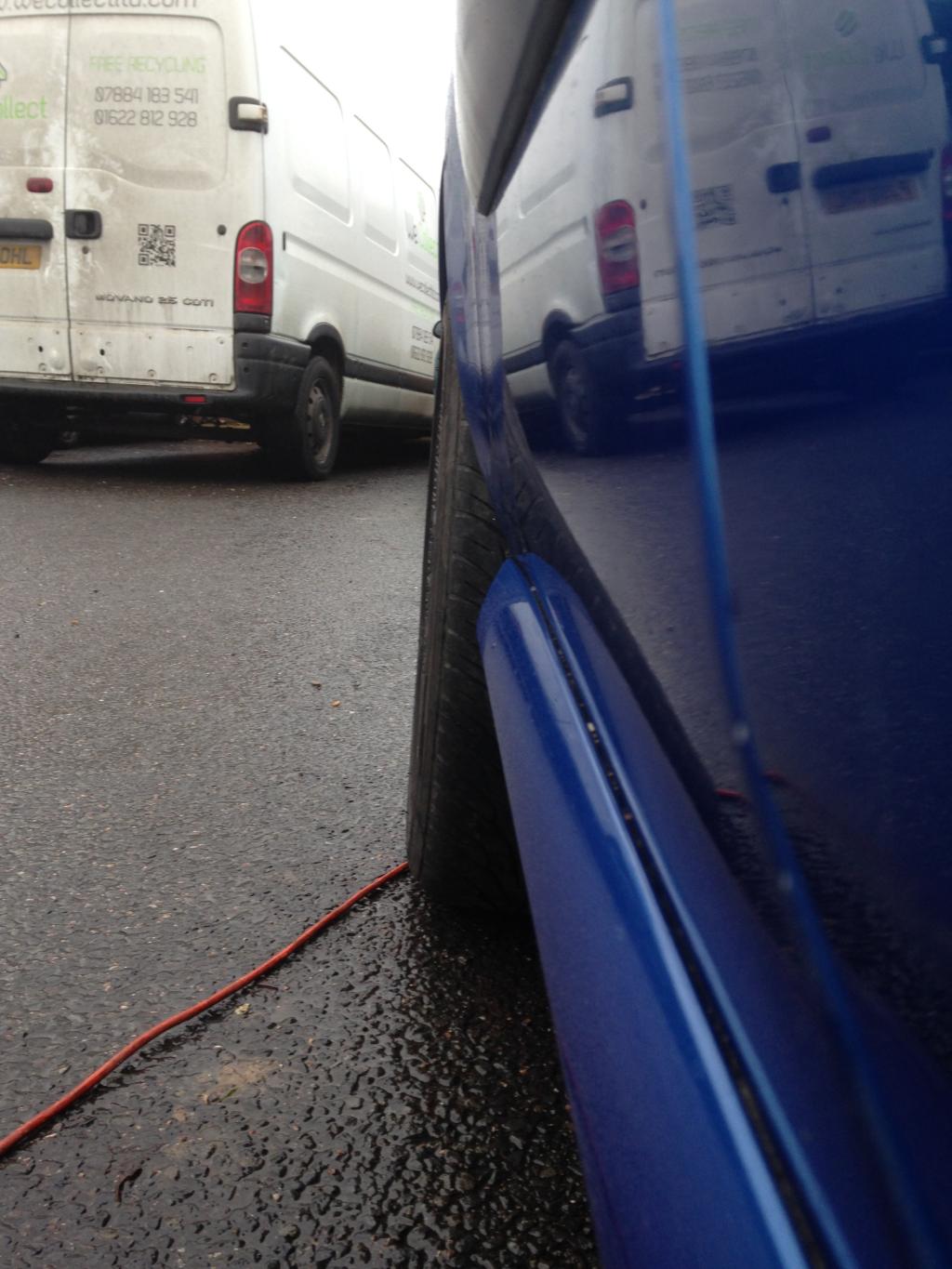

The rear wheels looked totally lost in the arches so decided to sort that. I had some 15mm hub spacers from the ph1 I had in the summer so decided to pop those on. Previously I had an absolute nightmare doing this job so expected it to take all day. This time though I decided to wirebrush the threads with the dremel before taking off the stub axles. What a differerence that made; had it all done in less than 2 hours.
Before
During
After

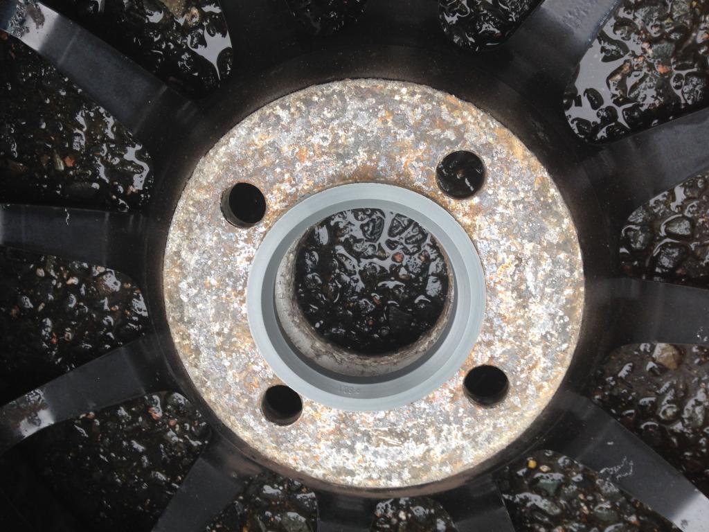

Whilst doing this I popped the spigot rings in the wheels

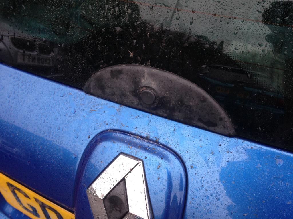

Removed the rear wiper

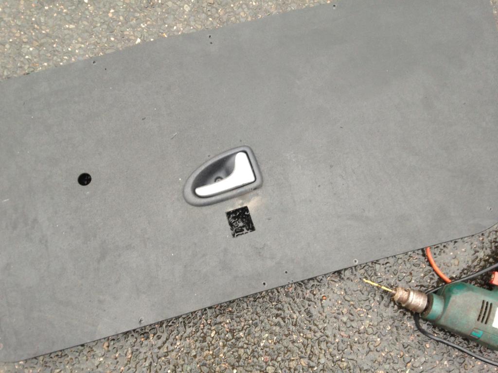

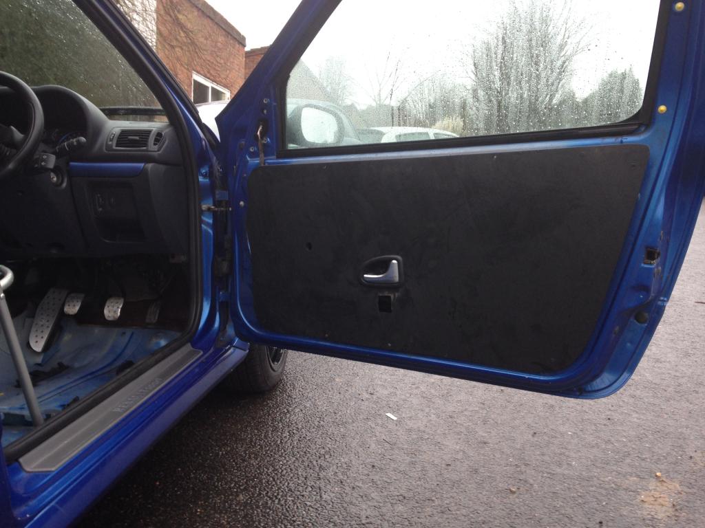

Then I started working on the door cards. The car came with some track door cards but I needed to add in the window switches. I cut up the handles from the car and glued the window switch frame to the back of the card. All mocked up, just need some proper trim fixings for them to screw into the door.

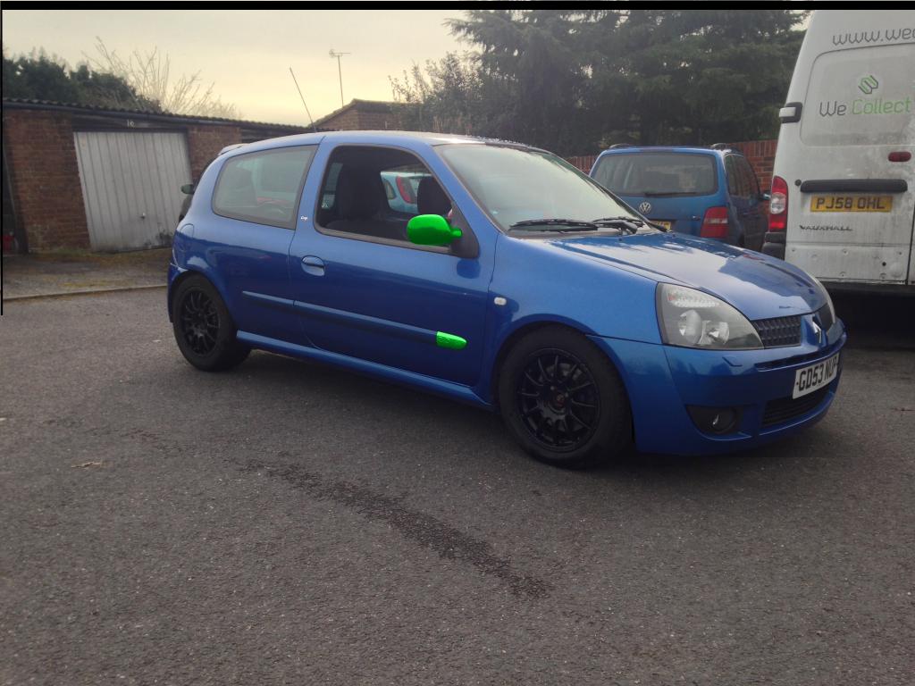

Sorry @NorthloopCup but I'm probably going to be going green with mine but much more shoddily done. Quick mock up from last weekend.

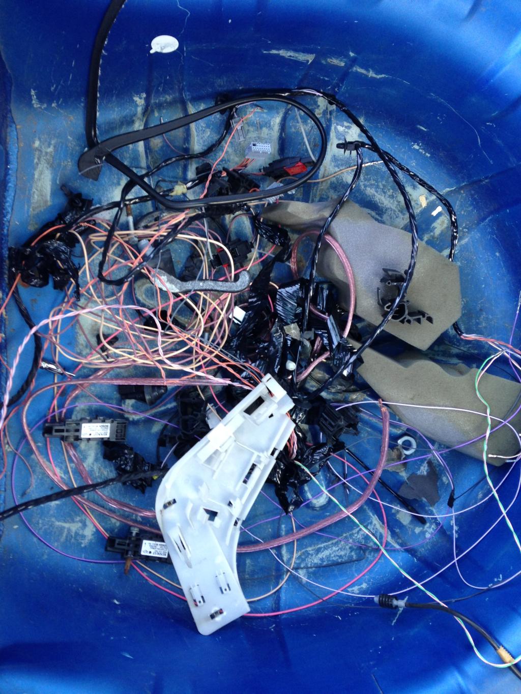

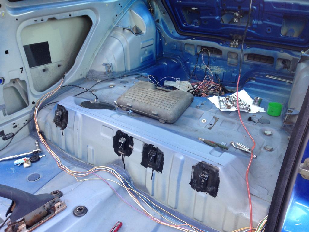

Today I have a little but rather boring update. Sunday was meant to be my work day but I felt brain dead so the product was likely to be rubbish. Decided to fit my sunstrip which was almost impossible with one person and stupid amounts of wind. Got there in the end though after lots of flapping.
Ripped out the headlining and a few other bits of plastic from the inside and changed the garden chair for the bucket seat. There are 2 conveniently placed holes on the original seat bars to bolt in the front of the bucket and it's now a touch safer to move in and out of the garage before I get the sumbframes.
I then started to strip the loom and tidy it up in the back after seeing @Chambers_RS run his rear loom down the 1/4 panels. Managed to take out the wiring for the antenna, door close switches and rear speakers. Removed all the pretensioner, seat airbag and side impact sensor wiring back to the airbag ECU so now I can relocate that to where the radio used to sit. Going to get some small conduit to wrap the wires in :)

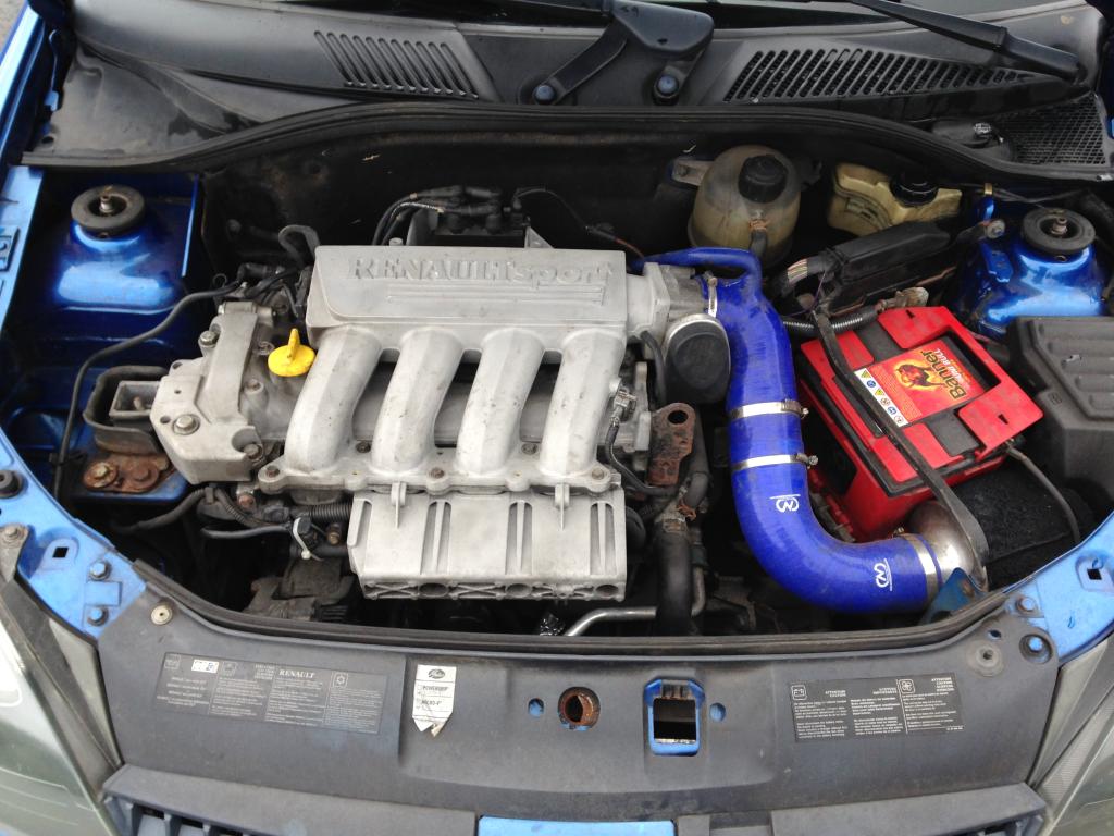

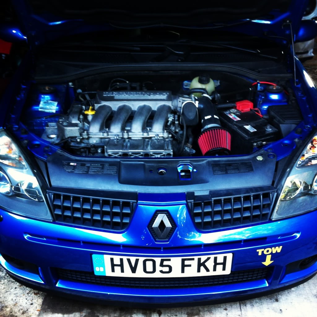

Glad you got a car mate. Just one suggestion really. The silly silicone air intake pipes look silly and don't suit the style of the car atall. If I can make a suggestion of selling them to me them I'm happy to help out :)
GrahamS
  981 Cayman
@Timmsy There's a guy just beyond Brighton who's breaking a 172 so probably has the remaining bits you need. APs should be with me Wednesday and depending on when I get back I might fit them very quickly :D
@imprezaworks I'm glad too!! That intake sounds absolutely mean though! I'll get an Apexi at some point, like I had on my old car. Not for a while so I'm hoarding the hoses until then :)
GrahamS
  981 Cayman
@imprezaworks That filter was the single best mod to that car hands down. I had a ktec style induction before that. Nah, heat soak isn't really a problem with the grill there. Less pipe bends, better power :)
imprezaworks
  Mk5 Golf GTI :)
Interesting, wouldn't have guessed that. The likes of the ep3's when I had one, the induction kit like that bogged some down when the temp outside was hot etc.
sburrell93
Scotland - South
That is an interesting one about the heat soak. My mate (@benji93) had a similar setup when he got his 182 the other week. We compared the intake temps on live data with mine and his, and after giving each car a bit of a booting up and down the road, his temps were around 50C and mine were around 15-20C with the filter tucked in front of the battery.

Wheels are currently in the garage getting the track tyres swapped onto the team dynamics.
