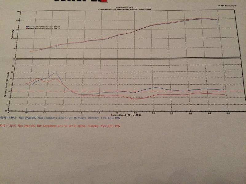

This is my last power run done at Sitech a few months ago after a map tweak.
The decrease in rev drop from 5800 rpm to 6500 , would mean I have around 25whp more after the shift.
Also the engine is still holding onto power at the 7500 limiter so hopefully wont drop too much if I up it to 7800.
