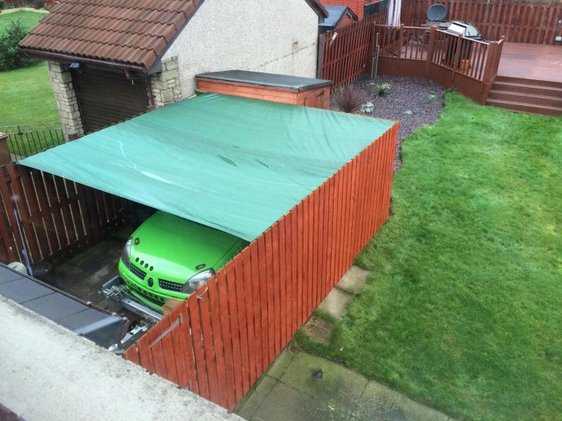

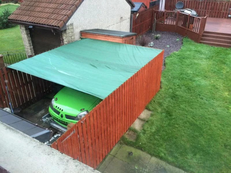

Also made the clio a little shelter to try and keep the worst of the winter weather off it , until I get a proper roof over that area.
Halfords professional small car cover, they're great.

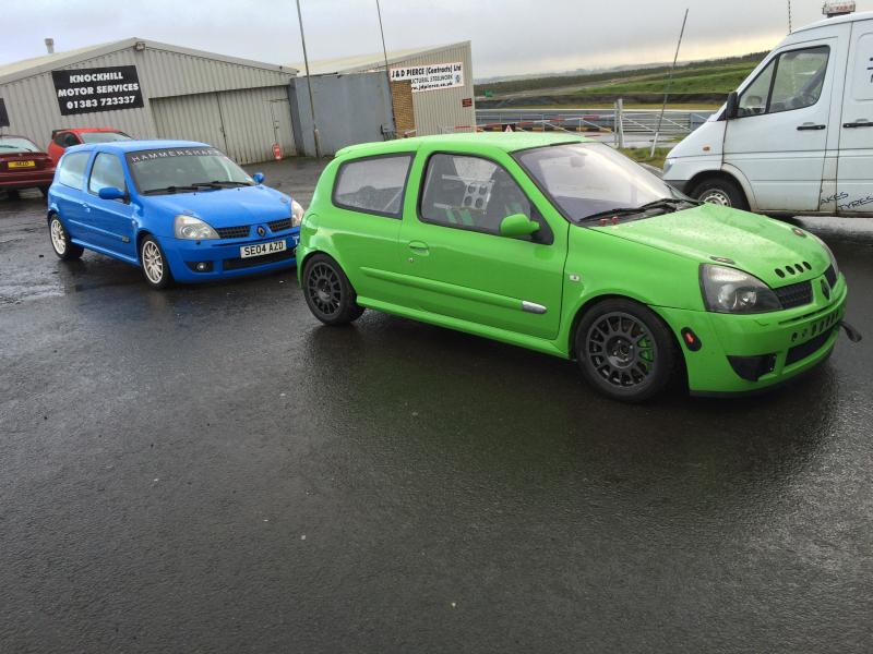

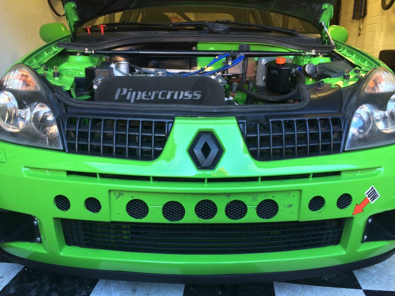

Had the car checked over today and it's good to go as far as regs go apart from needing to cover the holes in the bonnet and bumper for some strange reason. What makes it even stranger is if I the car was road legal they would be ok ???

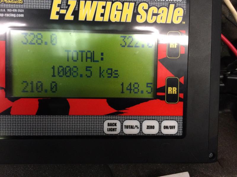

Car weighs 920kg now or 1008kg with me in it. Diet time for me I think lol

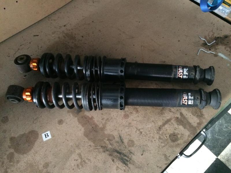

Need to adjust the corner weight slightly when I fit the rear ast's next week.

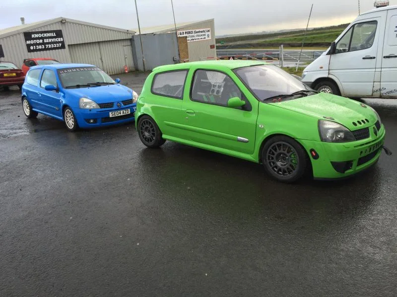

Also seen Neil from the forum up there getting his RB cup checked over
They are using MSA sprint regs , I am trying to find out more info just now about why the holes will mean i need a full race licence.
I should just need a non race National B licence.
I'm surprised they never picked up on your FG doors tbh. I was told distinctly that I wouldn't be getting to race with them from Ian Afek and Rob Mckinna, past and present SMRC S&S's scrut.
You'll have far too much trouble if you're trying to return it to road going from what I understand. They'll want that cage out, roof L&O Ning and and good part of the interior back in etc etc. That was last years regs, have they tweaked them at all this year?
Also what's this about needing a race nat b license? That's one of the points that's attracting people to it... That you can apply for a license on the day!
SLS is following different regs to SMRC you are ok with fg doors along as a cage is fitted, also there is two levels of road legal.
Road legal as you say with full interior and road legal as in you can legally if you wish drive it to and from the track.
This year in SLS they are having a full road trim sub class within each power to weight group.
Be wanting the holes covered up so you dont suck in any wildlife/spectators! ;)

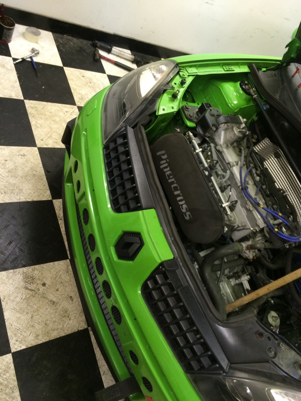

Sorry to go way back a few years but do you have any suggestions of the best way to drill the holes neatly in the bonnet and not make a mess of it. Yours looks very neat and I am in the same situation with ITB's and a carbon bonnet?
Also how did you go about getting the ITB air filter back box? Did you buy the box and cut the holes in yourself or get Jenvy to machine the box to their known dimensions?
Great thread by the way. I am also going to try and replicate the boot butchering. ;)
When i drilled the holes i just covered the bonnet in masking tape , and marked it up then used a hole saw. Covering the carbon in tape should minimise splinters and cracking of the lacquer.
I bought the filter backing box from Riviere as a blank and marked and drilled it myself, really easy to do just bolt the bodies up without the trumpets and mark out the box.

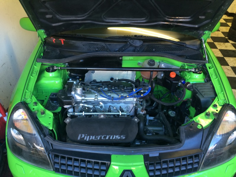

I did strip back one side of the engine bay and painted it up, still got the other side to do which is going to take a bit more time removing parts.

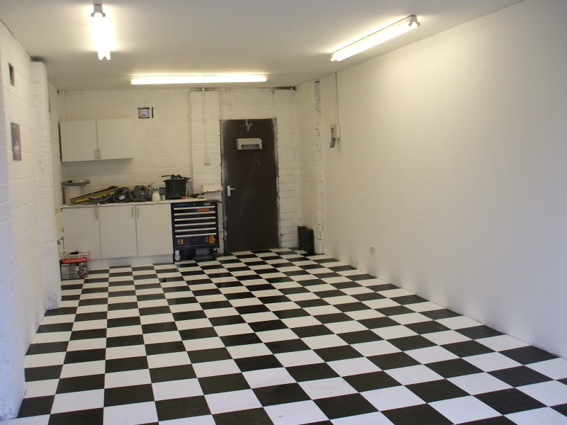

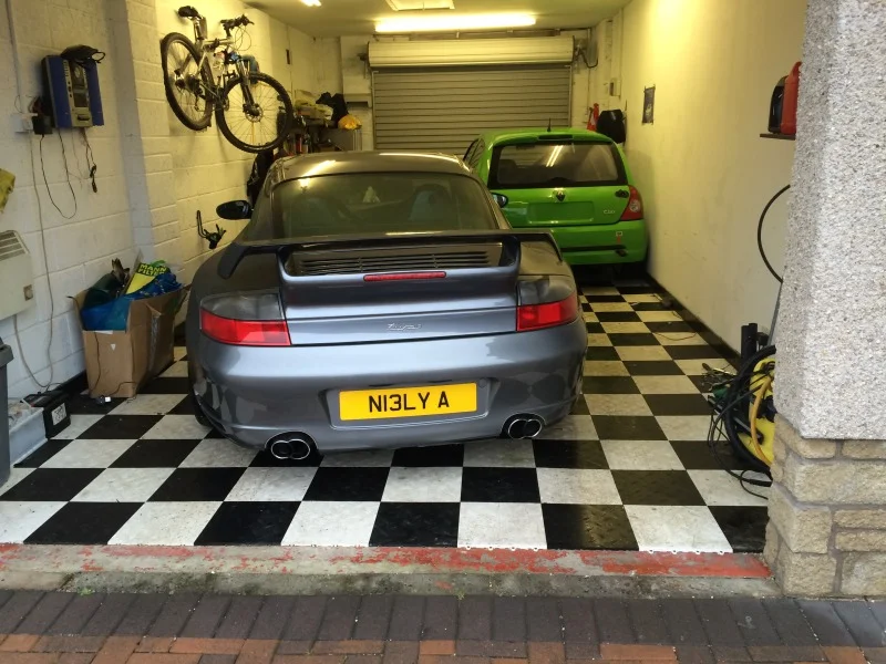

Its 'Racedeck" plastic tiles , they have seen better days now and really needs a good clean . This is how they looked when first put down about 5 years ago.
Finished under the bonnet today :)

Thanks Wayne its not perfect under the bonnet but better than blue, it will get a proper paint job if the engine ever has to come out .
