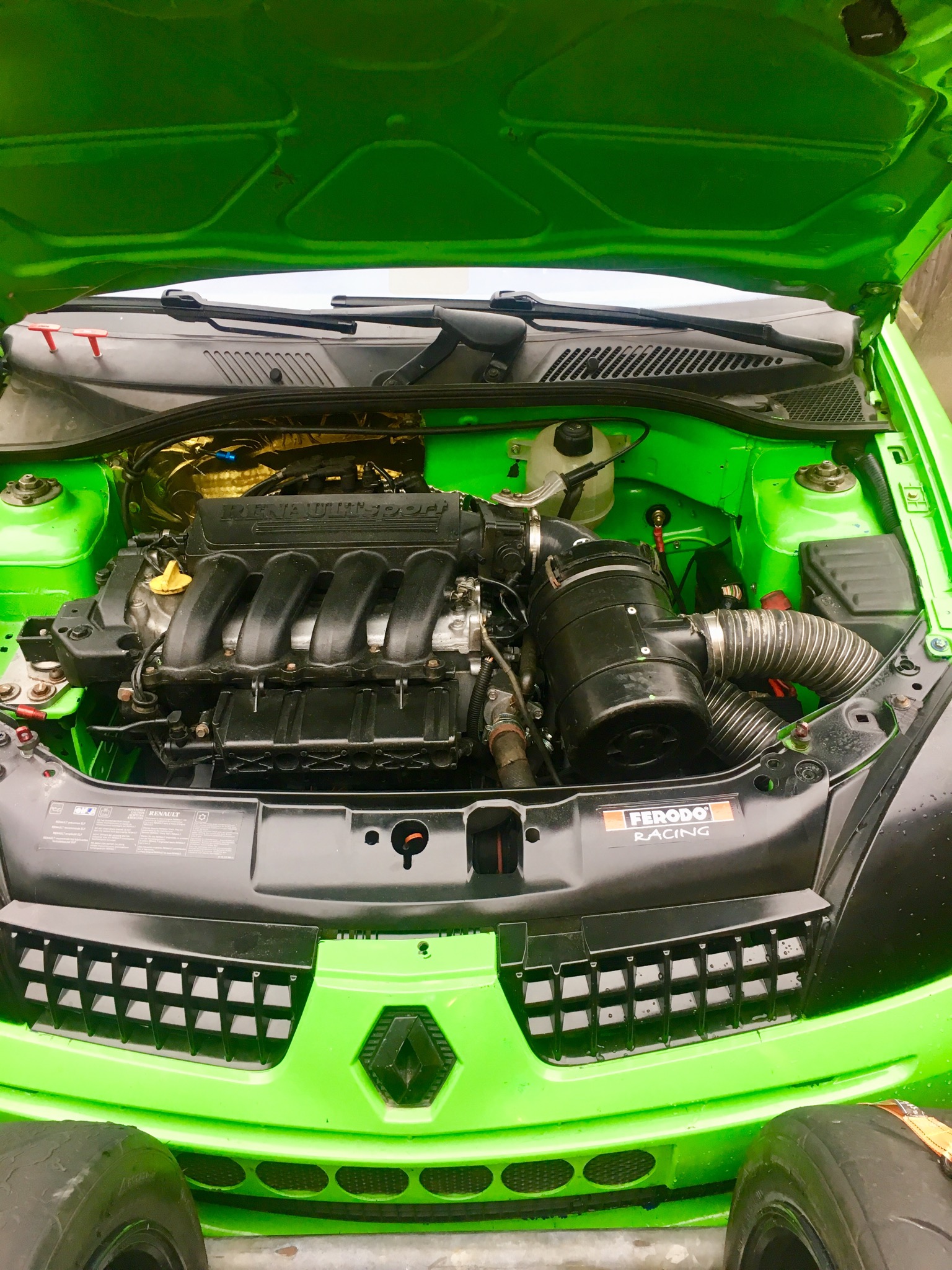

Couple more small jobs done today after I uncovered the car.

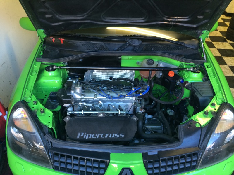

Engine bay cleaned up

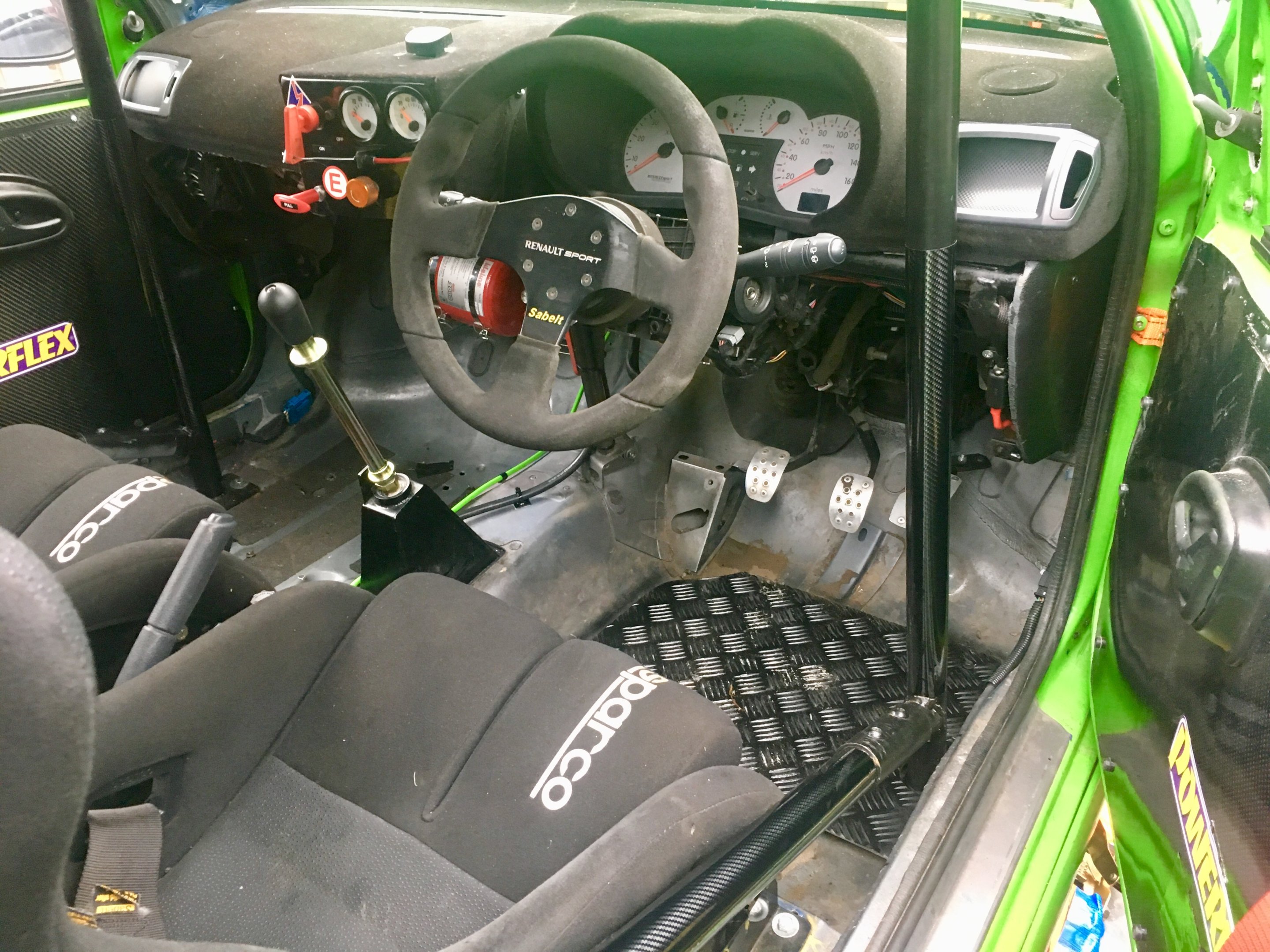

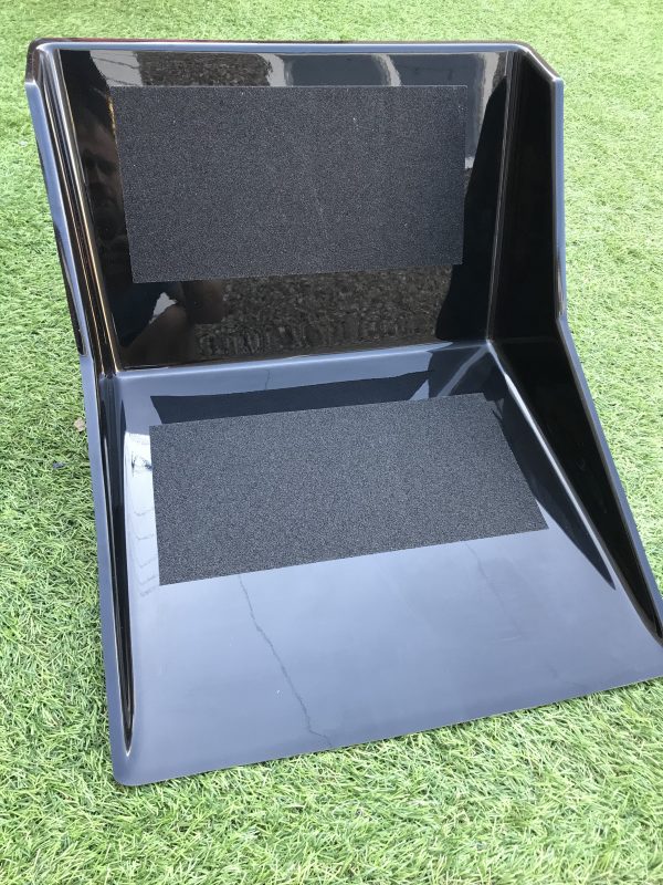

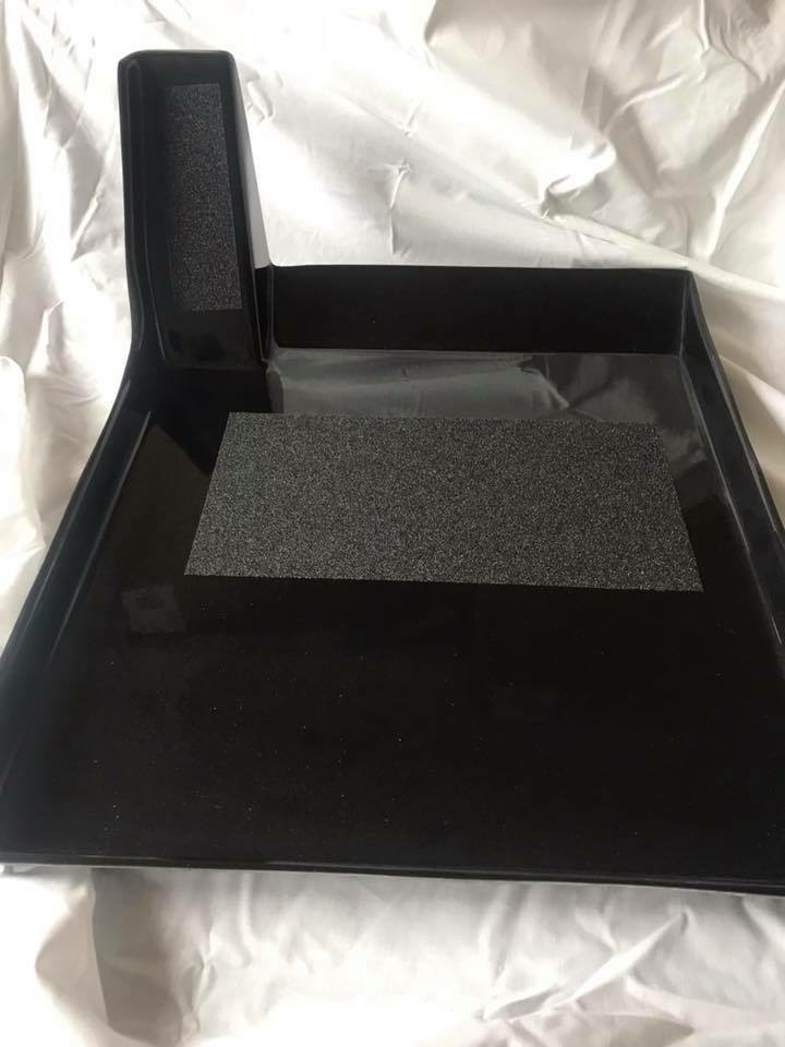

Carbon covers fitted to the cage where it would get rubbed getting in and out
Sun strip fitted

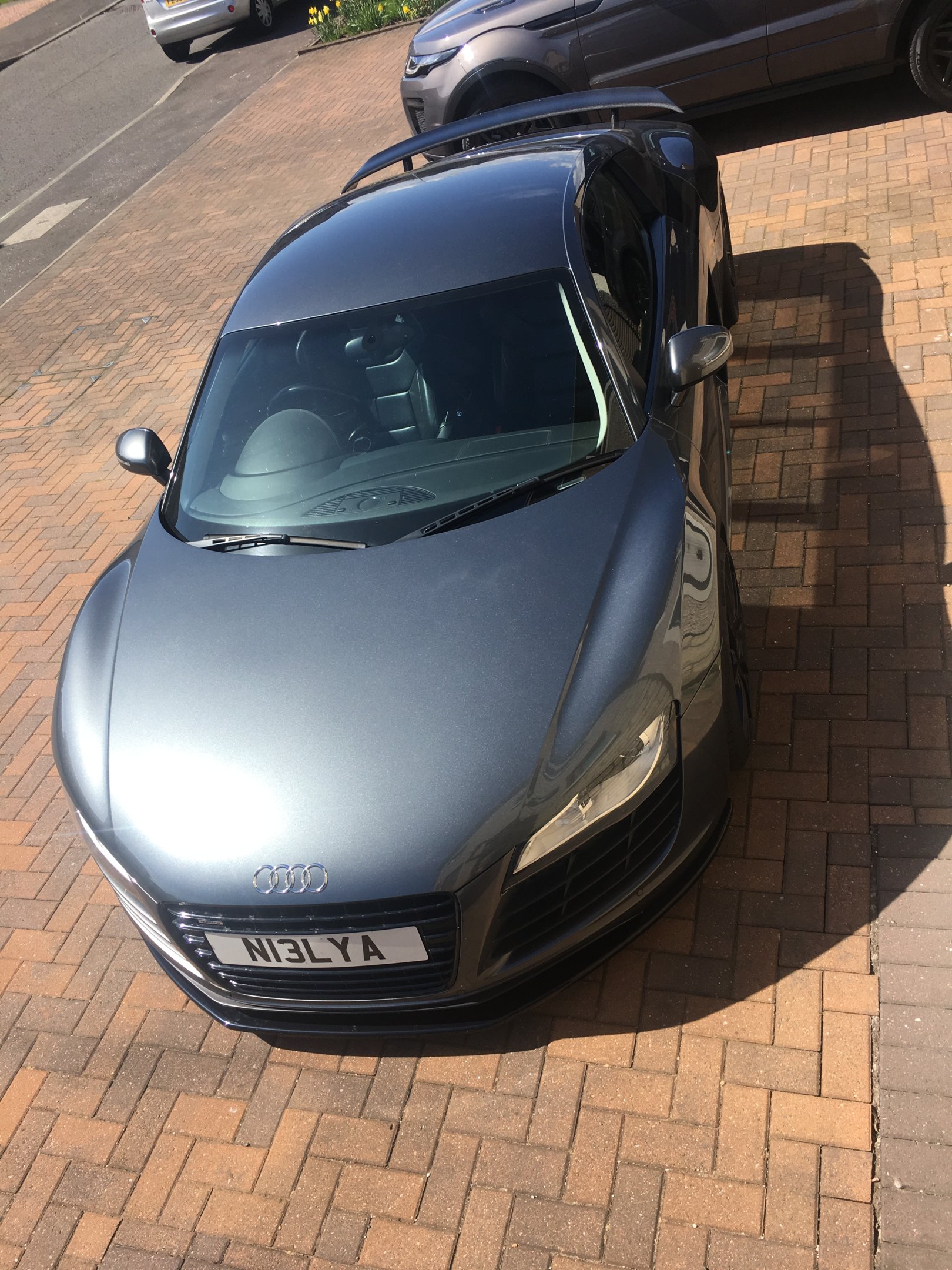

Also a little mod to the Audi , front splitter should be here for that next week as well.

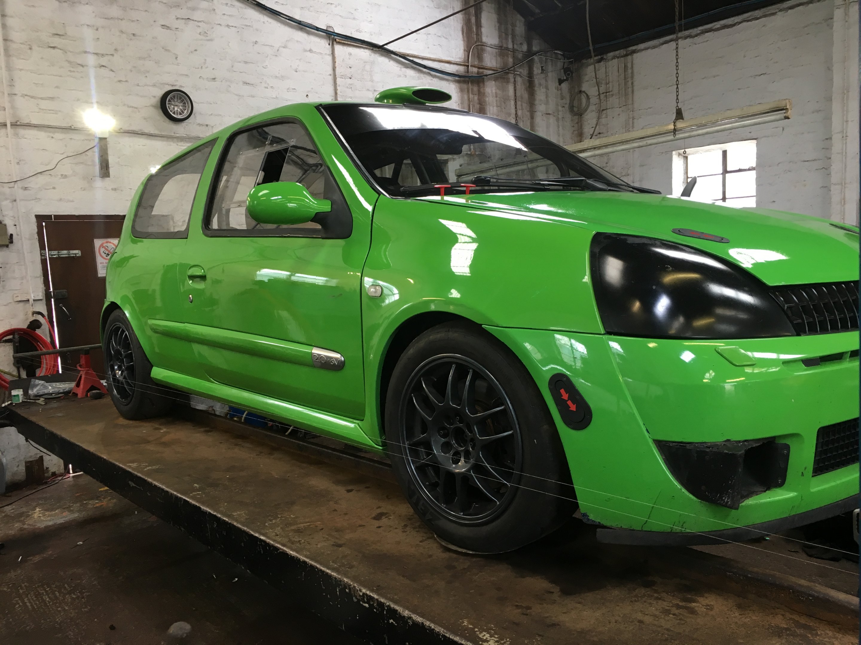

Got loaded up this morning and headed to ALM for alignment.
Up on the ramp and corner weighting done came in at 901kg with 1/4 tank and both seats in. Then it was time to get the strings out for alignment.
All done loaded up ready for home , got some rainsports fitted to spare wheels while I was there.

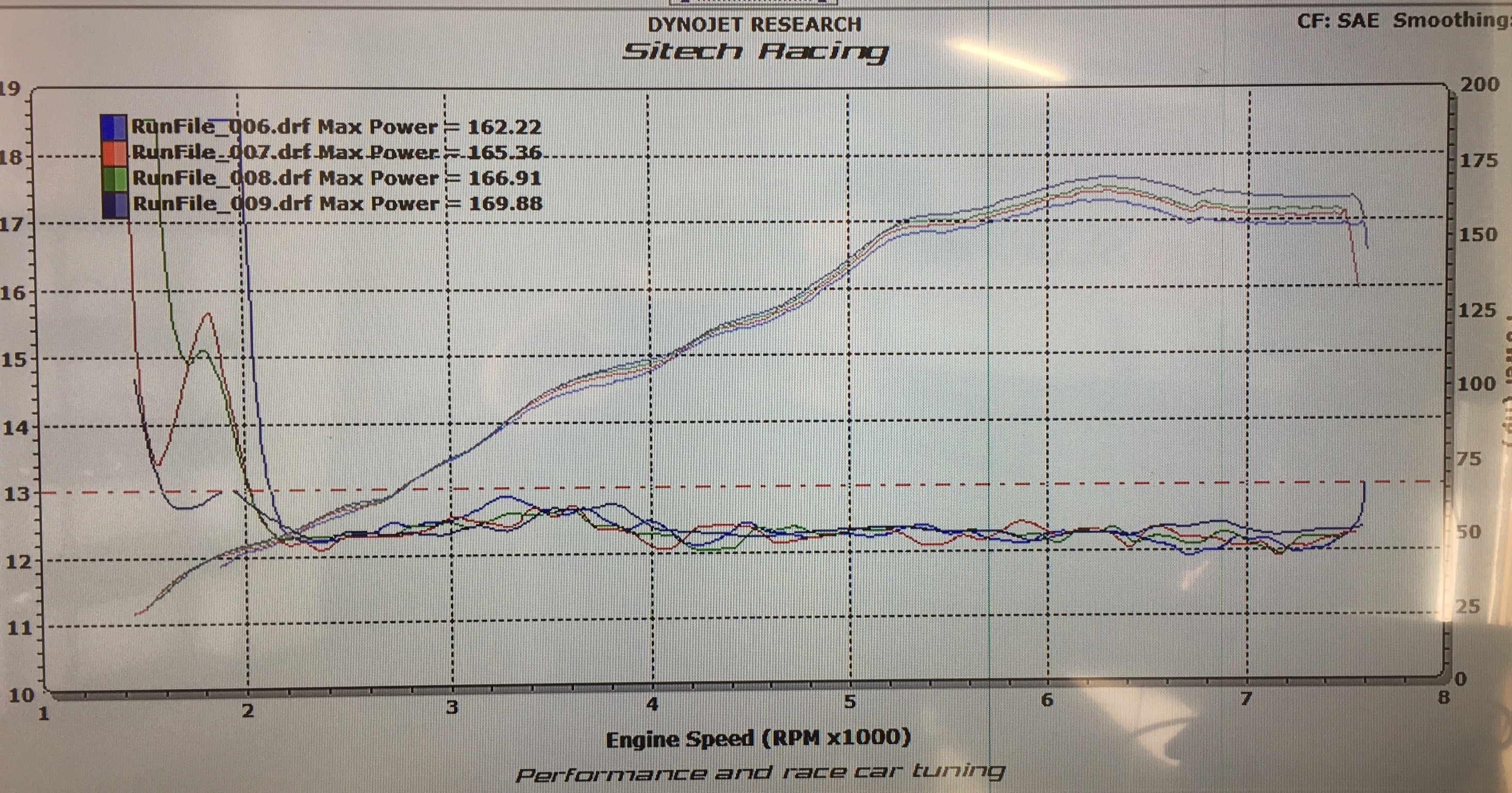

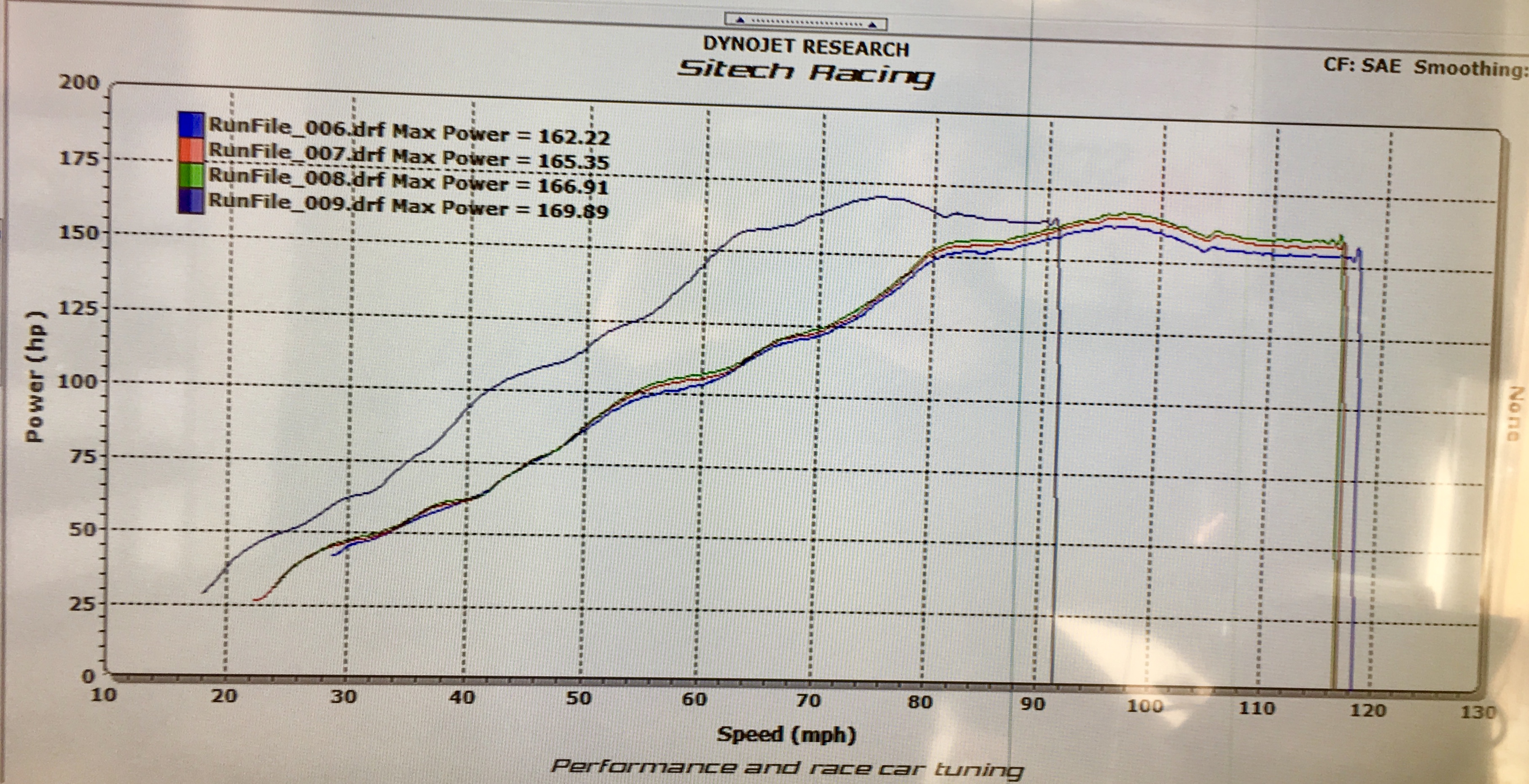

Had the car on a friends dyno this morning to check the fueling.
The engine was mapped by efi in Frasers car with group n timing, I have a 182 manifold and different exhaust but fueling still seems to be safe.
If I was planning on running this engine long term I would take it back to efi for a tweak but justnow I’m just glad it’s safe.
We did a couple of 4th gear pulls and one in 3rd. Showing 169 whp and 154 torque.
4th 3rd pulls
It was on a DynoJet dyne so will be different to the readings the SLS guys have been getting at RA , we did pull my old engines graph it was 205atw on the same dyno, and was 190+ at Performance HQ . Would guess this would be closer to 155atw on the RA dyno

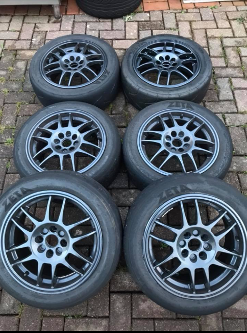

I also picked up a couple of sets of 1.2's with 888R's , so will be selling the Sparco wheels with semi slicks , and multi spokes with semis. Will keep the OZf1's with rainsports.

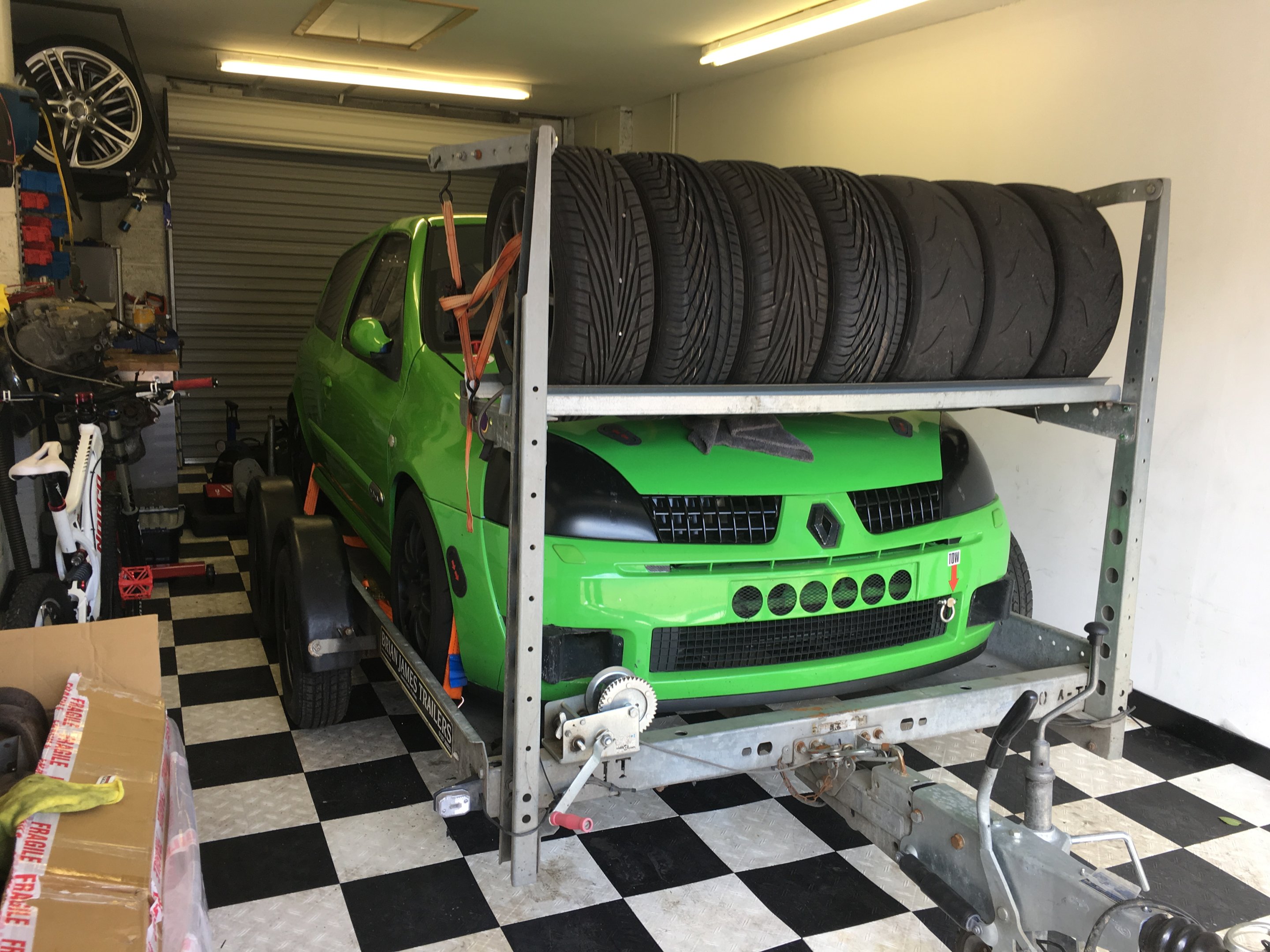

Ive ended up with my old trailer back in a deal with Stu , as the clubman was just a bit too tight for going through my garage door with 20mm clearance , through that deal ive now got the rest of the phase 1 return fuel system parts I need and another complete phase 1 loom that Im going to cut back and re wrap to remove all the unused parts then look at switching it out over winter when hopefully the turbo engine will go in.

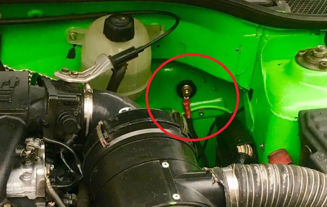

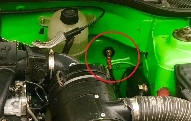

Dear Neil,
could you please tell me where i can get this from?
Ive searched it for so long, and cant find some stuff like this in the net.
Would be so great! Thanks
Dear Neil,
Its called “longacre through panel connector”. Got mine from merlin motorsport.

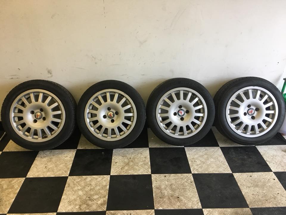

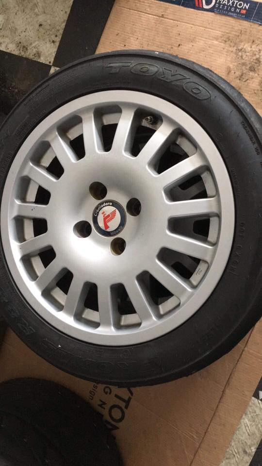

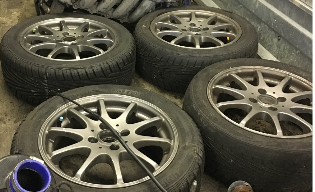

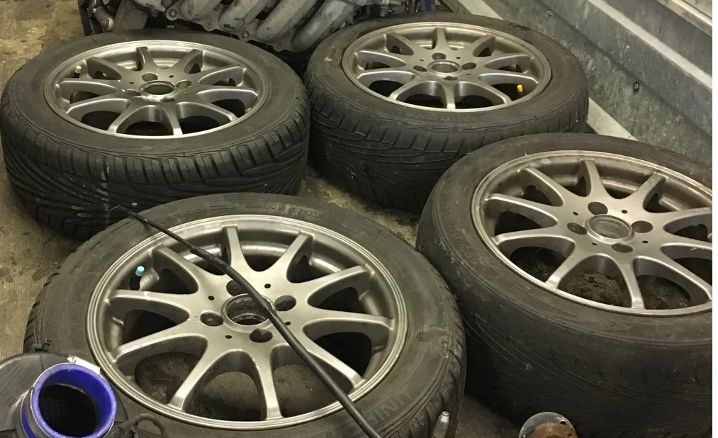

Going be moving house soon so need to shift a few sets of my spare wheels

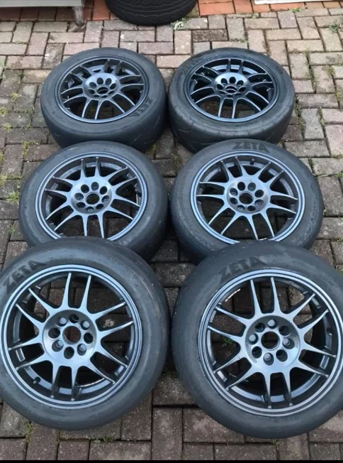

Got these sparco cromodora with 888's £350
And these 6.5X15 wheels now fitted with Maragoni semi slicks , not sure on the make but they are light £120
How much life is left in the 888s Neil? Sorry, I know I have asked you about the wheels before, totally forgot about it!

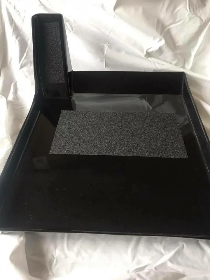

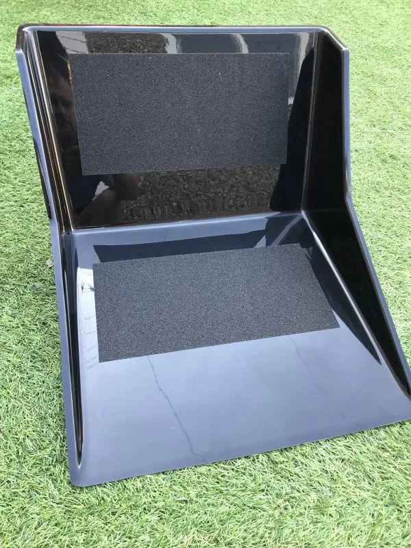

Picked up these as well from CMC to tidy up the interior a little , they will be fitted again over winter when i hope to fit a trimmed down and re wrapped spare loom.

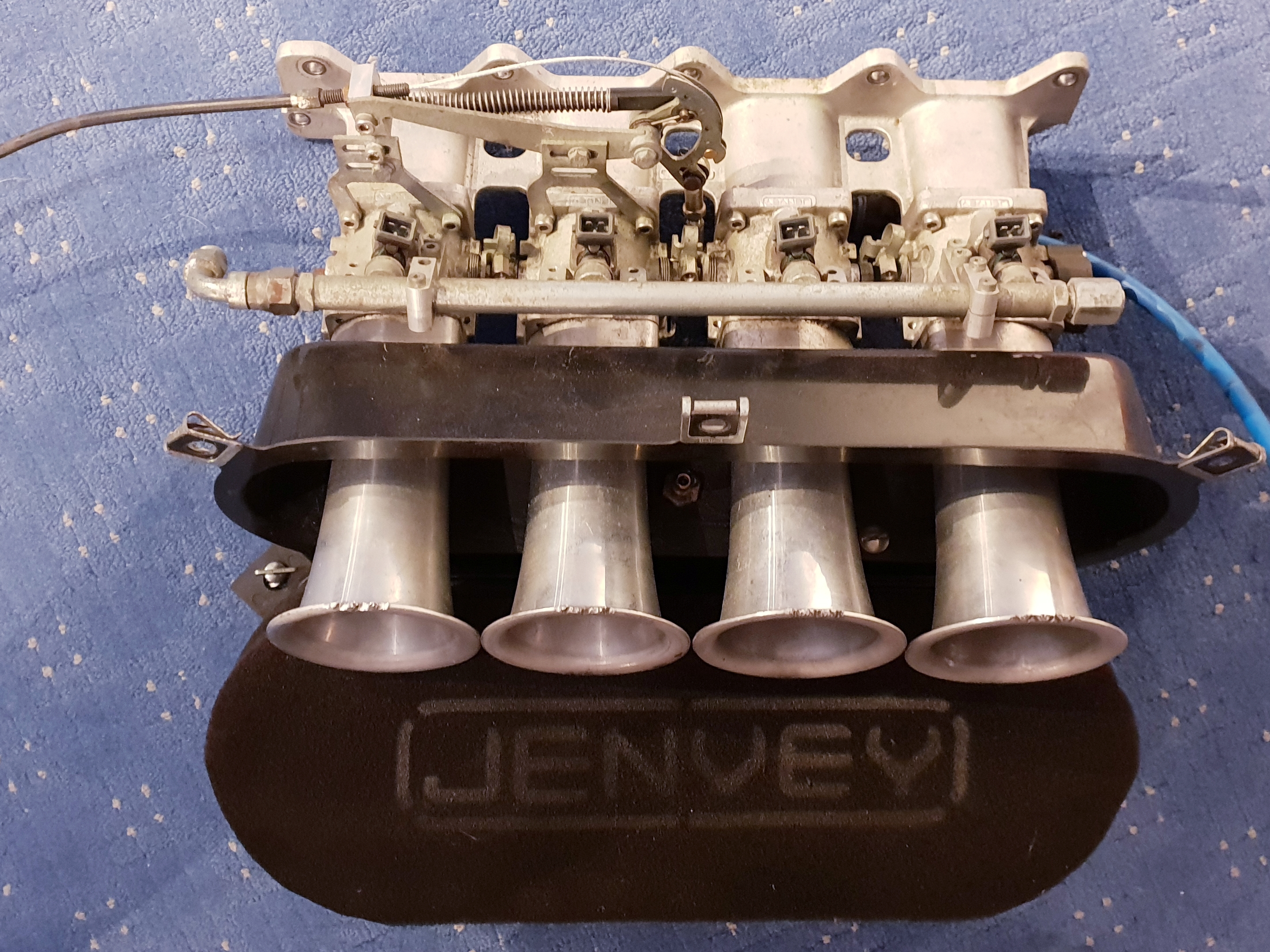

In the last month Ive went from selling it , keeping it and plan to turbo , to buying my old bodies and Omex management back from Stu today.
When i first did the bodies and cams on the car it was fun out on track and more importantly reliable , as the engine in the car is timed to group N settings and I now have the tool for doing the belt changes it makes sense to leave the engine as is and fit the bodies to it.
With the bodies and my old cams the car made 210 bhp before going high comp , with standard cams it will hopefully do 190+ .
The bonus is standard almost throw away engines and shouldnt really have enough power to justify needing a diff for just doing track days.
That and really cant beat the noise of bodies which also makes trackdays more fun, unsure if i may re wire the car this time though as really only have the standard ecu/uch to run the dash and lights. The omex can be used to run the fuel pump and trigger the fans , so would only really need a basic loom for lights,horn, wipers and some form of clocks.

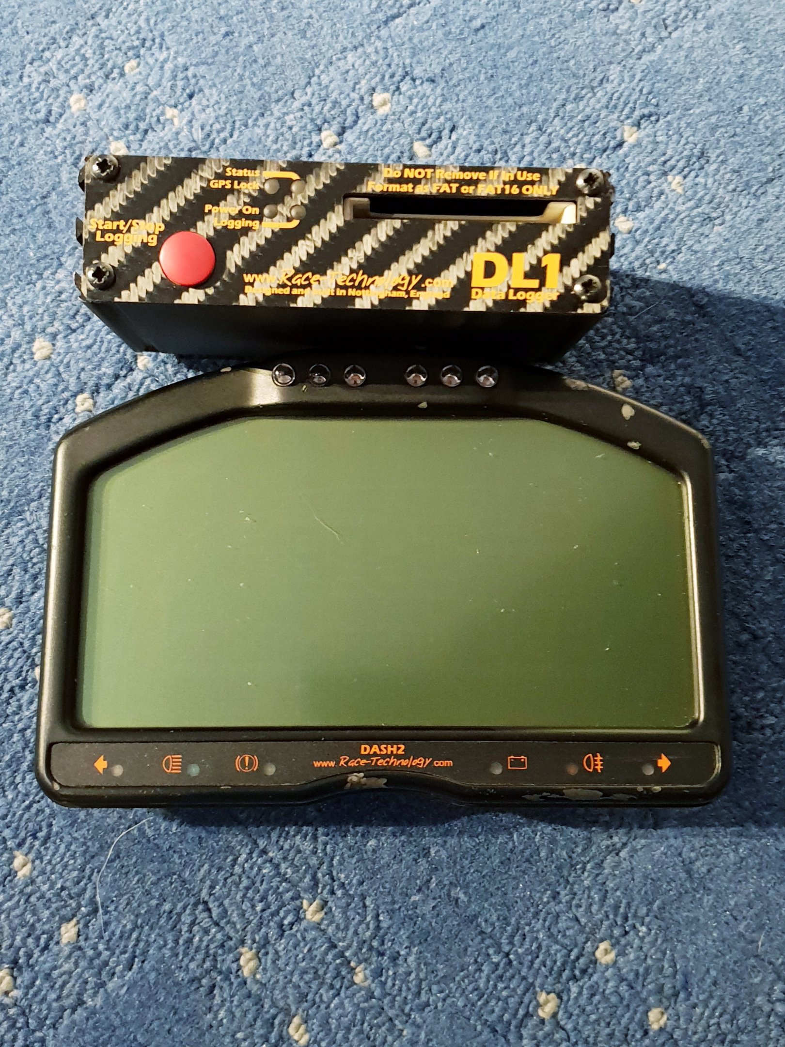

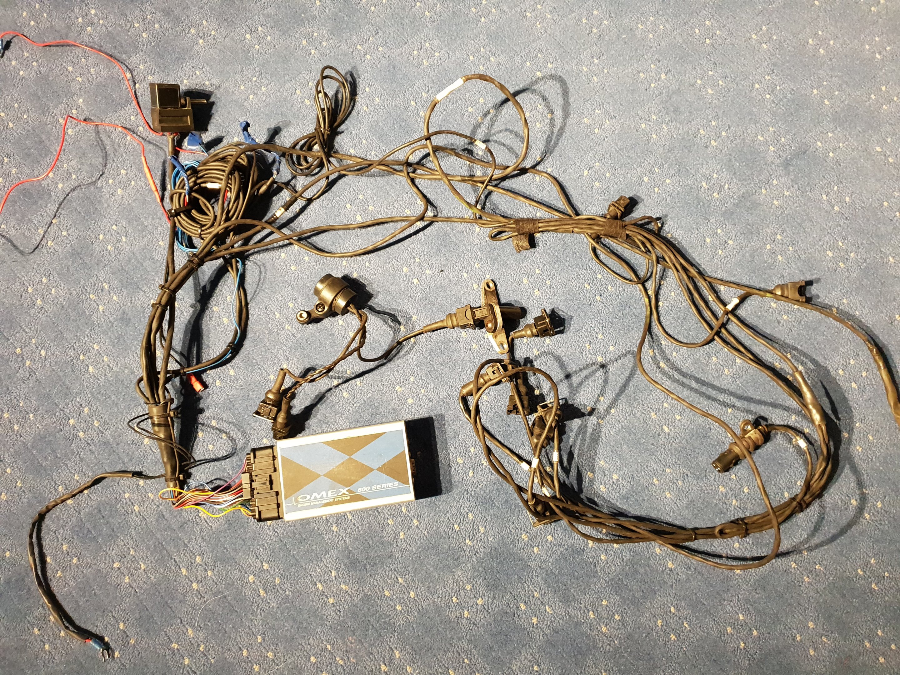

Dash2 and data logger with GPS
Bodies and omex

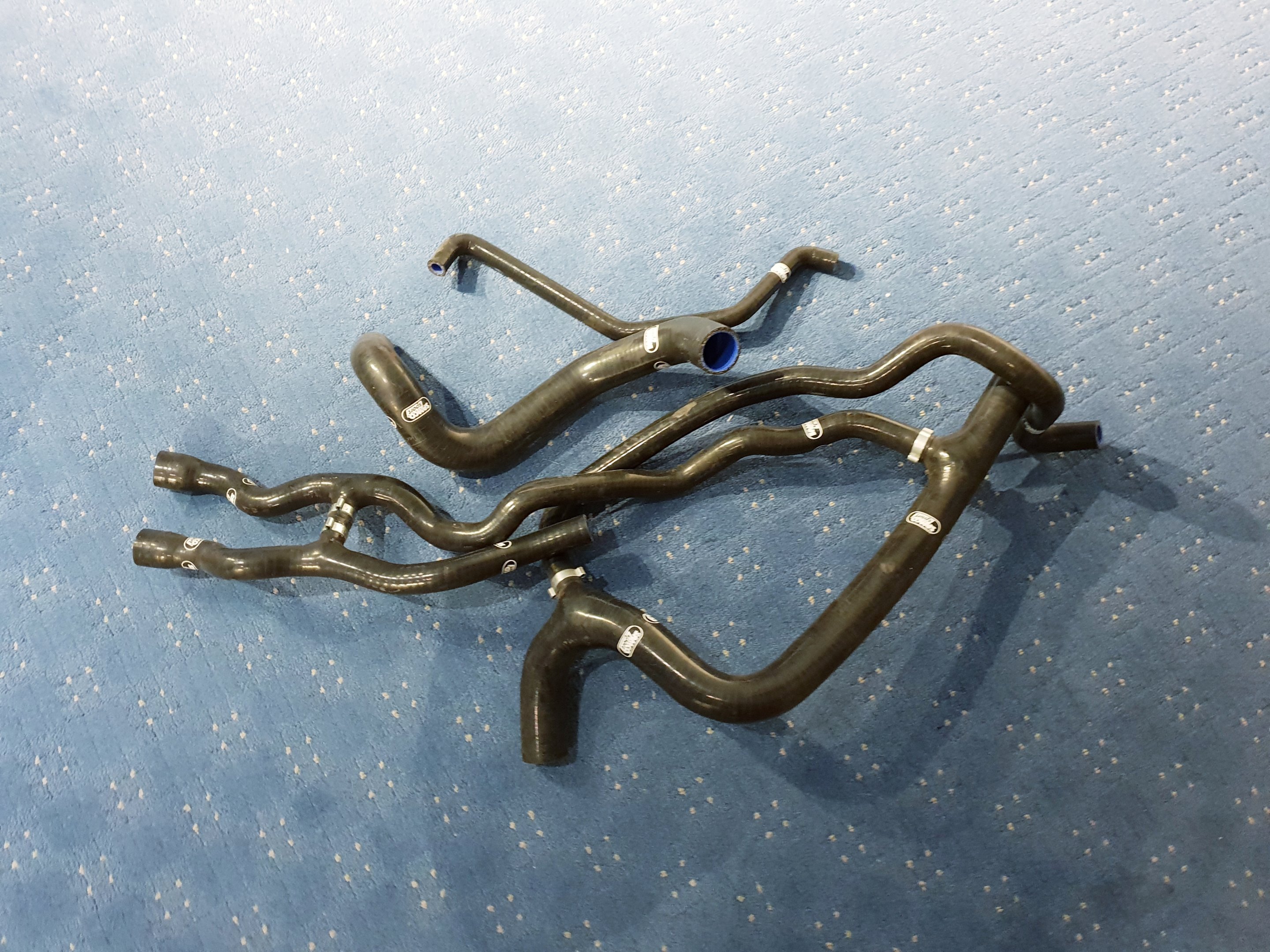

Samco hoses

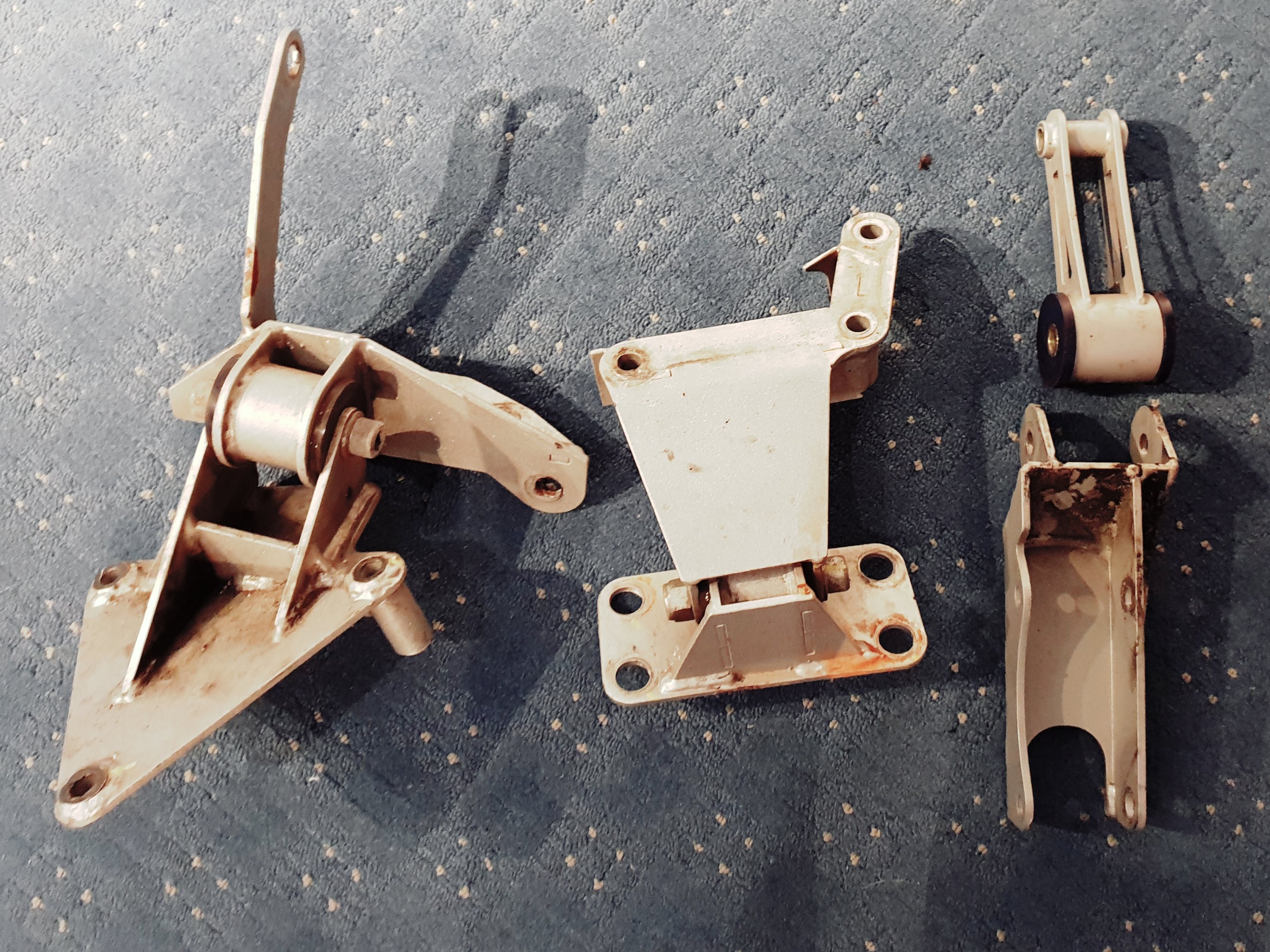

Pure engine mounts

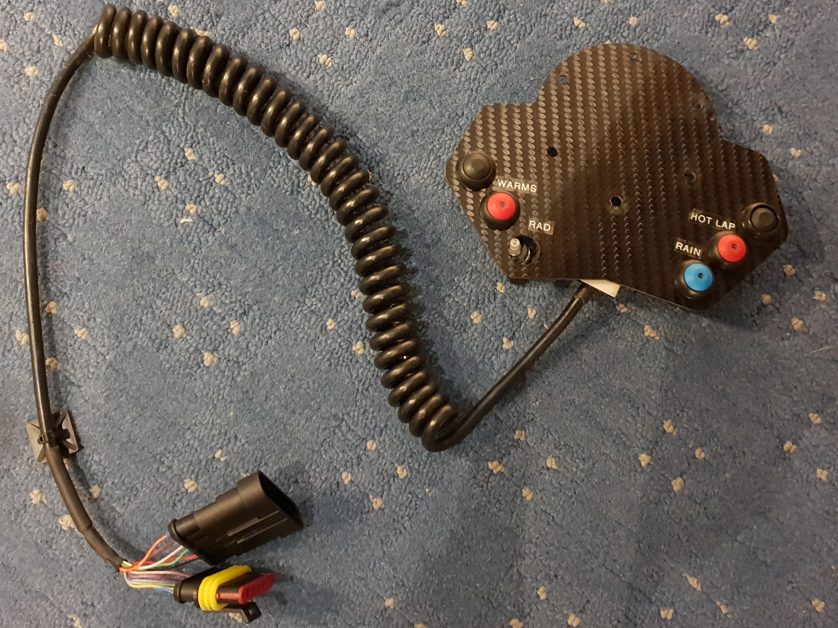

Also picked up button panel for the steering wheel, but might not use it now if I'm going to rewire the full car with custom switch panel
